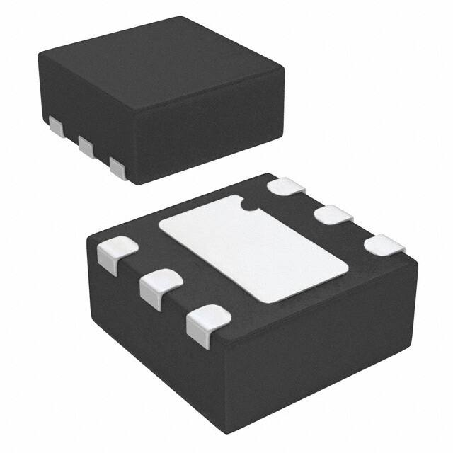

    IC REG LINEAR POS ADJ 1A 6TMLF
MIC37112YMT-TR 数据手册
MIC37110/MIC37112 MIC37120/MIC37122 High-Performance, Low-Noise, 1A LDOs General Description Features The MIC37110/MIC37112 and MIC37120/MIC37122 are high-performance, low-noise, low dropout regulators. Each of these LDOs is capable of sourcing 1A output current, offers high power supply rejection, and low output noise. These general purpose LDOs are most suitable for consumer applications such as multimedia devices, set-top boxes, Blu-ray players, handheld devices, and gaming consoles. The MIC37112 and MIC37122 feature adjustable output voltages while the MIC37110 and MIC37120 come in fixed 1.8V output voltage options. All devices feature 2% initial output voltage accuracy, typical dropout of 230mV at 1A, and low ground current. This family of low-noise regulators is available in 2mm x ® 2mm Thin MLF , SOIC-8 and SOT-223 packages and they all have an operating junction temperature range of −40°C to +125°C. Data sheets and support documentation can be found on Micrel’s web site at: www.micrel.com. • Input voltage range: 2.375V to 5.5V • Output voltage adjustable down to 1.0V (MIC37112/MIC37122) • Stable with small, 2.2µF ceramic output capacitor • 230mV typical dropout at 1A • 1A minimum guaranteed output current • ±2.0% initial accuracy • Low ground current • High PSRR: >60dB, up to 1kHz • Output auto-discharge circuit (MIC37120/MIC37122) • Thermal-shutdown and current-limit protection Applications • • • • • Mobile phones and consumer multimedia devices Set-top boxes and Blu-ray players Gaming consoles Tablets and handheld devices GPS receivers ___________________________________________________________________________________________________________ Typical Application Dropout Voltage vs. Output Current DROPOUT VOLTAGE (mV) 400 VIN = 2.5V VADJ = 0.95 * 1.0V ADJUSTABLE OPTION 300 TA = 25ºC 200 100 0 0.0 0.2 0.4 0.6 0.8 1.0 OUTPUT CURRENT (A) MLF and MicroLeadFrame are registered trademarks of Amkor Technology, Inc. Micrel Inc. • 2180 Fortune Drive • San Jose, CA 95131 • USA • tel +1 (408) 944-0800 • fax + 1 (408) 474-1000 • http://www.micrel.com December 2012 M9999-121312-A MIC37110/MIC37112 MIC37120/MIC37122 Micrel, Inc. Ordering Information (1,2) Part Number Output Voltage Top Mark Output Auto-Discharge Package MIC37110-1.8YS 1.8V ZHG No SOT-223-3L MIC37110-1.8YM 1.8V − No SOIC-8L MIC37110-1.8YMT 1.8V GHZ No 2mm × 2mm Thin MLF-6L Adjustable − No SOIC-8L No 2mm × 2mm Thin MLF-6L SOIC-8L MIC37112YM Adjustable AZZ MIC37120-1.8YM 1.8V − Yes MIC37120-1.8YMT 1.8V 1H8 Yes 2mm × 2mm Thin MLF-6L MIC37122YM Adjustable − Yes SOIC-8L MIC37122YMT Adjustable ZAZ Yes 2mm × 2mm Thin MLF-6L MIC37112YMT Note: 1. RoHS compliant with ‘high-melting solder’ exemption. 2. Temperature range is -40°C to +125°C Pin Configuration December 2012 SOT-223 (S) MIC371x0-1.8 (Fixed) 2mm x 2mm Thin MLF - 6 Lead (MT) MIC371xx (Fixed/Adjustable) 8-Pin SOIC (M) MIC371x0-1.8 (Fixed) 8-Pin SOIC (M) MIC371x2 (Adjustable) 2 M9999-121312-A MIC37110/MIC37112 MIC37120/MIC37122 Micrel, Inc. Pin Description Pin Number SOIC-8 Pin Number SOIC-8 (Fixed) — Pin Name (Adjustable) Pin Number 2mm × 2mm Thin MLF-6L 1 1 1 EN 1 2 2 3 IN 3 3 3 4 OUT Regulator Output. 4 5 ADJ Adjustment Input: Feedback input. Connect to resistive voltage-divider network to set the output voltage of the MIC37112/MIC37122. — 5 SNS Output Voltage Sense Input. Connect this pin at the point-of-load to monitor the output voltage of the fixed output voltage options. Ground. Pin Number SOT-223 -3L — — 2, TAB 5-8 5-8 2 GND — 4 — 6 NC December 2012 3 Pin Description Enable (Input): CMOS-compatible control input. Logic high = enable, logic low = shutdown. Supply (Input). Not internally connected M9999-121312-A MIC37110/MIC37112 MIC37120/MIC37122 Micrel, Inc. Absolute Maximum Ratings(1) Operating Ratings(2) Supply Voltage (VIN) ......................................... -0.3V to +6V Enable Voltage (VEN). ....................................... -0.3V to +VIN Adjust Pin Voltage (VADJ).................................. -0.3V to +VIN Lead Temperature (soldering, 5s) .............................. 260°C Storage Temperature (Ts) ......................... –65°C to +150°C (3) ESD Rating HBM ......................................................................... 3kV Supply Voltage (VIN) ................................. +2.375V to +5.5V Enable Voltage (VEN). ............................................. 0V to VIN (4) Power Dissipation (PD(max))………………Internally Limited Junction Temperature (TJ) ........................ –40°C to +125°C Package Thermal Resistance SOT-223 (θJA) .................................................... 40°C/W SOIC-8 (θJA) ....................................................... 63°C/W Thin MLF-6 (θJA) .............................................. 100°C/W Electrical Characteristics(5) VIN = VEN = VOUT + 1V; IOUT = 10mA; CIN = 1.0 µF; COUT = 2.2µF; TJ = 25°C, bold values indicate –40°C ≤ TJ ≤ +125°C, unless noted. Parameter Condition Min. Typ. Max. Units 5.5 V 2.2 V Power Supply Input 2.375 Input Voltage Range (VIN) Input Supply UVLO 100 Input Supply UVLO Hysteresis Ground Pin Current (6) Ground Current in Shutdown mV 10mA ≤ IOUT ≤ 1.0A 250 500 µA VEN = VOUT = 0V 0.1 5 µA 1 1.025 V Reference Adjust Pin Voltage Adjustable Option Output Voltage Accuracy Fixed Option Load Regulation IOUT = 10mA to 1A Line Regulation VIN = (VOUT + 1V) to 5.5V ADJ Pin Current VADJ = 1.0V 0.975 -2 +2 -2.5 +2.5 -1.0 +1.0 % 0.05 0.5 % 0.01 1 µA 2.3 4.0 A 230 400 mV % Current Limit Current Limit VOUT = 0V 1.2 Dropout Voltage Dropout Voltage (VIN − VOUT) (7) IOUT = 1A Load Discharge Resistance (MIC37120/MIC37122) Load Discharge Resistance VEN = 0V; VIN = 3.6V; IOUT = 3mA 30 Ω 0.75 V Enable Input 1.2 Enable Logic Level High Enable Logic Level Low 0.65 EN Hysteresis 100 EN Pin Current December 2012 0.25 mV VEN = 0.2V (Regulator Shutdown) 0.1 1 VIN = VEN = 3.6V (Regulator Enabled) 0.1 1 4 V µA M9999-121312-A MIC37110/MIC37112 MIC37120/MIC37122 Micrel, Inc. Electrical Characteristics(5) (Continued) VIN = VEN = VOUT + 1V; IOUT = 10mA; CIN = 1.0 µF; COUT = 2.2µF; TJ = 25°C, bold values indicate –40°C ≤ TJ ≤ +125°C, unless noted. Parameter Condition Min. Typ. Max. Units 140 500 µs Enable Input Start-Up Time Minimum Load Current 10 Minimum Load Current mA Thermal Protection Over-Temperature Shutdown TJ Rising 160 °C 15 °C Over-Temperature Shutdown Hysteresis Notes: 1. Exceeding the absolute maximum rating may damage the device. 2. The device is not guaranteed to function outside its operating rating. 3. Devices are ESD sensitive. Handling precautions recommended. 4. PD(max) = (TJ(max) – TA) ÷ θJA, where θJA depends upon the printed circuit layout. See “Applications Information” section. 5. Specification for packaged product only. 6. IGND is the quiescent current. IIN = IGND + IOUT. 7. VDO = VIN – VOUT when VOUT decreases to 98% of its nominal output voltage with VIN = VOUT + 1V. For output voltages below 2.25V, dropout voltage is the input-to-output voltage differential with the minimum input voltage being 2.25V. The minimum input operating voltage is 2.375V. December 2012 5 M9999-121312-A MIC37110/MIC37112 MIC37120/MIC37122 Micrel, Inc. Typical Characteristics GND Pin Current vs. Input Voltage Dropout Voltage vs. Input Voltage 500 250 200 IOUT = 1A 150 100 IOUT = 500mA 50 1.0 VOUT = VIN - 1.0V 400 IOUT = 1A 300 200 100 0 0 2 3 4 5 3 5 6 VOUT = 1.0V IOUT = 10mA 1.000 0.995 0.990 5 6 15 10 5 4 5 6 0.10 0.05 3 0 INPUT VOLTAGE (V) 6 5 6 Load Discharge Resistance vs. Input Voltage 80 VOUT = VIN - 1.0V (ADJUSTABLE OPTION) IOUT = 10mA TO 1A 0.4 0.3 0.2 0.1 VEN = 0V IOUT = 3mA 60 40 20 0 0.0 5 4 INPUT VOLTAGE (V) DISCHARGE RESISTANCE (Ω) LOAD REGULATION (%) 1 December 2012 0.15 Load Regulation vs. Input Voltage 2 4 VEN = 3.6V 2 0.5 3 IOUT = 10mA 0.00 3 Current Limit vs. Input Voltage VOUT = 0V 6 VOUT = 1.0V 0.20 INPUT VOLTAGE (V) 3 5 0.25 2 4 4 Enable Pin Current vs. Input Voltage VADJ = 1.0V INPUT VOLTAGE (V) 2 3 INPUT VOLTAGE (V) 0 4 0.2 2 ENABLE PIN CURRENT (µA) ADJ PIN CURRENT (nA) ADJ PIN VOLTAGE (V) 4 20 3 0.4 Adjust Pin Current vs. Input Voltage 1.010 2 0.6 INPUT VOLTAGE (V) Adjust Pin Voltage vs. Input Voltage 1.005 VOUT = 0V VEN = 0V 0.8 0.0 2 6 INPUT VOLTAGE (V) CURRENT LIMIT (A) GROUND CURRENT (µA) ADJUSTABLE OPTION VADJ = 0V GROUND CURRENT (µA) DROPOUT VOLTAGE (mV) 300 Shutdown Ground Current vs. Input Voltage 2 3 4 5 INPUT VOLTAGE (V) 6 6 2 3 4 5 6 INPUT VOLTAGE (V) M9999-121312-A MIC37110/MIC37112 MIC37120/MIC37122 Micrel, Inc. Typical Characteristics (Continued) GND Pin Current vs. Temperature Shutdown Ground Current vs. Temperature 2.50 400 300 200 100 0 UVLO THRESHOLD (V) 2.0 VIN = 2.5V VOUT = 1.5V IOUT = 500mA GROUND CURRENT (µA) GROUND CURRENT (µA) 500 1.5 VIN =2.375V VOUT = 0V 1.0 0.5 0.0 -50 -25 0 25 50 75 100 125 VIN UVLO Threshold vs. Temperature 2.25 2.00 1.75 1.50 -50 -25 0 TEMPERATURE (°C) 25 50 75 100 125 -50 -25 TEMPERATURE (°C) Dropout Voltage vs. Temperature Dropout Voltage vs. Temperature 500 0 25 50 75 100 125 TEMPERATURE (°C) Current Limit vs. Temperature 500 VADJ = 0.95 * 1.0V ADJUSTABLE OPTION 400 IOUT = 1A 300 200 100 IOUT = 500mA VIN = 3.3V 400 300 IOUT = 1A 200 100 0 -50 -25 0 25 50 75 100 -25 Adjust Pin Voltage vs. Temperature 1.02 0 25 50 75 100 125 -50 15 10 5 0 0.98 25 50 75 TEMPERATURE (°C) December 2012 100 125 50 75 100 125 VIN = 2.5V to 5.5V LINE REGULATION (%) ADJ PIN CURRENT (nA) 0.99 25 1.0 VADJ = 1.0V 1.00 0 Line Regulation vs. Temperature VOUT = 1.5V IOUT = 10mA -25 Adjust Pin Current vs. Temperature VIN = 3.3V 0 1 TEMPERATURE (°C) VIN = 2.5V -25 2 TEMPERATURE (°C) 20 -50 3 0 -50 125 TEMPERATURE (°C) 1.01 VOUT = 0V IOUT = 500mA 0 ADJ PIN VOLTAGE (V) VIN = 2.5V VADJ = 0.95 * 1.0V ADJUSTABLE OPTION CURRENT LIMIT (A) DROPOUT VOLTAGE (mV) DROPOUT VOLTAGE (mV) 4 VIN = 2.375V VOUT = 1.5V 0.8 IOUT = 10mA 0.6 0.4 0.2 0.0 -50 -25 0 25 50 75 TEMPERATURE (°C) 7 100 125 -50 -25 0 25 50 75 100 125 TEMPERATURE (°C) M9999-121312-A MIC37110/MIC37112 MIC37120/MIC37122 Micrel, Inc. Typical Characteristics (Continued) 300 200 100 VIN = 2.5V VIN = 3.3V ADJ PIN VOLTAGE (V) VADJ = 0.95 * 1.0V ADJUSTABLE OPTION 0 VADJ = 0.95 * 1.0V ADJUSTABLE OPTION 300 200 100 0 0.0 0.2 0.4 0.6 0.8 1.0 VOUT = 1.8V 1.005 1.000 0.995 0.990 0.0 0.2 0.8 0.6 0.4 OUTPUT CURRENT (A) OUTPUT CURRENT (A) Line Regulation vs. Output Current GND Pin Current vs. Output Current 1.0 0.0 0.2 0.4 VOUT = 1.4V 0.6 0.4 0.2 0.0 -0.2 VOUT = 1.8V 300 200 100 0 0.0 0.2 0.4 0.6 0.8 1.0 0.0 -10 -20 0.4 0.6 0.8 OUTPUT CURRENT (A) PSRR vs. Frequency PSRR vs. Frequency 1.0 Noise Spectral Density 1 0.1 VIN =2.5V VOUT = 1.8V 0.01 IOUT = 500mA COUT = 10µF 0.001 0.01 0.1 1 10 100 1000 FREQUENCY (kHz) 10 Gain (dB) VIN =2.8V VOUT = 1.8V VRIPPLE = 80mV IOUT = 100mA CIN = 0uF COUT = 10uF 0 RIPPLE REJECTION (dB) 0 0.2 OUTPUT CURRENT (A) 10 1.0 10 OUTPUT NOISE (µV/√Hz) GROUND CURRENT (µA) VIN = 2.5V to 5.5V 0.8 Output Noise vs. Frequency VIN = 2.5V 0.8 0.6 OUTPUT CURRENT (A) 400 1.0 LINE REGULATION (%) 1.010 400 VIN = 2.5V DROPOUT VOLTAGE (mV) DROPOUT VOLTAGE (mV) 400 RIPPLE REJECTION (dB) Adjust Pin Voltage vs. Output Current Dropout Voltage vs. Output Current Dropout Voltage vs. Output Current -30 -40 -50 -60 -10 IOUT = 1A CIN = 1uF COUT = 10uF -40 -50 -60 -70 -80 0.01 1 10 December 2012 100 1000 VRIPPLE= 80mV -30 -80 0.01 FREQUENCY (kHz) VOUT = 2.2V -20 -70 0.1 Gain (dB) VIN = 2.8V 0.1 1 10 100 1000 FREQUENCY (kHz) 8 M9999-121312-A MIC37110/MIC37112 MIC37120/MIC37122 Micrel, Inc. Typical Characteristics (Continued) Power Dissipation vs. Output Current Power Dissipation vs. Output Current 100 VIN = 3.3V VOUT = 2.5V 0.8 0.5 0.3 CASE TEMPERATURE (°C) 1.0 POWER DISSIPATION (W) POWER DISSIPATION (W) 1.0 Case Temperature* (YM) vs. Output Current VIN = 2.5V VOUT = 1.8V 0.8 0.5 0.3 0.0 0.0 0.0 0.2 0.4 0.6 0.8 1.0 OUTPUT CURRENT (A) VIN = 3.3V VOUT = 2.5V 80 60 40 20 0 0.0 0.2 0.4 0.6 0.8 OUTPUT CURRENT (A) 1.0 0.0 0.2 0.4 0.6 0.8 1.0 OUTPUT CURRENT (A) Case Temperature* (YS) vs. Output Current CASE TEMPERATURE (°C) 100 VIN = 2.5V VOUT = 1.8V 80 60 40 20 0 0.0 0.2 0.4 0.6 0.8 1.0 OUTPUT CURRENT (A) Case Temperature*: The temperature measurement was taken at the hottest point on the MIC371xx that was case mounted on a 2.25 square inch PCB at an ambient temperature of 25°C; see “Thermal Measurement” section. Actual results will depend upon the size of the PCB, ambient temperature and proximity to other heat-emitting components. December 2012 9 M9999-121312-A MIC37110/MIC37112 MIC37120/MIC37122 Micrel, Inc. Functional Characteristics December 2012 10 M9999-121312-A MIC37110/MIC37112 MIC37120/MIC37122 Micrel, Inc. Functional Characteristics (Continued) December 2012 11 M9999-121312-A MIC37110/MIC37112 MIC37120/MIC37122 Micrel, Inc. Functional Characteristics (Continued) December 2012 12 M9999-121312-A MIC37110/MIC37112 MIC37120/MIC37122 Micrel, Inc. Functional Diagrams MIC37110 Functional Diagram − Fixed Voltage MIC37112 Functional Diagram − Adjustable Voltage December 2012 13 M9999-121312-A MIC37110/MIC37112 MIC37120/MIC37122 Micrel, Inc. Input Capacitor An input capacitor of 1µF or greater is recommended when the device is more than four inches away from the bulk AC supply capacitance or when the supply is a battery. Small, surface mount, ceramic chip capacitors can be used for bypassing. Larger values will help to improve ripple rejection by bypassing the input to the regulator, further improving the integrity of the output voltage. Place the external capacitors for the input/output as close to the IC as possible. See Figure 1. Application Information The MIC37110/2 and MIC37120/2 are high-performance, low-noise, low-voltage regulators suitable for moderate current consumer applications such as mobile phones, set-top boxes, and gaming consoles. The MIC37110/2 and MIC37120/2 are capable of sourcing 1A output, offer high PSRR and low output noise. With a 400mV dropout voltage at full load and over temperature, these ICs are especially valuable in battery-powered systems and as high-efficiency noise filters in post-regulator applications. The MIC37110/12 and MIC37120/22 regulators are fully protected from damage due to fault conditions. Linear current limiting is provided. Output current during overload conditions is constant. Thermal shutdown disables the device when the die temperature exceeds the maximum safe operating temperature. The output structure of these regulators allows voltages in excess of the desired output voltage to be applied without reverse current flow. Enable Input The TMLF-6 (Thin MLF) and SOIC-8 package options feature an active-high enable input (EN) that allows for ON/OFF control of the regulator. Current drain reduces to “zero” when the device is shutdown, with only microamperes of leakage current. The EN input has TTL/CMOS compatible thresholds for simple logic interfacing. EN may be directly tied to VIN. Transient Response and 3.3V to 2.5V or 2.5V to 1.8V, 1.65V or 1.5V Conversion The MIC37110/02 and MIC37120/22 have excellent transient response to variations in input voltage and load current. The device has been designed to respond quickly to load current variations and input voltage variations. Large output capacitors are not required to obtain this performance. A standard 10µF output capacitor (ceramic) is all that is required. Larger values help to improve performance even further. Figure 1. Capacitor Requirements Output Capacitor The MIC37110/2 and MIC37120/2 requires an output capacitor to maintain stability and improve transient response. The MIC37110/2 and MIC37120/2 require a 2.2µF or greater output capacitor to maintain stability. Larger capacitor values may be used but the device is optimized for 2.2µF and optimum performance is achieved with the use of low ESR ceramic capacitors. Ultra-low ESR ceramic capacitors are recommended for output capacitance of 10µF or greater to help improve transient response and noise reduction at high frequency. X7R/X5R dielectric-type ceramic capacitors are recommended because of their temperature performance. X7R-type capacitors change capacitance by 15% over their operating temperature range and are the most stable type of ceramic capacitors. Z5U and Y5V dielectric capacitors change value by as much as 50% and 60% respectively over their operating temperature ranges. To use a ceramic chip capacitor with Y5V dielectric, the value must be much higher than a X7R ceramic capacitor to ensure the same minimum capacitance over the equivalent operating temperature range. December 2012 14 M9999-121312-A MIC37110/MIC37112 MIC37120/MIC37122 Micrel, Inc. Minimum Load Current The MIC37112/22 regulator is specified between finite loads. If the output current is too small, leakage currents dominate and the output voltage rises. A 10mA minimum load current is necessary for proper regulation. Adjustable Regulator Design VOUT R1 R2 1.0V 0 − 1.1V 10.0Ω 100Ω 1.2V 20.0Ω 100Ω 1.5V 49.9Ω 100Ω 1.8V 80.6Ω 100Ω 2.2V 121Ω 100Ω 2.5V 150Ω 100Ω 3.0V 200Ω 100Ω 3.3V 232Ω 100Ω 3.6V 261Ω 100Ω Table 1. Resistor Selection for Specific VOUT Thermal Measurements It is always wise the measure the IC’s case temperature to make sure that it is within its operating limits. Although this might seem like a very elementary task, it is very easy to get to get erroneous results. The most common mistake is to use the standard thermal couple that comes with the thermal voltage meter. This thermal couple wire gauge is large, typically 22 gauge, and behaves like a heatsink, resulting in a lower case measurement. There are two suggested methods for measuring the IC case temperature: a thermal couple or an infrared thermometer. If a thermal couple is used, it must be constructed of 36 gauge wire or higher to minimize the wire heatsinking effect. In addition, the thermal couple tip must be covered in either thermal grease or thermal glue to make sure that the thermal couple junction is making good contact to the case of the IC. This thermal couple from Omega (5SC-TT-K-36-36) is adequate for most applications. To avoid this messy thermal couple grease or glue, an infrared thermometer is recommended. Most infrared thermometers’ spot size is too large for an accurate reading on small form factor ICs. However, an IR thermometer from Optris has a 1mm spot size, which makes it ideal for the MIC371xx 2mm x 2mm Thin MLF package. Also, get the optional stand. The stand makes it easy to hold the beam on the IC for long periods of time. Figure 2. Adjustable Regulator with Resistors The MIC37112 and MIC37122 allow programming the output voltage anywhere between 1.0V and 5.0V by placing a resistor divider network from OUT to GND and is determined by the following equation:  R1  VOUT = VADJ ×  + 1  R2  where: VOUT is the desired output voltage and VADJ = 1.0V. Two resistors are used. Resistors can be quite large, but the resistor (R1) value between the OUT pin and the ADJ pin should not exceed 10kΩ. Larger values can cause instability. The resistor values are calculated from the previous equation, resulting in the following: R1 = R2 × (VOUT − 1) Figure 2 shows component definition. Applications with widely varying load currents may scale the resistors to draw the minimum load current required for proper operation. See Table 1 for a list of resistor combinations to set the output voltage. A 1% tolerance is recommended for both R1 and R2. December 2012 Power SOIC-8 Thermal Characteristics One of the secrets of the MIC37110/37120’s performance is its power SO-8 package featuring half the thermal resistance of a standard SO-8 package. Lower thermal resistance means more output current or higher input voltage for a given package size. 15 M9999-121312-A MIC37110/MIC37112 MIC37120/MIC37122 Micrel, Inc. Lower thermal resistance is achieved by joining the four ground leads with the die attach paddle to create a single-piece electrical and thermal conductor. This concept has been used by MOSFET manufacturers for years, proving very reliable and cost effective for the user. Thermal resistance consists of two main elements, θJC (junction-to-case thermal resistance) and θCA (case-toambient thermal resistance). See Figure 3. θJC is the resistance from the die to the leads of the package. θCA is the resistance from the leads to the ambient air and it includes θCS (case-to-sink thermal resistance) and θSA (sink-to-ambient thermal resistance). Low-dropout linear regulators from Micrel are rated to a maximum junction temperature of 125°C. It is important not to exceed this maximum junction temperature during operation of the device. To prevent this maximum junction temperature from being exceeded, the appropriate ground plane heat sink must be used. Figure 4. Copper Area vs. Power SO-8 Power Dissipation Figure 4 shows copper area versus power dissipation with each trace corresponding to a different temperature rise above ambient. From these curves, the minimum area of copper necessary for the part to operate safely can be determined. The maximum allowable temperature rise must be calculated to determine operation along which curve: Figure 3. Thermal Resistance ΔT = TJ(max) – TA(max) TJ(max) = 125°C TA(max) = maximum ambient operating temperature. Using the power SOIC-8 reduces the θJC dramatically and allows the user to reduce θCA. The total thermal resistance, θJA (junction-to-ambient thermal resistance) is the limiting factor in calculating the maximum power dissipation capability of the device. Typically, the power SOIC-8 has a θJC of 20°C/W, this is significantly lower than the standard SOIC-8 which is typically 75°C/W. θCA is reduced because pins 5 through 8 can now be soldered directly to a ground plane which significantly reduces the case-to-sink thermal resistance and sinks to ambient thermal resistance. For example, the maximum ambient temperature is 50°C, the ΔT is determined as follows: ΔT = 125°C – 50°C ΔT = 75°C Using Figure 4, the minimum amount of required copper can be determined based on the required power dissipation. Power dissipation in a linear regulator is calculated as follows: PD = (VIN – VOUT) IOUT + VIN × IGND December 2012 16 M9999-121312-A MIC37110/MIC37112 MIC37120/MIC37122 Micrel, Inc. The θJA of this package is ideally 63°C/W, but it will vary depending upon the availability of copper ground plane to which it is attached. If we use a 2.5V output device and a 3.3V input at an output current of 1A, then our power dissipation is as follows: PD = (3.3V – 2.5V) × 1A + 3.3V × 11mA PD = 800mW + 36mW PD = 836mW From Figure 4, the minimum amount of copper required 2 to operate this application at a ΔT of 75°C is 160mm . Quick Method Determine the power dissipation requirements for the design along with the maximum ambient temperature at which the device will be operated. Refer to Figure 5, which shows safe operating curves for three different ambient temperatures: 25°C, 50°C and 85°C. From these curves, the minimum amount of copper can be determined by knowing the maximum power dissipation required. If the maximum ambient temperature is 50°C and the power dissipation is as above, 836mW, the curve in Figure 5 shows that the required area of copper 2 is 160mm . December 2012 Figure 5. Copper Area vs. Power-SOIC Power Dissipation 17 M9999-121312-A MIC37110/MIC37112 MIC37120/MIC37122 Micrel, Inc. Package Information SOT-223 (S) December 2012 18 M9999-121312-A MIC37110/MIC37112 MIC37120/MIC37122 Micrel, Inc. Package Information (Continued) 6-Pin 2mm × 2mm Thin MLF (MT) December 2012 19 M9999-121312-A MIC37110/MIC37112 MIC37120/MIC37122 Micrel, Inc. Package Information (Continued) 8-Pin SOIC (M) MICREL, INC. 2180 FORTUNE DRIVE SAN JOSE, CA 95131 USA TEL +1 (408) 944-0800 FAX +1 (408) 474-1000 WEB http://www.micrel.com Micrel makes no representations or warranties with respect to the accuracy or completeness of the information furnished in this data sheet. This information is not intended as a warranty and Micrel does not assume responsibility for its use. Micrel reserves the right to change circuitry, specifications and descriptions at any time without notice. No license, whether express, implied, arising by estoppel or otherwise, to any intellectual property rights is granted by this document. Except as provided in Micrel’s terms and conditions of sale for such products, Micrel assumes no liability whatsoever, and Micrel disclaims any express or implied warranty relating to the sale and/or use of Micrel products including liability or warranties relating to fitness for a particular purpose, merchantability, or infringement of any patent, copyright or other intellectual property right. Micrel Products are not designed or authorized for use as components in life support appliances, devices or systems where malfunction of a product can reasonably be expected to result in personal injury. Life support devices or systems are devices or systems that (a) are intended for surgical implant into the body or (b) support or sustain life, and whose failure to perform can be reasonably expected to result in a significant injury to the user. A Purchaser’s use or sale of Micrel Products for use in life support appliances, devices or systems is a Purchaser’s own risk and Purchaser agrees to fully indemnify Micrel for any damages resulting from such use or sale. © 2012 Micrel, Incorporated. December 2012 20 M9999-121312-A
