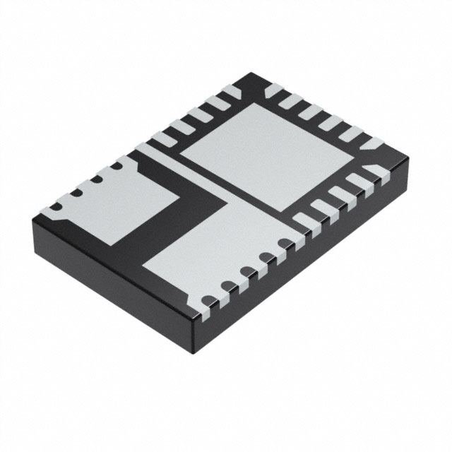

MIC38300 HELDO® 3A High-Efficiency Low Dropout Regulator General Description The MIC38300 is a 3A peak, 2.2A continuous output current step down converter. This is the first device in a ® new generation of HELDO (High-Efficiency Low Dropout) regulators that provide the benefits of an LDO in respect to ease of use, fast transient performance, high PSRR, and low noise while offering the efficiency of a switching regulator. As output voltages move lower, the output noise and transient response of a switching regulator become an increasing challenge for designers. By combining a switcher whose output is slaved to the input of a highperformance LDO, high efficiency is achieved with a clean low noise output. The MIC38300 is designed to provide less than 5mV of peak to peak noise and over 70dB of PSRR at 1kHz. Furthermore, the architecture of the MIC38300 is optimized for fast load transients that allow maintenance of less than 30mV of output voltage deviation even during ultra-fast load steps, making the MIC38300 an ideal choice for low-voltage ASICs and other digital ICs. The MIC38300 features a fully-integrated switching regulator and LDO combo, operates with input voltages from 3.0V to 5.5V input, and offers adjustable output voltages down to 1.0V. The MIC38300 is offered in the small 28-pin 4mm × 6mm ® × 0.9mm MLF package and can operate from –40°C to +125°C. HELDO® Features • • • • • • • • • • 3A peak output current 2.2A continuous operating current Input voltage range: 3.0V to 5.5V Adjustable output voltage down to 1.0V Output noise less than 5mV Ultra-fast transient performance Unique switcher plus LDO architecture Fully-integrated MOSFET switches Micro-power shutdown Easy upgrade from LDO as power dissipation becomes an issue • Thermal shutdown and current-limit protection • 4mm × 6mm × 0.9mm MLF package Applications • • • • Point-of-load applications Networking, server, industrial power Wireless base-stations Sensitive RF applications Datasheets and support documentation are available on Micrel’s web site at: www.micrel.com. Typical Application HELDO is a registered trademark of Micrel, Inc. MLF and MicroLead Frame are registered trademarks of Amkor Technology, Inc. Micrel Inc. • 2180 Fortune Drive • San Jose, CA 95131 • USA • tel +1 (408) 944-0800 • fax + 1 (408) 474-1000 • http://www.micrel.com April 10, 2013 Revision 5.0 Micrel, Inc. MIC38300 Ordering Information Part Number Output Current MIC38300HYHL 3.0A Voltage (1) Junction Temperature Range Package –40°C to +125°C Pb-Free 28-Pin 4mm × 6mm MLF Adjustable Note: 1. Other voltages are available. Contact Micrel for details. Pin Configuration SWO 1 28 SW SWO 2 27 SW SWO 3 26 SW SWO 4 25 SW SWO 5 24 SW SW 6 23 SW ePAD 7 22 ePAD AVIN 8 21 PGND LPF 9 20 PGND AGND 10 18 EN 12 13 14 15 16 17 LDOOUT LDOOUT LDOIN LDOIN PVIN PVIN FB 19 PGND 11 28-Pin 4mm × 6mm MLF (ML) (Top View) Pin Description Pin Number MIC38300HYHL Pin Name 1, 2, 3, 4, 5 SWO 6, 23, 24, 25, 26, 27, 28 SW 7, 22 ePAD Exposed heat-sink pad. Connect externally to PGND. 8 AVIN Analog Supply Voltage: Supply for the analog control circuitry. Requires bypass capacitor to ground. Nominal bypass capacitor is 1µF. 9 LPF Low Pass Filter: Attach external resistor from SW to increase hysteretic frequency. 10 AGND 11 FB April 10, 2013 Pin Name Switch (Output): This is the output of the PFM Switcher. Switch Node: Attach external resistor from LPF to increase hysteretic frequency. Analog Ground. Feedback: Input to the error amplifier. Connect to the external resistor divider network to set the output voltage. 2 Revision 5.0 Micrel, Inc. MIC38300 Pin Description (Continued) Pin Number MIC38300HYHL Pin Name Pin Name 12, 13 LDOOUT LDO Output: Output of voltage regulator. Place capacitor to ground to bypass the output voltage. Nominal bypass capacitor is 10µF. 14, 15 LDOIN 16, 17 PVIN 18 EN 19, 20, 21 PGND April 10, 2013 LDO Input: Connect to SW output. Requires a bypass capacitor to ground. Nominal bypass capacitor is 10µF. Input Supply Voltage (Input): Requires bypass capacitor to GND. Nominal bypass capacitor is 10µF. Enable (Input): Logic low will shut down the device, reducing the quiescent current to less than 50µA. This pin can also be used as an undervoltage lockout function by connecting a resistor divider from EN/UVLO pin to VIN and GND. It should be not left open. Power Ground. 3 Revision 5.0 Micrel, Inc. MIC38300 Absolute Maximum Ratings(1) Operating Ratings(2) Supply Voltage (VIN) ......................................................... 6V Output Switch Voltage (VSW) ............................................ 6V LDO Output Voltage (VOUT) .............................................. 6V Logic Input Voltage (VEN) ................................. –0.3V to VIN (3) Power Dissipation .................................. Internally Limited Storage Temperature (TS) ...................–65°C ≤ TJ ≤ +150°C (4) ESD Rating ............................................................... 1.5kV Supply voltage (VIN) ......................................... 3.0V to 5.5V Junction Temperature Range ........... –40°C ≤ TJ ≤ +125°C Enable Input Voltage (VEN) ..................................... 0V to VIN Package Thermal Resistance 4mm × 6mm MLF-28 (θJA) ................................ 24°C/W Electrical Characteristics(5) TA = 25°C with VIN = VEN = 5V; IOUT = 10mA, VOUT = 1.8V. Bold values indicate –40°C ≤ TJ ≤ +125°C, unless noted. Parameter Conditions Min. 3.0 Supply Voltage Range (AVIN, PVIN) Undervoltage Lockout Threshold Typ. Turn-on UVLO Hysteresis Max. Units 5.5 V 2.85 V 100 mV 1 mA Quiescent Current IOUT = 0A, Not switching, open loop Turn-On Time VOUT to 95% of nominal 200 500 µs Shutdown Current VEN = 0V 30 50 µA Feedback Voltage ±2.5% 1 1.025 V 0.975 Feedback Current 5 0.85 nA Dropout Voltage (VIN – VOUT) ILOAD = 2.2A; VOUT = 3V Current Limit VFB = 0.9 × VNOM Output Voltage Load Regulation VOUT = 1.8V, 10mA to 2.2A 0.3 1 % Output Voltage Line Regulation VOUT = 1.8V, VIN from 3.0V to 5.5V 0.35 0.5 %/V Output Ripple ILOAD = 1.5A, COUTLDO = 20µF, COUTSW = 20µF LPF = 25kΩ 3 1.2 5 V A 2 mV Over-Temperature Shutdown 150 °C Over-Temperature Shutdown Hysteresis 15 °C Enable Input (6) Enable Input Threshold Regulator enable Enable Hysteresis 0.90 1 1.1 V 20 100 200 mV 0.03 1 µA Enable Input Current Notes: 1. Exceeding the absolute maximum rating may damage the device. 2. The device is not guaranteed to function outside its operating rating. 3. The maximum allowable power dissipation of any TA (ambient temperature) is PD(max) = (TJ(max) – TA) / θJA. Exceeding the maximum allowable power dissipation will result in excessive die temperature, and the regulator will go into thermal shutdown. 4. Devices are ESD sensitive. Handling precautions recommended. Human body model, 1.5kΩ in series with 100pF. 5. Specification for packaged product only. 6. Enable pin should not be left open. April 10, 2013 4 Revision 5.0 Micrel, Inc. MIC38300 Typical Characteristics VIN = 3.3V, VOUT = 1.8V, COUT = 10µF, RLPF = 25kΩ, IOUT = 100mA, unless noted. Load Regulation MIC38300 PSRR 90 1.820 2.0 80 1.815 70 1.810 1.8 1.6 60 50 1.800 40 1.795 30 20 1.790 10 1.785 0 10 1.88 100 1k 10k FREQUENCY (Hz) 100k Output Voltage vs. Temperature 1.86 1.84 1.82 1.80 1.78 1.76 1.74 1.72 0.9 VIN = 3.3V COUT = 10µF IOUT = 10mA 20 40 60 80 TEMPERATURE (°C) Dropout Voltage vs. Load Current 0.8 0.5 2.0 1.8 1.6 1.4 1.2 1.0 0.8 0.6 V = 3.3V 0.4 IN VOUT = 1.8V 0.2 COUT = 10µF 0 -40 10 60 110 160 TEMPERATURE (°C) 1.0 MIC38300 Efficiency 90 80 70 60 50 40 30 20 10 210 Dropout Voltage vs. Temperature 2A 1A VIN = 3.3V COUT = 20µF RLPF 0.5 1.0 1.5 2.0 2.5 3.0 LOAD CURRENT (A) 0.5 0.4 VOUT = 4V COUT = 20µF 20 40 60 80 TEMPERATURE (°C) 5 10mA 1.0 2A 0.8 0.6 0.4 VOUT = 1.8V 0.2 COUT = 10µF 0 012345 INPUT VOLTAGE (V) Thermal Shutdown 0.6 0.3 April 10, 2013 3.0 0.7 0.4 0 0 0.5 1.0 1.5 2.0 2.5 LOAD CURRENT (A) 0.8 0.6 0.1 1.780 0 VIN = 3.3V VOUT = 1.8V COUT = 10µF 0.9 0.7 0.2 1.4 1.2 1.805 Output Voltage vs. Input Voltage 0 0 VIN = 5V VOUT = 3.3V COUT = 10µF 0.5 1.0 1.5 2.0 2.5 LOAD CURRENT (A) 3.0 Current Limit vs. Input Voltage 5.5 5.3 5.1 4.9 4.7 4.5 4.3 4.1 VOUT = 1V 3.9 COUT = 20µF 3.7 RLPF 3.5 2.7 3.1 3.5 3.9 4.3 4.7 5.1 5.5 INPUT VOLTAGE (V) Revision 5.0 Micrel, Inc. MIC38300 Typical Characteristics (Continued) VIN = 3.3V, VOUT = 1.8V, COUT = 10µF, RLPF = 25kΩ, IOUT = 100mA, unless noted. 1.00 0.95 0.90 VOUT = 1.8V COUT = 10µF 0.85 0.80 3.0 3.5 4.0 4.5 5.0 INPUT VOLTAGE (V) Switch Frequency vs. RLPF Resistance (3.3V-1.8V) 2A 2 1.5 1 10mA 1A 1.5A 0.5 0 10 Switch Frequency vs. RLPF Resistance (5.0V-2.5V) 500mA 2 1.5 10mA 1 1A 0.5 0 10 100 1000 RLPF RESISTANCE (kohms) April 10, 2013 VOUT = 1.8V COUT = 10µF 3.5 4 4.5 5 INPUT VOLTAGE (V) 1.5A 2.5 2A 1A 2 1.5 500mA 1 10mA 0.5 3 2.5 5.0V 2 5.5V 1.5 1 0.5 0 -40 -20 0 20 40 60 80 AMBIENT TEMPERATURE (°C) 6 2A 2 1.5 10mA 500mA 1 1.5A 0.5 100 1000 RLPF RESISTANCE (kohms) Switch Frequency vs. RLPF Resistance (5.0V-1.8V) 3 1.5A 2.5 2A 1A 2 1.5 1 10mA 500mA 0.5 0 10 100 1000 RLPF RESISTANCE (kohms) 3.3V 1A 2.5 0 10 5.5 100 1000 RLPF RESISTANCE (kohms) Max Output Current @ 110°C Case Temp (1.2V VOUT) 3.5 MAX OUTPUT CURRENT (A) SWITCH FREQUENCY (MHz) 2.5 10 Max Output Current @ 110°C Case Temp (1.0V VOUT) 3 2A 20 0 10 100 1000 RLPF RESISTANCE (kohms) 1.5A 30 3 SWITCH FREQUENCY (MHz) SWITCH FREQUENCY (MHz) 500mA 40 Switch Frequency vs. RLPF Resistance (5.0V-1.0V) 3 2.5 50 0 3 5.5 3 SWITCH FREQUENCY (MHz) 1.05 60 Switch Frequency vs. RLPF Resistance (3.3V-1.0V) SWITCH FREQUENCY (MHz) 1.10 Operating Current vs. Input Voltage 3.5 MAX OUTPUT CURRENT (A) 1.20 1.15 OPERATING CURRENT (mA) Enable Threshold 3.3V 3 2.5 5.0V 2 5.5V 1.5 1 0.5 0 -40 -20 0 20 40 60 80 AMBIENT TEMPERATURE (°C) Revision 5.0 Micrel, Inc. MIC38300 Typical Characteristics (Continued) VIN = 3.3V, VOUT = 1.8V, COUT = 10µF, RLPF = 25kΩ, IOUT = 100mA, unless noted. Max Output Current @ 110°C Case Temp (1.8V VOUT) Max Output Current @ 110°C Case Temp (2.5V VOUT) 5.0V 3 2.5 2 5.5V 1.5 1 0.5 0 -40 -20 0 20 40 60 80 AMBIENT TEMPERATURE (°C) April 10, 2013 3.5 MAX OUTPUT CURRENT (A) MAX OUTPUT CURRENT (A) 3.5 3 5.0V 2.5 2 5.5V 1.5 1 0.5 0 -40 -20 0 20 40 60 80 AMBIENT TEMPERATURE (°C) 7 Revision 5.0 Micrel, Inc. MIC38300 Functional Characteristics VIN = 3.3V, VOUT = 1.8V, COUT = 10µF, Inductor = 470nH; RLPF = 25kΩ, IOUT = 100mA, unless noted. April 10, 2013 8 Revision 5.0 Micrel, Inc. MIC38300 Functional Diagram April 10, 2013 9 Revision 5.0 Micrel, Inc. MIC38300 EMI Performance VOUT =1.8V, IOUT = 1.2A. EMI Test − Horizontal Front EMI Test − Vertical Front Additional components to MIC38150 Evaluation Board (Performance similar to MIC38300): 1. Input Ferrite Bead Inductor. Part number: BLM21AG102SN1D. 2. 0.1µF and 0.01µF ceramic bypass capacitors on PVIN, SW, SWO, and LDOOUT pins. April 10, 2013 10 Revision 5.0 Micrel, Inc. MIC38300 Application Information Enable Input The MIC38300 features a TTL/CMOS compatible positive logic enable input for on/off control of the device. High enables the regulator while low disables the regulator. In shutdown the regulator consumes very little current (only a few microamperes of leakage). For simple applications the enable (EN) can be connected to VIN (IN). Adjustable Regulator Design The adjustable MIC38300 output voltage can be programmed from 1V to 5.0V using a resistor divider from output to the FB pin. Resistors can be quite large, up to 100kΩ because of the very high input impedance and low bias current of the sense amplifier. For large value resistors (>50kΩ) R1 should be bypassed by a small capacitor (CFF = 0.1µF bypass capacitor) to avoid instability due to phase lag at the ADJ/SNS input. Input Capacitor PVIN provides power to the MOSFETs for the switch mode regulator section and the gate drivers. Due to the high switching speeds, a 10µF capacitor is recommended close to PVIN and the power ground (PGND) pin for bypassing. Analog VIN (AVIN) provides power to the analog supply circuitry. Careful layout should be considered to ensure high-frequency switching noise caused by PVIN is reduced before reaching AVIN. A 1µF capacitor as close to AVIN as possible is recommended. Output Capacitor The MIC38300 requires an output capacitor for stable operation. As a µCap LDO, the MIC38300 can operate with ceramic output capacitors of 10µF or greater. Values of greater than 10µF improve transient response and noise reduction at high frequency. X7R/X5R dielectrictype ceramic capacitors are recommended because of their superior temperature performance. X7R-type capacitors change capacitance by 15% over their operating temperature range and are the most stable type of ceramic capacitors. Larger output capacitances can be achieved by placing tantalum or aluminum electrolytics in parallel with the ceramic capacitor. For example, a 100µF electrolytic in parallel with a 10µF ceramic can provide the transient and high frequency noise performance of a 100µF ceramic at a significantly lower cost. Specific undershoot/overshoot performance will depend on both the values and ESR/ESL of the capacitors. Figure 1. Adjustable Regulator with Resistors The output resistor divider values are calculated by Equation 1:  R1  VOUT = 1V  + 1  R2  Efficiency Considerations Efficiency is defined as the amount of useful output power, divided by the amount of power supplied. V ×I Efficiency _ % =  OUT OUT V × IN IIN  For less than 5mV noise performance at higher current loads, 20µF capacitors are recommended at LDOIN and LDOOUT. Low Pass Filter Pin The MIC38300 features a Low Pass Filter (LPF) pin for adjusting the switcher frequency. By tuning the frequency, the user can further improve output ripple without losing efficiency. Adjusting the frequency is accomplished by connecting a resistor between the LPF and SW pins. A small value resistor would increase the frequency while a larger value resistor decreases the frequency. Recommended RLPF value is 25kΩ. Please see Typical Characteristics section for more details. April 10, 2013 Eq. 1   × 100  Eq. 2 Maintaining high efficiency serves two purposes. It reduces power dissipation in the power supply, reducing the need for heat sinks and thermal design considerations and it reduces consumption of current for battery-powered applications. Reduced current draw from a battery increases the devices operating time and is critical in handheld devices. 11 Revision 5.0 Micrel, Inc. MIC38300 There are two types of losses in switching converters; DC losses and switching losses. DC losses are simply the 2 power dissipation of I R. Power is dissipated in the high side switch during the on cycle. Power loss is equal to the high-side MOSFET RDSON multiplied by the switch current. During the off cycle, the low side N-channel MOSFET conducts, also dissipating power. Device operating current also reduces efficiency. The product of the quiescent (operating) current and the supply voltage is another DC loss. If the current through the current sense of HELDO2 is less than the current through the current sense of HELDO1, the inverting pin will be at a higher voltage than the non-inverting pin and the op-amp will drive the FB of HELDO2 low. The low voltage sensed on HELDO2 FB pin will drive the output up until the output voltage of HELDO2 matches the output voltage of HELDO1. Since VOUT will remain constant and both HELDO VOUT terminals and sense resistances are matched, the output currents will be shared equally. Over 100mA, efficiency loss is dominated by MOSFET RDSON and inductor losses. Higher input supply voltages will increase the gate-to-source threshold on the internal MOSFETs, reducing the internal RDDSON. This improves efficiency by reducing DC losses in the device. All but the inductor losses are inherent to the device. In which case, inductor selection becomes increasingly critical in efficiency calculations. As the inductors are reduced in size, the DC resistance (DCR) can become quite significant. The DCR losses can be calculated as in Equation 3: 2 L_PD = IOUT × DCR Eq. 3 From that, the loss in efficiency due to inductor resistance can be calculated as in Equation 4:    VOUT × IOUT  × 100 Efficiency _ Loss = 1 −    VOUT × IOUT + L _ PD     Eq. 4 Efficiency loss due to DCR is minimal at light loads and gains significance as the load is increased. Inductor selection becomes a trade-off between efficiency and size in this case. Current-Sharing Circuit Figure 2 allows two MIC38300 HELDO regulators to share the load current equally. HELDO1 senses the output voltage at the load, on the other side of a current sense resistor. As the load changes, a voltage equal to the output voltage, plus the load current times the sense resistor, is developed at the VOUT terminal of HELDO1. The op-amp (MIC7300) inverting pin senses this voltage and compares it to the voltage on the VOUT terminal of HELDO2. April 10, 2013 12 Revision 5.0 Micrel, Inc. MIC38300 Figure 2. Current-Sharing Circuit for 6A Output April 10, 2013 13 Revision 5.0 Micrel, Inc. MIC38300 Package Information(1) 28-Pin 4mm × 4mm MLF (ML) Note: 1. Package information is correct as of the publication date. For updates and most current information, go to www.micrel.com. April 10, 2013 14 Revision 5.0 Micrel, Inc. MIC38300 Recommended Landing Pattern LP # HMLF46T-28LD-LP-1 All units are in mm Tolerance ±0.05, if not noted Red circles indicate Thermal Vias. Size should be .300mm − .350mm in diameter and it should be connected to GND plane for maximum thermal performance. MICREL, INC. 2180 FORTUNE DRIVE SAN JOSE, CA 95131 USA TEL +1 (408) 944-0800 FAX +1 (408) 474-1000 WEB http://www.micrel.com Micrel makes no representations or warranties with respect to the accuracy or completeness of the information furnished in this data sheet. This information is not intended as a warranty and Micrel does not assume responsibility for its use. Micrel reserves the right to change circuitry, specifications and descriptions at any time without notice. No license, whether express, implied, arising by estoppel or otherwise, to any intellectual property rights is granted by this document. Except as provided in Micrel’s terms and conditions of sale for such products, Micrel assumes no liability whatsoever, and Micrel disclaims any express or implied warranty relating to the sale and/or use of Micrel products including liability or warranties relating to fitness for a particular purpose, merchantability, or infringement of any patent, copyright or other intellectual property right. Micrel Products are not designed or authorized for use as components in life support appliances, devices or systems where malfunction of a product can reasonably be expected to result in personal injury. Life support devices or systems are devices or systems that (a) are intended for surgical implant into the body or (b) support or sustain life, and whose failure to perform can be reasonably expected to result in a significant injury to the user. A Purchaser’s use or sale of Micrel Products for use in life support appliances, devices or systems is a Purchaser’s own risk and Purchaser agrees to fully indemnify Micrel for any damages resulting from such use or sale. © 2007 Micrel, Incorporated. April 10, 2013 15 Revision 5.0
