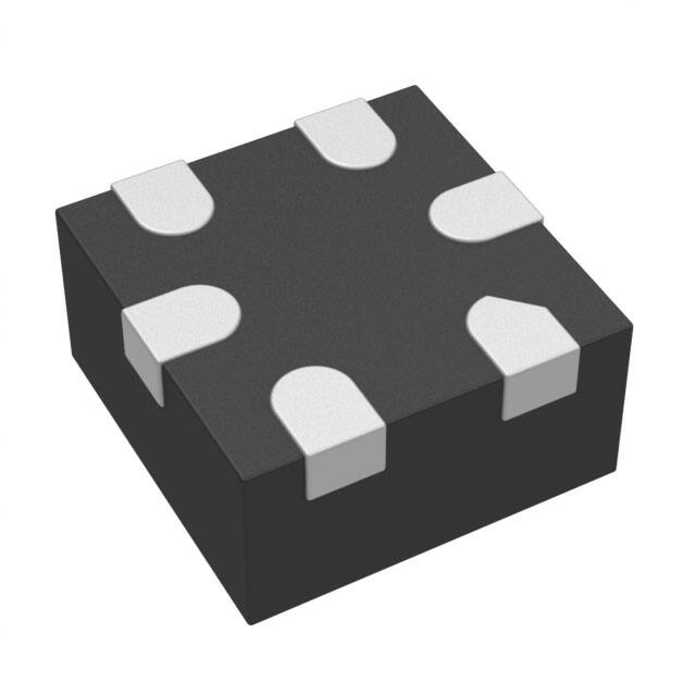

MIC5380/1 High Performance Dual 150 mA LDOs Features General Description • • • • • • • • • • • The MIC5380 and MIC5381 are advanced dual LDOs that are ideal for powering space-constrained portable devices. The MIC5380/1 provide two independently controlled, high performance 150 mA LDOs in an ultra-small 1 mm x 1 mm FTQFN package. 6-Lead 1 mm x 1 mm FTQFN Package 2.5V to 5.5V Input Voltage Range 150 mA Output Current per LDO High Output Accuracy ±1% Typical Low Quiescent Current of 32 µA per LDO Stable with 0402 1 µF Ceramic Output Capacitors Low Dropout Voltage 155 mV at 150 mA Output Discharge Circuit on MIC5381 Independent Enable Pins Thermal Shutdown Protection Current Limit Protection Applications • • • • • • Bluetooth Headsets Mobile Phones GPS, PMP, PDAs, DSCs USB Thumb Drive Medical Handheld Portable Handheld Electronics Ideal for battery powered applications, the MIC5380/1 offer ±1% typical accuracy, low dropout voltage (155 mV at 150 mA), and low ground current. The MIC5380/1 can also be put into a zero-off-mode current state, drawing virtually no current when disabled. The MIC5380/1 offer fast transient response and high PSRR while consuming minimal operating current. When the MIC5381 is disabled, an internal resistive load is automatically applied to the output to discharge the output capacitor. The MIC5380/1 are available with fixed output voltages in a lead-free (RoHS compliant) 6-lead 1 mm x 1 mm FTQFN package. Package Type MIC5380/MIC5381 6-Lead FTQFN (MT) (Top View) VIN 6 VOUT1 1 VOUT2 2 5 GND 4 EN1 3 EN2  2021 Microchip Technology Inc. DS20006525A-page 1 MIC5380/1 Typical Application Circuit Camera DSP Power Supply Circuit MIC5380/1-xxYFT VIN VOUT1 I/O EN1 VOUT2 VCORE 1μF VBAT 1μF EN2 1μF GND Functional Block Diagrams MIC5380 Block Diagram VIN VOUT1 LDO1 LDO2 EN1 EN2 VOUT2 ENABLE REFERENCE GND MIC5381 Block Diagram VIN VOUT1 LDO1 LDO2 EN1 EN2 VOUT2 ENABLE AUTO DISCHARGE REFERENCE GND DS20006525A-page 2  2021 Microchip Technology Inc. MIC5380/1 1.0 ELECTRICAL CHARACTERISTICS Absolute Maximum Ratings † Supply Voltage (VIN) .................................................................................................................................... –0.3V to +6V Enable Voltage (VEN1, VEN2) .........................................................................................................................–0.3V to VIN Power Dissipation (PD) (Note 1) ............................................................................................................ Internally Limited ESD Rating (Note 2) .................................................................................................................................................. 2 kV Operating Ratings †† Supply Voltage (VIN) ................................................................................................................................. +2.5V to +5.5V Enable Voltage (VEN1, VEN2) .........................................................................................................................–0.3V to VIN † Notice: Stresses above those listed under “Absolute Maximum Ratings” may cause permanent damage to the device. This is a stress rating only and functional operation of the device at those or any other conditions above those indicated in the operational sections of this specification is not intended. Exposure to maximum rating conditions for extended periods may affect device reliability. †† Notice: The device is not guaranteed to function outside its operating ratings. Note 1: The maximum allowable power dissipation of any TA (ambient temperature) is PD(MAX) = (TJ(MAX) – TA)/θJA. Exceeding the maximum allowable power dissipation will result in excessive die temperature, and the regulator will go into thermal shutdown. 2: Devices are ESD sensitive. Handling precautions recommended. Human body model, 1.5 kΩ in series with 100 pF. ELECTRICAL CHARACTERISTICS Electrical Characteristics: VIN = VEN1 = VEN2 = VOUT + 1V; higher of the two regulator outputs; IOUTLDO1 = IOUTLDO2 = 100 µA; COUT1 = COUT2 = 1 µF; TJ = +25°C, bold values valid for –40°C to +125°C, unless noted. Note 1 Parameter Output Voltage Accuracy Symbol — Min. Typ. Max. Units Conditions — ±1 — % Variation from nominal VOUT –3.0 — 3.0 % Variation from nominal VOUT; –40°C to +85°C Line Regulation ΔVOUT/ (VOUT x ΔVIN) — 0.02 0.3 %/V VIN = VOUT + 1V to 5.5V, IOUT = 100 µA Load Regulation ΔVOUT/ VOUT — 0.3 1 % IOUT = 100 µA to 150 mA Dropout Voltage VDROP — 55 110 mV IOUT = 50 mA — 155 310 mV IOUT = 150 mA — 32 45 µA VEN1 = High; VEN2 = Low; IOUT = 0 mA — 32 45 µA VEN1 = Low; VEN2 = High; IOUT = 0 mA — 59 85 µA VEN1 = VEN2 = High; IOUT1 = IOUT2 = 0 mA Ground Pin Current IGND Ground Pin Current in Shutdown ISHDN — 0.05 1 µA VEN1 = VEN2 = 0V Ripple Rejection PSRR — 60 — dB f = 1 kHz; COUT = 1 µF Current Limit ILIMIT 200 325 550 mA VOUT = 0V eN — 200 — Output Voltage Noise Note 1: µVRMS COUT = 1 µF, 10 Hz to 100 kHz Specification for packaged product only.  2021 Microchip Technology Inc. DS20006525A-page 3 MIC5380/1 ELECTRICAL CHARACTERISTICS (CONTINUED) Electrical Characteristics: VIN = VEN1 = VEN2 = VOUT + 1V; higher of the two regulator outputs; IOUTLDO1 = IOUTLDO2 = 100 µA; COUT1 = COUT2 = 1 µF; TJ = +25°C, bold values valid for –40°C to +125°C, unless noted. Note 1 Parameter Auto-Discharge NFET Resistance Symbol Min. Typ. Max. Units Conditions RDS — 30 — Ω MIC5381 Only; VEN1 = VEN2 = 0V; VIN = 3.6V — — 0.2 V Logic Low 1.2 — — V Logic High — 0.01 1 µA VIL ≤ 0.2V — 0.01 1 µA VIH ≥ 1.2V — 50 125 µs COUT = 1 µF Enable Inputs (EN1/EN2) Enable Input Voltage VEN Enable Input Current IEN Turn-On Time tON Note 1: Specification for packaged product only. TEMPERATURE SPECIFICATIONS Parameters Sym. Min. Typ. Max. Units Conditions Temperature Ranges Junction Temperature Range TJ –40 — +125 °C — Storage Temperature Range TS –65 — +150 °C — Lead Temperature — — — +260 °C Soldering, 10 sec. JA — 150 — °C/W Package Thermal Resistances Thermal Resistance, FTQFN 6-Ld Note 1: — The maximum allowable power dissipation is a function of ambient temperature, the maximum allowable junction temperature and the thermal resistance from junction to air (i.e., TA, TJ, JA). Exceeding the maximum allowable power dissipation will cause the device operating junction temperature to exceed the maximum +125°C rating. Sustained junction temperatures above +125°C can impact the device reliability. DS20006525A-page 4  2021 Microchip Technology Inc. MIC5380/1 2.0 Note: TYPICAL PERFORMANCE CURVES The graphs and tables provided following this note are a statistical summary based on a limited number of samples and are provided for informational purposes only. The performance characteristics listed herein are not tested or guaranteed. In some graphs or tables, the data presented may be outside the specified operating range (e.g., outside specified power supply range) and therefore outside the warranted range. 40 50mA 38 36 34 150mA 100μA 32 30 28 26 24 22 VIN = VEN = 3.8V VOUT = 2.8V COUT = 1μF 0 10 FIGURE 2-1: Ratio. 100 1k 10k 100k FREQUENCY (Hz) 1M Power Supply Rejection LDO1-150mA 40 VOUT1 = 2.8V VOUT2 = 1.8V CIN = COUT =1μF 3.0 3.5 4.0 4.5 5.0 5.5 INPUT VOLTAGE (V) Output Voltage vs. Input 20 10 0 0 FIGURE 2-5: Current. 2.90 65 60 2.86 2.84 55 VIN=4.8V VIN=3.8V 2.72 2.70 0 FIGURE 2-3: Current. Single Output VEN = VIN = VOUT + 1V VOUT1 = 2.8V VOUT2 = 1.2V CIN = COUT = 1μF 25 50 75 100 125 150 OUTPUT CURRENT (mA) Ground Current vs. Output Dual Output(100μA) V IN = V EN = 3.8V 50 VOUT1 = 2.8V 45 VOUT2 = 1.8V CIN = C OUT = 1μF 2.80 2.74 Dual Output 30 2.88 2.78 2.76 Ground Current vs. Input LDO2-150mA 1.0 2.82 5.5 50 1.5 LDO2-100μA FIGURE 2-2: Voltage. 3.0 3.5 4.0 4.5 5.0 INPUT VOLTAGE (V) 60 2.0 0 2.5 FIGURE 2-4: Voltage. 70 LDO1-100μA 0.5 20 2.5 VIN = VEN VOUT2 = 1.8V CIN = COUT = 1μF 80 3.0 2.5 100μA 40 VIN=5.5V 35 VIN = VEN VOUT = 2.8V CIN = COUT = 1μF 30 25 50 75 100 125 150 OUTPUT CURRENT (mA) Output Voltage vs. Output  2021 Microchip Technology Inc. Single Output(50mA) Single Outputs(100μA) 25 20 -40 -20 0 20 40 60 80 100 120 TEMPERATURE (°C) FIGURE 2-6: Temperature. Ground Current vs. DS20006525A-page 5 MIC5380/1 1.0 180 160 EN1 ON 0.8 140 120 0.6 100 80 EN1 OFF 0.4 60 40 VOUT = 2.8V CIN = COUT = 1μF 20 0 0 25 50 75 100 125 150 OUTPUT CURRENT (mA) FIGURE 2-7: Current. 250 Dropout Voltage vs. Output 0 3.0 3.5 4.0 4.5 5.0 INPUT VOLTAGE (V) FIGURE 2-10: Voltage. 5.5 Enable Voltage vs. Input 10 CIN = COUT = 1μF 200 VOUT1 = 2.8V CIN = COUT = 1μF Load = 150mA 0.2 150mA 1 150 100mA 0.1 100 50mA 0.01 50 V IN = 4.5V V OUT = 1.2V COUT = 1μF 10mA 0 -40 -20 0 20 40 60 80 100 120 TEMPERATURE (°C) FIGURE 2-8: Temperature. Dropout Voltage vs. 0.001 10 100 1k 10k 100k 1M 10M FREQUENCY (Hz) FIGURE 2-11: Density. Output Noise Spectral FIGURE 2-12: Turn-On Time. 500 400 LDO1 300 LDO2 200 VOUT1 = 2.8V VOUT2 = 1.8V CIN = COUT = 1μF 100 0 2.5 3.0 3.5 4.0 4.5 5.0 INPUT VOLTAGE (V) FIGURE 2-9: Voltage. DS20006525A-page 6 5.5 Current Limit vs. Input  2021 Microchip Technology Inc. MIC5380/1 FIGURE 2-13: Line Transient. FIGURE 2-15: Load Transient. FIGURE 2-14: Load Transient. FIGURE 2-16: (Auto-Discharge). Turn-Off Time MIC5381  2021 Microchip Technology Inc. DS20006525A-page 7 MIC5380/1 3.0 PIN DESCRIPTIONS The descriptions of the pins are listed in Table 3-1. TABLE 3-1: PIN FUNCTION TABLE Pin Number Pin Name 1 VOUT1 Regulator Output – LDO1. 2 VOUT2 Regulator Output – LDO2. 3 EN2 Enable Input (regulator 2). Active-High Input. Logic High = On; Logic Low = Off; Do not leave floating. 4 EN1 Enable Input (regulator 1). Active-High Input. Logic High = On; Logic Low = Off; Do not leave floating. 5 GND Ground. 6 VIN Supply Input. DS20006525A-page 8 Description  2021 Microchip Technology Inc. MIC5380/1 4.0 APPLICATION INFORMATION MIC5380/1 is a dual 150 mA LDO in a small 1 mm x 1 mm FTQFN package. The MIC5381 includes an auto-discharge circuit for each of the LDO outputs that is activated when the output is disabled. The MIC5380/1 regulator is fully protected from damage due to fault conditions through linear current limiting and thermal shutdown. 4.1 Input Capacitor The MIC5380/1 is a high-performance, high bandwidth device. An input capacitor of 1 µF capacitor is required from the input-to-ground to provide stability. Low-ESR ceramic capacitors provide optimal performance at a minimum of space. Additional high-frequency capacitors, such as small-valued NPO dielectric-type capacitors, help filter out high-frequency noise and are good practice in any RF-based circuit. X5R or X7R dielectrics are recommended for the input capacitor. Y5V dielectrics lose most of their capacitance over temperature and are therefore, not recommended. 4.2 Output Capacitor The MIC5380/1 requires an output capacitor of 1 µF or greater to maintain stability. The design is optimized for use with low-ESR ceramic chip capacitors. High ESR capacitors may cause high frequency oscillation. The output capacitor can be increased, but performance has been optimized for a 1 µF ceramic output capacitor and does not improve significantly with larger capacitance. X7R/X5R dielectric-type ceramic capacitors are recommended because of their temperature performance. X7R-type capacitors change capacitance by 15% over their operating temperature range and are the most stable type of ceramic capacitors. Z5U and Y5V dielectric capacitors change value by as much as 50% and 60%, respectively, over their operating temperature ranges. To use a ceramic chip capacitor with Y5V dielectric, the value must be much higher than an X7R ceramic capacitor to ensure the same minimum capacitance over the equivalent operating temperature range. 4.3 4.4 Enable/Shutdown The MIC5380/1 comes with two active-high enable pins that allow each regulator to be disabled independently. Forcing the enable pin low disables the regulator and sends it into a “zero” off-mode-current state. In this state, current consumed by the regulator goes nearly to zero. When disabled the MIC5381 switches a 30Ω (typical) load on the regulator output to discharge the external capacitor. Forcing the enable pin high enables the output voltage. The active-high enable pin uses CMOS technology and the enable pin cannot be left floating; a floating enable pin may cause an indeterminate state on the output. 4.5 Thermal Considerations The MIC5380/1 is designed to provide 150 mA of continuous current for both outputs in a very small package. Maximum ambient operating temperature can be calculated based upon the output current and the voltage drop across the part. For example, if the input voltage is 3.6V, and the output voltage 3.0V for VOUT1, 3.0V for VOUT2 and output current equals 150 mA, then the actual power dissipation of the regulator circuit can be calculated using the equation: EQUATION 4-1: P D =  V IN – V OUT1 I OUT1 +  V IN – V OUT2 I OUT2 + V IN I GND Because this device is CMOS and the ground current is typically
MIC5380-LLYFT-TR
物料型号: - MIC5380/1系列是高性能双150mA LDO(低压差线性稳压器)。
器件简介: - MIC5380和MIC5381是为空间受限的便携式设备设计的先进双LDO。 - 提供两个独立控制的、高性能的150mA LDO,封装在超小型1mm x 1mm FTQFN封装中。 - MIC5380/1适用于电池供电应用,具有±1%的典型精度、低降压电压(150mA时为155mV)和低地电流。 - MIC5380/1可以进入零关断模式电流状态,在禁用时几乎不消耗电流。
引脚分配: - MIC5380/MIC5381有6个引脚,其中: - VOUT1和VOUT2是LDO1和LDO2的稳压输出。 - EN1和EN2是使能输入引脚,高电平有效。 - GND是地引脚。 - VIN是供电输入引脚。
参数特性: - 供电电压范围:2.5V至5.5V。 - 输出电流:每个LDO 150mA。 - 输出精度:典型值为±1%。 - 静态电流:每个LDO 32µA。 - 降压电压:150mA时为155mV。 - MIC5381具有输出放电电路。 - MIC5380/1具有独立的使能引脚和热关断保护。
功能详解: - MIC5380/1提供快速瞬态响应和高电源抑制比(PSRR),同时消耗最小的工作电流。 - MIC5381在禁用时会自动将内部电阻负载应用于输出,以放电输出电容。
应用信息: - 适用于蓝牙耳机、移动电话、GPS、PMP、PDAs、DSCs、USB闪存驱动器、医疗手持设备和便携式手持电子设备。
封装信息: - MIC5380/1提供固定输出电压,符合RoHS标准的无铅6引脚1mm x 1mm FTQFN封装。
