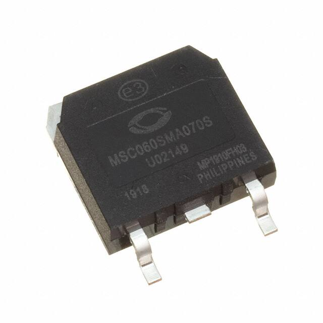

MSC060SMA070S Silicon Carbide N-Channel Power MOSFET 1 Product Overview The silicon carbide (SiC) power MOSFET product line from Microsemi increases the performance over silicon MOSFET and silicon IGBT solutions while lowering the total cost of ownership for high-voltage applications. The MSC060SMA070S device is a 700 V, 60 mΩ SiC MOSFET in a TO-268 (D3PAK) package. 1.1 Features The following are key features of the MSC060SMA070S device: Low capacitances and low gate charge Fast switching speed due to low internal gate resistance (ESR) Stable operation at high junction temperature, TJ(max) = 175 °C Fast and reliable body diode Superior avalanche ruggedness RoHS compliant 1.2 Benefits The following are benefits of the MSC060SMA070S device: High efficiency to enable lighter, more compact system Simple to drive and easy to parallel Improved thermal capabilities and lower switching losses Eliminates the need for external freewheeling diode Lower system cost of ownership 1.3 Applications The MSC060SMA070S device is designed for the following applications: PV inverter, converter, and industrial motor drives Smart grid transmission and distribution Induction heating and welding H/EV powertrain and EV charger Power supply and distribution 050-7748 MSC060SMA070S Datasheet Revision B 1 2 Device Specifications This section shows the specifications for the MSC060SMA070S device. 2.1 Absolute Maximum Ratings The following table shows the absolute maximum ratings for the MSC060SMA070S device. Table 1 • Absolute Maximum Ratings Symbol Characteristic Ratings Unit VDSS Drain source voltage 700 V ID Continuous drain current at TC = 25 °C 37 A Continuous drain current at T C = 100 °C 26 Pulsed drain current 93 IDM 1 VGS Gate-source voltage 23 to –10 V PD Total power dissipation at TC = 25 °C 130 W Linear derating factor 0.86 W/°C Note: 1. Repetitive rating: pulse width and case temperature limited by maximum junction temperature. The following table shows the thermal and mechanical characteristics for the MSC060SMA070S device. Table 2 • Thermal and Mechanical Characteristics Symbol Characteristic Min RθJC Junction-to-case thermal resistance TJ Operating junction temperature TSTG Storage temperature TL Soldering temperature for 10 seconds (1.6 mm from case) Wt Package weight Typ Max Unit 0.77 1.16 °C/W –55 175 °C –55 150 050-7748 MSC060SMA070S Datasheet Revision B 260 0.14 oz 4.0 g 2 2.2 Electrical Performance The following table shows the static characteristics for the MSC060SMA070S device. T J = 25 °C unless otherwise specified. Table 3 • Static Characteristics Symbol Characteristic Test Conditions Min V(BR)DSS Drain-source breakdown voltage VGS = 0 V, ID = 100 µA 700 RDS(on) Drain-source on resistance VGS = 20 V, ID = 20 A VGS(th) Gate-source threshold voltage VGS = VDS, ID = 1 mA ΔVGS(th)/ΔTJ Threshold voltage coefficient VGS = VDS, ID = 1 mA IDSS Zero gate voltage drain current VDS, = 700 V, VGS = 0 V 100 VDS = 700 V, VGS = 0 V TJ = 125 °C 500 VGS = 20 V/–10 V ±100 IGSS 1 Gate-source leakage current Typ Unit V 60 1.9 Max 75 mΩ 2.4 V –3.4 mV/° C µA nA Notes: 1. Pulse test: pulse width < 380 µs, duty cycle < 2%. The following table shows the dynamic characteristics for the MSC060SMA070S device. T J = 25 °C unless otherwise specified. Table 4 • Dynamic Characteristics Symbol Characteristic Test Conditions Ciss Input capacitance Crss Reverse transfer capacitance VGS = 0 V, VDD = 700 V, VAC = 25 mV, ƒ = 1 MHz Min Typ Coss Output capacitance Qg Total gate charge Qgs Gate-source charge Qgd Gate-drain charge td(on) Turn-on delay time tr Current rise time td(off) Turn-off delay time tf Current fall time Eon Turn-on switching energy Eoff Turn-off switching energy td(on) Turn-on delay time tr Current rise time td(off) Turn-off delay time tf Current fall time Eon Turn-on switching energy 2 130 Eoff Turn-off switching energy 25 ESR Equivalent series resistance f = 1 MHz, 25 mV, drain short 2.6 Ω SCWT Short circuit withstand time VDS = 560 V, VGS = 20 V 3 µs 1175 Max Unit pF 8 130 VGS = –5 V/20 V, VDD = 470 V ID = 20 A 56 nC 15 9 VDD = 470 V, VGS = –5 V/20 V, ID = 20 A RG(ext) = 4 Ω1, Freewheeling diode = MSC060SMA070S (V GS = -5 V) 18 7 26 7 140 2 ns µJ 25 VDD = 470 V, VGS = –5 V/20 V, ID = 20 A RG(ext) = 4 Ω1 Freewheeling diode = MSC010SDA070B 050-7748 MSC060SMA070S Datasheet Revision B 20 ns 9 25 10 µJ 3 Symbol Characteristic Test Conditions Min EAS Avalanche energy, single pulse VDS = 150 V, VGS = 20 V, ID = 20 A Typ 1150 Max Unit mJ Notes: 1. RG is total gate resistance excluding internal gate driver impedance. 2. Eon includes energy of freewheeling diode. The following table shows the body diode characteristics for the MSC060SMA070S device. T J = 25 °C unless otherwise specified. Table 5 • Body Diode Characteristics 2.3 Symbol Characteristic Test Conditions VSD Diode forward voltage ISD = 20 A, VGS = 0 V 4.0 V ISD = 20 A, VGS = –5 V 4.2 V ISD = 20 A, VGS = –5 V VDD = 470 V dl/dt = –1500 A/µs 25 ns 170 nC 10 A trr Reverse recovery time Qrr Reverse recovery charge IRRM Reverse recovery current Min Typ Max Unit Typical Performance Curves This section shows the typical performance curves for the MSC060SMA070S device. Figure 1 • Drain Current vs. Drain-to-Source Voltage Figure 2 • Drain Current vs. Drain-to-Source Voltage Figure 3 • Drain Current vs. Drain-to-Source Voltage Figure 4 • Drain Current vs. Drain-to-Source Voltage 050-7748 MSC060SMA070S Datasheet Revision B 4 Figure 3 • Drain Current vs. Drain-to-Source Voltage Figure 4 • Drain Current vs. Drain-to-Source Voltage Figure 5 • RDS(on) vs. Junction Temperature Figure 6 • Gate Charge Characteristics Figure 7 • Capacitance vs. Drain-to-Source Voltage Figure 8 • IDM vs. Gate-to-Source Voltage Figure 9 • IDM vs. VDS Third Quadrant Conduction Figure 10 • IDM vs. VDS Third Quadrant Conduction 050-7748 MSC060SMA070S Datasheet Revision B 5 Figure 9 • IDM vs. VDS Third Quadrant Conduction Figure 10 • IDM vs. VDS Third Quadrant Conduction Figure 11 • VGS(th) vs. Junction Temp. Figure 12 • Forward Safe Operating Area Figure 13 • Maximum Transient Thermal Impedance 050-7748 MSC060SMA070S Datasheet Revision B 6 3 Package Specification This section shows the package specification for the MSC060SMA070S device. 3.1 Package Outline Drawing The following figure illustrates the TO-268 package outline of the MSC060SMA070S device. Figure 14 • Package Outline Drawing The following table shows the TO-268 dimensions and should be used in conjunction with the package 050-7748 MSC060SMA070S Datasheet Revision B 7 The following table shows the TO-268 dimensions and should be used in conjunction with the package outline drawing. Table 6 • TO-268 Dimensions Symbol Min (mm) Max (mm) Min (in.) Max (in.) A 4.90 5.10 0.193 0.201 B 15.85 16.20 0.624 0.638 C 18.70 19.10 0.736 0.752 D 1.00 1.25 0.039 0.049 E 13.80 14.00 0.543 0.551 F 13.30 13.60 0.524 0.535 G 2.70 2.90 0.106 0.114 H 1.15 1.45 0.045 0.057 I 1.95 2.21 0.077 0.087 J 0.94 1.40 0.037 0.055 K 2.40 2.70 0.094 0.106 L 0.40 0.60 0.016 0.024 M 1.45 1.60 0.057 0.063 N 0.00 0.18 0.000 0.007 O 12.40 12.70 0.488 0.500 P 5.45 BSC (nom.) Terminal 1 Gate Terminal 2 Drain Terminal 3 Source Terminal 4 Drain 0.215 BSC (nom.) 050-7748 MSC060SMA070S Datasheet Revision B 8 Microsemi Headquarters One Enterprise, Aliso Viejo, CA 92656 USA Within the USA: +1 (800) 713-4113 Outside the USA: +1 (949) 380-6100 Sales: +1 (949) 380-6136 Fax: +1 (949) 215-4996 Email: sales.support@microsemi.com www.microsemi.com © 2019 Microsemi. All rights reserved. Microsemi and the Microsemi logo are trademarks of Microsemi Corporation. All other trademarks and service marks are the property of their respective owners. Microsemi makes no warranty, representation, or guarantee regarding the information contained herein or the suitability of its products and services for any particular purpose, nor does Microsemi assume any liability whatsoever arising out of the application or use of any product or circuit. The products sold hereunder and any other products sold by Microsemi have been subject to limited testing and should not be used in conjunction with mission-critical equipment or applications. Any performance specifications are believed to be reliable but are not verified, and Buyer must conduct and complete all performance and other testing of the products, alone and together with, or installed in, any end-products. Buyer shall not rely on any data and performance specifications or parameters provided by Microsemi. It is the Buyer's responsibility to independently determine suitability of any products and to test and verify the same. The information provided by Microsemi hereunder is provided "as is, where is" and with all faults, and the entire risk associated with such information is entirely with the Buyer. Microsemi does not grant, explicitly or implicitly, to any party any patent rights, licenses, or any other IP rights, whether with regard to such information itself or anything described by such information. Information provided in this document is proprietary to Microsemi, and Microsemi reserves the right to make any changes to the information in this document or to any products and services at any time without notice. Microsemi, a wholly owned subsidiary of Microchip Technology Inc. (Nasdaq: MCHP), offers a comprehensive portfolio of semiconductor and system solutions for aerospace & defense, communications, data center and industrial markets. Products include high-performance and radiation-hardened analog mixed-signal integrated circuits, FPGAs, SoCs and ASICs; power management products; timing and synchronization devices and precise time solutions, setting the world's standard for time; voice processing devices; RF solutions; discrete components; enterprise storage and communication solutions; security technologies and scalable anti-tamper products; Ethernet solutions; Power-over-Ethernet ICs and midspans; as well as custom design capabilities and services. Microsemi is headquartered in Aliso Viejo, California, and has approximately 4,800 employees globally. Learn more at www. microsemi.com. 050-7748 | November 2019 | Released 050-7748 MSC060SMA070S Datasheet Revision B 9
