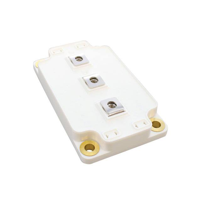

MSCDC450A70AG SiC Diode Phase Leg Power Module 1 Product Overview This section provides the product overview for the MSCDC450A70AG device. All ratings at Tj = 25 °C, unless otherwise specified. Caution: These devices are sensitive to electrostatic discharge. Proper handling procedures should be followed. MSCC-0344-DS-01021 Datasheet Revision 1.0 1 1.1 Features The following are key features of the MSCDC450A70AG device: Silicon carbide (SiC) Schottky diode Zero reverse recovery Zero forward recovery Temperature-independent switching behavior Positive temperature coefficient on VF Low stray inductance M5 power connectors High level of integration Aluminum nitride (AlN) substrate for improved thermal performance 1.2 Benefits The following are benefits of the MSCDC450A70AG device: Outstanding performance at high-frequency operation Low noise switching Direct mounting to heatsink (isolated package) Low junction-to-case thermal resistance RoHS compliant 1.3 Applications The MSCDC450A70AG device is designed for the following applications: Uninterruptible power supply (UPS) Induction heating Welding equipment High-speed rectifiers MSCC-0344-DS-01021 Datasheet Revision 1.0 2 2 Electrical Specifications This section provides the electrical specifications for the MSCDC450A70AG device. 2.1 Absolute Maximum Ratings The following table shows the absolute maximum ratings per diode for the MSCDC450A70AG device. Table 1 • Absolute Maximum Ratings Symbol Parameter Maximum Ratings Unit VRRM Repetitive peak reverse voltage 700 V IF DC forward current 450 A TC = 55 °C The following table shows the thermal and package characteristics of the MSCDC450A70AG. Table 2 • Thermal and Package Characteristics Symbol Characteristic Min VISOL RMS isolation voltage, any terminal to case t =1 minute, 50 Hz/60 Hz 4000 TJ Operating junction temperature range –40 175 TJOP Recommended junction temperature under switching conditions –40 TJmax–25 TSTG Storage temperature range –40 125 TC Operating case temperature Torque Mounting torque Wt 2.2 Max V –40 125 To heatsink M6 3 5 For terminals M5 2 3.5 Package weight Unit °C N.m 300 g Electrical Performance The following table shows the electrical characteristics per diode of the MSCDC450A70AG. Table 3 • Electrical Characteristics Per Diode Symbol Characteristic Test Conditions VF Diode forward voltage IF = 450 A IRM Reverse leakage current VR = 700 V Typ Max Unit Tj = 25 °C Min 1.5 1.8 V Tj = 175 °C 1.9 Tj = 25 °C 0.13 1.8 mA Tj = 175 °C 1.9 QC Total capacitive charge VR = 400 V 1197 nC C Total capacitance f = 1 MHz, VR = 200 V 2232 pF f = 1 MHz, VR = 400 V 1944 RthJC Junction-to-case thermal resistance MSCC-0344-DS-01021 Datasheet Revision 1.0 0.114 °C/W 3 2.3 Performance Curves This section shows the typical performance curves for the MSCDC450A70AG device. Figure 1 • Maximum Transient Thermal Impedance Figure 2 • Forward Current vs. Forward Voltage Figure 3 • Capacitance vs. Reverse Voltage MSCC-0344-DS-01021 Datasheet Revision 1.0 4 3 Package Specifications This section shows the package specifications for the MSCDC450A70AG device. 3.1 Package Outline Drawing The following drawing shows the package outline of the MSCDC450A70AG device. The dimensions in the following figure are in millimeters. Figure 4 • Package Outline Drawing MSCC-0344-DS-01021 Datasheet Revision 1.0 5 Microsemi Headquarters One Enterprise, Aliso Viejo, CA 92656 USA Within the USA: +1 (800) 713-4113 Outside the USA: +1 (949) 380-6100 Sales: +1 (949) 380-6136 Fax: +1 (949) 215-4996 Email: sales.support@microsemi.com www.microsemi.com © 2019 Microsemi. All rights reserved. Microsemi and the Microsemi logo are trademarks of Microsemi Corporation. All other trademarks and service marks are the property of their respective owners. Microsemi makes no warranty, representation, or guarantee regarding the information contained herein or the suitability of its products and services for any particular purpose, nor does Microsemi assume any liability whatsoever arising out of the application or use of any product or circuit. The products sold hereunder and any other products sold by Microsemi have been subject to limited testing and should not be used in conjunction with mission-critical equipment or applications. Any performance specifications are believed to be reliable but are not verified, and Buyer must conduct and complete all performance and other testing of the products, alone and together with, or installed in, any end-products. Buyer shall not rely on any data and performance specifications or parameters provided by Microsemi. It is the Buyer's responsibility to independently determine suitability of any products and to test and verify the same. The information provided by Microsemi hereunder is provided "as is, where is" and with all faults, and the entire risk associated with such information is entirely with the Buyer. Microsemi does not grant, explicitly or implicitly, to any party any patent rights, licenses, or any other IP rights, whether with regard to such information itself or anything described by such information. Information provided in this document is proprietary to Microsemi, and Microsemi reserves the right to make any changes to the information in this document or to any products and services at any time without notice. Microsemi, a wholly owned subsidiary of Microchip Technology Inc. (Nasdaq: MCHP), offers a comprehensive portfolio of semiconductor and system solutions for aerospace & defense, communications, data center and industrial markets. Products include high-performance and radiation-hardened analog mixed-signal integrated circuits, FPGAs, SoCs and ASICs; power management products; timing and synchronization devices and precise time solutions, setting the world's standard for time; voice processing devices; RF solutions; discrete components; enterprise storage and communication solutions; security technologies and scalable anti-tamper products; Ethernet solutions; Power-over-Ethernet ICs and midspans; as well as custom design capabilities and services. Microsemi is headquartered in Aliso Viejo, California, and has approximately 4,800 employees globally. Learn more at www. microsemi.com. MSCC-0344-DS-01021 | June 2019 | Final MSCC-0344-DS-01021 Datasheet Revision 1.0 6
