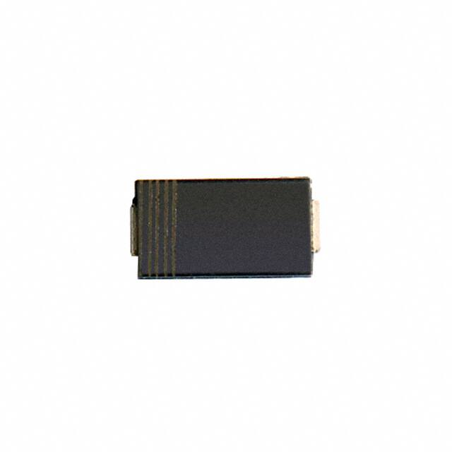

SMAJ5913Be3 – SMAJ5956Be3 Compliant Silicon 3.0 Watt Zener Diode DESCRIPTION The SMAJ5913Be3 – SMAJ5956Be3 series of surface mount 3.0 watt Zeners provides voltage regulation in a selection from 3.3 to 200 volts with different tolerances as identified by suffix letter on the part number. It is equivalent to the JEDEC registered 1N5913B through 1N5956B series with identical electrical characteristics except it is rated at 3.0 W instead of 1.5 W with the lower thermal resistance features of this surface mount packaging. These plastic encapsulated Zeners have a moisture classification of Level 1 with no dry pack required. . Important: For the latest information, visit our website http://www.microsemi.com. DO-214AC or BA (SMAJ) Package FEATURES • • • • Ideal for high-density and low-profile mounting. Zener voltage available 3.3V to 200V. Available voltage tolerances are 10%, 5%, 2%, and 1%. RoHS compliant. Also available in: DO-41 package ( plastic axial leaded) 1N5913BP – 1N5956BP DO-216 package ( tabbed surface moun t) 1PMT5913B – 1PMT5956B APPLICATIONS / BENEFITS • • • • Regulates voltage over a broad range of current and temperature. Nonsensitive to ESD per MIL-STD-750 method 1020. High specified maximum current (I ZM ) with adequately heat sinking. Moisture classification is Level 1 with no dry pack required per IPC/JEDEC J-STD-020B. MAXIMUM RATINGS Parameters/Test Conditions Junction and Storage Temperature Thermal Resistance Junction-to-Lead (1) Thermal Resistance Junction-to-Ambient Rated Average Power Dissipation @ +25 ºC (also see derating in Figure 1) Forward Voltage @ 200 mA Solder Temperature @ 10 s Symbol TJ and TSTG R ӨJL R ӨJA P M(AV) Value -65 to +150 15 80 3.0 VF TSP 1.2 260 Notes: 1. When mounted on FR4 PC board (1oz Cu) with recommended footprint (see last page). Unit ºC ºC/W ºC/W W V C o MSC – Lawrence 6 Lake Street, Lawrence, MA 01841 Tel: 1-800-446-1158 or (978) 620-2600 Fax: (978) 689-0803 MSC – Ireland Gort Road Business Park, Ennis, Co. Clare, Ireland Tel: +353 (0) 65 6840044 Fax: +353 (0) 65 6822298 Website: www.microsemi.com RF01130, Rev. A (5/13/13) ©2013 Microsemi Corporation Page 1 of 6 SMAJ5913Be3 – SMAJ5956Be3 MECHANICAL and PACKAGING • • • • • • • CASE: Void-free transfer molded thermosetting epoxy body meeting UL94V-0. TERMINALS: RoHS compliant annealed matte-tin plating. Solderable to MIL-STD-750, method 2026. MARKING: Includes part number without prefix (e.g. 5913B, 5916Be3, 5926C, 5951De3, etc.). POLARITY: Cathode indicated by band. Diode to be operated with the banded end positive with respect to the opposite end for Zener regulation. TAPE & REEL option: Standard per EIA-481-1-A with 12 mm tape (add “TR” suffix to part number). Consult factory for quantities. WEIGHT: Approximately 0.064 grams. See Package Dimensions on last page. PART NOMENCLATURE SM A J 5913 B Surface Mount Package RoHS Compliant 3 Watt Power Level Tolerance Level A = 10% tolerance B = 5% tolerance C = 2% tolerance D = 1% tolerance J-Bend Lead Form JEDEC type number (see Electrical Characteristics table) SYMBOLS & DEFINITIONS Definition Symbol IR I Z, I ZT, I ZK I ZM VF VR VZ Z ZT or Z ZK e3 Reverse Current: The maximum reverse (leakage) current that will flow at the specified voltage V R and temperature. Regulator Current: The dc regulator current (I Z), at a specified test point (I ZT), near breakdown knee (I ZK ). Maximum Regulator (Zener) Current: The maximum rated dc current for the specified power rating. Maximum Forward Voltage: The maximum forward voltage the device will exhibit at a specified current. Reverse Voltage: The dc voltage applied in the reverse direction below the breakdown region. Zener Voltage: The Zener voltage the device will exhibit at a specified current (I Z) in its breakdown region. Dynamic Impedance: The small signal impedance of the diode when biased to operate in its breakdown region at a specified rms current modulation (typically 10% of I ZT or I ZK ) and superimposed on I ZT or I ZK respectively. RF01130, Rev. A (5/13/13) ©2013 Microsemi Corporation Page 2 of 6 SMAJ5913Be3 – SMAJ5956Be3 ELECTRICAL CHARACTERISTICS @ 25 ºC unless otherwise stated JEDEC TYPE NUMBER ZENER VOLTAGE VZ TEST CURRENT I ZT DYNAMIC IMPEDANCE Z ZT KNEE CURRENT I ZK KNEE IMPEDANCE Z ZK REVERSE CURRENT I R (MAX.) REVERSE VOLTAGE VR MAX. DC CURRENT I ZM SMAJ5913B SMAJ5914B SMAJ5915B SMAJ5916B SMAJ5917B SMAJ5918B SMAJ5919B SMAJ5920B SMAJ5921B SMAJ5922B SMAJ5923B SMAJ5924B SMAJ5925B SMAJ5926B SMAJ5927B SMAJ5928B SMAJ5929B SMAJ5930B SMAJ5931B SMAJ5932B SMAJ5933B SMAJ5934B SMAJ5935B SMAJ5936B SMAJ5937B SMAJ5938B SMAJ5939B SMAJ5940B SMAJ5941B SMAJ5942B SMAJ5943B SMAJ5944B SMAJ5945B SMAJ5946B SMAJ5947B SMAJ5948B SMAJ5949B SMAJ5950B SMAJ5951B SMAJ5952B SMAJ5953B SMAJ5954B SMAJ5955B SMAJ5956B Volts 3.3 3.6 3.9 4.3 4.7 5.1 5.6 6.2 6.8 7.5 8.2 9.1 10 11 12 13 15 16 18 20 22 24 27 30 33 36 39 43 47 51 56 62 68 75 82 91 100 110 120 130 150 160 180 200 mA 113.6 104.2 96.1 87.2 79.8 73.5 66.9 60.5 55.1 50 45.7 41.2 37.5 34.1 31.2 28.8 25 23.4 20.8 18.7 17 15.6 13.9 12.5 11.4 10.4 9.6 8.7 8.0 7.3 6.7 6.0 5.5 5.0 4.6 4.1 3.7 3.4 3.1 2.9 2.5 2.3 2.1 1.9 Ohms 10 9.0 7.5 6.0 5.0 4.0 2.0 2.0 2.5 3.0 3.5 4.0 4.5 5.5 6.5 7.0 9.0 10 12 14 17.5 19 23 28 33 38 45 53 67 70 86 100 120 140 160 200 250 300 380 450 600 700 900 1200 mA 1.0 1.0 1.0 1.0 1.0 1.0 1.0 1.0 1.0 0.5 0.5 0.5 0.25 0.25 0.25 0.25 0.25 0.25 0.25 0.25 0.25 0.25 0.25 0.25 0.25 0.25 0.25 0.25 0.25 0.25 0.25 0.25 0.25 0.25 0.25 0.25 0.25 0.25 0.25 0.25 0.25 0.25 0.25 0.25 Ohms 500 500 500 500 500 350 250 200 200 400 400 500 500 550 550 550 600 600 650 650 650 700 700 750 800 850 900 950 1000 1100 1300 1500 1700 2000 2500 3000 3100 4000 4500 5000 6000 6500 7000 8000 µA 100 75 25 5.0 5.0 5.0 5.0 5.0 5.0 5.0 5.0 5.0 5.0 1.0 1.0 1.0 1.0 1.0 1.0 1.0 1.0 1.0 1.0 1.0 1.0 1.0 1.0 1.0 1.0 1.0 1.0 1.0 1.0 1.0 1.0 1.0 1.0 1.0 1.0 1.0 1.0 1.0 1.0 1.0 Volts 1.0 1.0 1.0 1.0 1.5 2.0 3.0 4.0 5.2 6.0 6.5 7.0 8.0 8.4 9.1 9.9 11.4 12.2 13.7 15.2 16.7 18.2 20.6 22.8 25.1 27.4 29.7 32.7 35.8 38.8 42.6 47.1 51.2 56 62.2 69.2 76 83.6 91.2 98.8 114 121.6 136.8 152 mA 908 832 768 696 638 588 534 482 440 400 364 328 300 272 250 230 200 186 166 150 136 124 110 100 90 82 76 68 62 58 52 48 44 40 36 32 30 26 24 22 20 18 16 14 NOTES: 1. Suffix B (shown) denotes a +/-5% tolerance on nominal V Z , A denotes a +/-10% tolerance, C denotes a 2% tolerance, and D denotes a +/-1% tolerance. 2. Zener voltage (V Z ) is measured at T L = 30 oC and 90 seconds after application of dc current. 3. The Zener impedance is derived from the 60 Hz ac voltage, which results when an ac current having an rms value equal to 10% of the dc Zener current (I ZT or I ZK ) is superimposed on I ZT or I ZK . 4. o The maximum dc current (I ZM ) is based only on the maximum power of 3.0 watts at T L < 105 C. These values must be reduced by 48% (1.56 W) when mounted on PC boards as described in Maximum Ratings. RF01130, Rev. A (5/13/13) ©2013 Microsemi Corporation Page 3 of 6 SMAJ5913Be3 – SMAJ5956Be3 Pd, Maximum Power Dissipation (mW) GRAPHS Temperature ºC Typical Maximum Power in Watts FIGURE 1 POWER DERATING CURVE Square Wave Pulse Width (Non-Repetitive) in Milliseconds FIGURE 2 TRANSIENT SURGE CAPABILITY RF01130, Rev. A (5/13/13) ©2013 Microsemi Corporation Page 4 of 6 SMAJ5913Be3 – SMAJ5956Be3 Typical Capacitance in Picofarads GRAPHS Zener Voltage V Z FIGURE 3 CAPACITANCE vs. V Z CURVE RF01130, Rev. A (5/13/13) ©2013 Microsemi Corporation Page 5 of 6 SMAJ5913Be3 – SMAJ5956Be3 PACKAGE DIMENSIONS Ltr A B C D E G H J Dimensions Inch Millimeters Min Max Min Max 0.075 0.089 1.90 2.25 0.050 0.064 1.27 1.63 0.004 0.008 0.10 0.20 0.006 0.012 0.15 0.31 0.031 0.059 0.80 1.50 0.189 0.205 4.80 5.20 0.157 0.181 4.00 4.60 0.095 0.104 2.40 2.65 NOTES: Dimension “A” is within DO-214BA but higher than DO-214AC standard JEDEC outlines. Dimension “B” is wider than both JEDEC outlines for lower thermal resistance. PAD LAYOUT Ltr A (MAX) B (MIN) C (MIN) D (TYP) RF01130, Rev. A (5/13/13) ©2013 Microsemi Corporation Inch 0.074 0.060 0.066 0.208 Millimeters 2.413 1.52 1.68 5.28 Page 6 of 6

器件简介: - 这些表面安装的3.0瓦Zener二极管提供从3.3到200伏的电压调节,具有不同的容差。 - 它们等同于JEDEC注册的1N5913B至1N5956B系列,但额定功率更高,具有更低的热阻。
引脚分配: - 采用DO-214AC或BA(SMAJ)封装,具有J形弯曲引脚。
参数特性: - 工作温度范围:-65℃至+150℃ - 热阻:结到引脚15°C/W,结到环境80°C/W - 额定平均功率耗散:3.0W - 200mA下的正向电压:1.2V - 10秒焊接温度:260°C
功能详解: - 这些Zener二极管适用于高密度和低剖面安装。 - 电压容差有10%、5%、2%和1%可选。 - 符合RoHS标准。
应用信息: - 用于在广泛的电流和温度范围内调节电压。 - 对静电放电不敏感,符合MIL-STD-750方法1020。 - 具有高规定的最大电流(IZM),在适当的散热条件下。
封装信息: - 提供DO-214AC或BA(SMAJ)封装,也提供DO-41(塑料轴向引线)和DO-216(带标签的表面安装)封装。
电气特性: - 在25°C下,列出了不同型号的Zener电压、测试电流、动态阻抗、折点电流、折点阻抗、最大反向电流、反向电压和最大直流电流。
