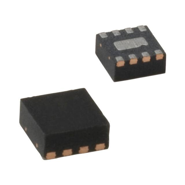

ECL Pro® SY10EP51V ECL Pro® 5V/3.3V D FLIP-FLOP WITH RESET AND DIFFERENTIAL CLOCK Micrel, Inc. SY10EP51V FEATURES ■ ■ ■ ■ ■ ■ 3.3V and 5V power supply options 320ps typical propagation delay Maximum frequency > 3GHz typical 75KΩ internal input pulldown resistor Transistor count: 143 Available in 8-Pin (3mmx3mm) MSOP, SOIC and MLF® (2mmx2mm) packages ECL Pro® DESCRIPTION The SY10EP51V is a D flip-flop with reset and differential clock. The device is pin and functionally equivalent to the EL51 device. The reset input is an asynchronous, level triggered signal. Data enters the master portion of the flip-flop when CLK is LOW and is transferred to the slave, and thus the outputs, upon a positive transition of the CLK. The differential clock inputs of the EP51V allow the device to be used as a negative edge triggered flip-flop. The differential input employs clamp circuitry to maintain stability under open input conditions. When left open, the CLK input will be pulled down to VEE and the /CLK input will be biased a VCC/2. PIN NAMES TRUTH TABLE Pin Function D RESET CLK Q CLK, /CLK ECL Clock Inputs L L Z L RESET ECL Asynchronous Reset H L Z H D ECL Data Input X H X L Q, /Q ECL Data Outputs VCC Positive Supply VEE Negative, 0 Supply Z = LOW to HIGH Transition ECL Pro is a registered trademark of Micrel, Inc. M9999-060409 hbwhelp@micrel.com or (408) 955-1690 Rev.: E 1 Amendment: /0 Issue Date: June 2009 ECL Pro® SY10EP51V Micrel, Inc. PACKAGE/ORDERING INFORMATION Ordering Information(1) RESET 1 R D 2 D Flip Flop CLK 3 /CLK 4 Package Type Operating Range Package Marking Lead Finish SY10EP51VKC K8-1 Commercial HP51 Sn-Pb SY10EP51VKCTR(2) K8-1 Commercial HP51 Sn-Pb SY10EP51VZC Z8-1 Commercial HEP51V Sn-Pb SY10EP51VZCTR(2) Z8-1 Commercial HEP51V Sn-Pb SY10EP51VKI K8-1 Industrial HP51 Sn-Pb SY10EP51VKITR(2) K8-1 Industrial HP51 Sn-Pb SY10EP51VZI Z8-1 Industrial HEP51V Sn-Pb SY10EP51VZITR(2) Z8-1 Industrial HEP51V Sn-Pb SY10EP51VKG(3) K8-1 Industrial HP51 with Pb-Free bar-line indicator Pb-Free NiPdAu SY10EP51VKGTR(2, 3) K8-1 Industrial HP51 with Pb-Free bar-line indicator Pb-Free NiPdAu SY10EP51VMGTR(2, 3) MLF-8 Industrial H51 with Pb-Free bar-line indicator Pb-Free NiPdAu SY10EP51VZG(3) Z8-1 Industrial HEP51V with Pb-Free bar-line indicator Pb-Free NiPdAu SY10EP51VZGTR(2, 3) Z8-1 Industrial HEP51V with Pb-Free bar-line indicator Pb-Free NiPdAu 8 VCC Part Number 7 Q 6 /Q 5 VEE 8-Pin SOIC and MSOP Packages RESET 1 8 VCC D 2 7 Q CLK 3 6 /Q /CLK 4 5 VEE 8-Pin (2mmx2mm) MLF® Notes: 1. Contact factory for die availability. Dice are guaranteed at TA = 25°C, DC Electricals only. 2. Tape and Reel. 3. Pb-Free package is recommended for new designs. M9999-060409 hbwhelp@micrel.com or (408) 955-1690 2 ECL Pro® SY10EP51V Micrel, Inc. ABSOLUTE MAXIMUM RATINGS(1) Symbol Rating Value Unit 6V V –6.0 to 0 +6.0 to 0 V V 50 100 mA +260 °C VCC — VEE Power Supply Voltage VIN Input Voltage (VCC = 0V, VIN not more negative than VEE) Input Voltage (VEE = 0V, VIN not more positive than VCC) IOUT Output Current TLEAD Lead Temperature (soldering, 20sec.) TA Operating Temperature Range –40 to +85 °C Tstore Storage Temperature Range –65 to +150 °C θJA Package Thermal Resistance (Junction-to-Ambient) –Still-Air (SOIC) –500lfpm (SOIC) 160 109 °C/W –Still-Air (MSOP) –500lfpm (MSOP) 206 155 °C/W –Still-Air (MLF®) –500lfpm (MLF®) 93 87 °C/W 39 39 60 °C/W Package Thermal Resistance (Junction-to-Case) θJC Note 1. –Continuous –Surge (SOIC) (MSOP) (MLF®) Permanent device damage may occur if absolute maximum ratings are exceeded. This is a stress rating only and functional operation is not implied at conditions other than those detailed in the operational sections of this data sheet. Exposure to absolute maximum ratlng conditions for extended periods may affect device reliability. 5V PECL DC ELECTRICAL CHARACTERISTICS(1) VCC = 5.0V, VEE = 0V(2) TA = –40°C Symbol IEE VOH Parameter Power Supply Output HIGH Current(3) Voltage(4) Voltage(4) TA = +25°C TA = +85°C Min. Typ. Max. Min. Typ. Max. Min. Typ. Max. Unit — 35 40 — 35 40 — 35 40 mA 3865 3990 4115 3930 4055 4180 3990 4115 4240 mV 3050 3190 3315 3050 3255 3380 3050 3315 3440 mV VOL Outuput LOW VIH Input HIGH Voltage (Single-Ended) 3790 — 4115 3855 — 4180 3915 — 4240 mV VIL Input LOW Voltage (Single-Ended) 3065 — 3390 3130 — 3455 3190 — 3515 mV VIHCMR Input HIGH Voltage(5) Common Mode Range 2.0 — VCC 2.0 — VCC 2.0 — VCC V IIH Input HIGH Current — — 150 — — 150 — — 150 µA IIL Input LOW Current 0.5 — — 0.5 — — 0.5 — — µA Note 1. 10EP circuits are designed to meet the DC specifications shown in the above table after thermal equilibrium has been established. The circuit is in a test socket or mounted on a printed circuit board and traverse airflow greater than 500lfpm is maintained. Note 2. Input and output parameters vary 1:1 with VCC. VCC can vary +0.25V to +0.5V. Note 3. VCC = 0V, VEE = VEE (min.) to VEE (max.), all other pins floating. Note 4. All loading with 50Ω to VCC –2.0V. Note 5. VIHCMR(min) varies 1:1 with VEE, VIHCMR(max) varies 1:1 with VCC. The VIHCMR range is referenced to the most positive side of the differential input signal. M9999-060409 hbwhelp@micrel.com or (408) 955-1690 3 ECL Pro® SY10EP51V Micrel, Inc. 3.3V LVPECL DC ELECTRICAL CHARACTERISTICS(1) VCC = 3.3V, VEE = 0V(2) TA = –40°C Symbol Parameter TA = +25°C TA = +85°C Min. Typ. Max. Min. Typ. Max. Min. Typ. Max. Unit IEE Power Supply Current(3) — 35 40 — 35 40 — 35 40 mA VOH Output HIGH Voltage(4) 2165 2290 2415 2230 2355 2480 2290 2415 2540 mV VOL Outuput LOW Voltage(4) 1350 1490 1615 1350 1555 1680 1350 1615 1740 mV VIH Input HIGH Voltage (Single-Ended) 2090 — 2415 2155 — 2480 2215 — 2540 mV VIL Input LOW Voltage (Single-Ended) 1365 — 1690 1430 — 1755 1490 — 1815 mV VIHCMR Input HIGH Voltage(5) Common Mode Range (Diff.) 2.0 — VCC 2.0 — VCC 2.0 — VCC V IIH Input HIGH Current — — 150 — — 150 — — 150 µA IIL Input LOW Current 0.5 — — 0.5 — — 0.5 — — µA Note 1. 10EP circuits are designed to meet the DC specifications shown in the above table after thermal equilibrium has been established. The circuit is in a test socket or mounted on a printed circuit board and traverse airflow greater than 500lfpm is maintained. Note 2. Input and output parameters vary 1:1 with VCC. VCC can vary –0.3V to +0.5V. Note 3. VCC = 0V, VEE = VEE(min.) to VEE(max.), all other pins floating. Note 4. All loading with 50Ω to VCC –2.0V. Note 5. VIHCMR(min) varies 1:1 with VEE, VIHCMR(max) varies 1:1 with VCC. The VIHCMR range is referenced to the most positive side of the differential input signal. NECL/LVECL DC ELECTRICAL CHARACTERISTICS(1) VCC = 0V, VEE = –5.5V to –3.0V TA = –40°C Symbol IEE VOH Parameter Power Supply Current(2) Output HIGH Voltage(3) Voltage(3) TA = +25°C TA = +85°C Min. Typ. Max. Min. Typ. Max. Min. Typ. Max. Unit — 35 40 — 35 40 — 35 40 mA –1135 –1010 –0885 –1070 –0945 –0820 –1010 –0885 –0760 mV –1950 –1810 –1685 –1950 –1745 –1620 –1950 –1685 –1560 mV VOL Outuput LOW VIH Input HIGH Voltage –1210 — –0885 –1145 — –0820 –1085 — –0760 mV VIL Input LOW Voltage –1935 — –1610 –1870 — –1545 –1810 — –1485 mV VIHCMR Input HIGH Voltage Common Mode Range(4) 0.0 V IIH Input HIGH Current — — 150 — — 150 — — 150 µA IIL Input LOW Current 0.5 — — 0.5 — — 0.5 — — µA VEE+2.0 0.0 VEE+2.0 0.0 VEE+2.0 Note 1. 10EP circuits are designed to meet the DC specifications shown in the above table after thermal equilibrium has been established. The circuit is in a test socket or mounted on a printed circuit board and traverse airflow greater than 500lfpm is maintained. Note 2. VCC = 0V, VEE = VEE(min) to VEE(max), all other pins floating. Note 3. All loading with 50Ω to VCC –2.0V. Note 4. VIHCMR min varies 1:1 with VEE, max varies 1:1 with VCC. M9999-060409 hbwhelp@micrel.com or (408) 955-1690 4 ECL Pro® SY10EP51V Micrel, Inc. AC ELECTRICAL CHARACTERISTICS VCC = 0V, VEE = –3.0V to –5.5V; VCC = 3.0V to 5.5V, VEE = 0V(1) TA = –40°C Symbol Parameter Frequency(2) TA = +25°C TA = +85°C Min. Typ. Max. Min. Typ. Max. Min. Typ. Max. Unit 3 — — 3 — — 3 — — GHz fMAX Maximum Toggle tPLH tPHL Propagation Delay to Output Differential CLK, /CLK ➝ Q, /Q RESET ➝ Q, /Q 250 260 300 310 350 450 270 210 320 320 370 475 300 280 350 320 420 500 tRR Reset Recovery 150 — — 150 — — 150 — — ps tS Setup Time 100 — — 100 80 — 100 — — ps tH Hold Time 100 — — 100 40 — 100 — — ps tPW Minimum Pulse Width RESET 500 440 — 500 440 — 500 440 — ps tr tf Output Rise/Fall Times (20% to 80%) 70 120 170 80 130 180 100 150 200 ps Q, /Q ps Note 1. Measured using 750mV source, 50% duty cycle clock source. All loading with 50Ω to VCC –2.0V. Note 2. fMAX guaranteed for functionality only. VOL and VOH levels are guaranteed at DC only. TIMING DIAGRAMS CLK tH 50% 50% DATA tS tRR RESET tPW Q 50% tPLH M9999-060409 hbwhelp@micrel.com or (408) 955-1690 50% tPHL 5 ECL Pro® SY10EP51V Micrel, Inc. 8-PIN MSOP (K8-1) Rev. 01 M9999-060409 hbwhelp@micrel.com or (408) 955-1690 6 ECL Pro® SY10EP51V Micrel, Inc. 8-PIN PLASTIC SOIC (Z8-1) Rev. 03 M9999-060409 hbwhelp@micrel.com or (408) 955-1690 7 ECL Pro® SY10EP51V Micrel, Inc. 8-PIN PLASTIC MLF® (MLF-8) MICREL, INC. 2180 FORTUNE DRIVE SAN JOSE, CA 95131 USA TEL + 1 (408) 944-0800 FAX + 1 (408) 474-1000 WEB http://www.micrel.com The information furnished by Micrel in this datasheet is believed to be accurate and reliable. However, no responsibility is assumed by Micrel for its use. Micrel reserves the right to change circuitry and specifications at any time without notification to the customer. Micrel Products are not designed or authorized for use as components in life support appliances, devices or systems where malfunction of a product can reasonably be expected to result in personal injury. Life support devices or systems are devices or systems that (a) are intended for surgical implant into the body or (b) support or sustain life, and whose failure to perform can be reasonably expected to result in a significant injury to the user. A Purchaser’s use or sale of Micrel Products for use in life support appliances, devices or systems is at Purchaser’s own risk and Purchaser agrees to fully indemnify Micrel for any damages resulting from such use or sale. © 2005 Micrel, Incorporated. M9999-060409 hbwhelp@micrel.com or (408) 955-1690 8
