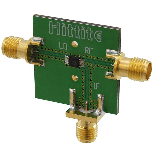

    BOARD EVAL MIXER MMIC HMC220A
101830-HMC220AMS8 数据手册
HMC220AMS8 / 220AMS8E v00.0211 10 - 1 Features The HMC220AMS8 / HMC220AMS8E is ideal for: Ultra Small Package: MSOP8 • Microwave Radios Conversion Loss: 8.5 dB • VSAT Wideband IF: DC - 4 GHz Functional Diagram General Description TE Typical Applications B SO LE The HMC220AMS8 & HMC220AMS8E are ultra miniature double-balanced mixers in 8 lead plastic surface mount packages (MSOP). This passive MMIC mixer is constructed of GaAs Schottky diodes and novel planar transformer baluns on the chip. The device can be used as an upconverter, downconverter, bi-phase (de)modulator, or phase comparator. The consistent MMIC performance will improve system operation and assure regulatory compliance. Electrical Specifications, TA = +25° C, As a Function of LO Drive O MIXERS - SINGLE & DOUBLE BALANCED - SMT 10 GaAs MMIC SMT DOUBLEBALANCED MIXER, 5 - 12 GHz LO = +13 dBm IF = 100 MHz Parameter Min. Typ. LO = +13 dBm IF = 100 MHz Max. Min. Typ. LO = +10 dBm IF = 100 MHz Max. Min. Typ. Units Max. Frequency Range, RF & LO 5 - 10 10 - 12 5.9 - 10 GHz Frequency Range, IF DC - 4 DC - 4 DC - 3.5 GHz Conversion Loss 7.0 10 8.5 10.5 7.5 10 dB Noise Figure (SSB) 7.0 10 8.5 10.5 7.5 10 dB LO to RF Isolation 17 25 13 18 17 25 dB LO to IF Isolation 20 28 14 20 20 28 dB IP3 (Input) 14 17 16 21 13 16 dBm 1 dB Gain Compression (Input) 4 8 4 8 5 8 dBm Information furnished by Analog Devices is believed to be accurate and reliable. However, no For price, delivery, andRoad, to place orders: Analog Devices, For price, delivery and to for place Hittite Microwave Corporation, 20 Alpha Chelmsford, MA 01824Inc., responsibility is assumed by Analog Devices its use, orders: nor for any infringements of patents or other One Technology Way, P.O. Box 9106, Norwood, MA 02062-9106 rights of third parties that may result from its use. Specifications subject to change without notice. No Phone: 978-250-3343 Fax: 978-250-3373 Phone: Order781-329-4700 On-line at www.hittite.com • Order online at www.analog.com license is granted by implication or otherwise under any patent or patent rights of Analog Devices. Application Support: Phone: 1-800-ANALOG-D Trademarks and registered trademarks are the property of their respective owners. Application Support: Phone: 978-250-3343 or apps@hittite.com HMC220AMS8 / 220AMS8E v00.0211 GaAs MMIC SMT DOUBLEBALANCED MIXER, 5 - 12 GHz Conversion Gain vs Temperature @ LO = +10 dBm Isolation @ LO = +10 dBm 0 ISOLATION (dB) -40 C +25 C +85 C -15 10 -15 -20 -25 -30 -35 -20 5 6 7 8 9 10 11 12 5 13 6 7 8 9 10 11 12 13 11 12 13 11 12 13 FREQUENCY (GHz) Conversion Gain vs. LO Drive LE FREQUENCY (GHz) Return Loss @ LO = +10 dBm 0 0 +5 dBm +7 dBm +9 dBm +10 dBm +13 dBm -10 -15 -20 5 6 7 8 LO RF -5 -5 B SO CONVERSION GAIN (dB) RF/IF LO/IF LO/RF -10 TE -10 9 10 11 12 RETURN LOSS (dB) CONVERSION GAIN (dB) -5 -5 -10 -15 -20 -25 5 13 6 7 IF Bandwidth vs LO Drive Conversion Gain and Return Loss 8 9 10 FREQUENCY (GHz) FREQUENCY (GHz) O P1dB vs. Temperature LO = +10 dBm 16 0 Conversion Gain -5 12 +10 dBm -10 P1dB (dBm) IF CONVERSION GAIN (dB) RETURN LOSS (dB) +13 dBm -15 8 -40 C +25 C +85 C 4 -20 +13 dBm +10 dBm IF Return Loss -25 MIXERS - SINGLE & DOUBLE BALANCED - SMT 0 0 0 1 2 3 4 IF FREQUENCY (GHz) 5 6 5 6 7 8 9 10 FREQUENCY (GHz) Information furnished by Analog Devices is believed to be accurate and reliable. However, no For price, delivery, andRoad, to place orders: Analog Devices, For price, delivery and to for place Hittite Microwave Corporation, 20 Alpha Chelmsford, MA 01824Inc., responsibility is assumed by Analog Devices its use, orders: nor for any infringements of patents or other One Technology Way, P.O. Box 9106, Norwood, MA 02062-9106 rights of third parties that may result from its use. Specifications subject to change without notice. No Phone: 978-250-3343 Fax: 978-250-3373 Phone: Order781-329-4700 On-line at www.hittite.com • Order online at www.analog.com license is granted by implication or otherwise under any patent or patent rights of Analog Devices. Application Support: Phone: 1-800-ANALOG-D Trademarks and registered trademarks are the property of their respective owners. Application Support: Phone: 978-250-3343 or apps@hittite.com 10 - 2 HMC220AMS8 / 220AMS8E v00.0211 GaAs MMIC SMT DOUBLEBALANCED MIXER, 5 - 12 GHz Input IP3 vs. Temperature @ LO = +10 dBm Input IP3 vs. LO Drive 30 10 - 3 +7 dBm +10 dBm +13 dBm -40 C +25 C +85 C INPUT IP3 (dBm) 25 20 TE 20 15 15 10 10 5 6 7 8 9 10 11 12 13 5 LO FREQUENCY (GHz) 6 7 8 9 10 11 12 13 11 12 13 LO FREQUENCY (GHz) LE Input IP2 vs. Temperature @ LO = +10 dBm Input IP2 vs. LO Drive 50 50 45 30 20 B SO 40 +7 dBm +10 dBm +13 dBm 10 0 5 6 7 8 9 10 12 13 -40 C +25 C +85 C 40 35 30 25 20 5 6 7 8 9 10 LO FREQUENCY (GHz) O LO FREQUENCY (GHz) 11 INPUT IP2 (dBm) INPUT IP3 (dBm) 25 INPUT IP2 (dBm) MIXERS - SINGLE & DOUBLE BALANCED - SMT 10 30 Information furnished by Analog Devices is believed to be accurate and reliable. However, no For price, delivery, andRoad, to place orders: Analog Devices, For price, delivery and to for place Hittite Microwave Corporation, 20 Alpha Chelmsford, MA 01824Inc., responsibility is assumed by Analog Devices its use, orders: nor for any infringements of patents or other One Technology Way, P.O. Box 9106, Norwood, MA 02062-9106 rights of third parties that may result from its use. Specifications subject to change without notice. No Phone: 978-250-3343 Fax: 978-250-3373 Phone: Order781-329-4700 On-line at www.hittite.com • Order online at www.analog.com license is granted by implication or otherwise under any patent or patent rights of Analog Devices. Application Support: Phone: 1-800-ANALOG-D Trademarks and registered trademarks are the property of their respective owners. Application Support: Phone: 978-250-3343 or apps@hittite.com HMC220AMS8 / 220AMS8E v00.0211 GaAs MMIC SMT DOUBLEBALANCED MIXER, 5 - 12 GHz Harmonics of LO nLO nLO Spur at RF Port mRF 0 1 2 3 4 LO Freq. (GHz) 1 2 3 4 0 xx 3 10 7 54 5.5 29 30 42 69 1 11 0 28 31 35 7 29 27 28 66 2 53 62 53 58 61 8.5 26 35 47 70 73 69 74 66 73 10 22 40 44 67 > 85 > 85 > 85 > 85 > 85 11.5 18 49 51 66 13 13 63 62 xx Absolute Maximum Ratings +13 dBm LO Drive +27 dBm Storage Temperature -65 to +150 °C Operating Temperature -40 to +85 °C ELECTROSTATIC SENSITIVE DEVICE OBSERVE HANDLING PRECAUTIONS B SO RF / IF Input LO = +10 dBm Values in dBc below input LO level measured at the RF port. LE RF = 7.5 GHz @ -10 dBm LO = 7.6 GHz @ +10 dBm All values in dBc below the IF power level (-1RF + 1LO) TE 3 4 Class 1A O ESD Sensitivity (HBM) Information furnished by Analog Devices is believed to be accurate and reliable. However, no For price, delivery, andRoad, to place orders: Analog Devices, For price, delivery and to for place Hittite Microwave Corporation, 20 Alpha Chelmsford, MA 01824Inc., responsibility is assumed by Analog Devices its use, orders: nor for any infringements of patents or other One Technology Way, P.O. Box 9106, Norwood, MA 02062-9106 rights of third parties that may result from its use. Specifications subject to change without notice. No Phone: 978-250-3343 Fax: 978-250-3373 Phone: Order781-329-4700 On-line at www.hittite.com • Order online at www.analog.com license is granted by implication or otherwise under any patent or patent rights of Analog Devices. Application Support: Phone: 1-800-ANALOG-D Trademarks and registered trademarks are the property of their respective owners. Application Support: Phone: 978-250-3343 or apps@hittite.com 10 MIXERS - SINGLE & DOUBLE BALANCED - SMT MxN Spurious Outputs 10 - 4 HMC220AMS8 / 220AMS8E v00.0211 GaAs MMIC SMT DOUBLEBALANCED MIXER, 5 - 12 GHz Outline Drawing 10 - 5 TE LE NOTES: B SO 1. LEADFRAME MATERIAL: COPPER ALLOY 2. DIMENSIONS ARE IN INCHES [MILLIMETERS] 3. DIMENSION DOES NOT INCLUDE MOLDFLASH OF 0.15mm PER SIDE. 4. DIMENSION DOES NOT INCLUDE MOLDFLASH OF 0.25mm PER SIDE. 5. ALL GROUND LEADS MUST BE SOLDERED TO PCB RF GROUND. Package Information Part Number Package Body Material Lead Finish HMC220AMS8 Low Stress Injection Molded Plastic Sn/Pb Solder MSL1 [1] 100% matte Sn MSL1 [2] O MIXERS - SINGLE & DOUBLE BALANCED - SMT 10 HMC220AMS8E RoHS-compliant Low Stress Injection Molded Plastic MSL Rating Package Marking [3] H220A XXXX H220A XXXX [1] Max peak reflow temperature of 235 °C [2] Max peak reflow temperature of 260 °C [3] 4-Digit lot number XXXX Information furnished by Analog Devices is believed to be accurate and reliable. However, no For price, delivery, andRoad, to place orders: Analog Devices, For price, delivery and to for place Hittite Microwave Corporation, 20 Alpha Chelmsford, MA 01824Inc., responsibility is assumed by Analog Devices its use, orders: nor for any infringements of patents or other One Technology Way, P.O. Box 9106, Norwood, MA 02062-9106 rights of third parties that may result from its use. Specifications subject to change without notice. No Phone: 978-250-3343 Fax: 978-250-3373 Phone: Order781-329-4700 On-line at www.hittite.com • Order online at www.analog.com license is granted by implication or otherwise under any patent or patent rights of Analog Devices. Application Support: Phone: 1-800-ANALOG-D Trademarks and registered trademarks are the property of their respective owners. Application Support: Phone: 978-250-3343 or apps@hittite.com HMC220AMS8 / 220AMS8E v00.0211 GaAs MMIC SMT DOUBLEBALANCED MIXER, 5 - 12 GHz Evaluation Circuit Board O List of Materials for Evaluation PCB 101830 [1] Item Description J1 - J3 PCB Mount SMA RF Connector U1 HMC220AMS8 / HMC220AMS8E Mixer PCB [2] 101828 Evaluation Board [1] Reference this number when ordering complete evaluation PCB [2] Circuit Board Material: Rogers 4350 The circuit board used in the application should use RF circuit design techniques. Signal lines should have 50 Ohm impedance while the package ground leads should be connected directly to the ground plane similar to that shown. A sufficient number of via holes should be used to connect the top and bottom ground planes. The evaluation circuit board shown is available from Hittite upon request. Information furnished by Analog Devices is believed to be accurate and reliable. However, no For price, delivery, andRoad, to place orders: Analog Devices, For price, delivery and to for place Hittite Microwave Corporation, 20 Alpha Chelmsford, MA 01824Inc., responsibility is assumed by Analog Devices its use, orders: nor for any infringements of patents or other One Technology Way, P.O. Box 9106, Norwood, MA 02062-9106 rights of third parties that may result from its use. Specifications subject to change without notice. No Phone: 978-250-3343 Fax: 978-250-3373 Phone: Order781-329-4700 On-line at www.hittite.com • Order online at www.analog.com license is granted by implication or otherwise under any patent or patent rights of Analog Devices. Application Support: Phone: 1-800-ANALOG-D Trademarks and registered trademarks are the property of their respective owners. Application Support: Phone: 978-250-3343 or apps@hittite.com MIXERS - SINGLE & DOUBLE BALANCED - SMT B SO LE TE 10 10 - 6
