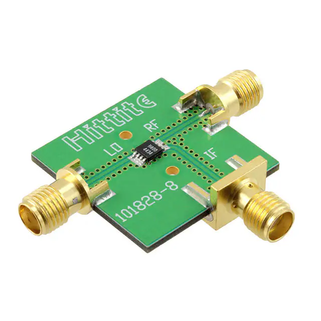

    EVAL BOARD HMC400MS8E
101830-HMC400MS8 数据手册
HMC400MS8 / 400MS8E v02.0705 HIGH IP3 GaAs MMIC MIXER, 1.7 - 2.2 GHz Typical Applications Features High Dynamic Range Infrastructure: Input IP3: +35 dBm • GSM, GPRS & EDGE Conversion Loss: 8.8 dB • CDMA & W-CDMA No External Components • Cable Modem Termination Systems Ultra Small MSOP Package: 14.8mm2 Included in the HMC-DK003 Designer’s Kit TE Functional Diagram General Description B SO LE The HMC400MS8(E) is a high dynamic range passive MMIC mixers in plastic surface mount 8 lead Mini Small Outline Packages (MSOP) covering 1.7 to 2.2 GHz. Excellent input IP3 performance of +36 dBm for down conversion and +29 dBm for up conversion is provided for 2.5G & 3G GSM/CDMA based UMTS or PCS applications at an LO drive of +17 dBm. With a 1 dB compression of +21 dBm, the RF port will accept a wide range of input signal levels. Conversion loss is 8.5dB typical and LO isolations are maintained at 22 to 33 dB. This miniature single-ended monolithic GaAs FET mixer does not require any external components or bias. The 50 to 300 MHz IF frequency response will satisfy many UMTS/PCS transmit or receive frequency plans configured for low side LO. The HMC400MS8(E) input IP3 performance coupled with its high P1dB rivals traditional active FET mixers while offering a much smaller 14.8mm2 standard IC footprint and no DC bias. O MIXERS - HIGH IP3 - SMT 9 Electrical Specifi cations, TA = +25°C, LO = +17 dBm, IF = 200 MHz* Parameter Min. Typ. Max. Min. Typ. Max. Min. Typ. Max. Units Frequency Range, RF 1.7 - 1.8 1.8 - 2.0 2.0 - 2.2 GHz Frequency Range, LO 1.4 - 1.75 1.5 - 1.95 1.7 - 2.15 GHz Frequency Range, IF DC - 300 DC - 300 DC - 300 MHz Conversion Loss 9 11 8.8 10.5 8.8 10.5 dB Noise Figure (SSB) 9 11 8.8 10.5 8.8 10.5 dB LO to RF Isolation 29 33 24 30 20 25 dB LO to IF Isolation 16 20 17 22 19 25 dB IP3 (Input) 30 34 32 36 28 32 dBm 1 dB Gain Compression (Input) 18 21 18 21 18 22 dBm +16 to +18 dBm LO Input Drive Level (Typical) +16 to +18 +16 to +18 *Unless otherwise noted, all measurements performed as a downconverter, with low side LO & IF = 200 MHz. 9 - 238 For price, delivery, and to placeCorporation: orders: Analog Devices, Inc., For price, delivery, and to place orders, please contact Hittite Microwave One Technology Way, P.O. Box 9106, Norwood, MA 02062-9106 20 Alpha Road, Chelmsford, MA 01824 Phone: Phone: 978-250-3343 978-250-3373 781-329-4700Fax: • Order online at www.analog.com Application Support: Phone: 1-800-ANALOG-D Order On-line at www.hittite.com Information furnished by Analog Devices is believed to be accurate and reliable. However, no responsibility is assumed by Analog Devices for its use, nor for any infringements of patents or other rights of third parties that may result from its use. Specifications subject to change without notice. No license is granted by implication or otherwise under any patent or patent rights of Analog Devices. Trademarks and registered trademarks are the property of their respective owners. HMC400MS8 / 400MS8E v02.0705 HIGH IP3 GaAs MMIC MIXER, 1.7 - 2.2 GHz Isolation @ LO = +17 dBm 0 -5 -10 + 25C + 85C - 40C -15 -40 1.8 1.9 2 2.1 RF FREQUENCY (GHz) 2.2 1.7 2.3 1.8 1.9 2 2.1 FREQUENCY (GHz) 2.2 2.3 2.2 2.3 LE 1.7 Return Loss @ LO = +17 dBm Conversion Gain vs. LO Drive 0 0 -5 -5 -10 B SO CONVERSION GAIN (dB) 9 -30 -20 LO = +15 dBm LO = +16 dBm LO = +17 dBm LO = +19 dBm -15 -20 1.7 1.8 1.9 2 2.1 RF FREQUENCY (GHz) 2.2 -10 -15 RF LO -20 -25 -30 1.7 2.3 Upconverter Performance Conversion Gain @ LO = +17 dBm 1.8 1.9 2 2.1 RF FREQUENCY (GHz) If Bandwidth @ LO = +17 dBm O 0 0 -5 -5 RESPONSE (dB) CONVERSION GAIN (dB) -20 TE -10 RF TO IF LO TO RF LO TO IF MIXERS - HIGH IP3 - SMT ISOLATION (dB) 0 RETURN LOSS (dB) CONVERSION GAIN (dB) Conversion Gain vs. Temperature @ LO = +17 dBm -10 -15 -10 CONVERSION GAIN RETURN LOSS -15 -20 -20 1.7 1.8 1.9 2 2.1 RF FREQUENCY (GHz) 2.2 2.3 50 100 150 200 250 300 350 IF FREQUENCY (MHz) 400 450 500 *Unless otherwise noted, all measurements performed as a downconverter, with low side LO & IF = 200 MHz. For price, delivery, and to placeCorporation: orders: Analog Devices, Inc., For price, delivery, and to place orders, please contact Hittite Microwave One Technology Way, P.O. Box 9106, Norwood, MA 02062-9106 20 Alpha Road, Chelmsford, MA 01824 Phone: Phone: 978-250-3343 978-250-3373 781-329-4700Fax: • Order online at www.analog.com Application Support: Phone: 1-800-ANALOG-D Order On-line at www.hittite.com Information furnished by Analog Devices is believed to be accurate and reliable. However, no responsibility is assumed by Analog Devices for its use, nor for any infringements of patents or other rights of third parties that may result from its use. Specifications subject to change without notice. No license is granted by implication or otherwise under any patent or patent rights of Analog Devices. Trademarks and registered trademarks are the property of their respective owners. 9 - 239 HMC400MS8 / 400MS8E v02.0705 HIGH IP3 GaAs MMIC MIXER, 1.7 - 2.2 GHz Input IP3 vs. Temperature, LO = +17 dBm 40 35 35 INPUT IP3 (dBm) 40 30 + 25C + 85C - 40C 25 20 20 90 120 150 180 210 240 IF FREQUENCY (MHz) Input IP3 vs. IF Frequency, RF = 1.95 GHz 40 270 300 1.7 1.8 1.9 2 2.1 RF FREQUENCY (GHz) 2.2 2.3 2.2 2.3 2.2 2.3 LE 60 Input IP3 vs. LO Drive 40 30 LO = +15 dBm LO = +16 dBm LO = +17 dBm LO = +19 dBm 25 20 60 90 120 150 180 210 240 IF FREQUENCY (MHz) 270 INPUT IP3 (dBm) 35 B SO 35 30 20 1.7 1.8 1.9 2 2.1 RF FREQUENCY (GHz) O Upconverter IP3 vs. LO Drive, IF = 200 MHz 40 35 35 INPUT IP3 (dBm) 40 30 LO = +15dBm LO = +16dBm LO = +17dBm LO = +19dBm 25 + 15dBm + 16dBm + 17dBm + 19dBm 25 300 Input IP3 vs. IF Frequency, RF = 2.15 GHz INPUT IP3 (dBm) 30 TE LO = +15dBm LO = +16dBm LO = +17dBm LO = +19dBm 25 INPUT IP3 (dBm) MIXERS - HIGH IP3 - SMT 9 INPUT IP3 (dBm) Input IP3 vs. IF Frequency, RF = 1.75 GHz LO = +15 dBm LO = +16 dBm LO = +17 dBm LO = +19 dBm 30 25 20 20 60 90 120 150 180 210 240 IF FREQUENCY (MHz) 270 300 1.7 1.8 1.9 2 2.1 RF FREQUENCY (GHz) *Unless otherwise noted, all measurements performed as a downconverter, with low side LO & IF = 200 MHz. 9 - 240 For price, delivery, and to placeCorporation: orders: Analog Devices, Inc., For price, delivery, and to place orders, please contact Hittite Microwave One Technology Way, P.O. Box 9106, Norwood, MA 02062-9106 20 Alpha Road, Chelmsford, MA 01824 Phone: Phone: 978-250-3343 978-250-3373 781-329-4700Fax: • Order online at www.analog.com Application Support: Phone: 1-800-ANALOG-D Order On-line at www.hittite.com Information furnished by Analog Devices is believed to be accurate and reliable. However, no responsibility is assumed by Analog Devices for its use, nor for any infringements of patents or other rights of third parties that may result from its use. Specifications subject to change without notice. No license is granted by implication or otherwise under any patent or patent rights of Analog Devices. Trademarks and registered trademarks are the property of their respective owners. HMC400MS8 / 400MS8E v02.0705 HIGH IP3 GaAs MMIC MIXER, 1.7 - 2.2 GHz Input IP2 vs. LO Drive @ LO = +17 dBm 45 45 40 40 35 + 25C + 85C - 40C 25 20 1.8 1.9 2 2.1 RF FREQUENCY (GHz) 2.2 Input P1dB vs. Temperature @ LO = +17 dBm 17 15 1.7 B SO 23 19 1.7 + 25C + 85C - 40C 1.8 1.9 2 2.1 RF FREQUENCY (GHz) 2.2 1.9 2 2.1 RF FREQUENCY (GHz) 2.2 2.3 nLO mRF 0 1 2 3 4 0 xx -11 7 4 8 1 9 0 24 31 27 2 71 70 49 58 64 3 79 80 80 79 77 4 77 80 80 79 80 RF Freq = 2 GHz @ -10 dBm LO Freq = 1.8 GHz @ +17 dBm All values in dBc relative to the IF output power. 2.3 Absolute Maximum Ratings O Harmonics of LO nLO Spur @ RF Port LO Freq (GHz) 1.8 MxN Spurious Outputs 25 21 2.3 LE 1.7 INPUT P1dB (dBm) + 15 dBm + 16 dBm + 17 dBm + 19 dBm 25 20 9 30 TE 30 35 MIXERS - HIGH IP3 - SMT INPUT IP2 (dBm) INPUT IP2 (dBm) Input IP2 vs. Temperature @ LO = +17 dBm 1 2 3 RF/IF Input +27 dBm 4 LO Drive +27 dBm 1.4 42 26 56 46 Storage Temperature -65 to +150 °C 1.55 33 25 56 53 Operating Temperature -40 to +85 °C 1.7 29 29 49 50 IF DC Current ±40 mA 1.85 26 31 44 53 2 24 36 44 48 2.15 21 38 43 49 ELECTROSTATIC SENSITIVE DEVICE OBSERVE HANDLING PRECAUTIONS LO = +17 dBm All values are in dBc below input LO level @ RF port. *Unless otherwise noted, all measurements performed as a downconverter, with low side LO & IF = 200 MHz. For price, delivery, and to placeCorporation: orders: Analog Devices, Inc., For price, delivery, and to place orders, please contact Hittite Microwave One Technology Way, P.O. Box 9106, Norwood, MA 02062-9106 20 Alpha Road, Chelmsford, MA 01824 Phone: Phone: 978-250-3343 978-250-3373 781-329-4700Fax: • Order online at www.analog.com Application Support: Phone: 1-800-ANALOG-D Order On-line at www.hittite.com Information furnished by Analog Devices is believed to be accurate and reliable. However, no responsibility is assumed by Analog Devices for its use, nor for any infringements of patents or other rights of third parties that may result from its use. Specifications subject to change without notice. No license is granted by implication or otherwise under any patent or patent rights of Analog Devices. Trademarks and registered trademarks are the property of their respective owners. 9 - 241 HMC400MS8 / 400MS8E v02.0705 HIGH IP3 GaAs MMIC MIXER, 1.7 - 2.2 GHz Outline Drawing TE LE NOTES: 1. LEADFRAME MATERIAL: COPPER ALLOY 2. DIMENSIONS ARE IN INCHES [MILLIMETERS] 3. DIMENSION DOES NOT INCLUDE MOLDFLASH OF 0.15mm PER SIDE. 4. DIMENSION DOES NOT INCLUDE MOLDFLASH OF 0.25mm PER SIDE. B SO 5. ALL GROUND LEADS MUST BE SOLDERED TO PCB RF GROUND. O MIXERS - HIGH IP3 - SMT 9 Package Information Part Number Package Body Material Lead Finish MSL Rating HMC400MS8 Low Stress Injection Molded Plastic Sn/Pb Solder MSL1 HMC400MS8E RoHS-compliant Low Stress Injection Molded Plastic 100% matte Sn MSL1 Package Marking [3] [1] H400 XXXX [2] H400 XXXX [1] Max peak reflow temperature of 235 °C [2] Max peak reflow temperature of 260 °C [3] 4-Digit lot number XXXX 9 - 242 For price, delivery, and to placeCorporation: orders: Analog Devices, Inc., For price, delivery, and to place orders, please contact Hittite Microwave One Technology Way, P.O. Box 9106, Norwood, MA 02062-9106 20 Alpha Road, Chelmsford, MA 01824 Phone: Phone: 978-250-3343 978-250-3373 781-329-4700Fax: • Order online at www.analog.com Application Support: Phone: 1-800-ANALOG-D Order On-line at www.hittite.com Information furnished by Analog Devices is believed to be accurate and reliable. However, no responsibility is assumed by Analog Devices for its use, nor for any infringements of patents or other rights of third parties that may result from its use. Specifications subject to change without notice. No license is granted by implication or otherwise under any patent or patent rights of Analog Devices. Trademarks and registered trademarks are the property of their respective owners. HMC400MS8 / 400MS8E v02.0705 HIGH IP3 GaAs MMIC MIXER, 1.7 - 2.2 GHz Pin Descriptions Description Interface Schematic 1 LO This pin is AC coupled & matched to 50 Ohms from 1.4 to 2.2 GHz. Blocking capacitors are required if line potential is not equal to 0V. 2, 4 N/C Not connected. 3, 6, 7 GND This pin must be connected to RF ground. 5 IF Port This pin is DC coupled. For applications not requiring operation to DC this port should be DC blocked externally using a series capacitor. Choose value of capacitor to pass IF frequency desired. For operation to DC, this pin must not sink/source more than 40 mA of current or failure may result. 8 RF Port This pin is DC coupled & matched to 50 Ohm from 1.7 to 2.2 GHz LE O B SO 9 MIXERS - HIGH IP3 - SMT Function TE Pin Number For price, delivery, and to placeCorporation: orders: Analog Devices, Inc., For price, delivery, and to place orders, please contact Hittite Microwave One Technology Way, P.O. Box 9106, Norwood, MA 02062-9106 20 Alpha Road, Chelmsford, MA 01824 Phone: Phone: 978-250-3343 978-250-3373 781-329-4700Fax: • Order online at www.analog.com Application Support: Phone: 1-800-ANALOG-D Order On-line at www.hittite.com Information furnished by Analog Devices is believed to be accurate and reliable. However, no responsibility is assumed by Analog Devices for its use, nor for any infringements of patents or other rights of third parties that may result from its use. Specifications subject to change without notice. No license is granted by implication or otherwise under any patent or patent rights of Analog Devices. Trademarks and registered trademarks are the property of their respective owners. 9 - 243 HMC400MS8 / 400MS8E v02.0705 HIGH IP3 GaAs MMIC MIXER, 1.7 - 2.2 GHz Evaluation PCB B SO LE MIXERS - HIGH IP3 - SMT TE 9 O List of Materials for Evaluation PCB 101830 [1] Item Description J1 - J3 PCB Mount SMA RF Connector U1 HMC400MS8 / HMC400MS8E Mixer PCB [2] 101828 Eval Board [1] Reference this number when ordering complete evaluation PCB [2] Circuit Board Material: Rogers 4350 9 - 244 The circuit board used in the final application should use RF circuit design techniques. Signal lines should have 50 ohm impedance while the package ground leads and exposed paddle should be connected directly to the ground plane similar to that shown. A sufficient number of via holes should be used to connect the top and bottom ground planes. The evaluation circuit board shown is available from Hittite upon request. For price, delivery, and to placeCorporation: orders: Analog Devices, Inc., For price, delivery, and to place orders, please contact Hittite Microwave One Technology Way, P.O. Box 9106, Norwood, MA 02062-9106 20 Alpha Road, Chelmsford, MA 01824 Phone: Phone: 978-250-3343 978-250-3373 781-329-4700Fax: • Order online at www.analog.com Application Support: Phone: 1-800-ANALOG-D Order On-line at www.hittite.com Information furnished by Analog Devices is believed to be accurate and reliable. However, no responsibility is assumed by Analog Devices for its use, nor for any infringements of patents or other rights of third parties that may result from its use. Specifications subject to change without notice. No license is granted by implication or otherwise under any patent or patent rights of Analog Devices. Trademarks and registered trademarks are the property of their respective owners. HMC400MS8 / 400MS8E v02.0705 HIGH IP3 GaAs MMIC MIXER, 1.7 - 2.2 GHz MIXERS - HIGH IP3 - SMT 9 O B SO LE TE Notes: For price, delivery, and to placeCorporation: orders: Analog Devices, Inc., For price, delivery, and to place orders, please contact Hittite Microwave One Technology Way, P.O. Box 9106, Norwood, MA 02062-9106 20 Alpha Road, Chelmsford, MA 01824 Phone: Phone: 978-250-3343 978-250-3373 781-329-4700Fax: • Order online at www.analog.com Application Support: Phone: 1-800-ANALOG-D Order On-line at www.hittite.com Information furnished by Analog Devices is believed to be accurate and reliable. However, no responsibility is assumed by Analog Devices for its use, nor for any infringements of patents or other rights of third parties that may result from its use. Specifications subject to change without notice. No license is granted by implication or otherwise under any patent or patent rights of Analog Devices. Trademarks and registered trademarks are the property of their respective owners. 9 - 245
