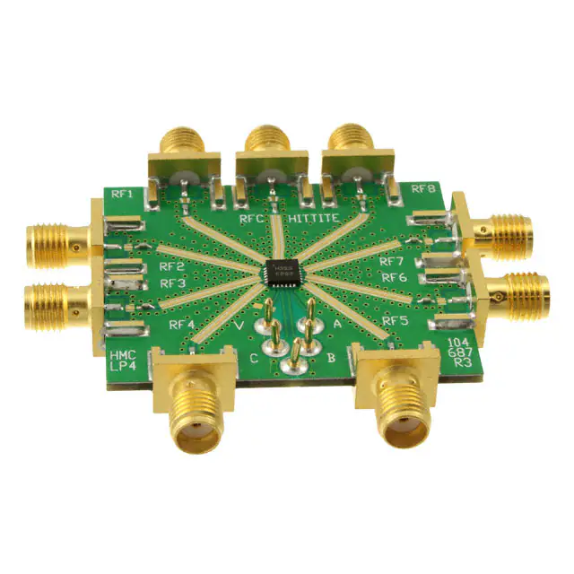

    EVAL BOARD HMC322LP4E
107780-HMC322LP4 数据手册
HMC322LP4 / 322LP4E v06.0112 Switches - Multi-Throw - SMT GaAs MMIC SP8T NON-REFLECTIVE SWITCH, DC - 8 GHz Typical Applications Features This switch is suitable for usage in DC - 8.0 GHz 50Ohm or 75-Ohm systems: Broadband Performance: DC - 8.0 GHz High Isolation: >30 dB@ 6 GHz • Broadband Low Insertion Loss: 2.4 dB@ 6 GHz • Fiber Optics Integrated 3:8 TTL Decoder • Switched Filter Banks 24 Lead 4x4mm QFN Package: 9 mm² • Wireless below 8 GHz General Description Functional Diagram The HMC322LP4 & HMC322LP4E are broadband non-reflective GaAs MESFET SP8T switches in low cost leadless surface mount packages. Covering DC to 8 GHz, this switch offers high isolation and low insertion loss. This switch also includes an on board binary decoder circuit which reduces the required logic control lines to three. The switch operates using a negative control voltage of 0/-5 volts, and requires a fixed bias of -5V. This switch is suitable for usage in 50-Ohm or 75-Ohm systems. Electrical Specifications, TA = +25° C, With 0/-5V Control, 50 Ohm System Parameter 1 Frequency Min. Typ. Max. Units 2.1 2.3 2.5 2.5 2.7 2.9 dB dB dB Insertion Loss DC - 2.0 GHz DC - 4.0 GHz DC - 8.0 GHz Isolation DC - 2.0 GHz DC - 4.0 GHz DC - 6.0 GHz DC - 8.0 GHz 35 30 25 20 40 35 30 25 dB dB dB dB Return Loss “On State” DC - 2.0 GHz DC - 8.0 GHz 9 6 12 10 dB dB Return Loss “Off State” DC - 8.0 GHz 7 10 dB Input Power for 1 dB Compression 0.5 - 8.0 GHz 19 23 dBm Input Third Order Intercept (Two-Tone Input Power = +7 dBm Each Tone) 0.5 - 8.0 GHz 36 40 dBm Switching Characteristics tRISE, tFALL (10/90% RF) tON, tOFF (50% CTL to 10/90% RF) DC - 8.0 GHz 50 150 ns ns Information furnished by Analog Devices is believed to be accurate and reliable. However, no For price, 2delivery, and to placeChelmsford, orders: Analog MA Devices, Inc., For price, delivery and to place orders: Microwave Corporation, Elizabeth Drive, 01824 responsibility is assumed by Analog Devices for its use, nor for anyHittite infringements of patents or other One Technology Way, P.O. Box 9106, Norwood, MA 02062-9106 rights of third parties that may result from its use. Specifications subject to change without notice. No Phone: 978-250-3343 Fax: 978-250-3373 Phone: Order781-329-4700 On-line at www.hittite.com • Order online at www.analog.com license is granted by implication or otherwise under any patent or patent rights of Analog Devices. Application Support: Phone: 1-800-ANALOG-D Trademarks and registered trademarks are the property of their respective owners. Application Support: Phone: 978-250-3343 or apps@hittite.com HMC322LP4 / 322LP4E v06.0112 GaAs MMIC SP8T NON-REFLECTIVE SWITCH, DC - 8 GHz Insertion Loss vs. Temperature Isolation ISOLATION (dB) INSERTION LOSS (dB) RF1 RF2 RF3 RF4 RF5 RF6 RF7 RF8 -10 -1 -2 -3 +25 C -40 C +85 C -4 -20 -30 -40 -50 -60 -70 -5 0 1 2 3 4 5 6 7 8 0 9 1 2 3 Return Loss 5 6 7 8 9 0.1 and 1 dB Input Compression Point 0 INPUT COMPRESSION POINT (dBm) 30 -5 RETURN LOSS (dB) 4 FREQUENCY (GHz) FREQUENCY (GHz) -10 -15 RFC RF1-8 ON RF1-8 OFF -20 -25 25 20 0.1dB Compression Point 1dB Compression Point 15 Switches - Multi-Throw - SMT 0 0 10 0 1 2 3 4 5 6 7 8 9 0 1 2 3 FREQUENCY (GHz) 4 5 6 7 8 FREQUENCY (GHz) INPUT THIRD ORDER INTERCEPT (dBm) Input Third Order Intercept Point 50 45 40 35 30 1 2 3 4 5 6 7 8 FREQUENCY (GHz) Information furnished by Analog Devices is believed to be accurate and reliable. However, no For price, 2delivery, and to placeChelmsford, orders: Analog MA Devices, Inc., For price, delivery and to place orders: Microwave Corporation, Elizabeth Drive, 01824 responsibility is assumed by Analog Devices for its use, nor for anyHittite infringements of patents or other One Technology Way, P.O. Box 9106, Norwood, MA 02062-9106 rights of third parties that may result from its use. Specifications subject to change without notice. No Phone: 978-250-3343 Fax: 978-250-3373 Phone: Order781-329-4700 On-line at www.hittite.com • Order online at www.analog.com license is granted by implication or otherwise under any patent or patent rights of Analog Devices. Application Support: Phone: 1-800-ANALOG-D Trademarks and registered trademarks are the property of their respective owners. Application Support: Phone: 978-250-3343 or apps@hittite.com 2 HMC322LP4 / 322LP4E v06.0112 GaAs MMIC SP8T NON-REFLECTIVE SWITCH, DC - 8 GHz Bias Voltage & Current Truth Table Switches - Multi-Throw - SMT Vee Range = -5.0 Vdc ± 10% Control Input Vee (Vdc) Iee (Typ.) (mA) Iee (Max.) (mA) -5.0 5.0 9.0 Signal Path State A B C High High High RFCOM to: RF1 Low High High RF2 High Low High RF3 Low Low High RF4 High High Low RF5 Bias Condition Low High Low RF6 Low -3V to 0 Vdc @ 25 µA Typical High Low Low RF7 High -5 to -4.2 Vdc @ 5 µA Typical Low Low Low RF8 Control Voltages State TTL Interface Circuit Note: Control inputs A, B, and C can be driven directly with TTL logic with -5 Volts applied to the HCT logic gates Vee pin and to Vee (pin 8) of the RF Switch. 3 Information furnished by Analog Devices is believed to be accurate and reliable. However, no For price, 2delivery, and to placeChelmsford, orders: Analog MA Devices, Inc., For price, delivery and to place orders: Microwave Corporation, Elizabeth Drive, 01824 responsibility is assumed by Analog Devices for its use, nor for anyHittite infringements of patents or other One Technology Way, P.O. Box 9106, Norwood, MA 02062-9106 rights of third parties that may result from its use. Specifications subject to change without notice. No Phone: 978-250-3343 Fax: 978-250-3373 Phone: Order781-329-4700 On-line at www.hittite.com • Order online at www.analog.com license is granted by implication or otherwise under any patent or patent rights of Analog Devices. Application Support: Phone: 1-800-ANALOG-D Trademarks and registered trademarks are the property of their respective owners. Application Support: Phone: 978-250-3343 or apps@hittite.com HMC322LP4 / 322LP4E v06.0112 GaAs MMIC SP8T NON-REFLECTIVE SWITCH, DC - 8 GHz Bias Voltage Range (Vee) -7.0 Vdc Control Voltage Range (A, B, & C) Vee -0.5V to +1.0 Vdc Storage Temperature -65 to +150 °C Operating Temperature -40 to +85 °C Maximum Input Power 26 dBm Channel Temperature 150 ° C Continuous Pdiss ( T = 85 ° C ) ( derate 5.34 mW / ° C ) 0.348 W Thermal Resistance 187 ° C / W ESD Sensitivity (HBM) Class 1B ELECTROSTATIC SENSITIVE DEVICE OBSERVE HANDLING PRECAUTIONS Outline Drawing Switches - Multi-Throw - SMT Absolute Maximum Ratings NOTES: 1. LEADFRAME MATERIAL: COPPER ALLOY 2. DIMENSIONS ARE IN INCHES [MILLIMETERS] 3. LEAD SPACING TOLERANCE IS NON-CUMULATIVE. 4. PAD BURR LENGTH SHALL BE 0.15mm MAXIMUM. PAD BURR HEIGHT SHALL BE 0.05mm MAXIMUM. 5. PACKAGE WARP SHALL NOT EXCEED 0.05mm. 6. ALL GROUND LEADS AND GROUND PADDLE MUST BE SOLDERED TO PCB RF GROUND. 7. REFER TO HITTITE APPLICATION NOTE FOR SUGGESTED LAND PATTERN. Package Information Part Number Package Body Material Lead Finish MSL Rating HMC322LP4 Low Stress Injection Molded Plastic Sn/Pb Solder MSL1 [1] HMC322LP4E RoHS-compliant Low Stress Injection Molded Plastic 100% matte Sn MSL1 [2] Package Marking [3] H322 XXXX H322 XXXX [1] Max peak reflow temperature of 235 °C [2] Max peak reflow temperature of 260 °C [3] 4-Digit lot number XXXX Information furnished by Analog Devices is believed to be accurate and reliable. However, no For price, 2delivery, and to placeChelmsford, orders: Analog MA Devices, Inc., For price, delivery and to place orders: Microwave Corporation, Elizabeth Drive, 01824 responsibility is assumed by Analog Devices for its use, nor for anyHittite infringements of patents or other One Technology Way, P.O. Box 9106, Norwood, MA 02062-9106 rights of third parties that may result from its use. Specifications subject to change without notice. No Phone: 978-250-3343 Fax: 978-250-3373 Phone: Order781-329-4700 On-line at www.hittite.com • Order online at www.analog.com license is granted by implication or otherwise under any patent or patent rights of Analog Devices. Application Support: Phone: 1-800-ANALOG-D Trademarks and registered trademarks are the property of their respective owners. Application Support: Phone: 978-250-3343 or apps@hittite.com 4 HMC322LP4 / 322LP4E v06.0112 GaAs MMIC SP8T NON-REFLECTIVE SWITCH, DC - 8 GHz Switches - Multi-Throw - SMT Pin Descriptions 5 Pin Number Function Description 1, 3, 5, 7, 12, 14, 16, 18, 21, 23 GND Package bottom has exposed metal paddle that must also be connected to PCB RF ground. 2, 4, 6, 13, 15, 17, 19, 22, 24 RF1 - RF8 & RFC This pin is DC coupled and matched to 50 Ohm. Blocking capacitors are required if RF line potential is not equal to 0V. 8 VEE Supply Voltage = -5V ± 10% 9 CTLC See truth table and control voltage table. 10 CTLB See truth table and control voltage table. 11 CTLA See truth table and control voltage table. 20 N/C This pin should be connected to PCB RF ground to maximize isolation. Interface Schematic Information furnished by Analog Devices is believed to be accurate and reliable. However, no For price, 2delivery, and to placeChelmsford, orders: Analog MA Devices, Inc., For price, delivery and to place orders: Microwave Corporation, Elizabeth Drive, 01824 responsibility is assumed by Analog Devices for its use, nor for anyHittite infringements of patents or other One Technology Way, P.O. Box 9106, Norwood, MA 02062-9106 rights of third parties that may result from its use. Specifications subject to change without notice. No Phone: 978-250-3343 Fax: 978-250-3373 Phone: Order781-329-4700 On-line at www.hittite.com • Order online at www.analog.com license is granted by implication or otherwise under any patent or patent rights of Analog Devices. Application Support: Phone: 1-800-ANALOG-D Trademarks and registered trademarks are the property of their respective owners. Application Support: Phone: 978-250-3343 or apps@hittite.com HMC322LP4 / 322LP4E v06.0112 GaAs MMIC SP8T NON-REFLECTIVE SWITCH, DC - 8 GHz Switches - Multi-Throw - SMT Evaluation PCB List of Materials for Evaluation PCB 107780 [1] Item Description J1 - J9 PCB Mount SMA RF Connector J10 - J14 DC Pin C1 - C9 100 pF Capacitor, 0402 Pkg. U1 HMC322LP4 / HMC322LP4E SP8T Switch PCB [2] 104687 Evaluation PCB 1.73”x1.46” [1] Reference this number when ordering complete evaluation PCB [2] Circuit Board Material: Rogers 4350 The circuit board used in the application should be generated with proper RF circuit design techniques. Signal lines at the RF port should have 50 ohm impedance and the package ground leads and backside ground slug should be connected directly to the ground plane similar to that shown above. The evaluation circuit board shown above is available from Hittite Microwave Corporation upon request. Information furnished by Analog Devices is believed to be accurate and reliable. However, no For price, 2delivery, and to placeChelmsford, orders: Analog MA Devices, Inc., For price, delivery and to place orders: Microwave Corporation, Elizabeth Drive, 01824 responsibility is assumed by Analog Devices for its use, nor for anyHittite infringements of patents or other One Technology Way, P.O. Box 9106, Norwood, MA 02062-9106 rights of third parties that may result from its use. Specifications subject to change without notice. No Phone: 978-250-3343 Fax: 978-250-3373 Phone: Order781-329-4700 On-line at www.hittite.com • Order online at www.analog.com license is granted by implication or otherwise under any patent or patent rights of Analog Devices. Application Support: Phone: 1-800-ANALOG-D Trademarks and registered trademarks are the property of their respective owners. Application Support: Phone: 978-250-3343 or apps@hittite.com 6
