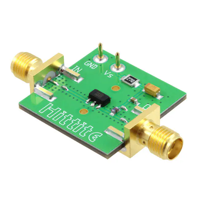

    BOARD EVAL HMC482ST89E
109026-HMC482ST89 数据手册
HMC482ST89 / 482ST89E v04.0710 Typical Applications Features The HMC482ST89 / HMC482ST89E is an ideal RF/IF gain block & LO or PA driver for: P1dB Output Power: +22 dBm • Cellular / PCS / 3G Output IP3: +36 dBm • Fixed Wireless, WLAN & WiMAX Cascadable 50 Ohm I/Os • CATV, Cable Modem & DBS Single Supply: +6V to +12V • Microwave Radio & Test Equipment Industry Standard SOT89 Package TE Gain: 20 dB Included in the HMC-DK001 Designer’s Kit Functional Diagram General Description B SO LE The HMC482ST89 & HMC482ST89E are SiGe Heterojunction Bipolar Transistor (HBT) Gain Block MMIC SMT amplifiers covering DC to 5 GHz. Packaged in an industry standard SOT89, the amplifier can be used as a cascadable 50 Ohm RF/IF gain stage as well as a LO or PA driver with up to +24 dBm output power. The Darlington feedback pair results in reduced sensitivity to normal process variations and excellent gain stability over temperature while requiring a minimal number of external bias components. Electrical Specifi cations, Vs= 8.0 V, Rbias= 27 Ohm, TA = +25° C Parameter Gain Gain Variation Over Temperature Input Return Loss O AMPLIFIERS - DRIVER & GAIN BLOCK - SMT 8 SiGe HBT GAIN BLOCK MMIC AMPLIFIER, DC - 5 GHz Output Return Loss Reverse Isolation Output Power for 1 dB Compression (P1dB) Output Third Order Intercept (IP3) (Pout= 0 dBm per tone, 1 MHz spacing) Noise Figure Supply Current (Icq) DC - 1.0 GHz 1.0 - 2.0 GHz 2.0 - 3.0 GHz 3.0 - 4.0 GHz 4.0 - 5.0 GHz DC - 5 GHz DC - 1.0 GHz 1.0 - 5.0 GHz DC - 1.0 GHz 1.0 - 3.0 GHz 3.0 - 4.0 GHz 4.0 - 5.0 GHz DC - 5 GHz 0.5 - 1.0 GHz 1.0 - 2.0 GHz 2.0 - 3.0 GHz 3.0 - 4.0 GHz 4.0 - 5.0 GHz 0.5 - 1.0 GHz 1.0 - 2.0 GHz 2.0 - 3.0 GHz 3.0 - 4.0 GHz 4.0 - 5.0 GHz DC - 2.0 GHz 2.0 - 4.0 GHz 4.0 - 5.0 GHz Min. Typ. 17 15 12.5 10 8 19 17 14.5 12 10 0.008 15 18 20 14 12 8 16 22.5 20 17.5 15.5 13.5 36 35 32 30 28 4 5 5.5 110 19.5 17 14.5 12.5 10.5 Max. 0.016 Units dB dB dB dB dB dB/ °C dB dB dB dB dB dB dB dBm dBm dBm dBm dBm dBm dBm dBm dBm dBm dB dB dB mA Note: Data taken with broadband bias tee on device output. 8 - 140 Information furnished by Analog Devices is believed to be accurate and reliable. However, no For price, delivery, andRoad, to place orders: Analog Devices, For price, delivery and to for place Hittite Microwave Corporation, 20 Alpha Chelmsford, MA 01824Inc., responsibility is assumed by Analog Devices its use,orders: nor for any infringements of patents or other One Technology Way, P.O. Box 9106, Norwood, MA 02062-9106 rights of third parties that may result from its use. Specifications subject to change without notice. No Phone: 978-250-3343 Fax: 978-250-3373 Phone: Order781-329-4700 On-line at www.hittite.com • Order online at www.analog.com license is granted by implication or otherwise under any patent or patent rights of Analog Devices. Application Support: Phone: 1-800-ANALOG-D Trademarks and registered trademarks are the property of their respective owners. Application Support: Phone: 978-250-3343 or apps@hittite.com HMC482ST89 / 482ST89E v04.0710 SiGe HBT GAIN BLOCK MMIC AMPLIFIER, DC - 5 GHz Broadband Gain & Return Loss Gain vs. Temperature 8 24 25 20 20 GAIN (dB) 5 S21 S11 S22 0 -5 -10 12 +25C +85C -40C TE 8 -15 -20 4 -25 0 -30 0 1 2 3 4 5 6 7 0 8 1 2 4 5 6 LE Output Return Loss vs. Temperature Input Return Loss vs. Temperature 0 0 -5 +25C +85C -40C -15 -20 -25 0 B SO -10 -30 1 2 3 4 5 -10 -20 +25C +85C -40C -30 -40 0 6 1 2 O Reverse Isolation vs. Temperature 4 5 6 Noise Figure vs. Temperature 10 0 -5 +25C +85C -40C 8 NOISE FIGURE (dB) -10 3 FREQUENCY (GHz) FREQUENCY (GHz) REVERSE ISOLATION (dB) 3 FREQUENCY (GHz) FREQUENCY (GHz) INPUT RETURN LOSS (dB) 16 +25C +85C -40C -15 -20 AMPLIFIERS - DRIVER & GAIN BLOCK - SMT 10 RETURN LOSS (dB) RESPONSE (dB) 15 6 4 2 -25 0 -30 0 1 2 3 4 FREQUENCY (GHz) 5 6 0 1 2 3 4 5 FREQUENCY (GHz) Information furnished by Analog Devices is believed to be accurate and reliable. However, no For price, delivery, andRoad, to place orders: Analog Devices, For price, delivery and to for place Hittite Microwave Corporation, 20 Alpha Chelmsford, MA 01824Inc., responsibility is assumed by Analog Devices its use,orders: nor for any infringements of patents or other One Technology Way, P.O. Box 9106, Norwood, MA 02062-9106 rights of third parties that may result from its use. Specifications subject to change without notice. No Phone: 978-250-3343 Fax: 978-250-3373 Phone: Order781-329-4700 On-line at www.hittite.com • Order online at www.analog.com license is granted by implication or otherwise under any patent or patent rights of Analog Devices. Application Support: Phone: 1-800-ANALOG-D Trademarks and registered trademarks are the property of their respective owners. Application Support: Phone: 978-250-3343 or apps@hittite.com 8 - 141 HMC482ST89 / 482ST89E v04.0710 SiGe HBT GAIN BLOCK MMIC AMPLIFIER, DC - 5 GHz P1dB vs. Temperature 8 30 +25C +85C -40C Psat (dBm) 26 22 14 18 +25C +85C -40C 14 10 10 0 1 2 3 4 5 0 38 36 B SO 34 28 +25C +85C -40C 26 24 0 0.5 1 1.5 2 2.5 3 3 4 5 Gain, Power & OIP3 vs. Supply Voltage for Constant Icc= 110 mA @ 850 MHz 40 30 2 FREQUENCY (GHz) Output IP3 vs. Temperature 32 1 LE FREQUENCY (GHz) IP3 (dBm) 22 TE 18 3.5 4 4.5 5 Gain (dB), P1dB (dBm), Psat (dBm), IP3 (dBm) P1dB (dBm) 26 40 32 24 16 Gain P1dB Psat IP3 8 0 6 7 8 FREQUENCY (GHz) 9 10 11 12 Vs (Vdc) Vcc vs. Icc Over Temperature for Fixed Vs= 8V, RBIAS= 27 Ohms O 128 126 +85C 124 122 Icc (mA) AMPLIFIERS - DRIVER & GAIN BLOCK - SMT Psat vs. Temperature 30 +25C 120 118 116 114 112 -40C 110 108 4.6 4.7 4.8 4.9 5 5.1 5.2 Vcc (Vdc) 8 - 142 Information furnished by Analog Devices is believed to be accurate and reliable. However, no For price, delivery, andRoad, to place orders: Analog Devices, For price, delivery and to for place Hittite Microwave Corporation, 20 Alpha Chelmsford, MA 01824Inc., responsibility is assumed by Analog Devices its use,orders: nor for any infringements of patents or other One Technology Way, P.O. Box 9106, Norwood, MA 02062-9106 rights of third parties that may result from its use. Specifications subject to change without notice. No Phone: 978-250-3343 Fax: 978-250-3373 Phone: Order781-329-4700 On-line at www.hittite.com • Order online at www.analog.com license is granted by implication or otherwise under any patent or patent rights of Analog Devices. Application Support: Phone: 1-800-ANALOG-D Trademarks and registered trademarks are the property of their respective owners. Application Support: Phone: 978-250-3343 or apps@hittite.com HMC482ST89 / 482ST89E v04.0710 SiGe HBT GAIN BLOCK MMIC AMPLIFIER, DC - 5 GHz Absolute Maximum Ratings +6.0 Vdc RF Input Power (RFIN)(Vcc = +5 Vdc) +14 dBm Junction Temperature 150 °C Continuous Pdiss (T = 85 °C) (derate 14.5 mW/°C above 85 °C) 0.94 W Thermal Resistance (junction to lead) 69 °C/W Storage Temperature -65 to +150 °C Operating Temperature -40 to +85 °C ESD Sensitivity (HBM) Class 1A LE TE ELECTROSTATIC SENSITIVE DEVICE OBSERVE HANDLING PRECAUTIONS B SO Outline Drawing NOTES: 1. PACKAGE BODY MATERIAL: MOLDING COMPOUND MP-180S OR EQUIVALENT. 2. LEAD MATERIAL: Cu w/ Ag SPOT PLATING. O 3. LEAD PLATING: 100% MATTE TIN. 4. DIMENSIONS ARE IN INCHES [MILLIMETERS] 5. DIMENSION DOES NOT INCLUDE MOLDFLASH OF 0.15mm PER SIDE. 6. DIMENSION DOES NOT INCLUDE MOLDFLASH OF 0.25mm PER SIDE. 8 AMPLIFIERS - DRIVER & GAIN BLOCK - SMT Collector Bias Voltage (Vcc) 7. ALL GROUND LEADS MUST BE SOLDERED TO PCB RF GROUND. Package Information Part Number Package Body Material Lead Finish MSL Rating HMC482ST89 Low Stress Injection Molded Plastic Sn/Pb Solder MSL1 HMC482ST89E RoHS-compliant Low Stress Injection Molded Plastic 100% matte Sn MSL1 Package Marking [3] [1] H482 XXXX [2] H482 XXXX [1] Max peak reflow temperature of 235 °C [2] Max peak reflow temperature of 260 °C [3] 4-Digit lot number XXXX Information furnished by Analog Devices is believed to be accurate and reliable. However, no For price, delivery, andRoad, to place orders: Analog Devices, For price, delivery and to for place Hittite Microwave Corporation, 20 Alpha Chelmsford, MA 01824Inc., responsibility is assumed by Analog Devices its use,orders: nor for any infringements of patents or other One Technology Way, P.O. Box 9106, Norwood, MA 02062-9106 rights of third parties that may result from its use. Specifications subject to change without notice. No Phone: 978-250-3343 Fax: 978-250-3373 Phone: Order781-329-4700 On-line at www.hittite.com • Order online at www.analog.com license is granted by implication or otherwise under any patent or patent rights of Analog Devices. Application Support: Phone: 1-800-ANALOG-D Trademarks and registered trademarks are the property of their respective owners. Application Support: Phone: 978-250-3343 or apps@hittite.com 8 - 143 HMC482ST89 / 482ST89E v04.0710 SiGe HBT GAIN BLOCK MMIC AMPLIFIER, DC - 5 GHz Pin Descriptions Function Description Interface Schematic 1 RFIN This pin is DC coupled. An off chip DC blocking capacitor is required. 3 RFOUT RF output and DC Bias (Vcc) for the output stage. 2, 4 GND These pins and package bottom must be connected to RF/ DC ground. LE TE Pin Number B SO Application Circuit O AMPLIFIERS - DRIVER & GAIN BLOCK - SMT 8 Recommended Bias Resistor Values for Icc= 110 mA, Rbias= (Vs - Vcc) / Icc Supply Voltage (Vs) 6V 8V 10V 12V RBIAS VALUE 9.1 Ω 27 Ω 47 Ω 62 Ω RBIAS POWER RATING 1/4 W 1/2 W 1W 1.5 W Note: 1. External blocking capacitors are required on RFIN and RFOUT. 2. RBIAS provides DC bias stability over temperature. Recommended Component Values for Key Application Frequencies Frequency (MHz) Component 8 - 144 50 900 1900 2200 2400 3500 5000 L1 270 nH 56 nH 18 nH 18 nH 15 nH 8.2 nH 6.8 nH C1, C2 0.01 μF 100 pF 100 pF 100 pF 100 pF 100 pF 100 pF Information furnished by Analog Devices is believed to be accurate and reliable. However, no For price, delivery, andRoad, to place orders: Analog Devices, For price, delivery and to for place Hittite Microwave Corporation, 20 Alpha Chelmsford, MA 01824Inc., responsibility is assumed by Analog Devices its use,orders: nor for any infringements of patents or other One Technology Way, P.O. Box 9106, Norwood, MA 02062-9106 rights of third parties that may result from its use. Specifications subject to change without notice. No Phone: 978-250-3343 Fax: 978-250-3373 Phone: Order781-329-4700 On-line at www.hittite.com • Order online at www.analog.com license is granted by implication or otherwise under any patent or patent rights of Analog Devices. Application Support: Phone: 1-800-ANALOG-D Trademarks and registered trademarks are the property of their respective owners. Application Support: Phone: 978-250-3343 or apps@hittite.com HMC482ST89 / 482ST89E v04.0710 SiGe HBT GAIN BLOCK MMIC AMPLIFIER, DC - 5 GHz Evaluation PCB O List of Materials for Evaluation PCB 109026 [1] Item Description J1 - J2 PCB Mount SMA Connector J3 - J4 DC Pin C1, C2 Capacitor, 0402 Pkg. C3 100 pF Capacitor, 0402 Pkg. C4 1000 pF Capacitor, 0603 Pkg. C5 2.2 μF Capacitor, Tantalum R1 Resistor, 1210 Pkg. L1 Inductor, 0603 Pkg. U1 HMC482ST89 / HMC482ST89E PCB [2] 107368 Evaluation PCB The circuit board used in the final application should use RF circuit design techniques. Signal lines should have 50 Ohm impedance while the package ground leads and package bottom should be connected directly to the ground plane similar to that shown. A sufficient number of via holes should be used to connect the top and bottom ground planes. The evaluation board should be mounted to an appropriate heat sink. The evaluation circuit board shown is available from Hittite upon request. AMPLIFIERS - DRIVER & GAIN BLOCK - SMT B SO LE TE 8 [1] Reference this number when ordering complete evaluation PCB [2] Circuit Board Material: Rogers 4350 Information furnished by Analog Devices is believed to be accurate and reliable. However, no For price, delivery, andRoad, to place orders: Analog Devices, For price, delivery and to for place Hittite Microwave Corporation, 20 Alpha Chelmsford, MA 01824Inc., responsibility is assumed by Analog Devices its use,orders: nor for any infringements of patents or other One Technology Way, P.O. Box 9106, Norwood, MA 02062-9106 rights of third parties that may result from its use. Specifications subject to change without notice. No Phone: 978-250-3343 Fax: 978-250-3373 Phone: Order781-329-4700 On-line at www.hittite.com • Order online at www.analog.com license is granted by implication or otherwise under any patent or patent rights of Analog Devices. Application Support: Phone: 1-800-ANALOG-D Trademarks and registered trademarks are the property of their respective owners. Application Support: Phone: 978-250-3343 or apps@hittite.com 8 - 145
