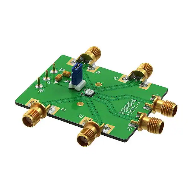

    HMC722LC3C - Logic Evaluation Board
118777-HMC722LC3C 数据手册
HMC722LC3C v04.0313 High Speed Digital Logic - SMT GATE, w/ PROGRAMMABLE OUTPUT VOLTAGE 13 Gbps, FAST RISE TIME AND/NAND/OR/NOR Typical Applications Features The HMC722LC3C is ideal for: Supports High Data Rates: up to 13 Gbps • RF ATE Applications Differential & Singe-Ended Operation • Broadband Test & Measurement Fast Rise and Fall Times: 19 / 18 ps • Serial Data Transmission up to 13 Gbps Low Power Consumption: 230 mW typ. • Digital Logic Systems up to 13 GHz Programmable Differential Output Voltage Swing: 600 - 1100 mV • NRZ-to-RZ Conversion Propagation Delay: 95 ps Single Supply: -3.3V 16 Lead Ceramic 3x3mm SMT Package: 9mm 2 Functional Diagram General Description The HMC722LC3C is an AND/NAND/OR/NOR function designed to support data transmission rates of up to 13 Gbps, and clock frequencies as high as 13 GHz. The HMC772LC3C may be easily configured to provide any of the following logic functions: AND, NAND, OR and NOR. The HMC722LC3C also features an output level control pin, VR, which allows for loss compensation or for signal level optimization. All input signals to the HMC722LC3C are terminated with 50 Ohms to ground on-chip, and may be either AC or DC coupled. The differential outputs of the HMC722LC3C may be either AC or DC coupled. Outputs can be connected directly to a 50 Ohm to ground terminated system, while DC blocking capacitors may be used if the terminating system is 50 Ohms to a nonground DC voltage. The HMC722LC3C operates from a single -3.3V DC supply, and is available in a ceramic RoHS compliant 3x3 mm SMT package. Electrical Specifications, TA = +25 °C, Vee = -3.3V Parameter Conditions Power Supply Voltage Min. Typ. Max -3.6 -3.3 -3.0 Power Supply Current V 70 mA Maximum Data Rate 13 Gbps Maximum Clock Rate 13 GHz Input High Voltage -0.5 0.5 Input Low Voltage -1.0 0.0 Input Return Loss Output Amplitude Output High Voltage 1 Units Frequency
