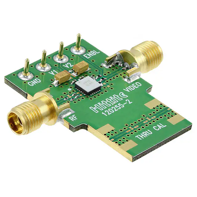

    EVAL BOARD HMC913LC4B
120257-HMC913LC4B 数据手册
HMC913LC4B v05.0614 SDLVAs - SMT SUCCESSIVE DETECTION LOG VIDEO AMPLIFIER (SDLVA), 0.6 - 20 GHz Typical Applications Features The HMC913LC4B is ideal for: • EW, ELINT & IFM Receivers High Logging Range: 59 dB (-54 to +5 dBm) @ 18 GHz • DF Radar Systems Output Frequency Flatness: ±2 dB • ECM Systems Log Linearity: ±1 dB • Broadband Test & Measurement Fast Rise/Fall Times: 5/10 ns • Power Measurement & Control Circuits Single Positive Supply: +3.3V • Military & Space Applications ESD Sensitivity (HBM): Class 1A 24 Lead 4x4mm SMT Package: 16mm2 Functional Diagram General Description The HMC913LC4B is a Successive Detection Log Video Amplifier (SDLVA) which operates from 0.6 to 20 GHz. The HMC913LC4B provides a logging range of 59 dB. This device offers typical fast rise/fall times of 5/10 ns and a superior delay time of only 14 ns. The HMC913LC4B log video output slope is typically 14 mV/dB. Maximum recovery times are less than 30 ns. The HMC913LC4B is available in a highly compact 4x4 mm SMT ceramic package and is ideal for high speed channelized receiver applications. Electrical Specifications, TA = +25 °C Vcc1 = Vcc2 = +3.3V Parameter Conditions Input Frequency Range [1][2] Frequency Flatness Log Linearity Log Linearity over Temperature Typ. Units 0.6 - 20 GHz Pin = -25 dBm ±2 dB Pin = -50 to +3 dBm ±1 dB Pin = -25 dBm ±1 dB Minimum Logging Range to ±3 dB error @ 18 GHz -54 @ 18 GHz dBm Maximum Logging Range to ±3 dB error @ 18 GHz +5 @ 18 GHz dBm Input Return Loss 7 dB Log Video Minimum Output Voltage 1 V Log Video Maximum Output Voltage 1.8 V 5 ns 10 ns Log Video Output Rise Time 10% to 90% Log Video Output Fall Time 90% to 10% Log Video Recovery Time 25 ns Log Video Output Slope 14 mV/dB Log Video Output Slope Variation over Temperature @ 10 GHz Log Video Propagation Delay Supply Current (Icc1) Supply Current (Icc2) @ Pin = -30 dBm 5 µV/dB°C 14 ns 80 mA 8 mA [1] Electrical specs and performance plots are given for single-ended operation [2] Video output load should be 1K Ohm or higher. 1 Information furnished by Analog Devices is believed to be accurate and reliable. However, no For price, 2delivery, and to placeChelmsford, orders: Analog MA Devices, Inc., For price, delivery and to place orders: Microwave Corporation, Elizabeth Drive, 01824 responsibility is assumed by Analog Devices for its use, nor for anyHittite infringements of patents or other One Technology Way, P.O. Box 9106, Norwood, MA 02062-9106 rights of third parties that may result from its use. Specifications subject to change without notice. No Phone: 978-250-3343 Fax: 978-250-3373 Phone: Order781-329-4700 On-line at www.hittite.com • Order online at www.analog.com license is granted by implication or otherwise under any patent or patent rights of Analog Devices. Application Support: Phone: 1-800-ANALOG-D Trademarks and registered trademarks are the property of their respective owners. Application Support: Phone: 978-250-3343 or apps@hittite.com HMC913LC4B v05.0614 SUCCESSIVE DETECTION LOG VIDEO AMPLIFIER (SDLVA), 0.6 - 20 GHz VIDEO OUT & Error vs. Input Power, Fin = 500 MHz [1] 6 2 3.2 1.8 4 ERR +25C ERR +85C ERR -40C VIDEO OUT (V) 0 -2 1.6 1.4 0.8 1.2 0 1 -0.8 0.8 -4 1 GHz 2 GHz 6 GHz 10 GHz -6 -70 -60 -50 -40 -30 -20 14 GHz 18 GHz 20 GHz -10 0 10 0.4 -70 20 -60 -50 ERR +25C ERR +85C ERR -40C 2 2.4 1.8 1.6 1.6 0.8 1.2 0 -2.4 0.6 -3.2 0.4 -70 Ideal Video Out +25C Video Out +85C Video Out -40C -20 -10 0 10 20 3.2 ERR +25C ERR +85C ERR -40C -60 -50 1.8 1.6 1.6 0 1 -0.8 Ideal Video Out +25C Video Out +85C Video Out -40C -60 -50 -40 -30 -20 -10 -40 -30 -20 -10 0 10 -2.4 20 -3.2 0 10 20 2.4 1.6 1.4 0.8 1.2 0 1 -1.6 0.8 -2.4 0.6 -3.2 0.4 -70 INPUT POWER (dBm) 3.2 ERR +25C ERR +85C ERR -40C -0.8 -1.6 Ideal Video Out +25C Video Out +85C Video Out -40C -60 -50 -40 -30 -20 -10 0 10 ERROR (dB) VIDEO OUT (V) 2.4 0.8 1.2 0.4 -70 2 ERROR (dB) 1.4 3.2 VIDEO OUT (V) ERR +25C ERR +85C ERR -40C 0.6 -1.6 Ideal Video Out +25C Video Out +85C Video Out -40C VIDEO OUT & Error vs. Input Power, Fin = 10 GHz [1] 2 0.8 1.6 INPUT POWER (dBm) VIDEO OUT & Error vs. Input Power, Fin = 6 GHz [1] 1.6 2.4 -0.8 INPUT POWER (dBm) 1.8 -3.2 0 0.8 -30 20 1 -1.6 -40 10 1.2 -0.8 -50 0 0.8 0.8 -60 -10 1.4 1 0.4 -70 -20 ERROR (dB) 1.4 ERROR (dB) VIDEO OUT (V) 3.2 VIDEO OUT (V) 2 0.6 -30 VIDEO OUT & Error vs. Input Power, Fin = 2 GHz [1] VIDEO OUT & Error vs. Input Power, Fin = 1 GHz [1] 1.6 -40 -2.4 INPUT POWER (dBm) INPUT POWER (dBm) 1.8 -1.6 Ideal Video Out +25C Video Out +85C Video Out -40C 0.6 ERROR (dB) ERROR (dB) 1.6 2 2.4 SDLVAs - SMT Error Flatness vs. Input Power Over Frequency [1][2] -2.4 20 -3.2 INPUT POWER (dBm) [1] Electrical Specs and performance plots are given for single-ended operation [2] An average ideal line is used to calculate error curves. Information furnished by Analog Devices is believed to be accurate and reliable. However, no For price, 2delivery, and to placeChelmsford, orders: Analog MA Devices, Inc., For price, delivery and to place orders: Microwave Corporation, Elizabeth Drive, 01824 responsibility is assumed by Analog Devices for its use, nor for anyHittite infringements of patents or other One Technology Way, P.O. Box 9106, Norwood, MA 02062-9106 rights of third parties that may result from its use. Specifications subject to change without notice. No Phone: 978-250-3343 Fax: 978-250-3373 Phone: Order781-329-4700 On-line at www.hittite.com • Order online at www.analog.com license is granted by implication or otherwise under any patent or patent rights of Analog Devices. Application Support: Phone: 1-800-ANALOG-D Trademarks and registered trademarks are the property of their respective owners. Application Support: Phone: 978-250-3343 or apps@hittite.com 2 HMC913LC4B v05.0614 SUCCESSIVE DETECTION LOG VIDEO AMPLIFIER (SDLVA), 0.6 - 20 GHz VIDEO OUT & Error vs. Input Power, Fin = 14 GHz [1] VIDEO OUT & Error vs. Input Power, Fin = 18 GHz [1] ERR +25C ERR +85C ERR -40C 1.4 2.4 1.8 1.6 1.6 0.8 1.2 0 1 -0.8 0.8 Ideal Video Out +25C Video Out +85C Video Out -40C 0.6 0.4 -70 -60 -50 -40 -30 -20 -10 0 10 20 3.2 ERR +25C ERR +85C ERR -40C 0.8 1.2 0 1 -0.8 -1.6 0.8 -2.4 0.6 -3.2 0.4 -70 -60 -50 -40 2 2.4 1.8 1.6 1.6 0.8 1.2 0 0.6 -3.2 0.4 -70 -10 0 10 20 1.6 0 -2.4 Ideal Video Out +25C Video Out +85C Video Out -40C 2.4 1 -0.8 -1.6 Ideal Video Out +25C Video Out +85C Video Out -40C -60 -50 -40 -30 -20 -10 0 10 -2.4 20 -3.2 INPUT POWER (dBm) INPUT POWER (dBm) VIDEO OUT vs. Frequency Over Input Power & Temperature [1] VIDEO OUT vs. Frequency Over Input Power & Bias Voltage [1] 1.8 1.8 +25C +85C -40C 1.7 -10 dBm -25 dBm 1.3 1.2 -10 dBm 1.6 1.5 1.4 3.15V 3.30V 3.45V 1.7 VIDEO OUT (V) 1.6 VIDEO OUT (V) -3.2 1.2 0.8 -20 20 0.8 -1.6 -30 10 1.4 -0.8 -40 0 ERR +25C ERR +85C ERR -40C 0.8 -50 -10 3.2 1 -60 -20 ERROR (dB) 1.4 ERROR (dB) VIDEO OUT (V) 3.2 VIDEO OUT (V) ERR +25C ERR +85C ERR -40C 0.4 -70 -30 -2.4 VIDEO OUT & Error vs. Input Power, Fin = 26 GHz [1] 2 0.6 -1.6 Ideal Video Out +25C Video Out +85C Video Out -40C INPUT POWER (dBm) VIDEO OUT & Error vs. Input Power, Fin = 20 GHz [1] 1.6 1.6 1.4 INPUT POWER (dBm) 1.8 2.4 ERROR (dB) VIDEO OUT (V) 1.6 2 VIDEO OUT (V) 1.8 3.2 ERROR (dB) SDLVAs - SMT 2 1.5 -25 dBm 1.4 1.3 1.2 -40 dBm 1.1 -40 dBm 1.1 1 1 0 2 4 6 8 10 12 14 16 18 20 22 FREQUENCY (GHz) 0 2 4 6 8 10 12 14 16 18 20 22 FREQUENCY (GHz) [1] Electrical Specs and performance plots are given for single-ended operation 3 Information furnished by Analog Devices is believed to be accurate and reliable. However, no For price, 2delivery, and to placeChelmsford, orders: Analog MA Devices, Inc., For price, delivery and to place orders: Microwave Corporation, Elizabeth Drive, 01824 responsibility is assumed by Analog Devices for its use, nor for anyHittite infringements of patents or other One Technology Way, P.O. Box 9106, Norwood, MA 02062-9106 rights of third parties that may result from its use. Specifications subject to change without notice. No Phone: 978-250-3343 Fax: 978-250-3373 Phone: Order781-329-4700 On-line at www.hittite.com • Order online at www.analog.com license is granted by implication or otherwise under any patent or patent rights of Analog Devices. Application Support: Phone: 1-800-ANALOG-D Trademarks and registered trademarks are the property of their respective owners. Application Support: Phone: 978-250-3343 or apps@hittite.com HMC913LC4B v05.0614 SUCCESSIVE DETECTION LOG VIDEO AMPLIFIER (SDLVA), 0.6 - 20 GHz Rise Time for Various Frequencies @ 0 dBm [1] Fall Time for Various Frequencies @ 0 dBm [1] 2 GHz 10 GHz 18 GHz 1.6 VIDEO OUT (V) VIDEO OUT (V) 1.6 1.4 1.2 2 GHz 10 GHz 18 GHz 1.4 1.2 1 1 0.8 0.8 0 20 40 60 80 100 TIME (ns) 0 20 40 60 TIME (ns) 80 100 SDLVAs - SMT 1.8 1.8 Input Return Loss vs. Frequency [1] 0 RETURN LOSS (dB) -5 -10 -15 +25C +85C -40C -20 -25 -30 0 4 8 12 16 20 24 28 FREQUENCY (GHz) [1] Electrical Specs and performance plots are given for single-ended operation Information furnished by Analog Devices is believed to be accurate and reliable. However, no For price, 2delivery, and to placeChelmsford, orders: Analog MA Devices, Inc., For price, delivery and to place orders: Microwave Corporation, Elizabeth Drive, 01824 responsibility is assumed by Analog Devices for its use, nor for anyHittite infringements of patents or other One Technology Way, P.O. Box 9106, Norwood, MA 02062-9106 rights of third parties that may result from its use. Specifications subject to change without notice. No Phone: 978-250-3343 Fax: 978-250-3373 Phone: Order781-329-4700 On-line at www.hittite.com • Order online at www.analog.com license is granted by implication or otherwise under any patent or patent rights of Analog Devices. Application Support: Phone: 1-800-ANALOG-D Trademarks and registered trademarks are the property of their respective owners. Application Support: Phone: 978-250-3343 or apps@hittite.com 4 HMC913LC4B v05.0614 SUCCESSIVE DETECTION LOG VIDEO AMPLIFIER (SDLVA), 0.6 - 20 GHz SDLVAs - SMT Absolute Maximum Ratings Vcc +3.6V Enable +3.6V RF Input Power +15 dBm Junction Temperature 125 °C Continuous Pdiss (T=85 °C) Derate 12.63 mW/°C above 85 °C 0.51 W Thermal Resistance (Rth) (junction to package bottom) 79.2 °C/W Storage Temperature -65 to +150 °C Operating Temperature -40 to +85 °C ESD Sensitivity (HBM) Class 1A ELECTROSTATIC SENSITIVE DEVICE OBSERVE HANDLING PRECAUTIONS Outline Drawing NOTES: 1. PACKAGE BODY MATERIAL: ALUMINA 2. LEAD AND GROUND PADDLE PLATING: 30-80 MICROINCHES GOLD OVER 50 MICROINCHES MINIMUM NICKEL. 3. DIMENSIONS ARE IN INCHES [MILLIMETERS]. 4. LEAD SPACING TOLERANCE IS NON-CUMULATIVE 5. PACKAGE WARP SHALL NOT EXCEED 0.05mm DATUM -C6. ALL GROUND LEADS AND GROUND PADDLE MUST BE SOLDERED TO PCB RF GROUND. Package Information Part Number Package Body Material Lead Finish HMC913LC4B Alumina, White Gold over Nickel MSL Rating MSL3 [1] Package Marking [2] H913 XXXX [1] Max peak reflow temperature of 260 °C [2] 4-Digit lot number XXXX 5 Information furnished by Analog Devices is believed to be accurate and reliable. However, no For price, 2delivery, and to placeChelmsford, orders: Analog MA Devices, Inc., For price, delivery and to place orders: Microwave Corporation, Elizabeth Drive, 01824 responsibility is assumed by Analog Devices for its use, nor for anyHittite infringements of patents or other One Technology Way, P.O. Box 9106, Norwood, MA 02062-9106 rights of third parties that may result from its use. Specifications subject to change without notice. No Phone: 978-250-3343 Fax: 978-250-3373 Phone: Order781-329-4700 On-line at www.hittite.com • Order online at www.analog.com license is granted by implication or otherwise under any patent or patent rights of Analog Devices. Application Support: Phone: 1-800-ANALOG-D Trademarks and registered trademarks are the property of their respective owners. Application Support: Phone: 978-250-3343 or apps@hittite.com HMC913LC4B v05.0614 SUCCESSIVE DETECTION LOG VIDEO AMPLIFIER (SDLVA), 0.6 - 20 GHz Pin Descriptions Function Description 1 - 3, 6, 7, 10 - 13, 16, 18 - 20, 24 N/C The pins are not connected internally; however, all data shown herein was measured with these pins connected to RF/DC ground externally. 4, 5 RFINP, RFINN RF Input pins Connect RF to RFINP and AC couple RFINN to ground via 50 Ohm for single ended operation 8, 9 GND These pins and the exposed package bottom must be connected to a high quality RF/DC ground. 14, 15 VIDEO FB, VIDEO OUT Video out and feedback. These pins should be shorted to each other (see application circuit). Video out load should be at least 1K Ohm or higher. 17 EN Enable pin connected to Vcc1 or Vcc2 for normal operation. Total supply current reduced to less than 3mA when EN is set to 0V. 21 Vcc2 Interface Schematic SDLVAs - SMT Pin Number Bias Supply. Connect supply voltage to these pins with appropriate filtering. Connect Vcc2 with Vcc1. See application circuit. To ensure proper start-up supply rise time should be faster than 100usec Information furnished by Analog Devices is believed to be accurate and reliable. However, no For price, 2delivery, and to placeChelmsford, orders: Analog MA Devices, Inc., For price, delivery and to place orders: Microwave Corporation, Elizabeth Drive, 01824 responsibility is assumed by Analog Devices for its use, nor for anyHittite infringements of patents or other One Technology Way, P.O. Box 9106, Norwood, MA 02062-9106 rights of third parties that may result from its use. Specifications subject to change without notice. No Phone: 978-250-3343 Fax: 978-250-3373 Phone: Order781-329-4700 On-line at www.hittite.com • Order online at www.analog.com license is granted by implication or otherwise under any patent or patent rights of Analog Devices. Application Support: Phone: 1-800-ANALOG-D Trademarks and registered trademarks are the property of their respective owners. Application Support: Phone: 978-250-3343 or apps@hittite.com 6 HMC913LC4B v05.0614 SUCCESSIVE DETECTION LOG VIDEO AMPLIFIER (SDLVA), 0.6 - 20 GHz Pin Descriptions SDLVAs - SMT Pin Number 7 22, 23 Function Description Vcc1 Bias Supply. Connect Supply Voltage to these pins with appropriate filtering. Connect Vcc2 with Vcc1. See application circuit. Interface Schematic To ensure proper start-up supply rise time should be faster than 100usec Information furnished by Analog Devices is believed to be accurate and reliable. However, no For price, 2delivery, and to placeChelmsford, orders: Analog MA Devices, Inc., For price, delivery and to place orders: Microwave Corporation, Elizabeth Drive, 01824 responsibility is assumed by Analog Devices for its use, nor for anyHittite infringements of patents or other One Technology Way, P.O. Box 9106, Norwood, MA 02062-9106 rights of third parties that may result from its use. Specifications subject to change without notice. No Phone: 978-250-3343 Fax: 978-250-3373 Phone: Order781-329-4700 On-line at www.hittite.com • Order online at www.analog.com license is granted by implication or otherwise under any patent or patent rights of Analog Devices. Application Support: Phone: 1-800-ANALOG-D Trademarks and registered trademarks are the property of their respective owners. Application Support: Phone: 978-250-3343 or apps@hittite.com HMC913LC4B v05.0614 SUCCESSIVE DETECTION LOG VIDEO AMPLIFIER (SDLVA), 0.6 - 20 GHz SDLVAs - SMT Application Circuit Note1: Connect Vcc2 and Vcc1 together for Nominal operation. Note2: Video output load should be 1K Ohm or higher. Information furnished by Analog Devices is believed to be accurate and reliable. However, no For price, 2delivery, and to placeChelmsford, orders: Analog MA Devices, Inc., For price, delivery and to place orders: Microwave Corporation, Elizabeth Drive, 01824 responsibility is assumed by Analog Devices for its use, nor for anyHittite infringements of patents or other One Technology Way, P.O. Box 9106, Norwood, MA 02062-9106 rights of third parties that may result from its use. Specifications subject to change without notice. No Phone: 978-250-3343 Fax: 978-250-3373 Phone: Order781-329-4700 On-line at www.hittite.com • Order online at www.analog.com license is granted by implication or otherwise under any patent or patent rights of Analog Devices. Application Support: Phone: 1-800-ANALOG-D Trademarks and registered trademarks are the property of their respective owners. Application Support: Phone: 978-250-3343 or apps@hittite.com 8 HMC913LC4B v05.0614 SUCCESSIVE DETECTION LOG VIDEO AMPLIFIER (SDLVA), 0.6 - 20 GHz SDLVAs - SMT Evaluation PCB List of Materials for Evaluation PCB 120257 [1] Item Description J1 K-Type Connector J2 SMA Connector J3 - J5 DC Pins C1, C2 33 pF Capacitor, 0201 Pkg. C3, C4 10k pF Capacitor, 0402 Pkg. C5 47 pF Capacitor, 0402 Pkg. C6, C7 4.7 µF Capacitor, CASE A Pkg. R2, R3, R5 0 Ohm Resistor, 0402 Pkg. R7 0 Ohm Resistor, 0201 Pkg. R8 49.9 Ohm Resistor, 0201 Pkg. U1 HMC913LC4B SDLVA PCB [2] 120255 Evaluation PCB The circuit board used in the application should use RF circuit design techniques. Signal lines should have 50 ohm impedance while the package ground leads and exposed paddle should be connected directly to the ground plane similar to that shown. A sufficient number of via holes should be used to connect the top and bottom ground planes. The evaluation circuit board shown is available from Hittite upon request. [1] Reference this number when ordering complete evaluation PCB [2] Circuit Board Material: Rogers 4350 or Arlon 25 FR 9 Information furnished by Analog Devices is believed to be accurate and reliable. However, no For price, 2delivery, and to placeChelmsford, orders: Analog MA Devices, Inc., For price, delivery and to place orders: Microwave Corporation, Elizabeth Drive, 01824 responsibility is assumed by Analog Devices for its use, nor for anyHittite infringements of patents or other One Technology Way, P.O. Box 9106, Norwood, MA 02062-9106 rights of third parties that may result from its use. Specifications subject to change without notice. No Phone: 978-250-3343 Fax: 978-250-3373 Phone: Order781-329-4700 On-line at www.hittite.com • Order online at www.analog.com license is granted by implication or otherwise under any patent or patent rights of Analog Devices. Application Support: Phone: 1-800-ANALOG-D Trademarks and registered trademarks are the property of their respective owners. Application Support: Phone: 978-250-3343 or apps@hittite.com HMC913LC4B v05.0614 SDLVAs - SMT SUCCESSIVE DETECTION LOG VIDEO AMPLIFIER (SDLVA), 0.6 - 20 GHz Information furnished by Analog Devices is believed to be accurate and reliable. However, no For price, 2delivery, and to placeChelmsford, orders: Analog MA Devices, Inc., For price, delivery and to place orders: Microwave Corporation, Elizabeth Drive, 01824 responsibility is assumed by Analog Devices for its use, nor for anyHittite infringements of patents or other One Technology Way, P.O. Box 9106, Norwood, MA 02062-9106 rights of third parties that may result from its use. Specifications subject to change without notice. No Phone: 978-250-3343 Fax: 978-250-3373 Phone: Order781-329-4700 On-line at www.hittite.com • Order online at www.analog.com license is granted by implication or otherwise under any patent or patent rights of Analog Devices. Application Support: Phone: 1-800-ANALOG-D Trademarks and registered trademarks are the property of their respective owners. Application Support: Phone: 978-250-3343 or apps@hittite.com 10
