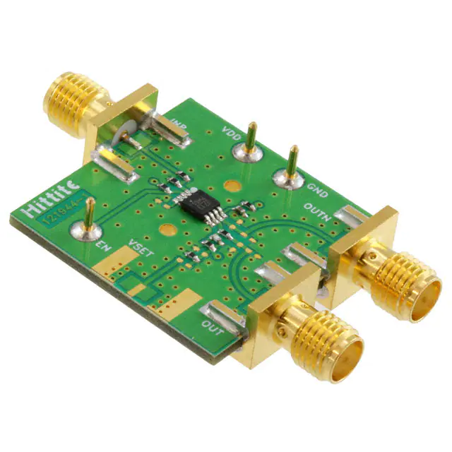

HMC713MS8 / 713MS8E v06.0412 Power Detectors - SMT 54 dB, LOGARITHMIC DETECTOR / CONTROLLER, 45 - 2700 MHz Typical Applications Features The HMC713MS8(E) is ideal for: Wide Dynamic Range: up to 54 dB • Cellular Infrastructure High Accuracy: ±1 dB with 54 dB Range Up To 2.7 GHz • WiMAX, WiBro & LTE/4G Fast Output Response Time • Power Monitoring & Control Circuitry Supply Voltage: +2.7 to +5.5V • Receiver Signal Strength Indication (RSSI) Power-Down Mode • Automatic Gain & Power Control Excellent Stability over Temperature • Military, ECM & Radar MSOP-8 SMT Package: 14.8 mm² Functional Diagram General Description The HMC713MS8(E) Logarithmic Detector/Controller is ideal for converting RF signals with frequencies in the 45 MHz to 2700 MHz range, to a proportional DC voltage at its output. The HMC713MS8(E) employs a successive compression technology which delivers 54 dB of dynamic range with high conversion accuracy over a wide input frequency range. As the input signal is increased, successive amplifiers move into saturation one by one creating an accurate approximation of the logarithm function. The outputs of a series of detectors are summed, converted into voltage domain and buffered to drive the OUT output. For detection mode, the OUT pin is connected to the VSET input and will provide a nominal logarithmic slope of 17 mV/dB and an intercept of -68 dBm. The HMC713MS8(E) can also be used in the controller mode where an external voltage is applied to the VSET pin to create an AGC or APC feedback loop. Electrical Specifications, TA = +25 °C, Vcc= +3V [1] Parameter Typ. Typ. Typ. Typ. Typ. Typ. Units MHz Input Frequency 45 100 900 1900 2200 2700 ±3 dB Dynamic Range 60 61 61 62 62 68 dB ±3 dB Dynamic Range Center -26 -28 -28 -30 -31 -27 dBm 53 54 54 54 53 59 dB OUT Slope ±1 dB Dynamic Range 17.3 17.3 17.2 17.1 17.1 17.2 mV/dB OUT Intercept -68 -68 -69 -71 -72 -70 dBm Variation of OUT with Temperature from -40°C to +85°C @ -20 dBm Input -0.8 -1 -0.9 -0.5 -0.6 -0.5 dB [1] Detector mode measurements; OUT (Pin 6) is shorted to VSET (Pin 3) through an RC network. 1 Information furnished by Analog Devices is believed to be accurate and reliable. However, no For price,2 delivery, andDrive, to place orders: AnalogMA Devices, For price, delivery andDevices to place orders: Hittite Microwave Elizabeth Chelmsford, 01824Inc., responsibility is assumed by Analog for its use, nor for any infringements of patents orCorporation, other One Technology Way, P.O. Box 9106, Norwood, MA 02062-9106 rights of third parties that may result from its use. Specifications subject to change without notice. No Phone: 978-250-3343 Fax: 978-250-3373 Order at www.hittite.com Phone: On-line 781-329-4700 • Order online at www.analog.com license is granted by implication or otherwise under any patent or patent rights of Analog Devices. Application Support: Phone: 1-800-ANALOG-D Trademarks and registered trademarks are the property of their respective owners. Application Support: Phone: 978-250-3343 or apps@hittite.com HMC713MS8 / 713MS8E v06.0412 54 dB, LOGARITHMIC DETECTOR / CONTROLLER, 45 - 2700 MHz Electrical Specifications, (continued) Conditions Min. Typ. Max. Units Voltage Range for Normal Mode 0.8 x Vcc V Voltage Range for Powerdown Mode 0.2 x Vcc Threshold Voltage Vcc/2 V V Power Supply (Vcc) Operating Voltage Range 2.7 - 5.5 V Supply Current in Normal Mode 17 mA Supply Current in Power Down Mode 0.3 mA OUT Interface Rise Time CLPF= 0, No Power to -10 dBm, 10% - 90% 24 ns Fall Time CLPF= 0, -10 dBm to No Power, 90% - 10% 70 ns 3 dB reduction in demodulated output voltage 16 MHz Closed Loop (Eval Board Setup) 0.2 - 1.2 V Open Loop 0.1 to (Vcc -0.1) V 3.5 / 0.51 mA 3.6 / 0.47 mA 0.2 - 2.1 V F= 50 MHz to 2.5 GHz Z0 = 50Ω, See plot 10 dB 1 MΩ Input Voltage Range Eval Board 0.2 - 1.2 V Low Frequency Gain VSET to OUT 64 dB 11 kHz Output Video BW Voltage Range Voltage Range Current Drive Source / Sink OUTN Interface Current Drive Source / Sink OUTN Interface Output Voltage Range Power Detectors - SMT Parameter Power Down (EN) Interface RF Input Input Return Loss (S11) VSET Interface Input Impedance Open Loop Corner Frequency Information furnished by Analog Devices is believed to be accurate and reliable. However, no For price,2 delivery, andDrive, to place orders: AnalogMA Devices, For price, delivery andDevices to place orders: Hittite Microwave Elizabeth Chelmsford, 01824Inc., responsibility is assumed by Analog for its use, nor for any infringements of patents orCorporation, other One Technology Way, P.O. Box 9106, Norwood, MA 02062-9106 rights of third parties that may result from its use. Specifications subject to change without notice. No Phone: 978-250-3343 Fax: 978-250-3373 Order at www.hittite.com Phone: On-line 781-329-4700 • Order online at www.analog.com license is granted by implication or otherwise under any patent or patent rights of Analog Devices. Application Support: Phone: 1-800-ANALOG-D Trademarks and registered trademarks are the property of their respective owners. Application Support: Phone: 978-250-3343 or apps@hittite.com 2 HMC713MS8 / 713MS8E v06.0412 54 dB, LOGARITHMIC DETECTOR / CONTROLLER, 45 - 2700 MHz Output Voltage & Error vs. Input Power, Fin = 45 MHz Output Voltage & Error vs. Input Power, Fin = 100 MHz 1.6 2.4 4 2 2 1.6 0 1.2 -2 0.8 OUT N 0 -60 OUT Err +25C OUT Err +85C OUT Err -40C OUT N Err +25C OUT N Err +85C OUT N Err -40C -50 -40 -30 -20 -10 0 0.4 -6 0 OUT N -50 Output Voltage & Error vs. Input Power, Fin = 900 MHz 2.4 4 2 2 1.6 -2 0.8 OUT N -30 -20 -10 0 -2 0.8 OUT N 6 -6 -50 -40 -4 -6 -30 -20 -10 0 INPUT POWER (dBm) 10 OUT, OUTN (V) OUT, OUTN (V) -10 0 10 6 OUT Err +25C OUT Err +85C OUT Err -40C OUT N Err +25C OUT N Err +85C OUT N Err -40C 1.6 4 2 0 1.2 -2 0.8 OUT OUT N 0.4 0 -60 ERROR (dB) OUT N ERROR (dB) -2 0.8 -40 -20 2 2 0 -50 -30 2.4 4 1.2 0 -60 -4 Output Voltage & Error vs. Input Power, Fin = 2700 MHz OUT Err +25C OUT Err +85C OUT Err -40C OUT N Err +25C OUT N Err +85C OUT N Err -40C 1.6 2 INPUT POWER (dBm) 2.4 2 4 0 0 -60 10 Output Voltage & Error vs. Input Power, Fin = 2200 MHz 0.4 10 1.2 Input Power (dBm) OUT 0 OUT Err +25C OUT Err +85C OUT Err -40C OUT N Err +25C OUT N Err +85C OUT N Err -40C 0.4 -6 -40 -10 6 OUT -4 0 -50 -20 ERROR (dB) 0 1.2 ERROR (dB) OUT, OUTN (V) 1.6 6 OUT, OUTN (V) OUT Err +25C OUT Err +85C OUT Err -40C OUT N Err +25C OUT N Err +85C OUT N Err -40C 2 -60 -30 Output Voltage & Error vs. Input Power, Fin = 1900 MHz 2.4 0.4 -40 INPUT POWER (dBm) INPUT POWER (dBm) OUT -4 -6 -60 10 2 -2 0.8 -4 4 0 1.2 OUT OUT 0.4 6 ERROR (dB) OUT, OUTN (V) 2 6 OUT, OUTN (V) OUT Err +25C OUT Err +85C OUT Err -40C OUT N Err +25C OUT N Err +85C OUT N Err -40C ERROR (dB) Power Detectors - SMT 2.4 -4 -6 -50 -40 -30 -20 -10 0 10 NPUT POWER (dBm) Unless otherwise noted: Vcc= +3V, TA = +25 °C 3 Information furnished by Analog Devices is believed to be accurate and reliable. However, no For price,2 delivery, andDrive, to place orders: AnalogMA Devices, For price, delivery andDevices to place orders: Hittite Microwave Elizabeth Chelmsford, 01824Inc., responsibility is assumed by Analog for its use, nor for any infringements of patents orCorporation, other One Technology Way, P.O. Box 9106, Norwood, MA 02062-9106 rights of third parties that may result from its use. Specifications subject to change without notice. No Phone: 978-250-3343 Fax: 978-250-3373 Order at www.hittite.com Phone: On-line 781-329-4700 • Order online at www.analog.com license is granted by implication or otherwise under any patent or patent rights of Analog Devices. Application Support: Phone: 1-800-ANALOG-D Trademarks and registered trademarks are the property of their respective owners. Application Support: Phone: 978-250-3343 or apps@hittite.com HMC713MS8 / 713MS8E v06.0412 54 dB, LOGARITHMIC DETECTOR / CONTROLLER, 45 - 2700 MHz OUT Slope vs. Frequency OUT Slope vs. Supply Voltage 20 20 SLOPE (mV/dB) SLOPE (mV/dB) 18 17 16 14 17 15 0 0.3 0.6 0.9 1.2 1.5 1.8 FREQUENCY (GHz) 2.1 2.4 2.7 2.7 -60 -60 INTERCEPT (dBm) -50 -70 -80 +25C intercept +85C intercept -40C intercept 0.3 0.6 0.9 1.2 1.5 1.8 FREQUENCY (GHz) 3.9 4.3 4.7 5.1 5.5 2.1 -70 -80 0.045GHz 0.1GHz 0.9GHz 1.9GHz 2.2GHz 2.7GHz -90 -100 2.7 -100 0 3.5 OUT Intercept vs. Supply Voltage -50 -90 3.1 VOLTAGE SUPPLY (V) OUT Intercept vs. Frequency INTERCEPT (dBm) 18 16 15 2.4 2.7 3.1 3.5 3.9 4.3 4.7 5.1 5.5 VOLTAGE SUPPLY (V) OUT vs. Frequency & Input Power OUT Voltage & Error vs. Frequency 1.4 1.8 6 1.5 4 0dBm 1.2 -10dBm 1 OUT (V) -30dBm -40dBm Error 0.6 0.4 0 0.9 OUT -2 0.045GHz 0.1GHz 0.9GHz 1.9GHz 2.2GHz 2.7GHz -50dBm 0.3 0.2 -60dBm 0 0 0.3 0.6 0.9 1.2 1.5 1.8 FREQUENCY (GHz) 2.1 2.4 2.7 0 -60 ERROR (dB) 0.8 0.6 2 1.2 -20dBm OUT (V) 0.045GHz 0.1GHz 0.9GHz 1.9GHz 2.2GHz 2.7GHz 19 Power Detectors - SMT +25C slope +85C slope -40C slope 19 -4 -6 -50 -40 -30 -20 -10 0 10 INPUT POWER (dBm) Unless otherwise noted: Vcc= +3V, TA = +25 °C Information furnished by Analog Devices is believed to be accurate and reliable. However, no For price,2 delivery, andDrive, to place orders: AnalogMA Devices, For price, delivery andDevices to place orders: Hittite Microwave Elizabeth Chelmsford, 01824Inc., responsibility is assumed by Analog for its use, nor for any infringements of patents orCorporation, other One Technology Way, P.O. Box 9106, Norwood, MA 02062-9106 rights of third parties that may result from its use. Specifications subject to change without notice. No Phone: 978-250-3343 Fax: 978-250-3373 Order at www.hittite.com Phone: On-line 781-329-4700 • Order online at www.analog.com license is granted by implication or otherwise under any patent or patent rights of Analog Devices. Application Support: Phone: 1-800-ANALOG-D Trademarks and registered trademarks are the property of their respective owners. Application Support: Phone: 978-250-3343 or apps@hittite.com 4 HMC713MS8 / 713MS8E v06.0412 54 dB, LOGARITHMIC DETECTOR / CONTROLLER, 45 - 2700 MHz Output Response Fall Time @ 900 MHz, C1 = Open Output Response Fall Time @ 900 MHz, C1 = 10nF 1.5 0dBm -10dBm -20dBm -30dBm 0.9 0.6 0.3 0 0dBm -10dBm -20dBm -30dBm 1.2 OUT (V) OUT (V) 1.2 0.9 0.6 0.3 0 50 100 150 200 250 300 350 400 450 0 500 0 25 50 75 TIME (ns) 125 150 175 200 Output Response Rise Time @ 900 MHz, C1 = 10nF 1.5 1.5 0dBm -10dBm -20dBm -30dBm 1.2 0dBm -10dBm -20dBm -30dBm 1.2 OUT (V) 0.9 0.6 0.3 0 100 TIME (us) Output Response Rise Time @ 900 MHz, C1 = Open OUT (V) Power Detectors - SMT 1.5 0.9 0.6 0.3 0 50 100 150 200 250 300 350 400 450 500 TIME (ns) 0 0 10 20 30 40 50 60 70 80 90 100 TIME (us) Input Return Loss 0 RETURN LOSS (dB) -10 -20 -30 -40 -50 0 0.5 1 1.5 2 FREQUENCY (GHz) 2.5 3 Unless otherwise noted: Vcc= +3V, TA = +25 °C 5 Information furnished by Analog Devices is believed to be accurate and reliable. However, no For price,2 delivery, andDrive, to place orders: AnalogMA Devices, For price, delivery andDevices to place orders: Hittite Microwave Elizabeth Chelmsford, 01824Inc., responsibility is assumed by Analog for its use, nor for any infringements of patents orCorporation, other One Technology Way, P.O. Box 9106, Norwood, MA 02062-9106 rights of third parties that may result from its use. Specifications subject to change without notice. No Phone: 978-250-3343 Fax: 978-250-3373 Order at www.hittite.com Phone: On-line 781-329-4700 • Order online at www.analog.com license is granted by implication or otherwise under any patent or patent rights of Analog Devices. Application Support: Phone: 1-800-ANALOG-D Trademarks and registered trademarks are the property of their respective owners. Application Support: Phone: 978-250-3343 or apps@hittite.com HMC713MS8 / 713MS8E v06.0412 54 dB, LOGARITHMIC DETECTOR / CONTROLLER, 45 - 2700 MHz Vcc 0 to +5.6V EN 0 to +5.6V VSET 0 to +5.6V OUT Output Current 5 mA OUTN Output Current 5 mA RF Input Power 12 dBm Junction Temperature 125 °C Continuous Pdiss (T = 85°C) (Derate 5.43 mW/°C above 85°C) 0.22 Watts Thermal Resistance (Rth) (junction to lead) 184 °C/W Storage Temperature -65 to +150 °C Operating Temperature -40 to +85 °C ESD Sensitivity (HBM) Class 1C ELECTROSTATIC SENSITIVE DEVICE OBSERVE HANDLING PRECAUTIONS Outline Drawing Power Detectors - SMT Absolute Maximum Ratings NOTES: 1. PACKAGE BODY MATERIAL: LOW STRESS INJECTION MOLDED PLASTIC SILICA AND SILICON IMPREGNATED. 2. LEAD MATERIAL: COPPER ALLOY 3. LEAD PLATING: 100% MATTE TIN 4. DIMENSIONS ARE IN INCHES [MILLIMETERS]. 5. DIMENSION DOES NOT INCLUDE MOLDFLASH OF 0.15mm PER SIDE. 6. DIMENSION DOES NOT INCLUDE MOLDFLASH OF 0.25mm PER SIDE. 7. ALL GROUND LEADS MUST BE SOLDERED TO PCB RF GROUND. Package Information Part Number Package Body Material Lead Finish MSL Rating HMC713MS8 Low Stress Injection Molded Plastic Sn/Pb Solder MSL1 [1] HMC713MS8E RoHS-compliant Low Stress Injection Molded Plastic 100% matte Sn MSL1 [2] Package Marking [3] H713 XXXX H713 XXXX [1] Max peak reflow temperature of 235 °C [2] Max peak reflow temperature of 260 °C [3] 4-Digit lot number XXXX Information furnished by Analog Devices is believed to be accurate and reliable. However, no For price,2 delivery, andDrive, to place orders: AnalogMA Devices, For price, delivery andDevices to place orders: Hittite Microwave Elizabeth Chelmsford, 01824Inc., responsibility is assumed by Analog for its use, nor for any infringements of patents orCorporation, other One Technology Way, P.O. Box 9106, Norwood, MA 02062-9106 rights of third parties that may result from its use. Specifications subject to change without notice. No Phone: 978-250-3343 Fax: 978-250-3373 Order at www.hittite.com Phone: On-line 781-329-4700 • Order online at www.analog.com license is granted by implication or otherwise under any patent or patent rights of Analog Devices. Application Support: Phone: 1-800-ANALOG-D Trademarks and registered trademarks are the property of their respective owners. Application Support: Phone: 978-250-3343 or apps@hittite.com 6 HMC713MS8 / 713MS8E v06.0412 54 dB, LOGARITHMIC DETECTOR / CONTROLLER, 45 - 2700 MHz Power Detectors - SMT Pin Descriptions 7 Pin Number Function Description 1 INP RF input pin. 2 EN Interface Schematic Enable pin. Apply VEN >0.8 x Vcc for normal operation. Apply VEN
