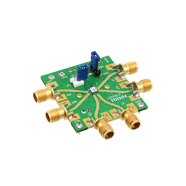

    EVAL BOARD HMC674LC3C
125932-HMC674LC3C 数据手册
Analog Devices Welcomes Hittite Microwave Corporation NO CONTENT ON THE ATTACHED DOCUMENT HAS CHANGED www.analog.com www.hittite.com THIS PAGE INTENTIONALLY LEFT BLANK HMC674LC3C v11.0714 COMPARATORS - SMT 10 GHz LATCHED COMPARATOR Typical Applications Features The HMC674LC3C is ideal for: Equivalent Input Bandwidth: 10 GHz • ATE Applications Propagation Delay: 85 ps • High Speed Instrumentation Overdrive & Slew Rate Dispersion: 10 ps • Digital Receiver Systems Minimum Pulse Width: 60 ps • Pulse Spectroscopy Resistor Programmable Hysteresis • High Speed Trigger Circuits Differential Latch Control • Clock & Data Restoration Power Dissipation: 140 mW RSCML Version Available 16 Lead 3x3 mm SMT Package: 9 mm 2 Functional Diagram General Description The HMC674LC3C is a SiGe monolithic, ultra fast comparator. The comparator supports 10 Gbps operation while providing 85 ps propagation delay and 60 ps minimum pulse width with 0.2 ps rms random jitter (RJ). Overdrive and slew rate dispersion are typically 10 ps, making the device ideal for a wide range of applications from ATE to broadband communications. The output stages are designed to directly drive 400 mV into 50 ohms terminated to Vtt = (Vcco - 2.0 V). The HMC674LP3E features high speed latch and programmable hysteresis and may be configured to operate in either latch mode, or as a tracking comparator. Electrical Specifications TA = +25°C, Vcci= +3.3 V, Vcco = +2.0 V, Vee = -3 V, Vtt = 0 V Parameter Conditions Input Voltage Range Input Differential Voltage Max Units -2 Typ. +2 V -1.75 1.75 V Input Offset Voltage (VOS) ±5 mV Input Offset Voltage, Temperature Coefficient 15 µV / °C Input Bias Current 15 uA Input Bias Current Temperature Coefficient 50 nA / °C Input Offset Current 4 µA Input Impedance 50 Ω Common Mode Input Impedance 350 KΩ Differential Input Impedance 15 KΩ Active Gain 48 dB Common Mode Rejection Ratio 80 dB ±1 mV Hysteresis 1 Min. Rhys = ∞ For price, delivery and to place orders: Hittite Microwave Corporation, 2 Elizabeth Drive, Chelmsford, MA 01824 Phone: 978-250-3343 Fax: 978-250-3373 Order On-line at www.hittite.com Application Support: Phone: 978-250-3343 or apps@hittite.com HMC674LC3C v11.0714 10 GHz LATCHED COMPARATOR Latch Enable Characteristics Conditions Min. Typ. Each Pin 8 Max Units KΩ Latch Enable to Output Delay, tPLOL , tPLOH VOD = 200 mV 85 ps Latch Enable Minimum Pulse Width, tPL VOD = 200 mV 20 ps Latch Enable Input Range VOD = 200 mV Latch Setup Time, tS VOD = 200 mV 1.6 Latch Hold Time, tH 2.4 V 45 ps -42 ps DC Output Characteristics, Vcco = +2.0 V, Vtt = 0 V Min. Typ. Max Units Output Voltage High Level, Voh Parameter Conditions 1.03 1.09 1.14 V Output Voltage Low Level, Vol 0.65 0.71 0.81 V Output Voltage Differential Swing 440 760 980 mVpp Conditions Min. Typ. Max Units VOD = 500 mV 80 85 110 AC Performance Parameter Propagation Delay - tPD, tPDL , tPDH Propagation Delay, Temperature Coefficient Propagation Delay Skew (Rising to Falling Transition) VOD [1] Dispersion tPD vs. Common Mode Dispersion, -1.75 V
