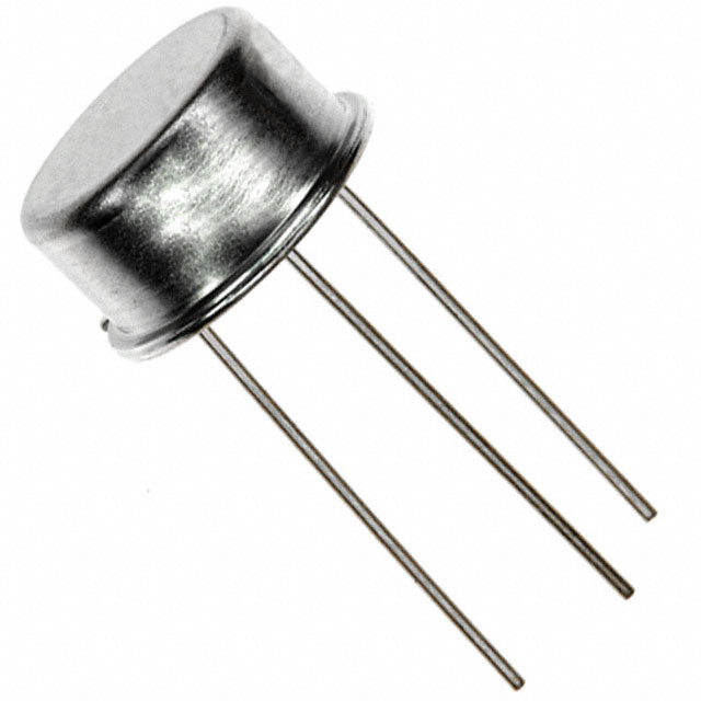

    4.5V~30V 串联 1.5MA 10PPM/℃
5962-8686103XA 数据手册
High Precision, 2.5 V IC Reference AD580 FUNCTIONAL BLOCK DIAGRAM FEATURES Laser-trimmed to high accuracy: 2.500 V ±0.4% 3-terminal device: voltage in/voltage out Excellent temperature stability: 10 ppm/°C (AD580M, U) Excellent long-term stability: 250 μV (25 μV/month) Low quiescent current: 1.5 mA maximum Small, hermetic IC package: TO-52 can MIL-STD-883 compliant versions available +E Figure 1. PRODUCT HIGHLIGHTS The AD580 is a 3-terminal, low cost, temperature-compensated, bandgap voltage reference, which provides a fixed 2.5 V output for inputs between 4.5 V and 30 V. A unique combination of advanced circuit design and laser-wafer trimmed thin film resistors provide the AD580 with an initial tolerance of ±0.4%, a temperature stability of better than 10 ppm/°C, and long-term stability of better than 250 μV. In addition, the low quiescent current drain of 1.5 mA maximum offers a clear advantage over classical Zener techniques. 1. The AD580J, K, L, and M are specified for operation over the 0°C to +70°C temperature range; the AD580S, T, and U are specified for operation over the extended temperature range of –55°C to +125°C. 00525-B-001 –E GENERAL DESCRIPTION The AD580 is recommended as a stable reference for all 8-, 10-, and 12-bit D/A converters that require an external reference. In addition, the wide input range of the AD580 allows operation with 5 volt logic supplies, making the AD580 ideal for digital panel meter applications or whenever only a single logic power supply is available. EOUT BOTTOM VIEW 2. 3. 4. 5. 6. Laser-trimming of the thin film resistors minimizes the AD580 output error. For example, the AD580L output tolerance is ±10 mV. The three-terminal voltage in/voltage out operation of the AD580 provides regulated output voltage without any external components. The AD580 provides a stable 2.5 V output voltage for input voltages between 4.5 V and 30 V. The capability to provide a stable output voltage using a 5 V input makes the AD580 an ideal choice for systems that contain a single logic power supply. Thin film resistor technology and tightly controlled bipolar processing provide the AD580 with temperature stabilities to 10 ppm/°C and long-term stability better than 250 μV. The low quiescent current drain of the AD580 makes it ideal for CMOS and other low power applications. The AD580 is available in versions compliant with MILSTD-883. Refer to the Analog Devices Military Products Data Book or the current AD580/AD883B data sheet for detailed specifications. Rev. B Information furnished by Analog Devices is believed to be accurate and reliable. However, no responsibility is assumed by Analog Devices for its use, nor for any infringements of patents or other rights of third parties that may result from its use. Specifications subject to change without notice. No license is granted by implication or otherwise under any patent or patent rights of Analog Devices. Trademarks and registered trademarks are the property of their respective owners. One Technology Way, P.O. Box 9106, Norwood, MA 02062-9106, U.S.A. Tel: 781.329.4700 www.analog.com Fax: 781.326.8703 © 2004 Analog Devices, Inc. All rights reserved. AD580 TABLE OF CONTENTS Specifications..................................................................................... 3 The AD580 as a Current Limiter.................................................6 Absolute Maximum Ratings............................................................ 4 The AD580 as a Low Power, Low Voltage, Precision Reference for Data Converters.......................................................................7 AD580 Chip Dimensions And Pad Layout............................... 4 ESD Caution.................................................................................. 4 Theory of Operation ........................................................................ 5 Outline Dimensions ..........................................................................8 Ordering Guide .............................................................................8 Voltage Variation versus Temperature ....................................... 5 Noise Performance ....................................................................... 6 REVISION HISTORY 8/04—Changed from Rev. A to Rev. B Updated Format................................................................ Universal Rev. B | Page 2 of 8 AD580 SPECIFICATIONS Table 1. VIN = 15 V and 25°C Model OUTPUT VOLTAGE TOLERANCE Error from Nominal 2.500 V Output OUTPUT VOLTAGE CHANGE TMIN to TMAX LINE REGULATION 7 V ≤ VIN ≤ 30 V 4.5 V ≤ VIN ≤ 7 V LOAD REGULATION ∆I = 10 mA QUIESCENT CURRENT NOISE (0.1 Hz to 10 Hz) STABILITY Long Term Per Month TEMPERATURE PERFORMANCE Specified Operating Storage PACKAGE OPTION2 TO-52 (H-03A) Min AD580J Typ Max 1.5 0.3 1.0 8 Min AD580K Typ Max AD580L Typ Max AD580M Typ Max Min Units ±75 ±25 ±10 ±10 mV 15 85 7 40 4.3 25 1.75 10 mV ppm/°C 4 2 2 1 2 1 mV mV 10 1.5 mV mA µV p-p 61 3 1.5 0.3 10 1.5 10 1.5 1.0 8 250 25 0 –55 –65 Min 1.0 8 250 25 +70 +125 +175 AD580JH 0 –55 –65 10 1.5 1.0 8 250 25 +70 +125 +175 AD580KH 0 –55 –65 250 25 +70 +125 +175 AD580LH 0 –55 –65 µV µV +70 +125 +175 AD580MH °C °C °C Table 2. Model OUTPUT VOLTAGE TOLERANCE Error from Nominal 2.500 V Output OUTPUT VOLTAGE CHANGE TMIN to TMAX LINE REGULATION 7 V ≤ VIN ≤ 30 V 4.5 V ≤ VIN ≤ 7 V LOAD REGULATION ∆I = 10 mA QUIESCENT CURRENT NOISE (0.1 Hz to 10 Hz) STABILITY Long Term Per Month TEMPERATURE PERFORMANCE Specified Operating Storage PACKAGE OPTION2 TO-52 (H-03A) 1 2 Min AD580S Typ Max 1.5 0.3 Min AD580U Typ Max Units ±10 ±10 mV 25 55 11 25 4.5 10 mV ppm/°C 6 3 2 1 2 1 mV mV 10 1.5 mV mA µV p-p 1.0 8 250 25 –55 –55 –65 Min ±251 10 1.5 1.0 8 AD580T Typ Max 10 1.5 1.0 8 250 25 +125 +150 +175 –55 –55 –65 AD580SH 250 25 +125 +150 +175 AD580TH –55 –55 –65 µV µV +125 +150 +175 °C °C °C AD580UH Specifications shown in boldface are tested on all production units at final electrical test. Results from those tests are used to calculate outgoing quality levels. All min and max specifications are guaranteed, although only those shown in boldface are tested on all production units. H = Metal Can. Rev. B | Page 3 of 8 AD580 ABSOLUTE MAXIMUM RATINGS Table 3. AD580 CHIP DIMENSIONS AND PAD LAYOUT Rating 40 V Dimensions shown in inches and (millimeters). 0.075 (1.90) 350 mW 2.8 mW/°C 300°C +E 0.046 (1.16) 100°C 360°C/W –E EOUT* Stresses above those listed under Absolute Maximum Ratings may cause permanent damage to the device. This is a stress rating only; functional operation of the device at these or any other conditions above those listed in the operational sections of this specification is not implied. Exposure to absolute maximum rating conditions for extended periods may affect device reliability. *BOTH EOUT PADS MUST BE CONNECTED TO THE OUTPUT. 00525-B-002 Parameter Input Voltage Power Dissipation @ 25°C Ambient Temperature Derate above 25°C Lead Temperature (Soldering 10 sec) Thermal Resistance Junction-to-Case Junction-to-Ambient Figure 2. The AD580 is also available in chip form. Consult the factory for specifications and applications information. ESD CAUTION ESD (electrostatic discharge) sensitive device. Electrostatic charges as high as 4000 V readily accumulate on the human body and test equipment and can discharge without detection. Although this product features proprietary ESD protection circuitry, permanent damage may occur on devices subjected to high energy electrostatic discharges. Therefore, proper ESD precautions are recommended to avoid performance degradation or loss of functionality. Rev. B | Page 4 of 8 AD580 THEORY OF OPERATION +VIN The AD580 family (AD580, AD581, AD584, AD589) uses the bandgap concept to produce a stable, low temperature coefficient voltage reference suitable for high accuracy data acquisition components and systems. The device makes use of the underlying physical nature of a silicon transistor base-emitter voltage in the forward-biased operating region. All such transistors have approximately a –2 mV/°C temperature coefficient, unsuitable for use directly as a low TC reference. Extrapolation of the temperature characteristic of any one of these devices to absolute zero (with an emitter current propor-tional to the absolute temperature), however, reveals that it will go to a VBE of 1.205 V at 0 K, as shown in Figure 3. Thus, if a voltage could be developed with an opposing temperature coefficient to sum with VBE to total 1.205 V, a 0 TC reference would result and operation from a single, low voltage supply would be possible. The AD580 circuit provides such a compensating voltage, V1 in Figure 4, by driving two transistors at different current densities and amplifying the resulting VBE difference (∆VBE—which now has a positive TC). The sum, VZ, is then buffered and amplified up to 2.5 V to provide a usable reference-voltage output. Figure 5 shows the schematic diagram of the AD580. R8 R7 I2 ≅ I1 VOUT = VZ 1 + R4 = 2.5V R5 R4 ∆VBE Q1 A R2 2I1 = I1 + I2 V1 = 2 R1 VZ = VBE + V1 R = VBE + 2 1 ∆VBE R2 R5 VBE (Q1) = VBE + 2 R1 ∆VBE R2 J R1 kT ln 1 R2 q J2 = 1.205V COM 00525-B-004 Q2 8A Figure 4. Basic Bandgap-Reference Regulator Circuit +E R12 Q14 R13 Q13 Q4 Q3 Q7 R8 R7 Q10 R6 Q11 Q12 Q6 Q8 Q15 Q9 R9 Q5 R10 Q2 8A R3 Q1 A C1 R5 R2 R11 R1 –E COM 1.5 00525-B-005 The AD580 operates as a 3-terminal reference, meaning that no additional components are required for biasing or current setting. The connection diagram, Figure 6, is quite simple. 2.5V OUT R4 Figure 5. Schematic Diagram CONSTANT SUM = 1.205V +E FOR BOTH DEVICES 4.5 ≤ VIN ≤ 30V 1.0 EOUT AD580 0 –273°C 0K LOAD –E REQUIRED COMPENSATION VOLTAGE– SAME DEVICES –200°C 73K –100°C 173K TEMPERATURE 0°C 273K 00525-B-006 0.5 VBE VS. TEMPERATURE FOR TWO TYPICAL DEVICES (IE α T) Figure 6. Connection Diagram 00525-B-003 JUNCTION VOLTAGE (V) 1.205 VOLTAGE VARIATION VERSUS TEMPERATURE 100°C 373K Figure 3. Extrapolated Variation of Base-Emitter Voltage with Temperature (IEαT), and Required Compensation, Shown for Two Different Devices Some confusion exists in the area of defining and specifying reference voltage error over temperature. Historically, references are characterized using a maximum deviation per degree Centigrade; i.e., 10 ppm/°C. However, because of the inconsistent nonlinearities in Zener references (butterfly or S type characteristics), most manufacturers use a maximum limit error band approach to characterize their references. This technique measures the output voltage at 3 to 5 different temperatures and guarantees that the output voltage deviation will fall within the guaranteed error band at these discrete temperatures. This approach, of course, makes no mention or guarantee of performance at any other temperature within the operating temperature range of the device. Rev. B | Page 5 of 8 AD580 1mV PEAK-TO-PEAK NOISE The consistent voltage versus temperature performance of a typical AD580 is shown in Figure 7. Note that the characteristic is quasi-parabolic, not the possible S type characteristics of classical Zener references. This parabolic characteristic permits a maximum output deviation specification over the device’s full operating temperature range, rather than just at 3 to 5 discrete temperatures. 2.51 100µV 10µV 0 100 MAXIMUM VOLTAGE CHANGE FROM 0°C TO 70°C 2.49 00525-B-009 OUTPUT VOLTAGE (V) 2.50 1k 10k FREQUENCY (Hz) 100k 1M Figure 9. Peak-to-Peak Output Noise vs. Frequency 2.48 2.46 –55 00525-B-007 2.47 –30 0 25 50 TEMPERATURE (°C) 75 100 125 Figure 7. Typical AD580K Output Voltage vs. Temperature 500µA 1.75 mV max 70°C 1 × = 10 ppm / °C max average 2.5V 5V Figure 10. Input Current vs. Input Voltage (Integral Loads) The AD580 typically exhibits a variation of 1.5 mV over the power supply range of 7 V to 30 V. Figure 8 is a plot of AD580 line rejection versus frequency. NOISE PERFORMANCE Figure 9 represents the peak-to-peak noise of the AD580 from 1 Hz (3 dB point) to a 3 dB high end shown on the horizontal axis. Peak-to-peak noise from 1 Hz to 1 MHz is approximately 600 µV. 140 130 120 110 e = 23V p-p E = 18.5V AD580 k e OUT p-p THE AD580 AS A CURRENT LIMITER The AD580 represents an excellent alternative to current limiter diodes that require factory selection to achieve a desired current. This approach often results in temperature coefficients of 1%/C. The AD580 approach is not limited to a specially selected factory set current limit; it can be programmed from 1 mA to 10 mA with the insertion of a single external resistor. The approximate temperature coefficient of current limit for the AD580 used in this mode is 0.13%/°C for ILIM = 1 mA and 0.01%/°C for ILIM = 13 mA (see Figure 11). Figure 10 displays the high output impedance of the AD580 used as a current limiter for ILIM = 1, 2, 3, 4, and 5 mA. E IN COMPOSITE (17V ≤ VIN ≤ 30V) 80 70 V+ 60 AD580 50 OUTPUT 40 2.5V 20 10 0 10 100 1k 10k LINE FREQUENCY (Hz) V– R LOAD i≅ 2.5V + 1mA R BOTTOM VIEW OF 2.5V PRECISION REFERENCE CIRCUIT IN TO-52 CASE 100k Figure 8. AD580 Line Rejection Plot Figure 11. A Two-Component Precision Current Limiter Rev. B | Page 6 of 8 00525-B-011 30 00525-B-008 EOUT, p-p (mV) 100 90 00525-B-010 The AD580M guarantees a maximum deviation of 1.75 mV over the 0°C to 70°C temperature range. This can be shown to be equivalent to 10 ppm/°C average maximum; i.e., AD580 The AD580 has a number of features that make it ideally suited for use with A/D and D/A data converters used in complex microprocessor-based systems. The calibrated 2.500 V output minimizes user trim requirements and allows operation from a single, low voltage supply. Low power consumption (1 mA quiescent current) is commensurate with that of CMOS-type devices, while the low cost and small package complements the decreasing cost and size of the latest converters. Figure 12 shows the AD580 used as a reference for the AD7542 12-bit CMOS DAC with complete microprocessor interface. The AD580 and the AD7542 are specified to operate from a single 5 V supply, thus eliminating the need to provide a 15 V power supply for the sole purpose of operating a reference. The AD7542 includes three 4-bit data registers, a 12-bit DAC register, and address decoding logic. It may thus be interfaced directly to a 4-, 8- or 16-bit data bus. Only 8 mA of quiescent current from the single 5 volt supply is required to operate the AD7542 which is packaged in a small, 16-pin DIP. The AD544 output amplifier is also low power, requiring only 2.5 mA quiescent current. Its laser-trimmed offset voltage preserves the ±1/2 LSB linearity of the AD7542KN without user trims, and it typically settles to ±1/2 LSB in less than 3 µs. It will provide the 0 V to –2.5 V output swing from ±5 V supplies. +5V +E AD580 –E SYSTEM 8-BIT DATA BUS 14 FROM SYSTEM RESET FROM ADDRESS BUS GAIN ADJUST VREF 200Ω RFB 15 16 7 6 5 4 1 AD7542 22pF IOUT1 2 IOUT2 AD544L CLR 10 A0 11 A1 9 WR 8 12 CS AGND –5V DGND A0 A1 FROM WR FROM ADDRESS DECODER Rev. B | Page 7 of 8 ANALOG INPUT 3 13 AD0 500Ω VDD D0 D1 D2 D3 AD7 EOUT Figure 12. Low Power, Low Voltage Reference for the AD7542 Microprocessor-Compatible, 12-Bit DAC 00525-B-012 THE AD580 AS A LOW POWER, LOW VOLTAGE, PRECISION REFERENCE FOR DATA CONVERTERS AD580 OUTLINE DIMENSIONS 0.500 (12.70) MIN 0.150 (3.81) 0.115 (2.92) 0.250 (6.35) MIN 0.050 (1.27) T.P. 0.048 (1.22) 0.028 (0.71) 3 0.195 (4.95) 0.178 (4.52) 0.230 (5.84) 0.209 (5.31) 0.050 (1.27) MAX 0.100 (2.54) T.P. 0.050 (1.27) T.P. 0.019 (0.48) 0.016 (0.41) 0.030 (0.76) MAX 2 0.021 (0.53) MAX 0.046 (1.17) 0.036 (0.91) 1 45° T.P. BASE & SEATING PLANE CONTROLLING DIMENSIONS ARE IN INCHES; MILLIMETERS DIMENSIONS (IN PARENTHESES) ARE ROUNDED-OFF INCH EQUIVALENTS FOR REFERENCE ONLY AND ARE NOT APPROPRIATE FOR USE IN DESIGN Figure 13. TO–52 Package Dimensions shown in inches and (millimeters) ORDERING GUIDE Model Output Voltage Tolerance Temperature Coefficient Operating Temperature Range Package Option Package Description AD580JH ±75 mV 85 ppm/°C –55°C to +125°C TO–52 H (Metal Can) AD580KH ±25 mV 40 ppm/°C –55°C to +125°C TO–52 H (Metal Can) AD580LH ±10 mV 25 ppm/°C –55°C to +125°C TO–52 H (Metal Can) AD580LMH ±10 mV 10 ppm/°C –55°C to +125°C TO–52 H (Metal Can) AD580SH ±25 mV 55 ppm/°C –55°C to +125°C TO–52 H (Metal Can) AD580SH/883B ±25 mV 55 ppm/°C –55°C to +125°C TO–52 H (Metal Can) AD580TH ±10 mV 25 ppm/°C –55°C to +125°C TO–52 H (Metal Can) AD580UH ±10 mV 10 ppm/°C –55°C to +125°C TO–52 H (Metal Can) AD580UH/883B ±10 mV 10 ppm/°C –55°C to +125°C TO–52 H (Metal Can) AD580TCHIPS ±10 mV DIE © 2004 Analog Devices, Inc. All rights reserved. Trademarks and registered trademarks are the property of their respective owners. C00525-0-8/04(B) Rev. B | Page 8 of 8
