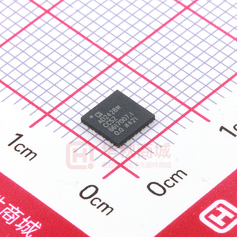

AD2428WCCSZ-RL
AD2428WCCSZ-RL
    AD(亚德诺)
    LFCSP32_5X5MM_EP
    汽车音频总线(A2B)收发器
AD2428WCCSZ-RL 数据手册
Automotive Audio Bus A2B Transceiver AD2420(W)/AD2426(W)/AD2427(W)/AD2428(W)/AD2429(W) A2B BUS FEATURES A2B TRANSCEIVER FEATURES Line topology Single master, multiple slave Up to 15 m between nodes and up to 40 m overall cable length (see Table 9) Communication over distance Synchronous data Multichannel I2S/TDM to I2S/TDM Synchronous clock, phase aligned in all nodes Low latency slave to slave communication Control and status information I2C to I2C GPIO and interrupt Bus power or local power slave nodes Configurable with SigmaStudio graphical software tool AEC-Q100 qualified for automotive applications Configurable A2B bus master or slave operation I2C interface 8-bit to 32-bit multichannel I2S/TDM interface Programmable I2S/TDM data rate Up to 32 upstream and 32 downstream channels PDM interface Programmable PDM clock rate Up to 4 high dynamic range microphone inputs Simultaneous reception of I2S data with up to 4 PDM microphones Unique ID register for each transceiver Crossover or straight-through cabling Programmable settings to optimize EMC performance APPLICATIONS Audio communication link Microphone arrays Beamforming Hands free and in car communication Active and road noise cancellation Audio/video conferencing systems IOVDD SCL SDA IRQ/IO0 ADR1/IO1 ADR2/IO2 I2C DTX0/IO3 DTX1/IO4 DRX0/IO5 DRX1/IO6 I2S/TDM PDM DVDD PLLVDD VOUT1 PLL VREG1 VIN VOUT2 VREG2 BTRXVDD A2 B TRX B (Towards Last Slave) DIAGNOSTICS PDMCLK/IO7 A2 B TRX A (Towards Master) BCLK SYNC VSSN VSS BP BCM BN SWP SENSE AP ACM AN ATRXVDD Figure 1. Functional Block Diagram A2B and the A2B logo are registered trademarks of Analog Devices, Inc. Rev. C Document Feedback Information furnished by Analog Devices is believed to be accurate and reliable. However, no responsibility is assumed by Analog Devices for its use, nor for any infringements of patents or other rights of third parties that may result from its use. Specifications subject to change without notice. No license is granted by implication or otherwise under any patent or patent rights of Analog Devices. Trademarks and registered trademarks are the property of their respective owners. One Technology Way, P.O. Box 9106, Norwood, MA 02062-9106 U.S.A. Tel: 781.329.4700 ©2021 Analog Devices, Inc. All rights reserved. Technical Support www.analog.com AD2420(W)/AD2426(W)/AD2427(W)/AD2428(W)/AD2429(W) TABLE OF CONTENTS A2B Bus Features . . . . . . . . . . . . . . . . . . . . . . . . . . . . . . . . . . . . . . . . . . . . . . . . . . . . . 1 ESD Caution . . . . . . . . . . . . . . . . . . . . . . . . . . . . . . . . . . . . . . . . . . . . . . . . . . . . . . 21 A2B Transceiver Features . . . . . . . . . . . . . . . . . . . . . . . . . . . . . . . . . . . . . . . . . . . 1 Test Circuits and Switching Characteristics . . . . . . . . . . . . . . . 21 Applications . . . . . . . . . . . . . . . . . . . . . . . . . . . . . . . . . . . . . . . . . . . . . . . . . . . . . . . . . . . 1 Output Drive Currents . . . . . . . . . . . . . . . . . . . . . . . . . . . . . . . . . . . . . . . . . 21 Table of Contents . . . . . . . . . . . . . . . . . . . . . . . . . . . . . . . . . . . . . . . . . . . . . . . . . . . . . 2 Test Conditions . . . . . . . . . . . . . . . . . . . . . . . . . . . . . . . . . . . . . . . . . . . . . . . . . . 22 Revision History . . . . . . . . . . . . . . . . . . . . . . . . . . . . . . . . . . . . . . . . . . . . . . . . . . . . . . 2 Pin Configuration and Function Descriptions . . . . . . . . . . . . . . . 24 General Description . . . . . . . . . . . . . . . . . . . . . . . . . . . . . . . . . . . . . . . . . . . . . . . . . 3 Power Analysis . . . . . . . . . . . . . . . . . . . . . . . . . . . . . . . . . . . . . . . . . . . . . . . . . . . . . . 28 2 A B Bus Details . . . . . . . . . . . . . . . . . . . . . . . . . . . . . . . . . . . . . . . . . . . . . . . . . . . . 4 Current Flow . . . . . . . . . . . . . . . . . . . . . . . . . . . . . . . . . . . . . . . . . . . . . . . . . . . . . . 28 2 VREG1 and VREG2 Output Currents . . . . . . . . . . . . . . . . . . . . . . 29 2 I S/TDM Interface . . . . . . . . . . . . . . . . . . . . . . . . . . . . . . . . . . . . . . . . . . . . . . . . 5 Current at VIN (IVIN) . . . . . . . . . . . . . . . . . . . . . . . . . . . . . . . . . . . . . . . . . . . 30 Pulse Density Modulation (PDM) Interface . . . . . . . . . . . . . . . . . 6 Power Dissipation . . . . . . . . . . . . . . . . . . . . . . . . . . . . . . . . . . . . . . . . . . . . . . . 30 GPIO Over Distance . . . . . . . . . . . . . . . . . . . . . . . . . . . . . . . . . . . . . . . . . . . . . . 6 Resistance Between Nodes . . . . . . . . . . . . . . . . . . . . . . . . . . . . . . . . . . . . . 30 Mailboxes . . . . . . . . . . . . . . . . . . . . . . . . . . . . . . . . . . . . . . . . . . . . . . . . . . . . . . . . . . . 6 Data Slot Exchange Between Slaves . . . . . . . . . . . . . . . . . . . . . . . . . . . 6 Voltage Regulator Current in Master Node or Local  Powered Slave Node . . . . . . . . . . . . . . . . . . . . . . . . . . . . . . . . . . . . . . . . . . 31 Clock Sustain State . . . . . . . . . . . . . . . . . . . . . . . . . . . . . . . . . . . . . . . . . . . . . . . . 6 Power Dissipation of A2B Bus . . . . . . . . . . . . . . . . . . . . . . . . . . . . . . . . . 31 I C Interface . . . . . . . . . . . . . . . . . . . . . . . . . . . . . . . . . . . . . . . . . . . . . . . . . . . . . . . . 5 Programmable Settings to Optimize EMC  Performance . . . . . . . . . . . . . . . . . . . . . . . . . . . . . . . . . . . . . . . . . . . . . . . . . . . . . 6 Power Analysis of Bus Powered System . . . . . . . . . . . . . . . . . . . . 31 Specifications . . . . . . . . . . . . . . . . . . . . . . . . . . . . . . . . . . . . . . . . . . . . . . . . . . . . . . . . . . 8 Reducing Power Consumption . . . . . . . . . . . . . . . . . . . . . . . . . . . . . . . 32 Operating Conditions . . . . . . . . . . . . . . . . . . . . . . . . . . . . . . . . . . . . . . . . . . . . 8 Thermal Power . . . . . . . . . . . . . . . . . . . . . . . . . . . . . . . . . . . . . . . . . . . . . . . . . . . 32 Electrical Characteristics . . . . . . . . . . . . . . . . . . . . . . . . . . . . . . . . . . . . . . . . . 9 Designer Reference . . . . . . . . . . . . . . . . . . . . . . . . . . . . . . . . . . . . . . . . . . . . . . . . . 33 Power Supply Rejection Ratio (PSRR) . . . . . . . . . . . . . . . . . . . . . . 11 VSENSE and Considerations for Diodes . . . . . . . . . . . . . . . . ... .... 33 Timing Specifications . . . . . . . . . . . . . . . . . . . . . . . . . . . . . . . . . . . . . . . . . . 12 Optional Add On Circuits . . . . . . . . . . . . . . . . . . . . . . . . . . . . . . . . . . . . . 33 Power-Up Sequencing Restrictions . . . . . . . . . . . . . . . . . . . . . . . . . 16 Layout Guidelines . . . . . . . . . . . . . . . . . . . . . . . . . . . . . . . . . . . . . . . . . . . . . . . 34 2 Supply Voltage . . . . . . . . . . . . . . . . . . . . . . . . . . . . . . . . . . . . . . . . . . . . . . . . . . . 31 A B Bus System Specification . . . . . . . . . . . . . . . . . . . . . . . . . . . . . . . . . 17 Outline Dimensions . . . . . . . . . . . . . . . . . . . . . . . . . . . . . . . . . . . . . . . . . . . . . . . . 36 PDM Typical Performance Characteristics . . . . . . . . . . . . . . . . 18 Automotive Products . . . . . . . . . . . . . . . . . . . . . . . . . . . . . . . . . . . . . . . . . . . . . . 37 Absolute Maximum Ratings . . . . . . . . . . . . . . . . . . . . . . . . . . . . . . . . . . 20 Ordering Guide . . . . . . . . . . . . . . . . . . . . . . . . . . . . . . . . . . . . . . . . . . . . . . . . . . . . . 38 Thermal Characteristics . . . . . . . . . . . . . . . . . . . . . . . . . . . . . . . . . . . . . . . 20 REVISION HISTORY 7/2021—Rev. B to Rev. C Removed references to ambient temperature in: Operating Conditions . . . . . . . . . . . . . . . . . . . . . . . . . . . . . . . . . . . . . . . . . . .8 Automotive Products . . . . . . . . . . . . . . . . . . . . . . . . . . . . . . . . . . . . . . . . . 37 Ordering Guide . . . . . . . . . . . . . . . . . . . . . . . . . . . . . . . . . . . . . . . . . . . . . . . . . 38 Added statement on specification applicability to: Operating Conditions . . . . . . . . . . . . . . . . . . . . . . . . . . . . . . . . . . . . . . . . . . .8 Electrical Characteristics . . . . . . . . . . . . . . . . . . . . . . . . . . . . . . . . . . . . . . .9 Timing Specifications . . . . . . . . . . . . . . . . . . . . . . . . . . . . . . . . . . . . . . . . . 12 Added IBUSDISC and CBUSDISC specifications to  A2B Bus System Specification . . . . . . . . . . . . . . . . . . . . . . . . . . . . . . .. . . . . . 17 Updated Figure 39 in Outline Dimensions . . . . . . . . . . . . . . . . . . . . 36 Changes to the Package Option column in  Automotive Products . . . . . . . . . . . . . . . . . . . . . . . . . . . . . . . . . . . . . . . . . . . . . . . 37 Rev. C | Page 2 of 38 | July 2021 AD2420(W)/AD2426(W)/AD2427(W)/AD2428(W)/AD2429(W) GENERAL DESCRIPTION The Automotive Audio Bus (A2B®) provides a multichannel, I2S/TDM link over distances of up to 15 m between nodes. It embeds bidirectional synchronous pulse-code modulation (PCM) data (for example, digital audio), clock, and synchronization signals onto a single differential wire pair. A2B supports a direct point to point connection and allows multiple, daisychained nodes at different locations to contribute and/or consume time division multiplexed (TDM) channel content. The transceiver can connect directly to general-purpose digital signal processors (DSPs), field-programmable gate arrays (FPGAs), application specific integrated circuits (ASICs), microphones, analog-to-digital converters (ADCs), digital-toanalog converters (DACs), and codecs through a multichannel I2S/TDM interface. It also provides a pulse density modulation (PDM) interface for direct connection of up to four PDM digital microphones. A2B is a single-master, multiple-slave system where the transceiver at the host controller is the master. The master generates clock, synchronization, and framing for all slave nodes. The master A2B transceiver is programmable over a control port (I2C) for configuration and read back. An extension of the control port protocol is embedded in the A2B data stream, which grants direct access of registers and status information on slave transceivers as well as I2C to I2C communication over distance. Finally, the transceiver also supports an A2B bus powering feature, where the master node supplies voltage and current to the slave nodes over the same daisy-chained, twisted pair wire cable as used for the communication link. Table 1. Product Comparison Guide Feature Master capable Number of slaves discoverable1 Functional TRX blocks I2S/TDM support PDM microphone inputs Max node to node cable length 1 2 AD2420/ AD2420W No N/A A only No 2 mics2 5m AD2426/ AD2426W No N/A A only No 4 mics 15 m AD2427/ AD2427W No N/A A+B No 4 mics 15 m N/A means not applicable. PDM microphones must be connected to the DRX0/IO5 pin. Rev. C | Page 3 of 38 | July 2021 AD2428/ AD2428W Yes Up to 10 A+B Yes 4 mics 15 m AD2429/ AD2429W Yes Up to 2 B only Yes 4 mics 5m AD2420(W)/AD2426(W)/AD2427(W)/AD2428(W)/AD2429(W) A2B BUS DETAILS Figure 2 shows a single-master, multiple-slave A2B communications system with the master transceiver controlled by the host. The host generates a periodic synchronization signal on the I2S/TDM interface at a fixed frequency (typically 48 kHz) to which all A2B nodes synchronize. Communications along the A2B bus occur in periodic superframes. The superframe frequency is the same as the synchronization signal frequency, and data is transferred at a bit rate that is 1024 times faster (typically 49.152 MHz). Each superframe is divided into periods of downstream transmission, upstream transmission, and no transmission (where the bus is not driven). Data is exchanged over the A2B bus in up to 32 equal width slots for both upstream and downstream transmissions. The A2B bus also communicates the following control and status information between nodes: • I2C to I2C communication • General-purpose input/output (GPIO) HOST DSP MASTER A2B TRANSCEIVER I2C A2B I2S/TDM I2S/TDM • Data received over the I2S/TDM interface by the A2B transceiver is transmitted over the A2B bus in the next superframe. • Data on the A2B bus is transmitted over the I2S/TDM interface of an A2B transceiver in the next superframe. I2C A2B SLAVE A2B TRANSCEIVER • Data transmitted by the master node transceiver in Superframe M creates Downstream Data M. • Data transmitted by the slave node transceivers in Superframe N creates Upstream Data N. I2C SLAVE A2B TRANSCEIVER All nodes in an A2B system are sampled synchronously in the same A2B superframe. Synchronous I2S/TDM downstream data from the master arrives at all slaves in the same A2B superframe, and the upstream audio data of every node arrives synchronously in the same I2S/TDM frame at the master. The remaining audio phase differences between slaves can be compensated for by register-programmable fine adjustment of the SYNC pin signal delay. Note in Figure 4, both downstream and upstream samples are named for the frame where they enter the A2B system as follows: A2B SLAVE A2B TRANSCEIVER The embedded control and response frames allow the host to individually address each slave transceiver in the system. The host also enables access to remote peripheral devices that are connected to the slave transceivers via the I2C or SPI ports for I2C to I2C communication over distance between multiple nodes. There is a sample delay incurred for data moving between the A2B bus and the I2S/TDM interfaces because data is received and transmitted over the I2S/TDM every sample period (typically 48 kHz). This timing relationship between samples over the A2B bus is shown in Figure 4. • Interrupts I2S/TDM control frame. Every slave can use or consume some of the downstream data and add data for downstream nodes. The last slave node transceiver responds after the response time with a synchronization response frame (SRF). Upstream synchronous data is added by each node directly after the response frame. Each node can also use or consume upstream data. I2S/TDM I2C Figure 2. Communication System Block Diagram In Figure 3, a superframe is shown with an initial period of downstream transmission and a later period of upstream transmission. • Data transmitted across the A2B bus (master to slave or slave to master) has two frames of latency plus any internal delay that has accumulated in the transceivers as well as delays due to wire length. Therefore, overall latency is slightly over two samples (0 ms tPORST Minimum Time Required for VVIN to be Held Below VRST to Assert Power on Reset 25 ms VDVDD | VIOVDD tPORST tVIN MIN VRST VVIN MAX VRSTN Figure 13. Power-Up Sequencing Timing with Externally Supplied VDVDD and VIOVDD Rev. C | Page 16 of 38 | July 2021 AD2420(W)/AD2426(W)/AD2427(W)/AD2428(W)/AD2429(W) A2B BUS SYSTEM SPECIFICATION Table 9. A2B System Specifications Parameter Cable Maximum Cable Length AD2428(W)Mastered System AD2429(W) Mastered System Maximum Number of Nodes AD2428(W) Mastered System AD2429(W) Mastered System Maximum Number of Audio Slots AD2426(W)/AD2427(W)/AD2428(W)1 AD2420(W)/AD2429(W)1 System Specification Unshielded, single, twisted pair wire (UTP) with 100 Ω differential impedance. EMC performance and full functionality under worst-case environmental conditions is confirmed with Leoni Dacar 545 cable (76D00305). 40 m total, 15 m between nodes. 10 m total, 5 m between nodes. 11 nodes (1 master node and 10 slave nodes). Three nodes (1 master node and 2 slave nodes). 64 total, up to 32 upstream and 32 downstream slots, depending upon system design. AD2429(W): 4 upstream and 2 downstream slots, depending upon system design.  AD2420(W): 2 upstream slots, depending upon system design. Number of Audio Channels per Slave Node Individually programmable 0 to 32 upstream channels and 0 to 32 downstream channels. 8, 12, 16, 20, 24, 28, or 32 bits to match I2S/TDM data-word lengths. Same slot size for all nodes. Synchronous A2B Data Slot Size Upstream and downstream can choose different slot sizes. 12-, 16-, or 20-bit slot sizes can carry compressed data over the A2B bus for 16-, 20-, or 24-bit I2S/TDM word lengths. Audio Sampling Frequency 44.1 kHz to 48 kHz. All nodes sample synchronously. Slave node transceivers support sample rates (fS) of 1× (48 kHz), 2× (96 kHz) or 4× (192 kHz), individually configured per slave. To support 2× and 4× sampling rates in slaves, the master uses two and four times the number of I2S/TDM data channels as the 1× sampling frequency (fSYNCM) interface to the host. Transceivers also support reduced rate sampling for 24 kHz, 12 kHz, 6 kHz, 4 kHz, 3 kHz, 2.4 kHz,  2 kHz, 1.71 kHz, or 1.5 kHz at a low latency 48 kHz superframe rate. Discovery Time Less than 35 ms per node. Much less than 350 ms for total system startup in a system with 10 nodes. Includes register initialization. Maximum IBUSDISC Bus Current per Node Prior 60 mA. Measured at the negative bias switch. to Discovery Completion Maximum CBUSDISC Total Bus Capacitance 70 μF. Capacitance measured between the N and P pins in the CON1-B connector terminal. Bit Error Detection Robust error detection for control data and status data with 16-bit cyclic redundancy check (CRC). Error Correction Parity and line code error detection on synchronous data slots with audio error correction (repeat of last known good data). For 24-bit and 32-bit data channels, single error correction and double error detection (SECDED) of synchronous data slots is possible. Failure Diagnostics1 Location and cause of failure can be detected for A2B wires shorted to a high voltage (for example, positive terminal of car battery), shorted to ground, wires shorted to each other, wires reversed or open connection. System EMI/EMC Meets or exceeds industry specifications for robustness (ISO 11452-2, ISO 11452-4, ISO 7637-3) and emissions (CISPR25). System ESD See IEC ESD ratings in Table 12 for terminals. 1 See the AD2420(W)/6(W)/7(W)/8(W)/9(W) Automotive Audio Bus A2B Transceiver Technical Reference for more information. Rev. C | Page 17 of 38 | July 2021 AD2420(W)/AD2426(W)/AD2427(W)/AD2428(W)/AD2429(W) RMS Time Interval Error (TIE) Jitter Table 10. SYNC Output RMS TIE Jitter at Each Slave Typ 1.57 1.79 1.91 2.04 2.15 2.27 2.44 2.47 2.58 2.70 Max 5.50 Unit ns ns ns ns ns ns ns ns ns ns –0.2 –0.4 –0.5 0.0001 0.001 0.01 0.1 1 NORMALIZED FREQUENCY (RELATIVE TO fSYNCM) (Hz) Figure 15. PDM Frequency Response 160 140 Figure 14 through Figure 18 and Table 11 describe typical PDM performance characteristics. 120 100 80 60 40 20 0 10 100 1k 10k 100k FREQUENCY (Hz) Figure 16. PDM Group Delay vs. Frequency, fSYNCM = 48 kHz CH1 CH2 0 –20 20 100 1k FREQUENCY (Hz) 10k –40 20k Figure 14. PDM FFT, fSYNCM = 48 kHz, –60 dB Frame Sync Input THD + N (dBFS) LEVEL (dBFS) –0.1 –0.3 PDM TYPICAL PERFORMANCE CHARACTERISTICS 0 –10 –20 –30 –40 –50 –60 –70 –80 –90 –100 –110 –120 –130 –140 –150 –160 –170 –180 –190 0 GROUP DELAY (μs) Slave Node 1 2 3 4 5 6 7 8 9 10 0.1 LEVEL (dBFS) Clocks in an A2B system are passed from the master to Slave 0, from Slave 0 to Slave 1, and so on. Each transceiver adds self jitter to the incoming jitter, which results in jitter growth from the master to the nth slave. Table 10 illustrates typical rms TIE jitter growth. –60 –80 –100 –120 –140 0.0001 0.001 0.01 0.1 1 NORMALIZED FREQUENCY (RELATIVE TO fSYNCM) (Hz) Figure 17. PDM Total Harmonic Distortion + Noise (THD + N) vs. Normalized Frequency (Relative to fSYNCM) Rev. C | Page 18 of 38 | July 2021 AD2420(W)/AD2426(W)/AD2427(W)/AD2428(W)/AD2429(W) 0 –20 MAGNITUDE (dB) –40 –60 –80 –100 –120 –140 –160 0 0.5 1.0 FREQUENCY (MHz) 1.5 Figure 18. PDM Out of Band Frequency Response (48 kHz Output) Table 11. PDM Interface Performance Specifications Parameter Dynamic Range With A-Weighted Filter (RMS) SNR Decimation Ratio Frequency Response Stop Band Attenuation Group Delay Gain Start-Up Time1 Bit Width 1 Conditions 20 Hz to 20 kHz, –60 dB input A-weighted, fourth-order input Default is 64× DC to 0.45 fSYNCM Min 64× –0.1 Typ 120 120 128× 0.566 74 0.02 fSYNCM input signal PDM to PCM Internal and output 3.80 0 48 24 Max Unit dB dB 256× +0.01 dB fSYNCM dB fSYNCM cycles dB fSYNCM cycles Bits The PDM start-up time is the time for the filters to settle after the PDM block is enabled. It is the time to wait before data is guaranteed to meet the specified performance. Rev. C | Page 19 of 38 | July 2021 AD2420(W)/AD2426(W)/AD2427(W)/AD2428(W)/AD2429(W) ABSOLUTE MAXIMUM RATINGS Stresses at or above those listed in Table 12 can cause permanent damage to the product. This is a stress rating only; functional operation of the product at these or any other conditions above those indicated in the operational section of this specification is not implied. Operation beyond the maximum operating conditions for extended periods may affect product reliability. Parameter Rating VIN to VSS –0.7 V to +30 V Power Supply IOVDD to VSS –0.3 V to +3.63 V Power Supply DVDD to VSS –0.3 V to +1.98 V Power Supply PLLVDD to VSS –0.3 V to +1.98 V Digital Pin Output Voltage Swing –0.3 V to +3.63 V 1 Input Voltage2, 3 2 I C Input Voltage –0.3 V to VIOVDD + 0.5 V –0.33 V to +3.63 V Input Voltage2, 4 –0.33 V to +2.10 V 2, 5 –0.33 V to +5.5 V 2 A B Bus Terminal Voltage AP, AN, BP, and BN Pins –0.5 V to +4.1 V SENSE, SWP, VSSN Voltage to VSS +30 V maximum Storage Temperature Range –65°C to +150°C Junction Temperature While Biased –40°C to +125°C VIN and SWP Pins ±2.5 kV THERMAL CHARACTERISTICS To determine the junction temperature on the application printed circuit board (PCB), use the following equations: TJ = TCASE + ΨJT × PD where: TJ = junction temperature (°C). TCASE = case temperature (°C) measured by customer at top center of package. ΨJT = values in Table 14. PD = power dissipation. Values of JA are provided for package comparison and PCB design considerations. Use JA for a first-order approximation of TJ by the following equation: TJ = TA + JA × PD AP, AN, BP, and BN Pins ±2.5 kV All Other Pins ±2.5 kV Values of JC are provided for package comparison and PCB design considerations when an external heat sink is required. Values of JB are provided for package comparison and PCB design considerations. ESD Rating FICDM Thermal characteristics of the LFCSP_SS package are shown in Table 14. See JESD51-13 for detailed parameter definitions. The junction to board measurement complies with JESD51-8. The junction to case measurement complies with MIL-STD-883 (Method 1012.1). All measurements use a 2S2P JEDEC test board. ±1.25 kV System ESD Rating CON1-A and CON1-B Terminals6 IEC 61000-4-2, Air Discharge ±15 kV IEC 61000-4-2, Contact Discharge ±12 kV Table 14. Thermal Characteristics Digital Pin Output Current per Pin Group7 15 mA 1 Pins in Group IRQ/IO0, ADR1/IO1, ADR2/IO2 BCLK, SYNC, DTX0/IO3, DTX1/DRX1/IO4, DRX0/IO5, DRX1/IO6, IO7 where TA = ambient temperature (°C). ESD Rating HBM All Pins Table 13. Total Current Pin Groups Group 1 2 Table 12. Absolute Maximum Ratings Power Supply TRXVDD to VSS Permanent damage can occur if the digital pin output current per pin group value is exceeded. For example, if three pins from Group 2 in Table 13 are sourcing or sinking 2 mA each, the total current for those pins is 6 mA. Up to 9 mA can be sourced or sunk by the remaining pins in the group without damaging the device. Applies to BCLK, SYNC, DTX0/IO3, DTX1/DRX1/IO4, DRX0/IO5, DRX1/IO6, IRQ/IO0, ADR1/IO1, ADR2/IO2, PDMCLK/IO7. 2 Only applies when the related power supply (VIOVDD) is within specification. When the power supply is below specification, the range is the voltage being applied to that power domain ± 0.2 V. 3 Applies when nominal VIOVDD is 3.3 V. 4 Applies when nominal VIOVDD is 1.8 V. 5 Applies to SCL and SDA. 6 CON1-A and CON1-B are connectors. 7 For more information, see the following description and Table 13. Parameter JA JMA JMA JC JB JT JT JT Rev. C | Page 20 of 38 | July 2021 Conditions Airflow = 0 m/s Airflow = 1 m/s Airflow = 2 m/s Airflow = 0 m/s Airflow = 0 m/s Airflow = 0 m/s Airflow = 1 m/s Airflow = 2 m/s Typical (°C/W) 31.6 28.8 28.1 4.6 14.7 0.20 0.27 0.30 AD2420(W)/AD2426(W)/AD2427(W)/AD2428(W)/AD2429(W) ESD CAUTION ESD (electrostatic discharge) sensitive device. Charged devices and circuit boards can discharge without detection. Although this product features patented or proprietary protection circuitry, damage may occur on devices subjected to high energy ESD. Therefore, proper ESD precautions should be taken to avoid performance degradation or loss of functionality. 30 IOVDD = 3.6V @ – 40°C IOVDD = 3.3V @ 25°C 20 SOURCE CURRENT (mA) The 32-lead LFCSP_SS package requires thermal trace squares and thermal vias to an embedded ground plane in the PCB. The exposed paddle must connect to ground for proper operation to data sheet specifications. Refer to JEDEC standard JESD51-5 for more information. IOVDD = 3.0V @ 125°C 10 VOH 0 – 10 VOL – 20 – 30 0 1.5 1.0 2.5 2.0 3.5 3.0 4.0 SOURCE VOLTAGE (V) TEST CIRCUITS AND SWITCHING CHARACTERISTICS Figure 21. GPIO, BCLK, and SYNC Drivers (DS0, 3.3 V IOVDD) Figure 19 shows a line driver voltage measurement circuit of the differential line driver and receiver AP/AN and BP/BN pins. 0 IOVDD = 1.9V @ – 40°C SOURCE CURRENT (mA) AP/BP VOD 0.5 ȍ AN/BN – 0.5 IOVDD = 1.8V @ 25°C – 1.0 IOVDD = 1.7V @ 125°C – 1.5 – 2.0 – 2.5 – 3.0 – 3.5 VOL – 4.0 Figure 19. Differential Line Driver Voltage Measurement – 4.5 – 5.0 OUTPUT DRIVE CURRENTS 0 0.2 0.4 0.6 0.8 1 1.2 IOVDD = 3.6V @ – 40°C 4 VOH 2 0 SOURCE CURRENT (mA) SOURCE CURRENT (mA) IOVDD = 1.7V @ 125°C IOVDD = 3.0V @ 125°C –6 –8 – 10 – 12 VOL – 14 – 2.0 – 16 – 4.0 – 18 VOL 0 – 6.0 0.5 1.0 1.5 2.0 2.5 SOURCE VOLTAGE (V) – 8.0 0 0.2 0.4 0.6 0.8 1 1.2 1.4 1.6 1.8 2.0 IOVDD = 3.3V @ 25°C –4 IOVDD = 1.8V @ 25°C 1.8 0 8 6 1.6 Figure 22. I2C Drivers (1.8 V IOVDD) –2 IOVDD = 1.9V @ – 40°C 1.4 SOURCE VOLTAGE (V) Figure 20 through Figure 25 show typical current voltage characteristics for the output drivers of the transceiver. The curves represent the current drive capability of the output drivers as a function of output voltage. Drive Strength 0 is DS0, and Drive Strength 1 is DS1. 2.0 SOURCE VOLTAGE (V) Figure 20. GPIO, BCLK, and SYNC Drivers (DS0, 1.8 V IOVDD) Rev. C | Page 21 of 38 | July 2021 Figure 23. I2C Drivers (3.3 V IOVDD) 3.0 3.5 4.0 AD2420(W)/AD2426(W)/AD2427(W)/AD2428(W)/AD2429(W) Output Enable Time Measurement 15 Output pins are considered enabled when they make a transition from a high impedance state to the point when they start driving. IOVDD = 1.9V @ – 40°C IOVDD = 1.8V @ 25°C SOURCE CURRENT (mA) 10 IOVDD = 1.7V @ 125°C VOH 5 0 –5 The output enable time, tENA, is the interval from the point when a reference signal reaches a high or low voltage level to the point when the output starts driving, as shown on the right side of Figure 27. If multiple pins are enabled, the measurement value is that of the first pin to start driving. VOL – 10 – 15 0 0.2 0.4 0.6 0.8 1 1.2 1.4 1.6 1.8 2.0 REFERENCE SIGNAL SOURCE VOLTAGE (V) Figure 24. GPIO, BCLK, and SYNC Drivers (DS1, 1.8 V IOVDD) tDIS tENA 60 IOVDD = 3.6V @ – 40°C IOVDD = 3.3V @ 25°C SOURCE CURRENT (mA) 40 IOVDD = 3.0V @ 125°C 20 VOH 0 OUTPUT STOPS DRIVING – 20 OUTPUT STARTS DRIVING HIGH IMPEDANCE STATE VOL Figure 27. Output Enable/Disable –40 – 60 0 0.5 1.0 1.5 2.0 2.5 3.0 3.5 4.0 SOURCE VOLTAGE (V) Figure 25. GPIO, BCLK, and SYNC Drivers (DS1, 3.3 V IOVDD) TEST CONDITIONS All timing parameters in this data sheet were measured under the conditions described in this section. Figure 26 shows the measurement point for ac measurements (except output enable/disable). The measurement point, VMEAS, is VIOVDD/2 for VIOVDD (nominal) = 3.3 V. INPUT OR OUTPUT VMEAS VMEAS Output Disable Time Measurement Output pins are considered disabled when they stop driving, enter a high impedance state, and start to decay from the output high or low voltage. The output disable time, tDIS, is the interval from when a reference signal reaches a high or low voltage level to the point when the output stops driving, as shown on the left side of Figure 27. Capacitive Loading Output delays and holds are based on standard capacitive loads of an average of 6 pF on all pins (see Figure 28). VLOAD is equal to VIOVDD/2. Figure 29 through Figure 32 show how output rise time varies with capacitance. The delay and hold specifications given must be derated by a factor derived from these figures. The graphs in Figure 29 through Figure 32 cannot be linear outside the ranges shown. Figure 26. Voltage Reference Levels for AC Measurements (Except Output Enable/Disable) Rev. C | Page 22 of 38 | July 2021 AD2420(W)/AD2426(W)/AD2427(W)/AD2428(W)/AD2429(W) 9 TESTER PIN ELECTRONICS 50: T1 DUT OUTPUT 45: 70: ZO = 50:(impedance) TD = 4.04 r 1.18 ns 50: 0.5pF 4pF 2pF 400: RISE AND FALL TIMES (ns) 8 VLOAD 7 6 tRISE 5 tFALL 4 3 2 1 DRIVE STRENGTH = 1 NOTES: THE WORST CASE TRANSMISSION LINE DELAY IS SHOWN AND CAN BE USED FOR THE OUTPUT TIMING ANALYSIS TO REFLECT THE TRANSMISSION LINE EFFECT AND MUST BE CONSIDERED. THE TRANSMISSION LINE (TD) IS FOR LOAD ONLY AND DOES NOT AFFECT THE DATA SHEET TIMING SPECIFICATIONS. ANALOG DEVICES RECOMMENDS USING THE IBIS MODEL TIMING FOR A GIVEN SYSTEM REQUIREMENT. IF NECESSARY, THE SYSTEM CAN INCORPORATE EXTERNAL DRIVERS TO COMPENSATE FOR ANY TIMING DIFFERENCES. 0 0 5 10 15 20 25 30 35 40 45 LOAD CAPACITANCE (pF) Figure 30. GPIO Driver Typical Rise and Fall Times (10% to 90%) vs. Load Capacitance (VIOVDD = 1.8 V, TJ = 25°C) 10 Figure 28. Equivalent Device Loading for AC Measurements (Includes All Fixtures) 9 RISE AND FALL TIMES (ns) 8 18 RISE AND FALL TIMES (ns) 16 14 12 tRISE 10 7 6 tRISE 5 tFALL 4 3 2 8 tFALL 1 DRIVE STRENGTH = 0 6 0 10 0 4 20 30 40 50 60 LOAD CAPACITANCE (pF) 2 DRIVE STRENGTH = 0 0 0 5 10 15 20 25 30 35 40 45 Figure 31. GPIO Driver Typical Rise and Fall Times (10% to 90%) vs. Load Capacitance (VIOVDD = 3.3 V, TJ = 25°C) LOAD CAPACITANCE (pF) 8 Figure 29. GPIO Driver Typical Rise and Fall Times (10% to 90%) vs. Load Capacitance (VIOVDD = 1.8 V, TJ = 25°C) RISE AND FALL TIMES (ns) 7 6 5 tRISE 4 tFALL 3 2 1 DRIVE STRENGTH = 1 0 0 10 20 30 40 50 60 70 80 90 LOAD CAPACITANCE (pF) Figure 32. GPIO Driver Typical Rise and Fall Times (10% to 90%) vs. Load Capacitance (VIOVDD = 3.3 V, TJ = 25°C) Rev. C | Page 23 of 38 | July 2021 AD2420(W)/AD2426(W)/AD2427(W)/AD2428(W)/AD2429(W) PIN CONFIGURATION AND FUNCTION DESCRIPTIONS PLLVDD DVDD DVDD SCL SDA IRQ/IO0 ADR1/IO1 ADR2/IO2 1 2 3 4 5 6 7 8 All digital inputs and digital outputs are three-stated with inputs disabled during reset. VSS VIN VOUT2 SENSE SWP VSSN VSS VOUT1 The 32-lead LFCSP_SS package pin configuration is shown in Figure 33. The pin function descriptions are shown in Table 15. 32 31 30 29 28 27 26 25 24 23 22 21 20 19 18 EPAD (PIN 33) TOP VIEW 17 BCM BN BP BTRXVDD ATRXVDD AP AN ACM PDMCLK/IO7 DTX1/IO4 DRX0/IO5 DRX1/IO6 IOVDD BCLK SYNC DTX0/IO3 9 10 11 12 13 14 15 16 PIN 33 IS THE EXPOSED PAD ON THE BOTTOM OF THE PACKAGE. THIS PIN MUST BE CONNECTED TO GND. Figure 33. 32-Lead LFCSP_SS and LFCSP Package Pin Configuration Table 15. AD2420(W)/AD2426(W)/AD2427(W)/AD2428(W)/AD2429(W) Pin Function Descriptions Pin  No. 1 2, 3 42 Pin Name PLLVDD DVDD SCL Type PWR PWR D_IO Alternate Functions1 None None None Description Power Supply for PLL. PLLVDD can be supplied by VVOUT1. Power Supply for Digital Core Logic. DVDD can be supplied by VVOUT1. Serial Clock for I2C Data Transfers. Digital input in A2B master mode. Digital input (I2C slave) or output (I2C master) in A2B slave mode. This pin uses open-drain I/O cells and must be pulled up to VI2C_VBUS through a resistor (consult Version 2.1 of the I2C bus specification for the proper resistor value). Connect the pin to ground when the I2C interface is not used. SDA D_IO None I2C Mode Serial Data. This pin is a bidirectional open-drain input/output and must be pulled up 52 to VI2C_VBUS through a resistor (consult Version 2.1 of the I2C bus specification for the proper resistor value). Connect the pin to ground if the I2C interface is not used. 62 IRQ/IO0 D_IO None Interrupt Request Output. In master mode, A2B transceivers create event driven interrupt requests towards the host controller. In slave mode, this pin indicates mailbox empty/full status to the slave node processor when mailbox interrupts are enabled. When not serving as an interrupt output pin, this pin serves as a general-purpose I/O pin with interrupt request input capability. The IRQ/IO0 pin must be initialized to become either an input or an output. This pin is high impedance by default. 2 7 ADR1/IO1 D_IO CLKOUT1 The ADR1/IO1 and ADR2/IO2 pins set the I2C slave device address during power-on reset; up to four A2B master transceiver chips connect to the same I2C bus. The ADR1/IO1 pin is high impedance by default. The ADR1/IO1 pin can then be initialized to become a general-purpose input/output (GPIO) pin with interrupt request capability. This pin can be programmed to become a clock output (CLKOUT1). The clock output can be used as a master clock for connected ADCs and DACs or to synchronize switching voltage regulators. In this table, the Type is defined as follows: PWR = power/ground, A_IN = analog input, D_OUT = digital output, A_IO = analog input/output, D_IO = digital input/output, N/A = not applicable. Rev. C | Page 24 of 38 | July 2021 AD2420(W)/AD2426(W)/AD2427(W)/AD2428(W)/AD2429(W) Table 15. AD2420(W)/AD2426(W)/AD2427(W)/AD2428(W)/AD2429(W) Pin Function Descriptions (Continued) Pin  No. Pin Name 82 ADR2/IO2 Alternate Functions1 Description CLKOUT2 The ADR1/IO1 and ADR2/IO2 pins set the I2C slave device address during power-on reset; up to four A2B master transceiver chips connect to the same I2C bus. The ADR2/IO2 pin is high impedance by default. The ADR2/IO2 pin can then be initialized to become a general-purpose input/output (GPIO) pin with interrupt request capability. This pin can be programmed to become a clock output (CLKOUT2). The clock output can be used as a master clock for connected ADCs and DACs or to synchronize switching voltage regulators. 9 IOVDD PWR None Power Supply for Digital Input and Output Pins. The digital output pins are supplied from IOVDD, which also sets the highest input voltage that is allowed on the digital input pins. Two I/O voltage ranges are supported (see VIOVDD specifications in the Operating Conditions section). The current draw of these pins is variable and depends on the loads of the digital outputs. IOVDD can be sourced by either the VOUT1 or VOUT2 pin. However, if the signals do not originate from logic supplied by the VOUT1 pin or VOUT2 pin, source IOVDD with an external supply. 10 BCLK D_IO PDMCLK Bit Clock. Digital input in master mode. Digital output in slave mode. When using the PDM interface in slave mode, this pin can operate as the clock output (PDMCLK) for PDM microphones (the PDMCLK/IO7 pin can also be used). 11 SYNC D_IO None Synchronization Signal. Digital input in master mode. Digital output in slave mode. For the AD2428W and AD2429W, the SYNC signal frames a multichannel I2S/TDM data stream. An A2B master node must have a continuous signal because the A2B master transceiver derives all clocking information for itself and for the A2B bus from this input. When this pin stops toggling, the A2B bus resets after a delay. For more information, see Table 3. 2 12 DTX0/IO3 D_IO None For the AD2428W and ADW2429W, serial I2S/TDM data is driven to the DTX0/IO3 pin in multichannel I2S/TDM format. This pin serves as the IO3 general-purpose I/O pin when DTX0 function is disabled. The DTX0/IO3 pin is high impedance by default until configured. The pin returns to high impedance when the chip resets due to a missing synchronization signal or low supply voltage. For the ADW2420W, AD2426W, and AD2427W, this pin is GPIO only (IO3). 132 DTX1/IO4 D_IO DRX1 For the AD2428W and AD2429W, serial I2S/TDM data is driven to the DTX1/IO4 pin in multichannel I2S/TDM format. When configured as the alternate DRX1 location, the DTX1/IO4 pin receives data presented in multichannel I2S/TDM format. This alternate location can be used when the DRX0/IO5 and DRX1/IO6 pins are used to receive PDM microphone data. This pin serves as the IO4 general-purpose I/O pin when DTX1 and DRX1 functions are disabled. The DTX1/IO4 pin is high impedance by default until configured. The pin returns to high impedance when the chip resets due to a missing synchronization signal or low supply voltage. For the AD2420W, AD2426W, and AD2427W, this pin is GPIO only (IO4). 142 DRX0/IO5 D_IO PDM0 For the AD2428W and AD2429W, serial I2S/TDM data is received on the DRX0/IO5 pin in multichannel I2S/TDM format. This pin is an input for microphone data when enabled as a PDM input (PDM0). This pin serves as the IO5 GPIO pin when DRX0 and PDM0 functions are disabled. The DRX0/IO5 pin is high impedance by default until configured. The pin returns to high impedance when the chip resets due to a missing synchronization signal or low supply voltage. For the AD2420W, AD2426W, and AD2427W, the DRX0 function is not supported. In this table, the Type is defined as follows: PWR = power/ground, A_IN = analog input, D_OUT = digital output, A_IO = analog input/output, D_IO = digital input/output, N/A = not applicable. Type D_IO Rev. C | Page 25 of 38 | July 2021 AD2420(W)/AD2426(W)/AD2427(W)/AD2428(W)/AD2429(W) Table 15. AD2420(W)/AD2426(W)/AD2427(W)/AD2428(W)/AD2429(W) Pin Function Descriptions (Continued) Pin  No. Pin Name 152 DRX1/IO6 Alternate Functions1 Description PDM1 For the AD2428W and AD2429W, serial I2S/TDM data is received on the DRX1/IO6 pin in multichannel I2S/TDM format. This pin is an input for microphone data when enabled as a PDM input (PDM1). This pin serves as the IO6 GPIO pin when DRX1 and PDM1 functions are disabled. The DRX1/IO6 pin is high impedance by default until configured. The pin returns to high impedance when the chip resets due to a missing synchronization signal or low supply voltage. For the AD2420W, AD2426W, and AD2427W, the DRX1 function is not supported. 2 PDMCLK/IO7 D_IO RRSTRB PDM Microphone Clock Output. 16 In master mode, the PDM clock output (PDMCLK) is used to clock PDM microphones. This pin runs at 64× the SYNC frequency regardless of the BCLK rate used by the host. When using the PDM interface in slave mode, this pin can still operate as the clock output for PDM microphones (PDMCLK), but BCLK can also be used. When PDM functions are disabled, this pin serves as the IO7 GPIO pin. The PDMCLK/IO7 pin can also be used as a strobe to indicate when reduced rate data is updated (RRSTRB). The PDMCLK/IO7 pin is high impedance by default until configured. The pin returns to high impedance when the chip resets due to a missing synchronization signal or low supply voltage. 17 ACM A_IN None Common-Mode Input for Bidirectional, Differential A2B Line Transceiver A. 18 AN A_IO None Inverted Pin of Bidirectional, Differential A2B Line Driver and Receiver A. Pin 18 is directed towards the master. Pin 18 is self biased. 19 AP A_IO None Noninverted Pin of Bidirectional, Differential A2B Line Driver and Receiver A. Pin 19 is directed towards the master. Pin 19 is self biased. 20 ATRXVDD PWR None Power Supply for A2B Line Driver and Receiver Circuit. Decouple these pins to VSS with one shared 100 nF capacitor and a shared 10 nF capacitor closest to the pin. The pins can be supplied by VOUT2. Supply the ATRXVDD pin for a master, last slave, or daisy-chained slave. 21 BTRXVDD PWR None Power Supply for A2B Line Driver and Receiver Circuit. Decouple these pins to VSS with one shared 100 nF capacitor and a shared 10 nF capacitor closest to the pin. The pins can be supplied by VOUT2. Supply the BTRXVDD pin for a master, last slave, or daisy-chained slave 22 BP A_IO None For the AD2427W, AD2428W, and AD2429W, this is the noninverted pin of bidirectional, differential A2B line driver and Receiver B, which is directed towards the last slave. This pin is self biased. 23 BN A_IO None For the AD2427W, AD2428W, and AD2429W, this is the inverted pin of bidirectional, differential A2B line driver and Receiver B, which is directed towards the last slave. This pin is self biased. 24 BCM A_IN None For the AD2427W, AD2428W, and AD2429W, this is the common-mode input for bidirectional, differential A2B Line Transceiver B. 25 VSS PWR None Power Supply Pin for Return Currents. Connect the VSS pin to a low impedance local VSS ground plane. 26 VSSN PWR None For the AD2427W, AD2428W, and AD2429W, this is the power supply return current connection for the next slave device. Connect to the inductor that provides the negative bias for the next slave device. The AD2427W, AD2428W, and AD2429W connect VSSN to the local VSS potential to sequence power to the next slave devices in the chain. VSSN automatically disconnects under critical fault conditions. 27 SWP D_OUT None For the AD2427W, AD2428W, and AD2429W, this is the active low open-drain output to drive the gate of a PMOS switch. The switch is open (SWP pin is high) by default. The switch can be closed (SWP pin goes low) to sequence power to the next slave devices in the chain. The switch automatically opens (SWP goes high) under critical fault conditions. 28 SENSE A_IN None Analog input to sense the power supplied to the next slave device. For the AD2420W, AD2426W, or a last in line AD2427W/AD2428W/AD2429W, connect this pin to local ground through a 33 kΩ pull-down resistor. In this table, the Type is defined as follows: PWR = power/ground, A_IN = analog input, D_OUT = digital output, A_IO = analog input/output, D_IO = digital input/output, N/A = not applicable. Type D_IO Rev. C | Page 26 of 38 | July 2021 AD2420(W)/AD2426(W)/AD2427(W)/AD2428(W)/AD2429(W) Table 15. AD2420(W)/AD2426(W)/AD2427(W)/AD2428(W)/AD2429(W) Pin Function Descriptions (Continued) Pin  No. Pin Name 29 VOUT2 Alternate Functions1 Description None Second Output of the On-Chip low Dropout Voltage Regulator. The voltage output on this pin provides a regulated supply to the TRXVDD supply pins. External devices also can be powered by this supply if the current consumption is within the specification. Decouple VOUT2 to VSS with a 4.7 μF capacitor. 30 VIN PWR None Power supply pin that accepts a wide input voltage range (see the VVIN specification in the Operating Conditions section) for an on-chip low dropout voltage regulator. 31 VSS PWR None Power Supply Pin for Return Currents. Connect the VSS pin to a low impedance local VSS ground plane. 32 VOUT1 PWR None First Output of the On-Chip Low Dropout Voltage Regulator. The voltage output on this pin provides a regulated supply to the DVDD and PLLVDD power supply pins. External devices can be powered by this supply if the current consumption is within the specification. Decouple VOUT1 to VSS with a 4.7 μF capacitor. 33 EPAD PWR None Power Supply Pin for Return Currents. See other VSS pin description in this table. This pin is the exposed pad on the bottom of the package and must be connected to GND. In this table, the Type is defined as follows: PWR = power/ground, A_IN = analog input, D_OUT = digital output, A_IO = analog input/output, D_IO = digital input/output, N/A = not applicable. 1 2 Type PWR See the AD2420(W)/6(W)/7(W)/8(W)/9(W) Automotive Audio Bus A2B Transceiver Technical Reference for more information about configuring pins for alternate functions. If the listed functions for this pin are not required, do not connect this pin. Rev. C | Page 27 of 38 | July 2021 AD2420(W)/AD2426(W)/AD2427(W)/AD2428(W)/AD2429(W) POWER ANALYSIS This section provides information on power consumption of the A2B system. The intent of power dissipation calculations is to assist board designers in estimating power requirements for power supply and thermal relief designs. Constant Current Power dissipation on an A2B node depends on various factors, such as the required external peripheral supply current and bus activity. An A2B system can be comprised of a mix of bus powered slaves and local powered slaves. A bus powered slave derives power from the A2B bus wires. A local powered slave derives power from separate power wires. Power estimation for a bus powered system is more complex when compared to a local powered system. For power analysis, A2B systems with both local and bus powered slaves must be divided into segments of nodes that draw from the same power supply. PLL Supply Current All currents that are not influenced directly by A2B bus activity on other nodes fall under the category of constant current. The PLL supply current is specified as IPLLVDD, which is the static current in an active transceiver. VIN Quiescent Current The VIN quiescent current is specified as the static current IVINQ. It is independent of the load and does not include any power drawn from the voltage regulator output pins. IOVDD Current The on-chip I2S/TDM/PDM I/O current IIOVDD is based on dynamic switching currents on the BCLK, SYNC, DTX0, DTX1, DRX0, and DRX1 pins. CURRENT FLOW Figure 34 describe key parameters and equations to calculate power dissipation on the transceiver. The current flow on an A2B node incorporates the described current paths. The dynamic current, due to switching activity on an output pin, is calculated using the following equation: • Constant current Output Dynamic Current = (CPDout + CL) × VIOVDD × f • IPLLVDD — PLL supply current where: CPDout = dynamic, transient power dissipation capacitance internal to the transceiver output pins. CL = total load capacitance that an output pin sees outside the transceiver. VIOVDD = voltage on a digital pin. f = frequency of switching on the pin. • IVINQ — VIN quiescent current • I2C I/O current • IIOVDD — I2S/TDM/PDM I/O current • IVEXT1 or IVEXT2 — peripheral supply currents • IDVDD — digital logic supply current The dynamic current, due to switching activity on an input pin, is calculated using the following equation: • ITRXVDD — A2B bus TX/RX current • LVDS transceiver supply currents of A and B transceivers — transmit LVDS TX and receive LVDS RX Input Dynamic Current = CPDin × VIOVDD × f where: CPDin = dynamic, transient power-dissipation capacitance internal to the input pins of the transceiver. IIOVDD = the sum of input and output dynamic currents of all pins internally supplied by the IOVDD pin. f = frequency of switching on the pin. I2C activity and the resulting I/O current is considered negligible when compared to other currents. Therefore, the on-chip I2C I/O current is not considered when calculating the current consumption. Peripheral Device(s) IVEXT2 IVEXT1 IIOVDD IVIN IDVDD IPLLVDD I VEXT2 + I VEXT1 IOVDD DVDD IVOUT1 PLLVDD VOUT1 IATRXVDD IVOUT2 1.9V VIN VOUT2 ATRXVDD BTRXVDD VREG1/2 IVINQ A2B TRANSCEIVER IBTRXVDD 3.3V VSS Figure 34. Current Flow Model Rev. C | Page 28 of 38 | July 2021 IVSSN VSSN AD2420(W)/AD2426(W)/AD2427(W)/AD2428(W)/AD2429(W) Peripheral Supply Current Peripheral components that are external to the transceiver also can be supplied through the voltage regulator outputs of VVOUT1 and VVOUT2. VVOUT1 can supply the current specified as IVEXT1 to external devices. VVOUT2 can supply the current specified as IVEXT2 to external devices. When bus powered, peripheral supply current draw has a direct impact on other nodes in the system. It is important to stay within the thermal package limits and not exceed the specification limits of IVSSN and VVIN in any of the A2B bus nodes. Digital Logic Supply Current • The number of upstream data bits transmitted in a node = number of upstream transmitted slots × (bits per slot + parity bit) where the parity bit = 1. The number of upstream transmitted slots is the sum of received upstream slots and locally contributed slots. • A side upstream transmitter activity level of a node.  (SRF bits + number of transmitted upstream data bits) ÷ 1024. LVDS Transmitter and Receiver Idle Current The idle current, ITRXVDD_IDLE, depends on ITXVDD and IRXVDD at 0% activity level and A2B bus idle time. The digital logic supply current IDVDD is a combination of static current consumption and digital TX/RX current. • B transceiver idle current. B Transceiver IBTRXVDD_IDLE LVDS current results from B transceiver idle time. A2B Bus TX/RX Current • A transceiver idle current. A Transceiver IATRXVDD_IDLE LVDS current results from A transceiver idle time. The level of A2B bus activity directly influences current consumption on both the LVDS transceivers related to A2B transmitter and receiver processing. LVDS Transmitter and Receiver Supply Currents The current ITRXVDD depends on ITXVDD and IRXVDD at 100% activity level and A2B bus activity: • Downstream LVDS transceiver current • B transceiver IBTXVDD LVDS TX current results from downstream TX activity level of the current node. • A transceiver IARXVDD LVDS RX current results from downstream activity level of the previous node. • Upstream LVDS transceiver current • A transceiver IATXVDD LVDS TX current results from  A side upstream activity level of the current node. • B transceiver IBRXVDD LVDS RX current results from upstream activity level of the next in line node. Downstream/Upstream Activity Level The activity level for downstream data of TRX B is determined by the following: • B transceiver idle time. B transceiver idle time is the time when both the TX and RX of the B transceiver are idle. The idle time of the B transceiver is derived by eliminating the following activity levels from the B transceiver frame cycle: • B transceiver downstream activity level of the current node. • A transceiver upstream activity level of the next in line node. • A transceiver idle time is the time when both the TX and RX of the A transceiver are idle. The idle time of the A transceiver is derived by eliminating the following activity from the A transceiver frame cycle: • A transceiver upstream activity level of the current node. • B transceiver downstream activity level of previous node. The sum of the LVDS transceiver currents is ITRXVDD = IBRXVDD + IBTXVDD + IARXVDD + IATXVDD +  IBTRXVDD_IDLE + IATRXVDD_IDLE • Header bits for downstream. A2B systems use 64 downstream header bits referred to as a synchronization control frame (SCF). VREG1 AND VREG2 OUTPUT CURRENTS • The number of downstream data bits transmitted in  a node = the number of downstream transmitted slots × (bits per slot + parity bit) where the parity bit = 1. The number of downstream transmitted slots does not include the locally consumed slots. IVOUT2 is the current from VVOUT2 which is the sum of the LVDS transmitter and receiver supply currents, peripheral supply currents, and I/O current. • B side downstream transmitter activity level of a node. (SCF bits + number of downstream transmitted data bits) ÷ 1024. The activity level for upstream data of TRX A is determined by the following: • Header bits for upstream. (SRF bits + total number of received downstream data bits) ÷ 1024. Voltage regulator output currents are governed by the following equations: IVOUT2 = ITRXVDD + IIOVDD+ IVEXT2 IVOUT1 is the current from the VOUT1 pin which is the sum of PLL supply current, IPLLVDD, digital logic supply current IDVDD, peripheral supply current, IVEXT1, and I2S/TDM/PDM I/O current IIOVDD. IVOUT1 = IPLLVDD + IVEXT1 + IDVDD + IIOVDD IIOVDD in a slave node can be sourced by either IVOUT1 or IVOUT2 but not both, depending on whether IIOVDD is supplied from VVOUT1 or VVOUT2. Rev. C | Page 29 of 38 | July 2021 AD2420(W)/AD2426(W)/AD2427(W)/AD2428(W)/AD2429(W) CURRENT AT VIN (IVIN) IVEXT2 = peripheral supply current from VVOUT2. VVOUT1 = output voltage from VREG1. VVOUT2 = output voltage from VREG2. The current at the VIN pin (IVIN) of the transceiver is the sum of currents IVOUT1 and IVOUT2 and the quiescent current, shown in Figure 34 and in the following equation: RESISTANCE BETWEEN NODES IVIN = IVOUT1 + IVOUT2 + IVINQ Figure 35 shows the dc model of a system with a combination of local and bus powered A2B slaves. The A side node current is the line bias current from an earlier node. In a bus powered node, it is also the power supply current and a portion of this current supplies the next in line nodes. A voltage drop of the dc bias is observed between the A2B nodes, due to resistance and current consumption. Table 16 lists the causes of the dc resistance between nodes (RBETWEEN) with example resistance values. IA = IVIN + IB + IVREGPERI where: IB = B side current to the next node (= IVSSN return current and IA of the next in line node). IVREGPERI = peripheral current supplied from IA by extra voltage regulator, external to the transceiver (not illustrated in Figure 35 and Figure 36). Both bias supply and return currents are subject to resistance. Therefore, some resistance values must be doubled (for example, wire length resistance). Table 16. Breakdown/Budget of Typical DC Resistance Between Nodes POWER DISSIPATION Resistance Inductor DC Resistance Short Circuit Protection Resistor Positive Bias PMOS Switch  On-Resistance Negative Bias Switch  On-Resistance RVSSN Resistance of Connections Total RSUM Wire Length Resistance of Cable The power dissipation of the transceiver is calculated using the following equation: Power =  IVIN × VVIN + (IVSSN)2 × RVSSN – IVEXT1 × VVOUT1 – IVEXT2 × VVOUT2 where: IVIN = current at VIN pin. VVIN = voltage at VIN pin. IVSSN = B side current IB to the next node and return current from the next node. The next node is the node connected to the B terminal of the current node. See Figure 35. RVSSN = internal VSSN on resistance (see Table 16). IVEXT1 = peripheral supply current from VVOUT1. 1 Connections Cable FB 1 1.2 Ω 0.04 2.39 0.242 Ω Ω Ω/m 0.01 4 N/A1 N/A1 0.121 2 Connections IB VNODE0 FB PMOS Cable FB FB VNODEn
