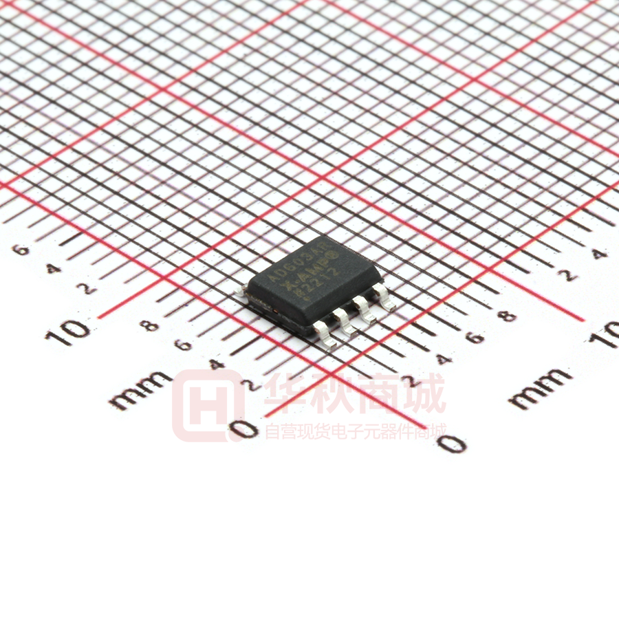

Low Noise, 90 MHz Variable Gain Amplifier AD603 FEATURES Linear-in-dB gain control Pin-programmable gain ranges −11 dB to +31 dB with 90 MHz bandwidth 9 dB to 51 dB with 9 MHz bandwidth Any intermediate range, for example −1 dB to +41 dB with 30 MHz bandwidth Bandwidth independent of variable gain 1.3 nV/√Hz input noise spectral density ±0.5 dB typical gain accuracy The decibel gain is linear in dB, accurately calibrated, and stable over temperature and supply. The gain is controlled at a high impedance (50 MΩ), low bias (200 nA) differential input; the scaling is 25 mV/dB, requiring a gain control voltage of only 1 V to span the central 40 dB of the gain range. An overrange and underrange of 1 dB is provided whatever the selected range. The gain control response time is less than 1 μs for a 40 dB change. The differential gain control interface allows the use of either differential or single-ended positive or negative control voltages. Several of these amplifiers may be cascaded and their gain control gains offset to optimize the system SNR. The AD603 can drive a load impedance as low as 100 Ω with low distortion. For a 500 Ω load in shunt with 5 pF, the total harmonic distortion for a ±1 V sinusoidal output at 10 MHz is typically −60 dBc. The peak specified output is ±2.5 V minimum into a 500 Ω load. The AD603 uses a patented proprietary circuit topology—the X-AMP®. The X-AMP comprises a variable attenuator of 0 dB to −42.14 dB followed by a fixed-gain amplifier. Because of the attenuator, the amplifier never has to cope with large inputs and can use negative feedback to define its (fixed) gain and dynamic performance. The attenuator has an input resistance of 100 Ω, laser trimmed to ±3%, and comprises a 7-stage R-2R ladder network, resulting in an attenuation between tap points of 6.021 dB. A proprietary interpolation technique provides a continuous gain control function that is linear in dB. The AD603 is specified for operation from −40°C to +85°C. APPLICATIONS RF/IF AGC amplifiers Video gain controls A/D range extensions Signal measurements GENERAL DESCRIPTION The AD603 is a low noise, voltage-controlled amplifier for use in RF and IF AGC systems. It provides accurate, pin-selectable gains of −11 dB to +31 dB with a bandwidth of 90 MHz or +9 dB to 51+ dB with a bandwidth of 9 MHz. Any intermediate gain range may be arranged using one external resistor. The input referred noise spectral density is only 1.3 nV/√Hz, and power consumption is 125 mW at the recommended ±5 V supplies. FUNCTIONAL BLOCK DIAGRAM VPOS 8 VNEG 6 GPOS 1 VG GNEG 2 SCALING REFERENCE PRECISION PASSIVE INPUT ATTENUATOR FIXED-GAIN AMPLIFIER 7 VOUT GAINCONTROL INTERFACE AD603 6.44k Ω* 5 FDBK 694 Ω* 0dB VINP 3 R –6.02dB R –12.04dB –18.06dB –24.08dB R R R –30.1dB R –36.12dB –42.14dB R 20Ω* 2R 2R 2R 2R 2R 2R R COMM 4 R-2R LADDER NETWORK 00539-001 *NOMINAL VALUES. Figure 1. Rev. H Information furnished by Analog Devices is believed to be accurate and reliable. However, no responsibility is assumed by Analog Devices for its use, nor for any infringements of patents or other rights of third parties that may result from its use. Specifications subject to change without notice. No license is granted by implication or otherwise under any patent or patent rights of Analog Devices. Trademarks and registered trademarks are the property of their respective owners. One Technology Way, P.O. Box 9106, Norwood, MA 02062-9106, U.S.A. Tel: 781.329.4700 www.analog.com Fax: 781.461.3113 ©2007 Analog Devices, Inc. All rights reserved. AD603 TABLE OF CONTENTS Features .............................................................................................. 1 Applications....................................................................................... 1 General Description ......................................................................... 1 Functional Block Diagram .............................................................. 1 Revision History ............................................................................... 2 Specifications..................................................................................... 3 Absolute Maximum Ratings............................................................ 4 ESD Caution.................................................................................. 4 Pin Configurations and Function Descriptions ........................... 5 Typical Performance Characteristics ............................................. 6 Theory of Operation ...................................................................... 11 Noise Performance ..................................................................... 11 The Gain Control Interface....................................................... 12 Programming the Fixed-Gain Amplifier Using Pin Strapping............................................................................... 12 Using the AD603 in Cascade ........................................................ 14 Sequential Mode (Optimal SNR) ............................................. 14 Parallel Mode (Simplest Gain Control Interface) .................. 16 Low Gain Ripple Mode (Minimum Gain Error) ................... 16 Applications Information .............................................................. 17 A Low Noise AGC Amplifier.................................................... 17 Caution ........................................................................................ 18 Evaluation Board ............................................................................ 19 Outline Dimensions ....................................................................... 21 Ordering Guide .......................................................................... 21 REVISION HISTORY 5/07—Rev. G to Rev. H Changes to Layout ...........................................................................14 Changes to Layout ...........................................................................15 Changes to Layout ...........................................................................16 Inserted Evaluation Board Section, and Figure 48 to Figure 51 ...........................................................................................19 Inserted Figure 52 and Table 4.......................................................20 Changes to Ordering Guide ...........................................................21 3/05—Rev. F to Rev. G Updated Format.................................................................. Universal Change to Features ............................................................................1 Changes to General Description .....................................................1 Change to Figure 1 ............................................................................1 Changes to Specifications .................................................................3 New Figure 4 and Renumbering Subsequent Figures...................6 Change to Figure 10 ..........................................................................7 Change to Figure 23 ..........................................................................9 Change to Figure 29 ........................................................................12 Updated Outline Dimensions ........................................................20 4/04—Rev. E to Rev. F Changes to Specifications.................................................................2 Changes to Ordering Guide .............................................................3 8/03—Rev. D to Rev E Updated Format.................................................................. Universal Changes to Specifications.................................................................2 Changes to TPCs 2, 3, 4 ....................................................................4 Changes to Sequential Mode (Optimal S/N Ratio) section.........9 Change to Figure 8 ..........................................................................10 Updated Outline Dimensions........................................................14 Rev. H | Page 2 of 24 AD603 SPECIFICATIONS @ TA = 25°C, VS = ±5 V, –500 mV ≤ VG ≤ +500 mV, GNEG = 0 V, –10 dB to +30 dB gain range, RL = 500 Ω, and CL = 5 pF, unless otherwise noted. Table 1. Parameter INPUT CHARACTERISTICS Input Resistance Input Capacitance Input Noise Spectral Density 1 Noise Figure 1 dB Compression Point Peak Input Voltage OUTPUT CHARACTERISTICS −3 dB Bandwidth Slew Rate Peak Output 2 Output Impedance Output Short-Circuit Current Group Delay Change vs. Gain Group Delay Change vs. Frequency Differential Gain Differential Phase Total Harmonic Distortion Third-Order Intercept ACCURACY Gain Accuracy, f = 100 kHz; Gain (dB) = (40 VG + 10) dB TMIN to TMAX Gain, f = 10.7 MHz Conditions Pin 3 to Pin 4 Input short-circuited f = 10 MHz, gain = maximum, RS = 10 Ω f = 10 MHz, gain = maximum, RS = 10 Ω Min 97 Typ 100 2 1.3 8.8 −11 ±1.4 90 275 ±3.0 2 50 ±2 ±2 0.2 0.2 −60 15 ±0.5 −9.0 +10.5 +30.3 +1 +1.5 −8.0 +11.5 +31.3 +20 +30 +20 +30 40.6 42 39.9 +2.0 Max 103 Unit Ω pF nV/√Hz dB dBm V MHz V/μs V Ω mA ns ns % Degree dBc dBm dB dB dB dB dB mV mV mV mV dB/V dB/V dB/V V nA nA MΩ dB/μs V mA mA ±2 VOUT = 100 mV rms RL ≥ 500 Ω RL ≥ 500 Ω f ≤ 10 MHz f = 3 MHz; full gain range VG = 0 V; f = 1 MHz to 10 MHz ±2.5 f = 10 MHz, VOUT = 1 V rms f = 40 MHz, gain = maximum, RS = 50 Ω −500 mV ≤ VG ≤ +500 mV VG = -0.5 V VG = 0.0 V VG = 0.5 V VG = 0 V −500 mV ≤ VG ≤ +500 mV −1 −1.5 −10.3 +9.5 +29.3 −20 −30 −20 −30 39.4 38 38.7 −1.2 Output Offset Voltage 3 TMIN to TMAX Output Offset Variation vs. VG TMIN to TMAX GAIN CONTROL INTERFACE Gain Scaling Factor TMIN to TMAX GNEG, GPOS Voltage Range 4 Input Bias Current Input Offset Current Differential Input Resistance Response Rate POWER SUPPLY Specified Operating Range Quiescent Current TMIN to TMAX 1 100 kHz 10.7 MHz 40 39.3 200 10 50 80 Pin 1 to Pin 2 Full 40 dB gain change ±4.75 12.5 ±6.3 17 20 Typical open or short-circuited input; noise is lower when system is set to maximum gain and input is short-circuited. This figure includes the effects of both voltage and current noise sources. 2 Using resistive loads of 500 Ω or greater or with the addition of a 1 kΩ pull-down resistor when driving lower loads. 3 The dc gain of the main amplifier in the AD603 is ×35.7; therefore, an input offset of 100 μV becomes a 3.57 mV output offset. 4 GNEG and GPOS, gain control, and voltage range are guaranteed to be within the range of −VS + 4.2 V to +VS − 3.4 V over the full temperature range of −40°C to +85°C. Rev. H | Page 3 of 24 AD603 ABSOLUTE MAXIMUM RATINGS Table 2. Parameter Supply Voltage ±VS Internal Voltage VINP (Pin 3) GPOS, GNEG (Pin 1 and Pin2) Internal Power Dissipation Operating Temperature Range AD603A AD603S Storage Temperature Range Lead Temperature (Soldering, 60 sec) Rating ±7.5 V ±2 V Continuous ±VS for 10 ms ±VS 400 mW −40°C to +85°C −55°C to +125°C −65°C to +150°C 300°C Table 3. Thermal Characteristics Package Type 8-Lead SOIC 8-Lead CERDIP θJA 155 140 θJC 33 15 Unit °C/W °C/W ESD CAUTION Stresses above those listed under Absolute Maximum Ratings may cause permanent damage to the device. This is a stress rating only; functional operation of the device at these or any other conditions above those indicated in the operational section of this specification is not implied. Exposure to absolute maximum rating conditions for extended periods may affect device reliability. Rev. H | Page 4 of 24 AD603 PIN CONFIGURATIONS AND FUNCTION DESCRIPTIONS GPOS 1 GNEG 2 VINP 3 8 VPOS VOUT 00539-002 GPOS 1 GNEG 2 VINP 3 AD603 7 Figure 2. 8-Lead SOIC Pin Configuration Figure 3. 8-Lead CERDIP Pin Configuration Table 4. Pin Function Descriptions Pin No. 1 2 3 4 5 6 7 8 Mnemonic GPOS GNEG VINP COMM FDBK VNEG VOUT VPOS Description Gain Control Input High (Positive Voltage Increases Gain). Gain Control Input Low (Negative Voltage Increases Gain). Amplifier Input. Amplifier Ground. Connection to Feedback Network. Negative Supply Input. Amplifier Output. Positive Supply Input. Rev. H | Page 5 of 24 00539-003 6 VNEG TOP VIEW COMM 4 (Not to Scale) 5 FDBK VOUT TOP VIEW 6 VNEG (Not to Scale) 5 FDBK COMM 4 7 AD603 8 VPOS AD603 TYPICAL PERFORMANCE CHARACTERISTICS @ TA = 25°C, VS = ±5 V, –500 mV ≤ VG ≤ +500 mV, GNEG = 0 V, –10 dB to +30 dB gain range, RL = 500 Ω, and CL = 5 pF, unless otherwise noted. 40 4 3 225 180 135 90 45 0 PHASE –45 –90 –135 –180 1M 10M FREQUENCY (Hz) 100M 00539-007 30 2 1 20 0 GAIN (dB) 10.7MHz –1 –2 –3 –4 –5 10 100kHz 0 –0.4 –0.2 0 VG (V) 0.2 0.4 0.6 Figure 4. Gain vs. VG at 100 kHz and 10.7 MHz 2.5 2.0 1.5 GAIN ERROR (dB) 00539-004 –10 –0.6 –6 100k –225 Figure 7. Frequency and Phase Response vs. Gain (Gain = 10 dB, PIN = −30 dBm) 4 225 180 135 90 45 PHASE 0 –45 –90 –135 –180 1M 10M FREQUENCY (Hz) 100M 00539-008 45MHz 3 2 1 0.5 0 –0.5 70MHz –1.0 00539-005 GAIN (dB) 10.7MHz 0 –1 –2 –3 –4 –5 455kHz –1.5 –0.5 –0.4 –0.3 –0.2 –0.1 0 0.1 0.2 GAIN VOLTAGE (V) 0.3 0.4 0.5 –6 100k –225 Figure 5. Gain Error vs. Gain Control Voltage at 455 kHz, 10.7 MHz, 45 MHz, 70 MHz 4 3 2 1 0 GAIN (dB) Figure 8. Frequency and Phase Response vs. Gain (Gain = 30 dB, PIN = −30 dBm) 225 180 135 90 45 0 –45 –90 –135 –180 00539-006 7.6 7.4 –1 –2 –3 –4 –5 –6 100k PHASE (Degrees) GAIN GROUP DELAY (ns) 7.2 PHASE 7.0 6.8 6.6 1M 10M FREQUENCY (Hz) 100M –0.4 –0.2 0 0.2 GAIN CONTROL VOLTAGE (V) 0.4 0.6 Figure 6. Frequency and Phase Response vs. Gain (Gain = −10 dB, PIN = −30 dBm) Figure 9. Group Delay vs. Gain Control Voltage Rev. H | Page 6 of 24 00539-009 –225 6.4 –0.6 PHASE (Degrees) 1.0 70MHz GAIN PHASE (Degrees) GAIN GAIN (dB) AD603 –1.0 –1.2 –1.4 +5V HP3326A DUALCHANNEL SYNTHESIZER 100Ω 4 8 3 5 7 0.1µF NEGATIVE OUTPUT VOLTAGE (V) 00539-010 –1.6 –1.8 –2.0 –2.2 –2.4 –2.6 –2.8 –3.0 –3.2 0 50 100 200 500 1000 LOAD RESISTANCE ( Ω) 2000 00539-013 AD603 1 2 10× PROBE 511Ω HP3585A SPECTRUM ANALYZER 6 0.1µF –5V DATEL DVC 8500 –3.4 Figure 10. Third-Order Intermodulation Distortion Test Setup Figure 13. Typical Output Voltage Swing vs. Load Resistance (Negative Output Swing Limits First) 102 10dB/DIV INPUT IMPEDANCE (Ω) 00539-011 100 98 96 94 100k 1M 10M FREQUENCY (Hz) 100M 00539-014 00539-015 Figure 11. Third-Order Intermodulation Distortion at 455 kHz (10× Probe Used to HP3585A Spectrum Analyzer, Gain = 0 dB, PIN = 0 dBm) Figure 14. Input Impedance vs. Frequency (Gain = −10 dB) 102 10dB/DIV INPUT IMPEDANCE (Ω) 00539-012 100 98 96 94 100k 1M 10M FREQUENCY (Hz) 100M Figure 12. Third-Order Intermodulation Distortion at 10.7 MHz (10× Probe Used to HP3585A Spectrum Analyzer, Gain = 0 dB, PIN = 0 dBm) Figure 15. Input Impedance vs. Frequency (Gain = 10 dB) Rev. H | Page 7 of 24 AD603 3V 102 INPUT IMPEDANCE (Ω) 100 INPUT GND 100MV/DIV 98 1V OUTPUT GND 1V/DIV 96 94 00539-016 100k 1M 10M FREQUENCY (Hz) 100M 50ns 451ns Figure 16. Input Impedance vs. Frequency (Gain = 30 dB) Figure 19. Output Stage Overload Recovery Time (Input Is 500 ns Period, 50% Duty-Cycle Square Wave, Output Is Captured Using Tektronix 11402 Digitizing Oscilloscope) 3.5V 1V 100 90 INPUT 500mV/DIV GND 500mV OUTPUT 500mV/DIV GND 10 0% 00539-017 1V 200ns 50ns 456ns Figure 17. Gain Control Channel Response Time Figure 20. Transient Response, G = 0 dB (Input Is 500 ns Period, 50% Duty-Cycle Square Wave, Output Is Captured Using Tektronix 11402 Digitizing Oscilloscope) 3.5V 4.5V INPUT GND 1V/DIV INPUT GND 100mV/DIV 500mV 500mV OUTPUT GND 500mV/DIV OUTPUT GND 500mV/DIV 00539-018 50ns 451ns 50ns 456ns Figure 18. Input Stage Overload Recovery Time (Input Is 500 ns Period, 50% Duty-Cycle Square Wave, Output Is Captured Using Tektronix 11402 Digitizing Oscilloscope) Figure 21. Transient Response, G = 20 dB (Input Is 500 ns Period, 50% Duty-Cycle Square Wave, Output Is Captured Using Tektronix 11402 Digitizing Oscilloscope) Rev. H | Page 8 of 24 00539-021 –500mV –49ns –1.5V –44ns 00539-020 –1.5V –44ns 00539-019 –2V –49ns AD603 21 0 –10 17 –20 NOISE FIGURE (dB) PSRR (dB) 19 10MHz TA = 25°C RS = 50Ω TEST SETUP FIGURE 23 –30 –40 –50 –60 15 13 11 9 7 20MHz 100k 1M 10M FREQUENCY (Hz) 100M 31 32 33 34 35 36 GAIN (dB) 37 38 39 40 Figure 22. PSRR vs. Frequency (Worst Case Is Negative Supply PSRR, Shown Here) 0 Figure 25. Noise Figure in 0 dB/40 dB Mode TA = 25°C TEST SETUP FIGURE 23 –5 INPUT LEVEL (dBm) +5V HP3326A DUALCHANNEL SYNTHESIZER 100 Ω 4 8 3 0.1µF –10 AD603 1 5 7 50Ω 2 HP3585A SPECTRUM ANALYZER –15 6 –20 0.1µF 00539-023 –5V DATEL DVC 8500 30 50 INPUT FREQUENCY (MHz) 70 Figure 23. Test Setup Used for: Noise Figure, Third-Order Intercept, and 1 dB Compression Point Measurements 23 21 19 NOISE FIGURE (dB) Figure 26. 1 dB Compression Point, −10 dB/+30 dB Mode, Gain = 30 dB 20 70MHz TA = 25°C RS = 50V TEST SETUP FIGURE 23 TA = 25°C TEST SETUP FIGURE 23 30MHz 18 17 50MHz 15 13 30MHz 11 9 10MHz OUTPUT LEVEL (dBm) 16 40MHz 14 12 70MHz 10 7 00539-024 00539-027 5 20 21 22 23 24 25 26 GAIN (dB) 27 28 29 30 0 –20 –10 INPUT LEVEL (dBm) 0 Figure 24. Noise Figure in −10 dB/+30 dB Mode Figure 27. Third-Order Intercept −10 dB/+30 dB Mode, Gain = 10 dB Rev. H | Page 9 of 24 00539-026 –25 10 00539-025 00539-022 5 30 AD603 20 TA = 25°C RS = 50Ω RIN = 50Ω RL = 100Ω TEST SETUP FIGURE 23 18 30MHz OUTPUT LEVEL (dBm) 16 40MHz 14 12 70MHz 10 –30 INPUT LEVEL (dBm) –20 Figure 28. Third-Order Intercept −10 dB/+30 dB Mode, Gain = 30 dB 00539-028 8 –40 Rev. H | Page 10 of 24 AD603 THEORY OF OPERATION The AD603 comprises a fixed-gain amplifier, preceded by a broadband passive attenuator of 0 dB to 42.14 dB, having a gain control scaling factor of 40 dB per volt. The fixed gain is lasertrimmed in two ranges, to either 31.07 dB (×35.8) or 50 dB (×358), or it may be set to any range in between using one external resistor between Pin 5 and Pin 7. Somewhat higher gain can be obtained by connecting the resistor from Pin 5 to common, but the increase in output offset voltage limits the maximum gain to about 60 dB. For any given range, the bandwidth is independent of the voltage-controlled gain. This system provides an underrange and overrange of 1.07 dB in all cases; for example, the overall gain is −11.07 dB to +31.07 dB in the maximum bandwidth mode (Pin 5 and Pin 7 strapped). This X-AMP structure has many advantages over former methods of gain control based on nonlinear elements. Most importantly, the fixed-gain amplifier can use negative feedback to increase its accuracy. Because large inputs are first attenuated, the amplifier input is always small. For example, to deliver a ±1 V output in the −1 dB/+41 dB mode (that is, using a fixed amplifier gain of 41.07 dB), its input is only 8.84 mV; therefore, the distortion can be very low. Equally important, the smallsignal gain and phase response, and thus the pulse response, are essentially independent of gain. Figure 29 is a simplified schematic. The input attenuator is a 7-section R-2R ladder network, using untrimmed resistors of nominally R = 62.5 Ω, which results in a characteristic resistance of 125 Ω ± 20%. A shunt resistor is included at the input and laser trimmed to establish a more exact input resistance of 100 Ω ± 3%, which ensures accurate operation (gain and HP corner frequency) when used in conjunction with external resistors or capacitors. The nominal maximum signal at input VINP is 1 V rms (±1.4 V peak) when using the recommended ±5 V supplies, although operation to ±2 V peak is permissible with some increase in HF distortion and feedthrough. Pin 4 (COMM) must be connected directly to the input ground; significant impedance in this connection reduces the gain accuracy. The signal applied at the input of the ladder network is attenuated by 6.02 dB by each section; therefore, the attenuation to each of the taps is progressively 0 dB, 6.02 dB, 12.04 dB, 18.06 dB, 24.08 dB, 30.1 dB, 36.12 dB, and 42.14 dB. A unique circuit technique is employed to interpolate between these tap points, indicated by the slider in Figure 29, thus providing continuous attenuation from 0 dB to 42.14 dB. It helps in understanding the AD603 to think in terms of a mechanical means for moving this slider from left to right; in fact, its position is controlled by the voltage between Pin 1 and Pin 2. The details of the gain control interface are in the The Gain Control Interface section. The gain is at all times very exactly determined, and a linear-indB relationship is automatically guaranteed by the exponential nature of the attenuation in the ladder network (the X-AMP principle). In practice, the gain deviates slightly from the ideal law, by about ±0.2 dB peak (see, for example, Figure 5). NOISE PERFORMANCE An important advantage of the X-AMP is its superior noise performance. The nominal resistance seen at inner tap points is 41.7 Ω (one third of 125 Ω), which exhibits a Johnson noise spectral density (NSD) of 0.83 nV/√Hz (that is, √4kTR) at 27°C, which is a large fraction of the total input noise. The first stage of the amplifier contributes a further 1 nV/√Hz, for a total input noise of 1.3 nV/√Hz. It is apparent that it is essential to use a low resistance in the ladder network to achieve the very low specified noise level. The source impedance of the signal forms a voltage divider with the 100 Ω input resistance of the AD603. In some applications, the resulting attenuation may be unacceptable, requiring the use of an external buffer or preamplifier to match a high impedance source to the low impedance AD603. The noise at maximum gain (that is, at the 0 dB tap) depends on whether the input is short-circuited or open-circuited. When short-circuited, the minimum NSD of slightly over 1 nV/√Hz is achieved. When open-circuited, the resistance of 100 Ω looking into the first tap generates 1.29 nV/√Hz, so the noise increases to 1.63 nV/√Hz. (This last calculation would be important if the AD603 were preceded by, for example, a 900 Ω resistor to allow operation from inputs up to 10 V rms.) As the selected tap moves away from the input, the dependence of the noise on source impedance quickly diminishes. Apart from the small variations just discussed, the signal-tonoise (SNR) at the output is essentially independent of the attenuator setting. For example, on the −11 dB/+31 dB range, the fixed gain of ×35.8 raises the output NSD to 46.5 nV/√Hz. Therefore, for the maximum undistorted output of 1 V rms and a 1 MHz bandwidth, the output SNR would be 86.6 dB, that is, 20 log(1 V/46.5 μV). Rev. H | Page 11 of 24 AD603 VPOS 8 VNEG 6 GPOS 1 VG GNEG 2 GAINCONTROL INTERFACE SCALING REFERENCE PRECISION PASSIVE INPUT ATTENUATOR FIXED-GAIN AMPLIFIER 7 VOUT AD603 6.44k Ω* 5 FDBK 694 Ω* 0dB VINP 3 R –6.02dB R –12.04dB –18.06dB –24.08dB R R R –30.1dB R –36.12dB –42.14dB R 20Ω* 2R 2R 2R 2R 2R 2R R COMM 4 R-2R LADDER NETWORK 00539-029 *NOMINAL VALUES. Figure 29. Simplified Block Diagram THE GAIN CONTROL INTERFACE The attenuation is controlled through a differential, high impedance (50 MΩ) input, with a scaling factor that is lasertrimmed to 40 dB per volt, that is, 25 mV/dB. An internal band gap reference ensures stability of the scaling with respect to supply and temperature variations. When the differential input voltage VG = 0 V, the attenuator slider is centered, providing an attenuation of 21.07 dB. For the maximum bandwidth range, this results in an overall gain of 10 dB (= −21.07 dB + 31.07 dB). When the control input is −500 mV, the gain is lowered by +20 dB (= 0.500 V × 40 dB/V) to −10 dB; when set to +500 mV, the gain is increased by +20 dB to +30 dB. When this interface is overdriven in either direction, the gain approaches either −11.07 dB (= − 42.14 dB + +31.07 dB) or 31.07 dB (= 0 + 31.07 dB), respectively. The only constraint on the gain control voltage is that it be kept within the common-mode range (−1.2 V to +2.0 V assuming +5 V supplies) of the gain control interface. The basic gain of the AD603 can therefore be calculated by Gain (dB) = 40 VG +10 (1) where VG is in volts. When Pin 5 and Pin 7 are strapped (see the Programming the Fixed-Gain Amplifier Using Pin Strapping section), the gain becomes Gain (dB) = 40 VG + 20 for 0 to +40 dB and Gain (dB) = 40 VG + 30 for +10 to +50 dB The high impedance gain control input ensures minimal loading when driving many amplifiers in multiple channel or cascaded applications. The differential capability provides flexibility in choosing the appropriate signal levels and polarities for various control schemes. (2) For example, if the gain is to be controlled by a DAC providing a positive-only, ground-referenced output, the gain control low (GNEG) pin should be biased to a fixed offset of 500 mV to set the gain to −10 dB when gain control high (GPOS) is at zero, and to 30 dB when at 1.00 V. It is a simple matter to include a voltage divider to achieve other scaling factors. When using an 8-bit DAC having an FS output of 2.55 V (10 mV/bit), a divider ratio of 2 (generating 5 mV/bit) results in a gain-setting resolution of 0.2 dB/bit. The use of such offsets is valuable when two AD603s are cascaded, when various options exist for optimizing the signal-to-noise profile, as is shown in the Sequential Mode (Optimal SNR) section, PROGRAMMING THE FIXED-GAIN AMPLIFIER USING PIN STRAPPING Access to the feedback network is provided at Pin 5 (FDBK). The user may program the gain of the output amplifier of the AD603 using this pin, as shown in Figure 30, Figure 31, and Figure 32. There are three modes: in the default mode, FDBK is unconnected, providing the range +9 dB/+51 dB; when VOUT and FDBK are shorted, the gain is lowered to −11 dB/+31 dB; and, when an external resistor is placed between VOUT and FDBK, any intermediate gain can be achieved, for example, −1 dB/+41 dB. Figure 33 shows the nominal maximum gain vs. external resistor for this mode. VC1 VC2 VIN 1 GPOS GNEG VINP COMM VPOS 8 VOUT 7 VNEG 6 FDBK 5 VPOS VOUT VNEG 00539-030 AD603 2 3 4 Figure 30. −10 dB to +30 dB; 90 MHz Bandwidth Rev. H | Page 12 of 24 AD603 VC1 VC2 VIN 1 GPOS GNEG VINP COMM VPOS 8 VOUT 7 VNEG 6 FDBK 5 VPOS VOUT VNEG 2.15k Ω 5.6pF 00539-031 AD603 2 3 Optionally, when a resistor is placed from FDBK to COMM, higher gains can be achieved. This fourth mode is of limited value because of the low bandwidth and the elevated output offsets; it is thus not included in Figure 30, Figure 31, or Figure 32. The gain of this amplifier in the first two modes is set by the ratio of on-chip laser-trimmed resistors. While the ratio of these resistors is very accurate, the absolute value of these resistors can vary by as much as ±20%. Therefore, when an external resistor is connected in parallel with the nominal 6.44 kΩ ± 20% internal resistor, the overall gain accuracy is somewhat poorer. The worst-case error occurs at about 2 kΩ (see Figure 34). 1.2 –1:VdB (OUT) – (–1):VdB (OREF ) 1.0 0.8 00539-032 4 Figure 31. 0 dB to 40 dB; 30 MHz Bandwidth VC1 VC2 VIN 1 GPOS GNEG VINP COMM VPOS 8 VOUT 7 VNEG 6 FDBK 5 VPOS VOUT VNEG AD603 2 3 4 18pF 0.6 GAIN ERROR (dB) 0.4 0.2 0 –0.2 –0.4 –0.6 Figure 32. 10 dB to 50 dB; 9 MHz to Set Gain 52 50 48 46 44 GAIN (dB) –1:VdB (OUT) –2:VdB (OUT) 40 38 36 34 32 100 1k REXT (Ω) 10k 100k 1M 00539-033 100 1k REXT (Ω) 10k 100k 1M Figure 34. Worst-Case Gain Error, Assuming Internal Resistors Have a Maximum Tolerance of −20% (Top Curve) or = 20% (Bottom Curve) 30 10 Figure 33. Gain vs. REXT, Showing Worst-Case Limits Assuming Internal Resistors Have a Maximum Tolerance of 20% While the gain bandwidth product of the fixed-gain amplifier is about 4 GHz, the actual bandwidth is not exactly related to the maximum gain. This is because there is a slight enhancing of the ac response magnitude on the maximum bandwidth range, due to higher order poles in the open-loop gain function; this mild peaking is not present on the higher gain ranges. Figure 30, Figure 31, and Figure 32 show how an optional capacitor may be added to extend the frequency response in high gain modes. Rev. H | Page 13 of 24 00539-034 42 VdB (OUT) –0.8 –1.0 10 VdB (OUT) – VdB (OREF ) AD603 USING THE AD603 IN CASCADE Two or more AD603s can be connected in series to achieve higher gain. Invariably, ac coupling must be used to prevent the dc offset voltage at the output of each amplifier from overloading the following amplifier at maximum gain. The required highpass coupling network is usually just a capacitor, chosen to set the desired corner frequency in conjunction with the welldefined 100 Ω input resistance of the following amplifier. For two AD603s, the total gain control range becomes 84 dB (2 × 42.14 dB); the overall −3 dB bandwidth of cascaded stages is somewhat reduced. Depending on the pin strapping, the gain and bandwidth for two cascaded amplifiers can range from −22 dB to +62 dB (with a bandwidth of about 70 MHz) to +22 dB to +102 dB (with a bandwidth of about 6 MHz). There are several ways of connecting the gain control inputs in cascaded operation. The choice depends on whether it is important to achieve the highest possible instantaneous signalto-noise ratio (ISNR), or, alternatively, to minimize the ripple in the gain error. The following examples feature the AD603 programmed for maximum bandwidth; the explanations apply to other gain/bandwidth combinations with appropriate changes to the arrangements for setting the maximum gain. Figure 35 shows the SNR over a gain range of −22 dB to +62 dB, assuming an output of 1 V rms and a 1 MHz bandwidth. Figure 36, Figure 37, and Figure 38 show the general connections to accomplish this. Here, both the positive gain control inputs (GPOS) are driven in parallel by a positive-only, ground-referenced source with a range of 0 V to 2 V, while the negative gain control inputs (GNEG) are biased by stable voltages to provide the needed gain offsets. These voltages may be provided by resistive dividers operating from a common voltage reference. 90 85 80 75 SNR (dB) 70 65 60 55 00539-035 SEQUENTIAL MODE (OPTIMAL SNR) In the sequential mode of operation, the ISNR is maintained at its highest level for as much of the gain control range as possible. A1 –40.00dB –8.93dB 50 –0.2 0.2 0.6 1.0 VC (V) 1.4 1.8 2.2 Figure 35. SNR vs. Control Voltage, Sequential Control (1 MHz Bandwidth) A2 –51.07dB INPUT 0dB –42.14dB GPOS VG1 GNEG 31.07dB –42.14dB GPOS VG2 GNEG 31.07dB VC = 0V VO1 = 0.473V VO2 = 1.526V Figure 36. AD603 Gain Control Input Calculations for Sequential Control Operation VC = 0 V 0dB 31.07dB –11.07dB INPUT 0dB 0dB GPOS VG1 GNEG 31.07dB –42.14dB GPOS VG2 GNEG 31.07dB VC = 1.0V VO1 = 0.473V VO2 = 1.526V Figure 37. AD603 Gain Control Calculations for Sequential Control Operation VC = 1.0 V 0dB 31.07dB –28.93dB INPUT 0dB 0dB GPOS VG1 GNEG 31.07dB –2.14dB GPOS VG2 GNEG 31.07dB VC = 2.0V VO1 = 0.473V VO2 = 1.526V Figure 38. AD603 Gain Control Input Calculations for Sequential Operation VC = 2.0 V Rev. H | Page 14 of 24 00539-038 OUTPUT 60dB 00539-037 OUTPUT 20dB 00539-036 OUTPUT –20dB AD603 The gains are offset (Figure 39) such that the gain of A2 is increased only after the gain of A1 has reached its maximum value. Note that for a differential input of –600 mV or less, the gain of a single amplifier (A1 or A2) is at its minimum value of −11.07 dB; for a differential input of 600 mV or more, the gain is at its maximum value of 31.07 dB. Control inputs beyond these limits do not affect the gain and can be tolerated without damage or foldover in the response. This is an important aspect of the gain control response of the AD603. (See the Specifications section for more details on the allowable voltage range.) The gain is now Gain (dB) = 40 VG + GO where: VG is the applied control voltage. GO is determined by the gain range chosen. In the explanatory notes that follow, it is assumed that the maximum bandwidth connections are used, for which GO is −20 dB. +31.07dB +31.07dB +10dB –8.93dB +28.96dB Figure 41 is a plot of the SNR of the cascaded amplifiers vs. the control voltage. Figure 42 is a plot of the gain error of the cascaded stages vs. the control voltages. 70 60 50 OVERALL GAIN (dB) COMBINED 40 30 20 10 0 –10 –20 0.2 0.6 1.0 VC (V) 1.4 1.8 2.0 00539-040 00539-042 00539-041 A1 (3) A2 –30 –0.2 Figure 40. Plot of Separate and Overall Gains in Sequential Control 90 80 A1 * –11.07dB * A2 70 60 –11.07dB 0.473 GAIN (dB) –22.14 0 –20 0.5 0 1.0 20 1.526 1.50 40 2.0 60 VC (V) 62.14 SNR (dB) 00539-039 50 40 30 20 10 –0.2 *GAIN OFFSET OF 1.07dB, OR 26.75mV. Figure 39. Explanation of Offset Calibration for Sequential Control GAIN ERROR (dB) With reference to Figure 36, Figure 37, and Figure 38, note that VG1 refers to the differential gain control input to A1, and VG2 refers to the differential gain control input to A2. When VG is 0 V, VG1 = −473 mV and thus the gain of A1 is −8.93 dB (recall that the gain of each individual amplifier in the maximum bandwidth mode is –10 dB for VG = −500 mV and 10 dB for VG = 0 V); meanwhile, VG2 = −1.908 V so the gain of A2 is pinned at −11.07 dB. The overall gain is therefore –20 dB (see Figure 36). When VG = 1.00 V, VG1 = 1.00 V − 0.473 V = 0.526 V, which sets the gain of A1 to nearly its maximum value of +31.07 dB, while VG2 = 1.00 V − 1.526 V = 0.526 V, which sets the gain of A2 to nearly its minimum value of −11.07 dB. Close analysis shows that the degree to which neither AD603 is completely pushed to its maximum nor minimum gain exactly cancels in the overall gain, which is now 20 dB (see Figure 37). When VG = 2.0 V, the gain of A1 is pinned at 31.07 dB and that of A2 is near its maximum value of 28.93 dB, resulting in an overall gain of 60 dB (see Figure 38). This mode of operation is further clarified in Figure 40, which is a plot of the separate gains of A1 and A2 and the overall gain vs. the control voltage. 0.2 0.6 1.0 VC (V) 1.4 1.8 2.0 Figure 41. SNR for Cascaded Stages—Sequential Control 2.0 1.5 1.0 0.5 0 –0.5 –1.0 –1.5 –2.0 –0.2 0 0.2 0.4 0.6 0.8 1.0 1.2 VC (V) 1.4 1.6 1.8 2.0 2.2 Figure 42. Gain Error for Cascaded Stages–Sequential Control Rev. H | Page 15 of 24 AD603 PARALLEL MODE (SIMPLEST GAIN CONTROL INTERFACE) In this mode, the gain control of voltage is applied to both inputs in parallel: the GPOS pins of both A1 and A2 are connected to the control voltage and the GNEW inputs are grounded. The gain scaling is then doubled to 80 dB/V, requiring only a 1.00 V change for an 80 dB change of gain Gain = (dB) = 80 VG + GO (4) where, as before, GO depends on the range selected; for example, in the maximum bandwidth mode, GO is 20 dB. Alternatively, the GNEG pins may be connected to an offset voltage of 0.500 V, in which case GO is −20 dB. The amplitude of the gain ripple in this case is also doubled, as shown in Figure 43, while the ISNR at the output of A2 now decreases linearly as the gain increases, as shown in Figure 44. 2.0 1.5 1.0 GAIN ERROR (dB) LOW GAIN RIPPLE MODE (MINIMUM GAIN ERROR) As can be seen in Figure 42 and Figure 43, the error in the gain is periodic, that is, it shows a small ripple. (Note that there is also a variation in the output offset voltage, which is due to the gain interpolation, but this is not exact in amplitude.) By offsetting the gains of A1 and A2 by half the period of the ripple, that is, by 3 dB, the residual gain errors of the two amplifiers can be made to cancel. Figure 45 shows much lower gain ripple when configured in this manner. Figure 46 plots the ISNR as a function of gain; it is very similar to that in the parallel mode. 3.0 2.5 2.0 1.5 GAIN ERROR (dB) 1.0 0.5 0 –0.5 –1.0 –1.5 –2.0 0.5 0 –0.5 –1.0 –1.5 00539-043 –2.5 0 0.1 0.2 0.3 0.4 0.5 0.6 VC (V) 0.7 0.8 0.9 1.0 1.1 00539-045 00539-046 –3.0 –0.1 Figure 45. Gain Error for Cascaded Stages—Low Ripple Mode 90 85 0 0.2 0.4 0.6 0.8 1.0 1.2 VC (V) 1.4 1.6 1.8 2.0 2.2 80 75 ISNR (dB) –2.0 –0.2 Figure 43. Gain Error for Cascaded Stages—Parallel Control 90 85 80 75 ISNR (dB) 70 65 60 55 50 –0.2 70 65 60 55 00539-044 0 0.2 0.4 VC (V) 0.6 0.8 1.0 1.2 Figure 46. ISNR vs. Control Voltage—Low Ripple Mode 50 –0.2 0 0.2 0.4 0.6 VC (V) 0.8 1.0 1.2 Figure 44. ISNR for Cascaded Stages—Parallel Control Rev. H | Page 16 of 24 AD603 APPLICATIONS INFORMATION A LOW NOISE AGC AMPLIFIER Figure 47 shows the ease with which the AD603 can be connected as an AGC amplifier. The circuit illustrates many of the points previously discussed: it uses few parts, has linear-indB gain, operates from a single supply, uses two cascaded amplifiers in sequential gain mode for maximum SNR, and an external resistor programs each gain of the amplifier. It also uses a simple temperature-compensated detector. The circuit operates from a single 10 V supply. Resistors R1, R2, R3, and R4 bias the common pins of A1 and A2 at 5 V. The common pin is a low impedance point and must have a low impedance path to ground, provided here by the 100 μF tantalum capacitors and the 0.1 μF ceramic capacitors. The cascaded amplifiers operate in sequential gain. Here, the offset voltage between Pin 2 (GNEG) of A1 and A2 is 1.05 V (42.14 dB × 25 mV/dB), provided by a voltage divider consisting of Resistors R5, R6, and R7. Using standard values, the offset is not exact, but it is not critical for this application. The gain of both A1 and A2 is programmed by Resistors R13 and R14, respectively, to be about 42 dB; therefore, the maximum gain of the circuit is twice that, or 84 dB. The gain control range can be shifted up by as much as 20 dB by appropriate choices of R13 and R14. The circuit operates as follows: • A1 and A2 are cascaded. • Capacitor C1 and the 100 Ω of resistance at the input of A1 form a time constant of 10 μs. • C2 blocks the small dc offset voltage at the output of A1 (which might otherwise saturate A2 at its maximum gain) and introduces a high-pass corner at about 16 kHz, eliminating low frequency noise. A half-wave detector is used, based on Q1 and R8. The current into capacitor, CAV, is the difference between the collector current of Q2 (biased to be 300 μA at 300 K, 27°C) and the collector current of Q1, which increases with the amplitude of the output signal. The automatic gain control voltage, VAGC, is the time integral of this error current. For VAGC (and thus the gain) to remain insensitive to short-term amplitude fluctuations in the output signal, the rectified current in Q1 must, on average, exactly balance the current in Q2. If the output of A2 is too small to do this, VAGC increases, causing the gain to increase until Q1 conducts sufficiently. Consider the case where R8 is zero and the output voltage VOUT is a square wave at, for example, 455 kHz, which is well above the corner frequency of the control loop. 10 V C7 0.1µF C1 0.1µF J1 R T1 100 Ω 10V R1 2.49kΩ C 32 100µF + C4 0.1µF 4 3 THIS CAPACITOR SETS AGC TIME CONSTANT 10V R1 3 2.49kΩ 6 R9 1.54kΩ Q2 2N3906 R1 0 1.24kΩ C11 0.1µF C8 0.1µF C2 0.1µF VAGC 10V R1 4 2.49kΩ 6 8 CAV 0.1µF Q1 2N3904 R8 806 Ω R11 3.83kΩ 5V R1 2 4.99kΩ C9 0.1µF J2 C10 0.1µF A1 AD603 1 5 7 2 8 3 10V R3 2.49kΩ C 52 100µF + C6 0.1µF 4 A2 AD603 1 5 7 2 R2 2.49kΩ R4 2.49kΩ AGC LINE R5 5.49kΩ 5.5V 1V OFFSET FOR SEQUENTIAL GAIN R6 1.05kΩ 6.5V R7 3.48kΩ 10V 1 RT PR OVI D ES A 5 0 Ω I N PU T I MPED A N C E. 2 C 3 A N D C 5 A R E TA NTA LU M. Figure 47. A Low Noise AGC Amplifier Rev. H | Page 17 of 24 00539-047 AD603 During the time VOUT is negative with respect to the base voltage of Q1, Q1 conducts; when VOUT is positive, it is cut off. Because the average collector current of Q1 is forced to be 300 μA, and the square wave has a duty cycle of 1:1, Q1’s collector current when conducting must be 600 μA. With R8 omitted, the peak amplitude of VOUT is forced to be just the VBE of Q1 at 600 μA, typically about 700 mV, or 2 VBE peak-to-peak. This voltage, the amplitude at which the output stabilizes, has a strong negative temperature coefficient (TC), typically −1.7 mV/°C. Although this may not be troublesome in some applications, the correct value of R8 renders the output stable with temperature. To understand this, note that the current in Q2 is made to be proportional to absolute temperature (PTAT). For the moment, continue to assume that the signal is a square wave. When Q1 is conducting, VOUT is now the sum of VBE and a voltage that is PTAT and that can be chosen to have an equal but opposite TC to that of the VBE. This is actually nothing more than an application of the band gap voltage reference principle. When R8 is chosen such that the sum of the voltage across it and the VBE of Q1 is close to the band gap voltage of about 1.2 V, VOUT is stable over a wide range of temperatures, provided, of course, that Q1 and Q2 share the same thermal environment. Because the average emitter current is 600 μA during each half cycle of the square wave, a resistor of 833 Ω adds a PTAT voltage of 500 mV at 300 K, increasing by 1.66 mV/°C. In practice, the optimum value depends on the type of transistor used and, to a lesser extent, on the waveform for which the temperature stability is to be optimized; for the inexpensive 2N3904/2N3906 pair and sine wave signals, the recommended value is 806 Ω. This resistor also serves to lower the peak current in Q1 when more typical signals (usually sinusoidal) are involved, and the 1.8 kHz LP filter it forms with CAV helps to minimize distortion due to ripple in VAGC. Note that the output amplitude under sine wave conditions is higher than for a square wave because the average value of the current for an ideal rectifier is 0.637 times as large, causing the output amplitude to be 1.88 (= 1.2/0.637) V, or 1.33 V rms. In practice, the somewhat nonideal rectifier results in the sine-wave output being regulated to about 1.4 V rms, or 3.6 V p-p. The bandwidth of the circuit exceeds 40 MHz. At 10.7 MHz, the AGC threshold is 100 μV (−67 dBm) and its maximum gain is 83 dB (20 log 1.4 V/100 μV). The circuit holds its output at 1.4 V rms for inputs as low as −67 dBm to +15 dBm (82 dB), where the input signal exceeds the maximum input rating of the AD603. For a 30 dBm input at 10.7 MHz, the second harmonic is 34 dB down from the fundamental, and the third harmonic is 35 dB down from the fundamental. CAUTION Careful component selection, circuit layout, power supply decoupling, and shielding are needed to minimize the susceptibility of the AD603 to interference from signals such as those from radio and TV stations. In bench evaluation, it is recommended to place all of the components into a shielded box and use feedthrough decoupling networks for the supply voltage. Circuit layout and construction are also critical because stray capacitances and lead inductances can form resonant circuits and are a potential source of circuit peaking, oscillation, or both. Rev. H | Page 18 of 24 AD603 EVALUATION BOARD The evaluation board of the AD603 enables simple bench-top experimenting to be performed with easy control of the AD603. Built-in flexibility allows convenient configuration to accommodate most operating configurations. Figure 48 is a photograph of the AD603 evaluation board. The output is also ac-coupled and includes a 453 Ω series resistor. The gain of the AD603 is adjusted by connecting a voltage source between the GNEG and GPOS test loops. A 0 Ω resistor, R5, is provided, permitting ground reference of the differential gain control inputs. For other gain configurations, a signal generator may be connected to the test loops, or the GNEG and/or GPOS pins may be biased. Either pin may be driven to either polarity within the common-mode limits of −1.2 V to +2.0 V; therefore, to invert the gain slope, simply consider the GPOS as the reference and drive the GNEG pin positively with respect to GPOS. The AD603 includes built-in gain resistors selectable at the FDBK pin. The board is shipped with the gain at minimum, with a 0 Ω resistor installed in R3. For maximum gain, simply remove R3. Because of the architecture of the AD603, the bandwidth decreases by 10, but the gain range remains at 40 dB. Intermediate gain values may be selected by installing a resistor between the VOUT and FDBK pins. Figure 50, Figure 51, and Figure 52 show the component and circuit side copper patterns and silkscreen. A bill of materials is shown in Table 5. Figure 48. AD603 Evaluation Board Any dual-polarity power supply capable of providing 20 mA is all that is required, in addition to whatever test equipment the user wishes to perform the intended tests. Referring to the schematic in Figure 49, the input to the VGA is single-ended, ac-coupled, and terminated in 50 Ω to accommodate most commonly available signal generators. V+ V– G1 G2 GND G3 G4 C7 10µF 25V + + V+ V– V+ C8 10µF 25V V+ GPOS C1 0.1µF R1 R7 C2 0.1µF R6 1 2 VO GNEG C4 R5 0Ω AD603 GPOS GNEG VINP COMM VPOS VOUT VNEG FDBK 8 7 6 5 C9 C6 0.1µF R3 0Ω R4 453Ω W1 00539-048 C5 0.1µF 3 4 Figure 50. Component Side Copper VIN W2 R2 100Ω V– 00539-049 C3 0.1µF Figure 49. Schematic of the AD603 Evaluation Board Figure 51. Circuit Side Copper Rev. H | Page 19 of 24 00539-051 00539-050 VOUT AD603 G1 G4 + C7 V+ GND V– C8 GPOS C1 R1 R7 C2 + R3 C6 VO GNEG W2 R5 C4 VIN R6 C5 R2 C9 DUT C3 W1 R4 VOUT Pb G2 00539-052 AD603ARZ EVALUATION BOARD G3 RoHS Figure 52. Component Side Silk Screen Table 5. Bill of Materials Qty 5 2 1 5 3 1 2 1 1 1 2 2 Name Capacitors Capacitors IC Test Loops Test Loops Resistor Resistors Resistor Test Loop Test Loop Connectors Headers Description 0.1 μF, 16 V, 0603, X7R 10 μF, 25 V, C size tantalum Variable gain amplifier 0.125” diameter, black 0.125” diameter, purple 100 Ω, 1%, 1/16 W, 0603 0 Ω, 5%, 1/10 W, 0603 453 Ω, 1/16 W, 1%, 0603 0.125” diameter, red 0.125” diameter, green SMA female PC mount, RA 2-pin 025" sq., 0.1" spacing Not inserted Reference Designator C1, C2, C3, C5, C6 C7, C8 DUT G1, G2, G3, G4, GND GNEG, GPOS, VO R2 R3, R5 R4 +5V −5 V VIN, VOUT W1, W2 C4, C9, R1, R6, R7 Manufacturer KEMET Nichicon Analog Devices, Inc. Components Corp. Components Corp. Panasonic Panasonic Panasonic Components Corp. Components Corp. Amphenol Molex Mfg Part Number C0603C104K4RACTU F931E106MCC AD603ARZ TP-104-01-00 TP-104-01-07 ERJ-3EKF1000V ERJ-2GE0R00X ERJ-3EKF4530V TP-104-01-02 TP-104-01-05 901-143-6RFX 22-11-2032 Rev. H | Page 20 of 24 AD603 OUTLINE DIMENSIONS 0.005 (0.13) MIN 8 0.055 (1.40) MAX 5 0.310 (7.87) 0.220 (5.59) 1 4 0.100 (2.54) BSC 0.405 (10.29) MAX 0.200 (5.08) MAX 0.200 (5.08) 0.125 (3.18) 0.023 (0.58) 0.014 (0.36) 0.070 (1.78) 0.030 (0.76) 0.060 (1.52) 0.015 (0.38) 0.150 (3.81) MIN SEATING PLANE 15° 0° 0.015 (0.38) 0.008 (0.20) 0.320 (8.13) 0.290 (7.37) CONTROLLING DIMENSIONS ARE IN INCHES; MILLIMETER DIMENSIONS (IN PARENTHESES) ARE ROUNDED-OFF INCH EQUIVALENTS FOR REFERENCE ONLY AND ARE NOT APPROPRIATE FOR USE IN DESIGN. Figure 53. 8-Lead Ceramic Dual In-Line Package [CERDIP] (Q-8) Dimensions shown in inches and (millimeters) 5.00 (0.1968) 4.80 (0.1890) 4.00 (0.1574) 3.80 (0.1497) 8 1 5 4 6.20 (0.2441) 5.80 (0.2284) 1.27 (0.0500) BSC 0.25 (0.0098) 0.10 (0.0040) COPLANARITY 0.10 SEATING PLANE 1.75 (0.0688) 1.35 (0.0532) 0.50 (0.0196) 0.25 (0.0099) 8° 0° 0.25 (0.0098) 0.17 (0.0067) 1.27 (0.0500) 0.40 (0.0157) 45° 0.51 (0.0201) 0.31 (0.0122) COMPLIANT TO JEDEC STANDARDS MS-012-A A CONTROLLING DIMENSIONS ARE IN MILLIMETERS; INCH DIMENSIONS (IN PARENTHESES) ARE ROUNDED-OFF MILLIMETER EQUIVALENTS FOR REFERENCE ONLY AND ARE NOT APPROPRIATE FOR USE IN DESIGN. Figure 54. 8-Lead Standard Small Outline Package [SOIC-N] Narrow Body (R-8) Dimensions shown in millimeters and (inches) ORDERING GUIDE Model AD603AR AD603AR-REEL AD603AR-REEL7 AD603ARZ 1 AD603ARZ-REEL1 AD603ARZ-REEL71 AD603AQ AD603SQ/883B 2 AD603-EVALZ1 AD603ACHIPS 1 2 Temperature Range −40°C to +85°C −40°C to +85°C −40°C to +85°C −40°C to +85°C −40°C to +85°C −40°C to +85°C −40°C to +85°C −55°C to +125°C Package Description 8-Lead SOIC 8-Lead SOIC, 13" Reel 8-Lead SOIC, 7" Reel 8-Lead SOIC 8-Lead SOIC, 13" Reel 8-Lead SOIC, 7" Reel 8-Lead CERDIP 8-Lead CERDIP Evaluation Board DIE 012407-A Package Option R-8 R-8 R-8 R-8 R-8 R-8 Q-8 Q-8 Z = RoHS Compliant Part. Refer to AD603 Military data sheet. Also available as 5962-9457203MPA. Rev. H | Page 21 of 24 AD603 NOTES Rev. H | Page 22 of 24 AD603 NOTES Rev. H | Page 23 of 24 AD603 NOTES ©2007 Analog Devices, Inc. All rights reserved. Trademarks and registered trademarks are the property of their respective owners. C00539-0-5/07(H) T T Rev. H | Page 24 of 24
