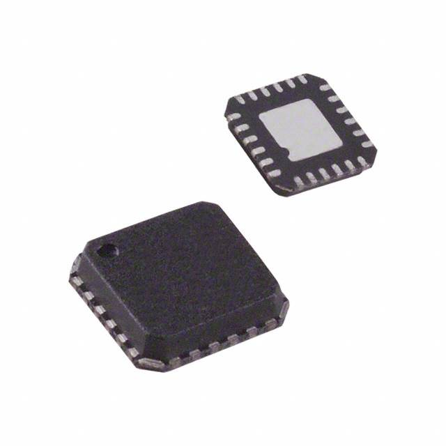

Ultralow Distortion IF VGA AD8375 Data Sheet FEATURES FUNCTIONAL BLOCK DIAGRAM VPOS Bandwidth of 630 MHz (−3 dB) Gain range: −4 dB to +20 dB Step size: 1 dB ± 0.2 dB Differential input and output Noise figure: 8 dB @ maximum gain Output IP3 of ~50 dBm at 200 MHz Output P1dB of 19 dBm at 200 MHz Provides constant SFDR vs. gain Parallel 5-bit control interface Power-down feature Single 5 V supply operation 24-lead, 4 mm × 4 mm LFCSP COMM VCOM PWUP AD8375 OUT+ VIN+ OUT+ α VIN– POST-AMP OUT– OUT– APPLICATIONS A4 A3 A2 A1 06724-001 REGISTERS AND GAIN DECODER A0 Figure 1. Differential ADC drivers High IF sampling receivers Wideband multichannel receivers Instrumentation GENERAL DESCRIPTION The AD8375 is powered on by applying the appropriate logic level to the PWUP pin. The quiescent current of the AD8375 is typically 130 mA. When powered down, the AD8375 consumes less than 5 mA and offers excellent input-to-output isolation. Rev. B 65 –50 60 –60 55 OIP3 –70 50 –80 45 HD2 –90 HD3 –100 –110 40 40 60 80 100 120 140 FREQUENCY (MHz) 35 160 180 30 200 OIP3 (dBm), OUTPUT @ 3dBm/TONE The AD8375 provides a broad 24 dB gain range with 1 dB resolution. The gain is adjusted through a 5-pin control interface and can be driven using standard TTL levels. The open-collector outputs provide a flexible interface, allowing the overall signal gain to be set by the loading impedance. Thus, the signal voltage gain is directly proportional to the load. –40 06724-052 Using an advanced high speed SiGe process and incorporating proprietary distortion cancellation techniques, the AD8375 achieves 50 dBm output IP3 at 200 MHz. Fabricated on an Analog Devices, Inc., high speed SiGe process, the AD8375 is supplied in a compact, thermally enhanced, 4 mm × 4 mm, 24-lead LFCSP package and operates over the temperature range of −40°C to +85°C. HARMONIC DISTORTION (dBc), OUTPUT @ 2V p-p The AD8375 is a digitally controlled, variable gain, wide bandwidth amplifier that provides precise gain control, high IP3, and low noise figure. The excellent distortion performance and high signal bandwidth make the AD8375 an excellent gain control device for a variety of receiver applications. Figure 2. Harmonic Distortion and Output IP3 vs. Frequency Document Feedback Information furnished by Analog Devices is believed to be accurate and reliable. However, no responsibility is assumed by Analog Devices for its use, nor for any infringements of patents or other rights of third parties that may result from its use. Specifications subject to change without notice. No license is granted by implication or otherwise under any patent or patent rights of Analog Devices. Trademarks and registered trademarks are the property of their respective owners. One Technology Way, P.O. Box 9106, Norwood, MA 02062-9106, U.S.A. Tel: 781.329.4700 ©2007–2017 Analog Devices, Inc. All rights reserved. Technical Support www.analog.com AD8375 Data Sheet TABLE OF CONTENTS Features .............................................................................................. 1 Basic Structure ............................................................................ 12 Applications ....................................................................................... 1 Applications..................................................................................... 13 Functional Block Diagram .............................................................. 1 Basic Connections ...................................................................... 13 General Description ......................................................................... 1 Single-Ended-to-Differential Conversion............................... 13 Revision History ............................................................................... 2 Broadband Operation ................................................................ 14 Specifications..................................................................................... 3 ADC Interfacing ......................................................................... 14 Absolute Maximum Ratings ............................................................ 5 Layout Considerations ............................................................... 17 ESD Caution .................................................................................. 5 Characterization Test Circuits .................................................. 17 Pin Configuration and Function Descriptions ............................. 6 Evaluation Board ........................................................................ 18 Typical Performance Characteristics ............................................. 7 Outline Dimensions ....................................................................... 22 Circuit Description ......................................................................... 12 Ordering Guide .......................................................................... 22 REVISION HISTORY 8/2017—Rev. A to Rev. B Changed CP-24-1 to CP-24-10 .................................... Throughout Updated Outline Dimensions ....................................................... 22 Changes to Ordering Guide .......................................................... 22 10/2012—Rev. 0 to Rev. A Change to Maximum Junction Temperature Parameter, Table 3 ................................................................................................ 5 Added Exposed Pad Notation, Figure 3 and Exposed Pad Notation, Table 4 ............................................................................... 6 Added Exposed Pad Notation to Outline Dimensions ............. 22 8/2007—Revision 0: Initial Version Rev. B | Page 2 of 24 Data Sheet AD8375 SPECIFICATIONS VS = 5 V, T = 25°C, RS = RL = 150 Ω at 140 MHz, 2 V p-p differential output, unless otherwise noted. Table 1. Parameter DYNAMIC PERFORMANCE −3 dB Bandwidth Slew Rate INPUT STAGE Maximum Input Swing Differential Input Resistance Common-Mode Input Voltage CMRR GAIN Amplifier Transconductance Maximum Voltage Gain Minimum Voltage Gain Gain Step Size Gain Flatness Gain Temperature Sensitivity Gain Step Response OUTPUT STAGE Output Voltage Swing Output Impedance NOISE/HARMONIC PERFORMANCE 46 MHz Noise Figure Second Harmonic Third Harmonic Output IP3 Output 1 dB Compression Point 70 MHz Noise Figure Second Harmonic Third Harmonic Output IP3 Output 1 dB Compression Point 140 MHz Noise Figure Second Harmonic Third Harmonic Output IP3 Output 1 dB Compression Point 200 MHz Noise Figure Second Harmonic Third Harmonic Output IP3 Output 1 dB Compression Point Conditions Min VOUT < 2 V p-p (5.2 dBm) Pin VIN+ and Pin VIN− For linear operation (AV = −4 dB) Differential Max 630 5 125 Gain code = 00000 Gain code = 00000 Gain code = 00000 Gain code ≥ 11000 From gain code = 00000 to 11000 All gain codes, 20% fractional bandwidth for fC < 200 MHz Gain code = 00000 For VIN = 100 mV p-p, gain code = 10100 to 00000 Pin VOUT+ and Pin VOUT− At P1dB, gain code = 00000 Differential Typ 0.060 0.89 8.5 150 1.9 55 0.067 20 −4 0.98 0.12 8 5 Unit MHz V/ns 165 0.074 1.01 V p-p Ω V dB S dB dB dB dB mdB/°C ns 12.6 16||0.8 V p-p kΩ||pF 8.3 −92 −94 50 22 dB dBc dBc dBm dBm 8.3 −98 −95 51 22 dB dBc dBc dBm dBm 8.3 −90 −100 51 20 dB dBc dBc dBm dBm 8.3 −85 −92 50 19 dB dBc dBc dBm dBm Gain code = 00000 VOUT = 2 V p-p VOUT = 2 V p-p 2 MHz spacing, +3 dBm per tone Gain code = 00000 VOUT = 2 V p-p VOUT = 2 V p-p 2 MHz spacing, 3 dBm per tone Gain code = 00000 VOUT = 2 V p-p VOUT = 2 V p-p 2 MHz spacing, 3 dBm per tone Gain code = 00000 VOUT = 2 V p-p VOUT = 2 V p-p 2 MHz spacing, 3 dBm per tone Rev. B | Page 3 of 24 AD8375 Data Sheet Parameter POWER INTERFACE Supply Voltage VPOS and Output Quiescent Current vs. Temperature Power-Down Current vs. Temperature POWER-UP/GAIN CONTROL VIH VIL Logic Input Bias Current Conditions Thermal connection made to exposed paddle under device −40°C ≤ TA ≤ +85°C PWUP low −40°C ≤TA ≤ +85°C Pin A0 to Pin A4, Pin PWUP Minimum voltage for a logic high Maximum voltage for a logic low Min Typ Max Unit 4.5 120 5.0 125 5.5 130 150 V mA mA mA mA 2.5 3 1.6 0.8 900 Table 2. Gain Code vs. Voltage Gain Look-Up Table 5-Bit Binary Gain Code 00000 00001 00010 00011 00100 00101 00110 00111 01000 01001 01010 01011 01100 Voltage Gain (dB) +20 +19 +18 +17 +16 +15 +14 +13 +12 +11 +10 +9 +8 5-Bit Binary Gain Code 01101 01110 01111 10000 10001 10010 10011 10100 10101 10110 10111 11000 >11000 Rev. B | Page 4 of 24 Voltage Gain (dB) +7 +6 +5 +4 +3 +2 +1 0 −1 −2 −3 −4 −4 V V nA Data Sheet AD8375 ABSOLUTE MAXIMUM RATINGS Table 3. Parameter Supply Voltage, VPOS PWUP, A0 to A4 Input Voltage, VIN+, VIN− DC Common Mode VCOM Internal Power Dissipation θJA (Exposed Paddle Soldered Down) θJC (At Exposed Paddle) Maximum Junction Temperature Operating Temperature Range Storage Temperature Range Rating 5.5 V −0.6 V to (VPOS + 0.6 V) −0.15 V to +4.15 V VCOM ± 0.25 V ±6 mA 825 mW 63.6°C/W 14.6°C/W 140°C −40°C to +85°C −65°C to +150°C Stresses at or above those listed under Absolute Maximum Ratings may cause permanent damage to the product. This is a stress rating only; functional operation of the product at these or any other conditions above those indicated in the operational section of this specification is not implied. Operation beyond the maximum operating conditions for extended periods may affect product reliability. ESD CAUTION Rev. B | Page 5 of 24 AD8375 Data Sheet 19 PWUP 21 COMM 20 COMM 22 COMM 23 VPOS 24 COMM PIN CONFIGURATION AND FUNCTION DESCRIPTIONS 18 VOUT– VCOM 1 VIN+ 2 17 VOUT+ VIN– 3 A4 4 A3 5 AD8375 16 VOUT– TOP VIEW (Not to Scale) 15 VOUT+ 14 COMM A2 6 NOTES 1. THE EXPOSED PAD IS INTERNALLY CONNECTED TO GROUND. SOLDER TO A LOW IMPEDANCE GROUND PLANE. 06724-002 VPOS 12 COMM 11 VPOS 10 VPOS 9 A0 8 A1 7 13 VPOS Figure 3. Pin Configuration Table 4. Pin Function Descriptions Pin No. 1 2 3 4 5 6 7 8 9, 10, 12, 13, 23 11, 14, 20, 21, 22, 24 15, 17 16, 18 19 Mnemonic VCOM VIN+ VIN− A4 A3 A2 A1 A0 VPOS COMM VOUT+ VOUT− PWUP EPAD Description Common-Mode Pin. Typically bypassed to ground using external capacitor. Voltage Input Positive. Voltage Input Negative. MSB for the 5-Bit Gain Control Interface. MSB − 1 for the Gain Control Interface. MSB − 2 for the Gain Control Interface. LSB + 1 for the Gain Control Interface. LSB for the 5-Bit Gain Control Interface. Positive Supply Pins. Should be bypassed to ground using suitable bypass capacitor. Device Common (DC Ground). Positive Output Pins (Open Collector). Require dc bias of +5 V nominal. Negative Output Pins (Open Collector). Require dc bias of +5 V nominal. Chip Enable Pin. Enabled with a logic high and disabled with a logic low. Exposed Pad. The Exposed Pad is internally connected to ground. Solder to a low impedance ground plane. Rev. B | Page 6 of 24 Data Sheet AD8375 TYPICAL PERFORMANCE CHARACTERISTICS VS = 5 V, TA = 25°C, RS = RL = 150 Ω, 2 V p-p output, maximum gain unless otherwise noted. 1.0 25 20 46MHz 70MHz 140MHz 200MHz 0.8 0.6 GAIN ERROR (dB) GAIN (dB) 15 10 5 0 0.4 0.2 0 –0.2 –0.4 –0.6 –5 5 10 01111 01010 GAIN CODE 15 00101 20 00000 –1.0 –4 11000 Figure 4. Gain vs. Gain Code at 46 MHz, 70 MHz, 140 MHz, and 200 MHz 10 5 0 –5 –10 10 100 FREQUENCY (MHz) 1000 20 6 INPUT MAX RATING BOUNDARY 200MHz 140MHz 70MHz 46MHz 15 10 0 –4 1 6 11 16 21 GAIN (dB) Figure 8. P1dB vs. Gain at 46 MHz, 70 MHz, 140 MHz, and 200 MHz 10 8 20 10100 5 Figure 5. Gain vs. Frequency Response 25 25°C 85°C –40°C 20 OP1dB (dBm) 4 2 0 –2 15 +25°C +85°C –40°C 10 –4 –6 5 0 10100 5 10 01111 01010 GAIN CODE 15 00101 20 00000 0 46 Figure 6. Gain Error over Temperature at 140 MHz 100 150 200 250 300 350 FREQUENCY (MHz) 400 450 500 06724-008 –8 –10 –4 11000 06724-005 GAIN ERROR (dB) GAIN (dB) 15 15 00101 25 OP1dB (dBm) 20 20dB 19dB 18dB 17dB 16dB 15dB 14dB 13dB 12dB 11dB 10dB 9dB 8dB 7dB 6dB 5dB 4dB 3dB 2dB 1dB 0dB –1dB –2dB –3dB –4dB 5 10 01111 01010 GAIN CODE Figure 7. Gain Step Error, Frequency 140 MHz 06724-004 25 0 10100 06724-007 0 10100 06724-006 –0.8 06724-003 –10 –4 11000 Figure 9. P1dB vs. Frequency at Maximum Gain, Three Temperatures Rev. B | Page 7 of 24 AD8375 Data Sheet AV = +20dB 51 50 50 AV = +10dB AV = 0dB 49 60 AV = 20dB 45 OIP3 (dBm) 48 OIP3 (dBm) 65 +25°C 20dB –40°C 20dB +85°C 20dB +25°C 0dB –40°C 0dB +85°C 0dB 47 46 AV = –4dB 45 55 40 50 AV = 0dB 44 35 45 30 40 OIP3 (dBm) 55 52 43 42 41 70 90 110 130 150 FREQUENCY (MHz) 170 190 210 25 –3 –1 0 1 2 3 4 5 35 POUT PER TONE (dBm) Figure 10. Output Third-Order Intercept at Four Gains, Output Level at 3 dBm/Tone Figure 13. Output Third-Order Intercept vs. Power, Frequency 140 MHz, Three Temperatures 52 –70 51 AV = +20dB 50 49 –80 IMD3 (dBc) 47 AV = 0dB 46 46MHz 70MHz 140MHz 200MHz –75 AV = +10dB 48 OIP3 (dBm) –2 06724-012 50 06724-009 40 30 45 44 AV = –4dB 43 –85 –90 –95 –100 42 –105 –3 –2 –1 0 1 2 POUT (dBm) 3 4 5 6 70 –70 65 –75 60 –80 IMD3 (dBc) 55 +25°C 50 –40°C +85°C 45 1 6 11 GAIN (dB) 16 Figure 14. Two-Tone Output IMD vs. Gain at 46 MHz, 70 MHz, 140 MHz, and 200 MHz, Output Level at 3 dBm/Tone Figure 11. Output Third-Order Intercept vs. Power at Four Gains, Frequency 140 MHz –85 +85°C –90 –40°C –95 –100 35 –105 30 40 60 80 100 120 140 FREQUENCY (MHz) 160 180 200 –110 40 60 80 100 120 140 FREQUENCY (MHz) 160 180 Figure 15. Two-Tone Output IMD vs. Frequency, Three Temperatures, Output Level at 3 dBm/Tone Figure 12. Output Third-Order Intercept vs. Frequency, Three Temperatures, Output Level at 3 dBm/Tone Rev. B | Page 8 of 24 200 06724-014 +25°C 40 06724-011 OIP3 (dBm) –110 –4 06274-010 40 –4 06724-013 41 Data Sheet AD8375 –75 –80 –95 –85 –100 –90 –105 –95 –110 –100 –115 40 60 80 100 120 140 FREQUENCY (MHz) 160 –105 200 180 –95 –105 –110 –115 –100 –85 HD3 +20dB HD3 +10dB HD3 0dB HD3 –4dB –95 –100 –120 –105 –2 –1 0 1 2 3 4 5 –110 –1 0 1 POUT (dBm) 2 3 4 5 –110 25 20 15 46MHz 70MHz 140MHz 200MHz 10 5 0 –4 –2 0 2 4 6 8 10 GAIN (dB) 12 14 16 18 20 Figure 20. NF vs. Gain at 46 MHz, 70 MHz, 140 MHz, and 200 MHz 45 HD2 +25°C HD3 +25°C HD2 –40°C HD3 –40°C HD2 +85°C HD3 +85°C 40 NOISE FIGURE (dB) –85 –2 30 Figure 17. Harmonic Distortion vs. Power at Four Gain Codes, Frequency 140 MHz –80 –3 POUT (dBm) 06724-016 –3 –4 –105 35 –90 –115 –4 HD3 +25°C –125 –5 NOISE FIGURE (dB) –80 –125 –5 –100 HD3 +85°C –120 HARMONIC DISTORTION HD3 (dBc) –95 –110 –95 HD3 –40°C Figure 19. Harmonic Distortion vs. Power, Frequency 140 MHz, Three Temperatures –70 –75 –105 –90 –65 –90 –90 –95 35 AV = –4dB 30 AV = 0dB 25 AV = +10dB 20 15 AV = +20dB 10 –100 –105 40 60 80 100 120 140 FREQUENCY (MHz) 160 180 200 Figure 18. Harmonic Distortion vs. Frequency, Three Temperatures, VOUT = 2 V p-p 0 0 100 200 300 400 500 600 700 FREQUENCY (MHz) Figure 21. NF vs. Frequency Rev. B | Page 9 of 24 800 900 1000 06724-020 5 06274-017 HARMONIC DISTORTION HD2 AND HD3 (dBc) HARMONIC DISTORTION HD2 (dBc) –85 –85 HD2 –40°C –60 HD2 +20dB HD2 +10dB HD2 0dB HD2 –4dB –80 –80 HD2 +25°C –100 Figure 16. Harmonic Distortion vs. Frequency at Four Gain Codes, VOUT = 2 V p-p –75 –75 HD2 +85°C HARMONIC DISTORTION HD3 (dBc) –90 06724-018 –90 –70 –70 06724-019 –85 –85 HARMONIC DISTORTION HD2 (dBc) –80 –65 HARMONIC DISTORTION HD3 (dBc) HD2 –4dB HD2 0dB HD2 +10dB HD2 +20dB HD3 –4dB HD3 0dB HD3 +10dB HD3 +20dB 06724-015 HARMONIC DISTORTION HD2 (dBc) –75 AD8375 Data Sheet REF3 POSITION –600mV/DIV REF3 SCALE 500mV 0pF 10pF EACH SIDE INPUT 2 R1 R3 M10.0ns 10.0GS/s IT 10.0ps/pt A CH1 960mV M2.5ns 20.0GS/s IT 10.0ps/pt A CH4 28.0mV REF3 500mV 2.5ns Figure 22. Gain Step Time Domain Response 06724-024 CH1 500mV Ω CH2 500mV Ω 06724-021 1 Figure 25. Pulse Response to Capacitive Loading, Gain 20 dB OUTPUT REF1 POSITION –1.02/DIV REF1 SCALE 50mV RISE (C2) 1.384ns FALL(C2) 1.39ns INPUT 2 2 REF1 CH2 500mV REF1 50.0mV Figure 23. ENBL Time Domain Response INPUT M2.5ns 20.0GS/s IT 10.0ps/pt A CH4 28.0mV 06724-023 R1 R3 R4 2.5ns –610mV 0 180 –5 120 –10 60 –15 0 –20 –60 –25 –120 –30 10 Figure 24. Pulse Response to Capacitive Loading, Gain −4 dB 100 FREQUENCY (MHz) Figure 27. S11 vs. Frequency Rev. B | Page 10 of 24 –180 1000 06724-026 S11 MAG (dB) 10pF EACH SIDE REF1 2.0V A CH2 Figure 26. Large Signal Pulse Response REF1 POSITION –420mV/DIV REF1 SCALE 2V 0pF M2.5ns 20Gsps IT 2.5ps/pt S11 PHASE (Degrees) M20.0ns 10.0GS/s IT 20.0ps/pt A CH1 960mV 06724-022 CH1 500mV Ω CH2 500mV Ω 06724-025 1 Data Sheet AD8375 0 1.00E–09 9.00E–10 –20 8.00E–10 DELAY (Seconds) S12 (dB) –40 –60 –80 +20dB +10dB 0dB –4dB 7.00E–10 6.00E–10 5.00E–10 4.00E–10 3.00E–10 2.00E–10 –100 0 100 200 300 400 500 600 700 FREQUENCY (MHz) 800 900 1000 0.00E+00 0 100 200 300 400 500 600 700 FREQUENCY (MHz) 800 900 1000 Figure 30. Group Delay vs. Frequency at Gain Figure 28. Reverse Isolation vs. Frequency 80 0 70 –20 –40 CMRR (dB) ISOLATION (dB) 60 –60 –80 50 40 30 20 –100 100 200 300 400 500 600 700 FREQUENCY (MHz) 800 900 1000 0 0 100 200 300 400 500 600 700 FREQUENCY (MHz) 800 900 1000 Figure 31. Common-Mode Rejection Ratio vs. Frequency Figure 29. Off-State Isolation vs. Frequency Rev. B | Page 11 of 24 06724-031 0 06724-028 –120 10 06724-029 –120 06724-027 1.00E–10 AD8375 Data Sheet CIRCUIT DESCRIPTION BASIC STRUCTURE The dependency of the gain on the load is due to the opencollector architecture of the output stage. The AD8375 is a differential variable gain amplifier consisting of a 150 Ω digitally controlled passive attenuator followed by a highly linear transconductance amplifier. The dc current to the outputs of the amplifier is supplied through two external chokes. The inductance of the chokes and the resistance of the load determine the low frequency pole of the amplifier. The parasitic capacitance of the chokes adds to the output capacitance of the part. This total capacitance in parallel with the load resistance sets the high frequency pole of the device. Generally, the larger the inductance of the choke, the higher its parasitic capacitance. Therefore, the value and type of the choke should be chosen keeping this trade-off in mind. AD8375 ATTENUATOR MUX BUFFERS VIN+ VOUT+ gm CORE AMP VCOM A0 TO A4 DIGITAL SELECT 06724-032 VOUT– VIN– Figure 32. Simplified Schematic Input System The dc voltage level at the inputs of the AD8375 is set by an internal voltage reference circuit to about 2 V. This reference is accessible at VCOM and can be used to source or sink 100 μA. For cases where a common-mode signal is applied to the inputs, such as in a single-ended application, an external capacitor between VCOM and ground is required. The capacitor improves the linearity performance of the part in this mode. This capacitor should be sized to provide a reactance of 10 Ω or less at the lowest frequency of operation. If the applied common-mode signal is dc, its amplitude should be limited to 0.25 V from VCOM (VCOM ± 0.25 V). The device can be powered down by pulling the PWUP pin down to below 0.8 V. In the powered down mode, the total current reduces to 3 mA (typical). The dc level at the inputs and at VCOM remains at about 2 V, regardless of the state of the PWUP pin. Output Amplifier The gain is based on a 150 Ω differential load and varies as RL is changed per the following equations: Voltage Gain = 20 × (log(RL/150) + 1) For operation frequency of 15 MHz to 700 MHz driving a 150 Ω load, 1 μH chokes with SRF of 160 MHz or higher are recommended (such as 0805LS-102XJBB from Coilcraft). The supply current consists of about 50 mA through the VCC pin and 80 mA through the two chokes combined. The latter increases with temperature at about 2.5 mA per 10°C. There are two output pins for each polarity and they are oriented in an alternating fashion. When designing the board, care should be taken to minimize the parasitic capacitance due to the routing that connects the corresponding outputs together. A good practice is to avoid any ground or power plane under this routing region and under the chokes to minimize the parasitic capacitance. Gain Control A 5-bit binary code changes the attenuator setting in 1 dB steps such that the gain of the device changes from 20 dB (Code 0) to −4 dB (Code 24 and higher). The noise figure of the device is about 8 dB at maximum gain setting and it increases as the gain is reduced. The increase in noise figure is equal to the reduction in gain. The linearity of the part measured at the output is first-order independent of the gain setting. From 0 dB to 20 dB gain, OIP3 is approximately 50 dBm into 150 Ω load at 140 MHz (3 dBm per tone). At gain settings below 0 dB, it drops to approximately 45 dBm. and Power Gain = 10 × (log(RL/150) + 2) Rev. B | Page 12 of 24 Data Sheet AD8375 APPLICATIONS BASIC CONNECTIONS +5V VCM 0.1µF Figure 35 shows the basic connections for operating the AD8375. A voltage between 4.5 V and 5.5 V should be applied to the supply pins. Each supply pin should be decoupled with at least one low inductance, surface-mount ceramic capacitor of 0.1 μF placed as close as possible to the device. 1µH 150Ω 0.1µF 50Ω AD8375 0.1µF AC The outputs of the AD8375 are open collectors that need to be pulled up to the positive supply with 1 μH RF chokes. The differential outputs are biased to the positive supply and require ac coupling capacitors, preferably 0.1 μF. Similarly, the input pins are at bias voltages of about 2 V above ground and should be ac-coupled as well. The ac coupling capacitors and the RF chokes are the principle limitations for operation at low frequencies. 1µH 0.1µF 0.1µF 150Ω 37.5Ω 06724-035 5 A0 TO A4 Figure 33. Single-Ended-to-Differential Conversion Using a single-ended input decreases the power gain by 3 dB and limits distortion cancellation. Consequently, the secondorder distortion is degraded. The third-order distortion remains low to 200 MHz, as shown in Figure 34. To enable the AD8375, the PWUP pin must be pulled high. Taking PWUP low puts the AD8375 in sleep mode, reducing current consumption to 5 mA at ambient. –60 –65 HD2 HARMONIC DISTORTION (dBc) SINGLE-ENDED-TO-DIFFERENTIAL CONVERSION The AD8375 can be configured as a single-ended input to differential output driver as shown in Figure 33. A 150 Ω resistor in parallel with the input impedance of input pin provides an impedance matching of 50 Ω. The voltage gain and the bandwidth of this configuration, using a 150 Ω load, remains the same as when using a differential input. –70 –75 –80 –85 –90 HD3 –100 0 50 100 FREQUENCY (MHz) 150 200 Figure 34. Harmonic Distortion vs. Frequency of Single-Ended-to-Differential Conversion +VS 0.1µF 10µF 1µH 24 0.1µF 22 21 20 19 0.1µF 1 VCOM VOUT– 18 2 VIN+ VOUT+ 17 3 VIN– VOUT– 16 0.1µF RL 1µH AD8375 0.1µF 0.1µF 4 A4 VOUT+ 15 5 A3 COMM 14 6 A2 VPOS 13 A1 7 A0 8 BALANCED LOAD VPOS VPOS COMM VPOS 9 10 11 12 +VS PARALLEL CONTROL INTERFACE 0.1µF Figure 35. Basic Connections Rev. B | Page 13 of 24 0.1µF 06724-034 RS 2 BALANCED AC SOURCE RS 2 23 COMM VPOS COMM COMM COMM PWUP 06724-036 –95 AD8375 Data Sheet BROADBAND OPERATION For example, in the extreme case where the load is assumed to be high impedance, RL = ∞, the equation for R1 reduces to R1 = 75 Ω. Using the equation for VR, the applied voltage should be VR = 8 V. The measured single-tone low frequency harmonic distortion for a 2 V p-p output using 75 Ω resistive pull-ups is provided in Figure 37. The AD8375 uses an open-collector output structure that requires dc bias through an external bias network. Typically, choke inductors are used to provide bias to the open-collector outputs. Choke inductors work well at signal frequencies where the impedance of the choke is substantially larger than the target ac load impedance. In broadband applications, it may not be possible to find large enough choke inductors that offer enough reactance at the lowest frequency of interest while offering a high enough self resonant frequency (SRF) to support the maximum bandwidth available from the device. The circuit in Figure 36 can be used when frequency response below 10 MHz is desired. This circuit replaces the bias chokes with bias resistors. The bias resistor has the disadvantage of a greater IR drop, and requires a supply rail that is several volts above the local 5 V supply used to power the device. Additionally, it is necessary to account for the ac loading effect of the bias resistors when designing the output interface. Whereas the gain of the AD8375 is load dependent, RL, in parallel with R1 + R2, should equal the optimum 150 Ω target load impedance to provide the expected ac performance depicted in the data sheet. Additionally, to ensure good output balance and even-order distortion performance, it is essential that R1 = R2. 5V 0.1µF 37.5Ω 0.1µF VR A0 TO A4 HARMONIC DISTORTION (dBc) and VR = R1 × 40 × 10 −3 + 5 0.1µF ETC1-1-13 37.5Ω 37.5Ω 0.1µF AD8375 5 5V 1µH 20 06724-038 15 10 FREQUENCY (MHz) (2) 5V 50Ω 5 There are several options available to the designer when using the AD8375. The open-collector output provides the capability of driving a variety of loads. Figure 38 shows a simplified wideband interface with the AD8375 driving a AD9445. The AD9445 is a 14-bit 125 MSPS analog-to-digital converter with a buffered wideband input, which presents a 2 kΩ differential load impedance and requires a 2 V p-p differential input swing to reach full scale. (1) R L − 150 0 The AD8375 is a high output linearity variable gain amplifier that is optimized for ADC interfacing. The output IP3 and noise floor essentially remain constant vs. the 24 dB available gain range. This is a valuable feature in a variable gain receiver where it is desirable to maintain a constant instantaneous dynamic range as the receiver gain is modified. The output noise density is typically around 20 nV/√Hz, which is comparable to 14-/16bit sensitivity limits. The two-tone IP3 performance of the AD8375 is typically around 50 dBm. This results in SFDR levels of better than 86 dB when driving the AD9445 up to 140 MHz. Using the formula for R1 (Equation 1), the values of R1 = R2 that provide a total presented load impedance of 150 Ω can be found. The required voltage applied to the bias resistors, VR, can be found by using the VR formula (Equation 2). 75 × R L –92 ADC INTERFACING Figure 36. Single-Ended Broadband Operation with Resistive Pull-Ups R1 = HD3 –90 Figure 37. Harmonic Distortion vs. Frequency Using Resistive Pull-Ups RL R2 5 –88 –96 0.1µF AD8375 –86 0.1µF 82Ω 1µH 0.1µF L (SERIES) 0.1µF L (SERIES) 0.1µF 33Ω AD9445 33Ω 82Ω A0 TO A4 Figure 38. Wideband ADC Interfacing Example Featuring the AD9445 Rev. B | Page 14 of 24 VIN+ 14 14-BIT ADC VIN– 06724-039 50Ω HD2 –84 –94 VR R1 0.1µF ETC1-1-13 –82 06724-037 37.5Ω SET TO 5V –80 Data Sheet AD8375 0 –1 –2 –3 –4 1 0 SNR = 64.93dBc SFDR = 86.37dBc NOISE FLOOR = –108.1dB FUND = –1.053dBFs SECOND = –86.18dBc THIRD = –86.22dBc –10 –20 –30 –40 –50 –6 –7 –8 FIRST POINT = –2.93dBFs END POINT = –9.66dBFs MID POINT = –2.33dBFs MIN = –9.66dBFs MAX = –1.91dBFs –9 –60 –10 20 –70 –80 3 2 –90 + –100 4 5 –130 5.25 10.50 15.75 21.00 26.25 31.50 36.75 42.00 47.25 52.50 FREQUENCY (MHz) 06724-040 –140 0 48 76 104 132 160 188 216 FREQUENCY (MHz) 244 272 300 Figure 40. Measured Frequency Response of Wideband ADC Interface Depicted in Figure 38 6 –110 –120 –150 –5 06724-041 (dBFS) The addition of the series inductors L (series) in Figure 38 extends the bandwidth of the system and provides response flatness. Using 100 nH inductors as L (series), the wideband system response of Figure 40 is obtained. The wideband frequency response is an advantage in broadband applications such as predistortion receiver designs and instrumentation applications. However, by designing for a wide analog input frequency range, the cascaded SNR performance is somewhat degraded due to high frequency noise aliasing into the wanted Nyquist zone. (dBFs) For optimum performance, the AD8375 should be driven differentially using an input balun or impedance transformer. Figure 38 uses a wideband 1:1 transmission line balun followed by two 37.5 Ω resistors in parallel with the 150 Ω input impedance of the AD8375 to provide a 50 Ω differential terminated input impedance. This provides a wideband match to a 50 Ω source. The open-collector outputs of the AD8375 are biased through the two 1 μH inductors and are ac-coupled to the two 82 Ω load resistors. The 82 Ω load resistors in parallel with the series-terminated ADC impedance yields the target 150 Ω differential load impedance, which is recommended to provide the specified gain accuracy of the device. The load resistors are ac-coupled from the AD9445 to avoid common-mode dc loading. The 33 Ω series resistors help to improve the isolation between the AD8375 and any switching currents present at the analog-to-digital sample and hold input circuitry. Figure 39. Measured Single-Tone Performance of the Circuit in Figure 38 for a 100 MHz Input Signal The circuit depicted in Figure 38 provides variable gain, isolation and source matching for the AD9445. Using this circuit with the AD8375 in a gain of 20 dB (maximum gain) an SFDR performance of 86 dBc is achieved at 100 MHz, as indicated in Figure 39. An alternative narrow-band approach is presented in Figure 41. By designing a narrow band-pass antialiasing filter between the AD8375 and the target ADC, the output noise of the AD8375 outside of the intended Nyquist zone can be attenuated, helping to preserve the available SNR of the ADC. In general, the SNR improves several dB when including a reasonable order antialiasing filter. In this example, a low loss 1:3 input transformer is used to match the AD8375’s 150 Ω balanced input to a 50 Ω unbalanced source, resulting in minimum insertion loss at the input. Rev. B | Page 15 of 24 AD8375 Data Sheet at dc, which introduces a zero into the transfer function. In addition, the ac coupling capacitors and the bias chokes introduce additional zeros into the transfer function. The final overall frequency response takes on a band-pass characteristic, helping to reject noise outside of the intended Nyquist zone. Table 5 provides initial suggestions for prototyping purposes. Some empirical optimization may be needed to help compensate for actual PCB parasitics. Figure 41 is optimized for driving some of Analog Devices popular unbuffered ADCs, such as the AD9246, AD9640, and AD6655. Table 5 includes antialiasing filter component recommendations for popular IF sampling center frequencies. Inductor L5 works in parallel with the on-chip ADC input capacitance and a portion of the capacitance presented by C4 to form a resonant tank circuit. The resonant tank helps to ensure the ADC input looks like a real resistance at the target center frequency. Additionally, the L5 inductor shorts the ADC inputs 1µH 1nF 50Ω 1nF AD8375 301Ω 1µH 5 1nF 1nF L1 L3 C2 L1 C4 CML 165Ω 165Ω AD9246 AD9640 AD6655 L5 L3 06724-042 1:3 A0 TO A4 Figure 41. Narrow-Band IF Sampling Solution for Unbuffered ADC Application Table 5. Interface Filter Recommendations for Various IF Sampling Frequencies Center Frequency 96 MHz 140 MHz 170 MHz 211 MHz 1 dB Bandwidth 27 MHz 30 MHz 32 MHz 32 MHz L1 390 nH 330 nH 270 nH 220 nH C2 5.6 pF 3.3 pF 2.7 pF 2.2 pF Rev. B | Page 16 of 24 L3 390 nH 330 nH 270 nH 220 nH C4 25 pF 20 pF 20 pF 18 pF L5 100 nH 56 nH 39 nH 27 nH Data Sheet AD8375 +9V LAYOUT CONSIDERATIONS There are two output pins for each polarity, and they are oriented in an alternating fashion. When designing the board, care should be taken to minimize the parasitic capacitance due to the routing that connects the corresponding outputs together. A good practice is to avoid any ground or power plane under this routing region and under the chokes to minimize the parasitic capacitance. 96Ω TC3-1T 0.1µF 0.1µF 330Ω 25Ω AD8375 T1 50Ω 96Ω AC 50Ω 0.1µF 330Ω 0.1µF 25Ω 06724-047 5 A0 TO A4 Figure 43. Test Circuit for Time Domain Measurements CHARACTERIZATION TEST CIRCUITS Differential-to-Differential Characterization The S-parameter characterization for the AD8375 was performed using a dedicated differential input to differential output characterization board. Figure 44 shows the layout of characterization board. The board was designed for optimum impedance matching into a 75 Ω system. Because both the input and output impedances of the AD8375 are 150 Ω differentially, 75 Ω impedance runs were used to match 75 Ω network analyzer port impedances. On-board 1 μH inductors were used for output biasing, and the output board traces were designed for minimum capacitance. +5V L1 1µH AD8375 75Ω 75Ω TRACES 0.1µF AC 75Ω 0.1µF 5 A0 TO A4 06724-044 75Ω 75Ω TRACES Figure 42. Test Circuit for S-Parameters on Dedicated 75 Ω Differential-to-Differential Board Figure 44. Differential-to-Differential Characterization Board Circuit Side Layout +5V TC3-1T 50Ω AC L1 1µH C1 0.1µF AD8375 T1 C2 0.1µF 5 L2 1µH C3 0.1µF R1 62Ω R4 25Ω ETC1-1-13 PAD LOSS = 11dB C4 0.1µF R2 62Ω R3 25Ω A0 TO A4 Figure 45. Test Circuit for Distortion, Gain, and Noise Rev. B | Page 17 of 24 T2 50Ω 06724-043 AC 0.1µF 0.1µF 06724-046 75Ω L2 1µH AD8375 Data Sheet EVALUATION BOARD Figure 46 shows the schematic of the AD8375 evaluation board. The silkscreen and layout of the component and circuit sides are shown in Figure 47 through Figure 50. The board is powered by a single supply in the 4.5 V to 5.5 V range. The power supply is decoupled by 10 µF and 0.1 µF capacitors at each power supply pin. Additional decoupling, in the form of a series resistor or inductor at the supply pins, can also be added. Table 6 details the various configuration options of the evaluation board. The output pins of the AD8375 require supply biasing with 1 µH RF chokes. Both the input and output pins must be accoupled. These pins are converted to single-ended with a pair of baluns (Mini-Circuits TC3-1T+ and M/A-COM ETC1-1-13). The balun at the input, T1, is used to transform a 50 Ω source impedance to the desired 150 Ω reference level. The output balun, T3, and the matching components are configured to provide a 150 Ω to 50 Ω impedance transformation with an insertion loss of about 11 dB. Rev. B | Page 18 of 24 INN INP R2 0Ω R1 TC3-1T+ Figure 46. AD8375 Evaluation Board Schematic Rev. B | Page 19 of 24 VPOS C20 10µF C60 0.1µF T1 WA4 R72 R71 R70 C1 0.1µF WA3 R10 C2 0Ω 0.1µF R9 0Ω WA2 C11 0.1µF 23 22 21 20 C5 19 WA1 WA0 VPOS 13 C14 0.1µF VPOS VPOS VPOS COMM VPOS 9 10 11 12 6 A2 A0 8 COMM 14 5 A3 VOUT– 16 VOUT+ 15 AD8375 VOUT+ 17 VOUT– 18 4 A4 A1 7 3 VIN– 2 VIN+ 1 VCOM C63 0.1µF R13 0Ω COMM VPOS COMM COMM COMM PWUP 24 VPOS PU C13 0.1µF L2 1µH R16 0Ω VXA R19 C7 0.1µF 61.9Ω R23 30.9Ω R24 R25 30.9Ω VPOS R20 61.9Ω C64 0.1µF C8 0.1µF L1 1µH R15 0Ω R91 0Ω C62 0.1µF R62 T3 ETC1-1-13 R29 VPOS R30 0Ω OUTP OUTN 06724-045 VPOS Data Sheet AD8375 AD8375 Data Sheet Table 6. Evaluation Board Configuration Options Components C13, C14, C20, C63, C64, R91 Function Power Supply Decoupling. Nominal supply decoupling consists a 10 µF capacitor to ground followed by 0.1 µF capacitors to ground positioned as close to the device as possible. T1, C1, C2, C60, R1, R2, R9, R10, R70 to R72 Input Interface. T1 is a 3:1 impedance ratio balun to transform a 50 Ω singleended input into a 150 Ω balanced differential signal. R2 grounds one side of the differential drive interface for single-ended applications. R9, R10, and R70 to R72 are provided for generic placement of matching components. C1 and C2 are dc blocks. Output Interface. C7 and C8 are dc blocks. L1 and L2 provide dc biases for the output. R19, R20, and R23 to R25 are provided for generic placement of matching components. The evaluation board is configured to provide a 150 Ω to 50 Ω impedance transformation with an insertion loss of about 11 dB. T3 is a 1:1 impedance ratio balun to transform the balanced differential signal to a single-ended signal. R30 grounds one side of the differential output interface for single-ended applications. T3, C7, C8, C62 L1, L2, R15, R16, R19, R20, R23 to R25, R29, R30, R62 PU, R13, C5 WA0 to WA4 C11 Enable Interface. The AD8375 is enabled by applying a logic high voltage to the PWUP pin. The device is disabled when the PU switch is set in the position closest to the PU label, connecting the PWUP pin to ground. The device is enabled when the PU switch is set in the opposite position, connecting the PWUP to VPOS. Parallel Interface Control. Used to hardwire A0 through A4 to the desired gain. The bank of switches, WA4 to WA0, set the binary gain code. WA4 represents the LSB. WA0 represents the MSB. Voltage Reference. Input common-mode voltage ac-coupled to ground by 0.1 µF capacitor, C11. Rev. B | Page 20 of 24 Default Conditions C20 = 10 µF (size 3528) C13, C14, C63, C64 = 0.1 µF (size 0402) R91 = 0 Ω (size 0402) T1 = TC3-1+ (Mini-Circuits) C1, C2, C60 = 0.1 µF (size 0402) R2, R9, R10 = 0 Ω (size 0402) R1, R70 to R72 = open (size 0402) T3 = ETC1-1-13 (M/A-COM) C7, C8, C62 = 0.1 µF (size 0402) L1, L2 = 1 µH (size 0805) R19, R20 = 61.9 Ω (size 0402) R23, R25 = 30.9 Ω (size 0402) R15, R16 = 0 Ω (size 0603) R30 = 0 Ω (size 0402) R24, R29, R62 = open (size 0402) PU = installed R13 = 0 Ω (size 0603) C5 = open (size 0603) WA0 to WA4 = installed C11 = 0.1 µF (size 0402) AD8375 06724-048 06724-050 Data Sheet 06724-049 06724-051 Figure 49. Component Side Layout Figure 47. Component Side Silkscreen Figure 50. Circuit Side Layout Figure 48. Circuit Side Silkscreen Rev. B | Page 21 of 24 AD8375 Data Sheet OUTLINE DIMENSIONS PIN 1 INDICATOR DETAIL A (JEDEC 95) 0.30 0.25 0.20 1 0.50 BSC 2.20 2.10 SQ 2.00 EXPOSED PAD 13 TOP VIEW 0.80 0.75 0.70 SIDE VIEW PKG-004714 SEATING PLANE 0.50 0.40 0.30 PIN 1 INDIC ATOR AREA OPTIONS (SEE DETAIL A) 24 19 18 6 12 7 BOTTOM VIEW 0.05 MAX 0.02 NOM COPLANARITY 0.08 0.203 REF 0.25 MIN FOR PROPER CONNECTION OF THE EXPOSED PAD, REFER TO THE PIN CONFIGURATION AND FUNCTION DESCRIPTIONS SECTION OF THIS DATA SHEET. COMPLIANT TO JEDEC STANDARDS MO-220-WGGD-8. 02-21-2017-A 4.10 4.00 SQ 3.90 Figure 51. 24-Lead Lead Frame Chip Scale Package [LFCSP] 4 mm × 4 mm Body and 0.75 mm Package Height (CP-24-10) Dimensions shown in millimeters ORDERING GUIDE Model1 AD8375ACPZ-WP AD8375ACPZ-R7 AD8375-EVALZ 1 Temperature Range −40°C to +85°C −40°C to +85°C Package Description 24-Lead Lead Frame Chip Scale Package [LFCSP], Waffle Pack 24-Lead Lead Frame Chip Scale Package [LFCSP], 7” Tape and Reel Evaluation Board Z = RoHS Compliant Part. Rev. B | Page 22 of 24 Package Option CP-24-10 CP-24-10 Data Sheet AD8375 NOTES Rev. B | Page 23 of 24 AD8375 Data Sheet NOTES ©2007–2017 Analog Devices, Inc. All rights reserved. Trademarks and registered trademarks are the property of their respective owners. D06724-0-9/17(B) Rev. B | Page 24 of 24
