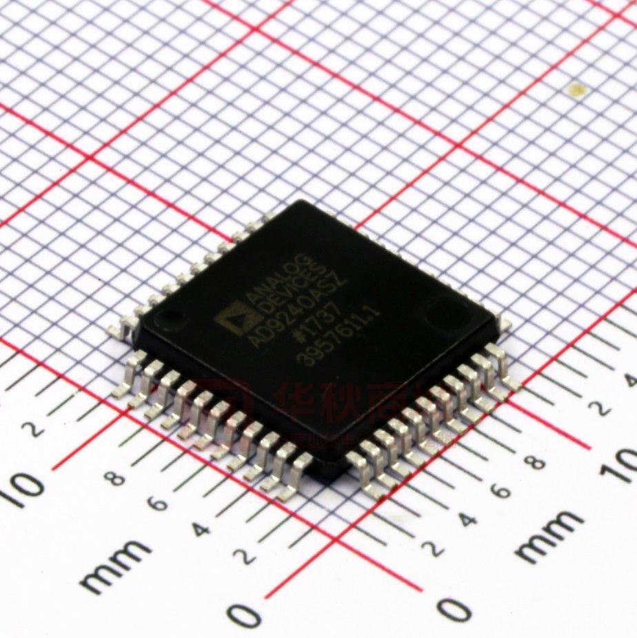

AD9240ASZ
AD9240ASZ
    AD(亚德诺)
    MQFP44
    14 位模数转换器 1 输入 1 管线 44-MQFP(10x10)
AD9240ASZ 数据手册
a FEATURES Monolithic 14-Bit, 10 MSPS A/D Converter Low Power Dissipation: 285 mW Single +5 V Supply Integral Nonlinearity Error: 2.5 LSB Differential Nonlinearity Error: 0.6 LSB Input Referred Noise: 0.36 LSB Complete: On-Chip Sample-and-Hold Amplifier and Voltage Reference Signal-to-Noise and Distortion Ratio: 77.5 dB Spurious-Free Dynamic Range: 90 dB Out-of-Range Indicator Straight Binary Output Data 44-Lead MQFP Complete 14-Bit, 10 MSPS Monolithic A/D Converter AD9240 FUNCTIONAL BLOCK DIAGRAM AVDD CLK DRVDD DVDD SHA VINA MDAC1 GAIN = 16 VINB CML MDAC2 GAIN = 8 MDAC3 GAIN = 8 4 4 5 A/D CAPT A/D 5 A/D 4 BIAS A/D 4 4 DIGITAL CORRECTION LOGIC 14 CAPB VREF OTR OUTPUT BUFFERS SENSE MODE SELECT BIT 1 (MSB) 1V AD9240 REFCOM AVSS BIT 14 (LSB) DVSS DRVSS PRODUCT DESCRIPTION PRODUCT HIGHLIGHTS The AD9240 is a 10 MSPS, single supply, 14-bit analog-todigital converter (ADC). It combines a low cost, high speed CMOS process and a novel architecture to achieve the resolution and speed of existing hybrid implementations at a fraction of the power consumption and cost. It is a complete, monolithic ADC with an on-chip, high performance, low noise sample-and-hold amplifier and programmable voltage reference. An external reference can also be chosen to suit the dc accuracy and temperature drift requirements of the application. The device uses a multistage differential pipelined architecture with digital output error correction logic to guarantee no missing codes over the full operating temperature range. The AD9240 offers a complete single-chip sampling 14-bit, analog-to-digital conversion function in a 44-lead Metric Quad Flatpack. Low Power and Single Supply The AD9240 consumes only 280 mW on a single +5 V power supply. Excellent DC Performance Over Temperature The AD9240 provides no missing codes, and excellent temperature drift performance over the full operating temperature range. Excellent AC Performance and Low Noise The AD9240 provides nearly 13 ENOB performance and has an input referred noise of 0.36 LSB rms. Flexible Analog Input Range The versatile onboard sample-and-hold (SHA) can be configured for either single ended or differential inputs of varying input spans. Flexible Digital Outputs The digital outputs can be configured to interface with +3 V and +5 V CMOS logic families. The input of the AD9240 is highly flexible, allowing for easy interfacing to imaging, communications, medical and dataacquisition systems. A truly differential input structure allows for both single-ended and differential input interfaces of varying input spans. The sample-and-hold amplifier (SHA) is equally suited for multiplexed systems that switch full-scale voltage levels in successive channels as well as sampling single-channel inputs at frequencies up to and beyond the Nyquist rate. The AD9240 also performs well in communication systems employing Direct-IF Down Conversion, since the SHA in the differential input mode can achieve excellent dynamic performance well beyond its specified Nyquist frequency of 5 MHz. A single clock input is used to control all internal conversion cycles. The digital output data is presented in straight binary output format. An out-of-range (OTR) signal indicates an overflow condition which can be used with the most significant bit to determine low or high overflow. Excellent Undersampling Performance The full power bandwidth and dynamic range of the AD9240 make it well suited for Direct-IF Down Conversion extending to 45 MHz. REV. B Information furnished by Analog Devices is believed to be accurate and reliable. However, no responsibility is assumed by Analog Devices for its use, nor for any infringements of patents or other rights of third parties which may result from its use. No license is granted by implication or otherwise under any patent or patent rights of Analog Devices. One Technology Way, P.O. Box 9106, Norwood, MA 02062-9106, U.S.A. Tel: 781/329-4700 World Wide Web Site: http://www.analog.com Fax: 781 /461-3113 © Analog Devices, Inc., 2010 AD9240–SPECIFICATIONS (AVDD = +5 V, DVDD = +5 V, DRVDD = +5 V, fSAMPLE = 10 MSPS, RBIAS = 2 k⍀, VREF = 2.5 V, VINB = 2.5 V, MIN to TMAX unless otherwise noted) DC SPECIFICATIONS T Parameter AD9240 Units RESOLUTION 14 Bits min MAX CONVERSION RATE 10 MHz min INPUT REFERRED NOISE VREF = 1 V VREF = 2.5 V 0.9 0.36 LSB rms typ LSB rms typ INL1 DNL1 No Missing Codes Zero Error (@ +25°C) Gain Error (@ +25°C)2 Gain Error (@ +25°C)3 ± 2.5 ± 0.6 ± 1.0 ± 2.5 ± 0.7 14 0.3 1.5 0.75 LSB typ LSB typ LSB max LSB typ LSB typ Bits Guaranteed % FSR max % FSR max % FSR max TEMPERATURE DRIFT Zero Error Gain Error2 Gain Error3 3.0 20.0 5.0 ppm/°C typ ppm/°C typ ppm/°C typ POWER SUPPLY REJECTION 0.1 % FSR max 2 5 0 AVDD 16 V p-p min V p-p max V min V max pF typ INTERNAL VOLTAGE REFERENCE Output Voltage (1 V Mode) Output Voltage Tolerance (1 V Mode) Output Voltage (2.5 V Mode) Output Voltage Tolerance (2.5 V Mode) Load Regulation4 1 ± 14 2.5 ± 35 5.0 Volts typ mV max Volts typ mV max mV max REFERENCE INPUT RESISTANCE 5 kΩ typ ACCURACY Integral Nonlinearity (INL) Differential Nonlinearity (DNL) ANALOG INPUT Input Span (with VREF = 1.0 V) Input Span (with VREF = 2.5 V) Input (VINA or VINB) Range Input Capacitance POWER SUPPLIES Supply Voltages AVDD DVDD DRVDD Supply Current IAVDD IDRVDD IDVDD +5 +5 +5 V (± 5% AVDD Operating) V (± 5% DVDD Operating) V (± 5% DRVDD Operating) 50 1 15 mA max (46 mA typ) mA max (0.1 mA typ) mA max (11 mA typ) POWER CONSUMPTION 330 mW max (285 mW typ) NOTES 1 VREF = 1 V. 2 Including internal reference. 3 Excluding internal reference. 4 Load regulation with 1 mA load current (in addition to that required by the AD9240). Specification subject to change without notice. –2– REV. B AD9240 (AVDD = +5 V, DVDD= +5 V, DRVDD = +5 V, fSAMPLE = 10 MSPS, RBIAS = 2 k⍀, VREF = 2.5 V, AIN = –0.5 dBFS, MIN to TMAX unless otherwise noted) AC SPECIFICATIONS AC Coupled/Differential Input, T Parameter SIGNAL-TO-NOISE AND DISTORTION RATIO (S/N+D) fINPUT = 500 kHz fINPUT = 1.0 MHz fINPUT = 5.0 MHz EFFECTIVE NUMBER OF BITS (ENOB) fINPUT = 500 kHz fINPUT = 1.0 MHz fINPUT = 5.0 MHz SIGNAL-TO-NOISE RATIO (SNR) fINPUT = 500 kHz fINPUT = 1.0 MHz fINPUT = 5.0 MHz TOTAL HARMONIC DISTORTION (THD) fINPUT = 500 kHz fINPUT = 1.0 MHz fINPUT = 5.0 MHz SPURIOUS FREE DYNAMIC RANGE fINPUT = 500 kHz fINPUT = 1.0 MHz fINPUT = 5.0 MHz DYNAMIC PERFORMANCE Full Power Bandwidth Small Signal Bandwidth Aperture Delay Aperture Jitter Acquisition to Full-Scale Step (0.0025%) Overvoltage Recovery Time AD9240 Units 75.0 77.5 77.5 75.0 dB min dB typ dB typ dB typ 12.2 12.6 12.6 12.2 Bits min Bits typ Bits typ Bits typ 76.0 78.5 78.5 78.5 dB min dB typ dB typ dB typ –78.0 –85.0 –85.0 –77.0 dB max dB typ dB typ dB typ 90.0 90.0 80.0 dB typ dB typ dB typ 70 70 1 4 45 167 MHz typ MHz typ ns typ ps rms typ ns typ ns typ Specifications subject to change without notice. DIGITAL SPECIFICATIONS (AVDD = +5 V, DVDD = +5 V, TMIN to TMAX unless otherwise noted) Parameters Symbol AD9240 Units CLOCK INPUT High Level Input Voltage Low Level Input Voltage High Level Input Current (VIN = DVDD) Low Level Input Current (VIN = 0 V) Input Capacitance VIH VIL IIH IIL CIN +3.5 +1.0 ± 10 ± 10 5 V min V max µA max µA max pF typ LOGIC OUTPUTS (with DRVDD = 5 V) High Level Output Voltage (IOH = 50 µA) High Level Output Voltage (IOH = 0.5 mA) Low Level Output Voltage (IOL = 1.6 mA) Low Level Output Voltage (IOL = 50 µA) Output Capacitance VOH VOH VOL VOL COUT +4.5 +2.4 +0.4 +0.1 5 V min V min V max V max pF typ LOGIC OUTPUTS (with DRVDD = 3 V) High Level Output Voltage (IOH = 50 µA) Low Level Output Voltage (IOL = 50 µA) VOH VOL +2.4 +0.7 V min V max Specifications subject to change without notice. REV. B –3– AD9240 SWITCHING SPECIFICATIONS (T MIN to TMAX Parameters Symbol AD9240 Units tC tCH tCL tOD 100 45 45 8 13 19 3 ns min ns min ns min ns min ns typ ns max Clock Cycles 1 Clock Period CLOCK Pulsewidth High CLOCK Pulsewidth Low Output Delay with AVDD = +5 V, DVDD = +5 V, DRVDD = +5 V, RBIAS = 2 k⍀, CL = 20 pF) Pipeline Delay (Latency) NOTES 1 The clock period may be extended to 1 ms without degradation in specified performance @ +25 °C. Specifications subject to change without notice. THERMAL CHARACTERISTICS S1 ANALOG INPUT S2 tCH Thermal Resistance 44-Lead MQFP θJA = 53.2°C/W θJC = 19°C/W S4 tC tCL S3 INPUT CLOCK tOD DATA OUTPUT DATA 1 Figure 1. Timing Diagram ABSOLUTE MAXIMUM RATINGS* DVSS 1 AVSS 2 NC CAPB BIAS CAPT CML NC NC 33 REFCOM PIN 1 IDENTIFIER 32 VREF DVDD 3 31 SENSE AVDD 4 30 NC DRVSS 5 AD9240 29 AVSS DRVDD 6 TOP VIEW (Not to Scale) 28 AVDD CLK 7 27 NC NC 8 26 NC NC 9 25 OTR NC 10 24 BIT 1 (MSB) (LSB) BIT 14 11 °C 23 BIT 2 BIT 3 BIT 4 BIT 6 BIT 13 BIT 5 12 13 14 15 16 17 18 19 20 21 22 *Stresses above those listed under Absolute Maximum Ratings may cause permanent damage to the device. This is a stress rating only; functional operation of the device at these or any other conditions above those indicated in the operational sections of this specification is not implied. Exposure to absolute maximum ratings for extended periods may effect device reliability. BIT 7 +300 44 43 42 41 40 39 38 37 36 35 34 BIT 8 –65 PIN CONFIGURATION VINA V V V V V V V V V V V V V V °C °C BIT 9 +6.5 +6.5 +0.3 +6.5 +6.5 +0.3 +0.3 AVDD + 0.3 DRVDD + 0.3 AVDD + 0.3 AVDD + 0.3 AVDD + 0.3 AVDD + 0.3 AVDD + 0.3 +150 +150 VINB –0.3 –0.3 –0.3 –6.5 –0.3 –0.3 –0.3 –0.3 –0.3 –0.3 –0.3 –0.3 –0.3 –0.3 BIT 11 AVSS DVSS DVSS DVDD DRVSS AVSS AVSS AVSS DRVSS AVSS AVSS AVSS AVSS AVSS BIT 10 Units NC Max NC AVDD DVDD AVSS AVDD DRVDD DRVSS REFCOM CLK Digital Outputs VINA, VINB VREF SENSE CAPB, CAPT BIAS Junction Temperature Storage Temperature Lead Temperature (10 sec) Min BIT 12 Parameter With Respect to NC = NO CONNECT CAUTION ESD (electrostatic discharge) sensitive device. Electrostatic charges as high as 4000 V readily accumulate on the human body and test equipment and can discharge without detection. Although the AD9240 features proprietary ESD protection circuitry, permanent damage may occur on devices subjected to high energy electrostatic discharges. Therefore, proper ESD precautions are recommended to avoid performance degradation or loss of functionality. –4– WARNING! ESD SENSITIVE DEVICE REV. B AD9240 PIN FUNCTION DESCRIPTIONS Pin Number 1 2, 29 3 4, 28 5 6 7 8–10 11 12–23 24 25 26, 27, 30 31 32 33 34, 38, 40, 43, 44 35 36 37 39 41 42 Name Description DVSS AVSS DVDD AVDD DRVSS DRVDD CLK NC BIT 14 BIT 13–BIT 2 BIT 1 OTR NC SENSE VREF REFCOM Digital Ground Analog Ground +5 V Digital Supply +5 V Analog Supply Digital Output Driver Ground Digital Output Driver Supply Clock Input Pin No Connect Least Significant Data Bit (LSB) Data Output Bits Most Significant Data Bit (MSB) Out of Range No Connect Reference Select Reference I/O Reference Common NC BIAS* CAPB CAPT CML VINA VINB No Connect Power/Speed Programming Noise Reduction Pin Noise Reduction Pin Common-Mode Level (Midsupply) Analog Input Pin (+) Analog Input Pin (–) *See Speed/Power Programmability section. OVERVOLTAGE RECOVERY TIME Overvoltage recovery time is defined as that amount of time required for the ADC to achieve a specified accuracy after an overvoltage (50% greater than full-scale range), measured from the time the overvoltage signal reenters the converter’s range. TEMPERATURE DRIFT The temperature drift for zero error and gain error specifies the maximum change from the initial (+25°C) value to the value at TMIN or TMAX. POWER SUPPLY REJECTION The specification shows the maximum change in full scale from the value with the supply at the minimum limit to the value with the supply at its maximum limit. APERTURE JITTER Aperture jitter is the variation in aperture delay for successive samples and is manifested as noise on the input to the A/D. APERTURE DELAY Aperture delay is a measure of the sample-and-hold amplifier (SHA) performance and is measured from the rising edge of the clock input to when the input signal is held for conversion. SIGNAL-TO-NOISE AND DISTORTION (S/N+D, SINAD) RATIO S/N+D is the ratio of the rms value of the measured input signal to the rms sum of all other spectral components below the Nyquist frequency, including harmonics but excluding dc. The value for S/N+D is expressed in decibels. EFFECTIVE NUMBER OF BITS (ENOB) DEFINITIONS OF SPECIFICATION INTEGRAL NONLINEARITY (INL) INL refers to the deviation of each individual code from a line drawn from “negative full scale” through “positive full scale.” The point used as “negative full scale” occurs 1/2 LSB before the first code transition. “Positive full scale” is defined as a level 1 1/2 LSB beyond the last code transition. The deviation is measured from the middle of each particular code to the true straight line. DIFFERENTIAL NONLINEARITY (DNL, NO MISSING CODES) An ideal ADC exhibits code transitions that are exactly 1 LSB apart. DNL is the deviation from this ideal value. Guaranteed no missing codes to 14-bit resolution indicates that all 16384 codes, respectively, must be present over all operating ranges. ZERO ERROR The major carry transition should occur for an analog value 1/2 LSB below VINA = VINB. Zero error is defined as the deviation of the actual transition from that point. GAIN ERROR The first code transition should occur at an analog value 1/2 LSB above negative full scale. The last transition should occur at an analog value 1 1/2 LSB below the nominal full scale. Gain error is the deviation of the actual difference between first and last code transitions and the ideal difference between first and last code transitions. REV. B For a sine wave, SINAD can be expressed in terms of the number of bits. Using the following formula, N = (SINAD – 1.76)/6.02 it is possible to get a measure of performance expressed as N, the effective number of bits. Thus, an effective number of bits for a device for sine wave inputs at a given input frequency can be calculated directly from its measured SINAD. TOTAL HARMONIC DISTORTION (THD) THD is the ratio of the rms sum of the first six harmonic components to the rms value of the measured input signal and is expressed as a percentage or in decibels. SIGNAL-TO-NOISE RATIO (SNR) SNR is the ratio of the rms value of the measured input signal to the rms sum of all other spectral components below the Nyquist frequency, excluding the first six harmonics and dc. The value for SNR is expressed in decibels. SPURIOUS FREE DYNAMIC RANGE (SFDR) SFDR is the difference in dB between the rms amplitude of the input signal and the peak spurious signal. TWO-TONE SFDR The ratio of the rms value of either input tone to the rms value of the peak spurious component. The peak spurious component may or may not be an IMD product. Two-tone SFDR may be reported in dBc (i.e., degrades as signal level is lowered), or in dBFS (always related back to converter full scale). –5– AD9240 (AVDD = +5 V, DVDD = +5 V, DRVDD = +5 V, fSAMPLE = BIAS = 2 k⍀, TA = +25ⴗC, Differential Input) Typical Differential AC Characterization Curves/Plots 10 MSPS, R 90 0 –40 85 –50 –20 –0.5dBFS –6.0dBFS 70 65 AMPLITUDE – dB 75 –30 –60 THD – dB SINAD – dB 80 –20.0dBFS –20.0dBFS –70 –6.0dBFS –80 60 –0.5dBFS –90 50 0.1 1 10 INPUT FREQUENCY – MHz 20 Figure 2. SINAD vs. Input Frequency (Input Span = 5 V, VCM = 2.5 V) –50 –60 –70 0.1 10 1 INPUT FREQUENCY – MHz 20 Figure 3. THD vs. Input Frequency (Input Span = 5 V, VCM = 2.5 V) –110 –120 9th 0 6th 5.0 FREQUENCY – MHz 1 –30 70 –6.0dBFS AMPLITUDE – dB –0.5dBFS –60 THD – dB 75 65 –20.0dBFS –70 –6.0dBFS –80 –20.0dBFS 20 Figure 5. SINAD vs. Input Frequency (Input Span = 2 V, VCM = 2.5 V) –100 0.1 –65 100 SFDR – dBc AND dBFS 110 5V SPAN 2V SPAN –85 5V SPAN – dBc 2V SPAN – dBc 50 –95 30 Figure 8. THD vs. Sample Rate (fIN = 5.0 MHz, AIN = –0.5 dBFS, VCM = 2.5 V) 2V SPAN – dBFS 60 40 10 5V SPAN – dBFS 80 –90 1 SAMPLE RATE – MHz 20 90 70 20 –60 –75 2 –90 4 6 9 7 8 5 3 –135 1 10 INPUT FREQUENCY – MHz Figure 6. THD vs. Input Frequency (Input Span = 2 V, VCM = 2.5 V) –60 –75 –0.5dBFS –50 –40 –30 –20 AIN – dB –10 Figure 9. Single Tone SFDR (fIN = 5.0 MHz, VCM = 2.5 V) –6– –150 0 0 5.0 FREQUENCY – MHz Figure 7. Typical FFT, fIN = 5.0 MHz (Input Span = 2 V, VCM = 2.5 V) WORST CASE SPURIOUS – dBc AND dBFS 1 10 INPUT FREQUENCY – MHz –60 –120 –90 55 –45 –105 60 –100 0.1 7th –15 –50 –80 8th 0 –40 80 –70 5th 4th Figure 4. Typical FFT, fIN = 1.0 MHz (Input Span = 5 V, VCM = 2.5 V) 85 50 0.1 3rd 2nd –80 –100 –100 90 SINAD – dB –40 –90 55 THD – dB 1st –10 110 105 5V SPAN – dBFS 100 95 2V SPAN – dBFS 90 85 80 75 5V SPAN – dBc 70 2V SPAN – dBc 65 60 –40 –35 –30 –25 –20 –15 –10 –5 0 INPUT POWER LEVEL (f1 = f2) – dBFS Figure 10. Dual Tone SFDR (f1 = 0.95 MHz, f2 = 1.04 MHz, VCM = 2.5 V) REV. B AD9240 (AVDD = +5 V, DVDD = +5 V, DRVDD = +5 V, fSAMPLE = 10 MSPS, RBIAS = 2 k⍀, Other Characterization Curves/Plots T = +25ⴗC, Single-Ended Input) A 3.0 1.0 2.5 0.8 2.0 13484335 0.6 1.5 0.4 0.5 0.0 –0.5 –1.0 0.0 –0.2 –0.4 –1.5 1414263 –0.6 –2.0 1482053 –0.8 –2.5 –3.0 0.2 HITS DNL – LSB INL – LSB 1.0 –1.0 0 CODE 0 16863 CODE Figure 11. Typical INL (Input Span = 5 V) N–1 16383 –40 0 85 –10 –50 80 N+1 Figure 13. “Grounded-Input” Histogram (Input Span = 5 V) Figure 12. Typical DNL (Input Span = 5 V) 90 N CODE –60 70 65 THD – dB SINAD – dB –0.5dBFS –6.0dBFS 60 55 –20.0dBFS –70 –80 –20.0dBFS –90 45 1 10 INPUT FREQUENCY – MHz –6.0dBFS –30 –40 –50 –60 50 40 0.1 AMPLITUDE – dB –20 75 20 Figure 14. SINAD vs. Input Frequency (Input Span = 2 V, VCM = 2.5 V) –0.5dBFS –100 0.1 –70 1 10 INPUT FREQUENCY – MHz Figure 15. THD vs. Input Frequency (Input Span = 2 V, VCM = 2.5 V) 90 –80 20 1 10 FREQUENCY – MHz 100 Figure 16. CMR vs. Input Frequency (Input Span = 2 V, VCM = 2.5 V) 0.01 –40 0.008 85 –50 0.006 –60 THD – dB SINAD – dB –0.5dBFS 75 –6.0dBFS 70 65 VREF ERROR – V 80 –0.5dBFS –20dBFS –70 –80 60 –20.0dBFS –6.0dBFS –90 0 –0.002 –0.004 –0.008 10 1 INPUT FREQUENCY – MHz 20 Figure 17. SINAD vs. Input Frequency (Input Span = 5 V, VCM = 2.5 V) REV. B 0.002 –0.006 55 50 0.1 0.004 –100 0.1 1 10 INPUT FREQUENCY – MHz 20 Figure 18. THD vs. Input Frequency (Input Span = 5 V, VCM = 2.5 V) –7– –0.01 –60 –40 –20 0 20 40 60 80 100 120 140 TEMPERATURE – 8C Figure 19. Typical Voltage Reference Error vs. Temperature AD9240 INTRODUCTION 80 The AD9240 uses a four-stage pipeline architecture with a wideband input sample-and-hold amplifier (SHA) implemented on a cost-effective CMOS process. Each stage of the pipeline, excluding the last, consists of a low resolution flash A/D connected to a switched capacitor DAC and interstage residue amplifier (MDAC). The residue amplifier amplifies the difference between the reconstructed DAC output and the flash input for the next stage in the pipeline. One bit of redundancy is used in each of the stages to facilitate digital correction of flash errors. The last stage simply consists of a flash A/D. RBIAS = 4kV SINAD – dB 60 50 RBIAS = 10kV 40 RBIAS = 20kV 30 20 RBIAS = 200kV 10 The pipeline architecture allows a greater throughput rate at the expense of pipeline delay or latency. This means that while the converter is capable of capturing a new input sample every clock cycle, it actually takes three clock cycles for the conversion to be fully processed and appear at the output. This latency is not a concern in most applications. The digital output, together with the out-of-range indicator (OTR), is latched into an output buffer to drive the output pins. The output drivers can be configured to interface with +5 V or +3.3 V logic families. 0 1 10 20 CLOCK FREQUENCY – MHz Figure 21. SINAD vs. Clock Frequency for Varying RBIAS Values (VCM = 2.5 V, AIN = –0.5 dB, 5 V Span, fIN = fCLK/2) 400 350 POWER – mW The AD9240 uses both edges of the clock in its internal timing circuitry (see Figure 1 and specification page for exact timing requirements). The A/D samples the analog input on the rising edge of the clock input. During the clock low time (between the falling edge and rising edge of the clock), the input SHA is in the sample mode; during the clock high time it is in the hold mode. System disturbances just prior to the rising edge of the clock and/or excessive clock jitter may cause the input SHA to acquire the wrong value, and should be minimized. 300 R BIAS R BIAS 250 150 100 2 The AD9240’s maximum conversion rate and associated power dissipation can be set using the part’s BIAS pin. A simplified diagram of the on-chip circuitry associated with the BIAS pin is shown in Figure 20. = 1.7kV = 2kV = 2.5kV R BIAS = 3.3kV R BIAS = 5kV R BIAS 10kV = R BIAS V = 100k R BIAS 200 Speed/Power Programmability 4 6 8 10 12 14 16 CLOCK FREQUENCY – MHz 18 20 Figure 22. Power Dissipation vs. Clock Frequency for Varying RBIAS Values ANALOG INPUT AND REFERENCE OVERVIEW ADCBIAS Figure 23, a simplified model of the AD9240, highlights the relationship between the analog inputs, VINA, VINB, and the reference voltage, VREF. Like the voltage applied to the top of the resistor ladder in a flash A/D converter, the value VREF defines the maximum input voltage to the A/D core. The minimum input voltage to the A/D core is automatically defined to be –VREF. BIAS I FIXED RBIAS = 2kV 70 RBIAS AD9240 Figure 20. The value of RBIAS can be varied over a limited range to set the maximum sample rate and power dissipation of the AD9240. A typical plot of S/(N+D) @ fIN = Nyquist vs. fCLK at varying RBIAS is shown in Figure 21. A similar plot of power vs. fCLK at varying RBIAS is shown in Figure 22. These plots indicate typical performance vs. RBIAS. Note that all other plots and specifications in this data sheet reflect performance at a fixed RBIAS = 2 kΩ. VINA AD9240 VCORE VINB +VREF A/D CORE 14 –VREF Figure 23. Equivalent Functional Input Circuit –8– REV. B AD9240 The addition of a differential input structure gives the user an additional level of flexibility that is not possible with traditional flash converters. The input stage allows the user to easily configure the inputs for either single-ended operation or differential operation. The A/D’s input structure allows the dc offset of the input signal to be varied independently of the input span of the converter. Specifically, the input to the A/D core is the difference of the voltages applied at the VINA and VINB input pins. Therefore, the equation, VCORE = VINA – VINB The input SHA of the AD9240 is optimized to meet the performance requirements for some of the most demanding communication, imaging, and data acquisition applications while maintaining low power dissipation. Figure 25 is a graph of the full-power bandwidth of the AD9240, typically 60 MHz. Note that the small signal bandwidth is the same as the full-power bandwidth. The settling time response to a full-scale stepped input is shown in Figure 26 and is typically less than 40 ns to 0.0025%. The low input referred noise of 0.36 LSB’s rms is displayed via a grounded histogram and is shown in Figure 13. (1) 1 defines the output of the differential input stage and provides the input to the A/D core. 0 –1 The voltage, VCORE , must satisfy the condition, –2 AMPLITUDE – dB –VREF ≤ VCORE ≤ VREF (2) where VREF is the voltage at the VREF pin. While an infinite combination of VINA and VINB inputs exist that satisfy Equation 2, there is an additional limitation placed on the inputs by the power supply voltages of the AD9240. The power supplies bound the valid operating range for VINA and VINB. The condition, –3 –4 –5 –6 –7 –8 –9 –10 AVSS – 0.3 V < VINA < AVDD + 0.3 V 1 (3) 10 FREQUENCY – MHz 100 Figure 25. Full-Power Bandwidth AVSS – 0.3 V < VINB < AVDD + 0.3 V 16000 where AVSS is nominally 0 V and AVDD is nominally +5 V, defines this requirement. Thus, the range of valid inputs for VINA and VINB is any combination that satisfies both Equations 2 and 3. 12000 CODE For additional information showing the relationship between VINA, VINB, VREF and the digital output of the AD9240, see Table IV. Refer to Table I and Table II for a summary of the various analog input and reference configurations. 8000 4000 ANALOG INPUT OPERATION Figure 24 shows the equivalent analog input of the AD9240 which consists of a differential sample-and-hold amplifier (SHA). The differential input structure of the SHA is highly flexible, allowing the devices to be easily configured for either a differential or single-ended input. The dc offset, or common-mode voltage, of the input(s) can be set to accommodate either singlesupply or dual supply systems. Note also that the analog inputs, VINA and VINB, are interchangeable with the exception that reversing the inputs to the VINA and VINB pins results in a polarity inversion. CH VINA VINB CPIN+ CPAR QS2 QS1 CS QS1 QH1 CS CPIN– CPAR QS2 0 0 20 30 40 50 SETTLING TIME – ns 60 70 80 Figure 26. Settling Time The SHA’s optimum distortion performance for a differential or single-ended input is achieved under the following two conditions: (1) the common-mode voltage is centered around midsupply (i.e., AVDD/2 or approximately 2.5 V) and (2) the input signal voltage span of the SHA is set at its lowest (i.e., 2 V input span). This is due to the sampling switches, QS1, being CMOS switches whose RON resistance is very low but has some signal dependency which causes frequency dependent ac distortion while the SHA is in the track mode. The RON resistance of a CMOS switch is typically lowest at its midsupply but increases symmetrically as the input signal approaches either AVDD or AVSS. A lower input signal voltage span centered at midsupply reduces the degree of RON modulation. CH Figure 24. Simplified Input Circuit REV. B 10 –9– AD9240 VCC Figure 27 compares the AD9240’s THD vs. frequency performance for a 2 V input span with a common-mode voltage of 1 V and 2.5 V. Note the difference in the amount of degradation in THD performance as the input frequency increases. Similarly, note how the THD performance at lower frequencies becomes less sensitive to the common-mode voltage. As the input frequency approaches dc, the distortion will be dominated by static nonlinearities such as INL and DNL. It is important to note that these dc static nonlinearities are independent of any RON modulation. VINA RS* VINB VEE VREF 10mF REFCOM *OPTIONAL SERIES RESISTOR Figure 28. Series Resistor Isolates Switched-Capacitor SHA Input from Op Amp. Matching Resistors Improve SNR Performance The optimum size of this resistor is dependent on several factors, which include the AD9240 sampling rate, the selected op amp and the particular application. In most applications, a 30 Ω to 50 Ω resistor is sufficient; however, some applications may require a larger resistor value to reduce the noise bandwidth or possibly limit the fault current in an overvoltage condition. Other applications may require a larger resistor value as part of an antialiasing filter. In any case, since the THD performance is dependent on the series resistance and the above mentioned factors, optimizing this resistor value for a given application is encouraged. –60 THD – dB 0.1mF SENSE –50 –70 VCM = 1.0V –80 VCM = 2.5V –90 0.1 AD9240 RS* 1 FREQUENCY – MHz 10 20 Figure 27. THD vs. Frequency for VCM = 2.5 V and 1.0 V (AIN = –0.5 dB, Input Span = 2.0 V p-p) Due to the high degree of symmetry within the SHA topology, a significant improvement in distortion performance for differential input signals with frequencies up to and beyond Nyquist can be realized. This inherent symmetry provides excellent cancellation of both common-mode distortion and noise. Also, the required input signal voltage span is reduced a factor of two which further reduces the degree of RON modulation and its effects on distortion. The optimum noise and dc linearity performance for either differential or single-ended inputs is achieved with the largest input signal voltage span (i.e., 5 V input span) and matched input impedance for VINA and VINB. Note that only a slight degradation in dc linearity performance exists between the 2 V and 5 V input span as specified in the AD9240 DC SPECIFICATIONS. Referring to Figure 24, the differential SHA is implemented using a switched-capacitor topology. Hence, its input impedance and its subsequent effects on the input drive source should be understood to maximize the converter’s performance. The combination of the pin capacitance, CPIN, parasitic capacitance CPAR, and the sampling capacitance, CS, is typically less than 16 pF. When the SHA goes into track mode, the input source must charge or discharge the voltage stored on CS to the new input voltage. This action of charging and discharging CS which is approximately 4 pF, averaged over a period of time and for a given sampling frequency, FS, makes the input impedance appear to have a benign resistive component (i.e., 83 kΩ at FS = 10 MSPS). However, if this action is analyzed within a sampling period (i.e., T = +5 V due to insufficient headroom @ 5 V. 2 × VREF 2.5 – VREF to 2.5 + VREF 2.5 39 Optimum THD performance with VREF = 1, noise performance improves while THD performance degrades as VREF increases to 2.5 V. Single supply operation (i.e., +5 V) for many op amps. 2 or 2 × VREF 0 to 1 or 1 or VREF 0 to 2 × VREF 34 Suboptimum ac performance due to input common-mode level not biased at optimum midsupply level (i.e., 2.5 V). Comments Best for stepped input response applications, suboptimum THD and noise performance, requires ± 5 V op amp. 5 0 to 5 2.5 34 Optimum noise performance, excellent THD performance. 2 × VREF 2.5 – VREF to 2.5 + VREF 2.5 35 Flexible input range, Optimum THD performance with VREF = 1. Noise performance improves while THD performance degrades as VREF increases to 2.5 V. 2 2 to 3 3 to 2 29–31 Optimum full-scale THD and SFDR performance well beyond the A/Ds Nyquist frequency. 2 × VREF 2.5 – VREF/2 to 2.5 + VREF/2 2.5 + VREF/2 to 2.5 – VREF/2 29–31 Same as 2 V to 3 V input range with the exception that full-scale THD and SFDR performance can be traded off for better noise performance. 5 1.25 to 3.75 3.75 to 1.25 29–31 Widest dynamic range (i.e., ENOBs) due to optimum noise performance. VINA and VINB can be interchanged if signal inversion is required. Table II. Reference Configuration Summary Reference Operating Mode Input Span (VINA–VINB) (V p-p) Required VREF (V) Connect To INTERNAL INTERNAL INTERNAL 2 5 2 ≤ SPAN ≤ 5 AND SPAN = 2 × VREF 1 2.5 1 ≤ VREF ≤ 2.5 AND VREF = (1 + R1/R2) SENSE SENSE R1 R2 VREF REFCOM VREF AND SENSE SENSE AND REFCOM EXTERNAL (NONDYNAMIC) 2 ≤ SPAN ≤ 5 1 ≤ VREF ≤ 2.5 SENSE VREF AVDD EXT. REF. EXTERNAL (DYNAMIC) 2 ≤ SPAN ≤ 5 CAPT and CAPB Externally Driven SENSE VREF EXT. REF. 1 EXT. REF. 2 AVDD REFCOM CAPT CAPB REV. B –11– AD9240 REFERENCE OPERATION The AD9240 contains an onboard bandgap reference that provides a pin-strappable option to generate either a 1 V or 2.5 V output. With the addition of two external resistors, the user can generate reference voltages other than 1 V and 2.5 V. Another alternative is to use an external reference for designs requiring enhanced accuracy and/or drift performance. See Table II for a summary of the pin-strapping options for the AD9240 reference configurations. Figure 29 shows a simplified model of the internal voltage reference of the AD9240. A pin-strappable reference amplifier buffers a 1 V fixed reference. The output from the reference amplifier, A1, appears on the VREF pin. The voltage on the VREF pin determines the full-scale input span of the A/D. This input span equals, The actual reference voltages used by the internal circuitry of the AD9240 appear on the CAPT and CAPB pins. For proper operation when using the internal or an external reference, it is necessary to add a capacitor network to decouple these pins. Figure 30 shows the recommended decoupling network. This capacitive network performs the following three functions: (1) along with the reference amplifier, A2, it provides a low source impedance over a large frequency range to drive the A/D internal circuitry, (2) it provides the necessary compensation for A2 and (3) it bandlimits the noise contribution from the reference. The turn-on time of the reference voltage appearing between CAPT and CAPB is approximately 15 ms and should be evaluated in any power-down mode of operation. 0.1mF CAPT Full-Scale Input Span = 2 × VREF AD9240 The voltage appearing at the VREF pin as well as the state of the internal reference amplifier, A1, are determined by the voltage appearing at the SENSE pin. The logic circuitry contains two comparators which monitor the voltage at the SENSE pin. The comparator with the lowest set point (approximately 0.3 V) controls the position of the switch within the feedback path of A1. If the SENSE pin is tied to REFCOM, the switch is connected to the internal resistor network thus providing a VREF of 2.5 V. If the SENSE pin is tied to the VREF pin via a short or resistor, the switch is connected to the SENSE pin. A short will provide a VREF of 1.0 V while an external resistor network will provide an alternative VREF between 1.0 V and 2.5 V. The second comparator controls internal circuitry that will disable the reference amplifier if the SENSE pin is tied AVDD. Disabling the reference amplifier allows the VREF pin to be driven by an external voltage reference. 0.1mF 10mF CAPB 0.1mF Figure 30. Recommended CAPT/CAPB Decoupling Network The A/D’s input span may be varied dynamically by changing the differential reference voltage appearing across CAPT and CAPB symmetrically around 2.5 V (i.e., midsupply). To change the reference at speeds beyond the capabilities of A2, it will be necessary to drive CAPT and CAPB with two high speed, low noise amplifiers. In this case, both internal amplifiers (i.e., A1 and A2) must be disabled by connecting SENSE to AVDD and VREF to REFCOM and the capacitive decoupling network removed. The external voltages applied to CAPT and CAPB must be 2.5 V + Input Span/4 and 2.5 V – Input Span/4, respectively, where the input span can be varied between 2 V and 5 V. Note that those samples within the pipeline A/D during any reference transition will be corrupted and should be discarded. AD9240 TO A/D 5kV CAPT 5kV A2 5kV CAPB 5kV DISABLE A2 LOGIC VREF A1 1V 7.5kV SENSE DISABLE A1 LOGIC 5kV REFCOM Figure 29. Equivalent Reference Circuit –12– REV. B AD9240 DRIVING THE ANALOG INPUTS The AD9240 has a highly flexible input structure allowing it to interface with single-ended or differential input interface circuitry. The applications shown in sections Driving the Analog Inputs and Reference Configurations, along with the information presented in the Input and Reference Overview section of this data sheet, give examples of both single-ended and differential operation. Refer to Tables I and II for a list of the different possible input and reference configurations and their associated figures in the data sheet. The optimum mode of operation, analog input range and associated interface circuitry will be determined by the particular applications performance requirements as well as power supply options. For example, a dc coupled single-ended input may be appropriate for many data acquisition and imaging applications. Also, many communication applications which require a dc coupled input for proper demodulation can take advantage of the excellent single-ended distortion performance of the AD9240. The input span should be configured such that the system’s performance objectives and the headroom requirements of the driving op amp are simultaneously met. Alternatively, the differential mode of operation provides the best THD and SFDR performance over a wide frequency range. A transformer coupled differential input should be considered for the most demanding spectral-based applications which allow ac coupling (e.g., Direct IF to Digital Conversion). The dccoupled differential mode of operation also provides an enhancement in distortion and noise performance at higher input spans. Furthermore, it allows the AD9240 to be configured for a 5 V span using op amps specified for +5 V or ± 5 V operation. Single-ended operation requires that VINA be ac or dc coupled to the input signal source while VINB of the AD9240 be biased to the appropriate voltage corresponding to a midscale code transition. Note that signal inversion may be easily accomplished by transposing VINA and VINB. Differential operation requires that VINA and VINB be simultaneously driven with two equal signals that are in and out of phase versions of the input signal. Differential operation of the AD9240 offers the following benefits: (1) Signal swings are smaller and therefore linearity requirements placed on the input signal source may be easier to achieve, (2) Signal swings are smaller and therefore may allow the use of op amps which may otherwise have been constrained by headroom limitations, (3) Differential operation minimizes even-order harmonic products and (4) Differential operation offers noise immunity based on the device’s common-mode rejection as shown in Figure 16. As is typical of most CMOS devices, exceeding the supply limits will turn on internal parasitic diodes resulting in transient currents within the device. Figure 31 shows a simple means of clamping a dc coupled input with the addition of two series resistors and two diodes. Note that a larger series resistor could be used to limit the fault current through D1 and D2 but should be evaluated since it can cause a degradation in overall performance. REV. B AVDD VCC RS1 30V INTRODUCTION D2 1N4148 RS2 20V AD9240 D1 1N4148 VEE Figure 31. Simple Clamping Circuit DIFFERENTIAL MODE OF OPERATION Since not all applications have a signal preconditioned for differential operation, there is often a need to perform a single-ended-to-differential conversion. A single-ended-todifferential conversion can be realized with an RF transformer or a dual op amp differential driver. The optimum method depends on whether the application requires the input signal to be ac or dc coupled to AD9240. AC Coupling via an RF Transformer An RF transformer with a center tap can be used to generate differential inputs for the AD9240. It provides all of the benefits of operating the ADC in the differential mode while contributing no additional noise and minimal distortion. As a result, an RF transformer is recommended in high frequency applications, especially undersampling, in which the performance of a dual op amp differential driver may not be adequate. An RF transformer has the added benefit of providing electrical isolation between the signal source and the ADC. However, since the lower cutoff frequency of most RF transformers is nominally a few 100 kHz, a dual op amp differential driver may be more suitable in ac-coupling applications, where the spectral content of the input signal falls below the cutoff frequency of a suitable RF transformer. Figure 32 is a suggested transformer circuit using a MiniCircuits RF transformer, model #T4-6T, which has an impedance ratio of four (turns ratio of 2). The 1:4 impedance ratio requires the 200 Ω secondary termination for optimum power transfer and VSWR. The centertap of the transformer provides a convenient means of level-shifting the input signal to a desired common-mode voltage. Optimum performance can be realized when the centertap is tied to CML of the AD9240 which is the common-mode bias level of the internal SHA. VINA 50V CML 200V 0.1mF AD9240 VINB MINI-CIRCUITS T4-6T Figure 32. Transformer Coupled Input Transformers with other turns ratios may also be selected to optimize the performance of a given application. For example, a given input signal source or amplifier may realize an improvement in distortion performance at reduced output power levels and signal swings. Hence, selecting a transformer with a higher impedance ratio (i.e., Mini-Circuits T16-6T with a 1:16 impedance ratio) effectively “steps up” the signal level, further reducing the driving requirements of the signal source. –13– AD9240 AC Coupling with Op Amps 390V As previously stated, a dual op amp differential driver may be more suitable in applications in which the spectral content of the input signal falls below the cutoff frequency of a suitable RF transformer and/or the cost of an RF transformer and a low distortion driver for the transformer is prohibitive. The ac-coupled differential driver shown in Figure 33 is best suited for ± 5 V systems in which the input signal is ground referenced. In this case, VCM will be 0 V. This driver circuit can achieve performance similar to an RF transformer over the AD9240’s full Nyquist bandwidth of 5 MHz. However, unlike the RF transformer, the lower cutoff frequency can be arbitrarily set low by adjusting the RC time constant formed by CC and RB/2. CN, in combination with RS, can be used to limit the contribution of op amp-generated noise at higher frequencies. Low cost, high performance dual op amps operating from ± 5 V such as the AD8056 and AD8058, are excellent choices for this application and are capable of maintaining 78 dB SNR and 83 dB THD at 1 MHz (5 V span). An optional resistor RO can be added to U1B to achieve a similar group delay as U1A, potentially improving overall distortion performance. A resistor divider network formed by RB centers the inputs of the AD9240 around AVDD/2 to achieve its optimum distortion performance. VCM VCC U1A RB 5kV RS CC 0.1mF RB 5kV RB 5kV U1B RS CC 0.1mF 220V AD9631 VCML–VIN 33V VINA VIN 390V 390V 390V AVDD 220V 390V 0.1mF AD9240 VCML+VIN AD9631 33V VINB 390V 2.5kV 390V 0.1mF 100V CML 0.1mF 1mF OP113 Figure 34. Differential Driver with Level-Shifting Single Supply DC-Coupled Driver The circuit of Figure 33 can be easily modified for a single supply, dc-coupled application. This is done by biasing VCM to AVDD/2, the normal common-mode level in a single supply system. Since the outputs of the op amps are centered at AVDD/2, the ac coupling network of CC and RB can be removed. With this done, the differential driving pair can now be run from a single supply. The AD9240 can be configured for single-ended operation using dc or ac coupling. In either case, the input of the A/D must be driven from an operational amplifier that will not degrade the A/D’s performance. Because the A/D operates from a single supply, it will be necessary to level-shift ground-based bipolar signals to comply with its input requirements. Both dc and ac coupling provide this necessary function, but each method results in different interface issues which may influence the system design and performance. VCC RO 390V SINGLE-ENDED MODE OF OPERATION CN SOURCE AVDD 0.1mF RB 5kV Figure 33. AC Coupling of Op Amps DC Coupling with Op Amps The dc-coupled differential driver in Figure 34 is best suited for ± 5 V systems in which the input signal is ground referenced and optimum distortion performance is desired. This driver circuit provides the ability to level-shift the input signal to within the common-mode range of the AD9240. The two op amps are configured as matched differential amps with the input signal applied to opposing inputs to provide the differential output. The common-mode offset voltage is applied to the noninverting resistor network, which provides the proper level shifting. The AD9631 is given as the amplifier of choice in this application due to its superior distortion performance for relatively large output swings and wide bandwidth. If cost or space are factors, the AD8056 dual op amp will save on both, but at the cost of slightly increased distortion with large signal levels. Figure 34 also illustrates the use of protection diodes, which are used to protect the AD9240 from any fault condition in which the op amps outputs inadvertently go above VDD or below GND. DC COUPLING AND INTERFACE ISSUES Many applications require the analog input signal to be dc coupled to the AD9240. An operational amplifier can be configured to rescale and level-shift the input signal so it is compatible with the selected input range of the A/D. The input range to the A/D should be selected on the basis of system performance objectives as well as the analog power supply availability since this will place certain constraints on the op amp selection. Many of the new high performance op amps are specified for only ± 5 V operation and have limited input/output swing capabilities. Hence, the selected input range of the AD9240 should be sensitive to the headroom requirements of the particular op amp to prevent clipping of the signal. Also, since the output of a dual supply amplifier can swing below –0.3 V, clamping its output should be considered in some applications. In some applications, it may be advantageous to use an op amp specified for single supply +5 V operation since it will inherently limit its output swing to within the power supply rails. Rail-torail output amplifiers such as the AD8041 allow the AD9240 to be configured with larger input spans which improves the noise performance. –14– REV. B AD9240 If the application requires the largest single-ended input range (i.e., 0 V to 5 V) of the AD9240, the op amp will require larger supplies to drive it. Various high speed amplifiers in the Op Amp Selection Guide of this data sheet can be selected to accommodate a wide range of supply options. Once again, clamping the output of the amplifier should be considered for these applications. Alternatively, a single-ended to differential op amp driver circuit using the AD8042 could be used to achieve the 5 V input span while operating from a single +5 V supply as discussed in the previous section. Two dc coupled op amp circuits using a noninverting and inverting topology are discussed below. Although not shown, the noninverting and inverting topologies can be easily configured as part of an antialiasing filter by using a Sallen-Key or Multiple-Feedback topology, respectively. An additional R-C network can be inserted between the op amp’s output and the AD9240 input to provide a real pole. Simple Op Amp Buffer In the simplest case, the input signal to the AD9240 will already be biased at levels in accordance with the selected input range. It is simply necessary to provide an adequately low source impedance for the VINA and VINB analog input pins of the A/D. Figure 35 shows the recommended configuration for a singleended drive using an op amp. In this case, the op amp is shown in a noninverting unity gain configuration driving the VINA pin. The internal reference drives the VINB pin. Note that the addition of a small series resistor of 30 Ω to 50 Ω connected to VINA and VINB will be beneficial in nearly all cases. Refer to the Analog Input Operation section for a discussion on resistor selection. Figure 35 shows the proper connection for a 0 V to 5 V input range. Alternative single ended input ranges of 0 V to 2 × VREF can also be realized with the proper configuration of VREF (refer to the section, Using the Internal Reference). +V 5V 0V AD9240 RS VINA U1 RS VINB –V 2.5V 10mF VREF 0.1mF SENSE Figure 35. Single-Ended AD9240 Op Amp Drive Circuit 500V* +VCC 0.1mF +VREF –VREF REV. B NC 500V* RS A1 RP** VINA 500V* AVDD 0.1mF 500V* AD9240 NC RS VREF VINB *OPTIONAL RESISTOR NETWORK-OHMTEK ORNA500D **OPTIONAL PULL-UP RESISTOR WHEN USING INTERNAL REFERENCE Figure 36. Single-Ended Input With DC-Coupled Level-Shift AC COUPLING AND INTERFACE ISSUES For applications where ac coupling is appropriate, the op amp’s output can be easily level-shifted to the common-mode voltage, VCM, of the AD9240 via a coupling capacitor. This has the advantage of allowing the op amps common-mode level to be symmetrically biased to its midsupply level (i.e., (VCC + VEE)/ 2). Op amps that operate symmetrically with respect to their power supplies typically provide the best ac performance as well as greatest input/output span. Hence, various high speed/ performance amplifiers that are restricted to +5 V/–5 V operation and/or specified for +5 V single-supply operation can be easily configured for the 5 V or 2 V input span of the AD9240, respectively. The best ac distortion performance is achieved when the A/D is configured for a 2 V input span and commonmode voltage of 2.5 V. Note that differential transformer coupling, which is another form of ac coupling, should be considered for optimum ac performance. Simple AC Interface Figure 37 shows a typical example of an ac-coupled, singleended configuration. The bias voltage shifts the bipolar, ground-referenced input signal to approximately VREF. The value for C1 and C2 will depend on the size of the resistor, R. The capacitors, C1 and C2, are typically a 0.1 µF ceramic and 10 µF tantalum capacitor in parallel to achieve a low cutoff frequency while maintaining a low impedance over a wide frequency range. The combination of the capacitor and the resistor form a high-pass filter with a high-pass –3 dB frequency determined by the equation, f–3 dB = 1/(2 × π × R × (C1 + C2)) Op Amp with DC Level-Shifting Figure 36 shows a dc-coupled level-shifting circuit employing an op amp, A1, to sum the input signal with the desired dc offset. Configuring the op amp in the inverting mode with the given resistor values results in an ac signal gain of –1. If the signal inversion is undesirable, interchange the VINA and VINB connections to reestablish the original signal polarity. The dc voltage at VREF sets the common-mode voltage of the AD9240. For example, when VREF = 2.5 V, the output level from the op amp will also be centered around 2.5 V. The use of ratio matched, thin-film resistor networks will minimize gain and offset errors. An optional pull-up resistor, RP, may also be used to reduce the output load on VREF to ±1 mA. 0VDC C1 +5V +VREF 0V –VREF RS C2 VIN AD9240 VINA R RS VINB –5V VREF C2 C1 SENSE Figure 37. AC-Coupled Input The low impedance VREF voltage source biases both the VINB input and provides the bias voltage for the VINA input. Figure 37 shows the VREF configured for 2.5 V. Thus the input range of the A/D is 0 V to 5 V. Other input ranges could be selected by changing VREF but the A/D’s distortion performance will –15– AD9240 degrade slightly as the input common-mode voltage deviates from its optimum level of 2.5 V. AD9631: 220 MHz Unity GBW, 16 ns Settling to 0.01%, ±5 V Supplies Best Applications: Best AC Specs, Low Noise, AC-Coupled Limits: Usable Input/Output Range, Power Consumption AD8047: 130 MHz Unity GBW, 30 ns Settling to 0.01%, ± 5 V Supplies Best Applications: Good AC Specs, Low Noise, AC-Coupled Limits: THD > 5 MHz, Usable Input Range AD8042: Dual AD8041 Best Applications: Differential and/or Low Impedance Input Drivers Limits: Noise with 2 V Input Range Alternative AC Interface Figure 38 shows a flexible ac-coupled circuit which can be configured for different input spans. Since the common-mode voltage of VINA and VINB are biased to midsupply independent of VREF, VREF can be pin-strapped or reconfigured to achieve input spans between 2 V and 5 V p-p. The AD9240’s CMRR along with the symmetrical coupling R-C networks will reject both power supply variations and noise. The resistors, R, establish the common-mode voltage. They may have a high value (e.g., 5 kΩ) to minimize power consumption and establish a low cutoff frequency. The capacitors, C1 and C2, are typically a 0.1 µF ceramic and 10 µF tantalum capacitor in parallel to achieve a low cutoff frequency while maintaining a low impedance over a wide frequency range. RS isolates the buffer amplifier from the A/D input. The optimum performance is achieved when VINA and VINB are driven via symmetrical networks. The high pass f –3 dB point can be approximated by the equation, f–3 dB = 1/(2 × π × R/2 × (C1 + C2)) +5V +5V R C1 VIN AD9240 RS VINA C2 R –5V RS R +5V C2 For the purpose of simplicity, the figures associated with this section on internal and external reference operation do not show recommended matching series resistors for VINA and VINB. Please refer to section Driving the Analog Inputs, Introduction, for a discussion of this topic. The figures do not show the decoupling network associated with the CAPT and CAPB pins. Please refer to the Reference Operation section for a discussion of the internal reference circuitry and the recommended decoupling network shown in Figure 30. USING THE INTERNAL REFERENCE Single-Ended Input with 0 to 2 ⴛ VREF Range VINB R REFERENCE CONFIGURATIONS C1 Figure 39 shows how to connect the AD9240 for a 0 V to 2 V or 0 V to 5 V input range via pin strapping the SENSE pin. An intermediate input range of 0 to 2 × VREF can be established using the resistor programmable configuration in Figure 41 and connecting VREF to VINB. Figure 38. AC-Coupled Input-Flexible Input Span, VCM = 2.5 V OP AMP SELECTION GUIDE Op amp selection for the AD9240 is highly dependent on a particular application. In general, the performance requirements of any given application can be characterized by either time domain or frequency domain parameters. In either case, one should carefully select an op amp that preserves the performance of the A/D. This task becomes challenging when one considers the AD9240’s high performance capabilities coupled with other external system level requirements such as power consumption and cost. The ability to select the optimal op amp may be further complicated by limited power supply availability and/or limited acceptable supplies for a desired op amp. Newer, high performance op amps typically have input and output range limitations in accordance with their lower supply voltages. As a result, some op amps will be more appropriate in systems where ac-coupling is allowable. When dc-coupling is required, op amps without headroom constraints such as rail-to-rail op amps or ones where larger supplies can be used should be considered. The following section describes some op amps currently available from Analog Devices. The system designer is always encouraged to contact the factory or local sales office to be updated on Analog Devices’ latest amplifier product offerings. Highlights of the areas where the op amps excel and where they may limit the performance of the AD9240 are also included. 2xVREF VINA 0V VINB 10mF 0.1mF VREF SHORT FOR 0 TO 2V INPUT SPAN AD9240 SENSE SHORT FOR 0 TO 5V INPUT SPAN REFCOM Figure 39. Internal Reference (2 V p-p Input Span, VCM = 1 V, or 5 V p-p Input Span, VCM = 2.5 V) In either case, both the common-mode voltage and input span are directly dependent on the value of VREF. More specifically, the common-mode voltage is equal to VREF while the input span is equal to 2 × VREF. Thus, the valid input range extends from 0 to 2 × VREF. When VINA is ≤ 0 V, the digital output will be 0000 Hex; when VINA is ≥ 2 × VREF, the digital output will be 3FFF Hex. Shorting the VREF pin directly to the SENSE pin places the internal reference amplifier in unity-gain mode and the resultant VREF output is 1 V. The valid input range is, therefore, 0 V to 2 V. Shorting the SENSE pin directly to the REFCOM pin configures the internal reference amplifier for a gain of 2.5 and –16– REV. B AD9240 the resultant VREF output is 2.5 V. The valid input range thus becomes 0 V to 5 V. The VREF pin should be bypassed to the REFCOM pin with a 10 µF tantalum capacitor in parallel with a low-inductance 0.1 µF ceramic capacitor. Single-Ended or Differential Input, V CM = 2.5 V the example shown, the valid input signal range for VINA is 1 V to 4 V since VINB is set to an external, low impedance 2.5 V source. The VREF pin should be bypassed to the REFCOM pin with a 10 µF tantalum capacitor in parallel with a low inductance 0.1 µF ceramic capacitor. Figure 37 shows the single-ended configuration that gives the best SINAD performance. To optimize dynamic specifications, center the common-mode voltage of the analog input at approximately by 2.5 V by connecting VINB to VREF, a lowimpedance 2.5 V source. As described above, shorting the SENSE pin directly to the REFCOM pin results in a 2.5 V reference voltage and a 5 V p-p input span. The valid range for input signals is 0 V to 5 V. The VREF pin should be bypassed to the REFCOM pin with a 10 µF tantalum capacitor in parallel with a low inductance 0.1 µF ceramic capacitor. This reference configuration could also be used for a differential input in which VINA and VINB are driven via a transformer as shown in Figure 32. In this case, the common-mode voltage, VCM, is set at midsupply by connecting the transformer’s center tap to CML of the AD9240. VREF can be configured for 1 V or 2.5 V by connecting SENSE to either VREF or REFCOM respectively. Note that the valid input range for each of the differential inputs is one half of the single-ended input and thus becomes VCM – VREF/2 to VCM + VREF/2. 5V VINA 0V VINB 2.5V 4V VINA 1V 1.5V VREF 0.1mF R1 2.5kV C1 0.1mF AD9240 SENSE R2 5kV REFCOM Figure 41. Resistor Programmable Reference (3 V p-p Input Span, VCM = 2.5 V) USING AN EXTERNAL REFERENCE Using an external reference may enhance the dc performance of the AD9240 by improving drift and accuracy. Figures 42 through 44 show examples of how to use an external reference with the A/D. Table III is a list of suitable voltage references from Analog Devices. To use an external reference, the user must disable the internal reference amplifier and drive the VREF pin. Connecting the SENSE pin to AVDD disables the internal reference amplifier. AD9240 Table III. Suitable Voltage References SENSE REFCOM Figure 40. Internal Reference—5 V p-p Input Span, VCM = 2.5 V Resistor Programmable Reference Figure 41 shows an example of how to generate a reference voltage other than 1 V or 2.5 V with the addition of two external resistors and a bypass capacitor. Use the equation, VREF = 1 V × (1 + R1/R2), to determine appropriate values for R1 and R2. These resistors should be in the 2 kΩ to 100 kΩ range. For the example shown, R1 equals 2.5 kΩ and R2 equals 5 kΩ. From the equation above, the resultant reference voltage on the VREF pin is 1.5 V. This sets the input span to be 3 V p-p. To assure stability, place a 0.1 µF ceramic capacitor in parallel with R1. Internal REF191 Internal REF192 AD780 Output Voltage Drift (ppm/ⴗC) Initial Accuracy % (max) Operating Current (␮A) 1.00 2.048 2.50 2.50 2.50 26 5–25 26 5–25 3–7 1.4 0.1–0.5 1.4 0.08–0.4 0.04–0.2 N/A 45 N/A 45 1000 The AD9240 contains an internal reference buffer, A2 (see Figure 29), that simplifies the drive requirements of an external reference. The external reference must be able to drive a ≈5 kΩ (± 20%) load. Note that the bandwidth of the reference buffer is deliberately left small to minimize the reference noise contribution. As a result, it is not possible to change the reference voltage rapidly in this mode without the removal of the CAPT/ CAPB Decoupling Network, and driving these pins directly. The common-mode voltage can be set to VREF by connecting VINB to VREF to provide an input span of 0 to 2 × VREF. Alternatively, the common-mode voltage can be set to 2.5 V by connecting VINB to a low impedance 2.5 V source. For REV. B 0.1mF 10mF VREF 10mF VINB 2.5V –17– AD9240 Variable Input Span with V CM = 2.5 V 3.75V VINA Figure 42 shows an example of the AD9240 configured for an input span of 2 × VREF centered at 2.5 V. An external 2.5 V reference drives the VINB pin thus setting the common-mode voltage at 2.5 V. The input span can be independently set by a voltage divider consisting of R1 and R2, which generates the VREF signal. A1 buffers this resistor network and drives VREF. Choose this op amp based on accuracy requirements. It is essential that a minimum of a 10 µF capacitor in parallel with a 0.1 µF low inductance ceramic capacitor decouple the reference output to ground. 2.5V+VREF 2.5V 2.5V–VREF 2.5V REF +5V 0.1mF 22mF 0.1mF +5V 0.1mF 1kV VINB 10mF 0.1mF 2N2222 7.5kV 1/2 OP282 1kV AD9240 316V 1.225V +5V AD1580 10mF 0.1mF VREF SENSE +5V VINB DIGITAL INPUTS AND OUTPUTS Digital Outputs The AD9240 output data is presented in positive true straight binary for all input ranges. Table IV indicates the output data formats for various input ranges regardless of the selected input range. A twos complement output data format can be created by inverting the MSB. VREF R2 SENSE +5V 1kV Figure 44. External Reference Using the AD1580 and Low Impedance Buffer AD9240 A1 820V VINA 0.1mF R1 1.25V Figure 42. External Reference, VCM = 2.5 V (2.5 V on VINB, Resistor Divider to Make VREF) Table IV. Output Data Format Single-Ended Input with 0 to 2 ⴛ VREF Range Input (V) Condition (V) Digital Output OTR Figure 43 shows an example of an external reference driving both VINB and VREF. In this case, both the common mode voltage and input span are directly dependent on the value of VREF. More specifically, the common-mode voltage is equal to VREF while the input span is equal to 2 × VREF. Thus, the valid input range extends from 0 to 2 × VREF. If, for example, the REF191, a 2.048 external reference, were selected, the valid input range extends from 0 V to 4.096 V. In this case, 1 LSB of the AD9240 corresponds to 0.250 mV. It is essential that a minimum of a 10 µF capacitor in parallel with a 0.1 µF low inductance ceramic capacitor decouple the reference output to ground. VINA – VINB VINA – VINB VINA – VINB VINA – VINB VINA – VINB < –VREF = –VREF =0 = +VREF – 1 LSB ≥ +VREF 00 0000 0000 0000 00 0000 0000 0000 10 0000 0000 0000 11 1111 1111 1111 11 1111 1111 1111 1 0 0 0 1 2xREF VINA 0V +5V VINB VREF 0.1mF 10mF 0.1mF AD9240 VREF 0.1mF +5V SENSE Figure 43. Input Range = 0 V to 2 × VREF Low Cost/Power Reference Out Of Range (OTR) An out-of-range condition exists when the analog input voltage is beyond the input range of the converter. OTR is a digital output that is updated along with the data output corresponding to the particular sampled analog input voltage. Hence, OTR has the same pipeline delay (latency) as the digital data. It is LOW when the analog input voltage is within the analog input range. It is HIGH when the analog input voltage exceeds the input range as shown in Figure 45. OTR will remain HIGH until the analog input returns within the input range and another conversion is completed. By logical ANDing OTR with the MSB and its complement, overrange high or underrange low conditions can be detected. Table V is a truth table for the over/ underrange circuit in Figure 46 which uses NAND gates. Systems requiring programmable gain conditioning of the AD9240 input signal can immediately detect an out-of-range condition, thus eliminating gain selection iterations. Also, OTR can be used for digital offset and gain calibration. The external reference circuit shown in Figure 44 uses a low cost 1.225 V external reference (e.g., AD580 or AD1580) along with an op amp and transistor. The 2N2222 transistor acts in conjunction with 1/2 of an OP282 to provide a very low impedance drive for VINB. The selected op amp need not be a high speed op amp and may be selected based on cost, power and accuracy. OTR 1 0 0 +FS –1 1/2 LSB DATA OUTPUTS 111111 1111 1111 OTR 111111 1111 1111 111111 1111 1110 –FS+1/2 LSB 0 0 1 000000 0000 0001 000000 0000 0000 000000 0000 0000 –FS –FS –1/2 LSB +FS +FS –1/2 LSB Figure 45. Output Data Format –18– REV. B AD9240 Table V. Out-of-Range Truth Table OTR MSB Analog Input Is 0 0 1 1 0 1 0 1 In Range In Range Underrange Overrange Most of the power dissipated by the AD9240 is from the analog power supply; however, lower clock speeds will reduce digital current slightly. Figure 47 shows the relationship between power and clock rate. 400 380 360 340 MSB POWER – mW OVER = “1” OTR UNDER = “1” MSB Figure 46. Overrange or Underrange Logic 320 300 280 260 Digital Output Driver Considerations (DRVDD) 240 The AD9240 output drivers can be configured to interface with +5 V or 3.3 V logic families by setting DRVDD to +5 V or 3.3 V respectively. The AD9240 output drivers are sized to provide sufficient output current to drive a wide variety of logic families; large drive currents tend to cause glitches on the supplies and may affect SINAD performance. Applications requiring the AD9240 to drive large capacitive loads or large fanout may require additional decoupling capacitors on DRVDD. In extreme cases, external buffers or latches may be required. 220 Clock Input and Considerations The AD9240 internal timing uses the two edges of the clock input to generate a variety of internal timing signals. The clock input must meet or exceed the minimum specified pulsewidth high and low (tCH and tCL) specifications for the given A/D, as defined in the Switching Specifications at the beginning of the data sheet, to meet the rated performance specifications. For example, the clock input to the AD9240 operating at 10 MSPS may have a duty cycle between 45% to 55% to meet this timing requirement since the minimum specified tCH and tCL is 45 ns. For clock rates below 10 MSPS, the duty cycle may deviate from this range to the extent that both tCH and tCL are satisfied. All high speed high resolution A/Ds are sensitive to the quality of the clock input. The degradation in SNR at a given full-scale input frequency (fIN), due only to aperture jitter (tA), can be calculated with the following equation: SNR = 20 log10 [1/(2 π fIN tA)] In the equation, the rms aperture jitter, tA, represents the rootsum square of all the jitter sources, which include the clock input, analog input signal and A/D aperture jitter specification. For example, if a 5.0 MHz full-scale sine wave is sampled by an A/D with a total rms jitter of 15 ps, the SNR performance of the A/D will be limited to 66.5 dB. Undersampling applications are particularly sensitive to jitter. The clock input should be treated as an analog signal in cases where aperture jitter may affect the dynamic range of the AD9240. As such, supplies for clock drivers should be separated from the A/D output driver supplies to avoid modulating the clock signal with digital noise. Low jitter crystal controlled oscillators make the best clock sources. If the clock is generated from another type of source (by gating, dividing or other method), it should be retimed by the original clock at the last step. REV. B 200 2 4 6 8 10 12 14 16 CLOCK FREQUENCY – MHz 18 20 Figure 47. Power Consumption vs. Clock Frequency (RBIAS = 2 kΩ) GROUNDING AND DECOUPLING Analog and Digital Grounding Proper grounding is essential in any high speed, high resolution system. Multilayer printed circuit boards (PCBs) are recommended to provide optimal grounding and power schemes. The use of ground and power planes offers distinct advantages: 1. The minimization of the loop area encompassed by a signal and its return path. 2. The minimization of the impedance associated with ground and power paths. 3. The inherent distributed capacitor formed by the power plane, PCB insulation and ground plane. These characteristics result in both a reduction of electromagnetic interference (EMI) and an overall improvement in performance. It is important to design a layout that prevents noise from coupling onto the input signal. Digital signals should not be run in parallel with input signal traces and should be routed away from the input circuitry. While the AD9240 features separate analog and digital ground pins, it should be treated as an analog component. The AVSS, DVSS and DRVSS pins must be joined together directly under the AD9240. A solid ground plane under the A/D is acceptable if the power and ground return currents are carefully managed. Alternatively, the ground plane under the A/D may contain serrations to steer currents in predictable directions where cross-coupling between analog and digital would otherwise be unavoidable. The AD9240/EB ground layout, shown in Figure 57, depicts the serrated type of arrangement. The analog and digital grounds are connected by a jumper below the A/D. –19– AD9240 output bits: large capacitive loads are to be avoided. Note that the internal correction logic of the AD9240 is referenced DVDD while the output drivers are referenced to DRVDD. Analog and Digital Supply Decoupling The AD9240 features separate analog and digital supply and ground pins, helping to minimize digital corruption of sensitive analog signals. The decoupling shown in Figure 51, a 0.1 µF ceramic chip capacitor, is appropriate for a reasonable capacitive load on the digital outputs (typically 20 pF on each pin). Applications involving greater digital loads should consider increasing the digital decoupling proportionally and/or using external buffers/ latches. 120 DVDD PSRR – dBFS 100 AVDD 80 DVDD 0.1mF DRVDD AD9240 DVSS 0.1mF DRVSS 60 Figure 51. Digital Supply Decoupling 40 1 10 100 FREQUENCY – kHz A complete decoupling scheme will also include large tantalum or electrolytic capacitors on the PCB to reduce low-frequency ripple to negligible levels. For more information regarding the placement of decoupling capacitors, refer to the AD9240/EB schematic and layouts in Figures 54–58. 1000 Figure 48. PSRR vs. Frequency Figure 48 shows the power supply rejection ratio vs. frequency for a 200 mV p-p ripple applied to both AVDD and DVDD. In general, AVDD, the analog supply, should be decoupled to AVSS, the analog common, as close to the chip as physically possible. Figure 49 shows the recommended decoupling for the analog supplies; 0.1 µF ceramic chip capacitors should provide adequately low impedance over a wide frequency range. Note that the AVDD and AVSS pins are co-located on the AD9240 to simplify the layout of the decoupling capacitors and provide the shortest possible PCB trace lengths. The AD9240/EB power plane layout, shown in Figure 58, depicts a typical arrangement using a multilayer PCB. AVDD 0.1mF AVSS AD9240 AVDD 0.1mF AVSS Figure 49. Analog Supply Decoupling The CML is an internal analog bias point used internally by the AD9240. This pin must be decoupled with at least a 0.1 µF capacitor as shown in Figure 50. The dc level of CML is approximately AVDD/2. This voltage should be buffered if it is to be used for any external biasing. CML 0.1mF AD9240 Figure 50. CML Decoupling The digital activity on the AD9240 chip falls into two general categories: correction logic and output drivers. The internal correction logic draws relatively small surges of current, mainly during the clock transitions. The output drivers draw large current impulses while the output bits are changing. The size and duration of these currents are a function of the load on the APPLICATIONS Direct IF Down Conversion Using the AD9240 Sampling IF signals above an ADC’s baseband region (i.e., dc to FS/2) is becoming increasingly popular in communication applications. This process is often referred to as Direct IF Down Conversion or Undersampling. There are several potential benefits in using the ADC to alias (or mix) down a narrowband or wideband IF signal. First and foremost is the elimination of a complete mixer stage with its associated amplifiers and filters reducing cost and power dissipation. Second is the ability to apply various DSP techniques to perform such functions as filtering, channel selection, quadrature demodulation, data reduction, detection, etc. A detailed discussion on using this technique in digital receivers can be found in Analog Devices Application Notes AN-301 and AN-302. In Direct IF Down Conversion applications, one exploits the inherent sampling process of an ADC in which an IF signal lying outside the baseband region can be aliased back into the baseband region in a similar manner that a mixer will downconvert an IF signal. Similar to the mixer topology, an image rejection filter is required to limit other potential interfering signals from also aliasing back into the ADC’s baseband region. A tradeoff exists between the complexity of this image rejection filter and the sample rate as well as dynamic range of the ADC. Until recently, the actual implementation of Direct IF Down Conversion has been limited by the lack of cost-effective ADCs with sufficiently wide dynamic range and high sample rates for IFs beyond 10.7 MHz. Since the performance of the AD9240 in the differential mode of operation extends well beyond its baseband region, it may be well suited as a mix-down converter in narrowband as well as some wideband applications. Also, with the full-power bandwidth of the AD9240 extending beyond 60 MHz, various IF frequencies exist over this frequency range in which the AD9240 maintains excellent dynamic performance. Figure 52 shows the AD9240 configured in an IF sampling application at 37.5 MHz. To reduce the complexity of the digital demodulator in many quadrature demodulation applications, the IF frequency and/or sample rate are selected such that –20– REV. B AD9240 the bandlimited IF signal aliases back into the center of the ADC’s baseband region (i.e. FS/4). At a sample rate of 10 MSPS, an image of the IF signal centered at 37.5 MHz will be aliased back to 2.5 MHz which corresponds to one quarter of the sample rate (i.e. FS/4). Note, the IF signal in this case will have undergone a frequency inversion that may easily be corrected for in the digital domain. 50V 50V WORST CASE SPURIOUS AND SNR – dBc G1 = 20dB G2 = 12dB AD8009 200V AD9240 50V VINA AD8009 280V 22.1V CML 0.1mF 200V 93.1V MINI-CIRCUITS T4-6T 60 SFDR w/5V SPAN 50 SFDR w/2V SPAN SNR w/5V SPAN 40 30 SNR w/2V SPAN 20 10 –70 –50 –20 –60 –40 –30 INPUT POWER LEVEL – dBFS –10 0 Figure 53. Single-Tone SNR/SFDR vs. Input Amplitude @ 37.45 MHz Figure 52. Simplified AD9240 IF Sampling Circuit Figure 54 compares the two tone SFDR performance of the AD9240 in the 2 V span with and without the use of the AD8009 gain stage. No degradation in distortion performance was noted with the inclusion of the AD8009 gain stage provided that the AD8009 2nd order distortion products are sufficiently attenuated by the bandpass filter. To maximize its distortion performance, the AD9240 is configured in the differential mode using a transformer. Preceding the AD9240 is a bandpass filter and a 32 dB gain stage. A large gain stage may be required to compensate for the high insertion losses of a SAW filter used for image rejection. The gain stage will also provide adequate isolation for the SAW filter from the transient currents associated with AD9240’s input stage. 100 The gain stage can be realized using one or two cascaded AD8009 op amps. The AD8009 is a low cost current-feedback op amp having a third order intercept of 33 dB for a gain of +10 MHz at 37.5 MHz. A passive bandpass filter is required after the AD8009 to reduce the resulting second order distortion products and limit its out-of-band noise. The specifications of this filter are application dependent and will affect both the total distortion and noise performance of this circuit. Figure 53 shows the single-tone SNR and SFDR performance of the AD9240 configured in the 2 V and 5 V span without using the AD8009 gain stage. Only a slight degradation in SNR performance (i.e., 1 dB) was noted with the inclusion of the AD8009 gain stage and a bandpass filter. Note, the tradeoff in SNR and SFDR (dBFS) performance between the 5 V and 2 V spans at different signal levels. REV. B 70 0 –80 VINB –21– WORST CASE SPURIOUS – dBc AND dBFS SAW FILTER OUTPUT 80 90 80 w/o AD8009 – dBFS w/AD8009 – dBFS 70 w/AD8009 – dBc 60 50 w/o AD8009 – dBc 40 85 dB REFERENCE LINE 30 20 10 0 –90 –80 –70 –60 –50 –40 –30 –20 INPUT POWER LEVEL (f1 = f2) – dBFS –10 0 Figure 54. Two Tone SFDR vs. Input Amplitude @ f1 = 36.40 MHz and f2 = 38.60 MHz AGND J7 DGND J6 J11 +5_OR _+3 –VEE J5 +VCC J4 +5D J3 +5A J2 VINB1 VINB2 VINA1 VINA2 TP23 TP22 TP27 TP21 TP20 TP19 TP18 L5 L4 L3 L2 L1 2 JG1-WIRE ETCH CKT SIDE C39 22mF 25V C31 22mF 25V A C30 22mF 25V A C29 22mF 25V A A C28 22mF 25V + + + + + 3 JP5 JP4 JP3 C4 0.1mF C3 + 0.1mF A C5 10mF 16V JP6 3 1 C40 0.1mF A C35 0.1mF A C34 0.1mF A C33 0.1mF A C32 0.1mF 2 A A 5 SETS OF PADS TO CONNECT GROUNDS VCC +DRVDD A C2 0.1mF RBIAS C6 0.1mF +DRVDD VEE VCC +5VD +5VA 1 A JP11 B C7 0.1mF A A JP12 B A A R2 10kV R1 10kV C1 10mF 16V 28 CAPT C12 0.1mF A C43 0.1mF 5 6 2 29 OTR VOUT A TP24 +5VA 25 A 1 28 J8 29 J8 30 J8 31 J8 10 J8 12 J8 14 J8 38 J8 24 J8 36 J8 NC 37 J8 20 J8 22 J8 NC 35 J8 18 J8 34 J8 32 J8 NC 39 J8 3 2 PRI 6 J8 8 J8 16 J8 R5 10kV A 7 22 21 20 19 18 17 16 15 14 13 12 11 +5VD D11 D10 D9 D8 D7 D6 D5 D4 D3 D2 D1 D0 T1 R3 15kV 4 5 A A R37 33V C13 10mF 16V A JP1 JP22 JP21 C37 15pF R38 33V C36 15pF A R36 200V C42 0.1mF SEC 6 R4 50V J9 A 2 3 7 R17 1kV 6 1 13 U8 3 U8 11 C15 0.1mF R9 50V A J1 A A C38 A C18 0.1mF C24 0.1mF C25 0.1mF JP24 B A 3 1 5 JP13 4 2 6 R13 10kV JP23 74HC04 U5 U5 U5 1 2 3 A C22 0.1mF +5VD 2 7 VCC SJ6 TP26 A VEE 4 40 J8 CW 3 C21 0.1mF 6 C19 0.1mF R34 TP9 22.1V R33 TP8 22.1V R32 TP7 22.1V R31 TP6 22.1V A A R30 TP17 22.1V R29 TP5 22.1V R28 TP4 22.1V R27 TP3 22.1V R26 TP16 22.1V R25 TP15 22.1V R24 TP14 22.1V R23 TP13 22.1V R22 TP12 22.1V R21 TP11 22.1V R20 TP10 22.1V BUFFER AD845 R14 10kV U5 DECOUPLING C20 0.1mF R10 500V U4 JP18 JP17 R11 500V 20 +DRVDD 11 12 13 14 15 16 17 18 TPD 74HC541N G1 Y7 G2 Y6 A7 Y5 A6 Y4 A5 Y3 A4 Y2 A3 Y1 A2 Y0 A1 A0 GND +5VD U7 74HC541N 20 +DRVDD 11 12 13 14 15 16 17 18 DIRECT COUPLE OPTION SPARE GATES A C26 0.1mF +5VA U6 G1 Y7 G2 Y6 A7 Y5 A6 Y4 A5 Y3 A4 Y2 A3 Y1 A2 Y0 A1 A0 GND +5VD AC COUPLE OPTION Q1 2N2222 C17 10mF 16V 1 19 CLK 9 D0 8 D1 7 D2 6 D3 5 D4 4 D5 3 D6 2 10 1 19 D7 9 D8 8 D9 7 D10 6 D11 5 D12 4 D13 3 2 10 JP14 A U8 DECOUPLING TPC 12 4 VIN R7 1kV TP25 R8 316V R41 R40 CLK JP16 CLKB JP15 C16 0.1mF TPD 10 A R18 5kV CW 74HC14 U8 2 U8 8 U8 A A 8 12 R16 5kV R6 820V C14 0.1mF 9 A CML TPD TPC VINB1 U5 +5VA +5VA VINA1 VEE 4 AD817 U3 VCC A R19 50V 9 13 U5 C23 0.1mF 5 10 U8 U5 TP2 6 11 ADC_CLK CLKIN ADC_CLK D13 EXTERNAL REFERENCE DRIVE JP10 4 J8 A JP8 C11 0.1mF 26 J8 R35 50V A J10 A GND 3 CLK BIT2 BIT3 BIT4 BIT5 BIT6 BIT7 BIT8 BIT9 BIT10 BIT11 BIT12 BIT13 BIT14 2 J8 AIN VIN REF43 U2 C10 0.1mF 1 36 CAPB 39 CML 41 VINA 42 VINB 35 BIAS 37 4 C8 0.1mF U1 24 D13 AD9240MQFP BIT1 23 D12 VREF 31 SENSE 33 REFCOM 32 DRVSS CML C41 0.1mF + A AVDD2 JP7 AVSS2 TPD JG1 DVSS +5VA SJ3 AVDD1 JP2 SJ1 DRVDD TPC SJ2 DVDD TP1 SJ5 –22– SJ4 AVSS1 C9 0.1mF D2 1N5711 A D1 1N5711 +5VA R15 33V A D4 1N5711 D3 1N5711 AC COUPLE OPTION +5VA R39 R12 33V 15 J8 17 J8 19 J8 21 J8 23 J8 25 J8 27 J8 33 J8 1 J8 3 J8 5 J8 7 J8 9 J8 11 J8 13 J8 VINB2 VINA2 AD9240 Figure 55. Evaluation Board Schematic REV. B AD9240 Figure 58. Evaluation Board Ground Plane Layout (Not to Scale) Figure 56. Evaluation Board Component Side Layout (Not to Scale) Figure 57. Evaluation Board Solder Side Layout (Not to Scale) REV. B Figure 59. Evaluation Board Power Plane Layout (Not to Scale) –23– AD9240 OUTLINE DIMENSIONS 1.03 0.88 0.73 13.45 13.20 SQ 12.95 2.45 MAX 34 44 1.60 REF 1 33 PIN 1 SEATING PLANE 10.20 10.00 SQ 9.80 TOP VIEW (PINS DOWN) 2.20 2.00 1.80 0.23 0.11 23 11 0.25 0.10 0.10 COPLANARITY 7° 0° VIEW A VIEW A 22 12 0.80 BSC LEAD PITCH 0.45 0.29 LEAD WIDTH COMPLIANT TO JEDEC STANDARDS MS-022-AB-1 041807-A ROTATED 90° CCW Figure 1. 44-Lead Metric Quad Flat Package [MQFP] (S-44-1) Dimensions shown in millimeters ORDERING GUIDE Model1 AD9240AS AD9240ASRL AD9240ASZ AD9240ASZRL 1 Temperature Range −55°C to +85°C −55°C to +85°C −55°C to +85°C −55°C to +85°C Package Description 44-Lead MQFP 44-Lead MQFP 44-Lead MQFP 44-Lead MQFP Z = RoHS Compliant Part. ©2010 Analog Devices, Inc. All rights reserved. Trademarks and registered trademarks are the property of their respective owners. D08985-0-3/10(B) Rev. B | Page 24 of 24 Package Option S-44-1 S-44-1 S-44-1 S-44-1
