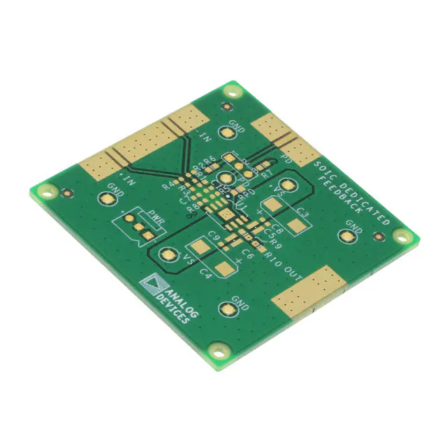

    8-SOIC Package 1 - Single Channels per IC Voltage Feedback Amplifier Evaluation Board
ADA4817-1ARD-EBZ 数据手册
低噪声、1 GHz FastFET运算放大器 ADA4817-1/ADA4817-2 CONNECTION DIAGRAMS 高速 ADA4817-1 TOP VIEW (Not to Scale) −3 dB带宽:1050 MHz(G = 1,RL = 100 Ω) 7 OUT –IN 3 6 NC +IN 4 5 –VS 低输入电容 共模电容:1.3 pF NC = NO CONNECT 图1. 8引脚LFCSP (CP-8-2) 差模电容:0.1 pF ADA4817-1 TOP VIEW (Not to Scale) 低噪声 4 nV/√Hz (100 kHz) 2.5 fA/√Hz (100 kHz) 低失真 FB 1 8 PD –IN 2 7 +VS +IN 3 6 OUT –VS 4 5 NC −90 dBc(10 MHz,G = 1,RL = 1 kΩ) 失调电压:2 mV(最大值) 07756-001 8 +VS FB 2 NC = NO CONNECT 07756-002 低输入偏置电流:2 pA PD 1 图2. 8引脚SOIC (RD-8-1) 高输出电流:40 mA ADA4817-2 TOP VIEW (Not to Scale) 16 FB1 每个放大器的电源电流:19 mA 掉电模式下,每个放大器的电源电流:1.5 mA 14 +VS1 0.1%建立时间:9 ns 13 OUT1 压摆率:870 V/μs 15 PD1 特性 11 NC NC 3 10 +IN2 –VS2 4 9 –IN2 OUT2 5 滤波器 ADC驱动器 CCD输出缓冲器 概述 FB2 8 仪器仪表 12 –VS1 PD2 7 数据采集前端 –IN1 1 +IN1 2 +VS2 6 光电二极管放大器 NC = NO CONNECT 07756-003 应用 图3. 16引脚LFSCP (CP-16-4) ADA4817-1(单通道)和ADA4817-2(双通道)FastFET™ ADA4817-1/ADA4817-2具有5 V至10 V的宽电源电压范围, 放大器是具有FET输入的单位增益稳定、超高速电压反馈 可采用单电源或双电源供电,适合包括有源滤波和ADC驱 型放大器。这些放大器采用ADI公司的专有超快速互补双 动在内的多种应用。 极性(XFCB)工艺进行开发,这一工艺可使放大器实现超低 ADA4817-1采用3 mm × 3 mm 8引脚LFCSP和8引脚SOIC封 的噪声(4 nV/√Hz;2.5 fA/√Hz)及极高的输入阻抗。 装,ADA4817-2采用4 mm × 4 mm 16引脚LFSCP封装。这些 ADA4817-1/ADA4871-2具有1.3 pF的输入电容、4 nV/√Hz 封装都采用低失真引脚排列,可以改善二次谐波失真,并 的低噪声、最大2 mV的低失调电压,以及1050 MHz的−3 简化电路板布局。此外,这些封装都具有裸露焊盘,提供 dB带宽,非常适合数据采集前端及宽带跨导应用,如光电 到达印制电路板(PCB)的低热阻路径,可实现更有效的热 二极管前置放大器等。 传输,并提高可靠性。这两款产品均可在−40°C至+105°C 的扩展工业温度范围内工作。 Rev. A Information furnished by Analog Devices is believed to be accurate and reliable. However, no responsibility is assumed by Analog Devices for its use, nor for any infringements of patents or other rights of third parties that may result from its use. Specifications subject to change without notice. No license is granted by implication or otherwise under any patent or patent rights of Analog Devices. Trademarks and registered trademarks are the property of their respective owners. One Technology Way, P.O. Box 9106, Norwood, MA 02062-9106, U.S.A. Tel: 781.329.4700 www.analog.com Fax: 781.461.3113 ©2008–2009 Analog Devices, Inc. All rights reserved. ADA4817-1/ADA4817-2 目录 特性.....................................................................................................1 驱动容性负载 .............................................................................15 应用.....................................................................................................1 散热考虑 ......................................................................................15 连接图 ................................................................................................1 掉电工作模式 .............................................................................15 概述.....................................................................................................1 容性反馈 ......................................................................................16 修订历史 ............................................................................................2 更高频率衰减 .............................................................................16 技术规格 ............................................................................................3 布局布线、接地和旁路考虑.......................................................17 ±5 V工作 ........................................................................................3 信号布线 ......................................................................................17 5 V工作...........................................................................................4 电源旁路 ......................................................................................17 绝对最大额定值...............................................................................5 接地...............................................................................................17 热阻.................................................................................................5 裸露焊盘 ......................................................................................17 最大安全功耗 ...............................................................................5 漏电流 ..........................................................................................18 ESD警告 .........................................................................................5 输入电容 ......................................................................................18 引脚配置和功能描述 ......................................................................6 输入至输入/输出耦合...............................................................18 典型工作特性 ...................................................................................8 应用信息 ..........................................................................................19 测试电路 ..........................................................................................13 低失真引脚排列.........................................................................19 工作原理 ..........................................................................................14 宽带光电二极管前置放大器 ...................................................19 闭环频率响应 .............................................................................14 高速JFET输入仪表放大器 .......................................................21 同相闭环频率响应 ....................................................................14 有源低通滤波器(LPF) ..............................................................22 反相闭环频率响应 ....................................................................14 外形尺寸 ..........................................................................................24 宽带工作 ......................................................................................15 订购指南 ......................................................................................25 修订历史 2009年3月—修订版0至修订版A 增加8引脚SOIC封装 ................................................................ 通篇 更改特性和概述部分 ......................................................................1 更改表1 ..............................................................................................3 更改表2 ..............................................................................................4 更改图4 ..............................................................................................5 更改图9、图11和图12 ....................................................................8 更改图21、图22和图24 ................................................................10 更改图33 ......................................................................................... 12 增加图34;重新排序 ....................................................................12 更改散热考虑和掉电工作模式部分..........................................15 更改容性反馈部分和图46 ...........................................................16 增加更高频率衰减部分、图47、图48和图49; 重新排序 ..........................................................................................16 更新外形尺寸 .................................................................................24 更改订购指南部分 ........................................................................25 2008年11月—修订版0:初始版 Rev. A | Page 2 of 28 ADA4817-1/ADA4817-2 技术规格 ±5 V工作 除非另有说明,TA = 25°C,+VS = 5 V,−VS = −5 V,G = 1,RF = 348 Ω (G > 1),RL = 100 Ω接地。 表1 参数 动态性能 −3 dB带宽 增益带宽积 全功率带宽 0.1 dB平坦度 压摆率 0.1%建立时间 噪声/谐波性能 谐波失真(HD2/HD3) 输入电压噪声 输入电流噪声 直流性能 输入失调电压 输入失调电压漂移 输入偏置电流 条件 最小值 MHz MHz MHz MHz MHz MHz V/µs ns f = 1 MHz, VOUT = 2 V 峰峰值, R L = 1 kΩ f = 10 MHz, VOUT = 2 V 峰峰值, RL = 1 kΩ f = 50 MHz, VOUT = 2 V 峰峰值, RL = 1 kΩ f = 100 kHz f = 100 kHz −113/−117 −90/−94 −64/−66 4 2.5 dBc dBc dBc nV/√Hz fA/√Hz 62 0.4 7 2 100 1 65 −77 500 1.3 0.1 −VS至+V S − 2.8 −90 GΩ pF pF V dB 8 −VS + 1.4 至 +VS − 1.3 −VS + 1 至 +VS − 1 40 100/170 ns V mA mA >+VS − 1 1),RL = 100 Ω接地。 表2 参数 动态性能 –3 dB带宽 全功率带宽 0.1 dB平坦度 压摆率 0.1%建立时间 噪声/谐波性能 谐波失真(HD2/HD3) 输入电压噪声 输入电流噪声 直流性能 输入失调电压 输入失调电压漂移 输入偏置电流 条件 最小值 输入共模电压范围 共模抑制 输出特性 输出过驱恢复时间 输出电压摆幅 掉电 PD引脚电压 开启/关闭时间 输入漏电流 电源 工作范围 每个放大器的静态电流 掉电静态电流 正电源抑制 负电源抑制 单位 500 160 280 95 32 320 11 MHz MHz MHz MHz MHz V/µs ns f = 1 MHz, VOUT = 1 V 峰峰值, R L = 1 kΩ f = 10 MHz, VOUT = 1 V 峰峰值, R L = 1 kΩ f = 50 MHz, VOUT = 1 V 峰峰值, R L = 1 kΩ f = 100 kHz f = 100 kHz −87/−88 −68/−66 −57/−55 4 2.5 dBc dBc dBc nV/√Hz fA/√Hz 61 0.5 7 2 100 1 63 −72 500 1.3 0.1 −VS to +VS − 2.9 −83 GΩ pF pF V dB 13 −VS + 1 至 +VS − 1.2 −VS + 0.9 至 +VS − 1 20 40/130 ns V mA mA >+VS − 1 1),RL = 100 Ω接地,小信号VOUT = 100 mV峰峰值,大信号 VOUT = 2 V峰峰值。 6 G =2 0 G=5 –3 –6 –9 –12 100k 1M 10M 100M FREQUENCY (Hz) 1G 10G 3 G = 1, DUAL 0 G=5 –3 –6 –9 –12 100k 图8. 不同增益下的小信号频率响应 (LFCSP) 6 G=2 G = 1, SINGLE 1M 10M 100M FREQUENCY (Hz) 1G 10G 07756-009 3 G = 1, SINGLE NORMALIZED CLOSED-LOOP GAIN (dB) G = 1, DUAL 07756-066 NORMALIZED CLOSED-LOOP GAIN (dB) 6 图11. 不同增益下的大信号频率响应 6 VS = 10V, SOIC VS = 10V, LFCSP 3 VS = 5V, LFCSP CLOSED-LOOP GAIN (dB) VS = 5V, SOIC 0 –3 –6 –3 VS = 5V –6 –9 1M 10M 100M FREQUENCY (Hz) 1G 10G VOUT = 1V p-p –12 100k 1M 07756-007 –12 100k 图9. 不同电源下的小信号频率响应 9 1G 10G 图12. 不同电源下的大信号频率响应 9 CL = 6.6pF CL = 4.4pF CL = 2.2pF RF = 348Ω RF = 274Ω 6 6 CLOSED-LOOP GAIN (dB) CL = 0pF 3 0 –3 RF = 200Ω 3 0 –3 –6 –6 G=2 RF = 274Ω –9 100k 1M 10M 100M FREQUENCY (Hz) 1G 10G 07756-068 CLOSED-LOOP GAIN (dB) 10M 100M FREQUENCY (Hz) 07756-010 –9 VS = 10V 0 图10. 不同CL 下的小信号频率响应 G=2 –9 100k 1M 10M 100M FREQUENCY (Hz) 1G 图13. 不同RF下的小信号频率响应 Rev. A | Page 8 of 28 10G 07756-011 CLOSED-LOOP GAIN (dB) 3 ADA4817-1/ADA4817-2 6 G = 2, SS 3 CLOSED-LOOP GAIN (dB) G = 2, LS 0.2 0.1 G = 1, SS 0 G = 1, LS –0.1 –0.2 0 –3 –6 –0.3 –9 –0.4 –0.5 100k 1M 10M 100M FREQUENCY (Hz) 1G 10G –12 100k –40 –40 –60 –60 DISTORTION (dBc) HD2, RL = 100Ω HD2, RL = 1kΩ –100 HD3, RL = 100Ω 100M 07756-014 10M –80 –100 HD2, VS = 10V –140 100k 1M 100M 10M 图18. 不同电源下失真与频率的关系,VOUT = 2 V峰峰值 –20 –20 –40 –40 DISTORTION (dBc) HD2, VS = 5V HD2, VS = 10V –80 –100 fC = 1MHz –60 –80 HD2, RL = 100Ω HD2, RL = 1kΩ –100 HD3, VS = 5V HD3, VS = 10V –120 –140 100k 1M 10M FREQUENCY (Hz) –120 100M 07756-016 DISTORTION (dBc) HD3, VS = 10V FREQUENCY (Hz) 图15. 不同负载下失真与频率的关系,VOUT = 2 V峰峰值 –60 10G HD2, VS = 5V –120 FREQUENCY (Hz) 1G HD3, VS = 5V HD3, RL = 1kΩ 1M 100M 图16. 不同电源下失真与频率的关系,G = 2,VOUT = 2 V峰峰值 Rev. A | Page 9 of 28 –140 HD3, RL = 100Ω HD3, RL = 1kΩ 0 1 2 3 4 5 OUTPUT VOLTAGE (V p-p) 图19. 不同负载下失真与输出电压的关系 6 07756-017 DISTORTION (dBc) –20 –140 100k 10M 图17. 小信号频率响应与温度的关系 –20 –120 1M FREQUENCY (Hz) 图14. 0.1 dB平坦度频率响应与增益和输出电压的关系 –80 TA = +25°C, SINGLE TA = +25°C, DUAL TA = –40°C, SINGLE TA = –40°C, DUAL TA = +105°C, SINGLE TA = +105°C, DUAL 07756-036 0.3 07756-013 0.4 07756-012 NORMALIZED CLOSED-LOOP GAIN (dB) 0.5 ADA4817-1/ADA4817-2 0.15 DUAL, CF = 0.5pF SINGLE, NO CF 0.10 SINGLE OUTPUT VOLTAGE (V) OUTPUT VOLTAGE (V) 0.10 DUAL, CF = 0.5pF SINGLE, NO CF 0.05 0 –0.05 DUAL –0.10 SINGLE 0.05 0 –0.05 DUAL 07756-018 –0.10 G=2 –0.15 –0.15 07756-021 0.15 VS = 5V G=2 TIME (5ns/DIV) TIME (5ns/DIV) 图20. 小信号瞬态响应 图23. 小信号瞬态响应 1.5 0.075 1.0 0 –0.025 DUAL, LFCSP RF = 0Ω RL = 100Ω VS = ±5V G = +1 –0.050 –0.075 0 –0.5 –1.0 SINGLE, LFCSP SINGLE, SOIC 0.5 TIME (5ns/DIV) 图21. 小信号瞬态响应与封装的关系 图24. 大信号瞬态响应 6 0.5 2 × VIN 0.4 4 SETTLING TIME SETTLING TIME (%) 0.3 2 0 –2 VOUT 0.2 0.1 0 –0.1 –0.2 07756-023 –0.3 –4 –0.4 G=2 TIME (10ns/DIV) 07756-019 OUTPUT VOLTAGE (V) SINGLE, LFCSP –1.5 TIME (5ns/DIV) –6 SINGLE,SOIC DUAL, LFCSP RF = 0Ω RL = 100Ω VS = ±5V G = +1 07756-024 OUTPUT VOLTAGE (V) 0.025 07756-022 OUTPUT VOLTAGE (V) 0.050 –0.5 TIME (5ns/DIV) 图22. 输出过驱恢复 图25. 0.1%短期建立时间 Rev. A | Page 10 of 28 ADA4817-1/ADA4817-2 0.5 –10 0.4 –20 0.3 –40 –PSRR +PSRR –50 –60 –70 0.2 0.1 0 –0.1 –0.2 –80 –0.3 –90 –0.4 1M 10M 100M 1G FREQUENCY (Hz) –0.5 –40 07756-032 –100 100k –20 40 60 80 100 图29. 失调电压与温度的关系 1000 INPUT VOLTAGE NOISE (nV/ Hz) –20 –25 –30 –35 –40 –45 –50 –55 –60 1M 10M 100M 1G FREQUENCY (Hz) 100 10 1 10 07756-029 CMRR (dB) 20 TEMPERATURE (°C) 图26. PSRR与频率的关系 –65 –70 –75 –80 –85 –90 –95 –100 100k 0 100 1k 10k 100k 1M 10M 100M 80 100 FREQUENCY (Hz) 图27. CMRR与频率的关系 07756-026 PSRR (dB) –30 07756-037 OFFSET VOLTAGE (mV) 0 图30. 输入电压噪声 100 24 VS = ±5V SUPPLY CURRENT (mA) 10 1 0.1 20 18 16 VS = +5V 14 0.01 100k 1M 10M 100M FREQUENCY (Hz) 1G 图28. 输出阻抗与频率的关系 10 –40 07756-033 12 07756-030 OUTPUT IMPEDANCE ( ) 22 –20 0 20 40 60 TEMPERATURE (°C) 图31. 不同电源电压下静态电流与温度的关系 Rev. A | Page 11 of 28 ADA4817-1/ADA4817-2 VS = ±5V RL = 100Ω 1.5 –V-S + VOUT 700 NUMBER OF HITS 1.4 1.3 +VS – VOUT 1.2 +VS – VOUT 1.1 1.0 400 300 –20 0 20 40 60 80 100 0 –1.5 100 图32. 输出饱和电压与温度的关系 60 GAIN 40 PHASE –90 30 20 10 PHASE (Degrees) –45 50 –135 10M 100M FREQUENCY (Hz) –180 1G 07756-015 0 1M –0.5 0 0.5 1.0 图34. 输入失调电压直方图 0 70 100k –1.0 VOS (mV) TEMPERATURE (°C) –10 10k 500 07756-025 VS = +5V 0.9 0.8 –40 600 200 –VS + VOUT GAIN (dB) N: 4197 MEAN: –0.0248457 SD: 0.245658 800 07756-034 OUTPUT SATURATION VOLTAGE (V) 1.6 图33. 开环增益和相位与频率的关系 Rev. A | Page 12 of 28 1.5 ADA4817-1/ADA4817-2 测试电路 输出反馈引脚用于简化布局,如图35至图40所示。 +VS +VS 10µF + 10µF + RG 0.1µF RF 0.1µF 0.1µF VOUT VIN VOUT VIN RL 49.9Ω 0.1µF RL 49.9Ω 10µF + 0.1µF 07756-147 0.1µF –VS –VS 图35. G = 1配置 图38. 同相增益配置 +VS +VS AC 07756-141 + 10µF 10µF + 49.9Ω 0.1µF VOUT VOUT RL RL 49.9Ω 10µF 07756-145 + 0.1µF –VS 07756-148 AC –VS 图36. 正电源抑制 图39. 负电源抑制 +VS +VS 10µF 10µF + + RF 1kΩ 0.1µF RSNUB VIN 49.9Ω 0.1µF VOUT CL 0.1µF 1kΩ VIN RL VOUT 1kΩ 53.6Ω 10µF 0.1µF RL 1kΩ –VS + 07756-142 + 10µF 0.1µF 0.1µF –VS 图37. 容性负载配置 图40. 共模抑制 Rev. A | Page 13 of 28 07756-146 RG ADA4817-1/ADA4817-2 工作原理 闭环−3 dB频率: ADA4817-1/ADA4817-2是电压反馈型运算放大器,集新型 f - 3dB = fCROSSOVER × FET输入运放结构与ADI公司的超快速互补双极性(XFCB) 工艺于一体,实现了高速度和低噪声的卓越组合。创新的 反相闭环频率响应 高速FET输入级能够处理从负电源电压到正供电轨2.7 V范 解传递函数: 围内的共模信号。此输入级与H桥相结合,实现870 V/μs的 VO - 2 π × fCROSSOVER × RF = VI (RG + RF)S + 2π × fCROSSOVER × RG 压摆率和低失真,以及输入电压噪声为4 nV/√Hz的特性。 该放大器具有一个高速输出级,能够驱动高负载,流出和 吸入最多40 mA的线性电流。电源电流和失调电流经过激 光 调 整 , 从 而 获 得 最 佳 性 能 。 这 些 特 性 使 ADA48171/ADA4817-2成为高速仪器仪表和高分辨率数据采集系统 RG RF + RG VO RF =− VI RG 求出闭环−3 dB频率: 对于直流, f 的绝佳选择。低噪声、皮安级输入电流、精密失调和高速 - 3dB = fCROSSOVER × 特性使这些运放特别适合用作光电二极管应用中的前置放 RG RF + RG 大器。 闭环频率响应 A = (2π× fCROSSOVER )/s 80 环频率响应与积分器响应类似,如图43所示。反相和同相 配置的基本闭环频率响应可以从图41和图42所示的原理图 获得。 RF RG 40 RF 10 FREQUENCY (MHz) 1000 闭环带宽与运算放大器电路的噪声增益((RF + RG)/RG)成反 VOUT 07756-045 A 比。对于2倍以上的噪声增益,这一简单的模型精确可 行。当噪声增益等于或小于2时,电路的实际带宽高于利 图42. 反相配置 用此模型所预测的值,原因是实际运算放大器的频率响应 会被其它极点影响。 同相闭环频率响应 图44显示了电压反馈型放大器的直流误差。对于反相和同 解传递函数: VO 2 π × fCROSSOVER (RG + RF) = VI (RG + RF)S + 2π × fCROSSOVER × RG 相配置, (4)  RF + RG   RF + RG  (10) VOUT (error) = Ib + ×RS   − Ib − ×RF + VOS    RG   RG  其中fCROSSOVER为放大器开环增益等于0 dB时的频率。 RF 对于直流, VO RF + RG = VI RG 100 图43. 基本连接的开环增益与频率的关系 RG VE 1 0.1 07756-046 0 图41. 同相配置 VIN fCROSSOVER = 410MHz 20 +VOS – RG (5) VIN RS Ib – A Ib+ 图43. 基本连接的开环增益与频率的关系 Rev. A | Page 14 of 28 VOUT 07756-047 VIN VOUT A 60 07756-044 VE OPEN-LOOP GAIN (A) (dB) ADA4817-1/ADA4817-2是优秀的电压反馈型放大器,其开 ADA4817-1/ADA4817-2 如 果 R S =R F ||R G , 则 I b +和 I b –所 引 起 的 电 压 误 差 最 小 请注意,这种电容会在频率响应中引起显著的峰化效应。 (ADA4817-1/ADA4817-2的输入电流在皮安范围,这一误 放大器可以驱动更大的电容值,但必须在输出端使用一个 差应当不是问题)。为了包括共模效应和电源抑制效应, 缓冲电阻(RSNUB),如图45所示。增加一个小串联电阻RSNUB 可以将总VOS表示为: 可以创建一个零点,从而抵消负载电容所引入的极点。典 VOS 型RSNUB值在10 Ω至50 Ω范围,此值通常根据电路要求确 ΔVS ΔVCM = VOSnom + + PSR CMR 定。图45还显示了降低容性负载(CL)所引起的极点效应的 另一种方法:在反馈环路中放置一个与反馈电阻并联的电 其中: 容(CF)。典型电容值在0.5 pF至2 pF范围。图46显示了增加 VOSnom是标称条件下的额定失调电压。 一个反馈电容对频率响应的影响。 ΔVS是相对于标称条件的电源变化。PSR为电源抑制性能。 +VS 10µF + ΔVCM是相对于标称条件的共模电压变化。 CF CMR为共模抑制性能。 RG 宽带运作 RF 0.1µF 作为高速缓冲器,ADA4817-1/ADA4817-2能够提供出色的 RSNUB VIN 性能。图41所示电路用于确定高增益下的宽带特性。求和 49.9Ω 点阻抗(RF || RG) 与放大器的1.3pF输入电容形成环路响应的 电阻,也可以补偿频率响应的峰化效应,如图45所示。 RL 07756-143 + 0.1µF –VS 响铃振荡。建议使用100 Ω至400 Ω的反馈电阻,该电阻可 电容(CF)与该反馈电阻并联,或者在同相输入端串联一个 VOUT CL 10µF 一个极点,。如果其频率过低,此极点可能会引起峰化和 以使峰化最小,但不会降低输出级的性能。将一个小反馈 0.1µF 图45. 用于降低峰化效应的RSNUB 或CF 散热考虑 ADA4817-1/ADA4817-2以10 V电源和19 mA静态电流工作 时,空载功耗为190 mW。这意味着,对于LFCSP封装 失真性能取决于多个因素: ( ADA4817-1的 热 阻 为 94°C/W, ADA4817-2的 热 阻 为 • 应用的闭环增益 64°C/W),结温通常比环境温度高出近25°。ADA4817- • 反相抑或同相 1/ADA4817-2旨在保持恒定带宽,能够不随温度而变化, • 放大器负载 因此在预热期间,功耗会有一个初始斜升过程。VOS温漂 • 信号频率和幅度 低于8 μV/°C;对于采用LFCSP封装、以10 V电源工作的 • 电路板布局布线 ADA4817-1/ADA4817-2,预热效应引起的VOS变化幅度最 获得最佳性能的条件一般是:G + 1配置、无反馈电阻、输 出负载电阻较大、电路板寄生电容非常小。 一般而言,高速放大器难以驱动容性负载,特别是在闭环 增益较低的情况下,因为此时相位裕量非常低。其困难在 于负载电容CL会与放大器的输出电阻RO形成一个极点。该 极点可以用下式来描述: 如果此极点太过靠近单位增益交越点,相位裕量就会降 1 fP = 2 πROCL 倍。 高负载会增加功耗并提升芯片结温,如绝对最大额定值部 驱动容性负载 低,原因是该极点会引起额外的相位损耗。 大可达0.3 mV。温度每升高10°C,输入偏置电流增大1.7 分所述。必须注意不要超过封装的额定功耗。 掉电工作模式 ADA4817-1/ADA4817-2的每个放大器都配有独立的掉电引 脚(PD)。当放大器不工作时,用户可以利用掉电功能将其 静态电源电流从19 mA降至2 mA以下。掉电阈值电平是从 施加于+VS引脚的电压推断出来的。在±5 V电源应用中, 使能电压高于+4 V;在+3 V、−2 V电源应用中,使能电压 高于+2 V。不过,只要施加于PD的电压比+VS低3 V,放大 器就会掉电。如果不用PD引脚,应将其连接到正电源,以 确保器件能够正确启动。 Rev. A | Page 15 of 28 ADA4817-1/ADA4817-2 表8. 掉电电压控制 PD 引脚 无效 有效 ±5 V +3 V, −2 V 图47显示了更高频率衰减,它降低了峰化,但同时也降低 >4 V 2 V
