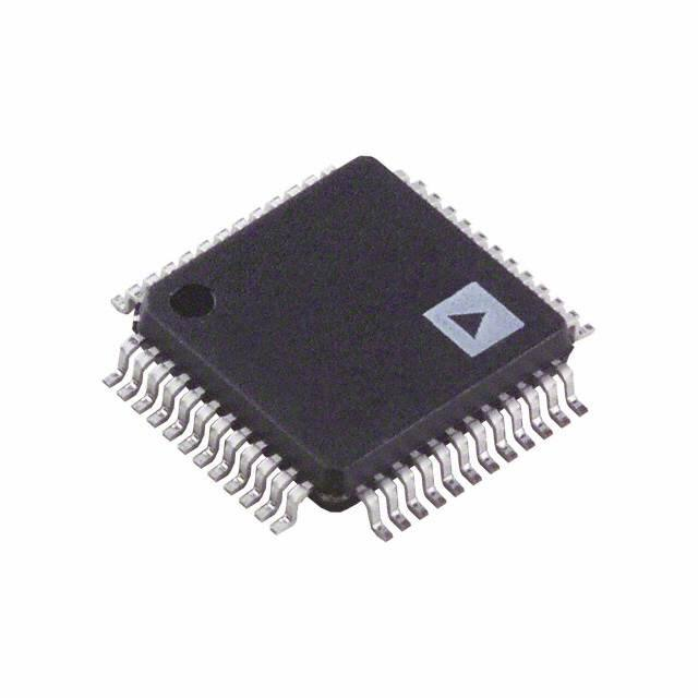

ADG731BSUZ
ADG731BSUZ
    AD(亚德诺)
    TQFP48
    IC MULTIPLEXER 32X1 48TQFP
ADG731BSUZ 数据手册
a 16-/32-Channel, Serially Controlled 4  1.8 V to 5.5 V, 2.5 V, Analog Multiplexers ADG725/ADG731 FEATURES 3-Wire SPI Compatible Serial Interface 1.8 V to 5.5 V Single Supply 2.5 V Dual-Supply Operation 4  On Resistance 0.5  On Resistance Flatness 7 mm x 7 mm 48-Lead Chip Scale Package (LFCSP) or 48-Lead TQFP Package Rail-to-Rail Operation Power-On Reset 42 ns Switching Times Single 32-to-1 Channel Multiplexer Dual/Differential 16-to-1 Channel Multiplexer TTL/CMOS Compatible Inputs For Functionally Equivalent Devices with Parallel Interface, See ADG726/ADG732 FUNCTIONAL BLOCK DIAGRAM ADG731 ADG725 S1 S1A DA S16A D S1B DB S32 S16B INPUT SHIFT REGISTER SCLK DIN SYNC INPUT SHIFT REGISTER SCLK DIN SYNC APPLICATIONS Optical Applications Data Acquisition Systems Communication Systems Relay Replacement Audio and Video Switching Battery-Powered Systems Medical Instrumentation Automatic Test Equipment GENERAL DESCRIPTION The ADG731/ADG725 are monolithic, CMOS, 32-channel/ dual 16-channel analog multiplexers with a serially controlled 3-wire interface. The ADG731 switches one of 32 inputs (S1–S32) to a common output, D. The ADG725 can be configured as a dual mux switching one of 16 inputs to one output, or a differential mux switching one of 16 inputs to a differential output. These mulitplexers utilize a 3-wire serial interface that is compatible with SPI®, QSPI™, MICROWIRE™, and some DSP interface standards. On power-up, the Internal Shift Register contains all zeros and all switches are in the OFF state. These multiplexers are designed on an enhanced submicron process that provides low power dissipation yet gives high switching speed with very low on resistance and leakage currents. They operate from a single supply of 1.8 V to 5.5 V or a ± 2.5 V dual supply, making them ideally suited to a variety of applications. On resistance is in the region of a few ohms, is closely matched between switches, and is very flat over the full signal range. Rev. B These parts can operate equally well as either multiplexers or demultiplexers and have an input signal range that extends to the supplies. In the OFF condition, signal levels up to the supplies are blocked. All channels exhibit break-before-make switching action, preventing momentary shorting when switching channels. The ADG731 and ADG725 are serially controlled 32-channel, and dual/differential 16-channel multiplexers, respectively. They are available in either a 48-lead LFCSP or TQFP package. PRODUCT HIGHLIGHTS 1. 3-Wire Serial Interface. 2. 1.8 V to 5.5 V Single-Supply or ± 2.5 V Dual-Supply Operation. These parts are specified and guaranteed with 5 V ± 10%, 3 V ± 10% single-supply, and ± 2.5 V ± 10% dual-supply rails. 3. On Resistance of 4 W. 4. Guaranteed Break-Before-Make Switching Action. 5. 7 mm ¥ 7 mm 48-Lead Chip Scale Package (LFCSP) or 48-Lead TQFP Package. Document Feedback Information furnished by Analog Devices is believed to be accurate and reliable. However, no responsibility is assumed by Analog Devices for its use, nor for any infringements of patents or other rights of third parties that may result from its use. Specifications subject to change without notice. No license is granted by implication or otherwise under any patent or patent rights of Analog Devices. Trademarks and registered trademarks are the property of their respective owners. One Technology Way, P.O. Box 9106, Norwood, MA 02062-9106, U.S.A. Tel: 781.329.4700 ©2015 Analog Devices, Inc. All rights reserved. Technical Support www.analog.com ADG725/ADG731–SPECIFICATIONS1 (V Parameter +25⬚C ANALOG SWITCH Analog Signal Range On Resistance (RON) B Version –40⬚C to +85⬚C 0 to VDD 4 5.5 On Resistance Match between Channels (ΔRON) On Resistance Flatness (RFLAT(ON)) 6 0.3 0.8 0.5 1 LEAKAGE CURRENTS Source OFF Leakage IS (OFF) Drain OFF Leakage ID (OFF) ADG725 ADG731 Channel ON Leakage ID, IS (ON) ADG725 ADG731 DIGITAL INPUTS Input High Voltage, VINH Input Low Voltage, VINL Input Current IINL or IINH ± 0.01 ± 0.25 ± 0.05 ± 0.5 ±1 ± 0.05 ± 0.5 ±1 = 5 V ± 10%, VSS = 0 V, GND = 0 V, unless otherwise noted.) Unit V Ω typ Ω max Ω typ Ω max Ω typ Ω max Test Conditions/Comments VS = 0 V to VDD, IDS = 10 mA; Test Circuit 1 VS = 0 V to VDD, IDS = 10 mA VS = 0 V to VDD, IDS = 10 mA VDD = 5.5 V VD = 4.5 V/1 V, VS = 1 V/4.5 V; Test Circuit 2 VD = 4.5 V/1 V, VS = 1 V/4.5 V; Test Circuit 3 ± 2.5 ±5 nA typ nA max nA typ nA max nA max nA typ nA max nA max 2.4 0.8 V min V max ± 0.5 μA typ μA max pF typ VIN = VINL or VINH RL = 300 Ω, CL = 35 pF; Test Circuit 5 VS1 = 3 V/0 V, VS32 = 0 V/3 V RL = 300 Ω, CL = 35 pF VS = 3 V; Test Circuit 6 VS = 2.5 V, RS = 0 Ω, CL = 1 nF; Test Circuit 7 RL = 50 Ω, CL = 5 pF, f = 1 MHz; Test Circuit 8 RL = 50 Ω, CL = 5 pF, f = 1 MHz; Test Circuit 9 ±1 ± 2.5 ±5 0.005 CIN, Digital Input Capacitance DD 5 VD = VS = 1 V or 4.5 V; Test Circuit 4 2 DYNAMIC CHARACTERISTICS tTRANSITION Break-Before-Make Time Delay, tD 42 53 30 Charge Injection 5 ns typ ns max ns typ ns min pC typ Off Isolation –72 dB typ Channel-to-Channel Crosstalk –72 dB typ 34 18 15 MHz typ MHz typ pF typ f = 1 MHz 170 340 pF typ pF typ f = 1 MHz f = 1 MHz 175 350 pF typ pF typ f = 1 MHz f = 1 MHz 10 μA typ μA max 62 1 –3 dB Bandwidth ADG725 ADG731 CS (OFF) CD (OFF) ADG725 ADG731 CD, CS (ON) ADG725 ADG731 POWER REQUIREMENTS IDD 20 RL = 50 Ω, CL = 5 pF; Test Circuit 10 VDD = 5.5 V Digital Inputs = 0 V or 5.5 V NOTES 1 Temperature range is as follows: B Version: –40°C to +85°C. 2 Guaranteed by design, not subject to production test. Specifications subject to change without notice. –2– REV. B ADG725/ADG731 SPECIFICATIONS1 (V DD Parameter = 3 V  10%, VSS = 0 V, GND = 0 V, unless otherwise noted.) +25⬚C ANALOG SWITCH Analog Signal Range On Resistance (RON) B Version –40⬚C to +85⬚C 0 to VDD 7 11 On Resistance Match between Channels (ΔRON) On Resistance Flatness (RFLAT(ON)) LEAKAGE CURRENTS Source OFF Leakage IS (OFF) Drain OFF Leakage ID (OFF) ADG725 ADG731 Channel ON Leakage ID, IS (ON) ADG725 ADG731 DIGITAL INPUTS Input High Voltage, VINH Input Low Voltage, VINL Input Current IINL or IINH ± 0.01 ± 0.25 ± 0.05 ± 0.5 ±1 ± 0.05 ± 0.5 ±1 12 0.35 1 3 V Ω typ Ω max Ω typ Ω max Ω max Test Conditions/Comments VS = 0 V to VDD, IDS = 10 mA; Test Circuit 1 VS = 0 V to VDD, IDS = 10 mA VS = 0 V to VDD, IDS = 10 mA VDD = 3.3 V VS = 3 V/1 V, VD = 1 V/3 V; Test Circuit 2 VS = 1 V/3 V, VD = 3 V/1 V; Test Circuit 3 ± 2.5 ±5 nA typ nA max nA typ nA max nA max nA typ nA max nA max 2.0 0.7 V min V max ± 0.5 μA typ μA max pF typ VIN = VINL or VINH RL = 300 Ω, CL = 35 pF; Test Circuit 5 VS1 = 2 V/0 V, VS32 = 0 V/2 V RL = 300 Ω, CL = 35 pF VS = 2 V; Test Circuit 6 VS = 0 V, RS = 0 Ω, CL = 1 nF; Test Circuit 7 RL = 50 Ω, CL = 5 pF, f = 1 MHz; Test Circuit 8 RL = 50 Ω, CL = 5 pF, f = 1 MHz; Test Circuit 9 ±1 ± 2.5 ±5 0.005 CIN, Digital Input Capacitance Unit 5 VS = VD = 1 V or 3 V; Test Circuit 4 2 DYNAMIC CHARACTERISTICS tTRANSITION Break-Before-Make Time Delay, tD 60 80 30 Charge Injection 1 ns typ ns max ns typ ns min pC typ Off Isolation –72 dB typ Channel-to-Channel Crosstalk –72 dB typ 34 18 15 MHz typ MHz typ pF typ f = 1 MHz 170 340 pF typ pF typ f = 1 MHz f = 1 MHz 175 350 pF typ pF typ f = 1 MHz f = 1 MHz 5 μA typ μA max 90 1 –3 dB Bandwidth ADG725 ADG731 CS (OFF) CD (OFF) ADG725 ADG731 CD, CS (ON) ADG725 ADG731 POWER REQUIREMENTS IDD 10 NOTES 1 Temperature range is as follows: B Version: –40°C to +85°C. 2 Guaranteed by design, not subject to production test. Specifications subject to change without notice. REV. B –3– RL = 50 Ω, CL = 5 pF; Test Circuit 10 VDD = 3.3 V Digital Inputs = 0 V or 3.3 V ADG725/ADG731 V  10%, V = –2.5 V  10%, GND = 0 V, otherwise noted.) DUAL-SUPPLY SPECIFICATIONS1 (Vunless= +2.5 DD Parameter +25⬚C ANALOG SWITCH Analog Signal Range On Resistance (RON) B Version –40⬚C to +85⬚C VSS to VDD 4 5.5 On Resistance Match Between Channels (ΔRON) On Resistance Flatness (RFLAT(ON)) 6 0.3 0.8 0.5 1 LEAKAGE CURRENTS Source OFF Leakage IS (OFF) Drain OFF Leakage ID (OFF) ADG725 ADG731 Channel ON Leakage ID, IS (ON) ADG725 ADG731 DIGITAL INPUTS Input High Voltage, VINH Input Low Voltage, VINL Input Current IINL or IINH ± 0.01 ± 0.25 ± 0.05 ± 0.5 ±1 ± 0.01 ± 0.5 ±1 Unit V Ω typ Ω max Ω typ Ω max Ω typ Ω max Test Conditions/Comments VS = VSS to VDD, IDS = 10 mA; Test Circuit 1 VS = VSS to VDD, IDS = 10 mA VS = VSS to VDD, IDS = 10 mA VDD = +2.75 V, VSS = –2.75 V VS = +2.25 V/–1.25 V, VD = –1.25 V/+2.25 V; Test Circuit 2 VS = +2.25 V/–1.25 V, VD = –1.25 V/+2.25 V; Test Circuit 3 ± 2.5 ±5 nA typ nA max nA typ nA max nA max nA typ nA max nA max 1.7 0.7 V min V max ± 0.5 μA typ μA max pF typ VIN = VINL or VINH RL = 300 Ω, CL = 35 pF; Test Circuit 5 VS1 = 1.5 V/0 V, VS32 = 0 V/1.5 V RL = 300 Ω, CL = 35 pF VS = 1.5 V; Test Circuit 6 VS = 0 V, RS = 0 Ω, CL = 1 nF; Test Circuit 7 RL = 50 Ω, CL = 5 pF, f = 1 MHz; Test Circuit 8 RL = 50 Ω, CL = 5 pF, f = 1 MHz; Test Circuit 9 ± 0.5 ± 2.5 ±5 0.005 CIN, Digital Input Capacitance SS 5 VS = VD = +2.25 V/–1.25 V; Test Circuit 4 2 DYNAMIC CHARACTERISTICS tTRANSITION Break-Before-Make Time Delay, tD 55 75 15 Charge Injection Off Isolation 1 –72 ns typ ns max ns typ ns min pC typ dB typ Channel-to-Channel Crosstalk –72 dB typ 34 18 13 MHz typ MHz typ pF typ RL = 50 Ω, CL = 5 pF; Test Circuit 10 130 260 pF typ pF typ f = 1 MHz f = 1 MHz 150 300 pF typ pF typ f = 1 MHz f = 1 MHz 10 μA typ μA max μA typ μA max 84 1 –3 dB Bandwidth ADG725 ADG731 CS (OFF) CD (OFF) ADG725 ADG731 CD, CS (ON) ADG725 ADG731 POWER REQUIREMENTS IDD 20 ISS 10 20 VDD = +2.75 V Digital Inputs = 0 V or 2.75 V VSS = –2.75 V Digital Inputs = 0 V or 2.75 V NOTES 1 Temperature range is as follows: B Version: –40°C to +85°C. 2 Guaranteed by design, not subject to production test. Specifications subject to change without notice. –4– REV. B ADG725/ADG731 TIMING CHARACTERISTICS1, 2 Parameter Limit at TMIN, TMAX Unit Conditions/Comments fSCLK t1 t2 t3 t4 t5 t6 t7 t8 30 33 13 13 13 40 5 4.5 33 MHz max ns min ns min ns min ns min ns min ns min ns min ns min SCLK Cycle Frequency SCLK Cycle Time SCLK High Time SCLK Low Time SYNC to SCLK Falling Edge Setup Time Minimum SYNC Low Time Data Setup Time Data Hold Time Minimum SYNC High Time NOTES 1 See Figure 1. 2 All input signals are specified with tr = tf = 5 ns (10% to 90% of V DD) and timed from a voltage level of (V IL + VIH)/2. Specifications subject to change without notice. t1 SCLK t2 t8 t4 t3 t5 SYNC t7 t6 DB0 DB7 DIN Figure 1. 3-Wire Serial Interface Timing Diagram DB0 (LSB) DB7 (MSB) EN CSA CSB X A3 A2 A1 EN DATA BITS CS X A4 A3 A2 A1 A0 DATA BITS Figure 2. ADG725 Input Shift Register Contents REV. B DB0 (LSB) DB7 (MSB) A0 Figure 3. ADG731 Input Shift Register Contents –5– ADG725/ADG731 ABSOLUTE MAXIMUM RATINGS 1 Storage Temperature Range . . . . . . . . . . . . –65°C to +150°C Junction Temperature . . . . . . . . . . . . . . . . . . . . . . . . . . 150°C Thermal Impedance (4-Layer Board) 48-lead LFCSP . . . . . . . . . . . . . . . . . . . . . . . . . . . 25°C/W 48-lead TQFP . . . . . . . . . . . . . . . . . . . . . . . . . . . 54.6°C/W Lead Temperature, Soldering (10 seconds) . . . . . . . . . . 300°C IR Reflow, Peak Temperature (
