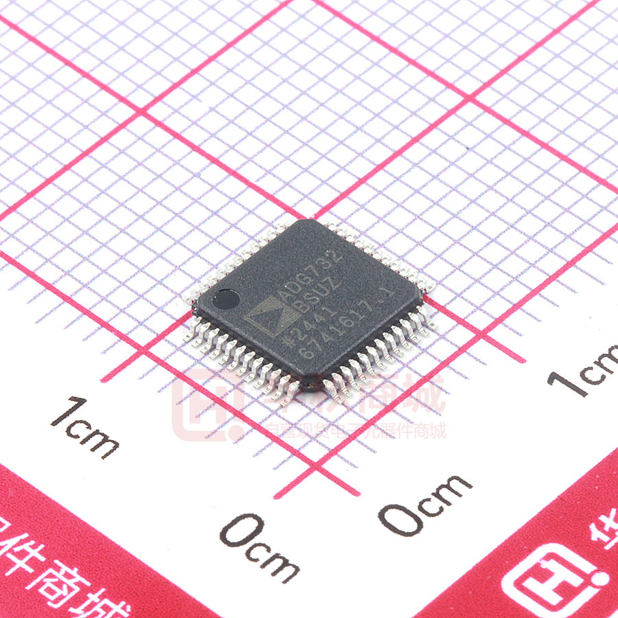

ADG732BSUZ-REEL
ADG732BSUZ-REEL
    AD(亚德诺)
    TQFP48_7X7MM
    16-/32-Channel, 4 Ω, +1.8 V to +5.5 V and ±2.5 V Analog Multiplexers
ADG732BSUZ-REEL 数据手册
FEATURES FUNCTIONAL BLOCK DIAGRAMS 1.8 V to 5.5 V single-supply operation ±2.5 V dual-supply operation On resistance: 4 Ω at 25°C (+5 V single supply/±2.5 V dual supply) 0.5 Ω on-resistance flatness at 25°C (+5 V single supply/ ±2.5 V dual supply) Rail-to-rail operation Transition times: 23 ns typical at 25°C Single 32-to-1 channel multiplexer Dual/differential 16-to-1 channel multiplexer TTL-/CMOS-compatible inputs 48-lead TQFP or 48-lead, 7 mm × 7 mm LFCSP ADG726 S1A DA S16A S1B DB S16B WR CSA 1-OF-16 DECODER 02765-001 CSB A0 A1 A2 A3 EN APPLICATIONS Figure 1. Optical applications Data acquisition systems Communication systems Relay replacement Audio and video switching Battery-powered systems Medical instrumentation Automatic test equipment (ATE) ADG732 S1 D S32 WR CS 1-OF-32 DECODER A0 A1 A2 A3 A4 EN 02765-002 Data Sheet 16-/32-Channel, 4 Ω, +1.8 V to +5.5 V and ±2.5 V Analog Multiplexers ADG726/ADG732 Figure 2. GENERAL DESCRIPTION The ADG726/ADG732 are monolithic, complementary metal oxide semiconductor (CMOS) 32-channel and dual 16-channel analog multiplexers. The ADG732 switches one of 32 inputs (S1 to S32) to a common output, D, as determined by the 5-bit binary address lines A0, A1, A2, A3, and A4. The ADG726 switches one of 16 inputs as determined by the 4-bit binary address lines A0, A1, A2, and A3. On-chip latches facilitate microprocessor interfacing. The ADG726 may also be configured for differential operation by tying CSA and CSB together. An EN input is used to enable or disable the devices. When disabled, all channels are switched off. These multiplexers are designed on an enhanced submicron process that provides low power dissipation yet gives high switching speed, very low on resistance, and leakage currents. They operate from a single supply of +1.8 V to +5.5 V and a ±2.5 V dual supply, making them ideally suited to a variety of applications. On resistance is in the region of a few ohms and is Rev. B closely matched between switches and very flat over the full signal range. These devices can operate equally well as either multiplexers or demultiplexers and have an input signal range that extends to the supplies. In the off condition, signal levels up to the supplies are blocked. All channels exhibit break-before-make switching action, preventing momentary shorting when switching channels. The ADG726/ADG732 are available in a 48-lead LFCSP or a 48-lead TQFP. For functionally equivalent devices with serial interface, see the ADG725/ADG731. PRODUCT HIGHLIGHTS 1. 2. 3. 4. +1.8 V to +5.5 V single- or ±2.5 V dual-supply operation. These devices are specified and guaranteed with +5 V ± 10%, +3 V ± 10% single-supply, and ±2.5 V ± 10% dual-supply rails. An on resistance of 4 Ω. Guaranteed break-before-make switching action. 48-lead LFCSP package or 48-lead TQFP package. Document Feedback Information furnished by Analog Devices is believed to be accurate and reliable. However, no responsibility is assumed by Analog Devices for its use, nor for any infringements of patents or other rights of third parties that may result from its use. Specifications subject to change without notice. No license is granted by implication or otherwise under any patent or patent rights of Analog Devices. Trademarks and registered trademarks are the property of their respective owners. One Technology Way, P.O. Box 9106, Norwood, MA 02062-9106, U.S.A. Tel: 781.329.4700 ©2002–2015 Analog Devices, Inc. All rights reserved. Technical Support www.analog.com ADG726/ADG732 Data Sheet TABLE OF CONTENTS Features .............................................................................................. 1 Absolute Maximum Ratings ............................................................9 Applications ....................................................................................... 1 ESD Caution...................................................................................9 Functional Block Diagrams ............................................................. 1 Pin Configurations and Function Description........................... 10 General Description ......................................................................... 1 48-Lead TQFP ............................................................................ 10 Product Highlights ........................................................................... 1 48-Lead LFCSP ........................................................................... 12 Revision History ............................................................................... 2 Typical Performance Characteristics ........................................... 15 Specifications..................................................................................... 3 Test Circuits..................................................................................... 17 +5 V Single Supply ....................................................................... 3 Terminology .................................................................................... 20 +3 V Single Supply ....................................................................... 5 Outline Dimensions ....................................................................... 21 ±2.5 V Dual Supply ...................................................................... 7 Ordering Guide .......................................................................... 21 Timing Characteristics ................................................................ 8 REVISION HISTORY 6/15—Rev. A to Rev. B Changes to Figure 4 and Table 6 ................................................... 10 Added Figure 5 and Table 7; Renumbered Sequentially ........... 11 Added Figure 6 and Table 8........................................................... 12 Changes to Figure 7, Table 9, and Table 10 ................................. 13 Changes to Table 11 ........................................................................ 14 2/15—Rev. 0 to Rev. A Updated Format .................................................................. Universal Changes to Features Section............................................................ 1 Changes to Table 1 ............................................................................ 3 Changes to Table 2 ............................................................................ 5 Changes to Table 3 ............................................................................ 7 Changes to Table 5 ............................................................................ 9 Added Table 6; Renumbered Sequentially .................................. 10 Added Table 7.................................................................................. 11 Changes to Figure 5 ........................................................................ 11 Changes to Figure 8 to Figure 11 .................................................. 13 Changes to Figure 13 and Figure 15 to Figure 17....................... 14 Changes to Figure 25 to Figure 28 ................................................ 16 Changes to Figure 29 ...................................................................... 17 Moved Terminology Section ......................................................... 18 Changes to Terminology Section.................................................. 18 Updated Outline Dimensions ....................................................... 19 Changes to Ordering Guide .......................................................... 19 7/02—Revision 0: Initial Version Rev. B | Page 2 of 21 Data Sheet ADG726/ADG732 SPECIFICATIONS +5 V SINGLE SUPPLY VDD = 5 V ± 10%, VSS = 0 V, GND = 0 V, unless otherwise noted. Table 1. Parameter ANALOG SWITCH Analog Signal Range On Resistance Symbol RON On Resistance Match Between Channels ΔRON On Resistance Flatness RFLAT (ON) LEAKAGE CURRENTS Source Off Leakage Drain Off Leakage ADG726 ADG732 Channel On Leakage ADG726 ADG732 DIGITAL INPUTS Input High Voltage Input Low Voltage Input Current Low or High Digital Input Capacitance DYNAMIC CHARACTERISTICS1 Transition Time IS (Off ) ID (Off ) ID, IS (On) IINL or IINH ±0.01 ±0.25 ±0.05 ±0.5 ±1 ±0.05 ±0.5 ±1 tTRANSITION 23 34 18 tON (CS, WR) Off Time (CS, WR) tOFF (CS, WR) On Time (EN) tON (EN) tOFF (EN) QINJ ISO CTK BW 7 0.8 1 1 1.2 18 25 17 23 24 32 16 22 5 −72 −72 Unit V Ω typ Ω max Ω typ Ω max Ω typ Ω max Test Conditions/Comments VS = 0 V to VDD, IDS = 10 mA, see Figure 20 VS = 0 V to VDD, IDS = 10 mA VS = 0 V to VDD, IDS = 10 mA VDD = 5.5 V VD = 4.5 V/1 V, VS = 1 V/4.5 V, see Figure 21 ±2.5 ±5 ±10 nA typ nA max nA typ nA max nA max nA typ nA max nA max 2.4 0.8 2.4 0.8 V min V max ±0.5 µA typ µA max pF typ VIN = VINL or VINH ±0.5 40 48 RL = 300 Ω, CL = 35 pF, see Figure 27 VS1 = 3 V/0 V, VS32 = 0 V/3 V RL = 300 Ω, CL = 35 pF; VS = 3 V, see Figure 28 1 1 32 38.5 ns typ ns max ns typ ns min ns typ ns max ns typ ns max ns typ ns max ns typ ns max pC typ dB typ dB typ ±1 ±2.5 ±5 ±2 ±10 0.005 5 On Time (CS, WR) 0 V to VDD 5 6 0.3 ADG732 −40°C to +125°C 0.5 CIN tD Charge Injection Off Isolation Channel-to-Channel Crosstalk −3 dB Bandwidth ADG726 ADG732 4 5.5 VINH VINL Break-Before-Make Time Delay Off Time (EN) ADG726/ADG732 −40°C to +25°C +85°C 29 33 40 43 25 25 34 18 MHz typ MHz typ Rev. B | Page 3 of 21 VD = 4.5 V/1 V, VS = 1 V/4.5 V, see Figure 24 VD = VS = 1 V, or 4.5 V, see Figure 25 RL = 300 Ω, CL = 35 pF; VS = 3 V, see Figure 29 RL = 300 Ω, CL = 35 pF; VS = 3 V, see Figure 29 RL = 300 Ω, CL = 35 pF; VS = 3 V, see Figure 30 RL = 300 Ω, CL = 35 pF; VS = 3 V, see Figure 30 VS = 2.5 V, RS = 0 Ω, CL = 1 nF, see Figure 31 RL = 50 Ω, CL = 5 pF, f = 1 MHz, see Figure 22 RL = 50 Ω, CL = 5 pF, f = 1 MHz, see Figure 23 RL = 50 Ω, CL = 5 pF, see Figure 26 ADG726/ADG732 Parameter Off Switch Source Capacitance Off Switch Drain Capacitance ADG726 ADG732 On Switch Drain, Source Capacitance ADG726 ADG732 POWER REQUIREMENTS Positive Supply Current Data Sheet Symbol CS (Off ) CD (Off ) ADG726/ADG732 −40°C to +25°C +85°C 13 Unit pF typ Test Conditions/Comments f = 1 MHz 170 340 pF typ pF typ f = 1 MHz f = 1 MHz 175 350 pF typ pF typ f = 1 MHz f = 1 MHz VDD = 5.5 V Digital inputs = 0 V or 5.5 V CD, CS (On) IDD 10 20 1 ADG732 −40°C to +125°C 20 Guaranteed by design; not subject to production test. Rev. B | Page 4 of 21 µA typ µA max Data Sheet ADG726/ADG732 +3 V SINGLE SUPPLY VDD = 3 V ± 10%, VSS = 0 V, GND = 0 V, unless otherwise noted. Table 2. Parameter ANALOG SWITCH Analog Signal Range On Resistance Symbol ADG726/ADG732 −40°C to +25°C +85°C 0 V to VDD RON 7 11 On Resistance Match Between Channels ΔRON 12 0.35 On Resistance Flatness RFLAT (ON) 1 3 LEAKAGE CURRENTS Source Off Leakage Drain Off Leakage ADG726 ADG732 Channel On Leakage ADG726 ADG732 DIGITAL INPUTS Input High Voltage Input Low Voltage Input Current Low or High Digital Input Capacitance DYNAMIC CHARACTERISTICS1 Transition Time IS (Off ) ID (Off ) ID, IS (On) IINL or IINH 5 tTRANSITION 34 52 26 On Time (CS, WR) tON (WR, CS) Off Time (CS, WR) tOFF (WR, CS) On Time (EN) tON (EN) tOFF (EN) QINJ ISO CTK BW 13 1 29 43 26 38 33 48 19 25 1 −72 −72 Unit Test Conditions/Comments V Ω typ Ω max Ω typ VS = 0 V to VDD, IDS = 10 mA Ω max Ω typ VS = 0 V to VDD, IDS = 10 mA VS = 0 V to VDD, IDS = 10 mA, see Figure 20 VDD = 3.3 V VS = 3 V/1 V, VD = 1 V/3 V, see Figure 21 ±2.5 ±5 ±10 nA typ nA max nA typ nA max nA max nA typ nA max nA max 2.0 0.7 2.0 0.7 V min V max ±0.5 µA typ µA max pF typ VIN = VINL or VINH ±0.5 62 69 RL = 300 Ω, CL = 35 pF, see Figure 27 VS1 = 2 V/0 V, VS32 = 0 V/2 V RL = 300 Ω, CL = 35 pF; VS = 2 V, see Figure 28 1 1 52 60 ns typ ns max ns typ ns min ns typ ns max ns typ ns max ns typ ns max ns typ ns max pC typ dB typ dB typ ±1 ±2.5 ±5 ±2 ±10 0.005 CIN tD Charge Injection Off Isolation Channel-to-Channel Crosstalk −3 dB Bandwidth ADG726 ADG732 ±0.01 ±0.25 ±0.05 ±0.5 ±1 ±0.05 ±0.5 ±1 VINH VINL Break-Before-Make Time Delay Off Time (EN) ADG732 −40°C to +125°C 42 55.5 55 63.5 28 28 34 18 MHz typ MHz typ Rev. B | Page 5 of 21 VS = 1 V/3 V, VD = 3 V/1 V, see Figure 24 VS = VD = 1 V or 3 V, see Figure 25 RL = 300 Ω, CL = 35 pF; VS = 2 V, see Figure 29 RL = 300 Ω, CL = 35 pF; VS = 2 V, see Figure 29 RL = 300 Ω, CL = 35 pF; VS = 2 V, see Figure 30 RL = 300 Ω, CL = 35 pF; VS = 2 V, see Figure 30 VS = 1.5 V, RS = 0 Ω, CL = 1 nF, see Figure 31 RL = 50 Ω, CL = 5 pF, f = 1 MHz, see Figure 22 RL = 50 Ω, CL = 5 pF, f = 1 MHz, see Figure 23 RL = 50 Ω, CL = 5 pF, see Figure 26 ADG726/ADG732 Parameter Off Switch Source Capacitance Off Switch Drain Capacitance ADG726 ADG732 On Switch Drain, Source Capacitance ADG726 ADG732 POWER REQUIREMENTS Positive Supply Current Data Sheet Symbol CS (Off ) CD (Off ) ADG726/ADG732 −40°C to +25°C +85°C 13 Unit pF typ Test Conditions/Comments f = 1 MHz 170 340 pF typ pF typ f = 1 MHz f = 1 MHz 175 350 pF typ pF typ f = 1 MHz f = 1 MHz VDD = 3.3 V Digital inputs = 0 V or 3.3 V CD, CS (On) IDD 5 10 1 ADG732 −40°C to +125°C 10 Guaranteed by design; not subject to production test. Rev. B | Page 6 of 21 µA typ µA max Data Sheet ADG726/ADG732 ±2.5 V DUAL SUPPLY VDD = +2.5 V ± 10%, VSS = −2.5 V ± 10%, GND = 0 V, unless otherwise noted. Table 3. Parameter ANALOG SWITCH Analog Signal Range On Resistance Symbol ADG726/ADG732 −40°C to +25°C +85°C VSS to VDD RON On Resistance Match Between Channels ∆RON On Resistance Flatness RFLAT (ON) 4 5.5 6 0.3 7 0.8 1 1 1.2 0.5 LEAKAGE CURRENTS Source Off Leakage IS (Off ) ±0.01 ID (Off ) ±0.25 ±0.05 ±0.5 Drain Off Leakage ±0.5 ±1 ±0.05 ±0.5 ±1 ±2.5 ±5 ADG726 ADG732 Channel On Leakage ADG726 ADG732 DIGITAL INPUTS Input High Voltage Input Low Voltage Input Current ID, IS (On) VINH VINL IINL or IINH Digital Input Capacitance DYNAMIC CHARACTERISTICS1 Transition Time 5 tTRANSITION 33 45 15 tD On Time (CS, WR) tON (WR, CS) Off Time (CS, WR) tOFF (WR, CS) On Time (EN) tON (EN) Charge Injection Off Isolation Channel-to-Channel Crosstalk −3 dB Bandwidth ADG726 ADG732 tOFF (EN) QINJ ISO CTK BW ±1 21 30 20 29 26 37 18 26 1 −72 −72 Unit V Ω typ Ω max Ω typ Test Conditions/Comments VS = VSS to VDD, IDS = 10 mA, see Figure 20 VS = VSS to VDD, IDS = 10 mA Ω max Ω typ Ω max VS = VSS to VDD, IDS = 10 mA nA typ VDD = +2.75 V, VSS = −2.75 V VS = +2.25 V/−1.25 V, VD = −1.25 V/+2.25 V, see Figure 21 nA max nA typ VS = +2.25 V/−1.25 V, VD = −1.25 V/+2.25 V, see Figure 24 ±2.5 ±5 ±10 nA max nA max nA typ nA max nA max 1.7 0.7 1.7 0.7 V min V max ±0.5 µA typ µA max pF typ VIN = VINL or VINH ±0.5 51 56 RL = 300 Ω, CL = 35 pF, see Figure 27 VS1 = 1.5 V/0 V, VS32 = 0 V/1.5 V RL = 300 Ω, CL = 35 pF; VS = 1.5 V, see Figure 28 1 1 37 43 ns typ ns max ns typ ns min ns typ ns max ns typ ns max ns typ ns max ns typ ns max pC typ dB typ dB typ ±10 0.005 CIN Break-Before-Make Time Delay Off Time (EN) ADG732 −40°C to +125°C 35 38 50 29 29 34 18 MHz typ MHz typ Rev. B | Page 7 of 21 VS = VD = +2.25 V/−1.25 V, see Figure 25 RL = 300 Ω, CL = 35 pF; VS = 1.5 V, see Figure 29 RL = 300 Ω, CL = 35 pF; VS = 1.5 V, see Figure 29 RL = 300 Ω, CL = 35 pF; VS = 1.8 V, see Figure 30 RL = 300 Ω, CL = 35 pF; VS = 1.8 V, see Figure 30 VS = 0 V, RS = 0 Ω, CL = 1 nF, see Figure 31 RL = 50 Ω, CL = 5 pF, f = 1 MHz, see Figure 22 RL = 50 Ω, CL = 5 pF, f = 1 MHz, see Figure 23 RL = 50 Ω, CL = 5 pF, see Figure 26 ADG726/ADG732 Parameter Off Switch Source Capacitance Off Switch Drain Capacitance ADG726 ADG732 On Switch Drain, Source Capacitance ADG726 ADG732 POWER REQUIREMENTS Positive Supply Current Negative Supply Current 1 Data Sheet ADG726/ADG732 −40°C to +25°C +85°C 13 Symbol CS (Off ) CD (Off ) ADG732 −40°C to +125°C Unit pF typ Test Conditions/Comments 137 275 pF typ pF typ f = 1 MHz f = 1 MHz 150 300 pF typ pF typ f = 1 MHz f = 1 MHz μA typ μA max μA typ μA max VDD = 2.75 V Digital inputs = 0 V or 2.75 V VDD = −2.75 V Digital inputs = 0 V or 2.75 V CD, CS (On) IDD 10 ISS 20 20 20 20 10 Guaranteed by design; not subject to production test. TIMING CHARACTERISTICS Table 4. Parameter1, 2, 3 t1 t2 t3 t4 t5 t6 1 2 3 Limit at TMIN, TMAX 0 0 10 10 5 2 Unit ns min ns min ns min ns min ns min ns min Test Conditions/Comments CS to WR setup time CS to WR hold time WR pulse width Time between WR cycles Address, enable setup time Address, enable hold time See Figure 3. All input signals are specified with tr = tf = 1 ns (10% to 90% of VDD). Guaranteed by design and characterization, not production tested. CS t1 t2 t3 t4 WR t6 02765-003 t5 A0, A1, A2, A3, (A4) EN Figure 3. Timing Diagram Figure 3 shows the timing sequence for latching the switch address and enable inputs. The latches are level sensitive; therefore, while WR is held low, the latches are transparent and the switches respond to changing the address and enable the inputs. Input data is latched on the rising edge of WR. The ADG726 has two CS inputs. This enables the device to be used either as a dual 16-to-1 channel multiplexer or a differential 16-channel multiplexer. If a differential output is required, tie CSA and CSB together. Rev. B | Page 8 of 21 Data Sheet ADG726/ADG732 ABSOLUTE MAXIMUM RATINGS TA = 25°C, unless otherwise noted. Table 5. Parameter VDD to VSS VDD to GND VSS to GND Analog Inputs1 Digital Inputs1 Peak Current, S or D (Pulsed at 1 ms, 10% Duty Cycle Maximum) Continuous Current, S or D Operating Temperature Range ADG726 ADG732 Storage Temperature Range Junction Temperature Thermal Impedance θJA (4-Layer Board) 48-Lead LFCSP 48-Lead TQFP Reflow Soldering Peak Temperature, Pb Free 1 Rating 7V −0.3 V to +7 V +0.3 V to −7 V VSS − 0.3 V to VDD + 0.3 V or 30 mA, whichever occurs first –0.3 V to VDD + 0.3 V or 30 mA, whichever occurs first 60 mA Stresses at or above those listed under Absolute Maximum Ratings may cause permanent damage to the product. This is a stress rating only; functional operation of the product at these or any other conditions above those indicated in the operational section of this specification is not implied. Operation beyond the maximum operating conditions for extended periods may affect product reliability. ESD CAUTION 30 mA −40°C to +85°C −40°C to +125°C −65°C to +150°C 150°C 25°C/W 54.6°C/W As per JEDEC J-STD-020 Overvoltages at A, EN, WR, CS, S, or D will be clamped by internal diodes. Current should be limited to the maximum ratings given. Rev. B | Page 9 of 21 ADG726/ADG732 Data Sheet PIN CONFIGURATIONS AND FUNCTION DESCRIPTION S13B S14B S15B S16B DB NIC DA NIC S16A S15A S14A S13A 48-LEAD TQFP 48 47 46 45 44 43 42 41 40 39 38 37 S12A 1 36 S12B S11A 2 35 S11B S10A 3 34 S10B 33 S9B S9A 4 32 S8B S8A 5 S7A 6 ADG726 31 S7B S6A 7 TOP VIEW (Not to Scale) 30 S6B S5A 8 29 S5B S4A 9 28 S4B S3A 10 27 S3B S2A 11 26 S2B S1A 12 25 S1B NOTES 1. NIC = NOT INTERNALLY CONNECTED. DO NOT CONNECT TO THIS PIN. 02765-005 GND VSS EN WR CSB CSA A3 A2 A1 A0 VDD VDD 13 14 15 16 17 18 19 20 21 22 23 24 Figure 4. ADG726 Pin Configuration Table 6. ADG726 Pin Function Description Pin No. 1 to 12, 45 to 48 13, 14 15 to 18 19 Mnemonic S16A to S1A VDD A0 to A3 CSA 20 CSB 21 WR 22 EN 23 24 GND VSS 25 to 40 41 42, 44 43 S1B to S16B DB NIC DA Description Source Terminal. This pin may be an input or output. Most Positive Power Supply Potential. Logic Control Inputs. Chip Select Pin A. CSA is active low. If a differential output configuration is required, tie CSA and CSB together. Chip Select Pin B. CSB is active low. If a differential output configuration is required, tie CSB and CSA together. Write pin. When WR is low, the logic control inputs (A0 to A3) control which state the switches are in. On the rising edge of WR, the logic control input data is latched. Active Low, Digital Input. When this pin is high, the device is disabled and all switches are off. When this pin is low, the Ax logic control inputs determine the on switches. The EN input signal is not latched by WR. Ground (0 V) Reference. Most Negative Power Supply in a Dual-Supply Application. In single-supply applications, connect this pin to GND. Source Terminal. This pin may be an input or output. Drain Terminal. This pin may be an input or output. Not Internally Connected. Do not connect to this pin. Drain Terminal. This pin may be an input or output. Rev. B | Page 10 of 21 S29 S30 S31 S32 NIC NIC D NIC S16 S15 S14 ADG726/ADG732 S13 Data Sheet 48 47 46 45 44 43 42 41 40 39 38 37 S12 1 36 S28 S11 2 35 S27 S10 3 34 S26 S9 4 33 S25 S8 5 32 S24 S7 6 ADG732 31 S23 S6 7 TOP VIEW (Not to Scale) 30 S22 S5 8 29 S21 S4 9 28 S20 S3 10 27 S19 S2 11 26 S18 S1 12 25 S17 NOTES 1. NIC = NOT INTERNALLY CONNECTED. DO NOT CONNECT TO THIS PIN. 02765-104 VSS GND EN WR CS A4 A3 A2 A1 A0 VDD VDD 13 14 15 16 17 18 19 20 21 22 23 24 Figure 5. ADG732 Pin Configuration Table 7. ADG732 Pin Function Description Pin No. 1 to 12, 45 to 48 13, 14 15 to 19 20 21 Mnemonic S16 to S1 VDD A0 to A4 CS WR 22 EN 23 24 GND VSS 25 to 40 41, 42, 44 43 S17 to S32 NIC D Description Source Terminal. This pin may be an input or output. Most Positive Power Supply Potential. Logic Control Inputs. Chip Select Pin. CS is active low. Write Pin. When WR is low, the logic control inputs (A0 to A4) control which state the switches are in. On the rising edge of WR, the logic control input data is latched. Active Low, Digital Input. When this pin is high, the device is disabled and all switches are off. When this pin is low, the Ax logic control inputs determine the on switches. The EN input signal is not latched by WR. Ground (0 V) Reference. Most Negative Power Supply in a Dual-Supply Application. In single-supply applications, connect this pin to GND. Source Terminal. This pin may be an input or output. Not Internally Connected. Do not connect to this pin. Drain Terminal. This pin may be an input or output. Rev. B | Page 11 of 21 ADG726/ADG732 Data Sheet 48 47 46 45 44 43 42 41 40 39 38 37 S13A S14A S15A S16A NIC DA NIC DB S16B S15B S14B S13B 48-LEAD LFCSP PIN 1 INDICATOR ADG726 TOP VIEW (Not to Scale) 36 35 34 33 32 31 30 29 28 27 26 25 S12B S11B S10B S9B S8B S7B S6B S5B S4B S3B S2B S1B NOTES 1. NIC = NOT INTERNALLY CONNECTED. DO NOT CONNECT TO THIS PIN. 2. THE EXPOSED PAD MUST BE CONNECTED TO GND. 02765-105 VDD VDD A0 A1 A2 A3 CSA CSB WR EN GND VSS 13 14 15 16 17 18 19 20 21 22 23 24 S12A 1 S11A 2 S10A 3 S9A 4 S8A 5 S7A 6 S6A 7 S5A 8 S4A 9 S3A 10 S2A 11 S1A 12 Figure 6. ADG726 Pin Configuration Table 8. ADG726 Pin Function Description Pin No. 1 to 12, 45 to 48 13, 14 15 to 18 19 Mnemonic S16A to S1A VDD A0 to A3 CSA 20 CSB 21 WR 22 EN 23 24 GND VSS 25 to 40 41 42, 44 43 S1B to S16B DB NIC DA EPAD Description Source Terminal. This pin may be an input or output. Most Positive Power Supply Potential. Logic Control Inputs. Chip Select Pin A. CSA is active low. If a differential output configuration is required, tie CSA and CSB together. Chip Select Pin B. CSB is active low. If a differential output configuration is required, tie CSB and CSA together. Write pin. When WR is low, the logic control inputs (A0 to A3) control which state the switches are in. On the rising edge of WR, the logic control input data is latched. Active Low, Digital Input. When this pin is high, the device is disabled and all switches are off. When this pin is low, the Ax logic control inputs determine the on switches. The EN input signal is not latched by WR. Ground (0 V) Reference. Most Negative Power Supply in a Dual-Supply Application. In single-supply applications, connect this pin to GND. Source Terminal. This pin may be an input or output. Drain Terminal. This pin may be an input or output. Not Internally Connected. Do not connect to this pin. Drain Terminal. This pin may be an input or output. Exposed Pad. The exposed pad must be connected to GND. Rev. B | Page 12 of 21 ADG726/ADG732 48 S13 47 S14 46 S15 45 S16 44 NIC 43 D 42 NIC 41 NIC 40 S32 39 S31 38 S30 37 S29 Data Sheet PIN 1 INDICATOR ADG732 TOP VIEW (Not to Scale) 36 S28 35 S27 34 S26 33 S25 32 S24 31 S23 30 S22 29 S21 28 S20 27 S19 26 S18 25 S17 NOTES 1. NIC = NOT INTERNALLY CONNECTED. DO NOT CONNECT TO THIS PIN. 2. THE EXPOSED PAD MUST BE CONNECTED TO GND. 02765-004 VDD 13 VDD 14 A0 15 A1 16 A2 17 A3 18 A4 19 CS 20 WR 21 EN 22 GND 23 VSS 24 S12 1 S11 2 S10 3 S9 4 S8 5 S7 6 S6 7 S5 8 S4 9 S3 10 S2 11 S1 12 Figure 7. ADG732 Pin Configuration Table 9. ADG732 Pin Function Description Pin No. 1 to 12, 45 to 48 13, 14 15 to 19 20 21 Mnemonic S16 to S1 VDD A0 to A4 CS WR 22 EN 23 24 GND VSS 25 to 40 41, 42, 44 43 S17 to S32 NIC D EPAD Description Source Terminal. This pin may be an input or output. Most Positive Power Supply Potential. Logic Control Inputs. Chip Select Pin. CS is active low. Write Pin. When WR is low, the logic control inputs (A0 to A4) control which state the switches are in. On the rising edge of WR, the logic control input data is latched. Active Low, Digital Input. When this pin is high, the device is disabled and all switches are off. When this pin is low, the Ax logic control inputs determine the on switches. The EN input signal is not latched by WR. Ground (0 V) Reference. Most Negative Power Supply in a Dual-Supply Application. In single-supply applications, connect this pin to GND. Source Terminal. This pin may be an input or output. Not Internally Connected. Do not connect to this pin. Drain Terminal. This pin may be an input or output. Exposed Pad. The exposed pad must be connected to GND. Truth Tables Table 10. ADG726 Truth Table A31 A21 A11 A01 X X X 0 0 0 0 0 0 0 0 1 1 1 1 X X X 0 0 0 0 1 1 1 1 0 0 0 0 X X X 0 0 1 1 0 0 1 1 0 0 1 1 X X X 0 1 0 1 0 1 0 1 0 1 0 1 EN1 X X 1 0 0 0 0 0 0 0 0 0 0 0 0 CSA 1 1 X 0 0 0 0 0 0 0 0 0 0 0 0 CSB 1 1 X 0 0 0 0 0 0 0 0 0 0 0 0 WR1 On Switch L→H X X 0 0 0 0 0 0 0 0 0 0 0 0 Latches control input data No change in switch condition None S1A to DA, S1B to DB S2A to DA, S2B to DB S3A to DA, S3B to DB S4A to DA, S4B to DB S5A to DA, S5B to DB S6A to DA, S6B to DB S7A to DA, S7B to DB S8A to DA, S8B to DB S9A to DA, S9B to DB S10A to DA, S10B to DB S11A to DA, S11B to DB S12A to DA, S12B to DB Rev. B | Page 13 of 21 ADG726/ADG732 Data Sheet A31 A21 A11 A01 EN1 CSA CSB WR1 On Switch 1 1 1 1 1 1 1 1 0 0 1 1 0 1 0 1 0 0 0 0 0 0 0 0 0 0 0 0 0 0 0 0 S13A to DA, S13B to DB S14A to DA, S14B to DB S15A to DA, S15B to DB S16A to DA, S16B to DB 1 X is don’t care, L is low, and H is high. Table 11. ADG732 Truth Table A41 A31 A21 A11 A01 EN1 CS WR1 Switch Condition X X X 0 0 0 0 0 0 0 0 0 0 0 0 0 0 0 0 1 1 1 1 1 1 1 1 1 1 1 1 1 1 1 1 X X X 0 0 0 0 0 0 0 0 1 1 1 1 1 1 1 1 0 0 0 0 0 0 0 0 1 1 1 1 1 1 1 1 X X X 0 0 0 0 1 1 1 1 0 0 0 0 1 1 1 1 0 0 0 0 1 1 1 1 0 0 0 0 1 1 1 1 X X X 0 0 1 1 0 0 1 1 0 0 1 1 0 0 1 1 0 0 1 1 0 0 1 1 0 0 1 1 0 0 1 1 X X X 0 1 0 1 0 1 0 1 0 1 0 1 0 1 0 1 0 1 0 1 0 1 0 1 0 1 0 1 0 1 0 1 X X 1 0 0 0 0 0 0 0 0 0 0 0 0 0 0 0 0 0 0 0 0 0 0 0 0 0 0 0 0 0 0 0 0 1 1 X 0 0 0 0 0 0 0 0 0 0 0 0 0 0 0 0 0 0 0 0 0 0 0 0 0 0 0 0 0 0 0 0 L→H X X 0 0 0 0 0 0 0 0 0 0 0 0 0 0 0 0 0 0 0 0 0 0 0 0 0 0 0 0 0 0 0 0 Latches control input data No change in switch condition None 1 2 3 4 5 6 7 8 9 10 11 12 13 14 15 16 17 18 19 20 21 22 23 24 25 26 27 28 29 30 31 32 1 X is don’t care, L is low, and H is high. Rev. B | Page 14 of 21 Data Sheet ADG726/ADG732 TYPICAL PERFORMANCE CHARACTERISTICS 8 8 TA = 25°C VSS = 0V VDD = 2.7V VDD = +3V +125°C 7 7 +85°C VDD = 3.0V 5 6 ON RESISTANCE (Ω) VDD = 3.3V 4 3 VDD = 4.5V VDD = 5V 2 VDD = 5.5V 5 +25°C 4 –40°C 3 2 0 0.5 1.0 1.5 2.0 2.5 3.0 3.5 4.0 4.5 5.0 5.5 VD, VS (V) 0 02765-006 0 0 0.5 1.0 1.5 2.0 2.5 Figure 8. On Resistance vs. VD (VS), Single Supply Figure 11. On Resistance vs. VD (VS), Single Supply 8 8 VDD = +2.5V VSS = –2.5V TA = 25°C 7 7 VDD = +2.25V VSS = –2.25V ON RESISTANCE (Ω) 5 4 VDD = +2.75V VSS = –2.75V 3 +85°C 5 4 3 2 2 1 1 0 –1.75 0.25 –0.75 +125°C 6 VDD = +2.75V VSS = –2.75V 1.25 2.25 VD, VS (V) +25°C 0 –2.5 02765-007 RESISTANCE (Ω) 6 3.0 VD, VS (V) 02765-009 1 1 –2.0 –1.5 –1.0 –0.5 0 –40°C 0.5 1.0 1.5 2.0 2.5 VD, VS (V) Figure 9. On Resistance vs. VD (VS), Dual Supply 02765-010 ON RESISTANCE (Ω) 6 Figure 12. On Resistance vs. VD (VS), Dual Supply 8 2000 VDD = +5V VDD = +5V 7 +125°C LEAKAGE CURRENT (pA) ON RESISTANCE (Ω) 1500 +85°C 6 5 4 +25°C 3 –40°C 2 ON (+, +) 1000 ON (–, –) 500 OFF (+, –) 0 1 0.5 1.0 1.5 2.0 2.5 3.0 VS, VD (V) 3.5 4.0 4.5 5.0 Figure 10. On Resistance vs. VD (VS) for Different Temperatures, Single Supply Rev. B | Page 15 of 21 –500 0 20 40 60 80 100 TEMPERATURE (°C) Figure 13. Leakage Currents vs. Temperature 120 02765-011 0 02765-008 OFF (–, +) 0 ADG726/ADG732 Data Sheet 25 0 TA = +25°C –10 20 VDD = 5V TA = 25°C –20 15 –30 OFF ISOLATION (dB) QINJ (pC) 10 5 0 –40 –50 –60 –70 –5 –80 –10 1 0 –1 2 4 3 5 VD, VS (V) –100 0.03 0 45 –10 tON, VDD = 3V CROSSTALK (dB) 25 tOFF, VDD = 3V –30 –40 –50 –60 –70 tOFF, VDD = 5V 10 –80 5 –90 0 –40 –20 0 20 40 60 80 100 120 TEMPERATURE (°C) –100 0.03 02765-013 0.1 1 10 Figure 18. Crosstalk vs. Frequency Figure 15. tON/tOFF (EN) Time vs. Temperature 1.8 0 TA = +25°C ADG726 1.6 –2 INSERTION LOSS (dB) 1.4 1.2 RISING 1.0 FALLING 0.8 0.6 –4 ADG732 –6 –8 –10 0.4 –12 0.2 0 0 1 2 3 4 5 6 VDD (V) VDD = 5V TA = 25°C –14 0.03 0.1 02765-014 LOGIC THRESHOLD VOLTAGE (V) 100 FREQUENCY (MHz) 1 10 FREQUENCY (MHz) Figure 16. Logic Threshold Voltage vs. Supply Voltage (VDD) Figure 19. Insertion Loss vs. Frequency Rev. B | Page 16 of 21 100 02765-017 TIME (ns) tON, VDD = 5V 15 VDD = 3V, 5V TA = 25°C –20 35 20 100 Figure 17. Off Isolation vs. Frequency 50 30 10 1 FREQUENCY (MHz) Figure 14. ADG732 Charge Injection (QINJ) vs. VD (VS) 40 0.1 02765-016 –2 02765-012 –15 –3 02765-015 –90 Data Sheet ADG726/ADG732 TEST CIRCUITS S1 V1 VDD VSS VDD VSS D S2 D VS RON = V1/IDS GND Figure 20. On Resistance S1 A VSS VDD VSS VS Figure 24. ID (Off) D S2 VDD VSS VDD VSS D S1 S32 LOGIC 1 VS 02765-019 EN GND VD GND Figure 21. IS (Off) VDD 0.1µF VSS S VD LOGIC 0 50Ω A0 NETWORK ANALYZER 50Ω S VS D VOUT RL 50Ω ADG732* VSS A4 VS EN 0.1µF VDD NETWORK ANALYZER 50Ω D LOGIC 1 EN VSS 0.1µF A4 A0 A Figure 25. ID (On) VSS 0.1µF VDD ID (ON) S32 VS VDD VD LOGIC 1 VOUT RL 50Ω EN ADG732* GND OFF ISOLATION = 20 LOG VOUT VS *SIMILAR CONNECTION FOR ADG726. 02765-027 GND INSERTION LOSS = 20 LOG VOUT WITH SWITCH VOUT WITHOUT SWITCH *SIMILAR CONNECTION FOR ADG726. Figure 26. Bandwidth Figure 22. Off Isolation VDD VSS VDD VSS S1 A4 A0 S2 S32 ADG732* D 50Ω NETWORK ANALYZER 50Ω VS VOUT RL 50Ω *SIMILAR CONNECTION FOR ADG726. CHANNEL-TO-CHANNEL CROSSTALK = 20LOG10 (VOUT/VS) 02765-028 EN CS GND WR Figure 23. Channel-to-Channel Crosstalk Rev. B | Page 17 of 21 02765-029 IS (OFF) VDD EN 02765-021 VS A S32 02765-018 S ID(OFF) 02765-020 IDS ADG726/ADG732 Data Sheet VSS VDD VSS A4 VIN VIN S1 50Ω ADDRESS DRIVE (VIN) VS1 VS1 VS32 S32 ADG732* 50% 0V S2 THRU S31 A0 50% D RL 300Ω EN CS GND WR CL 35pF 90% VOUT VOUT 90% VS32 tTRANSITION tTRANSITION 02765-022 VDD *SIMILAR CONNECTION FOR ADG726. Figure 27. Switching Time of Multiplexer, tTRANSITION VSS VDD VSS A4 VIN 50Ω A0 VIN S1 VS ADDRESS DRIVE (VIN) S2 THRU S31 0V S32 ADG732* VS D RL 300Ω EN CS GND WR CL 35pF VOUT VOUT 80% 80% 02765-023 VDD tOPEN *SIMILAR CONNECTION FOR ADG726. Figure 28. Break-Before-Make Delay, tOPEN VDD VSS VDD VSS VIN A4 VWR S1 50% 0V VS S2 THRU S32 A0 ADG732* WR VWR EN D RL 300Ω GND CL 35pF VOUT SWITCH VOUT OUTPUT 0V tON (WR) 20% tOFF (WR) 20% *SIMILAR CONNECTION FOR ADG726. 02765-024 CS VCS Figure 29. Write Turn-On and Turn-Off Time, tON, tOFF (WR) VDD VSS VDD VSS A4 VIN S1 VS VEN 50% A0 tON (EN) EN ADG732* CS GND D WR RL 300Ω CL 35pF VOUT SWITCH OUTPUT VOUT 90% tOFF (EN) 10% 0V 02765-025 VEN 50% 0V S2 THRU S32 *SIMILAR CONNECTION FOR ADG726. Figure 30. Enable Delay, tON (EN), tOFF (EN) Rev. B | Page 18 of 21 Data Sheet ADG726/ADG732 A4 VDD VSS VDD VSS VIN A0 LOGIC INPUT (VIN) ADG732* S VS EN VIN CS D CL 1nF GND WR VOUT 0V VOUT QINJ = CL × ∆VOUT ∆VOUT 02765-026 RS *SIMILAR CONNECTION FOR ADG726. Figure 31. Charge Injection Rev. B | Page 19 of 21 ADG726/ADG732 Data Sheet TERMINOLOGY IDD IDD represents the positive supply current. CD (Off) CD (Off) represents the off switch drain capacitance. It is measured with reference to ground. ISS ISS represents the negative supply current. CD (On), CS (On) CD (On) and CS (On) represent the on switch capacitances, which are measured with reference to ground. IN IN represents the logic control input. VD (VS) VD and VS represent the analog voltage on the Dx pins and the Sx pins, respectively. RON RON represents the ohmic resistance between the Dx pins and the Sx pins. CIN CIN is the digital input capacitance. tTRANSITION tTRANSITION is the delay time measured between the 50% and 90% points of the digital inputs and the switch on condition when switching from one address state to another. ∆RON ∆RON represents the difference between the RON of any two channels. tON (EN) tON (EN) is the delay time between the 50% and 90% points of the EN digital input and the switch on condition. RFLAT(ON) RFLAT(ON) is the flatness that is defined as the difference between the maximum and minimum value of on resistance measured over the specified analog signal range. tOFF (EN) tOFF (EN) is the delay time between the 50% and 90% points of the EN digital input and the switch off condition. IS (Off) IS (Off) represents the source leakage current with the switch off. ID (Off) ID (Off) represents the drain leakage current with the switch off. ID (On), IS (On) ID (On) and IS (On) represent the channel leakage currents with the switch on. VINL VINL is the maximum input voltage for Logic 0. VINH VINH is the minimum input voltage for Logic 1. IINL, IINH IINL and IINH represent the low and high input currents of the digital inputs. tOPEN tOPEN is the off time measured between the 80% points of both switches when switching from one address state to another Charge Injection Charge injection is a measure of the glitch impulse transferred from the digital input to the analog output during switching. Off Isolation Off isolation is a measure of the unwanted signal coupling through an off switch. Channel-to-Channel Crosstalk Crosstalk is a measure of unwanted signal that is coupled through from one channel to another as a result of parasitic capacitance. Insertion Loss Insertion loss is the loss due to the on resistance of the switch. CS (Off) CS (Off) represents the off switch source capacitance. It is measured with a reference to ground. Rev. B | Page 20 of 21 Data Sheet ADG726/ADG732 OUTLINE DIMENSIONS 7.10 7.00 SQ 6.90 0.30 0.23 0.18 0.60 MAX 0.60 MAX 37 48 1 36 PIN 1 INDICATOR 6.85 6.75 SQ 6.65 0.50 REF 5.25 5.10 SQ 4.95 EXPOSED PAD 25 0.25 MIN 5.50 REF 0.80 MAX 0.65 TYP 12° MAX FOR PROPER CONNECTION OF THE EXPOSED PAD, REFER TO THE PIN CONFIGURATION AND FUNCTION DESCRIPTIONS SECTION OF THIS DATA SHEET. 0.05 MAX 0.02 NOM COPLANARITY 0.08 0.20 REF SEATING PLANE 06-05-2012-A 1.00 0.85 0.80 12 13 24 0.50 0.40 0.30 TOP VIEW PIN 1 INDICATOR COMPLIANT TO JEDEC STANDARDS MO-220-VKKD-2 Figure 32. 48-Lead Frame Chip Scale Package [LFCSP_VQ] 7 mm × 7 mm Body, Very Thin Quad (CP-48-1) Dimensions shown in millimeters 0.75 0.60 0.45 1.20 MAX 9.00 BSC SQ 37 36 48 1 PIN 1 1.05 1.00 0.95 0.15 0.05 SEATING PLANE 0.20 0.09 7° 3.5° 0° 0.08 MAX COPLANARITY 7.00 BSC SQ TOP VIEW 0° MIN (PINS DOWN) 12 13 25 24 VIEW A VIEW A 0.50 0.27 BSC 0.22 LEAD PITCH 0.17 ROTATED 90° CCW COMPLIANT TO JEDEC STANDARDS MS-026ABC Figure 33. 48-Lead Thin Plastic Quad Flat Package [TQFP] (SU-48) Dimensions shown in millimeters ORDERING GUIDE Model1 ADG726BCPZ ADG726BCPZ-REEL ADG726BSUZ ADG726BSUZ-REEL ADG732BCPZ ADG732BCPZ-REEL ADG732BSUZ ADG732BSUZ-REEL 1 Temperature Range –40°C to +85°C –40°C to +85°C –40°C to +85°C –40°C to +85°C –40°C to +125°C –40°C to +125°C –40°C to +125°C –40°C to +125°C Package Description 48-Lead Frame Chip Scale Package [LFCSP_VQ] 48-Lead Frame Chip Scale Package [LFCSP_VQ] 48-Lead Thin Plastic Quad Flat Package [TQFP] 48-Lead Thin Plastic Quad Flat Package [TQFP] 48-Lead Frame Chip Scale Package [LFCSP_VQ] 48-Lead Frame Chip Scale Package [LFCSP_VQ] 48-Lead Thin Plastic Quad Flat Package [TQFP] 48-Lead Thin Plastic Quad Flat Package [TQFP] Z = RoHS-Compliant Part ©2002–2015 Analog Devices, Inc. All rights reserved. Trademarks and registered trademarks are the property of their respective owners. D02765-0-6/15(B) Rev. B | Page 21 of 21 Package Option CP-48-1 CP-48-1 SU-48 SU-48 CP-48-1 CP-48-1 SU-48 SU-48
