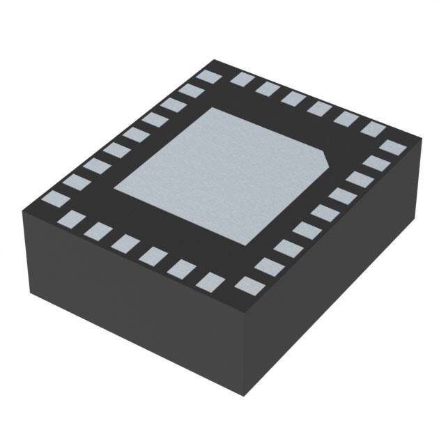

ADGS1414DBCCZ-RL7
ADGS1414DBCCZ-RL7
    AD(亚德诺)
    FLGA30
    FULLY INTEGRATED, 1.5 ? RON, 15
ADGS1414DBCCZ-RL7 数据手册
FEATURES FUNCTIONAL BLOCK DIAGRAM SPI with error detection Includes CRC, invalid read and write address, and SCLK count error detection Supports burst mode and daisy-chain mode Industry-standard SPI Mode 0 and Mode 3 interface compatible Integrated passive components Route through of digital signals and supplies Guaranteed break-before-make switching allowing external wiring of switches to deliver multiplexer configurations 1.5 Ω typical on resistance at 25°C (±15 V dual supply) 0.3 Ω typical on resistance flatness at 25°C (±15 V dual supply) 0.1 Ω typical on resistance match between channels at 25°C (±15 V dual supply) VSS to VDD analog signal range Fully specified at ±15 V, ±5 V, and +12 V 1.8 V logic compatibility with 2.7 V ≤ VL ≤ 3.3 V (excludes SPI readback to a 1.8 V device) 4 mm × 5 mm, 30-terminal LGA APPLICATIONS Automated test equipment Data acquisition systems Sample-and-hold systems Audio and video signal routing Communications systems Relay replacement VDD ADGS1414D S1 D1 S2 D2 S3 D3 S4 D4 S5 D5 S6 D6 S7 D7 S8 VL SPI INTERFACE SCLK SDI CS RESET/VL D8 SDO Figure 1. The ADGS1414D is suited to high density switching applications, such as large switching matrices and fanout applications. Each switch conducts equally well in both directions when on, and each switch has an input signal range that extends to the supplies. In the off condition, signal levels up to the supplies are blocked. Multifunction pin names may be referenced by their relevant function only. GENERAL DESCRIPTION The ADGS1414D contains eight independent SPST switches. A serial peripheral interface (SPI) controls the switches. The SPI has robust error detection features, such as cyclic redundancy check (CRC) error detection, invalid read and write address detection, and SCLK count error detection. It is possible to daisy-chain multiple ADGS1414D devices together. Daisy-chain mode enables the configuration of multiple devices with a minimal amount of digital lines. The route of digital signals and supplies through the ADGS1414D allows for a further increase in channel density. Integrated passive components eliminate the need for external passive components. PRODUCT HIGHLIGHTS 1. 2. 3. 4. 5. 6. 7. Rev. 0 VSS 23895-001 Data Sheet SPI, 1.5 Ω RON, ±15 V/±5 V/+12 V, High Density Octal SPST Switch ADGS1414D The SPI removes the need for parallel conversion and logic traces and reduces the general-purpose input and output (GPIO) channel count. Daisy-chain mode removes additional logic traces when multiple devices are used. Route through of digital signals and supplies eases routing and allows for an increase in channel density. Integrated passive components eliminate the need for external passive components. CRC error detection, invalid read and write address detection, and SCLK count error detection ensure a robust digital interface. CRC, invalid read and write address, and SCLK error detection capabilities allow for the use of the ADGS1414D in safety critical systems. Minimum distortion. Document Feedback Information furnished by Analog Devices is believed to be accurate and reliable. However, no responsibility is assumed by Analog Devices for its use, nor for any infringements of patents or other rights of third parties that may result from its use. Specifications subject to change without notice. No license is granted by implication or otherwise under any patent or patent rights of Analog Devices. Trademarks and registered trademarks are the property of their respective owners. One Technology Way, P.O. Box 9106, Norwood, MA 02062-9106, U.S.A. Tel: 781.329.4700 ©2020 Analog Devices, Inc. All rights reserved. Technical Support www.analog.com ADGS1414D Data Sheet TABLE OF CONTENTS Features .............................................................................................. 1 Clearing the Error Flags Register ............................................. 21 Applications ...................................................................................... 1 Burst Mode .................................................................................. 21 General Description ......................................................................... 1 Software Reset ............................................................................. 21 Functional Block Diagram .............................................................. 1 Daisy-Chain Mode ..................................................................... 21 Product Highlights ........................................................................... 1 Power-On Reset.......................................................................... 22 Revision History ............................................................................... 2 Applications Information ............................................................. 23 Specifications .................................................................................... 3 System Channel Density ........................................................... 23 ±15 V Dual Supply ....................................................................... 3 Break-Before-Make Switching ................................................. 24 ±5 V Dual Supply ......................................................................... 5 Digital Input Buffers .................................................................. 24 12 V Single Supply ....................................................................... 7 Power Supply Rails..................................................................... 24 Continuous Current per Channel, Sx or Dx ............................ 9 Power Supply Recommendations ............................................ 24 Timing Characteristics ................................................................ 9 1.8 V Logic Compatibility ......................................................... 24 Absolute Maximum Ratings ......................................................... 11 Register Summary .......................................................................... 25 Thermal Resistance .................................................................... 11 Register Details ............................................................................... 26 Electrostatic Discharge (ESD) Ratings .................................... 11 Switch Data Register .................................................................. 26 ESD Caution................................................................................ 11 Error Configuration Register ................................................... 26 Pin Configuration and Function Descriptions .......................... 12 Error Flags Register.................................................................... 27 Typical Performance Characteristics ........................................... 13 Burst Enable Register ................................................................. 27 Test Circuits .................................................................................... 17 Software Reset Register ............................................................. 27 Terminology .................................................................................... 19 Outline Dimensions ....................................................................... 28 Theory of Operation ...................................................................... 20 Ordering Guide .......................................................................... 28 Address Mode ............................................................................. 20 Error Detection Features ........................................................... 20 REVISION HISTORY 6/2020—Revision 0: Initial Version Rev. 0 | Page 2 of 28 Data Sheet ADGS1414D SPECIFICATIONS ±15 V DUAL SUPPLY VDD = +15 V ± 10%, VSS = −15 V ± 10%, VL = 2.7 V to 5.5 V, and GND = 0 V, unless otherwise noted. Table 1. Parameter ANALOG SWITCH Analog Signal Range On Resistance, RON On-Resistance Match Between Channels, ∆RON On-Resistance Flatness, RFLAT (ON) LEAKAGE CURRENTS Source Off Leakage, IS (Off) Drain Off Leakage, ID (Off) Channel On Leakage, ID (On), IS (On) +25°C −40°C to +85°C VDD to VSS V Ω typ 1.8 0.1 2.3 2.6 Ω max Ω typ 0.18 0.3 0.19 0.21 Ω max Ω typ VS = ±10 V, IS = −10 mA 0.36 0.4 0.45 ±0.03 ±0.55 ±0.03 ±0.55 ±0.15 ±2 ±2 ±4 ±2 ±12.5 ±12.5 nA max nA typ nA max nA typ VS = ±10 V, VD =  10 V, see Figure 32 VS = VD = ±10 V, see Figure 28 nA max 0.4 0.3 VL − 1.25 V VL − 0.125 V V max V max V min V min pF typ Sink current, ISINK = 1 mA ISINK = 100 µA Source current, ISOURCE = 1 mA ISOURCE = 100 µA 2 1.35 0.8 0.8 V min V min V max V max 3.3 V < VL ≤ 5.5 V 2.7 V ≤ VL ≤ 3.3 V 3.3 V < VL ≤ 5.5 V 2.7 V ≤ VL ≤ 3.3 V µA typ Input voltage, VIN = ground voltage, VGND or VL 4 0.001 4 µA max pF typ 400 ns typ 475 160 190 VDD = +16.5 V, VSS = −16.5 V VS = ±10 V, drain voltage, VD =  10 V, see Figure 32 ±30 ±0.1 Off Time, tOFF Ω max nA typ Low, VINL Digital Input Capacitance, CIN DYNAMIC CHARACTERISTICS1 On Time, tON Test Conditions/Comments Source voltage, VS = ±10 V, source current, IS = −10 mA, see Figure 29 VDD = +13.5 V, VSS = −13.5 V VS = ±10 V, IS = −10 mA High, VOH Input Current Low, IINL or High, IINH Unit 1.5 DIGITAL OUTPUT Output Voltage Low, VOL Digital Output Capacitance, COUT DIGITAL INPUTS Input Voltage High, VINH −40°C to +125°C 480 485 210 225 Rev. 0 | Page 3 of 28 ns max ns typ ns max Load resistance, RL = 300 Ω, load capacitance, CL = 35 pF VS = 10 V, see Figure 37 RL = 300 Ω, CL = 35 pF VS = 10 V, see Figure 37 ADGS1414D Parameter Break-Before-Make Time Delay, tD Data Sheet +25°C 215 −40°C to +85°C −40°C to +125°C Unit ns typ Test Conditions/Comments RL = 300 Ω, CL = 35 pF 170 ns min Source 1 voltage, VS1 = Source 2 voltage, VS2 = 10 V, see Figure 36 VS = 0 V, source resistance, RS = 0 Ω, CL = 1 nF, see Figure 38 RL = 50 Ω, CL = 5 pF, frequency, f = 1 MHz, see Figure 31 RL = 50 Ω, CL = 5 pF, f = 1 MHz, see Figure 30 RL = 110 Ω, 15 V p-p, f = 20 Hz to 20 kHz, see Figure 33 RL = 50 Ω, CL = 5 pF, see Figure 34 RL = 50 Ω, CL = 5 pF, f = 1 MHz, see Figure 34 VS = 0 V, f = 1 MHz VS = 0 V, f = 1 MHz VS = 0 V, f = 1 MHz VDD = +16.5 V, VSS = −16.5 V All switches open Charge Injection, QINJ −20 pC typ Off Isolation −76 dB typ Channel to Channel Crosstalk Total Harmonic Distortion + Noise, THD + N −3 dB Bandwidth Insertion Loss −75 dB typ 0.014 % typ 170 −0.2 MHz typ dB typ 20 21 111 pF typ pF typ pF typ Source Capacitance, CS (Off) Drain Capacitance, CD (Off) CD (On), CS (On) POWER REQUIREMENTS Positive Supply Current, IDD 0.04 4.0 480 800 480 800 Load Current, IL Inactive 6.3 8.0 Inactive, SCLK = 1 MHz SCLK = 50 MHz Inactive, SDI = 1 MHz SDI = 25 MHz Active at 50 MHz 14 7 390 210 15 7.5 230 120 1.8 2.1 0.7 1.0 Negative Supply Current, ISS 0.04 VDD/VSS 1 4.0 ±4.5/±16.5 Guaranteed by design. Not subject to production test. Rev. 0 | Page 4 of 28 µA typ µA max µA typ µA max µA typ µA max µA typ µA max µA typ µA typ µA typ µA typ µA typ µA typ µA typ µA typ mA typ mA max mA typ mA max µA typ µA max V min/V max All switches closed, VL = 5.5 V All switches closed, VL = 2.7 V Digital inputs = 0 V or VL CS = VL and SDI = 0 V or VL, VL = 5 V CS = VL and SDI = 0 V or VL, VL = 3 V CS = VL and SDI = 0 V or VL, VL = 5 V CS = VL and SDI = 0 V or VL, VL = 3 V CS and SCLK = 0 V or VL, VL = 5 V CS and SCLK = 0 V or VL, VL = 3 V CS and SCLK = 0 V or VL, VL = 5 V CS and SCLK = 0 V or VL, VL = 3 V Digital inputs toggle between 0 V and VL, VL = 5.5 V Digital inputs toggle between 0 V and VL, VL = 2.7 V Digital inputs = 0 V or VL GND = 0 V Data Sheet ADGS1414D ±5 V DUAL SUPPLY VDD = +5 V ± 10%, VSS = −5 V ± 10%, VL = 2.7 V to 5.5 V, and GND = 0 V, unless otherwise noted. Table 2. Parameter ANALOG SWITCH Analog Signal Range On Resistance, RON On-Resistance Match Between Channels, ∆RON On-Resistance Flatness, RFLAT (ON) +25°C −40°C to +85°C −40°C to +125°C Unit VDD to VSS V Ω typ 3.3 4.9 5.4 Ω max Ω typ 0.35 0.9 1.1 0.43 0.45 VS = ±4.5 V, IS = −10 mA 1.24 1.31 Ω max Ω typ Ω max nA typ VDD = +5.5 V, VSS = −5.5 V VS = ±4.5 V, VD =  4.5 V, see Figure 32 ±0.03 ±0.55 ±0.03 ±2 Drain Off Leakage, ID (Off) ±0.55 ±0.05 ±1.0 ±2 ±12.5 ±4 ±30 DIGITAL OUTPUT Output Voltage Low, VOL High, VOH Digital Output Capacitance, COUT DIGITAL INPUTS Input Voltage High, VINH Digital Input Capacitance, CIN DYNAMIC CHARACTERISTICS1 On Time, tON ±12.5 nA max nA typ nA max nA typ nA max VS = VD = ±4.5 V, see Figure 28 V max V max V min V min pF typ ISINK = 1 mA ISINK = 100 µA ISOURCE = 1 mA ISOURCE = 100 µA 2 1.35 0.8 0.8 V min V min V max V max 3.3 V < VL ≤ 5.5 V 2.7 V ≤ VL ≤ 3.3 V 3.3 V < VL ≤ 5.5 V 2.7 V ≤ VL ≤ 3.3 V µA typ µA max pF typ VIN = VGND or VL ±0.1 RL = 300 Ω, CL = 35 pF VS = 3 V, see Figure 37 RL = 300 Ω, CL = 35 pF VS = 3 V, see Figure 37 RL = 300 Ω, CL = 35 pF VS1 = VS2 = 3 V, see Figure 36 VS = 0 V, RS = 0 Ω, CL = 1 nF, see Figure 38 RL = 50 Ω, CL = 5 pF, f = 1 MHz, see Figure 31 RL = 50 Ω, CL = 5 pF, f = 1 MHz, see Figure 30 0.001 4 Break-Before-Make Time Delay, tD 510 645 280 365 245 Charge Injection, QINJ 10 ns typ ns max ns typ ns max ns typ ns min pC typ Off Isolation −76 dB typ Channel to Channel Crosstalk −75 dB typ Off Time, tOFF VS = ±4.5 V, VD =  4.5 V, see Figure 32 0.4 0.3 VL − 1.25 V VL − 0.125 V 4 Low, VINL Input Current Low, IINL or High, IINH VS = ±4.5 V, IS = −10 mA, see Figure 29 VDD = +4.5 V, VSS = −4.5 V VS = ±4.5 V, IS = −10 mA 4 0.13 LEAKAGE CURRENTS Source Off Leakage, IS (Off) Channel On Leakage, ID (On), IS (On) Test Conditions/Comments 680 710 400 435 200 Rev. 0 | Page 5 of 28 ADGS1414D Parameter Total Harmonic Distortion + Noise, THD + N −3 dB Bandwidth Insertion Loss Source Capacitance, CS (Off) Drain Capacitance, CD (Off) CD (On), CS (On) POWER REQUIREMENTS Positive Supply Current, IDD Data Sheet +25°C 0.03 −40°C to +85°C −40°C to +125°C 130 MHz typ −0.3 dB typ 30 31 116 pF typ pF typ pF typ 0.04 µA typ 4.0 28 60 Load Current, IL Inactive 6.3 8.0 Inactive, SCLK = 1 MHz SCLK = 50 MHz Inactive, SDI = 1 MHz SDI = 25 MHz Active at 50 MHz 14 7 390 210 15 7.5 230 120 1.8 2.1 0.7 1.0 Negative Supply Current, ISS 0.04 VDD/VSS 1 Unit % typ 4.0 ±4.5/±16.5 Guaranteed by design. Not subject to production test. Rev. 0 | Page 6 of 28 µA max µA typ µA max µA typ µA max µA typ µA typ µA typ µA typ µA typ µA typ µA typ µA typ mA typ mA max mA typ mA max µA typ µA max V min/V max Test Conditions/Comments RL = 110 Ω, 5 V p-p, f = 20 Hz to 20 kHz, see Figure 33 RL = 50 Ω, CL = 5 pF, see Figure 34 RL = 50 Ω, CL = 5 pF, f = 1 MHz, see Figure 34 VS = 0 V, f = 1 MHz VS = 0 V, f = 1 MHz VS = 0 V, f = 1 MHz VDD = +5.5 V, VSS = −5.5 V Digital inputs = 0 V or VL, VL = 5.5 V All switches closed, VL = 2.7 V Digital inputs = 0 V or VL CS = VL and SDI = 0 V or VL, VL = 5 V CS = VL and SDI = 0 V or VL, VL = 3 V CS = VL and SDI = 0 V or VL, VL = 5 V CS = VL and SDI = 0 V or VL, VL = 3 V CS and SCLK = 0 V or VL, VL = 5 V CS and SCLK = 0 V or VL, VL = 3 V CS and SCLK = 0 V or VL, VL = 5 V CS and SCLK = 0 V or VL, VL = 3 V Digital inputs toggle between 0 V and VL, VL = 5.5 V Digital inputs toggle between 0 V and VL, VL = 2.7 V Digital inputs = 0 V or VL GND = 0 V Data Sheet ADGS1414D 12 V SINGLE SUPPLY VDD = 12 V ± 10%, VSS = 0 V, VL = 2.7 V to 5.5 V, and GND = 0 V, unless otherwise noted. Table 3. Parameter ANALOG SWITCH Analog Signal Range On Resistance, RON On-Resistance Match Between Channels, ∆RON On-Resistance Flatness, RFLAT (ON) +25°C −40°C to +85°C 4.3 4.8 Ω max Ω typ 0.35 0.6 0.43 0.45 Ω max Ω typ VS = 0 V to 10 V, IS = −10 mA 1.1 1.2 ±0.55 ±0.02 ±2 ±0.55 ±0.15 ±2 ±1.5 ±4 High, VOH Break-Before-Make Time Delay, tD ±12.5 ±12.5 nA max nA typ nA max nA typ VDD = 13.2 V, VSS = 0 V VS = 1 V/10 V, VD = 10 V/1 V, see Figure 32 VS = 1 V/10 V, VD = 10 V/1 V, see Figure 32 VS = VD = 1 V/10 V, see Figure 28 nA max 0.4 0.3 VL − 1.25 V VL − 0.125 V V max V max V min V min pF typ ISINK = 1 mA ISINK = 100 µA ISOURCE = 1 mA ISOURCE = 100 µA 2 1.35 0.8 0.8 V min V min V max V max 3.3 V < VL ≤ 5.5 V 2.7 V ≤ VL ≤ 3.3 V 3.3 V < VL ≤ 5.5 V 2.7 V ≤ VL ≤ 3.3 V µA typ µA max pF typ VIN = VGND or VL ±0.1 ns typ ns max ns typ ns max ns typ RL = 300 Ω, CL = 35 pF VS = 8 V, see Figure 37 RL = 300 Ω, CL = 35 pF VS = 8 V, see Figure 37 RL = 300 Ω, CL = 35 pF VS1 = VS2 = 8 V, see Figure 36 VS = 6 V, RS = 0 Ω, CL = 1 nF, see Figure 38 RL = 50 Ω, CL = 5 pF, f = 1 MHz, see Figure 31 0.001 4 470 570 170 215 280 Ω max ±30 4 Low, VINL Off Time, tOFF 1.3 nA typ DIGITAL OUTPUT Output Voltage Low, VOL Digital Input Capacitance, CIN DYNAMIC CHARACTERISTICS1 On Time, tON V Ω typ 3.5 0.13 Drain Off Leakage, ID (Off) Input Current Low, IINL or High, IINH 0 V to VDD Test Conditions/Comments VS = 0 V to 10 V, IS = −10 mA, see Figure 29 VDD = 10.8 V, VSS = 0 V VS = 0 V to 10 V, IS = −10 mA ±0.02 Digital Output Capacitance, COUT DIGITAL INPUTS Input Voltage High, VINH Unit 2.8 LEAKAGE CURRENTS Source Off Leakage, IS (Off) Channel On Leakage, ID (On), IS (On) −40°C to +125°C 595 615 240 265 Charge Injection, QINJ 10 225 ns min pC typ Off Isolation −76 dB typ Rev. 0 | Page 7 of 28 ADGS1414D Parameter Channel to Channel Crosstalk Total Harmonic Distortion + Noise, THD + N −3 dB Bandwidth Insertion Loss Source Capacitance, CS (Off) Drain Capacitance, CD (Off) CD (On), CS (On) POWER REQUIREMENTS Positive Supply Current, IDD Data Sheet +25°C −75 −40°C to +85°C −40°C to +125°C 0.06 % typ 130 −0.3 MHz typ dB typ 27 28 116 pF typ pF typ pF typ 0.04 4.0 420 800 520 850 Load Current, IL Inactive 6.3 8.0 Inactive, SCLK = 1 MHz SCLK = 50 MHz Inactive, SDI = 1 MHz SDI = 25 MHz Active at 50 MHz 14 7 390 210 15 7.5 230 120 1.8 2.1 0.7 VDD 1 Unit dB typ 1.0 5/20 Guaranteed by design. Not subject to production test. Rev. 0 | Page 8 of 28 µA typ µA max µA typ µA max µA typ µA max µA typ µA max µA typ µA typ µA typ µA typ µA typ µA typ µA typ µA typ mA typ mA max mA typ mA max V min/V max Test Conditions/Comments RL = 50 Ω, CL = 5 pF, f = 1 MHz, see Figure 30 RL = 110 Ω, 6 V p-p, f = 20 Hz to 20 kHz, see Figure 33 RL = 50 Ω, CL = 5 pF, see Figure 34 RL = 50 Ω, CL = 5 pF, f = 1 MHz, see Figure 34 VS = 6 V, f = 1 MHz VS = 6 V, f = 1 MHz VS = 6 V, f = 1 MHz VDD = 13.2 V All switches open All switches closed, VL = 5.5 V All switches closed, VL = 2.7 V Digital inputs = 0 V or VL CS = VL and SDI = 0 V or VL, VL = 5 V CS = VL and SDI = 0 V or VL, VL = 3 V CS = VL and SDI = 0 V or VL, VL = 5 V CS = VL and SDI = 0 V or VL, VL = 3 V CS and SCLK = 0 V or VL, VL = 5 V CS and SCLK = 0 V or VL, VL = 3 V CS and SCLK = 0 V or VL, VL = 5 V CS and SCLK = 0 V or VL, VL = 3 V Digital inputs toggle between 0 V and VL, VL = 5.5 V Digital inputs toggle between 0 V and VL, VL = 2.7 V GND = 0 V, VSS = 0 V Data Sheet ADGS1414D CONTINUOUS CURRENT PER CHANNEL, Sx OR Dx Table 4. Eight Channels On Parameter CONTINUOUS CURRENT, Sx OR Dx1 VDD = +15 V, VSS = −15 V (θJA = 65.5°C/W) VDD = +12 V, VSS = 0 V (θJA = 65.5°C/W) VDD = +5 V, VSS = −5 V (θJA = 65.5°C/W) 1 25°C 85°C 125°C Unit 273 221 206 156 133 126 80 72 70 mA maximum mA maximum mA maximum 25°C 85°C 125°C Unit 490 399 373 225 200 192 87 84 83 mA maximum mA maximum mA maximum Sx refers to the S1 to S8 pins, and Dx refers to the D1 to D8 pins. Table 5. One Channel On Parameter CONTINUOUS CURRENT, Sx OR Dx1 VDD = +15 V, VSS = −15 V (θJA = 65.5°C/W) VDD = +12 V, VSS = 0 V (θJA = 65.5°C/W) VDD = +5 V, VSS = −5 V (θJA = 65.5°C/W) 1 Sx refers to the S1 to S8 pins, and Dx refers to the D1 to D8 pins. TIMING CHARACTERISTICS VL = 2.7 V to 5.5 V, GND = 0 V, and all specifications minimum temperature (TMIN) to maximum temperature (TMAX), unless otherwise noted. Guaranteed by design and characterization, not production tested. See Figure 2 to Figure 4 for the timing diagrams. Table 6. Parameter TIMING CHARACTERISTICS t1 t2 t3 t4 t5 t6 t7 t8 t91 t10 t11 t12 t13 1 Limit Unit Test Conditions/Comments 20 8 8 10 6 8 10 20 30 30 20 8 8 ns min ns min ns min ns min ns min ns min ns min ns max ns max ns max ns min ns min ns min SCLK period SCLK high pulse width SCLK low pulse width CS falling edge to SCLK active edge Data setup time Data hold time SCLK active edge to CS rising edge CS falling edge to SDO data available SCLK falling edge to SDO data available CS rising edge to SDO returns to high CS high time between SPI commands CS falling edge to SCLK becomes stable CS rising edge to SCLK becomes stable Measured with a 20 pF load. t9 determines the maximum SCLK frequency when SDO is used. Rev. 0 | Page 9 of 28 ADGS1414D Data Sheet Timing Diagrams t1 SCLK t4 t2 t3 t7 CS t5 R/W SDI t6 A6 A5 D2 D1 D0 t10 t9 SDO 0 1 D2 D1 D0 23895-002 0 t8 Figure 2. Address Mode Timing Diagram t1 SCLK t2 t3 t4 t7 CS SDI D7 t6 D6 D0 INPUT BYTE FOR DEVICE N D7 D6 D1 D0 INPUT BYTE FOR DEVICE N + 1 t9 0 t8 0 0 ZERO BYTE D7 D6 D1 INPUT BYTE FOR DEVICE N Figure 3. Daisy-Chain Timing Diagram t11 CS SCLK t13 t12 23895-004 SDO Figure 4. SCLK and CS Timing Relationship Rev. 0 | Page 10 of 28 t10 D0 23895-003 t5 Data Sheet ADGS1414D ABSOLUTE MAXIMUM RATINGS TA = 25°C, unless otherwise noted. Stresses at or above those listed under Absolute Maximum Ratings may cause permanent damage to the product. This is a stress rating only; functional operation of the product at these or any other conditions above those indicated in the operational section of this specification is not implied. Operation beyond the maximum operating conditions for extended periods may affect product reliability. Table 7. Parameter VDD to VSS VDD to GND VSS to GND VL to GND For VDD ≤ 5.5 V For VDD > 5.5 V SDO Analog Inputs 1 Digital Inputs1 Peak Current, Sx or Dx2 Continuous Current, Sx or Dx2, 3 Temperature Operating Range Storage Range Junction Reflow Soldering Peak Temperature, Pb Free Rating 35 V −0.3 V to +25 V +0.3 V to −25 V −0.3 V to VDD + 0.3 V −0.3 V to +6 V −0.3 V to VL + 0.3 V or 6 mA, whichever occurs first VSS − 0.3 V to VDD + 0.3 V or 30 mA, whichever occurs first −0.3 V to +6 V 550 mA (pulsed at 1 ms, 10% duty cycle maximum) Data + 15% THERMAL RESISTANCE Thermal performance is directly linked to printed circuit board (PCB) design and operating environment. Careful attention to PCB thermal design is required. θJA is the natural convection junction to ambient thermal resistance measured in a one cubic foot sealed enclosure. θJCB is the junction to the bottom of the case value. Table 8. Thermal Resistance −40°C to +125°C −65°C to +150°C 150°C 260(+0/−5)°C Package Type LGA1 1 θJA 65.5 θJCB 48.12 Unit °C/W Thermal impedance simulated values are based on a JEDEC 2S2P thermal test board with four thermal vias. See JEDEC JESD-51. ELECTROSTATIC DISCHARGE (ESD) RATINGS Overvoltages at the digital Sx and Dx pins are clamped by internal diodes. Limit current to the maximum ratings given. 2 Sx refers to the S1 to S8 pins, and Dx refers to the D1 to D8 pins. 3 See Table 4 and Table 5. 1 Only one absolute maximum rating can be applied at any one time. The following ESD information is provided for handling of ESD-sensitive devices in an ESD protected area only. Human body model (HBM) per ANSI/ESDA/JEDEC JS-001. Field induced charged device model (FICDM) per ANSI/ESDA/JEDEC JS-002. ESD Ratings for ADGS1414D Table 9. ADGS1414D, 30-Terminal LGA Package Type HBM FICDM ESD CAUTION Rev. 0 | Page 11 of 28 Withstand Threshold (V) ±2000 ±1250 Class 2 C3 ADGS1414D Data Sheet PIN CONFIGURATION AND FUNCTION DESCRIPTIONS VDD GND RESET/VL SDI SCLK CS ADGS1414D 30 29 28 27 26 25 D1 D2 S1 S2 VSS S3 S4 D3 D4 1 24 23 2 3 4 5 6 22 21 TOP VIEW (Not to Scale) 20 19 18 7 8 17 9 16 D8 D7 S8 S7 NIC S6 S5 D6 D5 NOTES 1. NIC = NOT INTERNALLY CONNECTED. 2. EXPOSED PAD. THE EXPOSED PAD IS CONNECTED INTERNALLY. FOR INCREASED RELIABILITY OF THE SOLDER JOINTS AND MAXIMUM THERMAL CAPABILITY, IT IS RECOMMENDED THAT THE EXPOSED PAD IS CONNECTED TO VSS. Table 10. Pin Function Descriptions Pin No. 1 2 3 4 5 6 7 8 9 10, 30 11, 29 12, 28 Mnemonic D1 D2 S1 S2 VSS S3 S4 D3 D4 VDD GND RESET/VL 13 SDO 14, 26 SCLK 15, 25 CS 16 17 18 19 20 21 22 23 24 27 D5 D6 S5 S6 NIC S7 S8 D7 D8 SDI EPAD 23895-005 VDD GND RESET/VL SDO SCLK CS 10 11 12 13 14 15 Figure 5. Pin Configuration Description Drain Terminal 1. The D1 pin can be an input or an output. Drain Terminal 2. The D2 pin can be an input or an output. Source Terminal 1. The S1 pin can be an input or an output. Source Terminal 2. The S2 pin can be an input or an output. Most Negative Power Supply Potential. In single-supply applications, tie the VSS pin to ground. Source Terminal 3. The S3 pin can be an input or an output. Source Terminal 4. The S4 pin can be an input or an output. Drain Terminal 3. The D3 pin can be an input or an output. Drain Terminal 4. The D4 pin can be an input or an output. Most Positive Power Supply Potential. Both VDD pins are connected internally. Ground (0 V) Reference. Both GND pins are connected internally. RESET/Logic Power Supply Input (VL). Under normal operation, drive RESET/VL with a 2.7 V to 5.5 V supply. Pull RESET/VL low to complete a hardware reset. After a reset, all switches open, and the appropriate registers are set to their default. Both RESET and VL are connected internally. Serial Data Output. Use the SDO pin for daisy-chaining a number of these devices together or for reading back the data stored in a register for diagnostic purposes. The serial data is propagated on the falling edge of SCLK. Serial Clock Input. Data is captured on the positive edge of SCLK. Data can be transferred at rates up to 50 MHz. Both SCLK pins are connected internally. Active Low Control Input. CS is the frame synchronization signal for the input data. Both CS pins are connected internally. Drain Terminal 5. The D5 pin can be an input or an output. Drain Terminal 6. The D6 pin can be an input or an output. Source Terminal 5. The S5 pin can be an input or an output. Source Terminal 6. The S6 pin can be an input or an output. Not Internally Connected. Source Terminal 7. The S7 pin can be an input or an output. Source Terminal 8. The S8 pin can be an input or an output. Drain Terminal 7. The D7 pin can be an input or an output. Drain Terminal 8. The D8 pin can be an input or an output. Serial Data Input. Data is captured on the positive edge of SCLK. Exposed Pad. The exposed pad is connected internally. For increased reliability of the solder joints and maximum thermal capability, it is recommended that the exposed pad is connected to VSS. Rev. 0 | Page 12 of 28 Data Sheet ADGS1414D TYPICAL PERFORMANCE CHARACTERISTICS 3.0 2.5 VDD = +10V, VSS = –10V 2.5 VDD = +12V, VSS = –12V 1.5 VDD = +13.5V, VSS = –13.5V 1.0 VDD = +16.5V, VSS = –16.5V VDD = +15V, VSS = –15V 0.5 TA = +125°C 2.0 TA = +85°C 1.5 TA = +25°C TA = –40°C 1.0 0.5 VDD = +15V VSS = –15V IS = –10mA TA = 25°C IS = –10mA –12.5 –8.5 –4.5 –0.5 11.5 7.5 3.5 15.5 VS OR VD (V) 0 –15 23895-006 0 –16.5 15 4.0 ON RESISTANCE (Ω) ON RESISTANCE (Ω) 10 4.5 2.5 2.0 VDD = +7V, VSS = –7V VDD = +5.5V, VSS = –5.5V 1.5 5 5.0 VDD = +5V, VSS = –5V 3.0 0 Figure 9. On Resistance vs. VS or VD for Various Temperatures, ±15 V Dual Supply VDD = +4.5V, VSS = –4.5V 3.5 –5 VS OR VD (V) Figure 6. On Resistance vs. VS or VD for Various Dual Supplies, ±10 V to ±16.5 V 4.0 –10 23895-009 ON RESISTANCE (Ω) ON RESISTANCE (Ω) 2.0 3.5 TA = +85°C 3.0 TA = +25°C 2.5 2.0 TA = –40°C 1.5 1.0 1.0 0.5 TA = 25°C IS = –10mA –6 –5 –4 –3 –2 –1 0 1 2 3 5 4 6 7 VS OR VD (V) 0 –5 23895-007 0 –7 VDD = +5V VSS = –5V IS = –10mA –3 –4 –2 –1 0 1 2 3 4 5 VS OR VD (V) Figure 7. On Resistance vs. VS or VD for Various Dual Supplies, ±4.5 V to ±7 V 23895-010 0.5 Figure 10. On Resistance vs. VS or VD for Various Temperatures, ±5 V Dual Supply 7 4.5 VDD = 5V, VSS = 0V 6 4.0 VDD = 12V, VSS = 0V 3 2 VDD = 13.2V, VSS = 0V 1 TA = 25°C IS = –10mA 0 2 4 6 8 10 12 14 VS OR VD (V) TA = +85°C 2.5 TA = +25°C 2.0 TA = –40°C 1.5 1.0 VDD = 15V, VSS = 0V 0 3.0 VDD = 12V VSS = 0V IS = –10mA 0.5 0 0 2 4 6 8 10 12 VS OR VD (V) Figure 8. On Resistance vs. VS or VD for Various Single Supplies Figure 11. On Resistance vs. VS or VD for Various Temperatures, 12 V Single Supply Rev. 0 | Page 13 of 28 23895-011 4 ON RESISTANCE (Ω) VDD = 10.8V, VSS = 0V VDD = 8V, VSS = 0V 23895-008 ON RESISTANCE (Ω) 3.5 5 ADGS1414D Data Sheet 5.0 9 4.5 8 TA = 125°C IS = 100mA 3.5 3.0 2.5 TA = 25°C IS = 190mA 2.0 1.5 6 5 4 3 2 1 1.0 0 VDD = +5V VSS = –5V –4 –3 –2 –1 0 1 2 3 4 5 VS OR VD (V) –1 0 40 60 80 100 120 TEMPERATURE (°C) Figure 12. On Resistance vs. VS or VD for Various Current Levels and Temperatures, ±5 V Dual Supply Figure 15. Leakage Current vs. Temperature, 12 V Single Supply 400 1.5 TA = 25°C ID, IS (ON) + + 1.0 ID (OFF) – + 0.5 VDD = +15V, VSS = –15V 300 IS (OFF) + – 200 CHARGE INJECTION (pC) 0 –0.5 –1.0 ID, IS (ON) – – –1.5 ID (OFF) + – –2.0 100 VDD = +5V, VSS = –5V 0 –100 VDD = +12V, VSS = 0V –200 –300 –2.5 IS (OFF) – + 80 100 120 TEMPERATURE (°C) –500 –15 –5 –10 0 10 5 23895-016 60 –400 23895-013 VDD = +15V –3.0 VSS = –15V VBIAS = +10V/–10V –3.5 20 40 0 15 VS (V) Figure 16. Charge Injection vs. VS Figure 13. Leakage Current vs. Temperature, ±15 V Dual Supply (VBIAS = Bias Voltage) 700 1.5 VDD = +5V VSS = –5V VBIAS = +4.5V/–4.5V 1.0 600 15V DUAL SUPPLY, tON 15V DUAL SUPPLY, tOFF 5V DUAL SUPPLY, tON 5V DUAL SUPPLY, tOFF 12V SINGLE SUPPLY, tON 12V SINGLE SUPPLY, tOFF tON AND tOFF (ns) 500 0.5 400 0 300 –0.5 IS (OFF) + – ID (OFF) + – IS (OFF) – + ID (OFF) – + ID, IS (ON) ++ ID, IS (ON) – – –1.5 0 20 40 100 60 80 100 120 TEMPERATURE (°C) Figure 14. Leakage Current vs. Temperature, ±5 V Dual Supply 0 –40 23895-014 –1.0 200 –20 0 20 40 60 TEMPERATURE (°C) 80 100 120 23895-017 LEAKAGE CURRENT (nA) 20 23895-015 0 –5 23895-012 0.5 LEAKAGE CURRENT (nA) IS (OFF) + – ID (OFF) + – IS (OFF) – + ID (OFF) – + ID, IS (ON) ++ ID, IS (ON) – – 7 LEAKAGE CURRENT (nA) ON RESISTANCE (Ω) 4.0 VDD = 12V VSS = 0V VBIAS = 1V/10V Figure 17. tON and tOFF vs. Temperature for Single Supply and Dual Supply Rev. 0 | Page 14 of 28 Data Sheet ADGS1414D 0 VDD = +15V VSS = –15V TA = 25°C –20 –40 –40 AC PSRR (dB) –60 –80 NO EXTERNAL DECOUPLING –60 –80 –100 10µF DECOUPLING CAPACITOR –100 –120 1k 10k 100k 1M 10M 100M 1G FREQUENCY (Hz) –120 100 23895-018 –140 100 Figure 18. Off Isolation vs. Frequency, ±15 V Dual Supply 1k 10k 100k 1M 10M VDD = +15V VSS = –15V TA = 25°C 0.025 VDD = +15V VSS = –15V TA = 25°C RL = 110Ω, VS = 20V p-p 0.020 THD + N (%) –40 CROSSTALK (dB) 1G Figure 21. AC Power Supply Rejection Ratio (AC PSRR) vs. Frequency, ±15 V Dual Supply 0 –20 100M FREQUENCY (Hz) 23895-021 OFF ISOLATION (dB) –20 0 VDD = +15V VSS = –15V TA = 25°C –60 –80 0.015 RL = 110Ω, VS = 15V p-p 0.010 RL = 110Ω, VS = 10V p-p RL = 1kΩ, VS = 20V p-p –100 0.005 100k 1M 10M 100M 1G FREQUENCY (Hz) 0 20 23895-019 –140 10k 2k 20k Figure 22. THD + N vs. Frequency, ±15 V Dual Supply 0 0.20 VDD = +15V VSS = –15V TA = 25°C RL = 110Ω, VS = 10V p-p VDD = +5V VSS = –5V TA = 25°C 0.15 THD + N (%) –2 –3 0.10 –4 0.05 RL = 110Ω, VS = 5V p-p RL = 1kΩ, VS = 10V p-p RL = 110Ω, VS = 2.5V p-p RL = 1kΩ, VS = 5V p-p RL = 1kΩ, VS = 2.5V p-p –6 10k 100k 1M 10M 100M FREQUENCY (Hz) 1G 0 20 200 2k FREQUENCY (Hz) Figure 23. THD + N vs. Frequency, ±5 V Dual Supply Figure 20. Insertion Loss vs. Frequency, ±15 V Dual Supply Rev. 0 | Page 15 of 28 20k 23895-023 –5 23895-020 INSERTION LOSS (dB) 200 FREQUENCY (Hz) Figure 19. Crosstalk vs. Frequency, ±15 V Dual Supply –1 RL = 1kΩ, VS = 10V p-p 23895-022 RL = 1kΩ, VS = 15V p-p –120 ADGS1414D Data Sheet 0.14 80 VDD = 12V VSS = 0V 0.12 TA = 25°C 70 RL = 110Ω, VS = 9V p-p VDD = +15V VSS = –15V 60 0.10 50 IDD (µA) 0.08 RL = 110Ω, VS = 6V p-p 0.06 RL = 110Ω, VS = 3V p-p RL = 1kΩ, VS = 9V p-p 0.02 RL = 1kΩ, VS = 6V p-p 30 20 10 RL = 1kΩ, VS = 3V p-p 0 20 200 VDD = +12V VSS = 0V 40 2k 20k FREQUENCY (Hz) VDD = +5V VSS = –5V 0 2.7 4.0 3.5 3.0 4.5 5.0 5.5 VL (V) 23895-126 0.04 23895-124 THD + N (%) TA = 25°C IDD PER CLOSED SWITCH Figure 26. IDD vs. VL Figure 24. THD + N vs. Frequency, 12 V Single Supply 2.0 450 VDD = +15V VSS = –15V 1.5 T = 25°C A SCLK = 2.5MHz SCLK IDLE TA = 25°C 400 350 1.0 300 IL (uA) 0 250 200 –0.5 150 –1.0 100 50 –2.0 0 0 2 4 6 8 TIME (µs) VL = 5V VL = 3V 1 10 20 30 40 SCLK FREQUENCY (MHz) Figure 27. IL vs. SCLK Frequency When CS Is High Figure 25. Digital Feedthrough (VOUT = Output Voltage) Rev. 0 | Page 16 of 28 50 23895-226 –1.5 23895-125 VOUT (mV) 0.5 Data Sheet ADGS1414D TEST CIRCUITS IS (OFF) A A VS VD ID (OFF) Sx Dx A VS VD Figure 32. Off Leakage Figure 28. On Leakage IDS VDD VSS VDD VSS V AUDIO PRECISION RS Dx Sx 23895-025 Sx 23895-028 ID (ON) Dx 23895-024 Sx VS RON = V/IDS VS V p-p Dx Figure 29. On Resistance (IDS = Drain and Source Current) VDD VSS VDD VSS S1 RL 50Ω D1 VDD VSS VDD VSS 23895-029 NETWORK ANALYZER NC 50Ω Sx S2 D2 VS RL 50Ω Dx V RL OUT 50Ω VS GND VOUT VS 23895-026 CHANNEL TO CHANNEL CROSSTALK = 20 log GND INSERTION LOSS = 20 log Figure 34. −3 dB Bandwidth Figure 30. Channel to Channel Crosstalk VDD VOUT WITH SWITCH VS WITHOUT SWITCH VSS VSS NETWORK ANALYZER VDD NETWORK ANALYZER VSS Sx 50Ω RL 50Ω 50Ω INTERNAL BIAS VDD VSS VS VS Dx S1 RL 50Ω AC PSRR = 20 log OFF ISOLATION = 20 log VOUT VS 23895-027 GND VOUT V RL OUT 50Ω GND D1 VOUT VS NOTES 1. BOARD AND COMPONENT EFFECTS ARE NOT DE-EMBEDDED FROM THE AC PSRR MEASUREMENT. Figure 35. AC PSRR Figure 31. Off Isolation Rev. 0 | Page 17 of 28 NC 23895-235 VOUT Figure 33. THD + N 23895-030 NETWORK ANALYZER VOUT RL 110Ω GND ADGS1414D Data Sheet V DD V SS SCLK 50% 50% 0V V SS VS1 S1 D1 VS2 S2 D2 INPUT LOGIC 80% VOUT1 C L2 35pF R L2 300Ω VOUT2 C L1 35pF R L1 300Ω VOUT1 80% 0V 80% 80% VOUT2 0V GND tD 23895-236 V DD tD Figure 36. Break-Before-Make Time Delay, tD VSS VDD VSS Sx VOUT Dx RL 300Ω VS INPUT LOGIC CL 35pF SCLK 50% 50% 90% VOUT GND 10% tON tOFF 23895-031 VDD Figure 37. Switching Times, tON and tOFF 3V SCLK RS VDD VSS VDD VSS Sx Dx QINJ = CL × ΔVOUT INPUT LOGIC ΔVOUT SWITCH OFF GND SWITCH ON Figure 38. Charge Injection, QINJ (ΔVOUT = Change in Output Voltage) Rev. 0 | Page 18 of 28 23895-032 VOUT VOUT CL 1nF VS Data Sheet ADGS1414D TERMINOLOGY IDD IDD represents the positive supply current. CIN CIN is the digital input capacitance. ISS ISS represents the negative supply current. COUT COUT is the digital output capacitance. VD, VS VD and VS represent the analog voltage on Terminal Dx and Terminal Sx, respectively. tON tON represents the delay between applying the digital control input and the output switching on. RON RON represents the ohmic resistance between Terminal Dx and Terminal Sx. tOFF tOFF represents the delay between applying the digital control input and the output switching off. ∆RON ∆RON represents the difference between the RON of any two channels. Off Isolation Off isolation is a measure of unwanted signal coupling through an off switch. RFLAT (ON) RFLAT (ON) is flatness that is defined as the difference between the maximum and minimum value of on resistance measured over the specified analog signal range. Charge Injection Charge injection is a measure of the glitch impulse transferred from the digital input to the analog output during switching. IS (Off) IS (Off) is the source leakage current with the switch off. ID (Off) ID (Off) is the drain leakage current with the switch off. ID (On), IS (On) ID (On) and IS (On) represent the channel leakage currents with the switch on. VINL VINL is the maximum input voltage for Logic 0. Crosstalk Crosstalk is a measure of unwanted signal that is coupled through from one channel to another as a result of parasitic capacitance. −3 dB Bandwidth Bandwidth is the frequency at which the output is attenuated by 3 dB. On Response On response is the frequency response of the on switch. Insertion Loss Insertion loss is the loss due to the on resistance of the switch. VINH VINH is the minimum input voltage for Logic 1. IINL, IINH IINL and IINH represent the low and high input currents of the digital inputs. CD (Off) CD (Off) represents the off switch drain capacitance, which is measured with reference to ground. CS (Off) CS (Off) represents the off switch source capacitance, which is measured with reference to ground. Total Harmonic Distortion + Noise (THD + N) THD + N is the ratio of the harmonic amplitude plus noise of the signal to the fundamental. AC Power Supply Rejection Ratio (AC PSRR) AC PSRR is the ratio of the amplitude of the signal on the output to the amplitude of the modulation. AC PSRR is a measure of the ability of the device to avoid coupling noise and spurious signals that appear on the supply voltage pin to the output of the switch. The dc voltage on the device is modulated by a sine wave of 0.62 V p-p. CD (On), CS (On) CD (On) and CS (On) represent on switch capacitances, which are measured with reference to ground. Rev. 0 | Page 19 of 28 ADGS1414D Data Sheet THEORY OF OPERATION During any SPI command, SDO sends out eight alignment bits as the first eight bits. The alignment bits observed at SDO are 0x25. The ADGS1414D is a set of serially controlled, octal SPST switches with error detection features. SPI Mode 0 and Mode 3 can be used with the ADGS1414D, and the device operates with SCLK frequencies up to 50 MHz. The default mode for the ADGS1414D is address mode in which the registers of the device are accessed by a 16-bit SPI command that is bounded by CS. The SPI command is a 24-bit command if the user enables CRC error detection. Other error detection features include SCLK count error and invalid read and write error. Read the error flags register to detect if any of these SPI errors occur. The ADGS1414D can also operate in two other modes: burst mode and daisy-chain mode. ERROR DETECTION FEATURES Protocol and communication errors on the SPI are detectable. There are three error detection features: incorrect SCLK count error detection, invalid read and write address error detection, and CRC error detection. Each of these error detection features has a corresponding enable bit in the error configuration register. In addition, there is an error flag bit for each of these error detection features in the error flags register. Cyclic Redundancy Check (CRC) Error Detection The CRC error detection feature extends a valid SPI frame by 8 SCLK cycles. These eight extra cycles are needed to send the CRC byte for that SPI frame. The CRC byte is calculated by the SPI block using the 16-bit payload: the R/W bit, the register address, Bits[6:0], and the register data, Bits[7:0]. The CRC polynomial used in the SPI block is x8 + x2 + x1 + 1 with a seed value of 0. For a timing diagram with CRC enabled, see Figure 40. Register writes occur at the 24th SCLK rising edge with CRC error checking enabled. The interface pins of the ADGS1414D are CS, SCLK, SDI, and SDO. Hold CS low when using the SPI. Data is captured on the SDI on the rising edge of SCLK, and data is propagated out on the SDO on the falling edge of SCLK. ADDRESS MODE Address mode is the default mode for the ADGS1414D upon power up. A single SPI frame in address mode is bounded by a CS falling edge and the succeeding CS rising edge. The SPI frame is comprised of 16 SCLK cycles. The timing diagram for address mode is shown in Figure 39. The first SDI bit indicates if the SPI command is a read or write command. When the first bit is set to 0, a write command is issued, and if the first bit is set to 1, a read command is issued. The next seven bits determine the target register address. The remaining eight bits provide the data to the addressed register. The last eight bits are ignored during a read command, because during these clock cycles, SDO propagates out the data contained in the addressed register. During an SPI write, the microcontroller or central processing unit (CPU) provides the CRC byte through SDI. The SPI block checks the CRC byte just before the 24th SCLK rising edge. On this same edge, the register write is prevented if an incorrect CRC byte is received by the SPI. The CRC error flag asserts in the error flags register in the case of the incorrect CRC byte being detected. During an SPI read, the CRC byte is provided to the microcontroller through SDO. The target register address of an SPI command is determined on the eighth SCLK rising edge. Data from this register propagates out on SDO from the 8th to the 15th SCLK falling edge during SPI reads. A register write occurs on the 16th SCLK rising edge during SPI writes. The CRC error detection feature is disabled by default and can be configured by the user through the error configuration register. 1 2 3 4 5 6 7 8 9 10 11 12 13 14 15 16 R/W A6 A5 A4 A3 A2 A1 A0 D7 D6 D5 D4 D3 D2 D1 D0 CS SDI SDO 0 0 1 0 0 1 0 1 D7 D6 D5 D4 D3 D2 D1 D0 23895-033 SCLK Figure 39. Address Mode Timing Diagram 1 2 8 9 10 16 17 18 19 20 21 22 23 24 R/W A6 A0 D7 D6 D0 C7 C6 C5 C4 C3 C2 C1 C0 CS SDI SDO 0 0 1 D7 D6 D0 C7 C6 C5 Figure 40. Timing Diagram with CRC Enabled Rev. 0 | Page 20 of 28 C4 C3 C2 C1 C0 23895-034 SCLK Data Sheet ADGS1414D SCLK Count Error Detection BURST MODE SCLK count error detection allows the user to detect if an incorrect number of SCLK cycles are sent by the microcontroller or CPU. When in address mode, with CRC disabled, 16 SCLK cycles are expected. If 16 SCLK cycles are not detected, the SCLK count error flag asserts in the error flags register. When less than 16 SCLK cycles are received by the device, a write to the register map does not occur. When the ADGS1414D receives more than 16 SCLK cycles, a write to the memory map still occurs at the 16th SCLK rising edge, and the flag asserts in the error flags register. With CRC enabled, the expected number of SCLK cycles is 24. SCLK count error detection is enabled by default and can be configured by the user through the error configuration register. The SPI can accept consecutive SPI commands without the need to deassert the CS line, which is called burst mode. Burst mode is enabled through the burst enable register. This mode uses the same 16-bit command to communicate with the device. In addition, the response of the device at SDO is still aligned with the corresponding SPI command. Figure 41 shows an example of SDI and SDO during burst mode. An invalid read and write address error detects when a nonexistent register address is a target for a read or write. In addition, this error asserts when a write to a read only register is attempted. The invalid read and write address error flag asserts in the error flags register when an invalid read and write address error occurs. The invalid read and write address error is detected on the ninth SCLK rising edge, which means a write to the register does not occur when an invalid address is targeted. Invalid read and write address error detection is enabled by default and can be disabled by the user through the error configuration register. CLEARING THE ERROR FLAGS REGISTER CS SDI COMMAND0[15:0] SDO RESPONSE0[15:0] COMMAND1[15:0] COMMAND2[15:0] COMMAND3[15:0] RESPONSE1[15:0] RESPONSE2[15:0] RESPONSE3[15:0] Figure 41. Burst Mode Frame SOFTWARE RESET When in address mode, the user can initiate a software reset by writing two consecutive SPI commands, 0xA3 followed by 0x05, targeting Register 0x0B. After a software reset, all register values are set to default. DAISY-CHAIN MODE To clear the error flags register, write the special 16-bit SPI frame, 0x6CA9, to the device. This SPI command does not trigger the invalid R/W address error. When CRC is enabled, the user must also send the correct CRC byte for a successful error clear command. At the 16th or 24th SCLK rising edge, the error flags register resets to zero. The connection of several ADGS1414D devices in a daisy-chain configuration is possible, and Figure 42 illustrates this setup. All devices share the same CS, SCLK, and VL line, whereas the SDO of a device forms a connection to the SDI of the next device, creating a shift register. In daisy-chain mode, SDO is an eight cycle delayed version of SDI. When in daisy-chain mode, all commands target the switch data register. Therefore, it is not possible to make configuration changes while in daisy-chain mode. ADGS1414D ADGS1414D DEVICE 2 DEVICE 1 S1 D1 S1 D1 S2 D2 S2 D2 S3 D3 S3 D3 S4 D4 S4 D4 S5 D5 S5 D5 S6 D6 S6 D6 S7 D7 S7 D7 S8 D8 S8 D8 SPI INTERFACE 23895-035 Invalid Read and Write Address Error The invalid read and write address and CRC error checking functions operate similarly during burst mode as these error checking functions do during address mode. However, SCLK count error detection operates in a slightly different manner. The total number of SCLK cycles within a given CS frame are counted, and if the total is not a multiple of 16, or a multiple of 24 when CRC is enabled, the SCLK count error flag asserts. SDO SPI INTERFACE SDO 23895-036 SDI SCLK CS VL Figure 42. Two ADGS1414D Devices Connected in a Daisy-Chain Configuration Rev. 0 | Page 21 of 28 ADGS1414D Data Sheet When in address mode, the ADGS1414D can only enter daisychain mode by sending the 16-bit SPI command, 0x2500 (see Figure 43). When the ADGS1414D receives this command, the SDO of the device sends out the same command because the alignment bits at SDO are 0x25, which allows multiple daisy connected devices to enter daisy-chain mode in a single SPI frame. A hardware reset is required to exit daisy-chain mode. on each device in the chain are 0x00. When CS goes high, the internal shift register value does not reset back to zero. An SCLK rising edge reads data on SDI while data is propagated out SDO on an SCLK falling edge. POWER-ON RESET The digital section of the ADGS1414D goes through an initialization phase during VL power up. This initialization also occurs after a hardware or software reset. After VL power-up or a reset, ensure that a minimum of 120 µs passes from the time of power-up or reset before any SPI command is issued. Ensure that VL does not drop out during the 120 µs initialization phase because it may result in the incorrect operation of the ADGS1414D. For the timing diagram of a typical daisy-chain SPI frame, see Figure 44. When CS goes high, Device 1 writes Command 0, Bits[7:0] to its switch data register, Device 2 writes Command 1, Bits[7:0] to its switches, and so on. The SPI block uses the last eight bits it received through SDI to update the switches. After entering daisy-chain mode, the first eight bits sent out by SDO 1 2 3 4 5 6 7 8 9 10 11 12 13 14 15 16 0 0 1 0 0 1 0 1 0 0 0 0 0 0 0 0 CS SDI 0 SDO 0 1 0 0 1 0 1 0 0 0 0 0 0 0 23895-037 SCLK 0 Figure 43. SPI Command to Enter Daisy-Chain Mode SDI COMMAND3[7:0] COMMAND2[7:0] COMMAND1[7:0] COMMAND0[7:0] DEVICE 1 SDO 0x00 COMMAND3[7:0] COMMAND2[7:0] COMMAND1[7:0] DEVICE 2 SDO2 0x00 0x00 COMMAND3[7:0] COMMAND2[7:0] DEVICE 3 0x00 0x00 0x00 COMMAND3[7:0] DEVICE 4 SDO3 NOTES 1. SDO2 AND SDO3 ARE THE OUTPUT COMMANDS FROM DEVICE 2 AND DEVICE 3, RESPECTIVELY. Figure 44. Example of an SPI Frame Where Four ADGS1414D Devices Connect in Daisy-Chain Mode Rev. 0 | Page 22 of 28 23895-038 CS Data Sheet ADGS1414D APPLICATIONS INFORMATION SYSTEM CHANNEL DENSITY The ADGS1414D feature set allows for large system channel density. These features include route through pins for the digital signals and power supplies, as well as integrated passive components. Route Through Pins When multiple ADGS1414D devices are used in a system, the route through pins allow for a greater channel density layout. The route through pins enable the passing of power supplies and digital lines between devices with ease. The VDD, RESET/VL, and GND power lines, as well as the SCLK, CS, SDI, and SDO digital lines, are available on both the top and bottom pins of the package. These route through pins simplify PCB routing and reduce the need for vias when connecting many ADGS1414D devices together. Figure 45 shows an example layout where the route through pins on four ADGS1414D devices configured in daisy-chain mode are used to reduce the overall size of the layout. Integrated Passive Components Note the lack of external passive components in the layout in Figure 45. The ADGS1414D has integrated decoupling capacitors for the VDD, VSS, and RESET/VL power supplies. Therefore, the need for external decoupling capacitors is eliminated, reducing the total system footprint of the ADGS1414D. If additional decoupling is required for extremely noise sensitive applications, add an external decoupling capacitor. Figure 21 shows the AC PSRR performance with and without external decoupling capacitors. CS SCLK SDO RESET/VL GND VDD 23895-245 CS SCLK SDO RESET/VL GND VDD Figure 45. Layout Example Showing the Use of the Route Pins and the Elimination of External Passive Components Rev. 0 | Page 23 of 28 ADGS1414D Data Sheet The ADGS1414D exhibits break-before-make switching action. This feature allows for the use of the device in multiplexer applications. To use the device as a multiplexer, externally hardwire a device into the desired mux configuration, as shown in Figure 46. The ADP7142 can generate the VL voltage that is required to power digital circuitry within the ADGS1414D. ADP7142 LDO +15.5V +5V INPUT ADP7142 LDO LT3463 –15.5V 4:1 MUX ADP7182 LDO +3.3V +15V –15V 23895-247 BREAK-BEFORE-MAKE SWITCHING Figure 47. Bipolar Power Solution Table 11. Recommended Power Management Devices 4 × SPST Product LT3463 S1 Description Dual micropower, dc to dc converter with Schottky diodes 40 V, 200 mA, low noise, CMOS, LDO linear regulator −28 V, −200 mA, low noise, LDO linear regulator S2 ADP7142 ADP7182 Dx S3 1.8 V LOGIC COMPATIBILITY S4 SPI INTERFACE Figure 46. An SPI Controlled Switch Configured into a 4:1 Mux DIGITAL INPUT BUFFERS There are input buffers present on the digital input pins (CS, SCLK, and SDI). These buffers are active at all times. Therefore, there is current draw from the VL supply if SCLK or SDI is toggled, regardless of whether CS is active. For typical values of this current draw, refer to the Specifications section and Figure 27. POWER SUPPLY RAILS The ADGS1414D can operate with bipolar supplies between ±4.5 V and ±16.5 V. The supplies on VDD and VSS do not have to be symmetrical. However, the VDD to VSS range must not exceed 33 V. The ADGS1414D can also operate with single supplies between 5 V and 20 V with VSS connected to GND. The voltage range that can be supplied to VL is from 2.7 V to 5.5 V. The device is fully specified at ±15 V, ±5 V, and +12 V analog supply voltage ranges. The SDO digital output levels are proportional to the VL voltage. For example, if VL = 3 V, a logic high on the SDO is approximately 3 V. When performing an SPI readback from the ADGS1414D with a controller device using 1.8 V logic, there may be an issue if the digital pins on the controller cannot tolerate digital input signals that exceed 1.8 V. Figure 48 describes how to use the ADG3231 level translator to perform a 1.8 V SPI readback with a device that has 1.8 V logic ports, such as a microcontroller or field programmable gate array (FPGA). Place the ADG3231 between the SDO of the ADGS1414D and the microcontroller or FPGA. Supply VCC1 of the ADG3231 with the VL voltage of the ADGS1414D and connect VCC2 to the 1.8 V supply from the microcontroller or FPGA. The ADG3231 then translates the logic level of the SDO from VL to 1.8 V. This solution is only required if the 1.8 V microcontroller or FPGA cannot tolerate digital input signals that exceed 1.8 V. ADGS1414D POWER SUPPLY RECOMMENDATIONS S1 S2 D2 Analog Devices, Inc., has a wide range of power management products to meet the requirements of high performance signal chains. S3 D3 S4 D4 S5 D5 S6 D6 An example of a bipolar power solution is shown in Figure 47. The LT3463 (a dual switching regulator) generates a positive and negative supply rail for the ADGS1414D, an amplifier, and/or a precision converter in a typical signal chain. Also shown in Figure 47 are two optional low dropout regulators (LDOs), the ADP7142 and ADP7182 (positive and negative LDOs, respectively), which can reduce the output ripple of the LT3463 in ultralow noise sensitive applications. S7 D7 S8 D8 D1 VL VCC1 VCC2 SDO A SPI INTERFACE ADG3231 CS 1.8V VL Y GND MICROCONTROLLER OR FPGA SDI SCLK Figure 48. Using the ADG3231 to Perform a 1.8 V SPI Readback Rev. 0 | Page 24 of 28 23895-248 23895-045 SCLK SDI CS RESET/VL The SDI, CS, and SCLK digital inputs of the ADGS1414D are compatible with 1.8 V logic when VL is between or equal to 2.7 V and 3.3 V. Data Sheet ADGS1414D REGISTER SUMMARY Table 12. Register Summary Reg. Name Bit 7 0x01 SW_DATA SW8_EN SW7_EN SW6_EN SW5_EN SW4_EN SW3_EN 0x02 ERR_CONFIG 0x03 ERR_FLAGS 0x05 BURST_EN 0x0B SOFT_RESETB Bit 6 Bit 5 Bit 4 Bit 3 Bit 2 Reserved Reserved Bit 1 Bit 0 Default R/W SW2_EN SW1_EN 0x00 R/W 0x06 R/W 0x00 BURST_MODE_EN 0x00 0x00 R R/W RW_ERR_EN SCLK_ERR_EN CRC_ERR_EN RW_ERR_FLAG SCLK_ERR_FLAG CRC_ERR_FLAG Reserved SOFT_RESETB Rev. 0 | Page 25 of 28 W ADGS1414D Data Sheet REGISTER DETAILS SWITCH DATA REGISTER Address: 0x01, Reset: 0x00, Name: SW_DATA Use the switch data register to control the status of the eight switches of the ADGS1414D. Table 13. Bit Descriptions for SW_DATA Bit 7 Bit Name SW8_EN Setting 0 1 6 SW7_EN 0 1 5 SW6_EN 0 1 4 SW5_EN 0 1 3 SW4_EN 0 1 2 SW3_EN 0 1 1 SW2_EN 0 1 0 SW1_EN 0 1 Description Enable the SW8_EN bit for Switch 8. Switch 8 open. Switch 8 closed. Enable the SW7_EN bit for Switch 7. Switch 7 open. Switch 7 closed. Enable the SW6_EN bit for Switch 6. Switch 6 open. Switch 6 closed. Enable the SW5_EN bit for Switch 5. Switch 5 open. Switch 5 closed. Enable the SW4_EN bit for Switch 4. Switch 4 open. Switch 4 closed. Enable the SW3_EN bit for Switch 3. Switch 3 open. Switch 3 closed. Enable the SW2_EN bit for Switch 2. Switch 2 open. Switch 2 closed. Enable the SW1_EN bit for Switch 1. Switch 1 open. Switch 1 closed. Default 0x0 Access R/W 0x0 R/W 0x0 R/W 0x0 R/W 0x0 R/W 0x0 R/W 0x0 R/W 0x0 R/W Default 0x0 0x1 Access R R/W 0x1 R/W ERROR CONFIGURATION REGISTER Address: 0x02, Reset: 0x06, Name: ERR_CONFIG Use the error configuration register to enable and disable the relevant error features as required. Table 14. Bit Descriptions for ERR_CONFIG Bits [7:3] 2 Bit Name Reserved RW_ERR_EN Settings 0 1 1 SCLK_ERR_EN 0 1 Description Bits[7:3] are reserved. Set Bits[7:3] to 0. Enable the RW_ERR_EN bit to detect an invalid read and write address. Disabled. Enabled. Enable the SCLK_ERR_EN bit to detect the correct number of SCLK cycles in an SPI frame. 16 SCLK cycles are expected when CRC is disabled and burst mode is disabled. 24 SCLK cycles are expected when CRC is enabled and burst mode is disabled. A multiple of 16 SCLK cycles are expected when CRC is disabled and burst mode is enabled. A multiple of 24 SCLK cycles are expected when CRC is enabled and burst mode is enabled. Disabled. Enabled. Rev. 0 | Page 26 of 28 Data Sheet Bits 0 Bit Name CRC_ERR_EN ADGS1414D Settings 0 1 Description Enable the CRC_ERR_EN bit for CRC error detection. SPI frames are 24 bits wide when enabled. Disabled. Enabled. Default 0x0 Access R/W ERROR FLAGS REGISTER Address: 0x03, Reset: 0x00, Name: ERR_FLAGS Use the error flags register to determine if an error has occurred. To clear the error flags register, write the special 16-bit SPI command, 0x6CA9, to the device. This SPI command does not trigger the invalid R/W address error. When CRC is enabled, include the correct CRC byte during the SPI write for the clear error flags register command to succeed. Table 15. Bit Descriptions for ERR_FLAGS Bits [7:3] 2 Bit Name Reserved RW_ERR_FLAG Settings 0 1 1 SCLK_ERR_FLAG 0 1 0 CRC_ERR_FLAG 0 1 Description Bits[7:3] are reserved and are set to 0. Error flag for invalid read and write address. The error flag asserts during an SPI read if the target address does not exist. The error flag also asserts when the target address of an SPI write does not exist or is read only. No error. Error. Error flag for the detection of the correct number of SCLK cycles in an SPI frame. No error. Error. Error flag that determines if a CRC error has occurred during a register write. No error. Error. Default 0x0 0x0 Access R R 0x0 R 0x0 R BURST ENABLE REGISTER Address: 0x05, Reset: 0x00, Name: BURST_EN Use the burst enable register to enable or disable burst mode. When burst mode is enabled, the user can send multiple consecutive SPI commands without deasserting CS. Table 16. Bit Descriptions for BURST_EN Bits [7:1] 0 Bit Name Reserved BURST_MODE_EN Settings 0 1 Description Bits[7:1] are reserved. Set Bits[7:1] to 0. Burst mode enable bit. Disabled. Enabled. Default 0x0 0x0 Access R R/W SOFTWARE RESET REGISTER Address: 0x0B, Reset: 0x00, Name: SOFT_RESETB Use the software reset register to perform a software reset. Consecutively write 0xA3 followed by 0x05 to this register, and the registers of the device reset to their default state. Table 17. Bit Descriptions for SOFT_RESETB Bits [7:0] Bit Name SOFT_RESETB Settings Description To perform a software reset, consecutively write 0xA3 followed by 0x05 to the SOFT_RESETB register. Rev. 0 | Page 27 of 28 Default 0x0 Access W ADGS1414D Data Sheet OUTLINE DIMENSIONS 4.10 4.00 3.90 2.50 REF 0.075 REF 25 30 1 24 5.10 5.00 4.90 0.50 BSC TOP VIEW PKG-006441 1.73 1.63 1.53 2.60 BSC EXPOSED PAD 4.00 REF 0.40 0.35 0.30 0.32 0.27 0.22 16 9 10 15 BOTTOM VIEW 2.40 BSC SIDE VIEW 1.30 REF 0.372 0.332 0.292 SEATING PLANE FOR PROPER CONNECTION OF THE EXPOSED PAD, REFER TO THE PIN CONFIGURATION AND FUNCTION DESCRIPTIONS SECTION OF THIS DATA SHEET. 04-27-2020-A PIN 1 INDICATOR AREA Figure 49. 30-Terminal Land Grid Array [LGA] (CC-30-3) 4 mm × 5 mm Body and 1.63 mm Package Height Dimensions shown in millimeters ORDERING GUIDE Model1 ADGS1414DBCCZ ADGS1414DBCCZ-RL7 EV-ADGS1414DSDZ 1 Temperature Range −40°C to +125°C −40°C to +125°C Package Description 30-Terminal Land Grid Array [LGA] 30-Terminal Land Grid Array [LGA] Evaluation Board Z = RoHS Compliant Part. ©2020 Analog Devices, Inc. All rights reserved. Trademarks and registered trademarks are the property of their respective owners. D23895-6/20(0) Rev. 0 | Page 28 of 28 Package Option CC-30-3 CC-30-3
