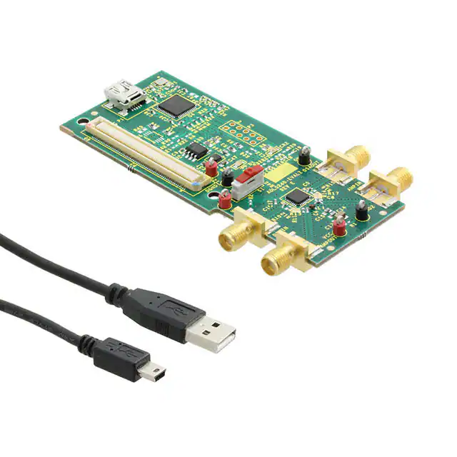

100 MHz to 4000 MHz RF/IF Digitally Controlled VGA ADL5240 FEATURES Operating frequency from 100 MHz to 4000 MHz Digitally controlled VGA with serial and parallel interfaces 6-bit, 0.5 dB digital step attenuator 31.5 dB gain control range with ±0.25 dB step accuracy Gain block amplifier specifications Gain: 19.7 dB at 2.14 GHz OIP3: 41.0 dBm at 2.14 GHz P1dB: 19.5 dBm at 2.14 GHz Noise figure: 2.9 dB at 2.14 GHz Gain block or digital step attenuator can be first Single supply operation from 4.75 V to 5.25 V Low quiescent current of 93 mA Thermally efficient, 5 mm × 5 mm, 32-lead LFCSP The companion ADL5243 integrates a ¼ W driver amplifier to the output of the gain block and DSA GENERAL DESCRIPTION The ADL5240 is a high performance, digitally controlled variable gain amplifier (VGA) operating from 100 MHz to 4000 MHz. The VGA integrates a high performance, 20 dB gain, internally matched amplifier (AMP) with a 6-bit digital step attenuator (DSA) that has a gain control range of 31.5 dB in 0.5 dB steps with ±0.25 dB step accuracy. The attenuation of the DSA can be controlled using a serial or parallel interface. Both the gain block and DSA are internally matched to 50 Ω at their inputs and outputs and are separately biased. The separate bias allows all or part of the ADL5240 to be used, which facilitates easy reuse throughout a design. The pinout of the ADL5240 also enables either the gain block or DSA to be first, giving the VGA maximum flexibility in a signal chain. The ADL5240 consumes just 93 mA and operates from a single supply ranging from 4.75 V to 5.25 V. The VGA is packaged in a thermally efficient, 5 mm × 5 mm, 32-lead LFCSP and is fully specified for operation from −40°C to +85°C. A fully populated evaluation board is available. APPLICATIONS Wireless infrastructure Automated test equipment RF/IF gain control FUNCTIONAL BLOCK DIAGRAM D1/DATA D0/CLK D2/LE SEL D3 D4 D5 D6 25 32 31 30 29 28 27 26 VDD 1 SERIAL/PARALLEL INTERFACE NC 2 24 VDD 23 NC NC 3 22 NC DSAIN 4 0.5dB NC 5 1dB 2dB 4dB 8dB 16dB 21 DSAOUT 20 NC NC 6 ADL5240 AMP 19 NC NC 7 18 NC NC 8 9 10 11 12 13 14 15 16 17 NC AMPOUT/VCC AMPIN NC NC NC NC NC NC Figure 1. Rev. 0 Information furnished by Analog Devices is believed to be accurate and reliable. However, no responsibility is assumed by Analog Devices for its use, nor for any infringements of patents or other rights of third parties that may result from its use. Specifications subject to change without notice. No license is granted by implication or otherwise under any patent or patent rights of Analog Devices. Trademarks and registered trademarks are the property of their respective owners. One Technology Way, P.O. Box 9106, Norwood, MA 02062-9106, U.S.A. Tel: 781.329.4700 www.analog.com Fax: 781.461.3113 ©2011 Analog Devices, Inc. All rights reserved. 09430-001 ADL5240 TABLE OF CONTENTS Features .............................................................................................. 1  Applications....................................................................................... 1  General Description ......................................................................... 1  Functional Block Diagram .............................................................. 1  Revision History ............................................................................... 2  Specifications..................................................................................... 3  Absolute Maximum Ratings............................................................ 8  ESD Caution.................................................................................. 8  Pin Configuration and Function Descriptions............................. 9  Typical Performance Characteristics ........................................... 10  Applications Information .............................................................. 15  Basic Layout Connections......................................................... 15  SPI Timing................................................................................... 17  Loop Performance...................................................................... 19  Thermal Considerations............................................................ 20  Evaluation Board ............................................................................ 21  Outline Dimensions ....................................................................... 24  Ordering Guide .......................................................................... 24  REVISION HISTORY 7/11—Revision 0: Initial Version Rev. 0 | Page 2 of 24 ADL5240 SPECIFICATIONS VDD = 5 V, VCC = 5 V, TA = 25oC Table 1. Parameter OVERALL FUNCTION Frequency Range AMPLIFIER FREQUENCY = 150 MHz Gain vs. Frequency vs. Temperature vs. Supply Input Return Loss Output Return Loss Output 1 dB Compression Point Output Third-Order Intercept Noise Figure AMPLIFIER FREQUENCY = 450 MHz Gain vs. Frequency vs. Temperature vs. Supply Input Return Loss Output Return Loss Output 1 dB Compression Point Output Third-Order Intercept Noise Figure AMPLIFIER FREQUENCY = 748 MHz Gain vs. Frequency vs. Temperature vs. Supply Input Return Loss Output Return Loss Output 1 dB Compression Point Output Third-Order Intercept Noise Figure AMPLIFIER FREQUENCY = 943 MHz Gain vs. Frequency vs. Temperature vs. Supply Input Return Loss Output Return Loss Output 1 dB Compression Point Output Third-Order Intercept Noise Figure Test Conditions/Comments Min 100 Using the AMPIN and AMPOUT pins ±50 MHz −40°C ≤ TA ≤ +85°C 4.75 V to 5.25 V S11 S22 ∆f = 1 MHz, POUT = 4 dBm/tone Using the AMPIN and AMPOUT pins ±50 MHz −40°C ≤ TA ≤ +85°C 4.75 V to 5.25 V S11 S22 ∆f = 1 MHz, POUT = 4 dBm/tone Using the AMPIN and AMPOUT pins ±50 MHz −40°C ≤ TA ≤ +85°C 4.75 V to 5.25 V S11 S22 ∆f = 1 MHz, POUT = 4 dBm/tone Using the AMPIN and AMPOUT pins 19.0 ±18 MHz −40°C ≤ TA ≤ +85°C 4.75 V to 5.25 V S11 S22 18.5 ∆f = 1 MHz, POUT = 4 dBm/tone 20.5 ±0.01 ±0.27 ±0.01 −30.3 −24.8 20.1 40.0 2.7 22.0 dB dB dB dB dB dB dBm dBm dB 20.6 ±0.01 ±0.31 ±0.01 −25.7 −23.7 20.2 40.0 2.7 dB dB dB dB dB dB dBm dBm dB 20.3 ±0.11 ±0.36 ±0.01 −18.3 −15.7 20.2 39.0 2.9 dB dB dB dB dB dB dBm dBm dB 17.6 ±1.0 ±0.04 ±0.04 −10.4 −7.7 18.3 30.0 2.8 dB dB dB dB dB dB dBm dBm dB Typ Max 4000 Unit MHz Rev. 0 | Page 3 of 24 ADL5240 Parameter AMPLIFIER FREQUENCY = 1960 MHz Gain vs. Frequency vs. Temperature vs. Supply Input Return Loss Output Return Loss Output 1 dB Compression Point Output Third-Order Intercept Noise Figure AMPLIFIER FREQUENCY = 2140 MHz Gain vs. Frequency vs. Temperature vs. Supply Input Return Loss Output Return Loss Output 1 dB Compression Point Output Third-Order Intercept Noise Figure AMPLIFIER FREQUENCY = 2630 MHz Gain vs. Frequency vs. Temperature vs. Supply Input Return Loss Output Return Loss Output 1 dB Compression Point Output Third-Order Intercept Noise Figure AMPLIFIER FREQUENCY = 3600 MHz Gain vs. Frequency vs. Temperature vs. Supply Input Return Loss Output Return Loss Output 1 dB Compression Point Output Third-Order Intercept Noise Figure DSA FREQUENCY = 150 MHz Insertion Loss vs. Frequency vs. Temperature Attenuation Range Attenuation Step Error Attenuation Absolute Error Input Return Loss Output Return Loss Input Third-Order Intercept Test Conditions/Comments Using the AMPIN and AMPOUT pins ±30 MHz −40°C ≤ TA ≤ +85°C 4.75 V to 5.25 V S11 S22 ∆f = 1 MHz, POUT = 4 dBm/tone Using the AMPIN and AMPOUT pins 18.0 ±30 MHz −40°C ≤ TA ≤ +85°C 4.75 V to 5.25 V S11 S22 17.5 ∆f = 1 MHz, POUT = 4 dBm/tone Using the AMPIN and AMPOUT pins 18.0 ±60 MHz −40°C ≤ TA ≤ +85°C 4.75 V to 5.25 V S11 S22 18.0 ∆f = 1 MHz, POUT = 4 dBm/tone Using the AMPIN and AMPOUT pins ±100 MHz −40°C ≤ TA ≤ +85°C 4.75 V to 5.25 V S11 S22 ∆f = 1 MHz, POUT = 4 dBm/tone Using the DSAIN and DSAOUT pins Minimum attenuation ±50 MHz −40°C ≤ TA ≤ +85°C All attenuation states All attenuation states Minimum attenuation Minimum attenuation ∆f = 1 MHz, POUT = 4 dBm/tone, minimum attenuation 19.6 ±0.03 ±0.05 ±0.10 −15.1 −12.2 18.8 37.0 3.1 −1.5 ±0.12 ±0.09 28.8 ±0.18 ±1.35 −13.3 −13.4 45.5 dB dB dB dB dB dB dBm dBm dB dB dB dB dB dB dB dB dB dBm 19.6 ±0.01 ±0.22 ±0.04 −11.0 −13.3 19.9 41.0 2.9 22.0 dB dB dB dB dB dB dBm dBm dB 19.7 ±0.02 ±0.25 ±0.04 −11.0 −12.0 19.5 41.0 2.9 22.0 dB dB dB dB dB dB dBm dBm dB Min Typ 19.8 ±0.03 ±0.26 ±0.03 −11.9 −12.6 19.8 40.0 2.9 Max Unit dB dB dB dB dB dB dBm dBm dB Rev. 0 | Page 4 of 24 ADL5240 Parameter DSA FREQUENCY = 450 MHz Insertion Loss vs. Frequency vs. Temperature Attenuation Range Attenuation Step Error Attenuation Absolute Error Input Return Loss Output Return Loss Input Third-Order Intercept DSA FREQUENCY = 748 MHz Insertion Loss vs. Frequency vs. Temperature Attenuation Range Attenuation Step Error Attenuation Absolute Error Input Return Loss Output Return Loss Input Third-Order Intercept DSA FREQUENCY = 943 MHz Insertion Loss vs. Frequency vs. Temperature Attenuation Range Attenuation Step Error Attenuation Absolute Error Input Return Loss Output Return Loss Input 1 dB Compression Point Input Third-Order Intercept DSA FREQUENCY = 1960 MHz Insertion Loss vs. Frequency vs. Temperature Attenuation Range Attenuation Step Error Attenuation Absolute Error Input Return Loss Output Return Loss Input 1 dB Compression Point Input Third-Order Intercept DSA FREQUENCY = 2140 MHz Insertion Loss vs. Frequency vs. Temperature Attenuation Range Attenuation Step Error Attenuation Absolute Error Input Return Loss Output Return Loss Input 1 dB Compression Point Input Third-Order Intercept Test Conditions/Comments Using the DSAIN and DSAOUT pins Minimum attenuation ±50 MHz −40°C ≤ TA ≤ +85°C All attenuation states All attenuation states Minimum attenuation Minimum attenuation ∆f = 1 MHz, POUT = 4 dBm/tone, minimum attenuation Using the DSAIN and DSAOUT pins Minimum attenuation ±50 MHz −40°C ≤ TA ≤ +85°C All attenuation states All attenuation states Minimum attenuation Minimum attenuation ∆f = 1 MHz, POUT = 4 dBm/tone, minimum attenuation Using the DSAIN and DSAOUT pins Minimum attenuation ±18 MHz −40°C ≤ TA ≤ +85°C All attenuation states All attenuation states Minimum attenuation Minimum attenuation Minimum attenuation ∆f = 1 MHz, POUT = 4 dBm/tone, minimum attenuation Using the DSAIN and DSAOUT pins Minimum attenuation ±30 MHz −40°C ≤ TA ≤ +85°C All attenuation states All attenuation states Minimum attenuation Minimum attenuation Minimum attenuation ∆f = 1 MHz, POUT = 4 dBm/tone, minimum attenuation Using the DSAIN and DSAOUT pins Minimum attenuation ±30 MHz −40°C ≤ TA ≤ +85°C All attenuation states All attenuation states Minimum attenuation Minimum attenuation Minimum attenuation ∆f = 1 MHz, POUT = 4 dBm/tone, minimum attenuation Rev. 0 | Page 5 of 24 Min Typ −1.5 ±0.02 ±0.10 30.7 ±0.14 ±0.42 −17.6 −17.6 41.0 −1.6 ±0.02 ±0.11 30.9 ±0.15 ±0.32 −17.4 −17.4 40 −1.6 ±0.01 ±0.12 30.9 ±0.13 ±0.30 −16.6 −16.5 30.5 48.5 −2.4 ±0.02 ±0.16 31.0 ±0.15 ±0.29 −12.0 −11.5 31.5 45.0 −2.5 ±0.02 ±0.17 31.0 ±0.12 ±0.26 −11.9 −11.2 31.5 44.5 Max Unit dB dB dB dB dB dB dB dB dBm dB dB dB dB dB dB dB dB dBm dB dB dB dB dB dB dB dB dBm dBm dB dB dB dB dB dB dB dB dBm dBm dB dB dB dB dB dB dB dB dBm dBm ADL5240 Parameter DSA FREQUENCY = 2630 MHz Insertion Loss vs. Frequency vs. Temperature Attenuation Range Attenuation Step Error Attenuation Absolute Error Input Return Loss Output Return Loss Input 1 dB Compression Point Input Third-Order Intercept DSA FREQUENCY = 3600 MHz Insertion Loss vs. Frequency vs. Temperature Attenuation Range Attenuation Step Error Attenuation Absolute Error Input Return Loss Output Return Loss Input 1 dB Compression Point Input Third-Order Intercept DIGITAL STEP ATTENUATOR GAIN SETTLING Minimum Attenuation to Maximum Attenuation Maximum Attenuation to Minimum Attenuation AMP-DSA LOOP FREQUENCY = 943 MHz Gain vs. Frequency Gain Range Input Return Loss Output Return Loss Output 1 dB Compression Point Output Third-Order Intercept Noise Figure AMP-DSA LOOP FREQUENCY = 2140 MHz Gain vs. Frequency Gain Range Input Return Loss Output Return Loss Output 1 dB Compression Point Output Third-Order Intercept Noise Figure Test Conditions/Comments Using the DSAIN and DSAOUT pins Minimum attenuation ±60 MHz −40°C ≤ TA ≤ +85°C All attenuation states All attenuation states Minimum attenuation Minimum attenuation Minimum attenuation ∆f = 1 MHz, POUT = 4 dBm/tone, minimum attenuation Using the DSAIN and DSAOUT pins Minimum attenuation ±100 MHz −40°C ≤ TA ≤ +85°C All attenuation states All attenuation states Minimum attenuation Minimum attenuation Minimum attenuation ∆f = 1 MHz, POUT = 4 dBm/tone, minimum attenuation Min Typ −2.6 ±0.04 ±0.19 31.2 ±0.16 ±0.19 −13.1 −12.0 31.5 43.0 −2.8 ±0.03 ±0.21 32.1 ±0.37 ±0.31 −20.2 −18.2 31.0 43.0 36 36 Using the AMPIN and DSAOUT pins, DSA at minimum attenuation ±18 MHz Between maximum and minimum attenuation states S11 S22 ∆f = 1 MHz, POUT = 1 dBm/tone Using the AMPIN and DSAOUT pins, DSA at minimum attenuation ±30 MHz Between maximum and minimum attenuation states S11 S22 ∆f = 1 MHz, POUT = 1 dBm/tone 18.2 ±0.01 31.3 −14.9 −16.4 17.9 37.5 3.0 dB dB dB dB dB dBm dBm dB 18.9 ±0.01 30.8 −20.5 −19.7 18.6 36.0 2.7 dB dB dB dB dB dBm dBm dB Max Unit dB dB dB dB dB dB dB dB dBm dBm dB dB dB dB dB dB dB dB dBm dBm ns ns Rev. 0 | Page 6 of 24 ADL5240 Parameter AMP-DSA LOOP FREQUENCY = 2630 MHz Gain vs. Frequency Gain Range Input Return Loss Output Return Loss Output 1 dB Compression Point Output Third-Order Intercept Noise Figure DSA-AMP LOOP FREQUENCY = 943 MHz Gain vs. Frequency Gain Range Input Return Loss Output Return Loss Output 1 dB Compression Point Output Third-Order Intercept Noise Figure DSA-AMP LOOP Frequency = 2140 MHz Gain vs. Frequency Gain Range Input Return Loss Output Return Loss Output 1 dB Compression Point Output Third-Order Intercept Noise Figure DSA-AMP LOOP Frequency = 2630 MHz Gain vs. Frequency Gain Range Input Return Loss Output Return Loss Output 1 dB Compression Point Output Third-Order Intercept Noise Figure POWER SUPPLIES Voltage Supply Current Amplifier Digital Step Attenuator Test Conditions/Comments Using the AMPIN and DSAOUT pins, DSA at minimum attenuation ±60 MHz S11 S22 ∆f = 1 MHz, POUT = 1 dBm/tone Using the DSAIN and AMPOUT pins, DSA at minimum attenuation ±18 MHz Between maximum and minimum attenuation states S11 S22 ∆f = 1 MHz, POUT = 4 dBm/tone Using the DSAIN and AMPOUT pins, DSA at minimum attenuation ±30 MHz Between maximum and minimum attenuation states S11 S22 ∆f = 1 MHz, POUT = 4 dBm/tone Using the DSAIN and AMPOUT pins, DSA at minimum attenuation ±60 MHz Between maximum and minimum attenuation states S11 S22 ∆f = 1 MHz, POUT = 4 dBm/tone Using the VDD and VCC pins 4.75 5.0 93 0.5 5.25 120 V mA mA 18.2 ±0.01 31.7 −15.7 −16.9 19.8 40.8 5.2 dB dB dB dB dB dBm dBm dB 18.0 ±0.01 31.1 −13.7 −10.0 19.7 37.5 4.9 dB dB dB dB dB dBm dBm dB 18.9 ±0.01 30.8 −17.2 −23.7 20.2 40.0 4.4 dB dB dB dB dB dBm dBm dB Min Typ Max Unit 17.7 ±0.11 31.5 −15.2 −9.6 16.9 33.7 3.0 dB dB dB dB dB dBm dBm dB Rev. 0 | Page 7 of 24 ADL5240 ABSOLUTE MAXIMUM RATINGS Table 2. Parameter Supply Voltage (VDD, VCC) Input Power AMPIN DSAIN Internal Power Dissipation θJA (Exposed Pad Soldered Down) θJC (Exposed Pad is the Contact) Maximum Junction Temperature Lead Temperature (Soldering, 60 sec) Operating Temperature Range Storage Temperature Range Rating 6.5 V 16 dBm 30 dBm 0.5 W 36.8°C/W 6.9°C/W 150°C 240°C −40°C to +85°C −65°C to +150°C ESD CAUTION Stresses above those listed under Absolute Maximum Ratings may cause permanent damage to the device. This is a stress rating only; functional operation of the device at these or any other conditions above those indicated in the operational section of this specification is not implied. Exposure to absolute maximum rating conditions for extended periods may affect device reliability. Rev. 0 | Page 8 of 24 ADL5240 PIN CONFIGURATION AND FUNCTION DESCRIPTIONS 32 31 30 29 28 27 26 25 VDD NC NC DSAIN NC NC NC NC 1 2 3 4 5 6 7 8 24 23 22 21 20 19 18 17 SEL D0/CLK D1/DATA D2/LE D3 D4 D5 D6 PIN 1 INDICATOR ADL5240 TOP VIEW (Not to Scale) VDD NC NC DSAOUT NC NC NC NC NC AMPOUT/VCC NC NC NC NC AMPIN NC 9 10 11 12 13 14 15 16 NOTES 1. NC = NO CONNECT. DO NOT CONNECT TO THIS PIN. 2. THE EXPOSED PAD MUST BE CONNECTED TO GROUND. Figure 2. Pin Configuration Table 3. Pin Function Descriptions Pin No. 1, 24 2, 3, 5, 6, 7, 8, 9, 11, 12, 13, 14, 16, 17, 18, 19, 20, 22, 23 4 10 15 21 25 26 27 28 29 30 31 32 Mnemonic VDD NC Description Supply Voltage for DSA. Connect this pin to a 5 V supply. No Connect. Do not connect to this pin. DSAIN AMPOUT/VCC AMPIN DSAOUT D6 D5 D4 D3 D2/LE D1/DATA D0/CLK SEL EPAD RF Input to DSA. RF Output from Amplifier/Supply Voltage for Amplifier. A bias to the amplifier is provided through a choke inductor connected to this pin. RF Input to Amplifier. RF Output from DSA. Data Bit in Parallel Mode (LSB). Connect this pin to the supply in serial mode. Data Bit in Parallel Mode. Connect this pin to ground in serial mode. Data Bit in Parallel Mode. Connect this pin to ground in serial mode. Data Bit in Parallel Mode. Connect this pin to ground in serial mode. Data Bit in Parallel Mode/Latch Enable in Serial Mode. Data Bit in Parallel Mode (MSB)/Data in Serial Mode. Connect this pin to ground in parallel mode. This pin functions as a clock in serial mode. Select Pin. Connect this pin to the supply to select parallel mode operation; connect this pin to ground to select serial mode operation. Exposed Pad. The exposed pad must be connected to ground. Rev. 0 | Page 9 of 24 09430-002 ADL5240 TYPICAL PERFORMANCE CHARACTERISTICS 45 30 28 45 40 35 30 25 20 15 10 3.6 NOISE FIGURE, GAIN, P1dB, OIP3 (dB, dBm) 40 35 30 OIP3 26 P1dB (dBm) 25 20 15 GAIN 10 5 0 0 0.4 0.8 1.2 1.6 2.0 2.4 2.8 3.2 3.6 FREQUENCY (GHz) NF 09430-003 24 22 20 18 16 +85°C +25°C –40°C 0 0.4 0.8 1.2 1.6 2.0 2.4 2.8 3.2 OIP3 (dBm) 09430-008 09430-007 09430-006 P1dB FREQUENCY (GHz) Figure 3. AMP: Gain, P1dB, OIP3 at POUT = 4 dBm/Tone and Noise Figure vs. Frequency Figure 6. AMP: OIP3 at POUT = 4 dBm/Tone and P1dB vs. Frequency and Temperature 21.0 20.5 –40°C 20.0 46 1960MHz 44 42 40 38 2140MHz 943MHz 748MHz OIP3 (dBm) GAIN (dB) 19.5 19.0 18.5 +25°C +85°C 36 34 32 30 28 450MHz 2630MHz 18.0 17.5 0 0.4 0.8 1.2 1.6 2.0 2.4 2.8 3.2 3.6 FREQUENCY (GHz) 26 24 09430-004 150MHz 3600MHz 22 –5 –3 –1 1 3 5 7 9 11 13 15 17 POUT PER TONE (dBm) Figure 4. AMP: Gain vs. Frequency and Temperature Figure 7. AMP: OIP3 vs. POUT and Frequency 0 –5 4.5 4.0 –10 S-PARAMETERS (dB) +85°C NOISE FIGURE (dB) S22 –15 –20 3.5 +25°C 3.0 S12 –25 –30 2.5 –40°C 2.0 –35 S11 0.5 0.9 1.3 1.7 2.1 2.5 2.9 3.3 3.7 4.1 09430-005 –40 0.1 1.5 0 0.4 0.8 1.2 1.6 2.0 2.4 2.8 3.2 3.6 4.0 FREQUENCY (GHz) FREQUENCY (GHz) Figure 5. AMP: Input Return Loss (S11), Output Return Loss (S22), and Reverse Isolation (S12) vs. Frequency Figure 8. AMP: Noise Figure vs. Frequency and Temperature Rev. 0 | Page 10 of 24 ADL5240 0 –5 –10 0dB 1.0 0.8 0.6 31.5dB 16dB 30.5dB ATTENUATION (dB) –15 –20 –25 –30 STEP ERROR (dB) 0.4 0.2 0 –0.2 –0.4 –0.6 31dB –35 31.5dB 0.5 0.9 1.3 1.7 2.1 2.5 2.9 3.3 3.7 4.1 09430-009 –0.8 0.5 0.9 1.3 1.7 2.1 2.5 2.9 3.3 3.7 4.1 09430-016 09430-013 09430-012 –40 0.1 –1.0 0.1 FREQUENCY (GHz) FREQUENCY (GHz) Figure 9. DSA: Attenuation vs. Frequency Figure 12. DSA: Step Error vs. Frequency, All Attenuation States –1 –6 –11 –16 16dB –21 –26 –31 8dB 0dB 1.0 748MHz 0.8 450MHz 4dB 1960MHz 0.6 ABSOLUTE ERROR (dB) ATTENUATION (dB) 0.4 0.2 2140MHz 0 –0.2 –0.4 –0.6 –0.8 2630MHz 943MHz +85°C +25°C –40°C 3600MHz 31.5dB 09430-010 –36 0.1 –1.0 0 4 8 12 16 20 24 28 32 0.5 0.9 1.3 1.7 2.1 2.5 2.9 3.3 3.7 4.1 FREQUENCY (GHz) ATTENUATION (dB) Figure 10. DSA: Attenuation vs. Frequency and Temperature Figure 13. DSA: Absolute Error vs. Attenuation 0.5 0.4 0.3 450MHz 748MHz 943MHz 1960MHz 2140MHz 2630MHz 3600MHz 0 –5 INPUT RETURN LOSS (dB) –10 –15 –20 STEP ERROR (dB) 0.2 0.1 0 –0.1 –0.2 –0.3 –0.4 0 4 8 12 16 20 24 28 32 09430-011 0dB 31.5dB –25 –30 –35 –40 0.1 –0.5 0.5 0.9 1.3 1.7 2.1 2.5 2.9 3.3 3.7 4.1 ATTENUATION (dB) FREQUENCY (GHz) Figure 11. DSA: Step Error vs. Attenuation Figure 14. DSA: Input Return Loss vs. Frequency, All States Rev. 0 | Page 11 of 24 ADL5240 0 –5 OUTPUT RETURN LOSS (dB) –10 –15 0dB 3 –20 31.5dB –25 –30 –35 09430-014 4 –40 0.1 0.5 0.9 1.3 1.7 2.1 2.5 2.9 3.3 3.7 4.1 CH3 2.00V CH4 200mV FREQUENCY (GHz) M10ns 10GS/s A CH3 IT 1.0ps/pt 1.24V Figure 15. DSA: Output Return Loss vs. Frequency, All States Figure 18. DSA: Gain Settling Time, 0 dB to 31.5 dB 36 50 35 IIP3 34 45 40 IP1dB (dBm) IIP3 (dBm) 3 33 35 32 IP1dB 31 30 4 25 09430-015 30 0.9 1.2 1.5 1.8 2.1 2.4 2.7 3.0 3.3 20 3.6 CH3 2.00V CH4 200mV FREQUENCY (GHz) M10ns 10GS/s A CH3 IT 1.0ps/pt 1.24V Figure 16. DSA: Input P1dB and Input IP3 vs. Frequency, Minimum Attenuation State Figure 19. DSA: Gain Settling Time, 31.5 dB to 0 dB 200 150 100 22 1960MHz 20 GAIN AND NOISE FIGURE (dB) 18 GAIN 16 14 12 10 8 6 4 2 NOISE FIGURE 2140MHz PHASE (Degrees) 50 0 –50 –100 2630MHz 943MHz 09430-017 0 4 8 12 16 20 24 28 32 0.5 0.9 1.3 1.7 2.1 2.5 2.9 3.3 3.7 4.1 ATTENUATION (dB) FREQUENCY (GHz) Figure 17. DSA: Phase vs. Attenuation Figure 20. AMP-DSA Loop: Gain and Noise Figure vs. Frequency, Minimum Attenuation State Rev. 0 | Page 12 of 24 09430-020 –150 0 0.1 09430-019 09430-018 ADL5240 0 –5 –10 S11 22 20 S22 GAIN AND NOISE FIGURE (dB) 18 GAIN 16 14 12 10 8 6 4 2 NOISE FIGURE S-PARAMETERS (dB) –15 –20 –25 S12 –30 –35 09430-021 0.5 0.9 1.3 1.7 2.1 2.5 2.9 3.3 3.7 4.1 0.5 0.9 1.3 1.7 2.1 2.5 2.9 3.3 3.7 4.1 FREQUENCY (GHz) FREQUENCY (GHz) Figure 21. AMP-DSA Loop: Input Return Loss (S11), Output Return Loss (S22), and Reverse Isolation (S12) vs. Frequency, Minimum Attenuation State 40 38 36 943MHz 34 OIP3 (dBm) Figure 24. DSA-AMP Loop: Gain and Noise Figure vs. Frequency, Minimum Attenuation State 0 –5 S22 –10 S11 –15 –20 –25 S12 –30 –35 0.1 32 30 28 26 24 22 –4 –2 0 2 4 6 8 10 12 14 16 09430-022 2140MHz 2630MHz S-PARAMETERS (dB) 20 –6 0.5 0.9 1.3 1.7 2.1 2.5 2.9 3.3 3.7 4.1 POUT (dBm) FREQUENCY (GHz) Figure 22. AMP-DSA Loop: OIP3 vs. POUT and Frequency, Minimum Attenuation State Figure 25. DSA-AMP Loop: Input Return Loss (S11), Output Return Loss (S22), and Reverse Isolation (S12) vs. Frequency, Minimum Attenuation State 20.0 19.5 19.0 18.5 GAIN (dB) 44 42 943MHz 40 38 2140MHz OIP3 (dBm) 943MHz 36 34 32 30 2140MHz 18.0 2630MHz 17.5 17.0 28 16.5 16.0 –4 26 09430-023 2630MHz –2 0 2 4 6 8 10 12 14 16 18 20 –4 –2 0 2 4 6 8 10 12 14 16 POUT (dBm) POUT (dBm) Figure 23. AMP-DSA Loop: Gain vs. POUT and Frequency, Minimum Attenuation State Figure 26. DSA-AMP Loop: OIP3 vs. POUT and Frequency, Minimum Attenuation State Rev. 0 | Page 13 of 24 09430-026 24 –6 09430-025 09430-024 –40 0.1 0 0.1 ADL5240 20.0 19.5 19.0 18.5 30 943MHz 25 PERCENTAGE (%) 09430-027 20 GAIN (dB) 2140MHz 18.0 15 2630MHz 17.5 17.0 16.5 16.0 –4 10 5 18.8 18.9 19.0 19.1 19.2 19.3 19.4 19.5 19.6 19.7 19.8 19.9 20.0 20.1 20.2 20.3 20.4 20.5 4.0 POUT (dBm) P1dB (dBm) Figure 27. DSA-AMP Loop: Gain vs. POUT and Frequency, Minimum Attenuation State 110 30 Figure 30. AMP: P1dB Distribution at 2140 MHz 105 25 SUPPLY CURRENT (mA) 5.25V PERCENTAGE (%) 100 5.00V 95 4.75V 90 20 15 10 85 5 09430-028 0 10 20 30 40 50 60 70 80 90 33 34 35 36 37 38 39 40 41 42 43 44 45 46 47 48 49 50 OIP3 (dBm) TEMPERATURE (°C) Figure 28. AMP: Supply Current vs. Voltage and Temperature Figure 31. AMP: OIP3 Distribution at 2140 MHz 35 30 25 70 60 50 PERCENTAGE (%) PERCENTAGE (%) 20 15 10 5 0 40 30 20 10 0 09430-029 2.0 2.2 2.4 2.6 2.8 3.0 3.2 3.4 3.6 3.8 GAIN (dB) NOISE FIGURE (dB) Figure 29. AMP: Gain Distribution at 2140 MHz Figure 32. AMP: Noise Figure Distribution at 2140 MHz Rev. 0 | Page 14 of 24 09430-032 18.8 18.9 19.0 19.1 19.2 19.3 19.4 19.5 19.6 19.7 19.8 19.9 20.0 20.1 20.2 20.3 20.4 20.5 09430-031 80 –40 –30 –20 –10 0 09430-030 –2 0 2 4 6 8 10 12 14 16 18 20 0 ADL5240 APPLICATIONS INFORMATION BASIC LAYOUT CONNECTIONS The basic connections for operating the ADL5240 are shown in Figure 33. VDD SERIAL PARALLEL INTERFACE VDD 0.1µF C8 32 31 30 29 28 27 26 25 SEL D0/CLK D1/DATA D2/LE D3 D4 D5 D6 1 2 VDD NC NC DSAIN NC NC NC NC VDD NC NC 24 23 22 21 20 19 18 17 DSAIN 100pF 3 4 5 100pF DSAOUT ADL5240 DSAOUT NC NC NC NC C6 C7 6 7 8 9 10 11 12 13 14 15 16 NC AMPOUT/VCC NC NC NC NC AMPIN NC AMPOUT 0.1µF 0.1µF AMPIN C2 L1 470nH C1 C3 68pF C4 1.2nF C5 09430-033 VCC 1µF Figure 33. Basic Connections Rev. 0 | Page 15 of 24 ADL5240 Amplifier Bias The dc bias for the amplifier in ADL5240 is supplied through Inductor L1 and is connected to the AMPOUT pin. Three decoupling capacitors (C3, C4, and C5) are used to prevent RF signals from propagating onto the dc lines. The dc supply ranges from 4.75 V to 5.25 V and should be connected to the VCC test point on the evaluation board. DSA RF Input Interface Pin 4 is the RF input for the DSA of ADL5240. The input impedance of the DSA is close to 50 Ω over the entire frequency range; therefore, no external components are required. Only a dc blocking capacitor (C6) is required. DSA RF Output Interface Pin 21 is the RF output for the DSA of ADL5240. The output impedance of the DSA is close to 50 Ω over the entire frequency range; therefore, no external components are required. Only a dc blocking capacitor (C7) is required. Digital Step Attenuator Bias The bias for the DSA is provided through the VDD pin. At least one decoupling capacitor (C8) is recommended on the VDD trace. The voltage ranges from 4.75 V to 5.25 V and should be connected to the VDD test point on the evaluation board. The DSA is shown to work for dc voltages as low as 2.5 V. DSA SPI Interface The DSA of the ADL5240 can operate in either serial or parallel mode. Pin 32 (SEL) controls the mode of operation. To select serial mode, connect SEL to ground; to select parallel mode, connect SEL to VDD. In parallel mode, Pin 25 to Pin 30 (D6 to D1) are the data bits, with D6 being the LSB. Connect Pin 31 (D0) to ground during the parallel mode of operation. In serial mode, Pin 29 is the latch enable (LE), Pin 30 is the data (DATA), and Pin 31 is the clock (CLK). Pin 26, Pin 27, and Pin 28 are not used in serial mode and should be connected to ground. Pin 25 (D6) should be connected to VDD during the serial mode of operation. To prevent noise from coupling onto the digital signals, an RC filter can be used on each data line. Amplifier RF Input Interface Pin 15 is the RF input for the amplifier of ADL5240. The amplifier is internally matched to 50 Ω at the input; therefore, no external components are required. Only a dc blocking capacitor (C1) is required. Amplifier RF Output Interface Pin 10 is the RF output for the amplifier of ADL5240. The amplifier is internally matched to 50 Ω at the output; therefore, no external components are required. Only a dc blocking capacitor (C2) is required. The bias is provided through this pin via a choke inductor. Rev. 0 | Page 16 of 24 ADL5240 SPI TIMING Table 5 provides details about the timing characteristics for the SPI signals—namely, the clock (CLK), latch enable (LE), and data (DATA) signals—and Figure 34 shows the corresponding SPI timing diagram. Table 4. Mode Selection Table Pin 32 (SEL) Connect to Ground Connect to Supply Functionality Serial mode Parallel mode SPI Timing Sequence Figure 35 is the timing sequence for the SPI function using a 6-bit operation. The clock can be as fast as 20 MHz. In serial mode, Register B5 (MSB) is first and Register B0 (LSB) is last. Table 5. SPI Timing Setup Parameter fCLK t1 t2 t3 t4 t5 t6 Limit 10 30 30 10 10 10 30 Unit MHz ns min ns min ns min ns min ns min ns min Test Conditions/Comments Data clock frequency Clock high time Clock low time Data to clock setup time Clock to data hold time Clock low to LE setup time LE pulse width t1 CLK t5 t2 t3 DATA MSB B5 t4 B4 B3 B2 B1 LSB B0 t6 LE 09430-034 Figure 34. SPI Timing Diagram (Data Is Loaded MSB First), Serial Mode D0/CLK D1/DATA MSB B5 B4 B3 B2 B1 LSB B0 D2/LE D6 Figure 35. SPI Timing Sequence, Serial Mode Rev. 0 | Page 17 of 24 09430-035 ADL5240 Table 6. DSA Attenuation Truth Table—Serial Mode Attenuation State (dB) 0 (Reference) 0.5 1.0 2.0 4.0 8.0 16.0 31.5 B5 (MSB) 1 1 1 1 1 1 0 0 B4 1 1 1 1 1 0 1 0 B3 1 1 1 1 0 1 1 0 B2 1 1 1 0 1 1 1 0 B1 1 1 0 1 1 1 1 0 B0 (LSB) 1 0 1 1 1 1 1 0 Table 7. DSA Attenuation Truth Table—Parallel Mode Attenuation State (dB) 0 (Reference) 0.5 1.0 2.0 4.0 8.0 16.0 31.5 D1 (MSB) 1 1 1 1 1 1 0 0 D2 1 1 1 1 1 0 1 0 D3 1 1 1 1 0 1 1 0 D4 1 1 1 0 1 1 1 0 D5 1 1 0 1 1 1 1 0 D6 (LSB) 1 0 1 1 1 1 1 0 Rev. 0 | Page 18 of 24 ADL5240 LOOP PERFORMANCE The ADL5240 can be configured so that either the DSA precedes the amplifier (see Figure 36) or the amplifier precedes the DSA (see Figure 37). The performance of the loop configurations is presented in Figure 20 to Figure 27. To improve the overall return loss, a shunt capacitor can be placed between the amplifier and DSA. This helps to align the phases of the two blocks. SERIAL PARALLEL INTERFACE VDD VDD 0.1µF C7 32 31 30 29 28 27 26 25 SEL D0/CLK D1/DATA D2/LE D3 D4 D5 D6 1 2 VDD NC NC DSAIN NC NC NC NC VDD NC NC 24 23 22 21 20 19 18 17 RFIN 100pF 3 4 5 ADL5240 DSAOUT NC NC NC NC C6 6 7 8 9 10 11 12 13 14 15 16 NC AMPOUT/VCC NC NC NC NC AMPIN NC RFOUT 0.1µF 100pF C2 L1 470nH C1 C3 68pF C4 1.2nF C5 09430-036 VCC 1µF Figure 36. DSA-AMP Loop Configuration Rev. 0 | Page 19 of 24 ADL5240 VDD SERIAL PARALLEL INTERFACE VDD 0.1µF C7 32 31 30 29 28 27 26 25 SEL D0/CLK D1/DATA D2/LE D3 D4 D5 D6 1 2 3 4 5 6 7 VDD NC NC DSAIN NC NC NC NC VDD NC NC 24 23 22 21 20 19 18 17 100pF RFOUT ADL5240 DSAOUT NC NC NC NC C6 C2 100pF 8 9 10 11 12 13 14 15 16 NC AMPOUT/VCC NC NC NC NC AMPIN NC 0.1µF RFIN C1 L1 470nH C3 68pF C4 1.2nF C5 09430-037 VCC 1µF Figure 37. AMP-DSA Loop Configuration THERMAL CONSIDERATIONS The ADL5240 is packaged in a thermally efficient, 5 mm × 5 mm, 32-lead LFCSP. The thermal resistance from junction to air (θJA) is 36.8oC/W. The thermal resistance for the product was extracted assuming a standard 4-layer JEDEC board with 25 conductive, epoxy filled thermal vias. The thermal resistance from junction to case (θJC) is 6.9oC/W, where case is the exposed pad of the lead frame package. The ADL5240 consumes approximately 93 mA with a 5 V supply voltage. Even though the part dissipates less than 0.5 W, for the best thermal performance, it is recommended to add as many thermal vias as possible under the exposed pad of the LFCSP. The thermal resistance values given in this section assume a minimum of 25 thermal vias arranged in a 5 × 5 array with a diameter of 13 mils and a pitch of 25 mils. Figure 38 shows a close-up of the thermal via distribution under the exposed pad. Figure 38. Exposed Pad with Thermal Via Distribution Rev. 0 | Page 20 of 24 09430-038 ADL5240 EVALUATION BOARD The schematic of the ADL5240 evaluation board is shown in Figure 39, the evaluation board configuration options are detailed in Table 8, and the layout of the ADL5240 evaluation board is shown in Figure 40 and Figure 41. Each RF trace on the evaluation board has a characteristic impedance of 50 Ω and is fabricated on Rogers3003 material. In addition, each trace is a coplanar waveguide (CPWG) with a width of 25 mils, a spacing of 20 mils, and a dielectric thickness of 10 mils. The input to and output from the DSA and amplifier should be ac-coupled with capacitors of appropriate values to ensure the broadband performance. The bias to the amplifier is provided by connecting a choke to the AMPOUT pin. Bypassing capacitors are recommended on all supply lines to minimize the RF coupling. The DSA and the amplifier can be individually biased or connected to the VDD plane using Resistors R2 and R1. The ADL5240 can be operated in two ways: the amplifier can precede the DSA (AMP-DSA loop configuration) or the DSA can precede the amplifier (DSA-AMP loop configuration). The evaluation board can be configured to handle either option. In normal operation, R12 and R13 are open, and R10 and R11 are 0 Ω and are used to terminate any RF coupling onto the bypass trace. To configure the ADL5240 in AMP-DSA loop configuration, R12 should be replaced with a capacitor, R13 should be replaced with a 0 Ω resistor, and R10 and R11 should be left open. Similarly, to configure the ADL5240 in the DSA-AMP loop configuration, R16 should be replaced with a capacitor, R17 should be replaced with a 0 Ω resistor, and R14 and R15 should be left open. The digital signal traces incorporate a footprint for an RC filter to prevent potential noise from coupling onto the signal. In normal operation, Resistors R3 to R9 are 0 Ω and Capacitors C9 to C15 are open. Rev. 0 | Page 21 of 24 ADL5240 DATA R3 0 R4 0 R5 0 R6 0 R7 0 S1 AGND 3 2 R8 0 1 C9 DNI AGND VDD VDD R2 DNI PAD AGND C8 0.1µF AGND 32 31 30 29 28 27 26 25 C10 DNI AGND C11 DNI AGND C12 DNI AGND C13 DNI AGND C14 DNI AGND C15 AGND DNI AGND R9 0 1 2 3 4 5 6 7 8 9 LE CLK SEL D0 D1 D2 D3 D4 D5 D6 DSAIN C1 100pF R12 R10 0 R11 AGND 0 R13 DNI AGND DNI NC AMPOUT/VCC NC NC NC NC AMPIN NC 1 2 3 4 5 6 7 8 VDD NC NC DSAIN NC NC NC NC ADL5240 VDD NC NC DSAOUT NC NC NC NC 24 23 22 21 20 19 18 17 C2 100pF R16 R14 0 R15 AGND AGND 0 R17 DNI C3 DNI DSAOUT AMPOUT C4 0.1µF VCC L1 470nH C7 68pF C6 1.2nF C5 1µF R1 DNI VDD AGND 9 10 11 12 13 14 15 16 AMPIN 0.1µF AGND Figure 39. ADL5240 Evaluation Board Table 8. Evaluation Board Configuration Options Component C1, C2 C3, C4 C5, C6, C7 Function/Notes Input/output dc blocking capacitors for DSA. Input/output dc blocking capacitors for AMP. Power supply decoupling for amplifier. The bias associated with the AMPOUT pin is the most sensitive to noise because the bias is connected directly to the output. The smallest capacitor (C7) should be the closest to the AMPOUT pin. Power supply decoupling for the DSA. Capacitors of the RC filter on the digital signals leading to the SPI chip. The bias for the amplifier comes through L1 when VCC is connected to a 5 V supply. L1 should be high impedance for the frequency of operation while providing low resistance for the dc current. Resistors to connect the supply for the amplifier and the DSA to the same VDD plane. Resistors of the RC filter on the digital signals leading to the SPI chip. These resistors are used to terminate RF coupling onto the traces and to close the loop. R12 and R16 are replaced with capacitors, and R13 and R17 are replaced with 0 Ω to close the loop. Switch to change between the serial mode and parallel mode of operation. Connect to supply for parallel mode and to ground for serial mode operation. Default Value C1, C2 = 100 pF C3, C4 = 0.1 μF C5 = 1 μF C6 = 1.2 nF C7 = 68 pF C8 = 0.1 μF C9, C10, C11, C12, C13, C14, C15 = open L1 = 470 nH C8 C9, C10, C11, C12, C13, C14, C15 L1 R1, R2 R3, R4, R5, R6, R7, R8, R9 R10, R11, R14, R15 R12, R13, R16, R17 S1 R1, R2 = open R3, R4, R5, R6, R7, R8, R9 = 0 Ω R10, R11, R14, R15 = 0Ω R12, R13, R16, R17 = open S1 connected to ground Rev. 0 | Page 22 of 24 09430-039 ADL5240 09430-040 Figure 40. Evaluation Board Layout—Top Figure 41. Evaluation Board Layout—Bottom Rev. 0 | Page 23 of 24 09430-041 ADL5240 OUTLINE DIMENSIONS 5.00 BSC SQ 0.60 MAX 25 24 PIN 1 INDICATOR 32 1 0.60 MAX PIN 1 INDICATOR 3.45 3.30 SQ 3.15 8 16 BOTTOM VIEW 9 4.75 BSC SQ 0.50 BSC EXPOSED PAD 17 TOP VIEW 1.00 0.85 0.80 SEATING PLANE 12° MAX 0.80 MAX 0.65 TYP 0.50 0.40 0.30 0.05 MAX 0.02 NOM COPLANARITY 0.08 0.20 REF 0.25 MIN 3.50 REF FOR PROPER CONNECTION OF THE EXPOSED PAD, REFER TO THE PIN CONFIGURATION AND FUNCTION DESCRIPTIONS SECTION OF THIS DATA SHEET. COMPLIANT TO JEDEC STANDARDS MO-220-VHHD-2 Figure 42. 32-Lead Lead Frame Chip Scale Package [LFCSP_VQ] 5 mm × 5 mm Body, Very Thin Quad (CP-32-3) Dimensions shown in millimeters ORDERING GUIDE Model 1 ADL5240ACPZ-R7 ADL5240-EVALZ 1 Temperature Range −40°C to +85°C Package Description 32 Lead LFCSP_VQ, 7" Tape and Reel Evaluation Board Package Option CP-32-3 Z = RoHS Compliant Part. ©2011 Analog Devices, Inc. All rights reserved. Trademarks and registered trademarks are the property of their respective owners. D09430-0-7/11(0) Rev. 0 | Page 24 of 24 05-25-2011-A 0.30 0.25 0.18
