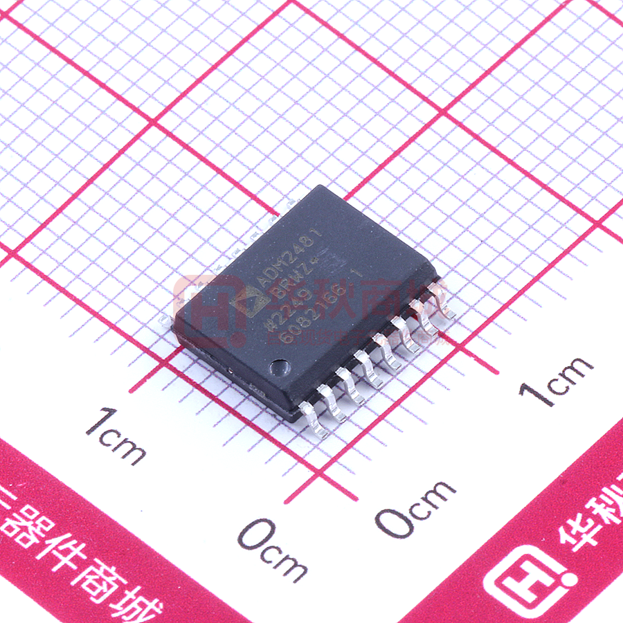

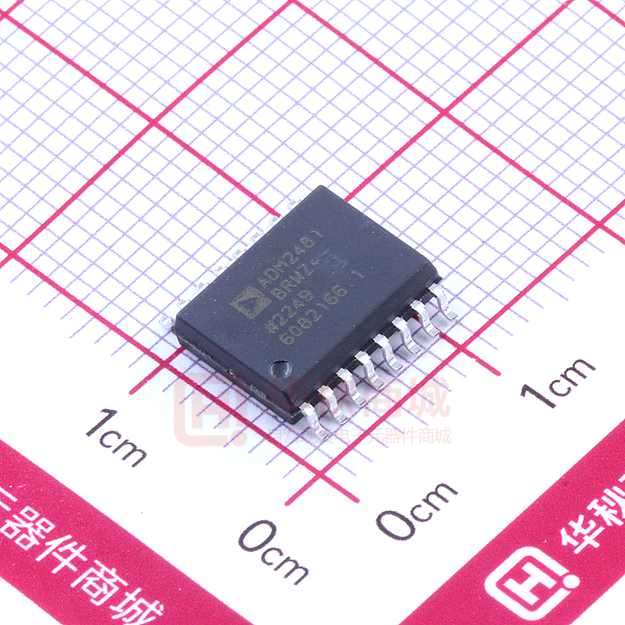

ADM2481BRWZ-RL7
ADM2481BRWZ-RL7
    AD(亚德诺)
    SOIC-16-WB
    RS422、RS485数字隔离器2500Vrms 3通道500kbps 25kV/µs CMTI SOIC16
ADM2481BRWZ-RL7 数据手册
Half-Duplex, iCoupler Isolated RS-485 Transceiver ADM2481 Data Sheet FUNCTIONAL BLOCK DIAGRAM VDD1 VDD2 ADM2481 DE TxD RxD A B RE GND2 GND1 08920-001 RS-485 transceiver with electrical data isolation Complies with ANSI TIA/EIA-485-A and ISO 8482: 1987(E) 500 kbps data rate Slew rate-limited driver outputs Low power operation: 2.5 mA maximum Suitable for 5 V or 3.3 V operations (VDD1) High common-mode transient immunity: >25 kV/μs True fail-safe receiver inputs Chatter-free power-up/power-down protection 256 nodes on bus Thermal shutdown protection Safety and regulatory approvals UL recognition: 2500 V rms for 1 minute per UL 1577 VDE certificates of conformity DIN V VDE V 0884-10 (VDE V 0884-10): 2006-12 VIORM = 560 V peak Operating temperature range: −40°C to +85°C GALVANIC ISOLATION FEATURES Figure 1. APPLICATIONS Low power RS-485/RS-422 networks Isolated interfaces Building control networks Multipoint data transmission systems GENERAL DESCRIPTION The ADM2481 differential bus transceiver is an integrated, galvanically isolated component designed for bidirectional data communication on balanced, multipoint bus transmission lines. It complies with ANSI EIA/TIA-485-A and ISO 8482: 1987(E). Using iCoupler® technology from Analog Devices, Inc., the ADM2481 combines a 3-channel isolator, a three-state differential line driver, and a differential input receiver into a single package. The logic side of the device is powered with either a 5 V or 3 V supply, and the bus side uses a 5 V supply only. The ADM2481 is slew-limited to reduce reflections with improperly terminated transmission lines. The controlled slew rate limits the data rate to 500 kbps. The input impedance of the device is 96 kΩ, allowing up to 256 transceivers on the bus. Its driver has an active-high enable feature. The driver differential outputs and receiver differential inputs are connected internally Rev. B to form a differential input/output (I/O) port. When the driver is disabled or when VDD1 or VDD2 = 0 V, this imposes minimal loading on the bus. An active-high receiver disable feature, which causes the receiver output to enter a high impedance state, is provided as well. The receiver inputs have a true fail-safe feature that ensures a logic-high receiver output level when the inputs are open or shorted. This guarantees that the receiver outputs are in a known state before communication begins and at the point when communication ends. Current limiting and thermal shutdown features protect against output short circuits and bus contention situations that might cause excessive power dissipation. The part is fully specified over the industrial temperature range of −40°C to +85°C and is available in a 16-lead, wide body SOIC package. Document Feedback Information furnished by Analog Devices is believed to be accurate and reliable. However, no responsibility is assumed by Analog Devices for its use, nor for any infringements of patents or other rights of third parties that may result from its use. Specifications subject to change without notice. No license is granted by implication or otherwise under any patent or patent rights of Analog Devices. Trademarks and registered trademarks are the property of their respective owners. One Technology Way, P.O. Box 9106, Norwood, MA 02062-9106, U.S.A. Tel: 781.329.4700 ©2010–2018 Analog Devices, Inc. All rights reserved. Technical Support www.analog.com ADM2481 Data Sheet TABLE OF CONTENTS Features .............................................................................................. 1 Typical Performance Characteristics ..............................................8 Applications ....................................................................................... 1 Test Circuits ..................................................................................... 11 Functional Block Diagram .............................................................. 1 Switching Characteristics .............................................................. 12 General Description ......................................................................... 1 Circuit Description......................................................................... 13 Revision History ............................................................................... 2 Electrical Isolation...................................................................... 13 Specifications..................................................................................... 3 Truth Tables................................................................................. 14 Timing Specifications .................................................................. 4 Thermal Shutdown .................................................................... 14 Package Characteristics ............................................................... 4 True Fail-Safe Receiver Inputs .................................................. 14 Regulatory Information ............................................................... 4 Magnetic Field Immunity.......................................................... 14 Insulation and Safety-Related Specifications ............................ 4 Applications Information .............................................................. 16 VDE 0884 Insulation Characteristics ........................................ 5 Printed Circuit Board (PCB) Layout ....................................... 16 Absolute Maximum Ratings............................................................ 6 Isolated Power Supply Circuit .................................................. 16 ESD Caution .................................................................................. 6 Outline Dimensions ....................................................................... 17 Pin Configuration and Function Descriptions ............................. 7 Ordering Guide .......................................................................... 17 REVISION HISTORY 4/2018—Rev. A to Rev. B Change to Minimum External Air Gap (Clearance) Parameter, Value Column, Table 5 ................................................. 4 6/2012—Rev. 0 to Rev. A Updated Safety and Regulatory Approvals (Throughout) .......... 1 Updated Outline Dimensions ....................................................... 17 Changes to Ordering Guide .......................................................... 17 7/2010—Revision 0: Initial Version Rev. B | Page 2 of 17 Data Sheet ADM2481 SPECIFICATIONS 3.0 V ≤ VDD1 ≤ 5.5 V, 4.75 V ≤ VDD2 ≤ 5.25 V, TA = TMIN to TMAX, unless otherwise noted. Table 1. Parameter DRIVER Differential Outputs Differential Output Voltage Δ |VOD| for Complementary Output States Common-Mode Output Voltage Δ |VOC| for Complementary Output States Output Short-Circuit Current, VOUT = High VOUT = Low Logic Inputs Input High Voltage Input Low Voltage CMOS Logic Input Current (TxD, DE, RE) RECEIVER Differential Inputs Differential Input Threshold Voltage Input Hysteresis Input Resistance (A, B) Input Current (A, B) RxD Logic Output Output High Voltage Output Low Voltage Output Short-Circuit Current Three-State Output Leakage Current POWER SUPPLY CURRENT Logic Side Bus Side COMMON-MODE TRANSIENT IMMUNITY 1 1 Symbol Min VOD VOD VOD3 2.0 1.5 1.5 Typ VOC Max Unit Test Conditions/Comments 5 5 5 5 V V V V 0.2 3 0.2 V V V RL = ∞, see Figure 16 RL = 50 Ω (RS-422), see Figure 16 RL = 27 Ω (RS-485), see Figure 16 VTEST = −7 V to +12 V, VDD1 ≥ 4.75, see Figure 17 RL = 27 Ω or 50 Ω, see Figure 16 RL = 27 Ω or 50 Ω, see Figure 16 RL = 27 Ω or 50 Ω, see Figure 16 +250 +250 mA mA −7 V ≤ VOUT ≤ +12 V −7 V ≤ VOUT ≤ +12 V 0.25 VDD1 +10 V V µA TxD, DE, RE TxD, DE, RE TxD, DE, RE = VDD1 or 0 V 0.125 −0.1 mV mV kΩ mA mA −7 V ≤ VCM ≤ +12 V −7 V ≤ VCM ≤ +12 V −7 V ≤ VCM ≤ +12 V VIN = 12 V VIN = −7 V 0.1 0.4 85 ±1 V V V V mA µA IOUT = 20 µA, VA − VB = 0.2 V IOUT = 4 mA, VA − VB = 0.2 V IOUT = −20 µA, VA − VB = −0.2 V IOUT = −4 mA, VA − VB = −0.2 V VOUT = GND or VCC 0.4 V ≤ VOUT ≤ 2.4 V 2.5 mA 1.3 mA 2.0 1.7 mA mA kV/µs 4.5 V ≤ VDD1 ≤ 5.5 V, outputs unloaded, RE = 0 V 3.0 V ≤ VDD1 ≤ 3.6 V, outputs unloaded, RE = 0 V Outputs unloaded, DE = 5 V Outputs unloaded, DE = 0 V TxD = VDD1 or 0 V, VCM = 1 kV, transient magnitude = 800 V ISC −250 −250 VIH VIL II VTH VHYS 0.7 VDD1 −10 +0.01 −200 −125 20 150 96 VOH VDD1 − 0.1 VDD1 − 0.4 VDD1 − 0.2 VOL ISC 7 IDD1 IDD2 VCM −30 25 Common-mode transient immunity is the maximum common-mode voltage slew rate that can be sustained while maintaining specification-compliant operation. VCM is the common-mode potential difference between the logic and bus sides. The transient magnitude is the range over which the common mode is slewed. The common-mode voltage slew rates apply to both rising and falling common-mode voltage edges. Rev. B | Page 3 of 17 ADM2481 Data Sheet TIMING SPECIFICATIONS 3.0 V ≤ VDD1 ≤ 5.5 V, 4.75 V ≤ VDD2 ≤ 5.25 V, TA = TMIN to TMAX, unless otherwise noted. Table 2. Parameter DRIVER Maximum Data Rate Propagation Delay Skew Rise/Fall Time Enable Time Disable Time RECEIVER Propagation Delay Differential Skew Enable Time Disable Time Symbol tPLH, tPHL tSKEW tR, tF tPLH, tPHL tSKEW Min Typ 500 250 200 400 25 40 Max Unit Test Conditions/Comments 620 40 600 1050 1050 kbps ns ns ns ns ns RL = 54 Ω, CL1 = CL2 = 100 pF, see Figure 18 and Figure 22 RL = 54 Ω, CL1 = CL2 = 100 pF, see Figure 18 and Figure 22 RL = 54 Ω, CL1 = CL2 = 100 pF, see Figure 18 and Figure 22 RL = 500 Ω, CL = 100 pF, see Figure 19 and Figure 24 RL = 500 Ω, CL = 15 pF, see Figure 19 and Figure 24 1050 250 70 70 ns ns ns ns CL = 15 pF, see Figure 20 and Figure 23 CL = 15 pF, see Figure 20 and Figure 23 RL = 1 kΩ, CL = 15 pF, see Figure 21 and Figure 25 RL = 1 kΩ, CL = 15 pF, see Figure 21 and Figure 25 PACKAGE CHARACTERISTICS Table 3. Parameter Resistance (Input-Output) 1 Capacitance (Input-Output)1 Input Capacitance 2 1 2 Symbol RI-O CI-O CI Min Typ 1012 3 4 Max Unit Ω pF pF Test Conditions f = 1 MHz Device is considered a 2-terminal device: Pin 1 to Pin 8 are shorted together, and Pin 9 to Pin16 are shorted together. Input capacitance is from any input data pin to ground. REGULATORY INFORMATION Table 4. ADM2481 Approvals Organization UL Approval Type Recognized under the Component Recognition Program of Underwriters Laboratories, Inc. VDE Certified according to DIN V VDE V 0884-10 (VDE V 0884-10): 2006-12 Notes In accordance with UL 1577, each ADM2481 is proof tested by applying an insulation test voltage of ≥ 3000 V rms for 1 second (current leakage detection limit = 5 µA). In accordance with DIN V VDE V 0884-10, each ADM2481 is proof tested by applying an insulation test voltage of ≥ 1050 V peak for 1 second (partial discharge detection limit = 5 pC). INSULATION AND SAFETY-RELATED SPECIFICATIONS Table 5. Parameter Rated Dielectric Insulation Voltage Minimum External Air Gap (Clearance) Symbol L(I01) Value 2500 7.6 Unit V rms mm Minimum External Tracking (Creepage) L(I02) 7.6 mm Minimum Internal Gap (Internal Clearance) Tracking Resistance (Comparative Tracking Index) Isolation Group CTI 0.017 min >175 IIIa mm V Rev. B | Page 4 of 17 Conditions 1-minute duration Measured from input terminals to output terminals, shortest distance through air Measured from input terminals to output terminals, shortest distance along body Insulation distance through insulation DIN IEC 112/VDE 0303 Part 1 Material Group (Table 1 in DIN VDE 0110,1/89) Data Sheet ADM2481 VDE 0884 INSULATION CHARACTERISTICS This isolator is suitable for basic electrical isolation only within this safety limit data. Maintenance of this safety data shall be ensured by means of protective circuits. Table 6. Description Installation Classification per DIN VDE 0110 for Rated Mains Voltage ≤150 V rms ≤300 V rms ≤400 V rms Climatic Classification Pollution Degree (Table 1 in DIN VDE 0110) Maximum Working Insulation Voltage Input to Output Test Voltage, Method b1 VIORM × 1.875 = VPR, 100% Production Tested tm = 1 sec, Partial Discharge of < 5 pC Input-to-Output Test Voltage, Method a (After Environmental Tests, Subgroup 1) VIORM × 1.6 = VPR, tm = 60 sec, Partial Discharge of < 5 pC (After Input and/or Safety Test, Subgroup 2/3) VIORM × 1.2 = VPR, tm = 60 sec, Partial Discharge of < 5 pC Highest Allowable Overvoltage (Transient Overvoltage, tTR = 10 sec) Safety-Limiting Values (Maximum Value Allowed in the Event of a Failure; see Figure 13) Case Temperature Input Current Output Current Insulation Resistance at TS, VIO = 500 V Rev. B | Page 5 of 17 Symbol Characteristic Unit VIORM VPR I to IV I to III I to II 40/85/21 2 560 1050 VPEAK VPEAK 896 VPEAK VPR 672 VPEAK VTR 4000 VPEAK TS IS, INPUT IS, OUTPUT RS 150 265 335 >109 °C mA mA Ω ADM2481 Data Sheet ABSOLUTE MAXIMUM RATINGS TA = 25°C, unless otherwise noted. All voltages are relative to their respective ground. Table 7. Parameter VDD1 VDD2 Digital Input Voltage (DE, RE, TxD) Digital Output Voltage (RxD) Driver Output/Receiver Input Voltage ESD Rating: Contact Human Body Model (A, B Pins Operating Temperature Range Storage Temperature Range Average Output Current per Pin θJA Thermal Impedance Lead Temperature Soldering (10 sec) Vapor Phase (60 sec) Infrared (15 sec) Rating −0.5 V to +7 V −0.5 V to +6 V −0.5 V to VDD1 + 0.5 V −0.5 V to VDD1 + 0.5 V −9 V to +14 V Stresses at or above those listed under Absolute Maximum Ratings may cause permanent damage to the product. This is a stress rating only; functional operation of the product at these or any other conditions above those indicated in the operational section of this specification is not implied. Operation beyond the maximum operating conditions for extended periods may affect product reliability. ESD CAUTION ±2 kV −40°C to +85°C −55°C to +150°C −35 mA to +35 mA 65°C/W 260°C 215°C 220°C Rev. B | Page 6 of 17 Data Sheet ADM2481 PIN CONFIGURATION AND FUNCTION DESCRIPTIONS 16 VDD2 VDD1 1 15 GND21 GND11 2 RxD 3 RE 4 ADM2481 14 NC 13 B TOP VIEW DE 5 (Not to Scale) 12 A TxD 6 11 NC GND11 7 10 GND21 GND11 8 9 GND21 PIN 9, PIN 10, AND PIN 15 MUST BE CONNECTED TO GND2. 08920-002 NC = NO CONNECT 1 PIN 2, PIN 7, AND PIN 8 MUST BE CONNECTED TO GND . 1 Figure 2. Pin Configuration Table 8. Pin Function Descriptions Pin No. 1 2, 7, 8 3 Mnemonic VDD1 GND1 RxD 4 RE 5 6 9, 10, 15 11, 14 12 DE TxD GND2 NC A 13 B 16 VDD2 Description Power Supply (Logic Side). Ground (Logic Side). Receiver Output Data. When enabled, if (A − B) ≥ −30 mV, then RxD = high; if (A − B) ≤ −200 mV, then RxD = low. This is a tristate output when the receiver is disabled, that is, when RE is driven high. Receiver Enable Input. This is an active-low input. Driving this input low enables the receiver, and driving it high disables the receiver. Driver Enable Input. Driving the input high enables the driver, and driving it low disables the driver. Transmit Data Input. Data to be transmitted by the driver is applied to this input. Ground (Bus Side). No Connect. Noninverting Driver Output/Receiver Input. When the driver is disabled, or when VDD1 or VDD2 is powered down, Pin A is put into a high impedance state to avoid overloading the bus. Inverting Driver Output/Receiver Input. When the driver is disabled, or when VDD1 or VDD2 is powered down, Pin B is put into a high impedance state to avoid overloading the bus. Power Supply (Bus Side). Rev. B | Page 7 of 17 ADM2481 Data Sheet TYPICAL PERFORMANCE CHARACTERISTICS 0.32 1.6 IDD1 _RCVR_ENABLE @ 5.5V 1.4 OUTPUT VOLTAGE (V) SUPPLY CURRENT (mA) 0.30 1.2 1.0 0.8 IDD2 _DE_ENABLE @ 5.5V 0.6 0.28 0.26 0.24 0.4 08920-038 0 0.20 –40 85 25 –40 08920-031 0.22 0.2 –25 35 80 65 50 TEMPERATURE (°C) Figure 6. Receiver Output Low Voltage vs. Temperature, IOUT = –4 mA Figure 3. Unloaded Supply Current vs. Temperature 120 4.78 100 4.76 OUTPUT VOLTAGE (V) 80 60 40 4.74 4.72 4.70 4.68 20 0 0.5 1.0 1.5 2.0 2.5 3.0 3.5 4.0 4.5 5.0 OUTPUT VOLTAGE (V) 4.66 –40 08920-014 0 08920-032 OUTPUT CURRENT (mA) 20 5 –10 TEMPERATURE (°C) –25 –10 5 20 35 50 80 65 TEMPERATURE (°C) Figure 4. Output Current vs. Driver Output Low Voltage Figure 7. Receiver Output High Voltage vs. Temperature, IOUT = 4 mA 90 DRIVER OUTPUT CURRENT (mA) 80 –30 –50 –70 –90 70 60 50 40 30 20 –110 0 0.5 1.0 1.5 2.0 2.5 3.0 3.5 4.0 4.5 OUTPUT VOLTAGE (V) 5.0 Figure 5. Output Current vs. Driver Output High Voltage 0 0 0.5 1.0 1.5 2.0 2.5 3.0 3.5 4.0 4.5 5.0 DIFFERENTIAL OUTPUT VOLTAGE (V) Figure 8. Driver Output Current vs. Differential Output Voltage Rev. B | Page 8 of 17 08920-013 10 08920-015 OUTPUT CURRENT (mA) –10 Data Sheet ADM2481 600 500 1 tPLHA tPHLA tPLHB tPHLB 300 200 2 0 –40 08920-034 100 –15 10 35 60 4 85 CH1 5.00V CH3 1.00V TEMPERATURE (°C) Figure 9. Driver Propagation Delay vs. Temperature CH2 1.00V CH4 5.00V M200ns A CH1 T 1.33600µs 3.10V 08920-022 TIME (ns) 400 Figure 11. Driver/Receiver Propagation Delay, High to Low 800 700 tPHL 1 600 tPLH 400 300 200 2 0 –40 –15 10 35 60 4 85 CH1 5.00V CH3 1.00V TEMPERATURE (°C) Figure 10. Receiver Propagation Delay vs. Temperature CH2 1.00V CH4 5.00V M200ns A CH1 T 360.000ns 3.10V Figure 12. Driver/Receiver Propagation Delay, Low to High Rev. B | Page 9 of 17 08920-023 100 08920-035 TIME (ns) 500 Data Sheet 0 300 –5 OUTPUT CURRENT (mA) 350 250 BUS SIDE 200 150 LOGIC SIDE 100 50 0 200 150 100 CASE TEMPERATURE (°C) Figure 13. Thermal Derating Curve, Dependence of Safety-Limiting Values with Case Temperature per VDE 0884 35 30 25 20 15 10 5 0 0 0.25 0.50 0.75 1.00 1.25 1.50 1.75 2.00 2.25 OUTPUT VOLTAGE (V) 08920-037 OUTPUT CURRENT (mA) –15 –20 Figure 14. Output Current vs. Receiver Output Low Voltage Rev. B | Page 10 of 17 –30 3.0 3.2 3.4 3.6 3.8 4.0 4.2 4.4 4.6 4.8 5.0 OUTPUT VOLTAGE (V) Figure 15. Output Current vs. Receiver Output High Voltage 08920-036 0 –10 –25 50 08920-024 SAFETY-LIMITING CURRENT (mA) ADM2481 Data Sheet ADM2481 TEST CIRCUITS VCC A 0V OR 3V VOC 08920-003 RL RL S1 DE S2 CL VOUT B DE IN Figure 16. Driver Voltage Measurement 08920-006 RL VOD Figure 19. Driver Enable/Disable 375Ω A VOUT RE CL Figure 17. Driver Voltage Measurement over Common-Mode Range Figure 20. Receiver Propagation Delay VCC +1.5V S1 A CL2 08920-005 RL B –1.5V CL1 RL RE S2 CL VOUT RE IN Figure 18. Driver Propagation Delay Figure 21. Receiver Enable/Disable Rev. B | Page 11 of 17 08920-008 375Ω B 08920-007 VTEST 60Ω 08920-004 VOD3 ADM2481 Data Sheet SWITCHING CHARACTERISTICS VDD1 0.7VDD1 0.5VDD1 0.5VDD1 DE 0V tPLH B 0.5VDD1 0.5VDD1 tPHL 0.3VDD1 tLZ tZL 1/2VOD VOD A VOL + 0.5V VOL 90% POINT 90% POINT tHZ tZH VOH A, B 10% POINT 10% POINT tR VOH – 0.5V A, B 2.3V 04736-009 VOL tF 0V Figure 22. Driver Propagation Delay, Rise/Fall Timing 08920-011 VOH 2.3V A, B tSKEW = |tPLH – tPHL| Figure 24. Driver Enable/Disable Timing 0.7VDD1 RE 0.5VDD1 0.5VDD1 0.3VDD1 tZL 0V tLZ 0V 1.5V RxD VOL + 0.5V OUTPUT LOW tPHL tPLH tZH VOH VOL tHZ OUTPUT HIGH 1.5V tSKEW = |tPLH – tPHL| 1.5V VOL VOH VOH – 0.5V RxD 08920-010 RxD 1.5V 0V Figure 23. Receiver Propagation Delay Figure 25. Receiver Enable/Disable Timing Rev. B | Page 12 of 17 08920-012 A–B Data Sheet ADM2481 CIRCUIT DESCRIPTION ELECTRICAL ISOLATION iCoupler Technology In the ADM2481, electrical isolation is implemented on the logic side of the interface. Therefore, the part has two main sections: a digital isolation section and a transceiver section (see Figure 26). Driver input and data enable signals, applied to the TxD and DE pins, respectively, and referenced to logic ground (GND1), are coupled across an isolation barrier to appear at the transceiver section referenced to isolated ground (GND2). Similarly, the receiver output, referenced to isolated ground in the transceiver section, is coupled across the isolation barrier to appear at the RxD pin referenced to logic ground (GND1). The digital signals are transmitted across the isolation barrier using iCoupler technology. This technique uses chip scale transformer windings to couple the digital signals magnetically from one side of the barrier to the other. Digital inputs are encoded into waveforms that are capable of exciting the primary transformer winding. At the secondary winding, the induced waveforms are then decoded into the binary value that was originally transmitted. VDD1 VDD2 ISOLATION BARRIER ENCODE TxD DECODE D A B DE ENCODE DECODE RxD DECODE ENCODE R DIGITAL ISOLATION GND1 TRANSCEIVER GND2 Figure 26. Digital Isolation and Transceiver Sections Rev. B | Page 13 of 17 04736-025 RE ADM2481 Data Sheet TRUTH TABLES TRUE FAIL-SAFE RECEIVER INPUTS The following truth tables use the abbreviations shown in Table 9. The receiver inputs have a true fail-safe feature that ensures that the receiver output is high when the inputs are open or shorted. During line-idle conditions, when no driver on the bus is enabled, the voltage across a terminating resistance at the receiver input decays to 0 V. With traditional transceivers, receiver input thresholds specified between −200 mV and +200 mV mean that external bias resistors are required on the A and B pins to ensure that the receiver outputs are in a known state. The true fail-safe receiver input feature eliminates the need for bias resistors by specifying the receiver input threshold between −30 mV and −200 mV. The guaranteed negative threshold means that when the voltage between A and B decays to 0 V, the receiver output is guaranteed to be high. Table 9. Letter H L X Z NC Description High level Low level Don’t care High impedance (off ) Disconnected Table 10. Transmitting Supply Status VDD1 VDD2 On On On On On On On Off Off On Off Off DE H H L X L X Inputs TxD H L X X L X A H L Z Z Z Z Outputs B L H Z Z Z Z MAGNETIC FIELD IMMUNITY Because iCouplers use a coreless technology, no magnetic components are present, and the problem of magnetic saturation of the core material does not exist. Therefore, iCouplers have essentially infinite dc field immunity. The analysis that follows defines the conditions under which this might occur. The 3 V operating condition of the ADM2481 is examined because it represents the most susceptible mode of operation. Table 11. Receiving Supply Status VDD1 On On On On On On Off VDD2 On On On On On Off Off Inputs A − B (V) >−0.03 1.0 V to 0.75 V. This is well above the 0.5 V sensing threshold of the decoder. DISTANCE = 1m 100.00 100M 08920-028 MAXIMUM ALLOWABLE CURRENT (kA) 10.000 08920-027 MAXIMUM ALLOWABLE MAGNETIC FLUX DENSITY (kGAUSS) 100.000 Figure 28. Maximum Allowable Current for Various Current-to-ADM2481 Spacings At combinations of strong magnetic field and high frequency, any loops formed by printed circuit board traces could induce large enough error voltages to trigger the thresholds of succeeding circuitry. To avoid this possibility, take care in the layout of such traces. Rev. B | Page 15 of 17 ADM2481 Data Sheet APPLICATIONS INFORMATION In applications involving high common-mode transients, take care to ensure that board coupling across the isolation barrier is minimized. Furthermore, the board layout must be designed such that any coupling that does occur equally affects all pins on a given component side. PRINTED CIRCUIT BOARD (PCB) LAYOUT The ADM2481 signal isolated RS-485 transceiver requires no external interface circuitry for the logic interfaces. Power supply bypassing is required at the input and output supply pins (see Figure 29). Failure to ensure this can cause voltage differentials between pins that exceed the absolute maximum ratings of the device, thereby leading to latch-up or permanent damage. Bypass capacitors are most conveniently connected between Pin 1 and Pin 2 for VDD1 and between Pin 15 and Pin 16 for VDD2. The capacitor value must be between 0.01 μF and 0.1 μF. The total lead length between both ends of the capacitor and the input power supply pin must not exceed 20 mm. VDD2 GND2 NC B A NC GND2 GND2 NC = NO CONNECT Figure 29. Recommended Printed Circuit Board Layout ISOLATION BARRIER VCC SD103C TRANSFORMER DRIVER 22µF VCC OUT IN + SD ADP3330 ERR NR 5V + 10µF GND 78253 SD103C VCC VDD1 VDD2 ADM2481 GND1 GND2 Figure 30. Isolated Power Supply Circuit Rev. B | Page 16 of 17 08920-029 ADM2481 The ADM2481 requires isolated power capable of 5 V at 100 mA to be supplied between the VDD2 and GND2 pins. If no suitable integrated power supply is available, a discrete circuit, such as the one in Figure 30, can be used. A centertapped transformer provides electrical isolation. The primary winding is excited with a pair of square waveforms that are 180° out of phase with each other. A pair of Schottky diodes and a smoothing capacitor are used to create a rectified signal from the secondary winding. The ADP3330 linear voltage regulator provides a regulated power supply to the bus-side circuitry of the ADM2481. 08920-127 VDD1 GND1 RxD RE DE TxD GND1 GND1 ISOLATED POWER SUPPLY CIRCUIT Data Sheet ADM2481 OUTLINE DIMENSIONS 10.50 (0.4134) 10.10 (0.3976) 9 16 7.60 (0.2992) 7.40 (0.2913) 8 1.27 (0.0500) BSC 0.30 (0.0118) 0.10 (0.0039) COPLANARITY 0.10 0.51 (0.0201) 0.31 (0.0122) 10.65 (0.4193) 10.00 (0.3937) 0.75 (0.0295) 45° 0.25 (0.0098) 2.65 (0.1043) 2.35 (0.0925) SEATING PLANE 8° 0° 0.33 (0.0130) 0.20 (0.0079) COMPLIANT TO JEDEC STANDARDS MS-013-AA CONTROLLING DIMENSIONS ARE IN MILLIMETERS; INCH DIMENSIONS (IN PARENTHESES) ARE ROUNDED-OFF MILLIMETER EQUIVALENTS FOR REFERENCE ONLY AND ARE NOT APPROPRIATE FOR USE IN DESIGN. 1.27 (0.0500) 0.40 (0.0157) 03-27-2007-B 1 Figure 31. 16-Lead Standard Small Outline Package [SOIC_W] Wide Body (RW-16) Dimensions shown in millimeters and (inches) ORDERING GUIDE Model 1 ADM2481BRWZ ADM2481BRWZ-RL7 EVAL-ADM2481EBZ 1 Data Rate (kbps) 500 500 Temperature Range −40°C to +85°C −40°C to +85°C Z = RoHS Compliant Part. ©2010–2018 Analog Devices, Inc. All rights reserved. Trademarks and registered trademarks are the property of their respective owners. D08920-0-4/18(B) Rev. B | Page 17 of 17 Package Description 16-Lead, Wide Body SOIC_W 16-Lead, Wide Body SOIC_W ADM2481 Evaluation Board Package Option RW-16 RW-16
