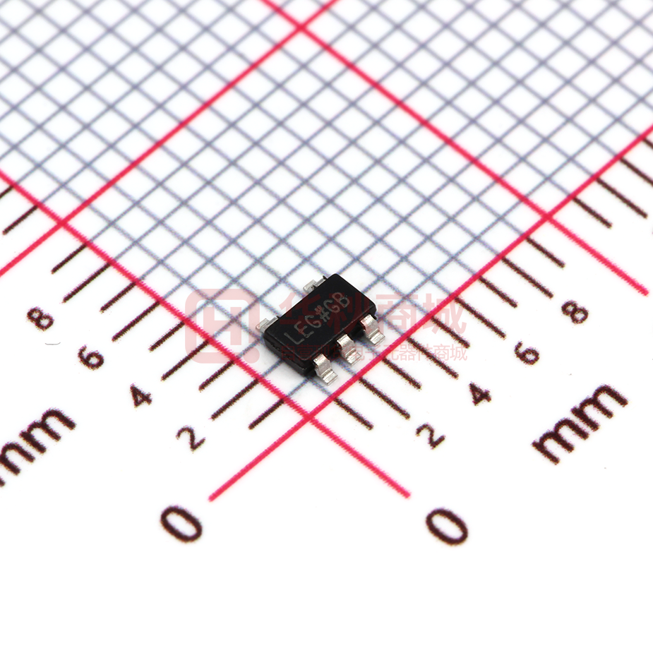

    300mA 60dB@(10kHz,100kHz)150mV@(300mA)可调0.8V~5V正极1 2.3~5.5V TSOT5线性稳压器(LDO)ROHS
ADP123AUJZ-R7 数据手册
FEATURES Digital camera and audio devices Portable and battery-powered equipment Automatic meter reading (AMR) meters GPS and location management units Medical instrumentation Point-of-sale equipment GENERAL DESCRIPTION The ADP122/ADP123 are low quiescent current, low dropout linear regulators. They are designed to operate from an input voltage between 2.3 V and 5.5 V and to provide up to 300 mA of output current. The low 85 mV dropout voltage at a 300 mA load improves efficiency and allows operation over a wide input voltage range. The low 170 μA of quiescent current at full load makes the ADP122 ideal for battery-operated portable equipment. The ADP122 is capable of 31 fixed output voltages from 1.75 V to 3.3 V. The ADP123 is the adjustable version of the device and allows the output voltage to be set between 0.8 V and 5.0 V by an external voltage divider. The ADP122/ADP123 are specifically designed for stable operation with tiny 1 µF ceramic input and output capacitors to meet the requirements of high performance, space constrained applications. VIN = 2.3V TO 5.5V VOUT = 1.8V VIN 1 CIN 1µF VOUT 5 COUT 1µF ADP122 ON 2 GND 3 EN NC 4 OFF Figure 1. ADP122 with Fixed Output Voltage (TSOT Version) VOUT = 0.5V(1 + R1/R2) VIN = 2.3V TO 5.5V VIN 1 CIN 1µF VOUT 5 COUT 1µF ADP123 ON 2 GND 3 EN R1 ADJ 4 OFF 08399-002 R2 Figure 2. ADP123 with Adjustable Output Voltage (TSOT Version) VOUT = 1.8V 1 C2 1µF GND 2 3 VOUT VIN NC NC 4 EN GND GND 6 VIN = 2.3V TO 5.5V C1 1µF 5 GND ON OFF ADP122 TOP VIEW (Not to Scale) NC = NOT CONNECT. THIS PIN CAN BE LEFT FLOATING OR CONNECTED TO GROUND. Figure 3. ADP122 with Fixed Output Voltage (LFCSP Version) VOUT = 0.5V (1 + R1/R2) 1 C2 1µF R1 2 GND R2 GND GND 3 VOUT VIN ADJ NC GND EN 6 VIN = 2.3V TO 5.5V C1 1µF 5 GND 4 ON OFF ADP123 TOP VIEW (Not to Scale) NC = NOT CONNECT. THIS PIN CAN BE LEFT FLOATING OR CONNECTED TO GROUND. 08399-136 APPLICATIONS TYPICAL APPLICATION CIRCUITS 08399-001 Input voltage supply range: 2.3 V to 5.5 V 300 mA maximum output current Fixed and adjustable output voltage versions Very low dropout voltage: 85 mV at 300 mA load Low quiescent current: 45 µA at no load Low shutdown current: 2.3 V IOUT = 10 mA, TJ = −40°C to +125°C IOUT = 150 mA, VOUT > 2.3 V IOUT = 150 mA, TJ = −40°C to +125°C IOUT = 300 mA, VOUT > 2.3V IOUT = 300 mA, TJ = −40°C to +125°C VOUT = 3.0 V START-UP TIME 5 CURRENT LIMIT THRESHOLD 6 THERMAL SHUTDOWN Thermal Shutdown Threshold Thermal Shutdown Hysteresis Typ 3 5 45 75 85 150 350 350 500 650 °C °C 150 15 TJ = −40°C to +125°C TJ = −40°C to +125°C TA = 25°C Rev. E | Page 3 of 24 1.2 0.4 0.1 1 2.1 1.5 125 mV mV mV mV mV mV µs mA V V µA µA V V mV ADP122/ADP123 Data Sheet Parameter OUTPUT NOISE Symbol OUTNOISE POWER SUPPLY REJECTION RATIO (VIN = VOUT + 0.5 V) PSRR Test Conditions 10 Hz to 100 kHz, VIN = 5.5 V, VOUT = 1.2 V 10 Hz to 100 kHz, VIN = 5.5 V, VOUT = 1.8 V 10 Hz to 100 kHz, VIN = 5.5 V, VOUT = 2.5 V 10 Hz to 100 kHz, VIN = 5.5 V, VOUT = 3.3 V 10 Hz to 100 kHz, VIN = 5.5 V, VOUT = 4.2 V 10 kHz, VOUT = 3.3 V 10 kHz, VOUT = 2.5 V 10 kHz, VOUT = 1.8 V 100 kHz, VOUT = 3.3 V 100 kHz, VOUT = 2.5 V 100 kHz, VOUT = 1.8 V Min Typ 25 35 45 55 65 60 60 60 60 60 60 Max Unit µV rms µV rms µV rms µV rms µV rms dB dB dB dB dB dB 1 The current from the external resistor divider network in the case of adjustable voltage output (as with the ADP123) should be subtracted from the ground current measured. Accuracy when VOUT is connected directly to ADJ. When VOUT voltage is set by external feedback resistors, absolute accuracy in adjust mode depends on the tolerances of the resistors used. 3 Based on an endpoint calculation using 1 mA and 300 mA loads. 4 Dropout voltage is defined as the input-to-output voltage differential when the input voltage is set to the nominal output voltage. This applies only for output voltages greater than 2.3 V. 5 Start-up time is defined as the time between the rising edge of EN to VOUT being at 90% of its nominal value. 6 Current limit threshold is defined as the current at which the output voltage drops to 90% of the specified typical value. For example, the current limit for a 3.3 V output voltage is defined as the current that causes the output voltage to drop to 90% of 3.3V, or 2.97 V. 2 RECOMMENDED SPECIFICATIONS Table 2. Parameter Minimum Input and Output Capacitance 1 Capacitor ESR 1 Symbol CAPMIN Test Conditions TA = −40°C to +125°C Min 0.70 RESR TA = −40°C to +125°C 0.001 Typ Max Unit µF 1 Ω The minimum input and output capacitance should be greater than 0.70 µF over the full range of operating conditions. The full range of operating conditions in the application must be considered during device selection to ensure that the minimum capacitance specification is met. X7R and X5R type capacitors are recommended; Y5V and Z5U capacitors are not recommended for use with any LDO. Rev. E | Page 4 of 24 Data Sheet ADP122/ADP123 ABSOLUTE MAXIMUM RATINGS Table 3. Parameter VIN to GND ADJ to GND EN to GND VOUT to GND Storage Temperature Range Operating Ambient Temperature Range Operating Junction Temperature Soldering Conditions Rating −0.3 V to +6.5 V −0.3 V to +6.5 V −0.3 V to +6.5 V −0.3 V to VIN −65°C to +150°C −40°C to +125°C −40°C to +125°C JEDEC J-STD-020 Stresses above those listed under Absolute Maximum Ratings may cause permanent damage to the device. This is a stress rating only; functional operation of the device at these or any other conditions above those indicated in the operational section of this specification is not implied. Exposure to absolute maximum rating conditions for extended periods may affect device reliability. THERMAL DATA Absolute maximum ratings apply individually only, not in combination. The ADP122/ADP123 can be damaged when the junction temperature limits are exceeded. Monitoring ambient temperature does not guarantee that TJ will remain within the specified temperature limits. In applications with high power dissipation and poor thermal resistance, the maximum ambient temperature may have to be derated. In applications with moderate power dissipation and low PCB thermal resistance, the maximum ambient temperature can exceed the maximum limit as long as the junction temperature is within specification limits. The junction temperature (TJ) of the device is dependent on the ambient temperature (TA), the power dissipation of the device (PD), and the junction-to-ambient thermal resistance of the package (θJA). Maximum junction temperature (TJ) is calculated from the ambient temperature (TA) and power dissipation (PD) using the formula application and board layout. In applications in which high maximum power dissipation exists, close attention to thermal board design is required. The value of θJA may vary, depending on PCB material, layout, and environmental conditions. The specified values of θJA are based on a 4-layer, 4 inch × 3 inch circuit board. Refer to JESD51-7 for detailed information on the board construction ΨJB is the junction-to-board thermal characterization parameter and is measured in °C/W. The ΨJB of the package is based on modeling and calculation using a 4-layer board. The Guidelines for Reporting and Using Package Thermal Information: JESD51-12 states that thermal characterization parameters are not the same as thermal resistances. ΨJB measures the component power flowing through multiple thermal paths rather than a single path as in thermal resistance, θJB. Therefore, ΨJB thermal paths include convection from the top of the package as well as radiation from the package—factors that make ΨJB more useful in real-world applications. Maximum junction temperature (TJ) is calculated from the board temperature (TB) and power dissipation (PD) using the formula TJ = TB + (PD × ΨJB) Refer to JESD51-8 and JESD51-12 for more detailed information about ΨJB. THERMAL RESISTANCE θJA and ΨJB are specified for the worst-case conditions, that is, a device soldered in a circuit board for surface-mount packages. Table 4. Thermal Resistance Package Type 5-Lead TSOT 6-Lead 2 mm × 2 mm LFCSP ESD CAUTION TJ = TA + (PD × θJA) The junction-to-ambient thermal resistance (θJA) of the package is based on modeling and calculation using a 4-layer board. The junction-to-ambient thermal resistance is highly dependent on the Rev. E | Page 5 of 24 θJA 170 68.9 ΨJB 43 44.1 Unit °C/W °C/W ADP122/ADP123 Data Sheet PIN CONFIGURATIONS AND FUNCTION DESCRIPTIONS EN 3 VIN 1 5 VOUT 4 ADJ ADP123 TOP VIEW (Not to Scale) 4 NC NC = NO CONNECT GND 2 EN 3 TOP VIEW (Not to Scale) Figure 7. ADP123 TSOT Adjustable Output Pin Configuration Figure 5. ADP122 TSOT Fixed Output Pin Configuration ADP122 ADP123 TOP VIEW (Not to Scale) TOP VIEW (Not to Scale) 1 VOUT VIN 6 1 VOUT VIN 6 2 NC NC 5 2 ADJ NC 5 3 GND EN 4 3 GND EN 4 NOTES 1. NC = NOT CONNECT. THIS PIN CAN BE LEFT FLOATING OR CONNECTED TO GROUND. 2. EXPOSED PAD MUST BE CONNECTED TO GND. 08399-137 NOTES 1. NC = NOT CONNECT. THIS PIN CAN BE LEFT FLOATING OR CONNECTED TO GROUND. 2. EXPOSED PAD MUST BE CONNECTED TO GND. 08399-138 2 VOUT 08399-004 GND 5 ADP122 08399-003 VIN 1 Figure 8. ADP123 LFCSP Adjustable Output Pin Configuration Figure 6. ADP122 LFCSP Fixed Output Pin Configuration Table 5. Pin Function Descriptions Pin No. ADP122 ADP123 TSOT LFCSP TSOT LFCSP 1 6 1 6 2 3 2 3 3 4 3 4 Mnemonic VIN GND EN Description Regulator Input Supply. Bypass VIN to GND with a capacitor of at least 1 µF. Ground. Enable Input. Drive EN high to turn on the regulator; drive EN low to turn off the regulator. For automatic startup, connect EN to VIN. N/A N/A 4 2 ADJ Output Voltage Adjust Input. Connect the midpoint of an external divider from VOUT to GND to this pin to set the output voltage. 4 2, 5 N/A 5 NC 5 N/A 1 EP 5 N/A 1 EP VOUT EPAD No Connect. These pins are not internally bonded. They can be left floating or connected to ground. Regulated Output Voltage. Bypass VOUT to GND with a capacitor of at least 1 µF. Exposed Pad. The exposed pad must be connected to ground. Rev. E | Page 6 of 24 Data Sheet ADP122/ADP123 TYPICAL PERFORMANCE CHARACTERISTICS VIN = 3.6 V, VOUT = 3.3 V, IOUT = 10 mA, CIN = 1.0 µF, COUT = 1.0 µF, TA = 25°C, unless otherwise noted. 250 3.300 3.295 200 GROUND CURRENT (µA) 3.290 IOUT = 100µA IOUT = 1mA IOUT = 10mA IOUT = 100mA IOUT = 200mA IOUT = 300mA 3.270 IOUT = 200mA IOUT = 100mA 100 IOUT = 10mA 50 IOUT = 100µA 3.265 –40 –5 25 85 JUNCTION TEMPERATURE (°C) 0 08399-005 3.260 125 –40 Figure 9. Output Voltage vs. Junction Temperature 180 3.2935 160 GROUND CURRENT (µA) 200 3.2940 VOUT (V) 3.2930 3.2925 3.2920 3.2915 3.2910 120 100 80 60 40 3.2900 20 100 1000 IOUT (mA) 0 08399-006 10 0.1 1 10 IOUT (mA) 100 1000 Figure 13. Ground Current vs. Load Current Figure 10. Output Voltage vs. Load Current 200 3.296 IOUT = 300mA 180 3.294 GROUND CURRENT (µA) 160 3.292 3.290 3.288 IOUT = 100µA IOUT = 1mA IOUT = 10mA IOUT = 100mA IOUT = 200mA IOUT = 300mA 3.286 3.284 3.6 3.8 4.0 4.2 140 IOUT = 200mA 120 IOUT = 100mA 100 IOUT = 10mA 80 IOUT = 1mA 60 IOUT = 100µA 40 20 4.4 4.6 VIN (V) 4.8 5.0 5.2 5.4 0 3.6 08399-007 VOUT (V) 125 140 3.2905 1 –5 25 85 JUNCTION TEMPERATURE (°C) Figure 12. Ground Current vs. Junction Temperature 3.2945 3.2895 0.1 IOUT = 1mA 08399-008 3.275 150 08399-009 3.280 IOUT = 300mA Figure 11. Output Voltage vs. Input Voltage 3.8 4.0 4.2 4.4 4.6 VIN (V) 4.8 5.0 5.2 Figure 14. Ground Current vs. Input Voltage Rev. E | Page 7 of 24 5.4 08399-010 VOUT (V) 3.285 Data Sheet 0.50 3.35 0.45 3.30 0.40 0.35 0.30 0.25 IOUT IOUT IOUT IOUT 3.25 VIN = 3.6V VIN = 3.8V VIN = 4.2V VIN = 4.4V VIN = 5.0V VIN = 5.2V VIN = 5.4V VIN = 5.5V VOUT (V) 3.20 3.15 3.10 0.20 3.05 0.15 –25 0 25 50 75 TEMPERATURE (°C) 100 125 3.00 3.05 08399-011 0.10 –50 Figure 15. Shutdown Current vs. Temperature at Various Input Voltages 3.10 3.15 3.20 3.25 VIN (V) 3.30 3.35 3.40 Figure 18. Output Voltage vs. Input Voltage (in Dropout) 70 –10 –20 60 IOUT = 100µA IOUT = 1mA IOUT = 10mA IOUT = 100mA IOUT = 200mA IOUT = 300mA –30 50 –40 PSRR (dB) DROPOUT (mV) = 10mA = 100mA = 150mA = 300mA 08399-013 SHUTDOWN CURRENT (µA) ADP122/ADP123 40 30 –50 –60 –70 20 –80 1 10 100 1000 IOUT (mA) –100 08399-012 0 10 100 1k 10k 100k 1M 10M FREQUENCY (Hz) Figure 19. Power Supply Rejection Ratio vs. Frequency, VOUT = 2.8 V, VIN = 3.3 V Figure 16. Dropout Voltage vs. Load Current –10 400 –20 350 –30 300 –40 PSRR (dB) 450 250 200 150 IOUT = 100µA IOUT = 1mA IOUT = 10mA IOUT = 100mA IOUT = 200mA IOUT = 300mA –50 –60 –70 IOUT = 10mA IOUT = 100mA IOUT = 150mA IOUT = 300mA 50 0 3.05 3.10 3.15 3.20 –80 VIN = VOUT + 0.5V VRIPPLE = 50mV CIN = COUT 1µF –90 3.25 VIN (V) 3.30 3.35 3.40 3.45 Figure 17. Ground Current vs. Input Voltage (in Dropout) 08399-016 100 –100 08399-014 IGND (µA) VIN = VOUT + 0.5V VRIPPLE = 50mV CIN = COUT 1µF –90 08399-015 10 10 100 1k 10k 100k 1M 10M FREQUENCY (Hz) Figure 20. Power Supply Rejection Ratio vs. Frequency, VOUT = 3.3 V, VIN = 3.8 V Rev. E | Page 8 of 24 Data Sheet ADP122/ADP123 –10 5 –20 IOUT = 100µA IOUT = 1mA IOUT = 10mA IOUT = 100mA IOUT = 200mA IOUT = 300mA PSRR (dB) –40 –50 VOUT = 4.2V 4 VOUT = 3.3V NOISE (µv/√Hz) –30 –60 3 2 –70 –80 1 –100 10 100 1k 10k 100k 1M VOUT = 2.8V 08399-020 08399-017 VIN = VOUT + 0.5V VRIPPLE = 50mV CIN = COUT 1µF –90 0 10 10M 100 1k FREQUENCY (Hz) FREQUENCY (Hz) 100k Figure 24. Output Noise Spectrum Figure 21. Power Supply Rejection Ratio vs. Frequency, VOUT = 4.2 V, VIN = 4.7 V 70 –10 VOUT = 2.8V, VOUT = 3.3V, VOUT = 4.2V, VOUT = 2.8V, VOUT = 3.3V, VOUT = 4.2V, –30 –40 –50 65 IOUT = 1mA IOUT = 1mA IOUT = 1mA IOUT = 300mA IOUT = 300mA IOUT = 300mA VOUT = 4.2V 60 RMS NOISE (µV) –20 PSRR (dB) 10k –60 VOUT = 3.3V 55 50 45 VOUT = 2.8V –70 40 –100 10 100 1k 35 10k 100k 1M 30 0.001 10M 08399-021 –90 08399-018 VIN = VOUT + 0.5V VRIPPLE = 50mV CIN = COUT 1µF –80 0.01 0.1 FREQUENCY (Hz) Figure 22. Power Supply Rejection Ratio vs. Frequency, Various Output Voltages and Load Currents 1 IOUT (mA) 10 100 1000 Figure 25. Output Noise vs. Load Current and Output Voltage –10 VIN = 3.1V, VIN = 3.3V, VIN = 3.8V, VIN = 4.8V, VIN = 3.1V, VIN = 3.3V, VIN = 3.8V, VIN = 4.8V, –20 –30 PSRR (dB) –40 IOUT = 1mA IOUT = 1mA IOUT = 1mA IOUT = 1mA IOUT = 300mA IOUT = 300mA IOUT = 300mA IOUT = 300mA IOUT 1mA TO 300mA LOAD STEP 1 –50 –60 VOUT 2 VRIPPLE = 50mV CIN = COUT 1µF VIN = 3.7V VOUT = 3.3V 08399-019 –80 –90 –100 10 100 1k 10k 100k 1M CH1 200mA Ω 10M FREQUENCY (Hz) Figure 23. Power Supply Rejection Ratio vs. Headroom Voltage (VIN − VOUT), VOUT = 2.8 V Rev. E | Page 9 of 24 B W CH2 50.0mV B W M 40.0µs A CH1 T 10.20% 196mA Figure 26. Load Transient Response, COUT = 1 μF 08399-022 –70 ADP122/ADP123 Data Sheet IOUT VIN 1mA TO 300mA LOAD STEP 4V TO 4.5V VOLTAGE STEP 1 2 VOUT VOUT 2 CH1 200mA Ω B W CH2 20.0mV B W M 40.0µs A CH1 T 10.40% 08399-023 VIN = 3.7V VOUT = 3.3V 08399-025 1 CH1 1.00V BW CH2 2.00mV 196mA Figure 27. Load Transient Response, COUT = 4.7 μF VIN 2 VOUT 08399-024 1 B W M 10.0µs A CH3 T 10.00% W M 10.0µs A CH3 T 9.600% 2.04V Figure 29. Line Transient Response, Load Current = 300 mA 4V TO 4.5V VOLTAGE STEP CH1 1.00V Ω BW CH2 2.00mV B 2.04V Figure 28. Line Transient Response, Load Current = 1 mA Rev. E | Page 10 of 24 Data Sheet ADP122/ADP123 THEORY OF OPERATION The ADP122/ADP123 are low quiescent current, low-dropout linear regulators that operate from 2.3 V to 5.5 V and can provide up to 300 mA of output current. Drawing a low 170 µA of quiescent current (typical) at full load makes the ADP122/ADP123 ideal for battery-operated portable equipment. Shutdown current consumption is typically 100 nA. Note that in shutdown, the output is turned off and the divider current is 0. The ADP122/ADP123 use the EN pin to enable and disable the VOUT pin under normal operating conditions. When EN is high, VOUT turns on; when EN is low, VOUT turns off. For automatic startup, EN can be tied to VIN. Optimized for use with small 1 µF ceramic capacitors, the ADP122/ADP123 provide excellent transient performance. ADP122 VIN The adjustable ADP123 has an output voltage range of 0.8 V to 5.0 V. The output voltage is set by the ratio of two external resistors, as shown in Figure 2. The device servos the output to maintain the voltage at the ADJ pin at 0.5 V referenced to ground. The current in R1 is then equal to 0.5 V/R2 and the current in R1 is the current in R2 plus the ADJ pin bias current. The ADJ pin bias current, 15 nA at 25°C, flows through R1 into the ADJ pin. The output voltage can be calculated using the equation: GND EN SHORT CIRCUIT, UVLO AND THERMAL PROTECT SHUTDOWN 0.5V REFERENCE Rev. E | Page 11 of 24 R2 NOTES 1. R1 AND R2 ARE INTERNAL RESISTORS, AVAILABLE ON THE ADP122 ONLY. Figure 30. ADP122 Internal Block Diagram (Fixed Output) ADP123 VIN GND VOUT SHORT CIRCUIT, UVLO AND THERMAL PROTECT VOUT = 0.5 V(1 + R1/R2) + (ADJI-BIAS)(R1) ADJ EN SHUTDOWN 0.5V REFERENCE 08399-122 The value of R1 should be less than 200 kΩ to minimize errors in the output voltage caused by the ADJ pin bias current. For example, when R1 and R2 each equal 200 kΩ, the output voltage is 1.0 V. The output voltage error introduced by the ADJ pin bias current is 3 mV or 0.3%, assuming a typical ADJ pin bias current of 15 nA at 25°C. R1 08399-121 Internally, the ADP122/ADP123 consist of a reference, an error amplifier, a feedback voltage divider, and a PMOS pass transistor. Output current is delivered via the PMOS pass device, which is controlled by the error amplifier. The error amplifier compares the reference voltage with the feedback voltage from the output and amplifies the difference. If the feedback voltage is lower than the reference voltage, the gate of the PMOS device is pulled lower, allowing more current to pass and increasing the output voltage. If the feedback voltage is higher than the reference voltage, the gate of the PMOS device is pulled higher, allowing less current to pass and decreasing the output voltage. VOUT Figure 31. ADP123 Internal Block Diagram (Adjustable Output) ADP122/ADP123 Data Sheet APPLICATIONS INFORMATION CAPACITOR SELECTION Input and Output Capacitor Properties Output Capacitor Any good quality ceramic capacitors can be used with the ADP122/ ADP123, as long as the capacitor meets the minimum capacitance and maximum ESR requirements. Ceramic capacitors are manufactured with a variety of dielectrics, each with different behavior over temperature and applied voltage. Capacitors must have an adequate dielectric to ensure the minimum capacitance over the necessary temperature range and dc bias conditions. Using an X5R or X7R dielectric with a voltage rating of 6.3 V or 10 V is recommended. However, using Y5V and Z5U dielectrics is not recommended for any LDO, due to their poor temperature and dc bias characteristics. The ADP122/ADP123 are designed for operation with small, space-saving ceramic capacitors, but these devices can function with most commonly used capacitors as long as care is taken to ensure an appropriate effective series resistance (ESR) value. The ESR of the output capacitor affects the stability of the LDO control loop. A minimum of 0.70 µF capacitance with an ESR of 1 Ω or less is recommended to ensure stability of the ADP122/ADP123. The transient response to changes in load current is also affected by the output capacitance. Using a larger value of output capacitance improves the transient response of the ADP122/ADP123 to dynamic changes in load current. Figure 32 and Figure 33 show the transient responses for output capacitance values of 1 µF and 4.7 µF, respectively. IOUT 1mA TO 300mA LOAD STEP 1 Figure 34 depicts the capacitance vs. capacitor voltage bias characteristics of a 0603, 1 µF, 6.3 V X5R capacitor. The voltage stability of a capacitor is strongly influenced by the capacitor size and the voltage rating. In general, a capacitor in a larger package or of a higher voltage rating exhibits better stability. The temperature variation of the X5R dielectric is about ±15% over the −40°C to +85°C temperature range and is not a function of package or voltage rating. 1.10 1.05 2 VOUT CH1 200mA ΩB CH2 50.0mV W B W M 400ns A CH1 T 14.80% 08399-026 VIN = 3.7V VOUT = 3.3V CAPACITANCE (µF) 1.00 196mA Figure 32. Output Transient Response, COUT = 1 µF 0.95 0.90 0.85 0.80 08399-030 0.75 0.70 IOUT 0 1mA TO 300mA LOAD STEP 1 2 3 4 5 6 7 BIAS VOLTAGE (V) 1 Figure 34. Capacitance vs. Capacitor Voltage Bias Characteristics Equation 1 can be used to determine the worst-case capacitance, accounting for capacitor variation over temperature, component tolerance, and voltage. 2 CEFF = C × (1 − TEMPCO) × (1 − TOL) VOUT CH1 200mA Ω B W CH2 20.0mV M 400ns A CH1 T 15.00% where: CEFF is the effective capacitance at the operating voltage. TEMPCO is the worst-case capacitor temperature coefficient. TOL is the worst-case component tolerance. 08399-027 VIN = 3.7V VOUT = 3.3V (1) 196mA Figure 33. Output Transient Response, COUT = 4.7 µF Input Bypass Capacitor Connecting a 1 µF capacitor from VIN to GND reduces the circuit sensitivity to the printed circuit board (PCB) layout, especially when a long input trace or high source impedance is encountered. If greater than 1 µF of output capacitance is required, the input capacitor should be increased to match it. In this example, the worst-case temperature coefficient (TEMPCO) over −40°C to +85°C is assumed to be 15% for an X5R dielectric. The tolerance of the capacitor (TOL) is assumed to be 10%, and C is 0.96 μF at 4.2 V from the graph in Figure 34. Substituting these values in Equation 1 yields Rev. E | Page 12 of 24 CEFF = 0.96 μF × (1 − 0.15) × (1 − 0.1) = 0.734 μF Data Sheet ADP122/ADP123 Therefore, the capacitor chosen in this example meets the minimum capacitance requirement of the LDO over temperature and tolerance at the chosen output voltage. 1.1 ENABLE THRESHOLDS (V) 1.0 To guarantee the performance of the ADP122/ADP123, it is imperative that the effects of dc bias, temperature, and tolerances on the behavior of the capacitors are evaluated for each application. UNDERVOLTAGE LOCKOUT The ADP122/ADP123 have an internal undervoltage lockout circuit that disables all inputs and the output when the input voltage is less than approximately 2 V. This ensures that the ADP122/ADP123 inputs and the output behave in a predictable manner during power-up. 0.8 FALLING 0.7 0.5 2.2 3.5 3.0 2.7 3.2 4.7 5.2 Figure 36. Typical EN Pin Thresholds vs. Input Voltage The ADP122/ADP123 utilize an internal soft start to limit the in-rush current when the output is enabled. The start-up time for the 2.8 V option is approximately 350 µs from the time the EN active threshold is crossed to when the output reaches 90% of its final value. As shown in Figure 37, the start-up time is dependent on the output voltage setting and increases slightly as the output voltage increases. 2.5 VOUT 3.7 4.2 VIN(V) 08399-034 0.6 ENABLE FEATURE The ADP122/ADP123 uses the EN pin to enable and disable the VOUT pin under normal operating conditions. As shown in Figure 35, when a rising voltage on EN crosses the active threshold, VOUT turns on. Conversely, when a falling voltage on EN crosses the inactive threshold, VOUT turns off. RISING 0.9 VIN = 5V VOUT = 4.2V 2.0 VOUT = 3.3V 1.5 VOUT = 2.8V 1.0 08399-230 0.5 0 0.2 0.4 0.6 0.8 VEN 1.0 1.2 1.4 1 2 1.6 08399-033 0 Figure 35. Typical EN Pin Operation As shown in Figure 35, the EN pin has built-in hysteresis. This prevents on/off oscillations that may occur due to noise on the EN pin as it passes through the threshold points. The active and inactive thresholds of the EN pin are derived from the VIN voltage. Therefore, these thresholds vary as the input voltage changes. Figure 36 shows typical EN active and inactive thresholds when the VIN voltage varies from 2.3 V to 5.5 V. Rev. E | Page 13 of 24 CH1 1.00V CH2 1.00V M200µs A CH1 T 600.000µs Figure 37. Typical Start-Up Time 3.08V ADP122/ADP123 Data Sheet CURRENT LIMIT AND THERMAL OVERLOAD PROTECTION Table 6. Typical θJA Values for Specified PCB Copper Sizes The ADP122/ADP123 are protected from damage due to excessive power dissipation by current and thermal overload protection circuits. The ADP122/ADP123 are designed to limit the current when the output load reaches 500 mA (typical). When the output load exceeds 500 mA, the output voltage is reduced to maintain a constant current limit. Copper Size (mm2) 01 50 100 300 500 Thermal overload protection is included, which limits the junction temperature to a maximum of 150°C typical. Under extreme conditions (that is, high ambient temperature and power dissipation), when the junction temperature starts to rise above 150°C, the output is turned off, reducing output current to zero. When the junction temperature cools to less than 135°C, the output is turned on again and the output current is restored to its nominal value. Consider the case where a hard short from VOUT to GND occurs. At first, the ADP122/ADP123 limit the current so that only 500 mA is conducted into the short. If self-heating causes the junction temperature to rise above 150°C, thermal shutdown activates, turning off the output and reducing the output current to zero. When the junction temperature cools to less than 135°C, the output turns on and conducts 500 mA into the short, again causing the junction temperature to rise above 150°C. This thermal oscillation between 135°C and 150°C results in a current oscillation between 500 mA and 0 mA that continues as long as the short remains at the output. Current and thermal limit protections are intended to protect the device from damage due to accidental overload conditions. For reliable operation, the device power dissipation must be externally limited so that the junction temperature does not exceed 125°C. THERMAL CONSIDERATIONS To guarantee reliable operation, the junction temperature of the ADP122/ADP123 must not exceed 125°C. To ensure that the junction temperature is less than this maximum value, the user needs to be aware of the parameters that contribute to junction temperature changes. These parameters include ambient temperature, power dissipation in the power device, and thermal resistances between the junction and ambient air (θJA). The value of θJA is dependent on the package assembly compounds used and the amount of copper to which the GND pins of the package are soldered on the PCB. Table 6 shows typical θJA values of the 5-lead TSOT package and 6-lead LFCSP package for various PCB copper sizes. 1 TSOT 170 152 146 134 131 θJA (°C/W) LFCSP 255 164 138 109 80 Device soldered to narrow traces. The typical ΨJB values are 42.8°C/W for TSOT packages and 44.1°C/W for LFCSP packages. The junction temperature of the ADP122/ADP123 can be calculated from the following equation: TJ = TA + (PD × θJA) (2) where: TA is the ambient temperature. PD is the power dissipation in the die, given by PD = [(VIN − VOUT) × ILOAD] + (VIN × IGND) (3) where: ILOAD is the load current. IGND is the ground current. VIN and VOUT are input and output voltages, respectively. The power dissipation due to ground current is quite small and can be ignored. Therefore, the junction temperature equation can be simplified as follows: TJ = TA + {[(VIN − VOUT) × ILOAD] × θJA} (4) As shown in Equation 4, for a given ambient temperature, inputto-output voltage differential, and continuous load current, there exists a minimum copper size requirement for the PCB to ensure that the junction temperature does not rise above 125°C. Figure 38 through Figure 44 show junction temperature calculations for different ambient temperatures, load currents, VIN to VOUT differentials, and areas of PCB copper. In cases where the board temperature is known, the thermal characterization parameter, ΨJB, can be used to estimate the junction temperature rise. The maximum junction temperature (TJ) is calculated from the board temperature (TB) and power dissipation (PD) using the formula Rev. E | Page 14 of 24 TJ = TB + (PD × ΨJB) (5) Data Sheet ADP122/ADP123 JUNCTION TEMPERATURE CALCULATIONS FOR TSOT PACKAGE 140 140 TJ MAX TJ MAX 120 JUNCTION TEMPERATURE (°C) ILOAD = 300mA 100 80 ILOAD = 150mA 60 ILOAD = 100mA 40 ILOAD = 25mA 80 ILOAD = 150mA 60 ILOAD = 100mA 40 ILOAD = 25mA 20 1.0 1.5 ILOAD = 10mA 2.0 2.5 ILOAD = 1mA 3.0 VOUT – VIN (V) 0 0.5 08399-128 ILOAD = 1mA 1.0 2.5 3.0 Figure 40. Junction Temperature vs. Power Dissipation, 0 mm2 of PCB Copper, TA = 25°C 140 140 TJ MAX TJ MAX 120 JUNCTION TEMPERATURE (°C) 120 ILOAD = 300mA 100 ILOAD = 150mA 80 60 ILOAD = 100mA 40 ILOAD = 25mA 20 ILOAD = 300mA ILOAD = 150mA 100 80 ILOAD = 100mA ILOAD = 25mA 60 40 ILOAD = 10mA ILOAD = 1mA 20 ILOAD = 10mA ILOAD = 1mA 1.0 1.5 2.0 2.5 VOUT – VIN (V) 3.0 08399-129 JUNCTION TEMPERATURE (°C) 2.0 VOUT – VIN (V) Figure 38. Junction Temperature vs. Power Dissipation, 500 mm2 of PCB Copper, TA = 25°C 0 0.5 1.5 ILOAD = 10mA 08399-130 20 0 0.5 ILOAD = 300mA 100 Figure 39. Junction Temperature vs. Power Dissipation, 100 mm2 of PCB Copper, TA = 25°C 0 0.5 1.0 1.5 2.0 2.5 VOUT – VIN (V) Figure 41. Junction Temperature vs. Power Dissipation, 500 mm2 of PCB Copper, TA = 50°C Rev. E | Page 15 of 24 3.0 08399-131 JUNCTION TEMPERATURE (°C) 120 ADP122/ADP123 Data Sheet 140 140 TJ MAX 120 ILOAD = 300mA JUNCTION TEMPERATURE (°C) ILOAD = 150mA 100 80 ILOAD = 100mA ILOAD = 25mA 60 40 ILOAD = 1mA ILOAD = 10mA 20 1.0 1.5 2.0 2.5 3.0 VOUT – VIN (V) 140 TJ MAX 120 ILOAD = 300mA ILOAD = 150mA 100 ILOAD = 100mA 80 ILOAD = 25mA 60 40 ILOAD = 1mA ILOAD = 10mA 20 1.0 1.5 2.0 2.5 VOUT – VIN (V) 3.0 08399-133 JUNCTION TEMPERATURE (°C) 60 40 ILOAD ILOAD ILOAD ILOAD = 1mA = 10mA = 50mA = 100mA ILOAD = 150mA ILOAD = 250mA ILOAD = 300mA TJ MAX 0 0.4 0.8 1.2 1.6 2.0 2.4 VIN – VOUT (V) Figure 44. Junction Temperature vs. Power Dissipation, Board Temperature = 85°C Figure 42. Junction Temperature vs. Power Dissipation, 100 mm2 of PCB Copper, TA = 50°C 0 0.5 80 20 08399-132 0 0.5 100 Figure 43. Junction Temperature vs. Power Dissipation, 0 mm2 of PCB Copper, TA = 50°C Rev. E | Page 16 of 24 2.8 08399-134 JUNCTION TEMPERATURE (°C) 120 Data Sheet ADP122/ADP123 JUNCTION TEMPERATURE CALCULATIONS FOR LFCSP PACKAGE 140 140 TJ MAX TJ MAX 120 JUNCTION TEMPERATURE (°C) 100 300mA 80 150mA 60 100mA 40 25mA 20 300mA 100 150mA 80 60 25mA 40 1mA 10mA 20 1.0 1.5 2.0 2.5 3.0 VOUT – VIN (V) 0 0.5 08399-139 0 0.5 1.0 1.5 2.0 2.5 3.0 08399-141 10mA 1mA 3.0 VOUT – VIN (V) Figure 45. Junction Temperature vs. Power Dissipation, 500 mm2 of PCB Copper, TA = 25°C Figure 47. Junction Temperature vs. Power Dissipation, 500 mm2 of PCB Copper, TA = 50°C 140 140 TJ MAX TJ MAX 120 JUNCTION TEMPERATURE (°C) 120 300mA 100 80 150mA 100mA 60 40 25mA 20 300mA 150mA 100 100mA 80 25mA 60 40 10mA 1mA 20 10mA 1mA 0 0.5 1.0 1.5 2.0 2.5 VOUT – VIN (V) 3.0 08399-140 JUNCTION TEMPERATURE (°C) 100mA 08399-142 JUNCTION TEMPERATURE (°C) 120 Figure 46. Junction Temperature vs. Power Dissipation, 100 mm2 of PCB Copper, TA = 25°C 0 0.5 1.0 1.5 2.0 2.5 VOUT – VIN (V) Figure 48. Junction Temperature vs. Power Dissipation, 100 mm2 of PCB Copper, TA = 50°C Rev. E | Page 17 of 24 ADP122/ADP123 Data Sheet 140 140 TJ MAX TJ MAX 120 300mA JUNCTION TEMPERATURE (°C) JUNCTION TEMPERATURE (°C) 120 150mA 100 100mA 80 60 25mA 40 20 300mA 150mA 100 100mA 80 1mA 10mA 25mA 60 40 20 10mA 1.0 1.5 2.0 2.5 3.0 VOUT – VIN (V) 140 TJ MAX 100 100mA 80 25mA 60 10mA 40 1mA 20 0 0.5 1.0 1.5 2.0 2.5 VOUT – VIN (V) 3.0 08399-145 JUNCTION TEMPERATURE (°C) 150mA 300mA 0.8 1.2 1.6 2.0 2.4 VOUT – VIN (V) Figure 51. Junction Temperature vs. Power Dissipation, Board Temperature = 85°C Figure 49. Junction Temperature vs. Power Dissipation, 0 mm2 of PCB Copper, TA = 25°C 120 0 0.4 Figure 50. Junction Temperature vs. Power Dissipation, 0 mm2 of PCB Copper, TA = 50°C Rev. E | Page 18 of 24 2.8 08399-144 0 0.5 08399-143 1mA Data Sheet ADP122/ADP123 PRINTED CIRCUIT BOARD LAYOUT CONSIDERATIONS The input capacitor should be placed as close as possible to the VIN and GND pins, and the output capacitor should be placed as close as possible to the VOUT and GND pins. Use of 0402 or 0603 size capacitors and resistors achieves the smallest possible footprint solution on boards where the area is limited. 08399-041 Heat dissipation from the package can be improved by increasing the amount of copper attached to the pins of the ADP122/ADP123. However, as shown in Table 6, a point of diminishing returns eventually is reached, beyond which an increase in the copper size does not yield significant heat dissipation benefits. 08399-042 Figure 52. Example ADP122 PCB Layout Figure 53. Example ADP123 PCB Layout Rev. E | Page 19 of 24 ADP122/ADP123 Data Sheet OUTLINE DIMENSIONS 2.90 BSC 5 4 2.80 BSC 1.60 BSC 1 2 3 0.95 BSC 1.90 BSC *0.90 MAX 0.70 MIN 0.10 MAX 0.50 0.30 0.20 0.08 8° 4° 0° SEATING PLANE 0.60 0.45 0.30 100708-A *1.00 MAX *COMPLIANT TO JEDEC STANDARDS MO-193-AB WITH THE EXCEPTION OF PACKAGE HEIGHT AND THICKNESS. Figure 54. 5-Lead Thin Small Outline Transistor Package [TSOT] (UJ-5) Dimensions shown in millimeters 1.70 1.60 1.50 2.00 BSC SQ 0.65 BSC 6 4 1.10 1.00 0.90 EXPOSED PAD 0.425 0.350 0.275 1 3 TOP VIEW 0.60 0.55 0.50 SEATING PLANE BOTTOM VIEW 0.05 MAX 0.02 NOM 0.35 0.30 0.25 FOR PROPER CONNECTION OF THE EXPOSED PAD, REFER TO THE PIN CONFIGURATION AND FUNCTION DESCRIPTIONS SECTION OF THIS DATA SHEET. 0.20 REF Figure 55. 6-Lead Lead Frame Chip Scale Package [LFCSP_UD] 2.00 mm× 2.00 mm Body, Ultra Thin, Dual Lead (CP-6-3) Dimensions shown in millimeters Rev. E | Page 20 of 24 PIN 1 INDICATOR (R 0.15) 07-11-2011-B PIN 1 INDEX AREA 0.175 REF Data Sheet ADP122/ADP123 ORDERING GUIDE Model 1 ADP122AUJZ-1.8-R7 ADP122AUJZ-2.5-R7 ADP122AUJZ-2.7-R7 ADP122AUJZ-2.8-R7 ADP122AUJZ-2.85-R7 ADP122AUJZ-2.9-R7 ADP122AUJZ-3.0-R7 ADP122AUJZ-3.3-R7 ADP122ACPZ-1.8-R7 ADP122ACPZ-2.0-R7 ADP122ACPZ-2.5-R7 ADP122ACPZ-2.6-R7 ADP122ACPZ-2.8-R7 ADP122ACPZ-3.0-R7 ADP122ACPZ-3.3-R7 ADP123AUJZ-R7 ADP123ACPZ-R7 ADP122-3.3-EVALZ ADP123-EVALZ ADP122UJZ-REDYKIT 1 2 Temperature Range –40°C to +125°C –40°C to +125°C –40°C to +125°C –40°C to +125°C –40°C to +125°C –40°C to +125°C –40°C to +125°C –40°C to +125°C –40°C to +125°C –40°C to +125°C –40°C to +125°C –40°C to +125°C –40°C to +125°C –40°C to +125°C –40°C to +125°C –40°C to +125°C –40°C to +125°C Output Voltage (V) 2 1.8 2.5 2.7 2.8 2.85 2.9 3.0 3.3 1.8 2.0 2.5 2.6 2.8 3.0 3.3 0.8 to 5.0 (Adjustable) 0.8 to 5.0 (Adjustable) 3.3 Adjustable REDYKIT 2.5,3.3 Package Description 5-Lead TSOT 5-Lead TSOT 5-Lead TSOT 5-Lead TSOT 5-Lead TSOT 5-Lead TSOT 5-Lead TSOT 5-Lead TSOT 6-Lead LFCSP_UD 6-Lead LFCSP_UD 6-Lead LFCSP_UD 6-Lead LFCSP_UD 6-Lead LFCSP_UD 6-Lead LFCSP_UD 6-Lead LFCSP_UD 5-Lead TSOT 6-Lead LFCSP_UD Evaluation Board Evaluation Board REDYKIT Package Option UJ-5 UJ-5 UJ-5 UJ-5 UJ-5 UJ-5 UJ-5 UJ-5 CP-6-3 CP-6-3 CP-6-3 CP-6-3 CP-6-3 CP-6-3 CP-6-3 UJ-5 CP-6-3 Branding LJS LE6 LE9 LEA LEC LED LEE LEF LJS LJT LE6 LJU LEA LEE LEF LEG LEG Z = RoHS Compliant Part. Up to 31 fixed-output voltage options from 1.75 V to 3.3 V are available. For additional voltage options, contact a local Analog Devices, Inc., sales or distribution representative. Rev. E | Page 21 of 24 ADP122/ADP123 Data Sheet NOTES Rev. E | Page 22 of 24 Data Sheet ADP122/ADP123 NOTES Rev. E | Page 23 of 24 ADP122/ADP123 Data Sheet NOTES ©2009–2012 Analog Devices, Inc. All rights reserved. Trademarks and registered trademarks are the property of their respective owners. D08399-0-6/12(E) Rev. E | Page 24 of 24
