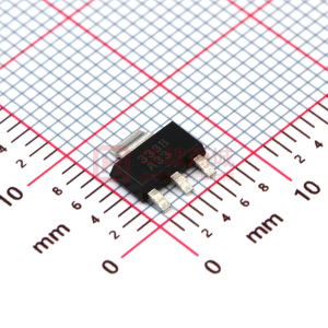

a High-Accuracy Ultralow IQ, 1 A, anyCAP® Low Dropout Regulator ADP3338 FUNCTIONAL BLOCK DIAGRAM IN THERMAL PROTECTION Q1 OUT FEATURES High Accuracy Over Line and Load: 0.8% @ 25 C, 1.4% Over Temperature Ultralow Dropout Voltage: 190 mV (Typ) @ 1 A Requires Only CO = 1 F for Stability anyCAP = Stable with Any Type of Capacitor (Including MLCC) Current and Thermal Limiting Low Noise 2.7 V to 8 V Supply Range –40 C to +85 C Ambient Temperature Range SOT-223 Package APPLICATIONS Notebook, Palmtop Computers SCSI Terminators Battery-Powered Systems Bar Code Scanners Camcorders, Cameras Home Entertainment Systems Networking Systems DSP/ASIC Supply ADP3338 CC gm R1 DRIVER R2 BANDGAP REF GND GENERAL DESCRIPTION The ADP3338 is a member of the ADP33xx family of precision low dropout anyCAP voltage regulators. The ADP3338 operates with an input voltage range of 2.7 V to 8 V and delivers a load current up to 1 A. The ADP3338 stands out from the conventional LDOs with a novel architecture and an enhanced process that enables it to offer performance advantages and higher output current than its competition. Its patented design requires only a 1 µF output capacitor for stability. This device is insensitive to output capacitor Equivalent Series Resistance (ESR), and is stable with any good quality capacitor, including ceramic (MLCC) types for space-restricted applications. The ADP3338 achieves exceptional accuracy of ± 0.8% at room temperature and ± 1.4% over temperature, line and load variations. The dropout voltage of the ADP3338 is only 190 mV (typical) at 1 A. This device also includes a safety current limit and thermal overload protection. The ADP3338 has ultralow quiescent current 110 µA (typical) in light load situations. ADP3338 VIN 1F IN GND OUT 1F VOUT Figure 1. Typical Application Circuit anyCAP is a registered trademark of Analog Devices Inc. R EV. 0 Information furnished by Analog Devices is believed to be accurate and reliable. However, no responsibility is assumed by Analog Devices for its use, nor for any infringements of patents or other rights of third parties that may result from its use. No license is granted by implication or otherwise under any patent or patent rights of Analog Devices. One Technology Way, P.O. Box 9106, Norwood, MA 02062-9106, U.S.A. Tel: 781/329-4700 www.analog.com Fax: 781/326-8703 © Analog Devices, Inc., 2001 ADP3338–SPECIFICATIONS1, 2, 3 Parameter OUTPUT Voltage Accuracy Symbol VOUT Conditions (VIN = 6.0 V, CIN = COUT = 1 F, TJ = –40 C to +125 C, unless otherwise noted.) Min –0.8 Typ Max +0.8 Unit % Line Regulation Load Regulation Dropout Voltage VDROP Peak Load Current Output Noise GROUND CURRENT In Regulation ILDPK VNOISE VIN = VOUTNOM + 0.4 V to 8 V IL = 0.1 mA to 1 A TJ = 25°C VIN = VOUTNOM + 0.4 V to 8 V IL = 0.1 mA to 1 A TJ = –40°C to +125°C VIN = VOUTNOM + 0.4 V to 8 V IL = 50 mA to 1 A TJ = 150 °C VIN = VOUTNOM + 0.4 V to 12 V TJ = 25°C IL = 0.1 mA to 1 A TJ = 25°C VOUT = 98% of VOUTNOM IL = 1 A IL = 500 mA IL = 100 mA VIN = VOUTNOM + 1 V f = 10 Hz–100 kHz, CL = 10 µF IL = 1 A IL = 1 A IL = 500 mA IL = 100 mA IL = 0.1 mA VIN = VOUTNOM – 100 mV IL = 0.1 mA –1.4 +1.4 % –1.6 +1.6 % 0.04 0.006 mV/V mV/mA 190 125 70 1.6 95 400 200 150 mV mV mV A µV rms IGND In Dropout IGND 9 4.5 0.9 110 190 30 15 3 190 600 mA mA mA µA µA NOTES 1 All limits at temperature extremes are guaranteed via correlation using standard Statistical Quality Control (SQC) methods. 2 Application stable with no load. 3 VIN = 2.7 V for models with V OUTNOM ≤ 2.2 V. Specifications subject to change without notice. –2– REV. 0 ADP3338 ABSOLUTE MAXIMUM RATINGS * PIN FUNCTION DESCRIPTIONS Input Supply Voltage . . . . . . . . . . . . . . . . . . –0.3 V to +8.5 V Power Dissipation . . . . . . . . . . . . . . . . . . . Internally Limited Operating Ambient Temperature Range . . . . –40°C to +85°C Operating Junction Temperature Range . . . –40°C to +150°C θJA . . . . . . . . . . . . . . . . . . . . . . . . . . . . . . . . . . . . . 62.3°C/W θJC . . . . . . . . . . . . . . . . . . . . . . . . . . . . . . . . . . . . . 26.8°C/W Storage Temperature Range . . . . . . . . . . . . –65°C to +150°C Lead Temperature Range (Soldering 10 sec) . . . . . . . . 300°C Vapor Phase (60 sec) . . . . . . . . . . . . . . . . . . . . . . . . . . 215°C Infrared (15 sec) . . . . . . . . . . . . . . . . . . . . . . . . . . . . . 220°C *This is a stress rating only; operation beyond these limits can cause the device to be permanently damaged. Unless otherwise specified, all voltages are referenced to GND. Pin No. 1 2 3 Mnemonic GND OUT IN Function Ground Pin. Output of the Regulator. Bypass to ground with a 1 µF or larger capacitor. Regulator Input. Bypass to ground with a 1 µF or larger capacitor. PIN CONFIGURATION 3 OUT OUT TOP VIEW (Not to Scale) 1 GND 2 ADP3338 IN ORDERING GUIDE Model ADP3338AKC-1.8 ADP3338AKC-2.5 ADP3338AKC-2.85 ADP3338AKC-3.3 ADP3338AKC-5 Output Voltage* 1.8 V 2.5 V 2.85 V 3.3 V 5V Package Option KC (SOT-223) KC (SOT-223) KC (SOT-223) KC (SOT-223) KC (SOT-223) Package Description Plastic Surface Mount Plastic Surface Mount Plastic Surface Mount Plastic Surface Mount Plastic Surface Mount *Contact the factory for other voltage options. CAUTION ESD (electrostatic discharge) sensitive device. Electrostatic charges as high as 4000 V readily accumulate on the human body and test equipment and can discharge without detection. Although the ADP3338 features proprietary ESD protection circuitry, permanent damage may occur on devices subjected to high-energy electrostatic discharges. Therefore, proper ESD precautions are recommended to avoid performance degradation or loss of functionality. WARNING! ESD SENSITIVE DEVICE REV. 0 –3– ADP3338–Typical Performance Characteristics (T = 25 C unless otherwise noted.) A 2.515 VOUT = 2.5V 2.510 IL = 0A 2.501 2.500 2.499 2.498 2.497 2.496 2.504 2.503 VIN = 6V 300 VOUT = 2.5V ILOAD = 0A 250 GROUND CURRENT – A OUTPUT VOLTAGE – V OUTPUT VOLTAGE – V 2.502 2.505 IL = 1A IL = 0.5A 200 150 100 50 2.500 2.495 2.490 2.5 2.495 4.5 6.5 8.5 INPUT VOLTAGE – V 10.5 12.5 0 0.2 0.4 0.6 0.6 LOAD CURRENT – A 0.8 1.0 0 0 2 4 6 8 INPUT VOLTAGE – V 10 12 TPC 1. Line Regulation Output Voltage vs. Supply Voltage TPC 2. Output Voltage vs. Load Current TPC 3. Ground Current vs. Supply Voltage 12 VOUT = 2.5V VIN = 6V 10 GROUND CURRENT – mA OUTPUT VOLTAGE – % 0.4 VOUT = 2.5V VIN = 6V 0.3 IL = 1A IL = 0.7A IL = 0.5A 0.2 IL = 0.3A 18 16 GROUND CURRENT – mA 14 12 10 8 6 4 2 0 –40 –20 0 20 40 60 80 100 120 140 150 JUNCTION TEMPERATURE – C ILOAD = 1A ILOAD = 700mA ILOAD = 500mA ILOAD = 300mA 8 6 4 2 0.1 IL = 0A 0 0 0 0.2 0.4 0.6 OUTPUT LOAD – A 0.8 1.0 –0.05 0 20 40 60 80 100 120 –40 –20 JUNCTION TEMPERATURE – C TPC 4. Ground Current vs. Load Current TPC 5. Output Voltage Variation % vs. Junction Temperature TPC 6. Ground Current vs. Junction Temperature 250 INPUT/OUTPUT VOLTAGE – V VOUT = 2.5V 200 DROPOUT – mV 3 VOUT = 2.5V RLOAD = 2.5 2.51 2.50 VOUT = 2.5V COUT = 1 F RLOAD = 2.5 150 1 4.5 100 0 0 1 2 3 4 5 6 TIME – sec 7 8 9 10 VOLTS 2 2.49 3.5 80 120 140 TIME – s 180 50 0 0 0.2 0.4 0.6 0.8 LOAD CURRENT – A 1.0 TPC 7. Dropout Voltage vs. Load Current TPC 8. Power-Up/Power-Down TPC 9. Line Transient Response –4– REV. 0 ADP3338 VOLTS VOLTS 2.51 2.50 VOLTS VOUT = 2.5V COUT = 10 F RLOAD = 2.5 T 2.6 2.5 2.4 VIN = 6V COUT = 1 F RLOAD = 2.5 T 2.6 2.5 2.4 VIN = 6V COUT = 10 F 2.49 1 A 1 4.5 3.5 80 120 140 TIME – s 180 A 0 200 300 600 TIME – s 800 0 200 400 600 TIME – s 800 TPC 10. Line Transient Response TPC 11. Load Transient Response TPC 12. Load Transient Response 0 VOLTS 2.5 –10 RIPPLE REJECTION – dB VOUT = 2.5V CL = 1 F IL = 1A RMS NOISE – V 300 0.0 400m SHORT 1.5 FULL SHORT VIN = 6V –20 –30 –40 –50 –60 –70 –80 CL = 1 F IL = 0 CL = 10 F IL = 1A 250 200 1.0 0.5 0.0 0.4 0.6 0.8 TIME – s 150 IL = 1A A 100 1 –90 10 100 CL = 10 F IL = 0 50 IL = 0A 0 1k 10k 100k FREQUENCY – Hz 1M 0 10 20 CL – 30 F 40 50 TPC 13. Short-Circuit Current TPC 14. Power Supply Ripple Rejection TPC 15. RMS Noise vs. CL (10 Hz–100 kHz) V/ Hz VOLTAGE NOISE SPECTRAL DENSITY – 100 10 CL = 1 F 1 0.1 CL = 10 F 0.01 0.001 10 100 10k 1k 100k FREQUENCY – Hz 1M TPC 16. Output Noise Density REV. 0 –5– ADP3338 THEORY OF OPERATION The new anyCAP LDO ADP3338 uses a single control loop for regulation and reference functions. The output voltage is sensed by a resistive voltage divider consisting of R1 and R2 which is varied to provide the available output voltage option. Feedback is taken from this network by way of a series diode (D1) and a second resistor divider (R3 and R4) to the input of an amplifier. INPUT Q1 COMPENSATION CAPACITOR PTAT VOS R4 OUTPUT ATTENUATION (VBANDGAP/VOUT) R3 D1 (a) PTAT CURRENT R1 CLOAD RLOAD R2 With the ADP3338 anyCAP LDO, this is no longer true. It can be used with virtually any good quality capacitor, with no constraint on the minimum ESR. This innovative design allows the circuit to be stable with just a small 1 µF capacitor on the output. Additional advantages of the pole-splitting scheme include superior line noise rejection and very high regulator gain, which leads to excellent line and load regulation. An impressive ± 1.4% accuracy is guaranteed over line, load, and temperature. Additional features of the circuit include current limit and thermal shutdown. VIN C1 1F IN OUT GND C2 1F VOUT NONINVERTING WIDEBAND DRIVER gm ADP3338 ADP3338 GND Figure 2. Functional Block Diagram Figure 3. Typical Application Circuit APPLICATION INFORMATION CAPACITOR SELECTION Output Capacitor A very high-gain error amplifier is used to control this loop. The amplifier is constructed in such a way that equilibrium produces a large, temperature-proportional input, “offset voltage” that is repeatable and very well controlled. The temperatureproportional offset voltage is combined with the complementary diode voltage to form a “virtual bandgap” voltage, implicit in the network, although it never appears explicitly in the circuit. Ultimately, this patented design makes it possible to control the loop with only one amplifier. This technique also improves the noise characteristics of the amplifier by providing more flexibility on the trade-off of noise sources that leads to a low noise design. The R1, R2 divider is chosen in the same ratio as the bandgap voltage to the output voltage. Although the R1, R2 resistor divider is loaded by the diode D1 and a second divider consisting of R3 and R4, the values can be chosen to produce a temperature-stable output. This unique arrangement specifically corrects for the loading of the divider, thus avoiding the error resulting from base current loading in conventional circuits. The patented amplifier controls a new and unique noninverting driver that drives the pass transistor, Q1. The use of this special noninverting driver enables the frequency compensation to include the load capacitor in a pole-splitting arrangement to achieve reduced sensitivity to the value, type, and ESR of the load capacitance. Most LDOs place very strict requirements on the range of ESR values for the output capacitor because they are difficult to stabilize due to the uncertainty of load capacitance and resistance. Moreover, the ESR value, required to keep conventional LDOs stable, changes depending on load and temperature. These ESR limitations make designing with LDOs more difficult because of their unclear specifications and extreme variations over temperature. The stability and transient response of the LDO is a function of the output capacitor. The ADP3338 is stable with a wide range of capacitor values, types, and ESR (anyCAP). A capacitor as low as 1 µF is all that is needed for stability. A higher capacitance may be necessary if high output current surges are anticipated or if the output capacitor cannot be located near the output and ground pins. The ADP3338 is stable with extremely low ESR capacitors (ESR ≈ 0), such as Multilayer Ceramic Capacitors (MLCC) or OSCON. Note that the effective capacitance of some capacitor types fall below the minimum over temperature or with dc voltage. Input Capacitor An input bypass capacitor is not strictly required but it is recommended in any application involving long input wires or high source impedance. Connecting a 1 µF capacitor from the input to ground reduces the circuit’s sensitivity to PC board layout and input transients. If a larger output capacitor is necessary, a larger value input capacitor is also recommended. OUTPUT CURRENT LIMIT The ADP3338 is short-circuit protected by limiting the pass transistor’s base drive current. The maximum output current is limited to about 2 A. See TPC 13. –6– REV. 0 ADP3338 THERMAL OVERLOAD PROTECTION The ADP3338 is protected against damage due to excessive power dissipation by its thermal overload protection circuit. Thermal protection limits the die temperature to a maximum of 160°C. Under extreme conditions (i.e., high ambient temperature and power dissipation) where the die temperature starts to rise above 160°C, the output current will be reduced until the die temperature has dropped to a safe level. Current and thermal limit protections are intended to protect the device against accidental overload conditions. For normal operation, the device’s power dissipation should be externally limited so that the junction temperature will not exceed 150°C. CALCULATING POWER DISSIPATION As shown in Figures 4a–c, the amount of copper the ADP3338 is mounted to affects the thermal performance. When mounted to 2 oz. copper with just the minimal pads, Figure 4a, the θJA is 126.6°C/W. By adding a small copper pad under the ADP3338, Figure 4b, reduces the θJA to 102.9°C/W. Increasing the copper pad to 1 square inch, Figure 4c, reduces the θ JA even further to 52.8°C/W. Device power dissipation is calculated as follows: PD = (VIN − VOUT ) × ILOAD + (VIN ) × IGND Where ILOAD and IGND are load current and ground current, VIN and VOUT are the input and output voltages respectively. Assuming worst-case operating conditions are ILOAD = 1.0 A, IGND = 10 mA, VIN = 3.3 V and VOUT = 2.5 V, the device power dissipation is: PD = ( 3.3V – 2.5V ) 1000 mA + ( 3.3V ) 10 mA = 833 mW So, for a junction temperature of 125°C and a maximum ambient temperature of 85° C, the required thermal resistance from junction to ambient is: a. b. c. Figure 4. PCB Layouts Use the following general guidelines when designing printed circuit boards: 1. Keep the output capacitor as close to the output and ground pins as possible. 2. Keep the input capacitor as close to the input and ground pins as possible. 3. PC board traces with larger cross sectional areas will remove more heat from the ADP3338. For optimum heat transfer, specify thick copper and use wide traces. 4. The thermal resistance can be decreased by adding a copper pad under the ADP3338 as shown in Figure 4b. 5. If possible, utilize the adjacent area to add more copper around the ADP3338. Connecting the copper area to the output of the ADP3338, as shown in Figure 4c, is best but will improve thermal performance even if it is connected to other signals. 6. Use additional copper layers or planes to reduce the thermal resistance. Again, connecting the other layers to the output of the ADP3338 is best, but not necessary. When connecting the output pad to other layers use multiple vias. θ JA = 125°C – 85°C = 48°C /W 0.833 W PRINTED CIRCUIT BOARD LAYOUT CONSIDERATIONS The SOT-223’s thermal resistance, θJA, is determined by the sum of the junction-to-case and the case-to-ambient thermal resistances. The junction-to-case thermal resistance, θJC, is determined by the package design and specified at 26.8°C/W. However, the case-to-ambient thermal resistance is determined by the printed circuit board design. REV. 0 –7– ADP3338 OUTLINE DIMENSIONS Dimensions shown in inches and (mm). 3-Lead Surface Mount KC (SOT-223) C02050–1.5–6/01(0) 0.287 (7.30) 0.264 (6.70) 1 2 3 0.124 (3.15) 0.116 (2.95) 4 0.146 (3.70) 0.130 (3.30) 0.033 (0.85) 0.026 (0.65) 0.0905 (2.30) NOM 0.041 (1.05) 0.033 (0.85) 0.051 (1.30) 0.043 (1.10) 16 10 0.264 (6.70) 0.248 (6.30) 0.067 (1.70) 0.060 (1.50) 0.004 (0.10) 0.0008 (0.02) 0.181 (4.60) NOM 0.25 (0.35) 0.010 (0.25) 16 10 10 MAX SEATING PLANE –8– REV. 0 PRINTED IN U.S.A.
ADP3338AKC-285
物料型号: - ADP3338AKC-1.8:输出电压1.8V,SOT-223封装。 - ADP3338AKC-2.5:输出电压2.5V,SOT-223封装。 - ADP3338AKC-2.85:输出电压2.85V,SOT-223封装。 - ADP3338AKC-3.3:输出电压3.3V,SOT-223封装。 - ADP3338AKC-5:输出电压5V,SOT-223封装。
器件简介: ADP3338是ADP33xx系列的高精度低压降任何电容电压调节器。工作电压范围2.7V至8V,提供高达1A的负载电流。其专利设计仅需要1μF的输出电容即可稳定工作,并且对输出电容的等效串联电阻(ESR)不敏感,适用于包括陶瓷(MLCC)在内的任何优质电容器。
引脚分配: - 引脚1:GND,地端。 - 引脚2:OUT,调节器输出端,需接1μF或更大的电容器至地。 - 引脚3:IN,调节器输入端,需接1μF或更大的电容器至地。
参数特性: - 输出电压精度:室温±0.8%,全温度±1.4%。 - 线路调整率:0.04 mV/V。 - 负载调整率:0.006 mV/mA。 - 掉电电压:190 mV(典型值)@ 1A。 - 峰值负载电流输出噪声:1.6 μV rms(典型值)@ 1A。
功能详解: ADP3338使用单一控制回路进行调节和参考功能。通过R1和R2组成的分压器来感应输出电压,并反馈到放大器输入端。使用高增益误差放大器控制此回路,并采用专利设计,使得只需要一个放大器即可控制回路,同时改善了放大器的噪声特性。
