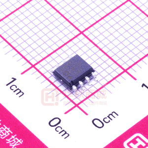

ADR431B 数据手册
Ultralow Noise XFET Voltage References with Current Sink and Source Capability ADR430/ADR431/ADR433/ADR434/ADR435/ADR439 FEATURES Low noise (0.1 Hz to 10.0 Hz): 3.5 μV p-p @ 2.5 V output No external capacitor required Low temperature coefficient A Grade: 10 ppm/°C maximum B Grade: 3 ppm/°C maximum Load regulation: 15 ppm/mA Line regulation: 20 ppm/V Wide operating range ADR430: 4.1 V to 18 V ADR431: 4.5 V to 18 V ADR433: 5.0 V to 18 V ADR434: 6.1 V to 18 V ADR435: 7.0 V to 18 V ADR439: 6.5 V to 18 V High output source and sink current: +30 mA and −20 mA Wide temperature range: −40°C to +125°C PIN CONFIGURATIONS TP 1 VIN 2 8 TP COMP TOP VIEW 6 VOUT (Not to Scale) GND 4 5 TRIM 7 ADR43x NIC 3 Figure 1. 8-Lead MSOP (RM-8) TP 1 VIN 2 8 TP COMP TOP VIEW 6 VOUT (Not to Scale) 5 TRIM GND 4 7 ADR43x NIC 3 Figure 2. 8-Lead SOIC_N (R-8) APPLICATIONS Precision data acquisition systems High resolution data converters Medical instruments Industrial process control systems Optical control circuits Precision instruments GENERAL DESCRIPTION The ADR43x series is a family of XFET® voltage references featuring low noise, high accuracy, and low temperature drift performance. Using Analog Devices, Inc., patented temperature drift curvature correction and XFET (eXtra implanted junction FET) technology, voltage change vs. temperature nonlinearity in the ADR43x is minimized. The XFET references operate at lower current (800 μA) and lower supply voltage headroom (2 V) than buried Zener references. Buried Zener references require more than 5 V headroom for operation. The ADR43x XFET references are the only low noise solutions for 5 V systems. The ADR43x family has the capability to source up to 30 mA of output current and sink up to 20 mA. It also comes with a trim terminal to adjust the output voltage over a 0.5% range without compromising performance. The ADR43x is available in 8-lead MSOP and 8-lead narrow SOIC packages. All versions are specified over the extended industrial temperature range of −40°C to +125°C. Rev. J Information furnished by Analog Devices is believed to be accurate and reliable. However, no responsibility is assumed by Analog Devices for its use, nor for any infringements of patents or other rights of third parties that may result from its use. Specifications subject to change without notice. No license is granted by implication or otherwise under any patent or patent rights of Analog Devices. Trademarks and registered trademarks are the property of their respective owners. Table 1. Selection Guide Output Voltage (V) 2.048 2.048 2.500 2.500 3.000 3.000 4.096 4.096 5.000 5.000 4.500 4.500 Temperature Coefficient (ppm/°C) 10 3 10 3 10 3 10 3 10 3 10 3 Model ADR430A ADR430B ADR431A ADR431B ADR433A ADR433B ADR434A ADR434B ADR435A ADR435B ADR439A ADR439B Accuracy (mV) ±3 ±1 ±3 ±1 ±4 ±1.5 ±5 ±1.5 ±6 ±2 ±5.5 ±2 One Technology Way, P.O. Box 9106, Norwood, MA 02062-9106, U.S.A. Tel: 781.329.4700 www.analog.com Fax: 781.461.3113 ©2003–2011 Analog Devices, Inc. All rights reserved. 04500-041 NOTES 1. NIC = NO INTERNAL CONNECTION 2. TP = TEST PIN (DO NOT CONNECT) 04500-001 NOTES 1. NIC = NO INTERNAL CONNECTION 2. TP = TEST PIN (DO NOT CONNECT) ADR430/ADR431/ADR433/ADR434/ADR435/ADR439 TABLE OF CONTENTS Features .............................................................................................. 1  Applications....................................................................................... 1  Pin Configurations ........................................................................... 1  General Description ......................................................................... 1  Revision History ............................................................................... 3  Specifications..................................................................................... 4  ADR430 Electrical Characteristics............................................. 4  ADR431 Electrical Characteristics............................................. 5  ADR433 Electrical Characteristics............................................. 6  ADR434 Electrical Characteristics............................................. 7  ADR435 Electrical Characteristics............................................. 8  ADR439 Electrical Characteristics............................................. 9  Absolute Maximum Ratings.......................................................... 10  Thermal Resistance .................................................................... 10  ESD Caution................................................................................ 10  Typical Performance Characteristics ........................................... 11  Theory of Operation ...................................................................... 16  Basic Voltage Reference Connections...................................... 16  Noise Performance ..................................................................... 16  High Frequency Noise ............................................................... 16  Turn-On Time ............................................................................ 17  Applications Information .............................................................. 18  Output Adjustment .................................................................... 18  Reference for Converters in Optical Network Control Circuits......................................................................................... 18  High Voltage Floating Current Source .................................... 18  Kelvin Connection ..................................................................... 18  Dual Polarity References ........................................................... 19  Programmable Current Source ................................................ 19  Programmable DAC Reference Voltage .................................. 20  Precision Voltage Reference for Data Converters.................. 20  Precision Boosted Output Regulator ....................................... 21  Outline Dimensions ....................................................................... 22  Ordering Guide .......................................................................... 23  Rev. J | Page 2 of 24 ADR430/ADR431/ADR433/ADR434/ADR435/ADR439 REVISION HISTORY 7/11—Rev. I to Rev. J Changes to Figure 1 and Figure 2....................................................1 Changes to Ordering Guide...........................................................23 5/11—Rev. H to Rev. I Added Endnote 1 in Table 2.............................................................4 Added Endnote 1 in Table 3.............................................................5 Added Endnote 1 in Table 4.............................................................6 Added Endnote 1 in Table 5.............................................................7 Added Endnote 1 in Table 6.............................................................8 Added Endnote 1 in Table 7.............................................................9 Deleted Negative Precision Reference Without Precision Resistors Section..............................................................................17 Deleted Figure 36; Renumbered Sequentially .............................18 2/11—Rev. G to Rev. H Updated Outline Dimensions........................................................21 Changes to Ordering Guide...........................................................22 7/10—Rev. F to Rev. G Changes to Storage Temperature Range in Table 9.......................9 6/10—Rev. E to Rev. F Updated Pin Name NC to COMP Throughout ............................1 Changes to Figure 1 and Figure 2....................................................1 Changes to Figure 30 and High Frequency Noise Section ........15 Updated Outline Dimensions........................................................21 Changes to Ordering Guide...........................................................22 1/09—Rev. D to Rev. E Added High Frequency Noise Section and Equation 3; Renumbered Sequentially ..............................................................15 Inserted Figure 31, Figure 32, and Figure 33; Renumbered Sequentially ......................................................................................16 Changes to the Ordering Guide ....................................................22 12/07—Rev. C to Rev. D Changes to Initial Accuracy and Ripple Rejection Ratio Parameters in Table 2 through Table 7...........................................3 Changes to Table 9 ............................................................................9 Changes to Theory of Operation Section ....................................15 Updated Outline Dimensions........................................................20 8/06—Rev. B to Rev. C Updated Format ................................................................. Universal Changes to Table 1 ............................................................................1 Changes to Table 3 ............................................................................4 Changes to Table 4 ............................................................................5 Changes to Table 7 ............................................................................8 Changes to Figure 26 ......................................................................14 Changes to Figure 31 ......................................................................16 Updated Outline Dimensions........................................................20 Changes to Ordering Guide...........................................................21 9/04—Rev. A to Rev. B Added New Grade.............................................................. Universal Changes to Specifications ................................................................3 Replaced Figure 3, Figure 4, Figure 5 ...........................................10 Updated Ordering Guide ...............................................................21 6/04—Rev. 0 to Rev. A Changes to Format............................................................. Universal Changes to the Ordering Guide ....................................................20 12/03—Revision 0: Initial Version Rev. J | Page 3 of 24 ADR430/ADR431/ADR433/ADR434/ADR435/ADR439 SPECIFICATIONS ADR430 ELECTRICAL CHARACTERISTICS VIN = 4.1 V to 18 V, IL = 0 mA, TA = 25°C, unless otherwise noted. Table 2. Parameter OUTPUT VOLTAGE A Grade B Grade INITIAL ACCURACY 1 A Grade B Grade TEMPERATURE COEFFICIENT A Grade B Grade LINE REGULATION LOAD REGULATION QUIESCENT CURRENT VOLTAGE NOISE VOLTAGE NOISE DENSITY TURN-ON SETTLING TIME LONG-TERM STABILITY 2 OUTPUT VOLTAGE HYSTERESIS RIPPLE REJECTION RATIO SHORT CIRCUIT TO GND SUPPLY VOLTAGE OPERATING RANGE SUPPLY VOLTAGE HEADROOM 1 2 Symbol VO Conditions Min 2.045 2.047 Typ 2.048 2.048 Max 2.051 2.049 ±3 ±0.15 ±1 ±0.05 Unit V V mV % mV % ppm/°C ppm/°C ppm/V ppm/mA ppm/mA μA μV p-p nV/√Hz μs ppm ppm dB mA V V VOERR TCVO −40°C < TA < +125°C −40°C < TA < +125°C VIN = 4.1 V to 18 V, −40°C < TA < +125°C IL = 0 mA to 10 mA, VIN = 5.0 V, −40°C < TA < +125°C IL = −10 mA to 0 mA, VIN = 5.0 V, −40°C < TA < +125°C No load, −40°C < TA < +125°C 0.1 Hz to 10.0 Hz 1 kHz CL = 0 μF 1000 hours fIN = 1 kHz 2 1 5 10 3 20 15 15 800 ∆VO/∆VIN ∆VO/∆IL ∆VO/∆IL IIN eN p-p eN tR ∆VO VO_HYS RRR ISC VIN VIN − VO 560 3.5 60 10 40 20 –70 40 4.1 2 18 Initial accuracy does not include shift due to solder heat effect. The long-term stability specification is noncumulative. The drift in subsequent 1000 hour periods is significantly lower than in the first 1000 hour period. Rev. J | Page 4 of 24 ADR430/ADR431/ADR433/ADR434/ADR435/ADR439 ADR431 ELECTRICAL CHARACTERISTICS VIN = 4.5 V to 18 V, IL = 0 mA, TA = 25°C, unless otherwise noted. Table 3. Parameter OUTPUT VOLTAGE A Grade B Grade INITIAL ACCURACY 1 A Grade B Grade TEMPERATURE COEFFICIENT A Grade B Grade LINE REGULATION LOAD REGULATION QUIESCENT CURRENT VOLTAGE NOISE VOLTAGE NOISE DENSITY TURN-ON SETTLING TIME LONG-TERM STABILITY 2 OUTPUT VOLTAGE HYSTERESIS RIPPLE REJECTION RATIO SHORT CIRCUIT TO GND SUPPLY VOLTAGE OPERATING RANGE SUPPLY VOLTAGE HEADROOM 1 2 Symbol VO Conditions Min 2.497 2.499 Typ 2.500 2.500 Max 2.503 2.501 ±3 ±0.12 ±1 ±0.04 Unit V V mV % mV % ppm/°C ppm/°C ppm/V ppm/mA ppm/mA μA μV p-p nV/√Hz μs ppm ppm dB mA V V VOERR TCVO −40°C < TA < +125°C −40°C < TA < +125°C VIN = 4.5 V to 18 V, −40°C < TA < +125°C IL = 0 mA to 10 mA, VIN = 5.0 V, −40°C < TA < +125°C IL = −10 mA to 0 mA, VIN = 5.0 V, −40°C < TA < +125°C No load, −40°C < TA < +125°C 0.1 Hz to 10.0 Hz 1 kHz CL = 0 μF 1000 hours fIN = 1 kHz 2 1 5 10 3 20 15 15 800 ∆VO/∆VIN ∆VO/∆IL ∆VO/∆IL IIN eN p-p eN tR ∆VO VO_HYS RRR ISC VIN VIN − VO 580 3.5 80 10 40 20 −70 40 4.5 2 18 Initial accuracy does not include shift due to solder heat effect. The long-term stability specification is noncumulative. The drift in subsequent 1000 hour periods is significantly lower than in the first 1000 hour period. Rev. J | Page 5 of 24 ADR430/ADR431/ADR433/ADR434/ADR435/ADR439 ADR433 ELECTRICAL CHARACTERISTICS VIN = 5.0 V to 18 V, IL = 0 mA, TA = 25°C, unless otherwise noted. Table 4. Parameter OUTPUT VOLTAGE A Grade B Grade INITIAL ACCURACY 1 A Grade B Grade TEMPERATURE COEFFICIENT A Grade B Grade LINE REGULATION LOAD REGULATION QUIESCENT CURRENT VOLTAGE NOISE VOLTAGE NOISE DENSITY TURN-ON SETTLING TIME LONG-TERM STABILITY 2 OUTPUT VOLTAGE HYSTERESIS RIPPLE REJECTION RATIO SHORT CIRCUIT TO GND SUPPLY VOLTAGE OPERATING RANGE SUPPLY VOLTAGE HEADROOM 1 2 Symbol VO Conditions Min 2.996 2.9985 Typ 3.000 3.000 Max 3.004 3.0015 ±4 ±0.13 ±1.5 ±0.05 Unit V V mV % mV % ppm/°C ppm/°C ppm/V ppm/mA ppm/mA μA μV p-p nV/√Hz μs ppm ppm dB mA V V VOERR TCVO −40°C < TA < +125°C −40°C < TA < +125°C VIN = 5 V to 18 V, −40°C < TA < +125°C IL = 0 mA to 10 mA, VIN = 6 V, −40°C < TA < +125°C IL = −10 mA to 0 mA, VIN = 6 V, −40°C < TA < +125°C No load, −40°C < TA < +125°C 0.1 Hz to 10.0 Hz 1 kHz CL = 0 μF 1000 hours fIN = 1 kHz 2 1 5 10 3 20 15 15 800 ∆VO/∆VIN ∆VO/∆IL ∆VO/∆IL IIN eN p-p eN tR ∆VO VO_HYS RRR ISC VIN VIN − VO 590 3.75 90 10 40 20 −70 40 5.0 2 18 Initial accuracy does not include shift due to solder heat effect. The long-term stability specification is noncumulative. The drift in subsequent 1000 hour periods is significantly lower than in the first 1000 hour period. Rev. J | Page 6 of 24 ADR430/ADR431/ADR433/ADR434/ADR435/ADR439 ADR434 ELECTRICAL CHARACTERISTICS VIN = 6.1 V to 18 V, IL = 0 mA, TA = 25°C, unless otherwise noted. Table 5. Parameter OUTPUT VOLTAGE A Grade B Grade INITIAL ACCURACY 1 A Grade B Grade TEMPERATURE COEFFICIENT A Grade B Grade LINE REGULATION LOAD REGULATION QUIESCENT CURRENT VOLTAGE NOISE VOLTAGE NOISE DENSITY TURN-ON SETTLING TIME LONG-TERM STABILITY 2 OUTPUT VOLTAGE HYSTERESIS RIPPLE REJECTION RATIO SHORT CIRCUIT TO GND SUPPLY VOLTAGE OPERATING RANGE SUPPLY VOLTAGE HEADROOM 1 2 Symbol VO Conditions Min 4.091 4.0945 Typ 4.096 4.096 Max 4.101 4.0975 ±5 ±0.12 ±1.5 ±0.04 Unit V V mV % mV % ppm/°C ppm/°C ppm/V ppm/mA ppm/mA μA μV p-p nV/√Hz μs ppm ppm dB mA V V VOERR TCVO −40°C < TA < +125°C −40°C < TA < +125°C VIN = 6.1 V to 18 V, −40°C < TA < +125°C IL = 0 mA to 10 mA, VIN = 7 V, −40°C < TA < +125°C IL = −10 mA to 0 mA, VIN = 7 V, −40°C < TA < +125°C No load, −40°C < TA < +125°C 0.1 Hz to 10.0 Hz 1 kHz CL = 0 μF 1000 hours fIN = 1 kHz 2 1 5 10 3 20 15 15 800 ∆VO/∆VIN ∆VO/∆IL ∆VO/∆IL IIN eN p-p eN tR ∆VO VO_HYS RRR ISC VIN VIN − VO 595 6.25 100 10 40 20 −70 40 6.1 2 18 Initial accuracy does not include shift due to solder heat effect. The long-term stability specification is noncumulative. The drift in subsequent 1000 hour periods is significantly lower than in the first 1000 hour period. Rev. J | Page 7 of 24 ADR430/ADR431/ADR433/ADR434/ADR435/ADR439 ADR435 ELECTRICAL CHARACTERISTICS VIN = 7.0 V to 18 V, IL = 0 mA, TA = 25°C, unless otherwise noted. Table 6. Parameter OUTPUT VOLTAGE A Grade B Grade INITIAL ACCURACY 1 A Grade B Grade TEMPERATURE COEFFICIENT A Grade B Grade LINE REGULATION LOAD REGULATION QUIESCENT CURRENT VOLTAGE NOISE VOLTAGE NOISE DENSITY TURN-ON SETTLING TIME LONG-TERM STABILITY 2 OUTPUT VOLTAGE HYSTERESIS RIPPLE REJECTION RATIO SHORT CIRCUIT TO GND SUPPLY VOLTAGE OPERATING RANGE SUPPLY VOLTAGE HEADROOM 1 2 Symbol VO Conditions Min 4.994 4.998 Typ 5.000 5.000 Max 5.006 5.002 ±6 ±0.12 ±2 ±0.04 Unit V V mV % mV % ppm/°C ppm/°C ppm/V ppm/mA ppm/mA μA μV p-p nV/√Hz μs ppm ppm dB mA V V VOERR TCVO −40°C < TA < +125°C −40°C < TA < +125°C VIN = 7 V to 18 V, −40°C < TA < +125°C IL = 0 mA to 10 mA, VIN = 8 V, −40°C < TA < +125°C IL = −10 mA to 0 mA, VIN = 8 V, −40°C < TA < +125°C No load, −40°C < TA < +125°C 0.1 Hz to 10 Hz 1 kHz CL = 0 μF 1000 hours fIN = 1 kHz 7.0 2 2 1 5 10 3 20 15 15 800 ∆VO/∆VIN ∆VO/∆IL ∆VO/∆IL IIN eN p-p eN tR ∆VO VO_HYS RRR ISC VIN VIN − VO 620 8 115 10 40 20 −70 40 18 Initial accuracy does not include shift due to solder heat effect. The long-term stability specification is noncumulative. The drift in subsequent 1000 hour periods is significantly lower than in the first 1000 hour period. Rev. J | Page 8 of 24 ADR430/ADR431/ADR433/ADR434/ADR435/ADR439 ADR439 ELECTRICAL CHARACTERISTICS VIN = 6.5 V to 18 V, IL = 0 mV, TA = 25°C, unless otherwise noted. Table 7. Parameter OUTPUT VOLTAGE A Grade B Grade INITIAL ACCURACY 1 A Grade B Grade TEMPERATURE COEFFICIENT A Grade B Grade LINE REGULATION LOAD REGULATION QUIESCENT CURRENT VOLTAGE NOISE VOLTAGE NOISE DENSITY TURN-ON SETTLING TIME LONG-TERM STABILITY 2 OUTPUT VOLTAGE HYSTERESIS RIPPLE REJECTION RATIO SHORT CIRCUIT TO GND SUPPLY VOLTAGE OPERATING RANGE SUPPLY VOLTAGE HEADROOM 1 2 Symbol VO Conditions Min 4.4946 4.498 Typ 4.500 4.500 Max 4.5054 4.502 ±5.5 ±0.12 ±2 ±0.04 Unit V V mV % mV % ppm/°C ppm/°C ppm/V ppm/mA ppm/mA μA μV p-p nV/√Hz μs ppm ppm dB mA V V VOERR TCVO −40°C < TA < +125°C −40°C < TA < +125°C VIN = 6.5 V to 18 V, −40°C < TA < +125°C IL = 0 mA to 10 mA, VIN = 6.5 V, −40°C < TA < +125°C IL = −10 mA to 0 mA, VIN = 6.5 V, −40°C < TA < +125°C No load, −40°C < TA < +125°C 0.1 Hz to 10.0 Hz 1 kHz CL = 0 μF 1000 hours fIN = 1 kHz 6.5 2 2 1 5 10 3 20 15 15 800 ∆VO/∆VIN ∆VO/∆IL ∆VO/∆IL IIN eN p-p eN tR ∆VO VO_HYS RRR ISC VIN VIN − VO 600 7.5 110 10 40 20 −70 40 18 Initial accuracy does not include shift due to solder heat effect. The long-term stability specification is noncumulative. The drift in subsequent 1000 hour periods is significantly lower than in the first 1000 hour period. Rev. J | Page 9 of 24 ADR430/ADR431/ADR433/ADR434/ADR435/ADR439 ABSOLUTE MAXIMUM RATINGS TA = 25°C, unless otherwise noted. Table 8. Parameter Supply Voltage Output Short-Circuit Duration to GND Storage Temperature Range Operating Temperature Range Junction Temperature Range Lead Temperature, Soldering (60 sec) Rating 20 V Indefinite −65°C to +150°C −40°C to +125°C −65°C to +150°C 300°C THERMAL RESISTANCE θJA is specified for the worst-case conditions, that is, a device soldered in a circuit board for surface-mount packages. Table 9. Thermal Resistance Package Type 8-Lead SOIC_N (R) 8-Lead MSOP (RM) θJA 130 142 θJC 43 44 Unit °C/W °C/W Stresses above those listed under Absolute Maximum Ratings may cause permanent damage to the device. This is a stress rating only; functional operation of the device at these or any other conditions above those indicated in the operational section of this specification is not implied. Exposure to absolute maximum rating conditions for extended periods may affect device reliability. ESD CAUTION Rev. J | Page 10 of 24 ADR430/ADR431/ADR433/ADR434/ADR435/ADR439 TYPICAL PERFORMANCE CHARACTERISTICS Default conditions: ±5 V, CL = 5 pF, G = 2, RG = RF = 1 kΩ, RL = 2 kΩ, VO = 2 V p-p, f = 1 MHz, TA = 25°C, unless otherwise noted. 0.8 2.5009 2.5007 2.5005 2.5003 2.5001 2.4999 2.4997 2.4995 –40 0.7 +125°C SUPPLY CURRENT (mA) OUTPUT VOLTAGE (V) 0.6 +25°C –40°C 0.5 0.4 04500-015 TEMPERATURE (°C) INPUT VOLTAGE (V) Figure 3. ADR431 Output Voltage vs. Temperature Figure 6. ADR435 Supply Current vs. Input Voltage 4.0980 700 4.0975 650 SUPPLY CURRENT (µA) OUTPUT VOLTAGE (V) 4.0970 600 4.0965 550 4.0960 500 4.0955 450 04500-016 TEMPERATURE (°C) TEMPERATURE (°C) Figure 4. ADR434 Output Voltage vs. Temperature Figure 7. ADR435 Supply Current vs. Temperature 5.0025 5.0020 5.0015 5.0010 5.0005 5.0000 4.9995 4.9990 –40 SUPPLY CURRENT (mA) 0.60 0.58 0.56 +125°C OUTPUT VOLTAGE (V) 0.54 0.52 0.50 0.48 0.46 0.44 0.42 0.40 –40°C +25°C 04500-017 TEMPERATURE (°C) INPUT VOLTAGE (V) Figure 5. ADR435 Output Voltage vs. Temperature Figure 8. ADR431 Supply Current vs. Input Voltage Rev. J | Page 11 of 24 04500-020 –25 –10 5 20 35 50 65 80 95 110 125 6 8 10 12 14 16 18 04500-019 4.0950 –40 –25 –10 5 20 35 50 65 80 95 110 125 400 –40 –25 –10 5 20 35 50 65 80 95 110 125 04500-018 –25 –10 5 20 35 50 65 80 95 110 125 0.3 4 6 8 10 12 14 16 ADR430/ADR431/ADR433/ADR434/ADR435/ADR439 610 580 2.5 SUPPLY CURRENT (µA) 550 520 490 460 430 400 –40 DIFFERENTIAL VOLTAGE (V) 2.0 –40°C 1.5 +25°C 1.0 +125°C 0.5 04500-021 TEMPERATURE (°C) LOAD CURRENT (mA) Figure 9. ADR431 Supply Current vs. Temperature 15 1.9 Figure 12. ADR431 Minimum Input/Output Differential Voltage vs. Load Current NO LOAD 1.8 IL = 0mA to 10mA LOAD REGULATION (ppm/mA) 12 MINIMUM HEADROOM (V) 1.7 1.6 1.5 1.4 1.3 1.2 1.1 9 6 3 04500-022 TEMPERATURE (°C) TEMPERATURE (°C) Figure 10. ADR431 Load Regulation vs. Temperature 15 Figure 13. ADR431 Minimum Headroom vs. Temperature 2.5 IL = 0mA to 10mA LOAD REGULATION (ppm/mA) DIFFERENTIAL VOLTAGE (V) 12 2.0 –40°C 1.5 +25°C 1.0 +125°C 0.5 9 6 3 04500-023 TEMPERATURE (°C) LOAD CURRENT (mA) Figure 11. ADR435 Load Regulation vs. Temperature Figure 14. ADR435 Minimum Input/Output Differential Voltage vs. Load Current Rev. J | Page 12 of 24 04500-026 0 –40 –25 –10 5 20 35 50 65 80 95 110 125 0 –10 –5 0 5 10 04500-025 0 –40 –25 –10 5 20 35 50 65 80 95 110 125 1.0 –40 –25 –10 5 20 35 50 65 80 95 110 125 04500-024 –25 –10 5 20 35 50 65 80 95 110 125 0 –10 –5 0 5 10 ADR430/ADR431/ADR433/ADR434/ADR435/ADR439 1.9 NO LOAD 1.7 MINIMUM HEADROOM (V) CL = 0.01µF NO INPUT CAPACITOR VO = 1V/DIV 1.5 1.3 1.1 VIN = 2V/DIV 04500-027 TEMPERATURE (°C) Figure 15. ADR435 Minimum Headroom vs. Temperature Figure 18. ADR431 Turn-On Response, 0.01 μF Load Capacitor 20 VIN = 7V TO 18V 16 LINE REGULATION (ppm/V) VO = 1V/DIV CIN = 0.01µF NO LOAD 12 8 4 0 VIN = 2V/DIV TIME = 4µs/DIV TEMPERATURE (°C) 04500-028 Figure 16. ADR435 Line Regulation vs. Temperature Figure 19. ADR431 Turn-Off Response CIN = 0.01µF NO LOAD VO = 1V/DIV BYPASS CAPACITOR = 0µF LINE INTERRUPTION VIN = 500mV/DIV VO = 50mV/DIV VIN = 2V/DIV 04500-030 Figure 17. ADR431 Turn-On Response Figure 20. ADR431 Line Transient Response Rev. J | Page 13 of 24 04500-033 TIME = 4µs/DIV TIME = 100µs/DIV 04500-032 –4 –40 –25 –10 5 20 35 50 65 80 95 110 125 04500-031 0.9 –40 –25 –10 5 20 35 50 65 80 95 110 125 TIME = 4µs/DIV ADR430/ADR431/ADR433/ADR434/ADR435/ADR439 BYPASS CAPACITOR = 0.1µF LINE INTERRUPTION VIN = 500mV/DIV VO = 50mV/DIV 2µV/DIV 04500-034 TIME = 1s/DIV Figure 21. ADR431 Line Transient Response, 0.1 μF Bypass Capacitor Figure 24. ADR435 0.1 Hz to 10.0 Hz Voltage Noise 1µV/DIV 50µV/DIV 04500-035 Figure 22. ADR431 0.1 Hz to 10.0 Hz Voltage Noise Figure 25. ADR435 10 Hz to 10 kHz Voltage Noise 14 12 10 8 6 4 2 0 –110 –90 50µV/DIV 04500-036 DEVIATION (PPM) Figure 23. ADR431 10 Hz to 10 kHz Voltage Noise Figure 26. ADR431 Typical Hysteresis Rev. J | Page 14 of 24 04500-029 TIME = 1s/DIV NUMBER OF PARTS –70 –50 –30 –10 10 30 50 70 90 04500-038 TIME = 1s/DIV TIME = 1s/DIV 04500-037 TIME = 100µs/DIV 110 ADR430/ADR431/ADR433/ADR434/ADR435/ADR439 50 45 40 OUTPUT IMPEDANCE (Ω) 35 30 25 20 15 10 5 0 100 1k 10k FREQUENCY (Hz) ADR430 ADR435 10 –10 –30 –50 –70 –90 –110 –130 –150 FREQUENCY (Hz) 04500-040 04500-039 ADR433 100k RIPPLE REJECTION (dB) 10 100 1k 10k 100k 1M Figure 27. Output Impedance vs. Frequency Figure 28. Ripple Rejection Rev. J | Page 15 of 24 ADR430/ADR431/ADR433/ADR434/ADR435/ADR439 THEORY OF OPERATION The ADR43x series of references uses a reference generation technique known as XFET (eXtra implanted junction FET). This technique yields a reference with low supply current, good thermal hysteresis, and exceptionally low noise. The core of the XFET reference consists of two junction field-effect transistors (JFETs), one of which has an extra channel implant to raise its pinch-off voltage. By running the two JFETs at the same drain current, the difference in pinch-off voltage can be amplified and used to form a highly stable voltage reference. The intrinsic reference voltage is around 0.5 V with a negative temperature coefficient of about −120 ppm/°C. This slope is essentially constant to the dielectric constant of silicon and can be compensated closely by adding a correction term generated in the same fashion as the proportional-to-temperature (PTAT) term used to compensate band gap references. The primary advantage of an XFET reference is its correction term, which is ~30 times lower and requires less correction than that of a band gap reference. Because most of the noise of a band gap reference comes from the temperature compensation circuitry, the XFET results in much lower noise. Figure 29 shows the basic topology of the ADR43x series. The temperature correction term is provided by a current source with a value designed to be proportional to absolute temperature. The general equation is VOUT = G (ΔVP – R1 × IPTAT) (1) where: G is the gain of the reciprocal of the divider ratio. ΔVP is the difference in pinch-off voltage between the two JFETs. IPTAT is the positive temperature coefficient correction current. ADR43x devices are created by on-chip adjustment of R2 and R3 to achieve 2.048 V or 2.500 V, respectively, at the reference output. I1 IPTAT I1 VIN The ADR43x family of references is guaranteed to deliver load currents to 10 mA with an input voltage that ranges from 4.1 V to 18 V. When these devices are used in applications at higher currents, use the following equation to account for the temperature effects due to the power dissipation increases: TJ = PD × θJA + TA (2) where: TJ and TA are the junction and ambient temperatures, respectively. PD is the device power dissipation. θJA is the device package thermal resistance. BASIC VOLTAGE REFERENCE CONNECTIONS Voltage references, in general, require a bypass capacitor connected from VOUT to GND. The circuit in Figure 30 illustrates the basic configuration for the ADR43x family of references. Other than a 0.1 μF capacitor at the output to help improve noise suppression, a large output capacitor at the output is not required for circuit stability. TP VIN 10µF + 1 2 8 TP 0.1µF NC GND COMP VOUT TOP VIEW 6 (Not to Scale) 4 5 TRIM 7 3 ADR43x 0.1µF Figure 30. Basic Voltage Reference Configuration NOISE PERFORMANCE The noise generated by the ADR43x family of references is typically less than 3.75 μV p-p over the 0.1 Hz to 10.0 Hz band for ADR430, ADR431, and ADR433. Figure 22 shows the 0.1 Hz to 10.0 Hz noise of the ADR431, which is only 3.5 μV p-p. The noise measurement is made with a band-pass filter made of a 2-pole high-pass filter with a corner frequency at 0.1 Hz and a 2-pole low-pass filter with a corner frequency at 10.0 Hz. ADR43x VOUT R2 HIGH FREQUENCY NOISE The total noise generated by the ADR43x family of references is composed of the reference noise and the op amp noise. Figure 31 shows the wideband noise from 10 Hz to 25 kHz. An internal node of the op amp is brought out on Pin 7, and by overcompensating the op amp, the overall noise can be reduced. This is understood by considering that in a closed-loop configuration, the effective output impedance of an op amp is * ∆VP R1 R3 *EXTRA CHANNEL IMPLANT VOUT = G(∆VP – R1 × IPTAT) GND Figure 29. Simplified Schematic Device Power Dissipation Considerations 04500-002 RO = rO 1 + AVO β 04500-044 NOTES: 1. NC = NO CONNECT 2. TP = TEST PIN (DO NOT CONNECT) (3) where: RO is the apparent output impedance. rO is the output resistance of the op amp. AVO is the open-loop gain at the frequency of interest. β is the feedback factor. Rev. J | Page 16 of 24 ADR430/ADR431/ADR433/ADR434/ADR435/ADR439 Equation 3 shows that the apparent output impedance is reduced by approximately the excess loop gain; therefore, as the frequency increases, the excess loop gain decreases, and the apparent output impedance increases. A passive element whose impedance increases as its frequency increases is an inductor. When a capacitor is added to the output of an op amp or a reference, it forms a tuned circuit that resonates at a certain frequency and results in gain peaking. This can be observed by using a model of a semiperfect op amp with a single-pole response and some pure resistance in series with the output. Changing capacitive loads results in peaking at different frequencies. For most normal op amp applications with low capacitive loading (
