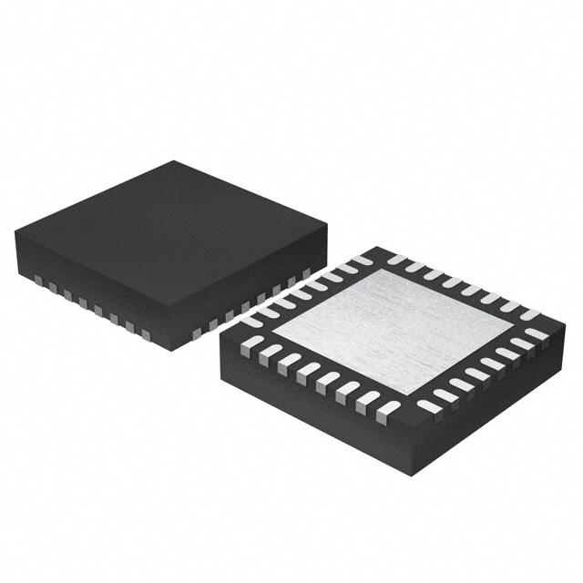

Data Sheet Integrated, Precision Battery Sensor for Automotive Systems ADuCM330WFS/ADuCM331WFS FEATURES High precision ADCs Dual-channel, simultaneous sampling IADC 20-bit Σ-Δ (minimizes range switching) VADC/TADC 20-bit Σ-Δ Programmable ADC conversion rate from 4 Hz to 8 kHz On-chip ±5 ppm/°C voltage reference Current channel Fully differential, buffered input Programmable gain (from 4 to 512) ADC absolute input range: −200 mV to +300 mV Digital comparator with current accumulator feature Voltage channel Buffered, on-chip attenuator for 12 V battery input Temperature channel External and on-chip temperature sensor options Microcontroller ARM Cortex-M3 32-bit processor 16.384 MHz precision oscillator with 1% accuracy (high precision) Serial wire debug (SWD) port supporting code download and debug Automotive qualified integrated LIN transceiver LIN 2.2A-compatible slave, 100 kbaud fast download option SAE J2602-compatible slave Low electromagnetic emissions High electromagnetic immunity Memory 96 kB programmable Flash/EE memory (ADuCM330WFS), ECC 128 kB programmable Flash/EE memory (ADuCM331WFS), ECC 10 kB SRAM, ECC 4 kB data Flash/EE memory, ECC 10,000 cycle Flash/EE endurance 20 year Flash/EE retention In circuit download via SWD and LIN On-chip peripherals SPI GPIO port General-purpose timer Wake-up timer Watchdog timer On-chip, power-on reset Power Operates directly from 12 V battery supply Power consumption, 8 mA typical (16 MHz) at TA = −40°C to +115°C Low power monitor mode Package and temperature range 6 mm × 6 mm, 32-lead LFCSP Fully specified for −40°C to +115°C operation; additional specifications for 115°C to 125°C AEC-Q100 qualified for automotive applications Developed for use in ISO 26262 applications for ASIL Capability B APPLICATIONS Battery sensing and management for automotive and light mobility vehicles Lead acid battery measurement for power supplies in industrial and medical domains Rev. D Document Feedback Information furnished by Analog Devices is believed to be accurate and reliable. However, no responsibility is assumed by Analog Devices for its use, nor for any infringements of patents or other rights of third parties that may result from its use. Specifications subject to change without notice. No license is granted by implication or otherwise under any patent or patent rights of Analog Devices. Trademarks and registered trademarks are the property of their respective owners. One Technology Way, P.O. Box 9106, Norwood, MA 02062-9106, U.S.A. Tel: 781.329.4700 ©2018–2020 Analog Devices, Inc. All rights reserved. Technical Support www.analog.com ADuCM330WFS/ADuCM331WFS Data Sheet TABLE OF CONTENTS Features .............................................................................................. 1 Terminology .................................................................................... 15 Applications ....................................................................................... 1 Applications Information .............................................................. 16 Revision History ............................................................................... 2 Design Guidelines ...................................................................... 16 Functional Block Diagram .............................................................. 3 Power and Ground Recommendations ................................... 16 General Description ......................................................................... 4 Exposed Pad Thermal Recommendations .............................. 16 Specifications..................................................................................... 5 General Recommendations....................................................... 16 Absolute Maximum Ratings .......................................................... 12 Outline Dimensions ....................................................................... 17 Thermal Resistance .................................................................... 12 Ordering Guide .......................................................................... 17 ESD Caution ................................................................................ 12 Automotive Products ................................................................. 17 Pin Configuration and Function Descriptions ........................... 13 REVISION HISTORY 4/2020—Rev. C to Rev. D Changes to Table 1 ............................................................................ 6 Changes to Figure 2 ........................................................................ 13 Changes to Table 4 .......................................................................... 14 8/2019—Rev. B to Rev. C Change to Features Section ............................................................. 1 Changes to Figure 1 .......................................................................... 3 Changes to General Description Section ...................................... 4 Changes to Table 1 ............................................................................ 5 Changes to Figure 2 and Table 4 ................................................... 13 Changes to General Recommendations Section ........................ 16 2/2019—Rev. 0 to Rev. A Added ADuCM330WFS ................................................... Universal Changes to Features Section ............................................................1 Changes to Figure 1 ...........................................................................3 Changes to General Description Section .......................................4 Changes to Flash/EE Memory Parameter, Table 1 ........................8 Added Note 14, Table 1; Renumbered Sequentially .................. 11 Changes to Thermal Resistance Section and Table 3 ................ 12 Changes to Ordering Guide .......................................................... 17 12/2018—Revision 0: Initial Version 6/2019—Rev. A to Rev. B Change to Features Section ............................................................. 1 Changes to General Description Section ...................................... 4 Changes to Table 1 .......................................................................... 10 Changes to Ordering Guide .......................................................... 17 Rev. D | Page 2 of 17 Data Sheet ADuCM330WFS/ADuCM331WFS FUNCTIONAL BLOCK DIAGRAM SWCLK SWDIO PRECISION ANALOG ACQUISITION IIN+ PGA ADuCM330WFS/ADuCM331WFS 20-BIT ADC BUF IIN– FLASH MEMORY 96kB (ADuCM330WFS) 128kB (ADuCM331WFS) LDO POR VBAT RESET 10kB SRAM, 4kB DATA Figure 1. Rev. D | Page 3 of 17 LIN 17188-001 GPIO0/CS/LIN_RX GPIO PORT SPI PORT LIN GPIO1/SCLK/LIN_TX GPIO2/MISO GPIO3/IRQ0/MOSI/LC_TX/LIN_TX GPIO5/LC_TX/LIN_TX GENERAL-PURPOSE TIMER WATCHDOG TIMER WAKE-UP TIMER VREF VSS IO_VSS DGND PRECISION REFERENCE AGND DVDD18 33VDD TEMPERATURE SENSOR 16MHz PRECISION OSCILLATOR 32kHz LOW POWER OSCILLATOR ARM CORTEX-M3 PROCESSOR 20-BIT ADC BUF AVDD18 GND_SW MUX VDD VTEMP DIGITAL COMPARATOR GPIO4/IRQ1/LC_RX/ECLKIN/LIN_RX RESULT ACCUMULATOR ADuCM330WFS/ADuCM331WFS Data Sheet GENERAL DESCRIPTION The ADuCM330WFS/ADuCM331WFS are fully integrated, 8 kHz data acquisition systems that incorporate dual, high performance, multichannel, Σ-Δ analog-to-digital converters (ADCs), a 32-bit ARM® Cortex™-M3 processor, and flash. The ADuCM330WFS has 96 kB Flash/EE memory, and the ADuCM331WFS has 128 kB Flash/EE memory. Both devices have 4 kB data flash. Error correction code (ECC) is available on all flash and SRAM memories. The ADuCM330WFS/ADuCM331WFS are complete system solutions for battery monitoring in 12 V automotive applications. The ADuCM330WFS/ADuCM331WFS integrate all features required to precisely and intelligently monitor, process, and diagnose 12 V battery parameters including battery current, voltage, and temperature over a wide range of operating conditions. Minimizing external system components, the devices are powered directly from a 12 V battery. On-chip, low dropout (LDO) regulators generate the supply voltage for two integrated Σ-Δ ADCs. The ADCs precisely measure battery current, voltage, and temperature to characterize the state of the health and the charge of the car battery. The devices operate from an on-chip, 16.384 MHz high frequency oscillator that supplies the system clock that is routed through a programmable clock divider, from which the core clock operating frequency is generated. The devices also contain a 32.768 kHz oscillator for low power operation. The analog subsystem consists of an ADC with a programmable gain amplifier (PGA) that allows the monitoring of various current and voltage ranges. The analog subsystem also includes an on-chip precision reference. The ADuCM330WFS/ADuCM331WFS integrate a range of on-chip peripherals that can be configured under core software control as required in the application. These peripherals include a serial port interface (SPI) serial input/output communication controller, six general-purpose input/output (GPIO) pins, one general-purpose timer, a wake-up timer, and a watchdog timer. See the ADuCM330WFS/ADuCM331WFS Hardware Reference Manual for more information. The ADuCM330WFS/ADuCM331WFS are designed to operate in battery-powered applications where low power operation is critical. The microcontroller core can be configured in normal operating mode, resulting in an overall system current consumption of 18.5 mA when all peripherals are active. The devices can also be configured in a number of low power operating modes under direct program control, consuming 6.0 V VLIN_CNT = (receiver threshold of recessive to dominant bus edge (VTH_DOM) + receiver threshold of dominant to recessive bus edge (VTH_REC))/2, VDD > 6.0 V VHYS = VTH_REC − VTH_DOM −1 0.6 × VDD 0.475 × VDD V 0.5 × VDD 0.525 × VDD V 0.175 × VDD V 1.2 V V 2 V V V V VDD = 6.0 V 0.6 VDD = 19 V 0.8 0.8 × VDD 0 Ground Shift1, 23 0 Slave Termination Resistance (RSLAVE) Voltage Drop at the Serial Diode (VSERIAL_DIODE)1 20 30 0.115 × VDD 0.115 × VDD 47 0.4 0.7 1 Rev. D | Page 9 of 17 V 30 kΩ V ADuCM330WFS/ADuCM331WFS Parameter LIN AC PARAMETERS1 Duty Cycle 1 (D1) Duty Cycle 2 (D2) Duty Cycle 3 (D3)23 Duty Cycle 4 (D4)23 Propagation Delay of Receiver (tRX_PD)23 Symmetry of Receiver Propagation Delay Rising Edge (tRX_SYM)23 POWER REQUIREMENTS Power Supply Voltages VDD (Pin 26) DVDD33 (Pin 21) AVDD18 (Pin 19) DVDD18 (Pin 22) POWER CONSUMPTION Supply Current (IDD) Processor, Normal Mode 24 IDD Processor, Powered Down IDD LIN IDD Current Channel ADC (IADC) Data Sheet Test Conditions/Comments Bus load conditions (CBUS||RBUS): 1 nF||1 kΩ or 6.8 nF||660 Ω or 10 nF||500 Ω Threshold recessive maximum (THREC(MAX)) = 0.744 × VBAT, threshold dominant maximum (THDOM(MAX)) = 0.581 × VBAT, supply voltage at transceiver (VSUP) = 6.0 V to 19 V, tBIT = 50 µs, D1 = tBUS_REC(MIN)/(2 × tBIT) Threshold recessive minimum (THREC(MIN)) = 0.284 × VBAT, threshold dominant minimum (THDOM(MIN)) = 0.422 × VBAT, VSUP = 6.0 V to 19 V, tBIT = 50 µs, D2 = tBUS_REC(MAX)/(2 × tBIT) THREC(MAX) = 0.778 × VBAT, THDOM(MAX) = 0.616 × VBAT, VDD = 6.0 V to 19 V, tBIT = 96 µs, D3 = tBUS_REC(MIN)/(2 × tBIT) THREC(MIN) = 0.389 × VBAT, THDOM(MIN) = 0.251 × VBAT, VDD = 6.0 V to 19 V, tBIT = 96 µs, D4 = tBUS_REC(MAX)/(2 × tBIT) With respect to falling edge (tRX_SYM = propagation delay rising edge (tRX_PDR) − propagation delay falling edge (tRX_PDF)) TA = −40°C to +115°C Min Typ Max TA = +115°C to +125°C 1 Min Typ Max Unit 0.396 0.581 0.417 0.590 −2 3.6 3.2 1.83 1.83 Clock Divider Setting 0 (CD0) (peripheral clock (PCLK) = 16 MHz), 16 MHz 1% mode, ADCs off, reference buffer off, executing code from program flash Clock Divider Setting 1 (CD1) (PCLK = 8 MHz), 16 MHz 1% mode, ADCs off, reference buffer off, executing code from program flash CD0 (PCLK = 16 MHz), 16 MHz 1% mode, ADCs on, reference buffer on, executing code from program flash Precision oscillator off, ADC off, external LIN master pull-up resistor present, measured with wake-up and watchdog timers clocked from low power oscillator, maximum value is at 105°C, and VDD = 18 V 6 µs +2 µs 3.35 1.88 1.88 19 3.5 1.93 1.93 3.3 1.88 1.88 V V V V 8 17 9 mA 7 mA 10 mA 6 9.5 18.5 55 100 µA Gain = 4, 8, or 16 500 700 µA µA Gain = 32 or 64 Low power mode, gain = 64 800 350 µA µA Rev. D | Page 10 of 17 Data Sheet Parameter IDD ADC Temperature and Voltage Channel 1 (ADC1) Voltage ADC (VADC) IDD Internal Reference (1.2 V) IDD High Frequency Oscillator ADuCM330WFS/ADuCM331WFS Test Conditions/Comments TA = −40°C to +115°C Min Typ Max 550 Reduction from 1% to 3% mode TA = +115°C to +125°C 1 Min Typ Max Unit µA 150 µA 50 µA Guaranteed by design, but not production tested. Valid for PGA current ADC gain settings of 4, 8, 16, 32, and 64. 3 These specifications include temperature drift. 4 A system calibration removes this error at a given temperature (and at a given gain for the current channel). 5 The offset error drift is included in the offset error. This typical specification is an indicator of the offset error due to temperature drift. This typical value is the mean of the temperature drift characterization data distribution. 6 Includes internal reference temperature drift. 7 The gain drift is included in the total gain error. This parameter is an indicator of the gain error due to the temperature drift in the ADC. The typical value of this parameter is the mean of the temperature drift characterization data distribution. 8 For data rates of 4 kHz and 8 kHz with a PGA gain = 32 or greater, allow 10 ms settling time after ADC Current Channel 0 (ADC0) wakes up from power-down mode. 9 Voltage channel specifications include resistive attenuator input stage, unless otherwise stated. 10 RMS noise is referred to voltage attenuator input. For example, at an ADC data output frequency (fADC) = 1 kHz, the typical rms noise at the ADC input is 7.5 µV. Scaling by the attenuator (1:24) yields these input referred noise figures. 11 Valid after an initial self calibration. 12 It is possible to extend the ADC input range by up to 10% by modifying the factory set value of the gain calibration register or using system calibration. This approach can also be used to reduce the ADC input range (LSB size). 13 Valid for a differential input less than 10 mV. 14 The reference voltage, VREF, for the ADC is provided by the signal pair, AVDD18 and GND_SW. 15 The absolute value of the voltage of VTEMP and GND_SW must be 100 mV (minimum) for accurate operation of the temperature ADC (TADC). 16 Measured using the box method. 17 The long-term stability specification is accelerated and noncumulative. The drift in subsequent 1000 hour periods is significantly lower than in the first 1000 hour period. 18 Die temperature. 19 Valid after an initial self gain calibration. 20 Endurance is qualified to 10,000 cycles, as per JEDEC Standard 22 Method A117 and measured at −40°C, +25°C, and +115°C. Typical endurance at 25°C is 100,000 cycles. 21 Data retention lifetime equivalent at junction temperature (TJ) = 85°C, as per JEDEC Standard 22 Method A117. Data retention lifetime derates with junction temperature. 22 Measured with LIN communication active. 23 Not production tested but are supported by LIN compliance testing. 24 Typical additional supply current consumed during Flash/EE memory programming is 3 mA, and typical additional supply current consumed during erase cycles is 1 mA. 1 2 Rev. D | Page 11 of 17 ADuCM330WFS/ADuCM331WFS Data Sheet ABSOLUTE MAXIMUM RATINGS The ADuCM330WFS/ADuCM331WFS operate directly from the 12 V battery supply and is fully specified over the −40°C to +115°C temperature range, unless otherwise noted. Table 2. Parameter AGND to DGND to VSS to IO_VSS VBAT to AGND VDD to VSS LIN to IO_VSS Digital Input and Output Voltage to DGND ADC Inputs to AGND ESD Rating Human Body Model (HBM) Rating1 All Pins Except LIN and VBAT LIN VBAT IEC 61000-4-2 LIN and VBAT Storage Temperature Range Junction Temperature Transient Continuous Lead Temperature Soldering Reflow2 Lifetime3 Normal Mode At −40°C At 23°C At 60°C At 85°C At 105°C Standby Mode At −40°C At 25°C At 50°C 1 2 3 Rating −0.3 V to +0.3 V −22 V to +40 V −0.3 V to +40 V −18 V to +40 V −0.3 V to DVDD33 + 0.3 V −0.3 V to AVDD18 + 0.3 V HBM-ADI0082 ±2.0 kV ±6 kV ±4 kV ±8 kV −55°C to +150°C 150°C 130°C Stresses at or above those listed under Absolute Maximum Ratings may cause permanent damage to the product. This is a stress rating only; functional operation of the product at these or any other conditions above those indicated in the operational section of this specification is not implied. Operation beyond the maximum operating conditions for extended periods may affect product reliability. THERMAL RESISTANCE Thermal performance is directly linked to printed circuit board (PCB) design and operating environment. Close attention to PCB thermal design is required. θJA is the natural convection junction to ambient thermal resistance measured in a one cubic foot sealed enclosure. θJC is the junction to case thermal resistance. Table 3. Thermal Resistance Package Type CP-32-151 1 θJA 40 θJC 15 Unit °C/W Test Condition 1: thermal impedance simulated values are based on JEDEC 4-layer test board. ESD CAUTION 260°C 480 Hours 1600 Hours 5200 Hours 640 Hours 80 Hours 12,648 Hours 60,000 Hours 50,000 Hours Based on ANSI/ESD STM5.1-2007. JEDEC Standard J-STD-020. Using an activation energy of 0.7 eV, verified using high temperature operating life (HTOL) at 125°C for 1000 hours. Rev. D | Page 12 of 17 Data Sheet ADuCM330WFS/ADuCM331WFS 32 31 30 29 28 27 26 25 GPIO5/LC_TX/LIN_TX DGND VSS IO_VSS LIN VBAT VDD DGND PIN CONFIGURATION AND FUNCTION DESCRIPTIONS 1 2 3 4 5 6 7 8 ADuCM330WFS/ ADuCM331WFS TOP VIEW (Not to Scale) 24 23 22 21 20 19 18 17 DNC DGND DVDD18 DVDD33 33VDD AVDD18 AGND VREF NOTES 1. DNC = DO NOT CONNECT. THIS PIN IS INTERNALLY CONNECTED. THEREFORE, DO NOT EXTERNALLY CONNECT TO THIS PIN. 2. IT IS RECOMMENDED THAT THE EXPOSED PAD BE SOLDERED TO GROUND FOR THERMAL REASONS. 17188-002 GND_SW VTEMP IIN+_AUX IIN+ IIN– IIN–_AUX VINP_AUX VINM_AUX 9 10 11 12 13 14 15 16 RESET SWDIO SWCLK GPIO0/CS/LIN_RX GPIO1/SCLK/LIN_TX GPIO2/MISO GPIO3/IRQ0/MOSI/LC_TX/LIN_TX GPIO4/IRQ1/LC_RX/ECLKIN/LIN_RX Figure 2. Pin Configuration Table 4. Pin Function Descriptions Pin No. 1 2 Mnemonic RESET SWDIO Type 1 I I/O 3 SWCLK I 4 GPIO0/CS/LIN_RX I/O 5 GPIO1/SCLK/LIN_TX I/O 6 GPIO2/MISO I/O 7 GPIO3/IRQ0/MOSI/ LC_TX/LIN_TX I/O Description Reset Input. Active low. This pin has an internal pull-up resistor to 33VDD. ARM Cortex-M3 Processor Debug Data Input and Output. At power-on, this output is disabled and pulled high via an internal pull-up resistor. This pin can be left unconnected when not in use. ARM Cortex-M3 Processor Debug Clock Input. This is an input only pin and has an internal pull-up resistor. This pin can be left unconnected when not in use. General-Purpose Input/Output 0 (GPIO0). By default, this pin is configured as an input. The pin has an internal 25 kΩ pull-up resistor to 33VDD and can be left unconnected when not in use. Chip Select (CS). When configured, this pin also operates the SPI chip select input. Local Interconnect Network Receiver (LIN_RX). This pin can be configured as the receiver pin for LIN frames in external transceiver mode. General-Purpose Input/Output 1 (GPIO1). By default, this pin is configured as an input. This pin is used by the kernel in external mode. See the ADuCM330WFS/ADuCM331WFS Hardware Reference Manual for more information. The pin has an internal 25 kΩ pull-up resistor to 33VDD and can be left unconnected when not in use. Serial Clock Input (SCLK). When configured, this pin operates the SPI serial clock input. Local Interconnect Network Transmitter (LIN_TX). This pin can be configured as the transmitter pin for LIN frames in external transceiver mode. General-Purpose Input/Output 2 (GPIO2). By default, this pin is configured as an input. The pin has an internal 25 kΩ pull-up resistor to 33VDD and can be left unconnected when not in use. Master Input/Slave Output (MISO). When configured, this pin also operates the SPI master input/slave output. General-Purpose Input/Output 3 (GPIO3). By default, this pin is configured as an input. This pin is used by the kernel in external mode. See the ADuCM330WFS/ADuCM331WFS Hardware Reference Manual for more information. The pin has an internal 25 kΩ pull-up resistor to 33VDD and can be left unconnected when not in use. Interrupt Request (IRQ0). This pin can also be configured as the External Interrupt Request 0. Master Output/Slave Input (MOSI). This pin can be configured as an SPI master output/slave input pin. LIN Conformance Transmitter (LC_TX). This pin can be connected to the LIN physical transmitter for LIN conformance testing. Local Interconnect Network Transmitter (LIN_TX). This pin can also be connected as the transmitter pin for LIN frames in external transceiver mode. Rev. D | Page 13 of 17 ADuCM330WFS/ADuCM331WFS Pin No. 8 Mnemonic GPIO4/IRQ1/LC_RX/ ECLKIN/LIN_RX Type 1 I/O 9 GND_SW I 10 VTEMP I 11 12 13 14 15 16 17 IIN+_AUX IIN+ IIN− IIN−_AUX VINP_AUX VINM_AUX VREF S I I S S S S 18 19 20 21 22 23, 25, 31 24 26 27 28 29 30 32 AGND AVDD18 33VDD DVDD33 DVDD18 DGND DNC VDD VBAT LIN IO_VSS VSS GPIO5/LC_TX/LIN_TX S S S S S S EPAD 1 2 S S I/O S S I/O Data Sheet Description General-Purpose Input/Output 4 (GPIO4). By default, this pin is configured as an input. This pin is used by the kernel in external mode. See the ADuCM330WFS/ADuCM331WFS Hardware Reference Manual for more information. The pin has an internal 25 kΩ pull-up resistor to 33VDD and can be left unconnected when not in use. Interrupt Request (IRQ1). This pin can be configured as the External Interrupt Request 1. LIN Conformance Receiver (LC_RX). This pin can be connected to the LIN physical receiver for LIN conformance testing. External Clock (ECLKIN). This pin can be configured as the external clock input. Local Interconnect Network Receiver (LIN_RX). This pin can be configured as the receiving pin for LIN frames in external transceiver mode. Switch to Internal Analog Ground Reference. This pin is the negative input for the external temperature channel. External Pin for Negative Temperature Coefficient (NTC)/Positive Temperature Coefficient (PTC) Temperature Measurement. Auxiliary Positive Differential Input Pin. If not used, connect this pin to AGND. Positive Differential Input for Current Channel. Negative Differential Input for Current Channel. Auxiliary Negative Differential Input Pin. If not used, connect this pin to AGND. Auxiliary Input Voltage Positive Channel. If not used, connect this pin to AGND. Auxiliary Input Voltage Negative Channel. If not used, connect this pin to AGND. Voltage Reference Pin. Connect this pin via a 470 nF capacitor to ground. This pin can also be used to input an external voltage reference. This pin cannot be used to supply an external circuit. Ground Reference for On-Chip Precision Analog Circuits. Supply from Analog LDO. Do not connect this pin to a low impedance external circuit. 2 3.3 V Supply. Connect to DVDD33. Do not connect this pin to a low impedance external circuit.2 3.3 V Supply. Connect to 33VDD. Do not connect this pin to a low impedance external circuit.2 1.8 V Supply. Do not connect this pin to a low impedance external circuit.2 Ground Reference for On-Chip Digital Circuits. Do Not Connect. This pin is internally connected. Therefore, do not externally connect to this pin. Battery Power Supply for On-Chip Regulator. Battery Voltage Input to Resistor Divider. Local Interconnect Network Physical Interface Input/Output. Ground Reference for LIN. Ground Reference. This pin is the ground reference for the internal voltage regulators. General-Purpose Input/Output 5 (GPIO5). By default, this pin is configured as an input. This pin is checked by the kernel on every reset. See the ADuCM330WFS/ADuCM331WFS Hardware Reference Manual for more information. The pin has an internal 25 kΩ pull-up resistor to 33VDD and can be left unconnected when not in use. LIN Conformance Transmitter (LC_TX). This pin can be connected to the LIN physical transmitter for LIN conformance testing. Local Interconnect Network Transmitter (LIN_TX). This pin can be configured as the transmitter pin for LIN frames in external transceiver mode. Exposed Pad. It is recommended that the exposed pad be soldered to ground for thermal reasons. I is input, I/O is input/output, and S is supply. Using the 1.8 V or 3.3 V supply to power an external circuit can have POR, electromagnetic compliance (EMC), and self heating implications. Device evaluation and testing completed without an external load attached. Rev. D | Page 14 of 17 Data Sheet ADuCM330WFS/ADuCM331WFS TERMINOLOGY Conversion Rate The conversion rate specifies the rate at which an output result is available from the ADC after the ADC has settled. Offset Error Offset error is the deviation of the first code transition ADC input voltage from the ideal first code transition. The Σ-Δ conversion techniques used on this device mean that, although the ADC front-end signal is oversampled at a relatively high sample rate, a subsequent digital filter is used to decimate the output. Use of a digital filter provides a valid 20-bit data conversion result at output rates from 4 Hz to 8 kHz. Offset Error Drift Offset error drift is the variation in absolute offset error with respect to temperature. This error is expressed as LSB/°C or nV/°C. When software switches from one input to another on the same ADC, the digital filter must first be cleared and then allowed to average a new result. Depending on the configuration of the ADC and the type of filter, this averaging can require multiple conversion cycles. Integral Nonlinearity (INL) INL is the maximum deviation of any code from a straight line passing through the endpoints of the transfer function. The endpoints of the transfer function are zero scale, which is a point ½ LSB below the first code transition, and full scale, which is a point ½ LSB above the last code transition (111…110 to 111…111). The error is expressed as a percentage of full scale. Positive INL is the deviation from a straight line through ½ LSB above midscale code transition to ½ LSB above the last code transition. Negative INL is the deviation from a straight line from a point ½ LSB below the first code transition to a point ½ LSB above the midscale code transition. Gain Error Gain error is a measure of the span error of the ADC. It is a measure of the difference between the measured and the ideal span between any two points in the transfer function. Output Noise The output noise is specified as the standard deviation (or 1 × Σ) of ADC output code distribution collected when the ADC input voltage is at a dc voltage. It is expressed as µV rms or nV rms. The output, or rms noise, is used to calculate the effective resolution of the ADC as defined by the following equation, measured in bits: Effective Resolution = log2(Full-Scale Range/rms Noise) The peak-to-peak noise is defined as the deviation of codes that fall within 6.6 × Σ of the distribution of ADC output codes collected when the ADC input voltage is at dc. The peak-to-peak noise is therefore calculated as 6.6 × the rms noise. The peak-to-peak noise can be used to calculate the ADC noise free code resolution for which there is no code flicker within a 6.6 × Σ limit as defined by the following equation, measured in bits: No Missing Codes No missing codes is a measure of the differential nonlinearity of the ADC. The error is expressed in bits and specifies the number of codes (ADC results) as 2N bits, where N equals no missing codes, guaranteed to occur through the full ADC input range. Rev. D | Page 15 of 17 Noise Free Code Resolution = log2(Full-Scale Range/Peakto-Peak Noise) ADuCM330WFS/ADuCM331WFS Data Sheet APPLICATIONS INFORMATION DESIGN GUIDELINES EXPOSED PAD THERMAL RECOMMENDATIONS Before starting design and layout of the ADuCM330WFS/ ADuCM331WFS on a PCB, it is recommended that the designer become familiar with the following guidelines that describe any special circuit considerations and layout requirements needed. It is required that the exposed pad on the underside of the ADuCM330WFS/ADuCM331WFS be connected to ground to achieve the best electrical and thermal performance. It is recommended that the user connect an exposed continuous copper plane on the PCB to the ADuCM330WFS/ADuCM331WFS exposed pad, and that the copper plane have several vias to achieve the lowest possible resistive thermal path for heat dissipation to flow through the bottom of the PCB. It is recommended that these vias be solder filled or plugged. POWER AND GROUND RECOMMENDATIONS Place capacitors that are connecting to the ADuCM330WFS/ ADuCM331WFS as close to the pins of the device as possible, with minimal trace length. GENERAL RECOMMENDATIONS Capacitors connected to the 33VDD, AVDD18, and DVDD18 pins must have a low equivalent series resistance (ESR) rating. It is highly recommended to use the schematic given with the component values shown in Figure 3. The component values shown in Figure 3 were chosen from the characterization tests and evaluated for optimum performance of the ADuCM330WFS/ ADuCM331WFS. All components must be rated accordingly to the temperature range expected by the application. Configure the GPIOs as inputs with pull-up resistors enabled to obtain the lowest possible current consumption in shutdown mode. Set the ARM Cortex-M3 processor clock speed to the minimum required to meet the application requirements. 220Ω 1nF 220Ω 12 IIN+ 100nF 13 IIN– 100nF 14 IIN–_AUX 15 VINP_AUX 16 VINM_AUX ADuCM330WFS/ ADuCM331WFS VSS IO_VSS DGND EPAD 25 AGND 24 DGND 0.47µF 100nF DVDD18 22 0.47µF DGND GND_SW 1µF AVDD18 19 DNC 9 LIN BUS ESD PROTECTION DIODE PESD1LIN (optional) 33VDD 20 10nF 17 VREF 10nF LIN LIN 28 DVDD33 21 10 VTEMP 10kΩ NTC 1 * AVDD18 100kΩ RESET 18 23 30 29 31 33 *LIN 2.2A PHYSICAL TEST PASSED WITH 220pF CAPACITOR Figure 3. External Components Recommended for Proper Operation Rev. D | Page 16 of 17 0.47µF 17188-003 100µΩ SHUNT SWDIO 11 IIN+_AUX 2 SWCLK 10nF 32 GPIO5/LC_TX/LIN_TX 10µF 8 GPIO4/IRQ1/LC_RX/ECLKIN/LIN_RX 26 VDD 100nF 7 GPIO2/MISO OPTIONAL ELECTRONIC CONTROL UNIT MASTER 1kΩ 3 6 GPIO3/IRQ0/MOSI/LC_TX/LIN_TX VBAT 27 VBAT GPIO0/CS/LIN_RX 1kΩ 5 GPIO1/SCLK/LIN_TX DVDD33 4 Data Sheet ADuCM330WFS/ADuCM331WFS OUTLINE DIMENSIONS DETAIL A (JEDEC 95) 0.30 0.25 0.18 1 0.50 BSC 3.90 3.80 SQ 3.70 EXPOSED PAD 8 17 TOP VIEW PKG-003499/3916 1.00 0.95 0.85 END VIEW SEATING PLANE P IN 1 IN D IC ATO R AR E A OP T IO N S (SEE DETAIL A) 32 25 24 0.70 0.60 0.50 9 16 BOTTOM VIEW 0.05 MAX 0.02 NOM COPLANARITY 0.08 0.15 REF 0.20 MIN FOR PROPER CONNECTION OF THE EXPOSED PAD, REFER TO THE PIN CONFIGURATION AND FUNCTION DESCRIPTIONS SECTION OF THIS DATA SHEET. COMPLIANT TO JEDEC STANDARDS MO-220-VJJD-7 09-12-2018-D PIN 1 INDICATOR AREA 6.10 6.00 SQ 5.90 Figure 4. 32-Lead Lead Frame Chip Scale Package [LFCSP] 6 mm × 6 mm Body and 0.95 mm Package Height (CP-32-15) Dimensions shown in millimeters ORDERING GUIDE Model 1, 2 ADuCM330WFSBCPZ-RL ADuCM331WFSBCPZ-RL EVAL-ADUCM331QSPZ Temperature Range 3 −40°C to +115°C −40°C to +115°C Program Flash/ Data Flash/SRAM 96 kB/4 kB/10 kB 128 kB/4 kB/10 kB Package Description 32-Lead Lead Frame Chip Scale Package [LFCSP] 32-Lead Lead Frame Chip Scale Package [LFCSP] Socketed Evaluation Board with Switches and LEDs Package Option CP-32-15 CP-32-15 Z = RoHS Compliant Part. W = Qualified for Automotive Applications. 3 The ADuCM330WFS/ADuCM331WFS are functional but have degraded performance at temperatures from 115°C to 125°C. 1 2 AUTOMOTIVE PRODUCTS The ADuCM330WFS and ADuCM331WFS models are available with controlled manufacturing to support the quality and reliability requirements of automotive applications. Note that these automotive models may have specifications that differ from the commercial model; therefore, designers should review the Specifications section of this data sheet carefully. Only the automotive grade products shown are available for use in automotive applications. Contact your local Analog Devices, Inc., account representative for specific product ordering information and to obtain the specific Automotive Reliability reports for these models. ©2018–2020 Analog Devices, Inc. All rights reserved. Trademarks and registered trademarks are the property of their respective owners. D17188-4/20(D) Rev. D | Page 17 of 17
ADUCM331WFSBCPZ-RL
物料型号:ADuCM330WFS/ADuCM331WFS
器件简介:ADuCM330WFS/ADuCM331WFS 是集成的、8 kHz数据采集系统,包含双通道高性能多路Σ-Δ模数转换器(ADCs)、32位ARM Cortex-M3处理器和闪存。
ADuCM330WFS有96 kB闪存/电可擦除可编程只读存储器(Flash/EE),ADuCM331WFS有128 kB Flash/EE。
两款设备都有4 kB数据闪存。
所有闪存和静态随机存取存储器(SRAM)存储器都有错误校正码(ECC)。
引脚分配:ADuCM330WFS/ADuCM331WFS有32个引脚,包括复用通用输入输出(GPIO)引脚、电源引脚、接地引脚、LIN总线引脚、ADC输入引脚等。
参数特性:包括转换速率、积分非线性(INL)、偏移误差、增益误差、输出噪声等。
功能详解:集成了多种片上外设,包括串行外设接口(SPI)、GPIO引脚、通用定时器、唤醒定时器和看门狗定时器。
还包括本地互连网络(LIN)物理接口,用于汽车环境中的单线、高电压通信。
应用信息:用于汽车和轻型移动车辆的电池传感和管理,以及工业和医疗领域电源的铅酸电池测量。
封装信息:6 mm × 6 mm,32引脚扁平无引线芯片级封装(LFCSP)。
