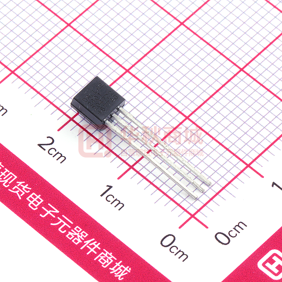

DS2401 Silicon Serial Number Benefits and Features • •  Guaranteed Unique 64-Bit ROM ID Chip for Absolute Traceability o Unique, 64-Bit Registration Number (8-Bit Family Code + 48-Bit Serial Number + 8-Bit CRC Tester) o 8-Bit Family Code Specifies DS2401 Communications Requirements to Reader Minimalist 1-Wire® Interface Lowers Cost and Interface Complexity o Multiple DS2401 Devices Can Reside on a Common 1-Wire Net o Built-In Multidrop Controller Ensures Compatibility with Other 1-Wire Net Products o Reduces Control, Address, Data, and Power to a Single Pin and Communicates at Up to 16.3kbps o Presence Pulse Acknowledges When the Reader First Applies Voltage o Low-Cost TO-92, SOT-223, and TSOC Surface-Mount Packages o TO-92 Tape-and-Reel Version with Leads Bent to 100-mil Spacing (Default) or with Straight Leads (DS2401-SL) Wide Voltage and Temperature Operating Ranges Enables Robust System Performance o Extended 2.8V to 6.0V Range (DS2401) o Zero Standby Power Required o -40°C to +85°C Industrial Temperature Range Applications • • • Pin Configurations TO-92 TSOC DS2401 TOP VIEW 1 2 3 1 2 3 TOP VIEW BOTTOM VIEW Flip Chip, Top View with Laser Mark, Contacts Not Visible. “rrd” = Revision/Date 01rrd 1 2 TOP VIEW DS2401 + A 1 2 B 1 2 PCB Identification Network Node ID Equipment Registration WLP Pin Descriptions NAME 1-Wire is a registered trademark of Maxim Integrated Products, Inc. DATA (DQ) GROUND N.C. (No Connect) 2 1 SOT223 2 1, 4 3 3 TO-92 PIN 2 1 FLIP CHIP 1 2 A1, B1 A2, B2 3–6 — — TSOC WLP 19-5860; Rev 1/22 1 Analog Devices Ordering Information PART DS2401+ DS2401A+ DS2401+T&R DS2401A+T&R DS2401-SL+T&R DS2401P+ DS2401AP+ DS2401P+T&R DS2401AP+T&R DS2401Z+ DS2401Z+T&R DS2401AZ+ DS2401AZ+T&R DS2401X1-S#T DS2401X-S+T TEMP RANGE -40°C to +85°C -40°C to +85°C -40°C to +85°C -40°C to +85°C -40°C to +85°C -40°C to +85°C -40°C to +85°C -40°C to +85°C -40°C to +85°C -40°C to +85°C -40°C to +85°C -40°C to +85°C -40°C to +85°C -40°C to +85°C -40°C to +85°C PIN-PACKAGE 3 TO-92 3 TO-92 3 TO-92 (formed leads) 3 TO-92 (formed leads) 3 TO-92 (straight leads) 6 TSOC 6 TSOC 6 TSOC 6 TSOC 4 SOT-223 4 SOT-223 4 SOT-223 4 SOT-223 2 Flip Chip (2.5k pieces) 4 WLP +Denotes a lead(Pb)-free/RoHS-compliant package. T&R/T = Tape and reel. SL = Straight leads. #Denotes a RoHS-compliant device that may include lead that is exempt under the RoHS requirements. Description The DS2401 enhanced silicon serial number is a low-cost, electronic registration number that provides an absolutely unique identity which can be determined with a minimal electronic interface (typically, a single port pin of a microcontroller). The DS2401 consists of a 64-bit ROM that includes a unique 48-bit serial number, an 8-bit CRC, and an 8-bit Family Code (01h). Data is transferred serially via the 1-Wire protocol that requires only a single data lead and a ground return. Power for reading and writing the device is derived from the data line itself with no need for an external power source. The DS2401 is an upgrade to the DS2400. The DS2401 is fully reverse-compatible with the DS2400 but provides the additional multi-drop capability that enables many devices to reside on a single data line. The familiar TO-92, SOT-223 or TSOC package provides a compact enclosure that allows standard assembly equipment to handle the device easily. Operation The DS2401’s internal ROM is accessed via a single data line. The 48-bit serial number, 8-bit family code and 8-bit CRC are retrieved using the Maxim 1-Wire protocol. This protocol defines bus transactions in terms of the bus state during specified time slots that are initiated on the falling edge of sync pulses from the bus master. All data is read and written least significant bit first. 1-Wire Bus System The 1-Wire bus is a system which has a single bus master system and one or more slaves. In all instances, the DS2401 is a slave device. The bus master is typically a microcontroller. The discussion of this bus system is broken down into three topics: hardware configuration, transaction sequence, and 1Wire signaling (signal type and timing). Hardware Configuration The 1-Wire bus has only a single line by definition; it is important that each device on the bus be able to drive it at the appropriate time. To facilitate this, each device attached to the 1-Wire bus must have an open-drain connection or 3-state outputs. The DS2401 is an open-drain part with an internal circuit 2 Analog Devices equivalent to that shown in Figure 2. The bus master can be the same equivalent circuit. If a bidirectional pin is not available, separate output and input pins can be tied together. The bus master requires a pullup resistor at the master end of the bus, with the bus master circuit equivalent to the one shown in Figure 3. The value of the pullup resistor should be approximately 5kΩ (DS2401) or 2.2kΩ (DS2401A) for short line lengths. A multidrop bus consists of a 1-Wire bus with multiple slaves attached. The 1-Wire bus has a maximum data rate of 16.3kbits per second. The idle state for the 1-Wire bus is high. If, for any reason, a transaction needs to be suspended, the bus MUST be left in the idle state if the transaction is to resume. If this does not occur and the bus is left low for more than 120µs, one or more of the devices on the bus may be reset. DS2401 Memory Map Figure 1 8-Bit CRC Code MSB 48-Bit Serial Number LSB MSB LSB 8-Bit Family Code (01h) MSB LSB DS2401 Equivalent Circuit Figure 2 3 Analog Devices Bus Master Circuit Figure 3 A) Open Drain VPUP See note To data connection of DS2401 B) Standard TTL VPUP See note To data connection of DS2401 Note: Depending on the 1-Wire communication speed and the bus load characteristics, the optimal pullup resistor (RPU) value for the DS2401 will be in the 1.5kΩ to 5kΩ range. For the DS2401A, RPU should range from 300Ω to 2.2kΩ. Transaction Sequence The sequence for accessing the DS2401 via the 1-Wire port is as follows:  Initialization  ROM Function Command  Read Data Initialization All transactions on the 1-Wire bus begin with an initialization sequence. The initialization sequence consists of a reset pulse transmitted by the bus master followed by a Presence Pulse(s) transmitted by the slave(s). The Presence Pulse lets the bus master know that the DS2401 is on the bus and is ready to operate. For more details, see the 1-Wire Signaling section. 4 Analog Devices ROM Function Commands Once the bus master has detected a presence, it can issue one of the four ROM function commands. All ROM function commands are 8 bits long. A list of these commands follows (refer to flowchart in Figure 4). Read ROM [33h] This command allows the bus master to read the DS2401’s 8-bit family code, unique 48-bit serial number, and 8-bit CRC. This command can only be used if there is a single DS2401 on the bus. If more than one slave is present on the bus, a data collision will occur when all slaves try to transmit at the same time (open drain will produce a wired-AND result). Legacy Read ROM [0Fh] (Not Supported by DS2401A) In addition to command byte 33h, the DS2401 Read ROM function will also occur with a command byte of 0Fh in order to ensure compatibility with the DS2400, which will only respond to a 0Fh command word with its 64-bit ROM data. This legacy command byte is not supported by the DS2401A. Match ROM [55h]/Skip ROM [CCh] The complete 1-Wire protocol for all Maxim iButtons® contains a Match ROM and a Skip ROM command. Since the DS2401 contains only the 64-bit ROM with no additional data fields, the Match ROM and Skip ROM are not applicable and will cause no further activity on the 1-Wire bus if executed. The DS2401 does not interfere with other 1-Wire parts on a multidrop bus that do respond to a Match ROM or Skip ROM (for example, a DS2401 and DS1994 on the same bus). However, the DS2401A will return a response after a Match ROM or Skip ROM command. If a multidrop configuration exists in the application, responses from connected DS2401A devices should be taken into account. Search ROM [F0h] When a system is initially brought up, the bus master might not know the number of devices on the 1Wire bus or their 64-bit ROM codes. The search ROM command allows the bus master to use a process of elimination to identify the 64-bit ROM codes of all slave devices on the bus. The ROM search process is the repetition of a simple 3-step routine: read a bit, read the complement of the bit, then write the desired value of that bit. The bus master performs this simple 3-step routine on each bit of the ROM. After one complete pass, the bus master knows the contents of the ROM in one device. The remaining number of devices and their ROM codes may be identified by additional passes. Refer to Application Note 187: 1-Wire Search Algorithm for a comprehensive discussion of a ROM search, including an actual example. 1-Wire Signaling The DS2401 requires a strict protocol to ensure data integrity. The protocol consists of four types of signaling on one line: reset sequence with Reset Pulse and Presence Pulse, write 0, write 1, and read data. All these signals except Presence Pulse are initiated by the bus master. The initialization sequence required to begin any communication with the DS2401 is shown in Figure 5. A reset pulse followed by a Presence Pulse indicates the DS2401 is ready to send or receive data given the correct ROM command. iButton is a registered trademark of Maxim Integrated Products, Inc. 5 Analog Devices The bus master transmits (Tx) a reset pulse (tRSTL, minimum 480µs). The bus master then releases the line and goes into receive mode (Rx). The 1-Wire bus is pulled to a high state via the pullup resistor. After detecting the rising edge on the data pin, the DS2401 waits (tPDH, 15-60µs) and then transmits the Presence Pulse (tPDL, 60-240µs). The 1-Wire bus requires a pullup resistance in the range specified by RPU, depending on bus load characteristics. Read/Write Time Slots The definitions of write and read time slots are illustrated in Figure 6. All time slots are initiated by the master driving the data line low. The falling edge of the data line synchronizes the DS2401 to the master by triggering a delay circuit in the DS2401. During write time slots, the delay circuit determines when the DS2401 will sample the data line. For a read data time slot, if a “0” is to be transmitted, the delay circuit determines how long the DS2401 will hold the data line low overriding the “1” generated by the master. If the data bit is a 1, the DS2401 will leave the read data time slot unchanged. 6 Analog Devices ROM Functions Flow Chart Figure 4 7 Analog Devices Initialization Procedure “Reset and Presence Pulses” Figure 5 RESISTOR MASTER DS2401 Read/Write Timing Diagram Figure 6 Write-One Time Slot RESISTOR MASTER 8 Analog Devices Read/Write Timing Diagram (cont’d) Figure 6 Write-Zero Time Slot tLOW0 < tSLOT Read-Data Time Slot RESISTOR MASTER DS2401 CRC Generation To validate the data transmitted from the DS2401, the bus master may generate a CRC value from the data as it is received. This generated value is compared to the value stored in the last 8 bits of the DS2401. If the two CRC values match, the transmission is error-free. The equivalent polynomial function of this CRC is: CRC = x8 + x5 + x4 + 1. Additional information about the Maxim 1-Wire CRC is available in Application Note 27. Custom DS2401 Customization of a portion of the unique 48-bit serial number by the customer is available. Maxim will register and assign a specific customer ID in the 12 most significant bits of the 48-bit field. The next most significant bits are selectable by the customer as a starting value, and the least significant bits are nonselectable and will be automatically incremented by one. Certain quantities and conditions apply for these custom parts. Contact your Maxim sales representative for more information. 9 Analog Devices Absolute Maximum Ratings Voltage Range on Any Pin Relative to Ground DS2401 .............................................................................................................................................. -0.5V to +7.0V DS2401A ........................................................................................................................................... -0.5V to +6.0V Operating Temperature Range............................................................................................................ -40°C to +85°C Storage Temperature Range ............................................................................................................. -55°C to +125°C Lead Temperature (TO-92, TSOC, SOT-223 only; soldering, 10s) ................................................................ +300°C Soldering Temperature (reflow) TO-92 ............................................................................................................................................................ +250°C TSOC, SOT-223, WLP ................................................................................................................................. +260°C Flip Chip ........................................................................................................................................................ +240°C This is a stress rating only and functional operation of the device at these or any other conditions above those indicated in the operation sections of this specification is not implied. Exposure to absolute maximum rating conditions for extended periods of time may affect reliability. Electrical Characteristics (Limits are 100% tested at TA = +25°C and TA = +85°C. Limits over the operating temperature range and relevant supply voltage range are guaranteed by design and characterization. Specifications marked GBD are guaranteed by design and not production tested. Specifications to the minimum operating temperature are guaranteed by design and are not production tested.) PARAMETER SYMBOL CONDITIONS MIN TYP MAX UNITS DC ELECTRICAL CHARACTERISTICS DS2401 2.8 6 Pullup Voltage V VPUP (Note 2) DS2401A 3 5.25 DS2401 1500 5000 Pullup Resistance RPUP Ω (Note 1) DS2401A 300 2000 DS2401 2.2 Logic 1 (Notes 6, V VIH 11) DS2401A 0.75 x VPUP Logic 0 VIL -0.3 0.3 V Output Logic-Low VOL 0.4 V Input Load Current IL 5 µA (Note 3) DS2401 800 Input Capacitance pF CIO (Notes 7, 11) DS2401A 1000 AC ELECTRICAL CHARACTERISTICS Time Slot tSLOT 60 120 µs Write 1 Low Time tLOW1 1 15 µs (Note 10) Write 0 Low Time tLOW0 60 120 µs Read Data Valid tRDV 15 µs (Note 9) Release Time tRELEASE 0 15 45 µs Read Data Setup tSU 1 µs (Note 5) 1 Recovery Time tREC µs DS2401A, RPUP = 2200Ω 5 (Notes 1, 12) Reset Time High tRSTH 480 µs (Note 4) DS2401 (Note 8) 480 960 Reset Time Low tRSTL µs DS2401A 480 640 Presence Detect tPDH 15 60 µs High Presence Detect tPDL 60 240 µs Low 10 Analog Devices Note 1: System requirement. Note 2: VPUP = external pullup voltage. Note 3: Input load is to ground. Note 4: An additional reset or communication sequence cannot begin until the reset high time has expired. Note 5: Read data setup time refers to the time the host must pull the 1-Wire bus low to read a bit. Data is guaranteed to be valid within tSU of this falling edge. VIH is a function of the external pullup resistor and VPUP. Note 6: Note 7: Note 11: Specified value represents the internal parasite capacitance when VPUP is first applied. Once the parasite capacitance is charged, it does not affect normal communication. The reset low time (tRSTL) should be restricted to a maximum of 960µs to allow interrupt signaling, otherwise it could mask or conceal interrupt pulses if this device is used in parallel with a DS2404 or DS1994. The optimal sampling point for the master is as close as possible to the end time of the tRDV period without exceeding tRDV. For the case of a Read-One Time slot, this maximizes the amount of time for the pullup resistor to recover to a high level. For a Read-Zero Time slot, it ensures that a read will occur before the fastest 1-Wire device(s) releases the line. The duration of the low pulse sent by the master should be a minimum of 1μs with a maximum value as short as possible to allow time for the pullup resistor to recover the line to a high level before the 1Wire device samples in the case of a Write-One Time, or before the master samples in the case of a Read-One Time. Guaranteed by design and/or characterization only. Not production tested Note 12: Applies to a single device attached to a 1-Wire line. Note 8: Note 9: Note 10: Package Information For the latest package outline information and land patterns (footprints), go to www.maxim-ic.com/packages. Note that a “+”, “#”, or “-” in the package code indicates RoHS status only. Package drawings may show a different suffix character, but the drawing pertains to the package regardless of RoHS status. 11 PACKAGE TYPE PACKAGE CODE OUTLINE NO. LAND PATTERN NO. 3 TO-92 (straight leads) Q3+1 21-0248 — 3 TO-92 (formed leads) Q3+4 21-0250 — 6 TSOC 4 SOT-223 2 Flip Chip D6+1 K3+1 BF211#1 21-0382 21-0264 21-0378 90-0321 — 21-0378 4 WLP N40B1+1 21-0605 Refer to Application Note 1891 Analog Devices Revision History REVISION DATE 040601 022202 122106 PAGES CHANGED DESCRIPTION Changed MicroLAN to 1-Wire Net; updated ordering information for tape and reel 1 Changed soldering temperature from 260°C for 10 seconds to See J-STD-020A Specification Below Figure 3, added a note on the optimal RPUP range; added a similar note before the Read/Write Time Slots section 9, 10 Added flip chip package; added lead-free ordering information 1, 2 References to the Book of iButton Standards replaced with references to corresponding application notes 12/16 11/21 11/23/21 1/22 Revised Benefits and Features section Added WLP package to Pin Configurations, Pin Descriptions, Ordering Information, Absolute Maximum Ratings, and Package Information sections Added DS2401 content: updated Benefits and Features, Ordering Information table, Description section, Hardware Configuration section, Figure 2, ROM Function Commands section, 1-Wire Signaling section, Figures 5 and 6, Absolute Maximum Ratings, and Electrical Characteristics table Removed from Ordering Information table: DS2401A-SL+T&R; DS2401AZ+; DS2401AZ+T&R Added DS2401AZ+T&R, DS2401AZ+ to Ordering Information table Various 9, 10 Deleted standard (Pb) parts from ordering information; changed flip chip part number from DS2401X1 to DS2401X1-S#T Deleted VOH from the EC table; moved VPUP from the EC table header into the EC table; changed soldering temperature from J-STD-020A reference to explicit package specific numbers Added Package Information and Revision History sections 3/15 3, 6 Added notes 11 to 13 to the EC table VILMAX changed from 0.8V to 0.3V, EC table note 11 deleted 5/11 9 2 9 10, 11 1 1, 2, 9, 10 1–6, 8–11 2 2 © 2022 Analog Devices, Inc. All rights reserved. Trademarks and registered trademarks are the property of their respective owners. One Analog Way, Wilmington, MA 01887 U.S.A. | Tel: 781.329.4700 | © 2022 Analog Devices, Inc. All rights reserved. 12 Analog Devices
