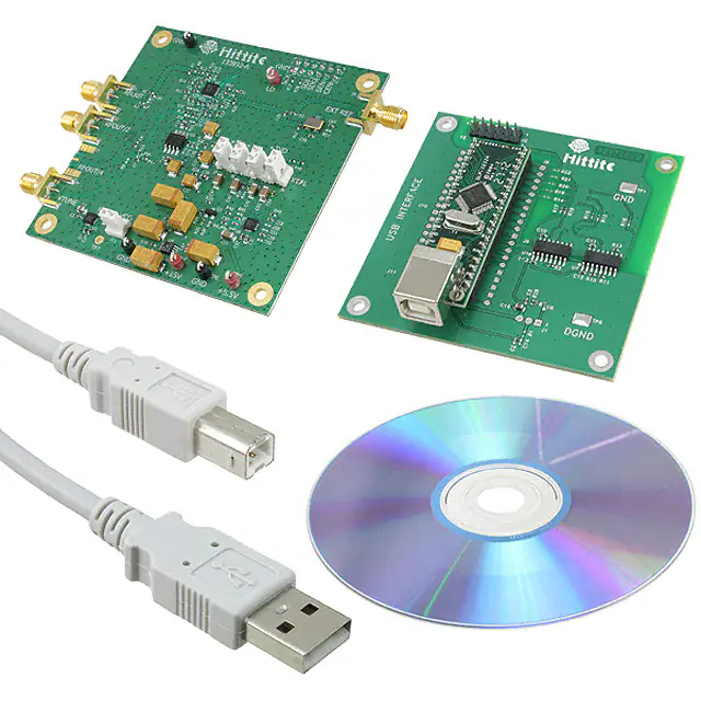

    HMC988LP3E - Timing, Clock Divider Evaluation Board
EKIT01-HMC988LP3E 数据手册
HMC988LP3E v04.1014 Clock Distribution - SMT PROGRAMMABLE CLOCK DIVIDER AND DELAY DC - 4 GHz Typical Applications Features The HMC988LP3E is ideal for: DC - 4 GHz • Basestation Digital Pre-Distortion Paths(DPD) -170 dBc/Hz floor @ 100 MHz output • High Performance Automated Test Equipment(ATE) -164 dBc/Hz floor @ 2 GHz output Integrated Jitter 35 fsRMS@ 100 MHz output 13 fsRMS(calculated) @ 2 GHz output • Backplane clock skew management • Phase Coherence of multiple clock paths Adjustable output phase with soft/hard reset sync • Clock Delay management to improve setup & hold time margins Flexible Input Interface: Adjustable output delay in 60 steps of 20 ps • PCB signal flight time offset circuits LVPECL,LVDS,CML,CMOS Compatible • Track and hold circuits for ADC/DACs AC or DC Coupling On - Chip Termination 50 Ω (100 Ω Differential) Output Driver (LVPECL): Functional Diagram 800 mVpp LVPECL into 50 Ω Single-Ended (+3 dBm Fo) Up to 8 addressable dividers per SPI bus 3.3 V operation or 5 V operation with Optional onchip regulator for best performance 3 x 3 QFN Leadless SMT Package General Description The HMC988LP3E is a an ultra low noise clock divider capable of dividing by 1/2/4/8/16/32. It is a versatile device with additional functionality including adjustable output phase, adjustable delay in 60 steps of ~ 20 ps, a clock synchronization function, and a clock invert option. Housed in a compact 3x3 mm SMT QFN package, the clock divider offers a high level of functionality. The device works with 3.3 V supply or may be connected to 5 V supply and utilize the optional on-chip regulator. This on-chip regulator may be bypassed. Up to 8 addressable HMC988LP3E devices can be used together on the SPI bus. The HMC988LP3E is ideally suited for data converter applications with extremely low phase noise requirements. 1 Information furnished by Analog Devices is believed to be accurate and reliable. However, no For price, 2delivery, and to placeChelmsford, orders: Analog MA Devices, Inc., For price, delivery and to place orders: Microwave Corporation, Elizabeth Drive, 01824 responsibility is assumed by Analog Devices for its use, nor for anyHittite infringements of patents or other One Technology Way, P.O. Box 9106, Norwood, MA 02062-9106 rights of third parties that may result from its use. Specifications subject to change without notice. No Phone: 978-250-3343 Fax: 978-250-3373 Phone: Order781-329-4700 On-line at www.hittite.com • Order online at www.analog.com license is granted by implication or otherwise under any patent or patent rights of Analog Devices. Application Support: Phone: 1-800-ANALOG-D Trademarks and registered trademarks are the property of their respective owners. Application Support: Phone: 978-250-3343 or apps@hittite.com HMC988LP3E v04.1014 PROGRAMMABLE CLOCK DIVIDER AND DELAY DC - 4 GHz Unless otherwise specified: T = +25 °C. Current consumptions assumes fine adjustable delay is disabled. Phase noise degrades approximately 15 dB if using fine delay adjustment. Parameter Conditions Min OSCP/N Input Frequency Range DC DIVP/N Output Frequency Range DC Divide Ratios Typ. Max Units 4 GHz 4 GHz 1 GHz 1/2/4/8/16/32 Maximum Fine Delay Adjust Frequency DC VDD with on-chip regulator +3.7 +4.5 +5.5 V VDD bypass on-chip regulator +3.1 +3.3 +3.5 V 0.800 See Figure 9 Vpp Measured into a 50ohm Load 0.8 (single ended) Vpp Measured into a 50ohm Load 1.6 (differential) Vppd 90 ps Input Swing (LVPECL or AC) Output Swing (LVPECL) [1] Rise/Fall Time (LVPECL OUT) 20%/80% OSCP/N Input Commom Mode DC Bias [2] +1.6 DIVP/N Output Common Mode Voltage [1] Phase Noise (@100 MHz offset) @ 100 MHz output @ 500 MHz output @ 1 GHz output @ 2 GHz output Jitter Density @ 100 MHz output @ 500 MHz output @ 1 GHz output @ 2 GHz output +2 +2 V [3] -170 -168 -166 -164 dBc/Hz 7.1 1.8 1.1 0.7 32 8 5 3.2 [6] [6] [6] Noise Floor = FOM+10Log(Fout) Coarse Delay Adjustment Range Fine Delay Adjustment Range asec/√Hz [5] FOM (Figure of Merit) Noise Floor [7] 60 steps of ~ 20 ps; Delay compresses with increasing frequency. See Figure 6. With divider bypassed maximum frequency limited to 650MHz fsec -254 dBc/Hz 1/2 to ∞ *TINPUT Input Cycles 300 1500 Fine Delay Adjustment Resolution 20 Fine Delay Adjustment Step Count 60 With Regulator V [4] Integrated Jitter (12k - 20MHz) @ 100 MHz output @ 500 MHz output @ 1 GHz output @ 2 GHz output PSRR +2.5 Clock Distribution - SMT Table 1. Electrical Specifications ps ps [8] AM -70 -80 dBc PM -80 -92 dBc Information furnished by Analog Devices is believed to be accurate and reliable. However, no For price, 2delivery, and to placeChelmsford, orders: Analog MA Devices, Inc., For price, delivery and to place orders: Microwave Corporation, Elizabeth Drive, 01824 responsibility is assumed by Analog Devices for its use, nor for anyHittite infringements of patents or other One Technology Way, P.O. Box 9106, Norwood, MA 02062-9106 rights of third parties that may result from its use. Specifications subject to change without notice. No Phone: 978-250-3343 Fax: 978-250-3373 Phone: Order781-329-4700 On-line at www.hittite.com • Order online at www.analog.com license is granted by implication or otherwise under any patent or patent rights of Analog Devices. Application Support: Phone: 1-800-ANALOG-D Trademarks and registered trademarks are the property of their respective owners. Application Support: Phone: 978-250-3343 or apps@hittite.com 2 HMC988LP3E v04.1014 PROGRAMMABLE CLOCK DIVIDER AND DELAY DC - 4 GHz Clock Distribution - SMT Table 1. Electrical Specifications 3 Unless otherwise specified: T = +25 °C. Current consumptions assumes fine adjustable delay is disabled. Phase noise degrades approximately 15 dB if using fine delay adjustment. Parameter Conditions Min Max Units AM -40 -50 dBc PM -50 -70 dBc Bypass Regulator Typ. Current Consumption Stand-by Current - Chip Disabled Mininum Current using Regulator case 0.7 bypass Regulator case 0.01 mA 68 mA [9] mA Additive Divider 16 21 Delay Line Current 12 44 mA LVPECL Termination Load Current 26 40 mA 250 MHz (Setpoint 15) 350 fs/ °C 1 GHz 150 fs/ °C 0.9 V Propagation Delay Delay vs Temp Delay Line Disabled 210 (Setpoint 15) mA ps Logic Inputs: CHIP0, CHIP1, CHIP 2, SLE,SDI, SCK, TRIG Input Logic Low, Vil Input Logic High, Vih 2.1 V [1] Using standard LVPECL termination as shown in Figure 9 [2] When Reg04[03]=1, Default Setting=0 [3] Phase noise performance is characterized using the HMC1034 as a source at ~2 GHz, 9 dBm differential. For sinusoidal low-frequency inputs, the phase noise may degrade. For example, a single-ended 100 MHz 9 dBm sin-wave in bypass mode produces a phase noise floor of -164 dBc/ Hz as opposed to -170 dBc/Hz. [4] To calculate Jitter Density, (√2*10^((Floor phase noise)/20)/2π)*(1/frequency) i.e jitter density@ 500 MHz = (√2*10^(-168/20)/2π)*(1/500000000) [5] Integrated Bandwidth start from 12 KHz to 20 MHz, Jitter Density x √Desired customized BW i.e integrated jitter @ 2 GHz over a 6 GHz BW = 0.7 asec/√Hz x √6 GHz 1asec = 1/1000 of a femtosecond. Only 100 MHz number is meaured with 100 MHz Wenzel and HMC988 in bypass mode [6] These integrated jitter number are based on calculation. [7] The fine delay adjustment is valid up to a 1 GHz output frequency. Maximum frequency is 650MHz with divider bypassed (divide-by-1). [8] Spur caused by 100 mVpp Agressor tone on input supply. This specification is the level of the SSB spur which appears symmetrically around the output frequency when the input supply stimulated by a 100 mVpp aggressive tone @ 30 kHz. The spur level is linearly proportional to the aggressor tone amplitude. It is relatively independent of input and output frequencies, and input power level. When regulated, at least 3.7 V must be applied to the input power supply to provide sufficient PSRR. The spur level is not appreciably different for single ended or differential operation. The frequency response to the aggressive tone is flat from 1 kHz to 50 kHz offset. Above 50 kHz the solution PSRR improves strongly, but is largely dependant on board decoupling capacitance and is not a direct indication of the raw part performance. [9] When Divider is bypassed,no termination loads and delay line disabled case. Information furnished by Analog Devices is believed to be accurate and reliable. However, no For price, 2delivery, and to placeChelmsford, orders: Analog MA Devices, Inc., For price, delivery and to place orders: Microwave Corporation, Elizabeth Drive, 01824 responsibility is assumed by Analog Devices for its use, nor for anyHittite infringements of patents or other One Technology Way, P.O. Box 9106, Norwood, MA 02062-9106 rights of third parties that may result from its use. Specifications subject to change without notice. No Phone: 978-250-3343 Fax: 978-250-3373 Phone: Order781-329-4700 On-line at www.hittite.com • Order online at www.analog.com license is granted by implication or otherwise under any patent or patent rights of Analog Devices. Application Support: Phone: 1-800-ANALOG-D Trademarks and registered trademarks are the property of their respective owners. Application Support: Phone: 978-250-3343 or apps@hittite.com HMC988LP3E v04.1014 PROGRAMMABLE CLOCK DIVIDER AND DELAY DC - 4 GHz TYPICAL PERFORMANCE CHARACTERISTICS Figure 2. Phase Noise Performance vs Temperature at 1.5 GHz Div 2 Figure 1. Phase Noise Performance vs Divider Ratio at 1.5 GHz Div 1/2/4/8/16 -110 -120 -120 PHASE NOISE (dBc/Hz) PHASE NOISE (dBc/Hz) -100 -140 -160 Source Div 1(Bypass) Div 2 Div 4 Div 8 Div 16 -180 -200 1 10 -130 -140 -150 27C 85C -40C -160 100 1000 10000 -170 100000 1 10 100 1000 10000 100000 OFFSET (KHz) OFFSET (KHz) Figure 3. Phase Noise Floor Performance Vs Input Swing Figure 4. Phase Noise Floor Performance Vs Output Frequency [1] -130 -162 100MHz Bypass Single-Ended 1500MHz div 2 Single-Ended 1500MHz div 2 Differential -140 PHASE NOISE (dBc/Hz) PHASE NOISE (dBc/Hz) -135 -145 -150 -155 Bypass -164 -166 Divide by 4 Divide by 8 -170 -165 1 10 100 1000 Instrument Noise Floor 100 10000 1000 3000 OUTPUT FREQUNECY (MHz) INPUT SWING (mVpp) Figure 5. VOUT Vs Frequency over Temperature [2] Figure 6. Delay Vs Delay line Setpoint [3] 2000 2.5 150 MHz 27C 85C -40C 1500 DELAY (ps) 2 OUTPUT LEVEL (Vpp) Divide by 2 -168 -160 -170 Clock Distribution - SMT Unless otherwise specified: T = 27 °C, Regulated VDD = 3.3 V, 1.5 GHz, 6 dBm in, AC coupled single ended input and output, 120 Ω/leg DC termination, AC coupled into 50 Ω measuring load. 1.5 1 1000 MHz 1000 Delay OFF 500 0.5 210 0 0 0.1 1 OUTPUT FREQUENCY (GHz) 7 0 13 26 39 52 60 DELAY LINE SETTING [1] Measured Differential input and out at various frequencies. Under 300 MHz, the measurment is restricted by the instrument. [2]Measured single-ended. 120 Ω DC termination, 3.3 V 1 +6 dBm single-ended input. HMC988LP3E AC coupled to 50 Ω instrument with divider bypass [3]Corrected for board delay 210 ps Information furnished by Analog Devices is believed to be accurate and reliable. However, no For price, 2delivery, and to placeChelmsford, orders: Analog MA Devices, Inc., For price, delivery and to place orders: Microwave Corporation, Elizabeth Drive, 01824 responsibility is assumed by Analog Devices for its use, nor for anyHittite infringements of patents or other One Technology Way, P.O. Box 9106, Norwood, MA 02062-9106 rights of third parties that may result from its use. Specifications subject to change without notice. No Phone: 978-250-3343 Fax: 978-250-3373 Phone: Order781-329-4700 On-line at www.hittite.com • Order online at www.analog.com license is granted by implication or otherwise under any patent or patent rights of Analog Devices. Application Support: Phone: 1-800-ANALOG-D Trademarks and registered trademarks are the property of their respective owners. Application Support: Phone: 978-250-3343 or apps@hittite.com 4 HMC988LP3E v04.1014 PROGRAMMABLE CLOCK DIVIDER AND DELAY DC - 4 GHz Figure 7. S-Parameters-S22 [4] Figure 8. S-Parameters-S11 [4] 0 0 -10 POWER (dB) POWER (dB) -5 -10 -15 -15 -20 -25 -30 -35 S22(Single-Ended) S22(Differnetial) -20 S11(Single-Ended) S11(Differnetial) -40 100000 5E+06 1000000 1E+5 5E+6 1E+6 FREQUENCY (KHz) FREQUENCY (KHz) Figure 9. Input Sensitivity[5] Figure 10. Supply Voltage vs input Voltage [6] 200 3.6 180 160 3.4 140 Recommended Operating Region 120 VOUT (V) INPUT POWER LEVEL (mVpp) Clock Distribution - SMT -5 100 80 3.2 3 60 40 VOUT(Regulated) VOUT(non regulated) 2.8 20 0 2.6 0 1 2 3 4 5 3 3.5 4 4.5 5 5.5 VIN (V) INPUT FREQUENCY (GHz) Figure 11. Time Domain 1 GHz input, 500 MHz Output [7] 400 300 AMPLITUTE (mVpp) 200 100 0 -100 -200 -300 -400 0 210 500 1000 1500 2000 2500 3000 3500 4000 TIME (ps) [4] Measured with 200 Ω DC termination, 10 Ω series resistor in front, AC couple 1 nF 3.3 V [5] Measured single-ended. 120 Ω DC termination, 3.3 V HMC988LP5E AC coupled to 50 Ω instrument(DSO8104B) with divider bypass. ESD diode will start to turn on if maximum input power exceeds 12 dBm. [6] On Chip regulator enable mode measured at PIN CAP_3V Vs regulator bypass mode [7] Measured with 1 GHz 400 mVpp source as single ended input, HMC988LP3E div 2. Board delay 210 ps 5 Information furnished by Analog Devices is believed to be accurate and reliable. However, no For price, 2delivery, and to placeChelmsford, orders: Analog MA Devices, Inc., For price, delivery and to place orders: Microwave Corporation, Elizabeth Drive, 01824 responsibility is assumed by Analog Devices for its use, nor for anyHittite infringements of patents or other One Technology Way, P.O. Box 9106, Norwood, MA 02062-9106 rights of third parties that may result from its use. Specifications subject to change without notice. No Phone: 978-250-3343 Fax: 978-250-3373 Phone: Order781-329-4700 On-line at www.hittite.com • Order online at www.analog.com license is granted by implication or otherwise under any patent or patent rights of Analog Devices. Application Support: Phone: 1-800-ANALOG-D Trademarks and registered trademarks are the property of their respective owners. Application Support: Phone: 978-250-3343 or apps@hittite.com HMC988LP3E v04.1014 PROGRAMMABLE CLOCK DIVIDER AND DELAY DC - 4 GHz Pin Number Function Description 1,4,5 CHIP0, CHIP1, CHIP2 Chip SPI Address 2,3 OSCP, OSCN Differential Signal Input 6 GPO General Purpose Output Pin & Serial Data Out 7 SDI Serial Data Input 8 SCK Serial Data Clock 9 SLE Serial Data Latch Enable 10,11 DIVN, DIVP Differential Output Signal 12 VDD3_DECAP Decoupling point for internally generated supply 13 TRIG External SYNC or SLIP Control Pin for slip/synchronization start Decoupling point for regulator 14 FB_DECAP 15 BGAP_DECAP Decoupling point for regulator 16 VDD5 Regulator Input Supply Voltage Information furnished by Analog Devices is believed to be accurate and reliable. However, no For price, 2delivery, and to placeChelmsford, orders: Analog MA Devices, Inc., For price, delivery and to place orders: Microwave Corporation, Elizabeth Drive, 01824 responsibility is assumed by Analog Devices for its use, nor for anyHittite infringements of patents or other One Technology Way, P.O. Box 9106, Norwood, MA 02062-9106 rights of third parties that may result from its use. Specifications subject to change without notice. No Phone: 978-250-3343 Fax: 978-250-3373 Phone: Order781-329-4700 On-line at www.hittite.com • Order online at www.analog.com license is granted by implication or otherwise under any patent or patent rights of Analog Devices. Application Support: Phone: 1-800-ANALOG-D Trademarks and registered trademarks are the property of their respective owners. Application Support: Phone: 978-250-3343 or apps@hittite.com Clock Distribution - SMT Table 2. Pin Descriptions 6 HMC988LP3E v04.1014 PROGRAMMABLE CLOCK DIVIDER AND DELAY DC - 4 GHz Table 3. Absolute Maximum Ratings Clock Distribution - SMT Parameter 7 Rating Max Vdd to paddle on suply pin -0.3 V to +5.5 V OSCP, OSCN Max RF Power 13 dBm OSCP, OSCN Differential DC -0.3 V to 3.6 V LVPECL Min Output Load Resistor 100 Ω to GND LVPECL Output Load Current 40 mA/leg Digital Load 1 kΩ min Digital Input Voltage Range -0.3 V to 3.6 V Thermal Resistance (Jxn to Gnd Paddle) 25 0C/W Operating Temperature Range -40 OC to +85 OC Storage Temperature Range -65 OC to + 125 OC Maximum Junction Temperature +125 OC Reflow Soldering Peak Temperature 260 OC Time at Peak Temperature 40 sec ESD Sensitivity HBM Class 1C Stresses above those listed under Absolute Maximum Ratings may cause permanent damage to the device. This is a stress rating only; functional operation of the device at these or any other conditions above those indicated in the operational section of this specification is not implied. Exposure to absolute maximum rating conditions for extended periods may affect device reliability. Information furnished by Analog Devices is believed to be accurate and reliable. However, no For price, 2delivery, and to placeChelmsford, orders: Analog MA Devices, Inc., For price, delivery and to place orders: Microwave Corporation, Elizabeth Drive, 01824 responsibility is assumed by Analog Devices for its use, nor for anyHittite infringements of patents or other One Technology Way, P.O. Box 9106, Norwood, MA 02062-9106 rights of third parties that may result from its use. Specifications subject to change without notice. No Phone: 978-250-3343 Fax: 978-250-3373 Phone: Order781-329-4700 On-line at www.hittite.com • Order online at www.analog.com license is granted by implication or otherwise under any patent or patent rights of Analog Devices. Application Support: Phone: 1-800-ANALOG-D Trademarks and registered trademarks are the property of their respective owners. Application Support: Phone: 978-250-3343 or apps@hittite.com HMC988LP3E v04.1014 PROGRAMMABLE CLOCK DIVIDER AND DELAY DC - 4 GHz Clock Distribution - SMT Outline Drawing NOTES: [1] PACKAGE BODY MATERIAL: LOW STRESS INJECTION MOLDED PLASTIC SILICA AND SILICON IMPREGNATED. [2] LEAD AND GROUND PADDLE MATERIAL: COPPER ALLOY. [3] LEAD AND GROUND PADDLE PLATING: 100% MATTE TIN. [4] DIMENSIONS ARE IN INCHES [MILLIMETERS]. [5] LEAD SPACING TOLERANCE IS NON-CUMULATIVE. [6] PAD BURR LENGTH SHALL BE 0.15 mm MAX. PAD BURR HEIGHT SHALL BE 0.05 mm MAX. [7] PACKAGE WARP SHALL NOT EXCEED 0.05 mm [8] ALL GROUND LEADS AND GROUND PADDLE MUST BE SOLDERED TO PCB RF GROUND. [9] REFER TO HITTITE APPLICATION NOTE FOR SUGGESTED PCB LAND PATTERN. Table 4. Package Information Part Number Package Body Material Lead Finish MSL Rating Package Marking [1] HMC988LP3E RoHS-compliant Low Stress Injection Molded Plastic 100% matte Sn MSL1[2] H988 XXXX [1] 4-Digit lot number XXXX [2] Max peak reflow temperature of 260 °C Information furnished by Analog Devices is believed to be accurate and reliable. However, no For price, 2delivery, and to placeChelmsford, orders: Analog MA Devices, Inc., For price, delivery and to place orders: Microwave Corporation, Elizabeth Drive, 01824 responsibility is assumed by Analog Devices for its use, nor for anyHittite infringements of patents or other One Technology Way, P.O. Box 9106, Norwood, MA 02062-9106 rights of third parties that may result from its use. Specifications subject to change without notice. No Phone: 978-250-3343 Fax: 978-250-3373 Phone: Order781-329-4700 On-line at www.hittite.com • Order online at www.analog.com license is granted by implication or otherwise under any patent or patent rights of Analog Devices. Application Support: Phone: 1-800-ANALOG-D Trademarks and registered trademarks are the property of their respective owners. Application Support: Phone: 978-250-3343 or apps@hittite.com 8 HMC988LP3E v04.1014 PROGRAMMABLE CLOCK DIVIDER AND DELAY DC - 4 GHz Clock Distribution - SMT Evaluation PCB The circuit board used in the application should use RF circuit design techniques. Signal lines should have 50 Ω impedance while the package ground leads and exposed paddle should be connected directly to the ground plane similar to that shown. A sufficient number of via holes should be used to connect the top and bottom ground planes. The evaluation circuit board shown is available from Hittite upon request. Evaluation PCB Schematic To view this Evaluation PCB Schematic please visit www.hittite.com and choose HMC988LP3E from the “Search by Part Number” pull down menu to view the product splash page. 9 Information furnished by Analog Devices is believed to be accurate and reliable. However, no For price, 2delivery, and to placeChelmsford, orders: Analog MA Devices, Inc., For price, delivery and to place orders: Microwave Corporation, Elizabeth Drive, 01824 responsibility is assumed by Analog Devices for its use, nor for anyHittite infringements of patents or other One Technology Way, P.O. Box 9106, Norwood, MA 02062-9106 rights of third parties that may result from its use. Specifications subject to change without notice. No Phone: 978-250-3343 Fax: 978-250-3373 Phone: Order781-329-4700 On-line at www.hittite.com • Order online at www.analog.com license is granted by implication or otherwise under any patent or patent rights of Analog Devices. Application Support: Phone: 1-800-ANALOG-D Trademarks and registered trademarks are the property of their respective owners. Application Support: Phone: 978-250-3343 or apps@hittite.com HMC988LP3E v04.1014 PROGRAMMABLE CLOCK DIVIDER AND DELAY DC - 4 GHz Item Contents Part Number Evaluation PCB Only HMC988LP3E Evaluation PCB EVAL01-HMC988LP3E Evaluation Kit HMC988LP3E Evaluation PCB USB Interface Board 6’ USB A Male to USB B Female Cable CD ROM (Contains User Manual, Evaluation PCB Schematic, Evaluation Software, Hittite PLL Design Software) EKIT01-HMC988LP3E Information furnished by Analog Devices is believed to be accurate and reliable. However, no For price, 2delivery, and to placeChelmsford, orders: Analog MA Devices, Inc., For price, delivery and to place orders: Microwave Corporation, Elizabeth Drive, 01824 responsibility is assumed by Analog Devices for its use, nor for anyHittite infringements of patents or other One Technology Way, P.O. Box 9106, Norwood, MA 02062-9106 rights of third parties that may result from its use. Specifications subject to change without notice. No Phone: 978-250-3343 Fax: 978-250-3373 Phone: Order781-329-4700 On-line at www.hittite.com • Order online at www.analog.com license is granted by implication or otherwise under any patent or patent rights of Analog Devices. Application Support: Phone: 1-800-ANALOG-D Trademarks and registered trademarks are the property of their respective owners. Application Support: Phone: 978-250-3343 or apps@hittite.com Clock Distribution - SMT Table 5. Evaluation Order Information 10 HMC988LP3E v04.1014 PROGRAMMABLE CLOCK DIVIDER AND DELAY DC - 4 GHz Theory of Operation In addition to HMC988LP3E excellent low noise performance, the device offers additional functionality including: Clock Distribution - SMT Modular Configuration Synchronization Function Adjustable Fine Delay Adjustable Coarse Delay Trigger Options Optional On-Chip Regulator GPO Modular Configuration The HMC988LP3E has been designed so that up to 8 devices can be placed on one SPI bus. The part has a 3-bit addressable chip addresses (CHIP0 pin, CHIP1 pin, CHIP2 pin) so that each chip can be controlled individually. In addition, HMC988LP3E has a broadcast mode which allows up to 8 HMC988LP3E devices to be simultaneously controlled, or triggered. In Broadcast mode each HMC988LP3E device will listen to the same chip address, namely “111.” Typical application of HMC988LP3E is shown in Figure 1. Figure 1. Typical application of HMC988LP3E 11 Information furnished by Analog Devices is believed to be accurate and reliable. However, no For price, 2delivery, and to placeChelmsford, orders: Analog MA Devices, Inc., For price, delivery and to place orders: Microwave Corporation, Elizabeth Drive, 01824 responsibility is assumed by Analog Devices for its use, nor for anyHittite infringements of patents or other One Technology Way, P.O. Box 9106, Norwood, MA 02062-9106 rights of third parties that may result from its use. Specifications subject to change without notice. No Phone: 978-250-3343 Fax: 978-250-3373 Phone: Order781-329-4700 On-line at www.hittite.com • Order online at www.analog.com license is granted by implication or otherwise under any patent or patent rights of Analog Devices. Application Support: Phone: 1-800-ANALOG-D Trademarks and registered trademarks are the property of their respective owners. Application Support: Phone: 978-250-3343 or apps@hittite.com HMC988LP3E v04.1014 PROGRAMMABLE CLOCK DIVIDER AND DELAY DC - 4 GHz procedure: Communicate with first 7 HMC988LP3E devices in a standard SPI mode. Select their chip addresses and write to the registers of interest. 1. After communicating with first 7 devices, with chip addresses ranging from (“000” to “110”), ensure that Broadcast Mode for all of them is disabled by writing to Reg04h[0] = “0” to each device. 2. Communicate with the 8th device, with Chip addresses (“111”) in standard mode. The rest of the devices will not be listening because their Broadcast Mode is disabled (Reg04h[0] = “0”). 3. If a broadcast to all devices on the SPI bus is required, Broadcast Mode needs to be enabled (Reg04h[0] = “1”) for each device separately. After the Broadcast Mode is enabled in each device, the SPI controller can write to the SPI bus in a standard way while selecting chip address (“111”). All of the HMC988LP3E devices will be listening. Synchronization Function If the HMC988LP3E is used in a typical application as shown in Figure 1, it may be advantageous for some or all of the outputs to be synchronized. The HMC988LP3E can accomplish this using its SYNC functionality. The SYNC feature is limited to low frequency (100MHz maximum) input clocks due to the internal rise time and delay on the internal trigger signal path. Clock Distribution - SMT Although the HMC988LP3E has only 8 SPI chip addresses, one of which (“111”) is used in the broadcast mode, it is still possible to use broadcast mode and control 8 HMC988LP3E devices on one SPI bus, according to the following Figure 2. HMC988LP3E SYNC Function Timing Diagram As shown in Figure 2, the Sync function ensures that all outputs launch synchronously, a number of input cycles after the the SYNC function is triggered. The delay, measured in the number of input cycles, is governed by equation 1 where x is the number of input cycles and N is the divide ratio selection (Reg02h[2:0]) of HMC988LP3E. if N = 1  NA: Output disabled    N  + 1 if N > 1 and Reg06h[2]=0  x =  2    N    + 2 if N > 1 and Reg06h[2]=1  2   Information furnished by Analog Devices is believed to be accurate and reliable. However, no For price, 2delivery, and to placeChelmsford, orders: Analog MA Devices, Inc., For price, delivery and to place orders: Microwave Corporation, Elizabeth Drive, 01824 responsibility is assumed by Analog Devices for its use, nor for anyHittite infringements of patents or other One Technology Way, P.O. Box 9106, Norwood, MA 02062-9106 rights of third parties that may result from its use. Specifications subject to change without notice. No Phone: 978-250-3343 Fax: 978-250-3373 Phone: Order781-329-4700 On-line at www.hittite.com • Order online at www.analog.com license is granted by implication or otherwise under any patent or patent rights of Analog Devices. Application Support: Phone: 1-800-ANALOG-D Trademarks and registered trademarks are the property of their respective owners. Application Support: Phone: 978-250-3343 or apps@hittite.com 12 HMC988LP3E v04.1014 PROGRAMMABLE CLOCK DIVIDER AND DELAY DC - 4 GHz Clock Distribution - SMT Adjustable Coarse Delay The HMC988LP3E provides the option to delay the output one cycle of the input signal using its SLIP function. This function in essence prevents the input signal from cycling for 1 period and causes a corresponding phase shift in the output signal. Timing diagram of the execution of the Slip function is show in Figure 3. Figure 3. HMC988LP3E’s SLIP Function Timing Diagram In addition, the HMC988LP3E allows the user to select the launch phase of the output signal relative to the input signal by programming Reg06h[2]. When this functionality is used in conjunction with the Slip function, it allows the user to adjust the delay/phase of the output signal, in increments of half period of the input signal. Example of a half period delay is shown in.Figure 4. In order to achieve the half period delay, the HMC988LP3E delays the output by one full period of the input signal, by using the SLIP function, then Reg06h[2] value is changed from “1” (rising edge) to “0” (falling edge) and the output is effectively sped up by half cycle of the input, resulting in a total delay of one half of the period of the input signal. Similar methodology can be deployed to delay the output signal by X.5 or more cycles, in effect the user would deploy the Slip function to X+1 times and then switch the trigger from rising edge to falling edge to achieve a total delay of X.5. 13 Information furnished by Analog Devices is believed to be accurate and reliable. However, no For price, 2delivery, and to placeChelmsford, orders: Analog MA Devices, Inc., For price, delivery and to place orders: Microwave Corporation, Elizabeth Drive, 01824 responsibility is assumed by Analog Devices for its use, nor for anyHittite infringements of patents or other One Technology Way, P.O. Box 9106, Norwood, MA 02062-9106 rights of third parties that may result from its use. Specifications subject to change without notice. No Phone: 978-250-3343 Fax: 978-250-3373 Phone: Order781-329-4700 On-line at www.hittite.com • Order online at www.analog.com license is granted by implication or otherwise under any patent or patent rights of Analog Devices. Application Support: Phone: 1-800-ANALOG-D Trademarks and registered trademarks are the property of their respective owners. Application Support: Phone: 978-250-3343 or apps@hittite.com HMC988LP3E v04.1014 Figure 4. Delay by 1/2 of Input Clock Cycle Timing Diagram Adjustable Fine Delay In addition to the 1/2 cycle delay offered by the slip function, the output of the HMC988LP3E can be delayed in ~20 ps steps, by programing Reg07h[5:0]. anywhere from 0 to 60. The delay function follows Equation 2. Delay ≅ (Reg07h) × 20ps + 300ps EQ (2) Clock Distribution - SMT PROGRAMMABLE CLOCK DIVIDER AND DELAY DC - 4 GHz At higher frequencies (> 200 MHz), the step size compresses near the high end of the range when using the Fine Delay. See Figure 6. If Fine Delay is used when the divider is bypassed (divide-by-1) the maximum frequency is limited to 650MHz. As the frequency is increased beyond 650MHz the output amplitude will decrease when the divider is bypassed. Please note that the phase noise can degrade by 15 dB when using Fine Delay mode. Trigger Details In HMC988LP3E, the Sync and the Slip functions can both be implemented using the external “TRIG” pin or by using the SPI interface. The circuit diagram for SYNC and SLIP controls pins is shown in Figure 5. Note that the SYNC and SLIP should not be applied at the same time. Figure 5. SYNC/SLIP Circuit Diagram Information furnished by Analog Devices is believed to be accurate and reliable. However, no For price, 2delivery, and to placeChelmsford, orders: Analog MA Devices, Inc., For price, delivery and to place orders: Microwave Corporation, Elizabeth Drive, 01824 responsibility is assumed by Analog Devices for its use, nor for anyHittite infringements of patents or other One Technology Way, P.O. Box 9106, Norwood, MA 02062-9106 rights of third parties that may result from its use. Specifications subject to change without notice. No Phone: 978-250-3343 Fax: 978-250-3373 Phone: Order781-329-4700 On-line at www.hittite.com • Order online at www.analog.com license is granted by implication or otherwise under any patent or patent rights of Analog Devices. Application Support: Phone: 1-800-ANALOG-D Trademarks and registered trademarks are the property of their respective owners. Application Support: Phone: 978-250-3343 or apps@hittite.com 14 HMC988LP3E v04.1014 PROGRAMMABLE CLOCK DIVIDER AND DELAY DC - 4 GHz Clock Distribution - SMT Executing SYNC/SLIP Using External PIn In order to execute SYNC or SLIP function using the external pin, simply assert the external “TRIG” pin of the HMC988LP3E. The functions will trigger on the rising edge of the external SYNC or SLIP pin . Note that the corresponding SYNC or SLIP external trigger awareness function needs to be enabled in the HMC988LP3E. Note that Reg04h[1] and Reg04h[2] should never be equal to “1” at the same time. if “1” is written to Reg04h[1], than “0” needs to be written to Reg04h[2], and vice-versa. Execute SYNC/SLIP Using the SPI Interface Pin 9, Serial Latch Enable (SLE), of the HMC988LP3E causes SPI bits to change states and therefore acts as a trigger if the SYNC and SLIP functions are chosen to be executed using the SPI interface. Note that the SYNC signal is level sensitive, and must remain 1 in order to keep the internal divider running. The slip signal is rising-edge sensitive, and must be returned low at some point before the next trigger. Optional On-Chip Regulator The HMC988LP3E has an optional on-chip regulator that can be used or bypassed. The regulator requires an input voltage ≥ 3.8 V. The on-chip regulator circuit is shown in Figure 6. The regulator can be bypassed by programing Reg04h[5] = “1”. In that case identical voltage should be applied to input of the regulator (VDD5) and VDD3_DECAP. Figure 6. Regulator Circuit Diagram GPO The HMC988LP3E has a GPO (General Purpose Output) pin that can be used for obtaining various internal states of the device (many of which are only used for internal testing), or as an SPI output. The function of the GPO pin is configured in Reg05h. 15 Information furnished by Analog Devices is believed to be accurate and reliable. However, no For price, 2delivery, and to placeChelmsford, orders: Analog MA Devices, Inc., For price, delivery and to place orders: Microwave Corporation, Elizabeth Drive, 01824 responsibility is assumed by Analog Devices for its use, nor for anyHittite infringements of patents or other One Technology Way, P.O. Box 9106, Norwood, MA 02062-9106 rights of third parties that may result from its use. Specifications subject to change without notice. No Phone: 978-250-3343 Fax: 978-250-3373 Phone: Order781-329-4700 On-line at www.hittite.com • Order online at www.analog.com license is granted by implication or otherwise under any patent or patent rights of Analog Devices. Application Support: Phone: 1-800-ANALOG-D Trademarks and registered trademarks are the property of their respective owners. Application Support: Phone: 978-250-3343 or apps@hittite.com HMC988LP3E v04.1014 PROGRAMMABLE CLOCK DIVIDER AND DELAY DC - 4 GHz HMC988LP3E Input Stage or CML signals. If driven single-ended, a large AC coupling cap to ground should be used on the undriven input. The input impedance is 50 Ω single-ended (100 Ω differential). The DC bias level of 2.0 V can be generated internally by programming Reg04h[3] = 1, supplied externally, or generated via an LVPECL termination network inside the part. When Reg04h[3] = 0 internal DC bias is disabled and LVPECL termination enabled. Clock Distribution - SMT The HMC988LP5E input stage, Figure 7, is flexible. It can be driven single-ended or differential, with LVPECL, LVDS, Figure 7. HMC988LP3E Input Stage HMC988LP3E Output Stage The LVPECL output driver produces up to 1.6 Vppd swing into 50 Ω loads. LVPECL drivers are terminated with off-chip resistors that provide the DC current through the emitter-follower output stage. The output stage has a switch which disconnects the output driver from the load when not used. The switch series resistor significantly improves the output match when driving into 50 Ω transmission lines. The switch series resistor causes a small DC level shift and swing degradation, depending on the termination current. If unused, disabled LVPECL outputs can be left floating, terminated, or grounded. Information furnished by Analog Devices is believed to be accurate and reliable. However, no For price, 2delivery, and to placeChelmsford, orders: Analog MA Devices, Inc., For price, delivery and to place orders: Microwave Corporation, Elizabeth Drive, 01824 responsibility is assumed by Analog Devices for its use, nor for anyHittite infringements of patents or other One Technology Way, P.O. Box 9106, Norwood, MA 02062-9106 rights of third parties that may result from its use. Specifications subject to change without notice. No Phone: 978-250-3343 Fax: 978-250-3373 Phone: Order781-329-4700 On-line at www.hittite.com • Order online at www.analog.com license is granted by implication or otherwise under any patent or patent rights of Analog Devices. Application Support: Phone: 1-800-ANALOG-D Trademarks and registered trademarks are the property of their respective owners. Application Support: Phone: 978-250-3343 or apps@hittite.com 16 HMC988LP3E v04.1014 Clock Distribution - SMT PROGRAMMABLE CLOCK DIVIDER AND DELAY DC - 4 GHz Figure 8. HMC988LP3E Output Stage DIV_P DIV_N Figure 9. Typical LVPECL Termination 17 Information furnished by Analog Devices is believed to be accurate and reliable. However, no For price, 2delivery, and to placeChelmsford, orders: Analog MA Devices, Inc., For price, delivery and to place orders: Microwave Corporation, Elizabeth Drive, 01824 responsibility is assumed by Analog Devices for its use, nor for anyHittite infringements of patents or other One Technology Way, P.O. Box 9106, Norwood, MA 02062-9106 rights of third parties that may result from its use. Specifications subject to change without notice. No Phone: 978-250-3343 Fax: 978-250-3373 Phone: Order781-329-4700 On-line at www.hittite.com • Order online at www.analog.com license is granted by implication or otherwise under any patent or patent rights of Analog Devices. Application Support: Phone: 1-800-ANALOG-D Trademarks and registered trademarks are the property of their respective owners. Application Support: Phone: 978-250-3343 or apps@hittite.com HMC988LP3E v04.1014 PROGRAMMABLE CLOCK DIVIDER AND DELAY DC - 4 GHz Serial Port Write Operation Parameter Conditions Min. Typ. Max. Units t1 SDI setup time 3 ns t2 SDI hold time 3 ns t3 SLE low duration 10 ns t4 SLE high duration 10 ns t5 SCLK 9 Rising Edge to SLE Rising Edge 10 Serial port Clock Speed DC SLE to SCLK Recovery Time 10 t6 ns 50 MHz ns A typical WRITE cycle is shown in Figure 10. a. The Master (host) places 9 bit data, d8:d0, MSB first, on SDI on the first 9 falling edges of SCLK. b. The slave () shifts in data on SDI on the first 9 rising edges of SCLK c. Master places 4 bit register address to be written to, r3:r0, MSB first, on the next 4 falling edges of SCLK (10-13) d. Slave shifts the register address bits on the next 4 rising edges of SCLK (10-13). e. Master places 3 bit chip address, a2:a0, MSB first, on the next 3 falling edges of SCLK (14-16). f. Slave shifts the chip address bits on the 3 rising edges of SCLK (14-16). g. Master asserts SLE after the 16th rising edge of SCLK. h. Slave registers the SDI data on the rising edge of SLE. Clock Distribution - SMT Table 6. SPI Open Mode - Write Timing Characteristics Figure 10. SPI Timing Diagram, Write Operation Serial Port Read Operation A typical READ cycle is shown in Figure 11. In general, SDO line is always active during the WRITE cycle. SDO will contain the data from the addresses pointed to by Reg00h. If Reg00h is not changed, the same data will always be present on the SDO. If it is desired to READ from a specific address, it is necessary in the first SPI cycle to write the desired address to Reg00h, then in the next SPI cycle the desired data will be available on the SDO. An example of the two cycle procedure to read from any random address is as follows: Information furnished by Analog Devices is believed to be accurate and reliable. However, no For price, 2delivery, and to placeChelmsford, orders: Analog MA Devices, Inc., For price, delivery and to place orders: Microwave Corporation, Elizabeth Drive, 01824 responsibility is assumed by Analog Devices for its use, nor for anyHittite infringements of patents or other One Technology Way, P.O. Box 9106, Norwood, MA 02062-9106 rights of third parties that may result from its use. Specifications subject to change without notice. No Phone: 978-250-3343 Fax: 978-250-3373 Phone: Order781-329-4700 On-line at www.hittite.com • Order online at www.analog.com license is granted by implication or otherwise under any patent or patent rights of Analog Devices. Application Support: Phone: 1-800-ANALOG-D Trademarks and registered trademarks are the property of their respective owners. Application Support: Phone: 978-250-3343 or apps@hittite.com 18 HMC988LP3E v04.1014 PROGRAMMABLE CLOCK DIVIDER AND DELAY DC - 4 GHz Clock Distribution - SMT The Master (host), on the first 9 falling edges of SCLK places 9 bit data, d8:d0, MSB first, on SDI as shown in Figure 11. d8:d0 should be set to zero. d3:d0 = address of the register to be READ on the next cycle. a. The slave () shifts in data on SDI on the first 9 rising edges of SCLK b. Master places 4 bit register address , r3:r0, ( the address the WRITE ADDRESS register), MSB first, on the next 4 falling edges of SCLK (10-13). r3:r0=0000. c. Slave shifts the register bits on the next 4 rising edges of SCLK (10-13). d. Master places 3 bit chip address, a2:a0, MSB first, on the next 3 falling edges of SCLK (14-16). e. Slave shifts the chip address bits on the next 3 rising edges of SCLK (14-16). f. Master asserts SLE after the 16th rising edge of SCLK. g. Slave registers the SDI data on the rising edge of SLE. h. Master clears SLE to complete the address transfer of the two part READ cycle. i. If we do not wish to write data to the chip at the same time as we do the second cycle , then it is recommended to simply rewrite the same contents on SDI to Register zero on the READ back part of the cycle. j. Master places the same SDI data as the previous cycle on the next 16 falling edges of SCLK. k. Slave () shifts the SDI data on the next 16 rising edges of SCLK. l. Slave places the desired data (i.e. data from address in Reg00h[3:0]) on SDO on the next 16 rising edges of SCLK. m. Master asserts SLE after the 16th rising edge of SCLK to complete the cycle. Note that if the chip address bits are unrecognized (a2:a0), the slave will tri-state the SDO output to prevent a possible bus contention issue. Table 7. SPI Open Mode - Read Timing Characteristics Parameter 19 Conditions Min. Typ. Max. Units t1 SDI setup time 3 ns t2 SDI hold time 3 ns t3 SLE low duration 10 ns t4 SLE high duration 10 t5 SCLK Rising Edge to SDO time t6 SLE to SCLK Recovery Time 10 t7 SCLK 16 Rising Edge to SLE Rising Edge 10 8.2+0.2ns/ pF ns ns ns ns Information furnished by Analog Devices is believed to be accurate and reliable. However, no For price, 2delivery, and to placeChelmsford, orders: Analog MA Devices, Inc., For price, delivery and to place orders: Microwave Corporation, Elizabeth Drive, 01824 responsibility is assumed by Analog Devices for its use, nor for anyHittite infringements of patents or other One Technology Way, P.O. Box 9106, Norwood, MA 02062-9106 rights of third parties that may result from its use. Specifications subject to change without notice. No Phone: 978-250-3343 Fax: 978-250-3373 Phone: Order781-329-4700 On-line at www.hittite.com • Order online at www.analog.com license is granted by implication or otherwise under any patent or patent rights of Analog Devices. Application Support: Phone: 1-800-ANALOG-D Trademarks and registered trademarks are the property of their respective owners. Application Support: Phone: 978-250-3343 or apps@hittite.com HMC988LP3E v04.1014 Clock Distribution - SMT PROGRAMMABLE CLOCK DIVIDER AND DELAY DC - 4 GHz Figure 11. SPI Diagram, Read Operation 2- Cycles Information furnished by Analog Devices is believed to be accurate and reliable. However, no For price, 2delivery, and to placeChelmsford, orders: Analog MA Devices, Inc., For price, delivery and to place orders: Microwave Corporation, Elizabeth Drive, 01824 responsibility is assumed by Analog Devices for its use, nor for anyHittite infringements of patents or other One Technology Way, P.O. Box 9106, Norwood, MA 02062-9106 rights of third parties that may result from its use. Specifications subject to change without notice. No Phone: 978-250-3343 Fax: 978-250-3373 Phone: Order781-329-4700 On-line at www.hittite.com • Order online at www.analog.com license is granted by implication or otherwise under any patent or patent rights of Analog Devices. Application Support: Phone: 1-800-ANALOG-D Trademarks and registered trademarks are the property of their respective owners. Application Support: Phone: 978-250-3343 or apps@hittite.com 20 HMC988LP3E v04.1014 PROGRAMMABLE CLOCK DIVIDER AND DELAY DC - 4 GHz Register Map Clock Distribution - SMT Table 8. Reg 00h - ID and Read Register Bit Name Width [3:0] Read Control 4 [4] Soft Reset 1 [8:0] Chip ID 9 Default Description Enter Register Address to be Read From 0 1: Reset Register 00 Contains the Chip ID (406 decimal) Table 9. Reg 01h - Enables Bit Width Default [0] Master Chip Enable 1 1 1 Enables the Chip [1] Rx Buffer Enable 1 1 1 Enables the Rx Buffer [2] Divider Core Enable 1 1 1 Enables the Divider Core [3] Output buffer enable 1 1 1 Enables the Output Buffer Reserved 5 0 [8:4] Name Description Table 10. Reg 02h - Divide/Delay select Bit Name Width Default [2:0] Divide Ratio Select 2 2 [8:3] Reserved 6 0 Description 0: /1 1: /2 2: /4 3: /8 4: /16 5: /32 6: N/A 7: N/A Table 11. Reg 03h - Bias Bit 21 Width Default [1:0] Reserved Name 2 2 Description [3:2] Reserved 2 2 [5:4] Transmit Buffer Swing Select 2 2 0: 600mVpp Single Ended 1: 700mVpp Single Ended 2: 800mVpp Single Ended 3: 900mVpp Single Ended [8:6] SYNC Delay Adjustment 3 3 Can be used to equalize SYNC delay between dividers. 1000+(0-7)*80 ps Information furnished by Analog Devices is believed to be accurate and reliable. However, no For price, 2delivery, and to placeChelmsford, orders: Analog MA Devices, Inc., For price, delivery and to place orders: Microwave Corporation, Elizabeth Drive, 01824 responsibility is assumed by Analog Devices for its use, nor for anyHittite infringements of patents or other One Technology Way, P.O. Box 9106, Norwood, MA 02062-9106 rights of third parties that may result from its use. Specifications subject to change without notice. No Phone: 978-250-3343 Fax: 978-250-3373 Phone: Order781-329-4700 On-line at www.hittite.com • Order online at www.analog.com license is granted by implication or otherwise under any patent or patent rights of Analog Devices. Application Support: Phone: 1-800-ANALOG-D Trademarks and registered trademarks are the property of their respective owners. Application Support: Phone: 978-250-3343 or apps@hittite.com HMC988LP3E v04.1014 PROGRAMMABLE CLOCK DIVIDER AND DELAY DC - 4 GHz Table 12. Reg 04h - Configuration Name Width Default Description [0] Broadcast Mode 1 0 if 1, a write to Chip Addr “111” will be listened to by all slaves. Useful for synchronizing multiple dividers [1] External SYNC Pin EN 1 1 External pin can be used to start-up divider synchronously. [2] External SLIP Pin EN 1 0 External pin can be used to slip divider synchronously Both ExtSLIP and ExtSYNC bits should not be ‘1’ at the same time [3] RX Buffer DC Bias Select 1 0 Use 1 for sinusoidal / non-LVPECL AC coupled inputs [4] Delay Line Enable 1 0 Use 0 for natural low-noise path, 1 enables the fine delay [5] On-Chip Regulator Bypass 1 0 1 bypass the on-chip regulator, 0 enable the on-chip regulator Reserved 3 0 [8:6] Table 13. Reg 05h - General Purpose Output Bit Name Width Default Description GPO Select 2 0 0: 0 1: 1 2: slip req 3: 0 4: sync req 5: sync delayed 6: waiting for clock pulse (post sync) 7: spare [3] Force GPO Pin on GPO only 1 0 no automux to serial data output [4] Force GPO Pin on SDO only 1 0 no automux to GPO selected data PRIORITY [5] Force GPO Pin to HiZ 1 0 Force GPO pin to HiZ Reserved 3 0 [2:0] [8:6] Clock Distribution - SMT Bit Table 14. Reg 06h - SPI Triggers Bit Name Width Default Description [0] SPI SYNC Signal 1 1 0 - holds divider in reset, 1 allows startup [1] SPI SLIP Signal 1 0 A 0 to 1 level change is sensed by the input clock, and causes a full input cycle-slip. The signal must be maintained for > 4 Tvco input clock cycles before brought low. [2] Output Launch Phase 1 0 0: Falling Edge (Early) 1: Rising Edge (Late) To delay the output by 1/2 cycle you can switch from early to late. To go back, you must force N-1 full cycle slips, and switch back from late to early. Reserved 6 0 [8:3] Table 15. Reg 07 - Delay Lines Width Default [5:0] Bit Delay Line Setpoint Name 6 4 [8:6] Reserved 3 0 Description Delay = Setpoint *20 ps + 300 ps (Max of 300 -> 1500 ps) Information furnished by Analog Devices is believed to be accurate and reliable. However, no For price, 2delivery, and to placeChelmsford, orders: Analog MA Devices, Inc., For price, delivery and to place orders: Microwave Corporation, Elizabeth Drive, 01824 responsibility is assumed by Analog Devices for its use, nor for anyHittite infringements of patents or other One Technology Way, P.O. Box 9106, Norwood, MA 02062-9106 rights of third parties that may result from its use. Specifications subject to change without notice. No Phone: 978-250-3343 Fax: 978-250-3373 Phone: Order781-329-4700 On-line at www.hittite.com • Order online at www.analog.com license is granted by implication or otherwise under any patent or patent rights of Analog Devices. Application Support: Phone: 1-800-ANALOG-D Trademarks and registered trademarks are the property of their respective owners. Application Support: Phone: 978-250-3343 or apps@hittite.com 22
