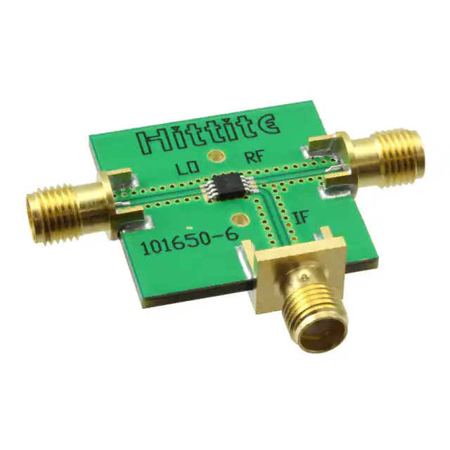

    EVALBOARDFORHMC412
EV1HMC412BMS8G 数据手册
HMC412BMS8GE v02.0417 MIXER - SINGLE & DOUBLE BALANCED - SMT DOUBLE-BALANCED MIXER 8 - 16 GHz Typical Applications Features The HMC412BMS8GE is ideal for: Conversion Loss: 8 dB • Long Haul Radio Platforms Noise Figure: 8 dB • Microwave Radio LO to RF Isolation: 44 dB • VSAT LO to IF Isolation: 38 RF to IF Isolation: 29 dB Input Third-Order Intercept: 19 dB Input Power for 1 dB Compression: 10 dB No External Components MSOP8GE SMT Package Functional Diagram General Description The HMC412BMS8GE is a passive doublebalanced mixer that operates from 8 to 16 GHz. The HMC412BMS8GE operates with LO drive levels between 9 to 15 dBm and provides 8 dB of conversion loss across the entire specified frequency band. This mixer requires no external components or bias. Electrical Specifications, TA = +25 °C, IF = 1.45 GHz, LO Power= +13 dBm, USB [1] Parameter RF Frequency Range Min. Typ. 8 Max. Units 16 GHz LO Frequency Range 8 16 GHz IF Frequency Range DC 2.5 GHz Conversion Loss 8 Noise Figure, Single Sideband (SSB) 8 dB 44 dB LO to RF Isolation LO to IF Isolation 32 RF to IF Isolation Input Third-Order Intercept (IP3) Input Power for 1 dB Compression (P1dB) 15 11 dB 38 dB 29 dB 19 dBm 10 dBm [1] Unless otherwise noted all measurements performed as down-converter with upper sideband selected , IF = 1.45 GHz, RFIN = -5dBm 1 Information furnished by Analog Devices is believed to be accurate and reliable. However, no responsibility is assumed by Analog Devices for its use, nor for any infringements of patents or other rights of third parties that may result from its use. Specifications subject to change without notice. No license is granted by implication or otherwise under any patent or patent rights of Analog Devices. Trademarks and registered trademarks are the property of their respective owners. For price, delivery, and to place orders: Analog Devices, Inc., One Technology Way, P.O. Box 9106, Norwood, MA 02062-9106 Phone: 781-329-4700 • Order online at www.analog.com Application Support: Phone: 1-800-ANALOG-D HMC412BMS8GE v02.0417 DOUBLE-BALANCED MIXER 8 - 16 GHz Down-converter Performance, IF = 1450 MHz Conversion Loss vs. LO Drive RFIN = -5 dBm, USB, Ta = +25C 0 CONVERSION LOSS (dB) CONVERSION LOSS (dB) 0 -5 -10 -15 -20 -5 -10 -15 -20 8 9 10 11 12 13 14 15 16 8 9 10 FREQUENCY (GHz) -40C +25C +85C 12 13 14 +9 dBm +11 dBm 15 16 30 30 25 25 20 +13 dBm +15 dBm Input IP3 vs. LO Drive RFIN = -5 dBm, USB, Ta = +25C IP3 (dBm) IP3 (dBm) 11 FREQUENCY (GHz) Input IP3 vs. Temperature LO = +13 dBm, RFIN = -5 dBm, USB 15 20 15 10 10 8 9 10 11 12 13 14 15 16 8 9 10 FREQUENCY (GHz) -40C 11 12 13 14 15 16 FREQUENCY (GHz) +25C +85C +9 dBm +11 dBm Input IP2 vs. Temperature LO = +13 dBm, RFIN = -5 dBm, USB 90 90 80 80 70 70 60 60 50 50 40 40 30 +13 dBm +15 dBm Input IP2 vs. LO Drive RFIN = -5 dBm, USB, Ta = +25C IP2 (dBm) IP2 (dBm) MIXER - SINGLE & DOUBLE BALANCED - SMT Conversion Loss vs. Temperature LO = +13 dBm, RFIN = -5 dBm, USB 30 8 9 10 11 12 13 14 15 16 8 9 10 FREQUENCY (GHz) -40C +25C 11 12 13 14 15 16 FREQUENCY (GHz) +85C +11 dBm +13 dBm +15 dBm For price, delivery, and to place orders: Analog Devices, Inc., One Technology Way, P.O. Box 9106, Norwood, MA 02062-9106 Phone: 781-329-4700 • Order online at www.analog.com Application Support: Phone: 1-800-ANALOG-D 2 HMC412BMS8GE v02.0417 DOUBLE-BALANCED MIXER 8 - 16 GHz Conversion Loss vs. Temperature LO = +13 dBm, RFIN = -5 dBm, USB Conversion Loss vs. LO Drive RFIN = -5 dBm, USB, Ta = +25C 0 CONVERSION LOSS (dB) CONVERSION LOSS (dB) 0 -5 -10 -15 -20 -5 -10 -15 -20 8 9 10 11 12 13 14 15 16 8 9 10 FREQUENCY (GHz) -40C +25C +85C 13 14 15 16 30 30 25 25 20 +13 dBm +15 dBm Input IP3 vs. LO Drive RFIN = -5 dBm, USB, Ta = +25C IP3 (dBm) IP3 (dBm) 12 +9 dBm +11 dBm 15 20 15 10 10 8 9 10 11 12 13 14 15 16 8 9 10 FREQUENCY (GHz) -40C 11 12 13 14 15 16 FREQUENCY (GHz) +25C +85C +9 dBm +11 dBm Input IP2 vs. Temperature LO = +13 dBm, RFIN = -5 dBm, USB 80 80 70 70 IP2 (dBm) 90 60 +13 dBm +15 dBm Input IP2 vs. LO Drive RFIN = -5 dBm, USB, Ta = +25C 90 60 50 50 40 40 30 30 8 9 10 11 12 13 14 15 16 8 9 10 FREQUENCY (GHz) -40C 3 11 FREQUENCY (GHz) Input IP3 vs. Temperature LO = +13 dBm, RFIN = -5 dBm, USB IP2 (dBm) MIXER - SINGLE & DOUBLE BALANCED - SMT Down-converter Performance, IF = 150 MHz +25C 11 12 13 14 15 16 FREQUENCY (GHz) +85C +11 dBm +13 dBm +15 dBm For price, delivery, and to place orders: Analog Devices, Inc., One Technology Way, P.O. Box 9106, Norwood, MA 02062-9106 Phone: 781-329-4700 • Order online at www.analog.com Application Support: Phone: 1-800-ANALOG-D HMC412BMS8GE v02.0417 DOUBLE-BALANCED MIXER 8 - 16 GHz Input P1dB vs. LO Power USB, Ta = +25C 15 15 14 14 13 13 12 12 P1dB (dBm) P1dB (dBm) Input P1dB vs. Temperature LO Power = +13 dBm, USB 11 10 9 11 10 9 8 8 7 7 6 6 5 5 8 9 10 11 12 13 14 15 8 16 9 10 11 +9 dBm -40C +25C 13 14 15 16 +11 dBm +13 dBm +85C Noise Figure vs. Temperature LO = +13 dBm, RFIN = -5 dBm, USB Noise Figure vs. LO Power RFIN = -5 dBm, USB, Ta = +25C 12 12 10 10 NOISE FIGURE (dB) NOISE FIGURE (dB) 12 FREQUENCY (GHz) FREQUENCY (GHz) 8 6 4 2 8 6 4 2 0 0 8 9 10 11 12 13 14 15 16 8 9 10 FREQUENCY (GHz) -40C 11 12 13 14 15 16 FREQUENCY (GHz) +25C +85C +9 dBm +11 dBm +13 dBm +15 dBm LO to RF, LO to IF, and RF to IF Isolation LO Power = +13 dBm, USB, Ta = +25C 60 MIXER - SINGLE & DOUBLE BALANCED - SMT Down-converter Performance, IF = 1450 MHz ISOLATION (dB) 50 40 30 20 10 0 8 9 10 11 12 13 14 15 16 FREQUENCY (GHz) LO-IF RF-IF LO-RF For price, delivery, and to place orders: Analog Devices, Inc., One Technology Way, P.O. Box 9106, Norwood, MA 02062-9106 Phone: 781-329-4700 • Order online at www.analog.com Application Support: Phone: 1-800-ANALOG-D 4 HMC412BMS8GE v02.0417 DOUBLE-BALANCED MIXER 8 - 16 GHz Input P1dB vs. LO Power USB, Ta = +25C 15 15 14 14 13 13 12 12 P1dB (dBm) P1dB (dBm) Input P1dB vs. Temperature LO Power = +13 dBm, USB 11 10 9 11 10 9 8 8 7 7 6 6 5 5 8 9 10 11 12 13 14 15 8 16 9 10 +9 dBm -40C +25C Noise Figure vs. Temperature LO = +13 dBm, RFIN = -5 dBm, USB 13 14 15 16 +11 dBm +13 dBm Noise Figure vs. LO Power RFIN = -5 dBm, USB, Ta = +25C 12 12 10 10 NOISE FIGURE (dB) NOISE FIGURE (dB) 12 +85C 8 6 4 2 8 6 4 2 0 0 8 9 10 11 12 13 14 15 16 8 9 10 FREQUENCY (GHz) -40C 11 12 13 14 15 16 FREQUENCY (GHz) +25C +85C Noise Figure vs. Temperature LO = +13 dBm, RFIN = -5 dBm, USB +9 dBm +11 dBm 10 10 NOISE FIGURE (dB) 12 8 6 4 +13 dBm +15 dBm Noise Figure vs. LO Power RFIN = -5 dBm, USB, Ta = +25C 12 2 8 6 4 2 0 0 8 9 10 11 12 13 14 15 16 8 9 10 FREQUENCY (GHz) -40C 5 11 FREQUENCY (GHz) FREQUENCY (GHz) NOISE FIGURE (dB) MIXER - SINGLE & DOUBLE BALANCED - SMT Down-converter Performance, IF = 150 MHz +25C 11 12 13 14 15 16 FREQUENCY (GHz) +85C +9 dBm +11 dBm +13 dBm +15 dBm For price, delivery, and to place orders: Analog Devices, Inc., One Technology Way, P.O. Box 9106, Norwood, MA 02062-9106 Phone: 781-329-4700 • Order online at www.analog.com Application Support: Phone: 1-800-ANALOG-D HMC412BMS8GE v02.0417 DOUBLE-BALANCED MIXER 8 - 16 GHz Input IP3 over IF Bandwidth, USB RFIN = -5dBm, LO = 9.5 GHz @ +13 dBm 0 30 -5 25 IP3 (dBm) CONVERSION LOSS (dB) Conversion Loss over IF Bandwidth, USB RFIN = -5dBm, LO = 9.5 GHz @ +13 dBm -10 -15 20 15 -20 0.1 0.6 1.1 1.6 2.1 2.6 3.1 3.6 4.1 4.6 5.1 10 0.1 5.6 0.6 1.1 1.6 IF FREQUENCY (GHz) -40C 2.1 2.6 3.1 3.6 4.1 4.6 5.1 5.6 IF FREQUENCY (GHz) +25C +85C -40C RF and LO Return Loss @ LO = 11 GHz, LO Power = +13 dBm, Ta = +25C +25C +85C IF Return Loss, Ta = +25C 0 0 -5 RETURN LOSS (dB) RETURN LOSS (dB) -5 -10 -15 -20 -25 -30 -35 -10 -15 -20 -25 -30 -35 -40 8 9 10 11 12 13 14 15 16 FREQUENCY (GHz) RF Return Loss IF -40 0.1 0.8 1.5 2.2 2.9 3.5 4.2 4.9 5.6 IF FREQUENCY (GHz) LO Return Loss IF Return Loss For price, delivery, and to place orders: Analog Devices, Inc., One Technology Way, P.O. Box 9106, Norwood, MA 02062-9106 Phone: 781-329-4700 • Order online at www.analog.com Application Support: Phone: 1-800-ANALOG-D MIXER - SINGLE & DOUBLE BALANCED - SMT Down-converter Performance 6 HMC412BMS8GE v02.0417 DOUBLE-BALANCED MIXER 8 - 16 GHz Conversion Loss vs. Temperature LO = +13 dBm, IFIN = -5 dBm, USB Conversion Loss vs. LO Drive IFIN = -5 dBm, USB, Ta = +25C 0 CONVERSION LOSS (dB) CONVERSION LOSS (dB) 0 -5 -10 -15 -20 -5 -10 -15 -20 8 9 10 11 12 13 14 15 16 8 9 10 FREQUENCY (GHz) -40C +25C +85C 13 14 15 16 30 25 25 20 20 15 +13 dBm +15 dBm Input IP3 vs. LO Drive IFIN = -5 dBm, USB, Ta = +25C IP3 (dBm) IP3 (dBm) 12 +9 dBm +11 dBm 30 15 10 10 5 5 0 0 8 9 10 11 12 13 14 15 16 8 9 10 FREQUENCY (GHz) -40C 11 12 13 14 15 16 FREQUENCY (GHz) +25C +85C Input IP2 vs. Temperature LO = +13 dBm, IFIN = -5 dBm, USB +9 dBm +11 dBm 80 70 70 60 60 IP2 (dBm) 90 80 50 40 +13 dBm +15 dBm Input IP2 vs. LO Drive IFIN = -5 dBm, USB, Ta = +25C 90 50 40 30 30 20 20 10 10 0 0 8 9 10 11 12 13 14 15 16 8 9 10 FREQUENCY (GHz) -40C 7 11 FREQUENCY (GHz) Input IP3 vs. Temperature LO = +13 dBm, IFIN = -5 dBm, USB IP2 (dBm) MIXER - SINGLE & DOUBLE BALANCED - SMT Up-converter Performance, IF = 1450 MHz +25C 11 12 13 14 15 16 FREQUENCY (GHz) +85C +9 dBm +11 dBm +13 dBm +15 dBm For price, delivery, and to place orders: Analog Devices, Inc., One Technology Way, P.O. Box 9106, Norwood, MA 02062-9106 Phone: 781-329-4700 • Order online at www.analog.com Application Support: Phone: 1-800-ANALOG-D HMC412BMS8GE v02.0417 DOUBLE-BALANCED MIXER 8 - 16 GHz Conversion Loss vs. Temperature LO = +13 dBm, IFIN = -5 dBm, USB Conversion Loss vs. LO Drive IFIN = -5 dBm, USB, Ta = +25C 0 CONVERSION LOSS (dB) CONVERSION LOSS (dB) 0 -5 -10 -15 -20 -5 -10 -15 -20 8 9 10 11 12 13 14 15 16 8 9 10 FREQUENCY (GHz) -40C +25C +85C 12 13 14 +9 dBm +11 dBm 15 16 30 30 25 25 20 20 15 +13 dBm +15 dBm Input IP3 vs. LO Drive IFIN = -5 dBm, USB, Ta = +25C IP3 (dBm) IP3 (dBm) Input IP3 vs. Temperature LO = +13 dBm, IFIN = -5 dBm, USB 15 10 10 5 5 0 0 8 9 10 11 12 13 14 15 16 8 9 10 FREQUENCY (GHz) -40C 11 12 13 14 15 16 FREQUENCY (GHz) +25C +85C Input IP2 vs. Temperature LO = +13 dBm, IFIN = -5 dBm, USB +9 dBm +11 dBm 90 90 80 80 70 70 60 60 50 40 50 40 30 30 20 20 10 10 0 +13 dBm +15 dBm Input IP2 vs. LO Drive IFIN = -5 dBm, USB, Ta = +25C IP2 (dBm) IP2 (dBm) 11 FREQUENCY (GHz) MIXER - SINGLE & DOUBLE BALANCED - SMT Up-converter Performance, IF = 150 MHz 0 8 9 10 11 12 13 14 15 16 8 9 10 FREQUENCY (GHz) -40C +25C 11 12 13 14 15 16 FREQUENCY (GHz) +85C +9 dBm +11 dBm +13 dBm +15 dBm For price, delivery, and to place orders: Analog Devices, Inc., One Technology Way, P.O. Box 9106, Norwood, MA 02062-9106 Phone: 781-329-4700 • Order online at www.analog.com Application Support: Phone: 1-800-ANALOG-D 8 HMC412BMS8GE v02.0417 DOUBLE-BALANCED MIXER 8 - 16 GHz Harmonics of LO MIXER - SINGLE & DOUBLE BALANCED - SMT nLO Spur @ RF port LO Freq (GHz) 1 2 3 4 63 9 39 35 51 10.5 40 48 51 62 12 46 53 60 N/A 13.5 49 65 52 N/A 15 40 48 N/A N/A 16 39 47 N/A N/A 16.5 35 45 N/A N/A LO = +13 dBm All values in dBc below input LO level @ RF port MxN Spurious Outputs, IF = 1450 MHz MxN Spurious Output, IF = 150 MHz nLO nLO mRF 0 1 2 3 4 mRF 5 1 2 3 4 5 0 X 3.3 32 26 N/A N/A 0 X 10.6 24 23 66 N/A 1 24 N/A 42 34 36 N/A 1 19 N/A 36 30 50 113 2 76 67 69 81 75 64 2 71 61 59 67 67 68 79.1 78 3 79 79 83 66 82 79 3 941 72 78 81 4 N/A N/A 68 78 8 82 4 65 78 80 85 68 82 5 N/A N/A N/A 66 75 81 5 N/A 63 77 79 83 87 RF = 14.45 GHz @ -10 dBm LO = 13 GHz @ +13 dBm, USB All values in dBc relative to the IF. Measured as Down-converter Spurs values are (m x RF) - (n x LO) MxN Spurious Output, IFin = 1450 MHz RF = 9.5 GHz @ -10 dBm LO = 9.65 GHz @ +13 dBm, LSB All values in dBc relative to the IF. Measured as Down-converter Spurs values are (m x RF) - (n x LO) MxN Spurious Output, IFin = 150 MHz nLO nLO mIF 0 1 2 3 4 5 mIF 0 1 2 3 4 5 0 X 8 16 N/A N/A N/A 0 X 9.3 6 21 36.5 N/A 1 26 N/A 34 N/A N/A N/A 1 45.5 N/A 23 48 64 N/A 2 79.3 54.7 71 N/A N/A N/A 2 88 60 50 65 62 N/A 3 87 78 78 N/A N/A N/A 3 89 59 74.5 79 63.5 N/A 4 84.5 82 70 N/A N/A N/A 4 69 82.5 80.5 78 64 N/A 5 81 81 73 N/A N/A N/A 5 91 82.5 78.6 78 65 N/A RFout = 14.45 GHz, IF input power = -10 dBm LO = 15.9 GHz @ +13 dBm, LSB All values in dBc relative to the RFout. Measured as Up-converter Spurs values are (m x IF) - (n x LO) 9 0 RFout = 9.5 GHz @ -10 dBm LO = 9.35 GHz @ +13 dBm, USB All values in dBc relative to the RFout. Measured as Up-converter Spurs values are (m x IF) - (n x LO) For price, delivery, and to place orders: Analog Devices, Inc., One Technology Way, P.O. Box 9106, Norwood, MA 02062-9106 Phone: 781-329-4700 • Order online at www.analog.com Application Support: Phone: 1-800-ANALOG-D HMC412BMS8GE v02.0417 DOUBLE-BALANCED MIXER 8 - 16 GHz Pin Descriptions Function Description 1, 8 GND These pins and the exposed ground paddle must be connected to RF ground. 2 LO This pin is AC coupled and matched to 50 ohms. 3, 4, 6 N/C These pins are not connected internally. 5 IF This pin is DC coupled. For applications not requiring operation to DC, this port shoud be DC blocked externally using a series capacitor whose values has been chosen to pass the necessary IF frequency range. For operation to DC, this pin must not source/sink more than 6 mA of current or die non-funtion and possible die failure will result. 7 RF This pin is AC coupled and matched to 50 ohm. Interface Schematic For price, delivery, and to place orders: Analog Devices, Inc., One Technology Way, P.O. Box 9106, Norwood, MA 02062-9106 Phone: 781-329-4700 • Order online at www.analog.com Application Support: Phone: 1-800-ANALOG-D MIXER - SINGLE & DOUBLE BALANCED - SMT Pin Number 10 HMC412BMS8GE v02.0417 DOUBLE-BALANCED MIXER 8 - 16 GHz MIXER - SINGLE & DOUBLE BALANCED - SMT Evaluation PCB List of Materials for EV1HMC412BMS8G [1] Item Description J1 - J2 PCB Mount SMA RF Connector, SRI J3 PCB Mount SMA Connector, Johnson U1 HMC412BMS8GE MIXER PCB [2] 101650 Evaluation Board [1] Reference this number when ordering complete evaluation PCB [2] Circuit Board Material: Rogers 4350 11 The circuit board used in the application should use RF circuit design techniques. Signal lines should have 50 Ohm impedance while the package ground leads and exposed paddle should be connected directly to the ground plane similar to that shown. A sufficient number of via holes should be used to connect the top and bottom ground planes. The evaluation circuit board shown is available from Analog Devices upon request. For price, delivery, and to place orders: Analog Devices, Inc., One Technology Way, P.O. Box 9106, Norwood, MA 02062-9106 Phone: 781-329-4700 • Order online at www.analog.com Application Support: Phone: 1-800-ANALOG-D HMC412BMS8GE v02.0417 DOUBLE-BALANCED MIXER 8 - 16 GHz LO Input Power +25 dBm RF/IF input Power +25 dBm IF DC Current ±6 mA Channel Temperature 150 °C Continuous Pdiss (T=85 °C) (derate 4.3 mW/°C above 85 °C) 280 mW Thermal Resistance (RTH) (junction to ground paddle) 180 °C/W Operating Temperature -40 to +85 °C Storage Temperature -65 to +150 °C ESD Sensitivity (HBM) 500 V (Class 1B) ESD Sensitivity (FICDM) 1000 V (Class C3) ELECTROSTATIC SENSITIVE DEVICE OBSERVE HANDLING PRECAUTIONS 8-Lead Mini Small Outline Package with Exposed Pad [MINI_SO_EP] (RH-8-4) Dimensions shown in millimeters 3.10 3.00 2.90 1 0.65 BSC 0.95 0.85 0.75 5 5.08 4.90 4.68 4 TOP VIEW BOTTOM VIEW 1.95 BSC 1.10 MAX SIDE VIEW PKG-004854 0.13 MAX COPLANARITY 0.10 1.78 MAX EXPOSED PAD 0.38 0.30 0.22 FOR PROPER CONNECTION OF THE EXPOSED PAD, REFER TO THE PIN CONFIGURATION AND FUNCTION DESCRIPTIONS SECTION OF THIS DATA SHEET. 0.25 GAGE PLANE 6° 0° END VIEW 0.80 0.60 0.40 0.22 0.08 0.95 REF 01-13-2017-A 8 3.10 3.00 2.90 2.41 MAX COMPLIANT TO JEDEC STANDARDS MO-187-AA-T 8-Lead Mini Small Outline Package with Exposed Pad [MINI_SO_EP] (RH-8-4) Dimensions shown in millimeters MIXER - SINGLE & DOUBLE BALANCED - SMT Absolute Maximum Ratings Package Information Part Number Package Body Material Lead Finish HMC412BMS8GE RoHS-compliant Low Stress Injection Molded Plastic 100% matte Sn MSL Rating MSL1 [1] Package Marking [2] 412B XXXX [1] Max peak reflow temperature of 260 °C [2] 4-Digit lot number XXXX For price, delivery, and to place orders: Analog Devices, Inc., One Technology Way, P.O. Box 9106, Norwood, MA 02062-9106 Phone: 781-329-4700 • Order online at www.analog.com Application Support: Phone: 1-800-ANALOG-D 12
