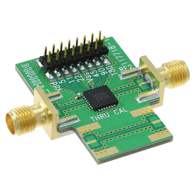

EV1HMC648ALP6 数据手册
HMC648ALP6E v01.0217 Product Type - SMT GaAs MMIC 6-BIT DIGITAL PHASE SHIFTER, 2.9 - 3.9 GHz Typical Applications Features The HMC648ALP6E is ideal for: Low RMS Phase Error: 1.2° • EW Receivers Low Insertion Loss: 5 dB • Weather & Military Radar High Linearity: +45 dBm • Satellite Communications Positive Control Logic • Beamforming Modules 360° Coverage, LSB = 5.625° 28 Lead 6x6mm SMT Package: 36mm² • Phase Cancellation Functional Diagram General Description The HMC648ALP6E is a 6-bit digital phase shifter which is rated from 2.9 - 3.9 GHz, providing 360 degrees of phase coverage, with a LSB of 5.625 degrees. The HMC648ALP6E features very low RMS phase error of 1.2 degrees and extremely low insertion loss variation of ±0.5 dB across all phase states. This high accuracy phase shifter is controlled with positive control logic of 0/+5V. The HMC648ALP6E is housed in a compact 6x6 mm plastic leadless SMT package and is internally matched to 50 Ohms with no external components. Electrical Specifications TA = +25° C, Vss= -5V, Vdd= +5V , Control Voltage= 0/ +5V, 50 Ohm System Parameter Frequency Range Min. Typ. 2.9 Insertion Loss* 5 Input Return Loss* 16 Output Return Loss* 17 Phase Error* ±5 Max. Units 3.9 GHz 8 dB dB dB +10 / -15 deg RMS Phase Error 1.2 deg Amplitude Settling Time (50% cntl to +/- 0.1dB margin of final RFout) 175 nS Phase Settling Time (50% cntl to +/-1 degree margin of final RFout) 125 nS Insertion Loss Variation* ±0.5 dB Input Power for 1 dB Compression 31 dBm Input Third Order Intercept 45 dBm Control Voltage Current 35 250 µA Bias Control Current 5 15 mA *Note: Major States Shown 1 Information furnished by Analog Devices is believed to be accurate and reliable. However, no responsibility is assumed by Analog Devices for its use, nor for any infringements of patents or other rights of third parties that may result from its use. Specifications subject to change without notice. No license is granted by implication or otherwise under any patent or patent rights of Analog Devices. Trademarks and registered trademarks are the property of their respective owners. For price, delivery, and to place orders: Analog Devices, Inc., One Technology Way, P.O. Box 9106, Norwood, MA 02062-9106 Phone: 781-329-4700 • Order online at www.analog.com Application Support: Phone: 1-800-ANALOG-D HMC648ALP6E v01.0217 GaAs MMIC 6-BIT DIGITAL PHASE SHIFTER, 2.9 - 3.9 GHz Insertion Loss, Major States Only Normalized Loss, Major States Only 3 NORMALIZED LOSS (dB) INSERTION LOSS (dB) -2 -4 -6 -8 -10 -12 2.4 2 1 0 -1 -2 -3 2.8 3.2 3.6 4 -4 2.4 4.4 2.8 Input Return Loss, Major States Only PHASE ERROR (degrees) RETURN LOSS (dB) 4.4 4 4.4 4 4.4 15 -10 -15 -20 -25 10 5 0 -5 -10 -15 2.8 3.2 3.6 4 -20 2.4 4.4 2.8 FREQUENCY (GHz) 3.2 3.6 FREQUENCY (GHz) Relative Phase Shift Major States Including All Bits Output Return Loss, Major States Only 0 RELATIVE PHASE SHIFT (degrees) 400 -5 RETURN LOSS (dB) 4 20 -5 -10 -15 -20 -25 -30 2.4 3.6 Phase Error, Major States Only 0 -30 2.4 3.2 FREQUENCY (GHz) FREQUENCY (GHz) Product Type - SMT 4 0 2.8 3.2 3.6 FREQUENCY (GHz) 4 4.4 350 300 250 200 150 100 50 0 2.4 2.8 3.2 3.6 FREQUENCY (GHz) For price, delivery, and to place orders: Analog Devices, Inc., One Technology Way, P.O. Box 9106, Norwood, MA 02062-9106 Phone: 781-329-4700 • Order online at www.analog.com Application Support: Phone: 1-800-ANALOG-D 2 HMC648ALP6E v01.0217 GaAs MMIC 6-BIT DIGITAL PHASE SHIFTER, 2.9 - 3.9 GHz Relative Phase Shift, RMS, Average, Max, All States Input IP3, Major States Only 60 15 55 RMS AVERAGE MAX 10 50 IP3 (dBm) RELATIVE PHASE SHIFT (degrees) 5 45 0 40 -5 35 -10 2.9 3.1 3.3 3.5 3.7 30 2.9 3.9 3.1 3.3 FREQUENCY (GHz) Input P1dB, Major States Only P1dB (dBm) 30 25 20 15 3.1 3.3 3.5 3.7 15 +25C -40C +85C 10 5 0 -5 -10 2.9 3.9 3.1 3.3 FREQUENCY (GHz) 3.7 3.9 Phase Error vs. State 0 20 -2 15 PHASE ERROR (degrees) INSERTION LOSS (dB) 3.5 FREQUENCY (GHz) Insertion Loss vs. Temperature, Major States Only -4 -6 -8 -10 3.1, 3.3, 3.5, 3.7, 3.9 GHz 10 5 0 -5 2.9 GHz -10 -15 3.1 3.3 3.5 FREQUENCY (GHz) 3 3.9 20 35 -12 2.9 3.7 RMS Phase Error vs. Temperature 40 10 2.9 3.5 FREQUENCY (GHz) RELATIVE PHASE SHIFT (degrees) Product Type - SMT 20 3.7 3.9 0 45 90 135 180 225 270 315 360 STATE (degrees) For price, delivery, and to place orders: Analog Devices, Inc., One Technology Way, P.O. Box 9106, Norwood, MA 02062-9106 Phone: 781-329-4700 • Order online at www.analog.com Application Support: Phone: 1-800-ANALOG-D HMC648ALP6E v01.0217 GaAs MMIC 6-BIT DIGITAL PHASE SHIFTER, 2.9 - 3.9 GHz Bias Voltage & Current Input Power (RFIN) 33 dBm (T= +85 °C) Vdd Idd Bias Voltage Range (Vdd) Bias Voltage Range (Vss) -0.2 to +12V 5.0 5.2mA +0.2 to -12V Vss Iss Channel Temperature (Tc) 150 °C -5.0 5.2mA Thermal Resistance (channel to ground paddle) 120 °C/W Storage Temperature -65 to +150 °C Operating Temperature -40 to +85 °C ESD Sensitivity Class1A Passed 250V Control Voltage State Bias Condition Low (0) 0 to 0.2 Vdc High (1) Vdd ±0.2 Vdc @ 35 µA Typ. ELECTROSTATIC SENSITIVE DEVICE OBSERVE HANDLING PRECAUTIONS Truth Table Control Voltage Input Bit 1 Bit 2 Bit 3 Bit 4 Bit 5 Bit 6 Phase Shift (Degrees) RFIN - RFOUT 0 0 0 0 0 0 Reference* 1 0 0 0 0 0 5.625 0 1 0 0 0 0 11.25 0 0 1 0 0 0 22.5 0 0 0 1 0 0 45.0 0 0 0 0 1 0 90.0 0 0 0 0 0 1 180.0 1 1 1 1 1 1 354.375 Product Type - SMT Absolute Maximum Ratings Any combination of the above states will provide a phase shift approximately equal to the sum of the bits selected. *Reference corresponds to monotonic setting For price, delivery, and to place orders: Analog Devices, Inc., One Technology Way, P.O. Box 9106, Norwood, MA 02062-9106 Phone: 781-329-4700 • Order online at www.analog.com Application Support: Phone: 1-800-ANALOG-D 4 HMC648ALP6E v01.0217 GaAs MMIC 6-BIT DIGITAL PHASE SHIFTER, 2.9 - 3.9 GHz Product Type - SMT Outline Drawing NOTES: 1. LEADFRAME MATERIAL: COPPER ALLOY 2. DIMENSIONS ARE IN INCHES [MILLIMETERS]. 3. DIMENSION DOES NOT INCLUDE MOLDFLASH OF 0.15mm PER SIDE. 4. DIMENSION DOES NOT INCLUDE MOLDFLASH OF 0.25mm PER SIDE. 5. ALL GROUND LEADS MUST BE SOLDERED TO PCB RF GROUND. 6. CLASSIFIED AS MOISTURE SENSITIVITY LEVEL (MSL) 3. Package Information Part Number Package Body Material Lead Finish HMC648ALP6E RoHS-compliant Low Stress Injection Molded Plastic 100% matte Sn MSL Rating MSL3 [1] Package Marking [2] H648A XXXX [1] Max peak reflow temperature of 260 °C [2] 4-Digit lot number XXXX 5 For price, delivery, and to place orders: Analog Devices, Inc., One Technology Way, P.O. Box 9106, Norwood, MA 02062-9106 Phone: 781-329-4700 • Order online at www.analog.com Application Support: Phone: 1-800-ANALOG-D HMC648ALP6E v01.0217 GaAs MMIC 6-BIT DIGITAL PHASE SHIFTER, 2.9 - 3.9 GHz Pin Descriptions Function Description 1 Vdd Voltage supply. 2, 20 GND These pins and exposed ground paddle must be connected to RF/DC ground. 3 RFIN This port is DC coupled and matched to 50 Ohms. 4 - 18 N/C The pins are not connected internally; however, all data shown herein was measured with these pins connected to RF/DC ground externally. 19 RFOUT This port is DC coupled and matched to 50 Ohms. 22 - 24, 26 - 28 BIT6, BIT5, BIT4, BIT3, BIT2, BIT1 Control Input. See truth table and control voltage tables. 25 Vss Voltage supply. Interface Schematic For price, delivery, and to place orders: Analog Devices, Inc., One Technology Way, P.O. Box 9106, Norwood, MA 02062-9106 Phone: 781-329-4700 • Order online at www.analog.com Application Support: Phone: 1-800-ANALOG-D Product Type - SMT Pin Number 6 HMC648ALP6E v01.0217 GaAs MMIC 6-BIT DIGITAL PHASE SHIFTER, 2.9 - 3.9 GHz Product Type - SMT Evaluation PCB List of Materials for Evaluation PCB 117720 [1][3] Item Description J1 - J2 PCB Mount SMA RF Connector J3 Header 2mm, 16 Pin C1, C2 1000pF Capacitor, 0402 Pkg. U1 HMC648ALP6E 6-Bit Digital Phase Shifter PCB [2] 117718 Evaluation PCB [1] Reference this number when ordering complete evaluation PCB [2] Circuit Board Material: Rogers 4350 [3] Please refer to part’s pin description and functional diagram for pin out assignments on evaluation board. 7 The circuit board used in the final application should use RF circuit design techniques. Signal lines should have 50 ohm impedance while the package ground leads and exposed paddle should be connected directly to the ground plane similar to that shown. A sufficient number of via holes should be used to connect the top and bottom ground planes. The evaluation board should be mounted to an appropriate heat sink. The evaluation circuit board shown is available from Analog Devices upon request. For price, delivery, and to place orders: Analog Devices, Inc., One Technology Way, P.O. Box 9106, Norwood, MA 02062-9106 Phone: 781-329-4700 • Order online at www.analog.com Application Support: Phone: 1-800-ANALOG-D HMC648ALP6E v01.0217 GaAs MMIC 6-BIT DIGITAL PHASE SHIFTER, 2.9 - 3.9 GHz Product Type - SMT Notes: For price, delivery, and to place orders: Analog Devices, Inc., One Technology Way, P.O. Box 9106, Norwood, MA 02062-9106 Phone: 781-329-4700 • Order online at www.analog.com Application Support: Phone: 1-800-ANALOG-D 8
