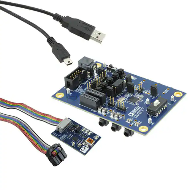

EVAL-ADAU1372Z User Guide UG-807 One Technology Way • P.O. Box 9106 • Norwood, MA 02062-9106, U.S.A. • Tel: 781.329.4700 • Fax: 781.461.3113 • www.analog.com Evaluating the ADAU1372 Quad ADC, Dual DAC, Low Latency, Low Power Codec EVAL-ADAU1372Z PACKAGE CONTENTS EVAL-ADAU1372Z EVALUATION BOARD, TOP SIDE AND BOTTOM SIDE EVAL-ADAU1372Z evaluation board EVAL-ADUSB2EBZ (USBi) communications adapter USB cable with Mini-B plug Evaluation board/software quick start guide DOCUMENTS NEEDED ADAU1372 data sheet AN-1006 Application Note, Using the EVAL-ADUSB2EBZ GENERAL DESCRIPTION This evaluation board provides full access to all analog and digital inputs/outputs on the ADAU1372. The ADAU1372 register can be controlled by Analog Devices, Inc., SigmaStudio™ software, which interfaces to the board via a USB connection. The EVAL-ADAU1372Z can be powered by a single AAA battery, by the USB bus, or by a single 3.8 V to 6 V supply; any of these are regulated to the voltages required on the board. The printed circuit board (PCB) is a 4-layer design, with a single ground plane and a single power plane on the inner layers. The board contains connectors for external microphones and speakers. The master clock can be provided externally or by the on-board 12.288 MHz passive crystal. 12946-001 This user guide explains the design and setup of the EVAL-ADAU1372Z evaluation board. Figure 1. EVAL-ADAU1372Z Evaluation Board, Top Side Note that throughout this application note, multifunction pins, such as SCL/SCLK, are referred to either by the entire pin name or by a single function of the pin, for example, SCLK, when only that function is relevant. 12946-002 Complete specifications for the ADAU1372 are available in the ADAU1372 data sheet available from Analog Devices, and should be consulted in conjunction with this user guide when using the evaluation board. Figure 2. EVAL-ADAU1372Z Evaluation Board, Bottom Side PLEASE SEE THE LAST PAGE FOR AN IMPORTANT WARNING AND LEGAL TERMS AND CONDITIONS. Rev. 0 | Page 1 of 24 UG-807 EVAL-ADAU1372Z User Guide TABLE OF CONTENTS EVAL-ADAU1372Z Package Contents .......................................... 1 Controlling Registers Using SigmaStudio ..................................7 Documents Needed .......................................................................... 1 Using the Evaluation Board .............................................................8 General Description ......................................................................... 1 Power...............................................................................................8 EVAL-ADAU1372Z Evaluation Board, Top Side and Bottom Side ..................................................................................................... 1 Inputs and Outputs .......................................................................8 Revision History ............................................................................... 2 Serial Audio Interface ................................................................ 10 Evaluation Board Block Diagrams ................................................. 3 Communications Header (J1) .................................................. 12 Setting Up the Evaluation Board .................................................... 5 Power-Down ............................................................................... 12 Installing the SigmaStudio Software .......................................... 5 Hardware Description.................................................................... 13 Installing the USBi Drivers ......................................................... 5 Jumpers ........................................................................................ 13 Default Switch and Jumper Settings .......................................... 6 Integrated Circuits (IC) ............................................................. 13 Powering Up the Board ............................................................... 6 LED .............................................................................................. 13 Connecting the Audio Cables ..................................................... 6 Evaluation Board Schematics and Artwork ................................ 14 Setting Up Communications in SigmaStudio........................... 6 Ordering Information .................................................................... 23 Downloading the Default Settings ............................................. 7 Bill of Materials ........................................................................... 23 MPx Pins ..................................................................................... 10 REVISION HISTORY 2/15—Revision 0: Initial Version Rev. 0 | Page 2 of 24 EVAL-ADAU1372Z User Guide UG-807 EVALUATION BOARD BLOCK DIAGRAMS I2C/SPI COMMUNICATIONS HEADER POWER SUPPLY REGULATION POWER/ BYPASS SWITCH MP PINS ANALOG MIC INPUTS ADAU1372 STEREO LINE INPUT DIFFERENTIAL STEREO OUTPUT DIGITAL MIC INPUTS SINGLE-ENDED STEREO OUTPUT SERIAL AUDIO CONNECTOR OSC 12946-003 MASTER CLOCK XTAL OSCILLATOR Figure 3. Functional Block Diagram COMMUNICATIONS HEADER POWER SUPPLY SERIAL AUDIO CONNECTOR PDM DIGITAL MIC INPUTS ANALOG MIC INPUTS MP PINS AND SWITCHES CLOCK XTAL ADAU1372 DIFF STEREO OUTPUT POWER/BYPASS SWITCH SINGLEENDED STEREO OUTPUT Figure 4. Board Layout Block Diagram Rev. 0 | Page 3 of 24 12946-004 STEREO LINE INPUT EVAL-ADAU1372Z User Guide 12946-005 UG-807 Figure 5. Default Jumper and Switch Settings (Solid Black Rectangles Indicate Switch or Jumper Positions) Rev. 0 | Page 4 of 24 EVAL-ADAU1372Z User Guide UG-807 SETTING UP THE EVALUATION BOARD INSTALLING THE SigmaStudio SOFTWARE SigmaStudio must be installed to use the EVAL-ADAU1372Z. Download the latest version of SigmaStudio by completing the following steps: 1. 2. 3. 4. Click Search for the best driver in these locations, select Include this location in the search, and click Browse to find the SigmaStudio 3.x\USB drivers directory (see Figure 8). Create or log into your myAnalog account at analog.com. Download the SigmaStudio software from analog.com/SigmaStudioDownload. Install SigmaStudio by double clicking ADI_SigmaStudioRel-.exe and following the prompts. A computer restart is not required. Consult ez.analog.com/community/dsp/SigmaDSP for answers to any questions. INSTALLING THE USBi DRIVERS Figure 8. Found New Hardware Wizard—Search and Installation Options When the message about Windows logo testing appears, click Continue Anyway (see Figure 9). 12946-006 SigmaStudio must be installed to use the USBi. When SigmaStudio has been properly installed, connect the USBi to an available USB port with the included USB cable. At this point, Windows® XP recognizes the device (see Figure 6) and prompts the user to install drivers. 12946-008 For Windows XP Figure 6. Found New Hardware Notification 12946-009 Click Install from a list or specific location (Advanced) and then click Next (see Figure 7). Figure 9. Hardware Installation—Windows Logo Testing Warning 12946-007 The USBi drivers are now installed. Leave the USBi connected to the PC. Connect the USBi to an available USB port with the included USB cable. At this point, Windows 7 recognizes the device and installs the drivers (see Figure 10). 12946-010 Figure 7. Found New Hardware Wizard—Installation For Windows 7 and Windows Vista Figure 10. USBi Driver Installed Correctly Rev. 0 | Page 5 of 24 UG-807 EVAL-ADAU1372Z User Guide DEFAULT SWITCH AND JUMPER SETTINGS SETTING UP COMMUNICATIONS IN SigmaStudio The J8, J10, J12, and J17 jumpers must be connected, and the J3 jumper must be set to the USB/EXT power setting. The MPx pin jumpers (J9) can be connected as desired to use the MPx push-buttons or switches. The microphone bias jumpers, J11 and J14, can be inserted if microphone bias is needed on Input 0 and Input 1. Start SigmaStudio by double-clicking the shortcut on the desktop. To create a new project, click New Project in the File menu or press CTRL + N. The default view of the new project is called the Hardware Configuration tab. POWERING UP THE BOARD To power up the evaluation board, connect the ribbon cable of the USBi to J1 (CONTROL PORT) of the EVAL-ADAU1372Z. 12946-012 Switch S7 selects whether the board is to be powered up or if audio is to be bypassed from input to output with the board powered down. For normal operation, slide the switch to the left. S1 selects whether the ADAU1372 is powered from 3.3 V or 1.8 V; the default is 3.3 V. When powering the board via the USBi, ensure that the switch on the bottom of the USBi board is set to the correct voltage (1.8 V or 3.3 V). To use the USBi in conjunction with SigmaStudio, select it in the Communication Channels subsection of the toolbox on the left side of the Hardware Configuration tab, and add it to the project space by clicking and dragging it to the right (see Figure 12). Figure 12. Adding the USBi Communication Channel If SigmaStudio cannot detect the USBi on the USB port of the PC, the background of the USB label is red (see Figure 13). This lack of communication can happen when the USBi is not connected or when the drivers are incorrectly installed. CONNECTING THE AUDIO CABLES 12946-013 Connect a stereo audio source to J22 (AIN2/3). Connect headphones or powered speakers to J23 (STEREO OUT). The labels for J22 and J23 are only visible on the bottom of the board (see Figure 11). Figure 13. USBi Not Detected by SigmaStudio 12946-014 If SigmaStudio detects the USBi on the USB port of the PC, the background of the USB label changes to green (see Figure 14). 12946-011 Figure 14. USBi Detected by SigmaStudio Figure 11. Stereo Out (J23), Left, and Stereo Input, AIN2/3 (J22), Right Rev. 0 | Page 6 of 24 EVAL-ADAU1372Z User Guide UG-807 12946-017 To add an ADAU1372 to the project, select it from the Processors (ICs/DSPs) list and drag it to the project space (see Figure 15). Figure 17. Link-Compile-Download Button After the download is complete, the registers for the ADAU1372 can be viewed and changed using SigmaStudio. CONTROLLING REGISTERS USING SigmaStudio 12946-018 12946-015 With SigmaStudio, users can view and change the register settings in real time. Click the IC 1—ADAU1372 Register Control tab on the bottom of the Hardware Configuration window to view and change the registers and to reveal the tabs on the top of the window used to view different groupings of registers (see Figure 18). Figure 15. Adding an ADAU1372 12946-016 To use the USB interface to communicate with the target integrated circuit (IC), connect it by clicking and dragging a wire between the blue pin of the USBi and the green pin of the IC (see Figure 16). The corresponding list of the USBi automatically fills with the default mode and channel for that IC. Figure 16. Connecting the USB Interface to an ADAU1372 IC DOWNLOADING THE DEFAULT SETTINGS The SigmaStudio default settings for the ADAU1372 set up the device to send the analog-to-digital converter (ADC) outputs to the serial ports in two I2S serial streams. The serial input port is routed to the two digital-to-analog converter (DAC) outputs. To update all of the registers with the default settings, click the Link-Compile-Download button once in the main toolbar of SigmaStudio (see Figure 17). Alternately, press F7. Figure 18. Hardware Configuration—Register Control in SigmaStudio Clicking any of these register setting buttons or changing a dropdown box immediately changes the register setting. There is no need to click the Link-Compile-Download button again. The Link-Compile-Download button is useful for transferring all of the settings shown on every tab to the ADAU1372 with one click. Transferring the settings is a good thing to do when the device is first powered up. Until the Link-Compile-Download button is clicked, the settings of the device do not necessarily reflect the settings shown in SigmaStudio. Alternatively, use the Read All Registers button to read the state of the device and update all of the objects in SigmaStudio. This button is often hidden from view and requires the user to scroll down to the bottom of the window. The Link-Compile-Download button is useful when working on hardware changes to quickly return the device to a known state after cycling the power. The Capture window at the very bottom of the SigmaStudio window shows the registers that are being written when a control is activated. One other detail about the link-compile-download function is that it properly sets the phase-locked loop (PLL) and main clock controls in the proper order to allow the PLL to lock and start up the internal clocks. The user is not required to select the proper sequence of controls to start up the ADAU1372. Rev. 0 | Page 7 of 24 UG-807 EVAL-ADAU1372Z User Guide USING THE EVALUATION BOARD Microphone Bias Power can be supplied to the EVAL-ADAU1372Z in one of three ways. When Jumper J3 is in the USB/EXT position, power can be supplied by connecting the EVAL-ADUSB2EBZ (USBi) board to J1 (see Figure 19) or by connecting a tip positive 3.8 V dc to 6 V dc power supply on J2. To add MBIAS0 to AIN0, connect a jumper to the J11 header. Similarly, MBIAS1 or MBIAS0 can be added to AIN1 by connecting a jumper to the J14 header (see Figure 21). 12946-019 POWER Figure 19. Header J1, Control Port 12946-021 To supply power via a 1.5 V battery, J3 must be set to the BATT position, and the battery must be connected to J5. The on-board regulator generates the 3.3 V dc or 1.8 V dc supply, determined by S1, for the on-board circuitry. LED D1 lights up when power is supplied to the board. To connect power to the ADAU1372, connect the J8, J10, J12, and J17 jumpers (see Figure 20). Figure 21. Microphone Bias Headers 12946-020 Enable the microphone bias circuitry in the PGA/ADC tab of SigmaStudio to use it. The appropriate gain settings can also be chosen in this tab (see Figure 22). Figure 20. Power Jumpers The EVAL-ADAU1372Z has multiple audio input and output options, including digital and analog. There are four single-ended analog inputs that are configurable as microphone or line inputs, dual stereo digital microphone inputs, and two differential outputs that can also be used in a single-ended configuration. Analog Microphone Inputs 12946-022 INPUTS AND OUTPUTS Figure 22. Microphone Bias Enable and Gain Stereo Line Input The stereo input jack, J22, accepts a standard stereo TRS 1/8 inch mini-plug (tip is left, ring is right) with two channels of audio. For microphone signals, the ADAU1372 analog inputs can be configured as single-ended inputs with an optional programmable gain amplifier (PGA) mode. Rev. 0 | Page 8 of 24 EVAL-ADAU1372Z User Guide UG-807 Digital Microphones Pulse density modulated (PDM) digital microphones can be connected to standard 0.100 inch headers (J6 and J7). For example, the ADMP521 digital microphone from InvenSense plugs directly into the header. Next, set the input of the ADAU1372 to be the digital microphones instead of the ADCs by selecting the appropriate decimator source settings. Click the PGA/ADC tab to find and set the decimator source as shown in Figure 25. 12946-025 To use the digital microphone headers on the EVAL-ADAU1372Z, ensure that the proper settings are selected in SigmaStudio. Click the Pin/Pad Control tab. Change the value of the CLKOUT/ ADC_SDATA1/MP6 menu to Clock Output (see Figure 23). Figure 25. Decimator Source 12946-023 The digital microphones can then be routed via the appropriate inputs on the audio input cell. Figure 23. Pin/Pad Control—MP6, Clock Output The headphone output, J23, connects to any standard 1/8 inch mini-plug stereo headphones. By setting the HP_EN_L and HP_EN_R bits in the headphone line output select register (Address 0x43), the output pins can be driven either by a line output driver or by a headphone driver. Headphones can be driven either as single-ended or differential outputs, and there are bits to disable the LN and RN pins if single-ended. 12946-024 To set the value of BCLK, click the PLL & Clock Control tab and change the value of the Output Clock Frequency menu to the desired division on the internal master clock (MCLK) (see Figure 24). Headphone Output Figure 24. Clock Output Enabled/Divided Rev. 0 | Page 9 of 24 UG-807 EVAL-ADAU1372Z User Guide Line Outputs The analog output pins, J19 and J21, can be used to drive differential loads. In their default settings, these pins can drive line loads of 10 Ω or greater. 12946-027 To use an external speaker, wires can be soldered to the unpopulated header pads, J13 and J16 (see Figure 26). 12946-026 Figure 27. Pin/Pad Control—Menus for MPx Pins Figure 26. Unpopulated J13 and J16 Headers MPx PINS The MPx pin jumpers, Header J9, provide access to the MPx pins (MP0, MP1, MP4, MP5, and MP6) of the ADAU1372, as well as facilitate the use of the push-buttons on the EVAL-ADAU1372Z evaluation board. See Figure 37 for the pinout of the header. These jumpers are used to enable the use of the volume control, mute, and other capabilities of the ADAU1372. The MP4 and MP5 pins are connected to the digital microphone headers, J6 and J7, respectively. The MP6 pin also connects to both J6 and J7. SERIAL AUDIO INTERFACE Serial audio signals in I2S, left justified, right justified, or timedivision multiplexing (TDM) format are available via the serial audio interface header, J4. This header also includes master clock input and output connection pins. To use MCLK on the J4 header, first install a resistor across the R2 pads. The R2 resistor is not populated from the factory. To use an external MCLK, remove the R3 resistor from the board to eliminate contention from the crystal oscillator on the MCLK line (see Figure 28). 12946-028 To use the full functionality of the MPx pins on the ADAU1372, change the selections in the menus under the Pin/Pad Control tab in the Hardware Configuration/ADAU1372 Register Control section of SigmaStudio. An example is shown in Figure 27. Figure 28. R2 and R3 Rev. 0 | Page 10 of 24 EVAL-ADAU1372Z User Guide UG-807 TDM/I2S Stream 12946-029 To use the serial audio outputs, connect the LRCLK, BCLK, and SDATA lines to the appropriate MPx pins on the evaluation board. The connections are located on the J4 header. The silk screen above the header helps identify where to connect the clocks and data (see Figure 29). After connecting, use SigmaStudio to set the registers for the desired operation. In the Output/Serial Port tab, under the Serial Port Control section, the settings can be manipulated to create the specific data stream desired. These settings include serial port FS (sample rate), serial port mode, serial port format, LRCLK/BCLK mode (slave or master), BCLK data change edge, bit width in TDM mode, BCLK cycles per channel, data input/ output on LSB/MSB, unused TDM outputs, LRCLK mode (as pulse or 50% duty cycle), and LRCLK polarity (see Figure 30). 12946-030 Figure 29. Serial Audio Port Figure 30. Serial Port Control 12946-031 When using TDM mode, ensure that the appropriate TDM output channels are enabled in the TDM Output Channel section (see Figure 31). Figure 31. TDM Output Channel Rev. 0 | Page 11 of 24 UG-807 EVAL-ADAU1372Z User Guide Use the Signal Routing tab to route the ADCs or serial inputs to either of the two available serial output lines. Ensure that quad output asynchronous sample rate converter (ASRC) is enabled (see Figure 32). J1 connects to the EVAL-ADUSB2EBZ USBi. More information about the USBi can be found in the AN-1006 Application Note. The IC defaults to I2C mode; however, it can be put into serial peripheral interface (SPI) control mode by pulling the SS pin low three times. POWER-DOWN The power-down header, J15 (/PD), on the silkscreen of the board provides access to the power-down pin, PD, on the ADAU1372. Put a jumper on the header to power down all analog and digital circuits. Before enabling the PD pin, mute the outputs to avoid any pops or clicks when the IC is powered down (see Figure 33). Figure 32. Signal Routing 12946-033 12946-032 When using the serial input port, ensure that the input ASRC is enabled and select which TDM slots or I2S slots are output to the appropriate DAC outputs. The serial input stream can also be routed to the serial output stream, which allows the daisychaining of other ADC data into a TDM, 8-channel stream. COMMUNICATIONS HEADER (J1) Figure 33. Power-Down Header J15 Rev. 0 | Page 12 of 24 EVAL-ADAU1372Z User Guide UG-807 HARDWARE DESCRIPTION JUMPERS Table 1. Connector and Jack Descriptions Reference J1 J2 J3 Functional Name Control port 5 V dc input Power select J4 J5 J6, J7 J8 Serial audio Battery 1.5 V Digital microphone inputs IOVDD 1372_IOVDD J9 J10 MPx pin jumpers IOVDD VDD J11, J14 J12 J13 J15 J16 J17 Microphone bias DVDD regulator (REG) Out R Power down Out L VDD AVDD Description The header facilitates communication between the evaluation board and USBi board. The connector provides external power to the board and accepts 3.8 V dc to 6 V dc input. The jumper is used to select power source for the evaluation board, selectable between USB/external and battery. The header accepts serial audio signals in I2S, left justified, right justified, or TDM format. The jumper used to power the board via a 1.5 V battery. Headers that allow digital microphones to be connected to the evaluation board. The jumper supplies power to the IOVDD supply of the ADAU1372 from the power supply section. The jumpers used to connect push-buttons on the board to MPx pins on the ADAU1372. The jumper connects IOVDD on the ADAU1372 to VDD (3.3 V board supply) on the evaluation board. The jumpers used to add a microphone bias to the analog microphone inputs, AIN0 and AIN1. The jumper connects DVDD on the ADAU1372 to its internal regulator. The jumper provides access to the mono differential right channel output. The jumper used to power down the ADAU1372 analog and digital circuits. The jumper provides access to the mono differential left channel output. The jumper connects AVDD on the ADAU1372 to VDD (3.3 V board supply) on the evaluation board. INTEGRATED CIRCUITS (IC) Table 2. IC Descriptions Reference U1 U3 U4 Functional Name ADAU1372 codec ADP1713AUJZ low dropout (LDO) regulator ADP1607 boost regulator Description The codec being evaluated Linear regulator that generates 1.5 V from an off board power supply Boost regulator that generates 1.8 V or 3.3 V for the board supply from a 1.5 V input LED Table 3. LED Description Reference D1 Functional Name VDD power LED Description The LED illuminates when the evaluation board is powered up. Rev. 0 | Page 13 of 24 C4 0 C3 7 J2 2 C8 4 7 .0 u F R5 0 2k00 C1 4 7 .0 u F J1 4 A B R4 8 0 R0 0 2k00 R4 5 J1 1 R4 4 2k00 R4 7 49k9 R4 2 R4 1 49k9 0 R0 0 C3 8 O PE N C1 6 Figure 34. EVAL-ADAU1372Z Evaluation Board Schematic—Digital and Analog Input/Output, Master Clock Generation 10uF C1 8 10uF AIN3P AIN2P 0 R0 0 R5 2 49k9 R5 5 49k9 RI G H T_ I N R5 4 0 R0 0 R5 3 LEFT_ I N 49 k 9 r esist or s on in pu t s r efer en ce AC cou pli n g capacit or s t o gr oun d pr ev en t in g pops w h en 'h ot - plu gg in g' in pu t s. Not n ecessar y f or h ar dw ir ed design 2 .2 u F 2 .2 u F S t er eo A n alog I n pu t s 2 & 3 J2 0 A n alog I n pu t 1 M I CB I A S1 M I CB I A S0 J1 8 An alog I n pu t 0 C3 4 2 .2 u F C4 6 O PE N C4 3 O PE N C1 0 4 7 .0 u F C3 3 O PE N 10uF C1 9 10uF C1 7 C2 4 7 .0 u F IOVDD R1 0 J1 5 AIN3P C4 1 10uF A P PL Y S H U N T F O R / PD 1 .0 u F C3 9 1k00 AIN2P M I CB I A S0 M I CB I A S1 D M I C _2 _ 3 D M I C _0 _ 1 C1 3 0 .1 0 u F 0 .1 0 u F 12 27 17 18 15 16 13 14 8 9 6 7 36 37 C9 C7 C3 6 0 .1 0 u F 10uF REG J1 2 DVDD 28 DVDD CM PD A I N 3 REF AIN3 A I N 2 REF AIN2 A I N 1 REF AIN1 A I N 0 REF AIN0 M I CBI A S 0 M I CBI A S 1 1772 _ I O V D D C6 C1 4 C1 2 0 .1 0 u F 0 .1 0 u F C1 1 C4 2 0 .1 0 u F 10uF 0 .1 0 u F C3 5 T P5 10uF J1 7 H PO U T L P/ L O U T L P H PO U T R P/ L O U T R P H PO U T L N / L O U T L N X TA LI / M CLK I N X TA LO LRCLK B CLK D A C _ S D A T A / M P0 A D C _ S D A T A 0 / M P1 A D C _ S D A T A 1 / C L K O U T / M P6 SDA/ MISO S CL/ S CLK A DD R1 / M O S I A D D R0 / SS DGND U1 A D A U 137 2 B C PZ H PO U T R N / L O U T R N D M I C 2_ 3 / M P5 D M I C 0_ 1 / M P4 REG _ O U T 24 J8 AGND 11 DGND 30 29 DVDD 19 AVDD 10 AVDD 40 20 39 38 31 32 33 34 35 1 2 3 4 5 25 26 21 22 R7 R5 3 3 R2 3 3 R2 3 3 R2 3 3 R2 3 3 R2 SDA/ MISO S CL/ S CLK A D DR1 / M O S I A D DR0 / S S R8 R6 R4 R2 O PE N C3 22 pF EX T_ M CLK 22 pF C5 Y1 1 2 . 28 8 M H z R3 10 0 R A D C _ S D A T A 1 / C L K O U T / M P6 LRCLK B CLK D A C _ S D A T A / M P0 A D C _ S D A T A 0 / M P1 0 R0 0 0 R0 0 0 R0 0 0 R 0R 01 1 R9 + IOVDD AGND R1 2 R1 3 49k9 R5 7 C4 5 47 0 u F C4 4 47 0 u F AVDD EP 41 AGND 23 Rev. 0 | Page 14 of 24 + M I CB I A S0 O PE N O PE N C4 S7 11 8 5 2 R4 3 O PE N R4 6 O PE N J1 3 J2 3 EVALUATION BOARD SCHEMATICS AND ARTWORK S T E R E O O U T PU T B RD _ RES ET J2 1 J1 9 M o n o D i ff e r e n t i a l O u t p u t R i g h t R5 6 49k9 10 12 7 9 6 4 3 1 R5 1 O PE N 4 PD T _ S L I D E _ B B M LEFT_ I N R4 9 O PE N J1 6 M o n o D i ff e r e n t i a l O u t p u t L e f t RI G H T_ I N C1 5 12946-034 IOVDD VDD UG-807 EVAL-ADAU1372Z User Guide EVAL-ADAU1372Z User Guide UG-807 PD M D i g i t a l M i cr o p h o n e I n p u t s D M I C1 D M I C0 I OVDD 10 k0 R3 2 11 9 7 5 3 1 POLARI Z I NGPLUG 12 10 8 6 4 2 DMI C_ 0 _ 1 R3 3 R3 0 10 k0 ADC_ SDATA1 / CLKOUT/ MP6 POLARI Z I NGPLUG 1 0 0 R M1 M2 J6 SOCKET_ 1 2 W AY_ UNSH ROUD D M I C3 D M I C2 I OVDD R3 5 10 k0 POLARI Z I NGPLUG 11 9 7 5 3 1 12 10 8 6 4 2 DMI C_ 2 _ 3 R3 4 R3 1 10 k0 ADC_ SDATA1 / CLKOUT/ MP6 POLARI Z I NGPLUG 1 0 0 R M3 M4 12946-035 J7 SOCKET_ 1 2 W AY_ UNSH ROUD Figure 35. EVAL-ADAU1372Z Evaluation Board Schematic—PDM Digital Microphone Interface S e r i a l A u d i o I n t e r f a ce R2 9 LRCLK 49 R9 BCLK DAC_ SDATA/ MP0 ADC_ SDATA0 / MP1 ADC_ SDATA1 / CLKOUT/ MP6 HEADER_12 WAY_ UNSHROUD 2 1 4 3 6 5 8 7 10 9 12 11 J4 Figure 36. EVAL-ADAU1372Z Evaluation Board Schematic—Serial Audio Interface Rev. 0 | Page 15 of 24 12946-036 EXT_ MCLK UG-807 EVAL-ADAU1372Z User Guide I OVDD R4 0 10 k0 R3 9 10k0 R3 8 10k0 R3 7 10k0 R3 6 10 k0 C3 2 0 .10 u F S4 V o l u m e - ( M P6 ) S6 J9 H EA D ER_ 1 0 W A Y_ U N S H RO U D 1 3 5 7 9 A D C_ S D A TA 1 / CLK O U T/ M P6 A D C_ S D A TA 0 / M P1 D A C_ S D A TA / M P0 D M I C_ 0 _ 1 D M I C_ 2 _ 3 V O L+ ( M P1 ) 2 4 6 8 10 S5 ( M P0 ) S3 ( M P4 ) M P PI N JU M PERS S8 12946-037 ( M P5 ) Figure 37. EVAL-ADAU1372Z Evaluation Board Schematic—MPx Pin Jumpers USB_5 V 2 EN R25 10 k0 7 C2 3 10 n F VDD FB J10 3 R28 1 62 k C2 4 V DD S EL S1 R26 R1 1 00 R 1 V8 BRD_RESET C3 0 10 uF C26 J5 1 37 k C29 0.10 u F TP3 5 SW U4 VOUT 6 VI N GND 1 B A TT RAPC7 22 X EPAD U S B / EX T 4 2 3 1 I OVDD TP4 ADP1 6 07 ACPZ- R7 J3 A B EXT_5 V 10 u F C27 SPDT C2 8 0 .10 uF TP7 TP6 3 V3 C31 10 u F 0 .10 uF R2 7 3 74 k TP2 TP1 C20 0 .10 uF D1 B a tt e r y I n p u t 1 .5 V Max im u m C2 1 0 .10 uF Plan e Decou pli n g Figure 38. EVAL-ADAU1372Z Evaluation Board Schematic—Power Supply IOVDD IOVDD Co n t r o l Po r t I n t e r f a ce USB_5 V R2 1 O PEN R1 4 2k67 S CL/ S CLK R2 2 1 3 5 7 9 A D D R0 / S S R1 7 O PEN O PEN O PEN I OVDD C2 2 0 .1 0 u F R1 5 2k67 R1 6 SDA/ MISO J1 2 4 6 8 10 H EA D ER_ 1 0 W A Y_ PO L R2 0 B RD _ RES ET O PEN R1 9 A D D R1 / M O S I O PEN R1 8 10 k0 R2 3 10 k0 2 I C Mode S CL R1 4 SDA R1 5 A DD R0 R23 / R2 1 A DD R1 R18 / R2 0 C47 0 .10 uF S PI M o d e S C LK R1 7 MOSI R1 9 SS R2 2 MISO R1 6 C o n t r o l Po r t Pi n s 1 : S CL 2 : O PE N 3 : SDA 4 : USB_5 V 5 : MISO 6 : B R D _ R ES E T 7 : S C LK 8 : MOSI 9 : SS 10 : GND Figure 39. EVAL-ADAU1372Z Evaluation Board Schematic—Control Port Interface Rev. 0 | Page 16 of 24 C4 8 0 .10 uF Gr een Diff used 12946-039 J2 2 .2 u H PW R S E L ADP1 7 13 AUJZ - 1 .5 - R7 1 5 IN OUT 3 4 EN BYP GND U3 2 12946-038 L1 D2 D3 UG-807 12946-040 EVAL-ADAU1372Z User Guide Figure 40. EVAL-ADAU1372Z Evaluation Board Layout—Top Assembly Rev. 0 | Page 17 of 24 EVAL-ADAU1372Z User Guide 12946-041 UG-807 Figure 41. EVAL-ADAU1372Z Evaluation Board Layout—Top Copper Rev. 0 | Page 18 of 24 UG-807 12946-042 EVAL-ADAU1372Z User Guide Figure 42. EVAL-ADAU1372Z Evaluation Board Layout—Power Plan, Layer 3 Rev. 0 | Page 19 of 24 EVAL-ADAU1372Z User Guide 12946-043 UG-807 Figure 43. EVAL-ADAU1372Z Evaluation Board Layout—Ground Plane, Layer 2 Rev. 0 | Page 20 of 24 UG-807 12946-044 EVAL-ADAU1372Z User Guide Figure 44. EVAL-ADAU1372Z Evaluation Board Layout—Bottom Copper Rev. 0 | Page 21 of 24 EVAL-ADAU1372Z User Guide 12946-045 UG-807 Figure 45. EVAL-ADAU1372Z Evaluation Board Layout—Bottom Assembly Rev. 0 | Page 22 of 24 EVAL-ADAU1372Z User Guide UG-807 ORDERING INFORMATION BILL OF MATERIALS Table 4. Qty. 16 1 1 1 3 1 2 3 2 5 1 2 4 6 1 1 Designator C6 to C7, C9, C11 to C14, C20 to C22, C28 to C30, C32, C47 to C48 R9, R11 to R13, R42, R48, R53 to R54 C24 C39 R30, R31 R3 R1 R18, R23, R25, R32 to R40 C23 C16 to C19, C26 to C27, C31, C35 to C36, C41 to C42 R26 R28 R10 C34, C37, C40 L1 C3, C5 R44 to R45, R50 R14 to R15 R4 to R8 R27 C44 to C45 C1 to C2, C8, C10 R41, R47, R52, R55 to R57 R29 S7 1 1 1 1 1 1 Y1 U1 U4 U3 J1 J9 137 kΩ chip resistor, 1%, 63 mW, thick film, 0402 162 kΩ chip resistor, 1%, 63 mW, thick film, 0402 1.00 kΩ chip resistor, 1%, 63 mW, thick film, 0402 2.2 µF multilayer ceramic, 10 V, X7R, 0603 2.2 µH inductor 22 pF multilayer ceramic, 50 V, NP0, 0402 2.00 kΩ chip resistor, 1%, 63 mW, thick film, 0402 2.67 kΩ chip resistor, 1%, 63 mW, thick film, 0402 33.2 Ω chip resistor, 1%, 63 mW, thick film, 0402 374 kΩ chip resistor, 1%, 63 mW, thick film, 0402 470 µF SMD tantalum capacitor, SMD D, 6.3 V 47.0 µF ceramic capacitor, 6.3 V, X7R, 1210 49.9 kΩ chip resistor, 1%, 63 mW, thick film, 0402 49.9 kΩ chip resistor, 1%, 63 mW, thick film, 0402 Four-pole, double-throw slide switch vertical break-before-make 12.288 MHz crystal, SMT, 18 pF Quad ADC, dual DAC codec Synchronous boost dc-to-dc converter Fixed low dropout voltage regulator 10-way shroud polarized header, 2 × 5 10-way unshrouded jumper, 2 × 6 1 J4 12-way unshrouded jumper 7 J5, J8, J10 to J12, J15, J17 2 J3, J14 2-pin header, unshrouded jumper, 0.10 inch; use shunt Tyco 881545-2 Three-position SIP header 1 2 6 10 D1 D2 to D3 J18 to J23 R16 to R17, R19 to R22, R43, R46, R49, R51 R2 C4, C15, C33, C38, C43, C46 J2 8 1 1 2 1 1 12 1 11 1 6 1 Description 0.10 µF multilayer ceramic, 16 V, X7R (0402) Part Number ECJ-0EX1C104K Manufacturer Panasonic EC 0 Ω chip resistor, 5%, 63 mW, thick film, 0402 ERJ-2GE0R00X Panasonic EC 1.0 µF multilayer ceramic, 16 V, X7R, 0603 1.0 µF multilayer ceramic, 16 V, X7R, 0603 100 Ω chip resistor, 1%, 63 mW, thick film, 0402 100 Ω chip resistor, 1%, 100 mW, thick film, 0603 100 Ω chip resistor, 1%, 125 mW, thick film, 0805 10 kΩ chip resistor, 1%, 63 mW, thick film, 0402 10 nF multilayer ceramic, 25 V, NP0, 0603 10 µF multilayer ceramic, 10 V, X7R, 0805 GRM188R71C105KA12D EMK107BJ105KA-TR MCR01MZPF1000 ERJ-3EKF1000V ERJ-6ENF1000V MCR01MZPF1002 C1608C0G1E103J GRM21BR71A106KE51L Murata ENA Taiyo Yuden Rohm Panasonic EC Panasonic EC Rohm TDK Corporation Murata ENA ERJ-2RKF1373X ERJ-2RKF1623X ERJ-2RKF1001X GRM188R71A225KE15D LQH32PN2R2NN0L GRM1555C1H220JZ01D ERJ-2RKF2001X CRCW04022K67FKED RMCF0402FT33R2 ERJ-2RKF3743X TR3D477M6R3C0200 GCM32ER70J476KE19L CRCW040249K9FKED MCR01MZPF49R9 ASE4204 Panasonic ECG Panasonic ECG Panasonic EC Murata ENA Murata Electronics Murata ENC Panasonic EC Vishay/Dale Stackpole Panasonic ECG Vishay/Sprague Murata Vishay/Dale Rohm Tyco Electronics Green diffused, 10 millicandela, 565 nm, 1206 Schottky, 30 V, 0.5 A, SOD123 diode Stereo mini jack Do not stuff ABM3B-12.288MHZ-10-1-U-T ADAU1372BCPZ ADP1607ACPZ-R7 ADP1713AUJZ-1.5-R7 N2510-6002RB PBC05DAAN or cut PBC36DAAN PBC06DAAN or cut PBC36DAAN PBC02SAAN; or cut PBC36SAAN PBC03SAAN; or cut PBC36SAAN SML-LX1206GW-TR MBR0530T1G SJ-3523-SMT Open Abracon Corporation Analog Devices Analog Devices Analog Devices 3M Sullins Connector Solutions Sullins Connector Solutions Sullins Connector Solutions Sullins Connector Solutions Lumex Opto On Semiconductor CUI, Inc. Do not stuff Do not stuff Do not stuff Mini power jack, 0.08 inch, R/A, TH Open Open RAPC722X Do not stuff Do not stuff Switchcraft Rev. 0 | Page 23 of 24 UG-807 Qty. 2 1 5 7 2 Designator J6 to J7 S1 S3to S6. S8 TP1 to TP7 J13, J16 EVAL-ADAU1372Z User Guide Description 12-way socket unshrouded, 2 × 6 Single-pole, double-throw slide switch PC mount Tact switch long stroke (normally open) Mini test point, white, 0.1 inch, OD Do not stuff Part Number PPPC062LFBN-RC EG1271 B3M-6009 5002 Open Manufacturer 3M E-Switch Omron Electronics Keystone Electronics Do not stuff I2C refers to a communications protocol originally developed by Philips Semiconductors (now NXP Semiconductors). ESD Caution ESD (electrostatic discharge) sensitive device. Charged devices and circuit boards can discharge without detection. Although this product features patented or proprietary protection circuitry, damage may occur on devices subjected to high energy ESD. Therefore, proper ESD precautions should be taken to avoid performance degradation or loss of functionality. Legal Terms and Conditions By using the evaluation board discussed herein (together with any tools, components documentation or support materials, the “Evaluation Board”), you are agreeing to be bound by the terms and conditions set forth below (“Agreement”) unless you have purchased the Evaluation Board, in which case the Analog Devices Standard Terms and Conditions of Sale shall govern. Do not use the Evaluation Board until you have read and agreed to the Agreement. Your use of the Evaluation Board shall signify your acceptance of the Agreement. This Agreement is made by and between you (“Customer”) and Analog Devices, Inc. (“ADI”), with its principal place of business at One Technology Way, Norwood, MA 02062, USA. Subject to the terms and conditions of the Agreement, ADI hereby grants to Customer a free, limited, personal, temporary, non-exclusive, non-sublicensable, non-transferable license to use the Evaluation Board FOR EVALUATION PURPOSES ONLY. Customer understands and agrees that the Evaluation Board is provided for the sole and exclusive purpose referenced above, and agrees not to use the Evaluation Board for any other purpose. Furthermore, the license granted is expressly made subject to the following additional limitations: Customer shall not (i) rent, lease, display, sell, transfer, assign, sublicense, or distribute the Evaluation Board; and (ii) permit any Third Party to access the Evaluation Board. As used herein, the term “Third Party” includes any entity other than ADI, Customer, their employees, affiliates and in-house consultants. The Evaluation Board is NOT sold to Customer; all rights not expressly granted herein, including ownership of the Evaluation Board, are reserved by ADI. CONFIDENTIALITY. This Agreement and the Evaluation Board shall all be considered the confidential and proprietary information of ADI. Customer may not disclose or transfer any portion of the Evaluation Board to any other party for any reason. Upon discontinuation of use of the Evaluation Board or termination of this Agreement, Customer agrees to promptly return the Evaluation Board to ADI. ADDITIONAL RESTRICTIONS. Customer may not disassemble, decompile or reverse engineer chips on the Evaluation Board. Customer shall inform ADI of any occurred damages or any modifications or alterations it makes to the Evaluation Board, including but not limited to soldering or any other activity that affects the material content of the Evaluation Board. Modifications to the Evaluation Board must comply with applicable law, including but not limited to the RoHS Directive. TERMINATION. ADI may terminate this Agreement at any time upon giving written notice to Customer. Customer agrees to return to ADI the Evaluation Board at that time. LIMITATION OF LIABILITY. THE EVALUATION BOARD PROVIDED HEREUNDER IS PROVIDED “AS IS” AND ADI MAKES NO WARRANTIES OR REPRESENTATIONS OF ANY KIND WITH RESPECT TO IT. ADI SPECIFICALLY DISCLAIMS ANY REPRESENTATIONS, ENDORSEMENTS, GUARANTEES, OR WARRANTIES, EXPRESS OR IMPLIED, RELATED TO THE EVALUATION BOARD INCLUDING, BUT NOT LIMITED TO, THE IMPLIED WARRANTY OF MERCHANTABILITY, TITLE, FITNESS FOR A PARTICULAR PURPOSE OR NONINFRINGEMENT OF INTELLECTUAL PROPERTY RIGHTS. IN NO EVENT WILL ADI AND ITS LICENSORS BE LIABLE FOR ANY INCIDENTAL, SPECIAL, INDIRECT, OR CONSEQUENTIAL DAMAGES RESULTING FROM CUSTOMER’S POSSESSION OR USE OF THE EVALUATION BOARD, INCLUDING BUT NOT LIMITED TO LOST PROFITS, DELAY COSTS, LABOR COSTS OR LOSS OF GOODWILL. ADI’S TOTAL LIABILITY FROM ANY AND ALL CAUSES SHALL BE LIMITED TO THE AMOUNT OF ONE HUNDRED US DOLLARS ($100.00). EXPORT. Customer agrees that it will not directly or indirectly export the Evaluation Board to another country, and that it will comply with all applicable United States federal laws and regulations relating to exports. GOVERNING LAW. This Agreement shall be governed by and construed in accordance with the substantive laws of the Commonwealth of Massachusetts (excluding conflict of law rules). Any legal action regarding this Agreement will be heard in the state or federal courts having jurisdiction in Suffolk County, Massachusetts, and Customer hereby submits to the personal jurisdiction and venue of such courts. The United Nations Convention on Contracts for the International Sale of Goods shall not apply to this Agreement and is expressly disclaimed. ©2015 Analog Devices, Inc. All rights reserved. Trademarks and registered trademarks are the property of their respective owners. UG12946-0-2/15(0) Rev. 0 | Page 24 of 24
