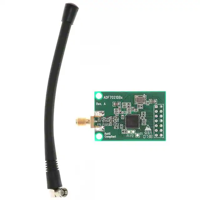

High Performance Narrow-Band Transceiver IC ADF7021 Data Sheet FEATURES On-chip VCO and fractional-N PLL On-chip, 7-bit ADC and temperature sensor Fully automatic frequency control loop (AFC) Digital received signal strength indication (RSSI) Integrated Tx/Rx switch 0.1 μA leakage current in power-down mode Low power, narrow-band transceiver Frequency bands using dual VCO 80 MHz to 650 MHz 862 MHz to 950 MHz Modulation schemes 2FSK, 3FSK, 4FSK, MSK Spectral shaping Gaussian and raised cosine filtering Data rates supported 0.05 kbps to 32.8 kbps 2.3 V to 3.6 V power supply Programmable output power −16 dBm to +13 dBm in 63 steps Automatic PA ramp control Receiver sensitivity −130 dBm at 100 bps, 2FSK −122 dBm at 1 kbps, 2FSK −113 dBm at 25 kbps, raised cosine 2FSK Patent pending, on-chip image rejection calibration APPLICATIONS Narrow-band standards ETSI EN 300 220, FCC Part 15, FCC Part 90, FCC Part 95, ARIB STD-T67 Low cost, wireless data transfer Remote control/security systems Wireless metering Private mobile radio Wireless medical telemetry service (WMTS) Keyless entry Home automation Process and building control Pagers FUNCTIONAL BLOCK DIAGRAM CE RSET TEMP SENSOR RLNA MUX 7-BIT ADC 2FSK 3FSK 4FSK LNA RFIN RSSI/ LOG AMP IF FILTER RFINB CREG(1:4) MUXOUT LDO(1:4) TEST MUX CLOCK AND DATA RECOVERY DEMODULATOR TxRxCLK Tx/Rx CONTROL TxRxDATA SWD GAIN AGC CONTROL SLE SERIAL PORT AFC CONTROL PA RAMP DIV P ÷1/÷2 VCO1 VCO2 VCOIN SCLK GAUSSIAN/ RAISED COSINE FILTER 3FSK ENCODING CP PFD DIV R L2 2FSK 3FSK 4FSK MOD CONTROL Σ-∆ MODULATOR ÷2 MUX L1 N/N + 1 SREAD CPOUT CLK DIV OSC OSC1 OSC2 CLKOUT 05876-001 RFOUT SDATA Figure 1. Rev. D Document Feedback Information furnished by Analog Devices is believed to be accurate and reliable. However, no responsibility is assumed by Analog Devices for its use, nor for any infringements of patents or other rights of third parties that may result from its use. Specifications subject to change without notice. No license is granted by implication or otherwise under any patent or patent rights of Analog Devices. Trademarks and registered trademarks are the property of their respective owners. One Technology Way, P.O. Box 9106, Norwood, MA 02062-9106, U.S.A. Tel: 781.329.4700 ©2007–2016 Analog Devices, Inc. All rights reserved. Technical Support www.analog.com ADF7021 Data Sheet TABLE OF CONTENTS Features .............................................................................................. 1 Receiver Setup ............................................................................. 34 Applications ....................................................................................... 1 Demodulator Considerations ................................................... 36 Functional Block Diagram .............................................................. 1 AFC Operation ........................................................................... 36 Revision History ............................................................................... 3 Automatic Sync Word Detection (SWD) ................................ 37 General Description ......................................................................... 4 Applications Information .............................................................. 38 Specifications..................................................................................... 5 IF Filter Bandwidth Calibration ............................................... 38 RF and PLL Specifications........................................................... 5 LNA/PA Matching ...................................................................... 38 Transmission Specifications ........................................................ 6 Image Rejection Calibration ..................................................... 39 Receiver Specifications ................................................................ 8 Packet Structure and Coding .................................................... 41 Digital Specifications ................................................................. 10 Applications Circuit ................................................................... 44 General Specifications ............................................................... 11 Serial Interface ................................................................................ 45 Timing Characteristics .............................................................. 11 Readback Format........................................................................ 45 Absolute Maximum Ratings .......................................................... 15 Interfacing to Microcontroller/DSP ........................................ 46 ESD Caution ................................................................................ 15 Register 0—N Register............................................................... 47 Pin Configuration and Function Descriptions ........................... 16 Register 1—VCO/Oscillator Register ...................................... 47 Typical Performance Characteristics ........................................... 18 Register 2—Transmit Modulation Register ............................ 49 Frequency Synthesizer ................................................................... 22 Register 3—Transmit/Receive Clock Register ........................ 50 Reference Input ........................................................................... 22 Register 4—Demodulator Setup Register ............................... 51 MUXOUT.................................................................................... 23 Register 5—IF Filter Setup Register......................................... 52 Voltage Controlled Oscillator (VCO) ...................................... 24 Register 6—IF Fine Cal Setup Register ................................... 53 Choosing Channels for Best System Performance ................. 25 Register 7—Readback Setup Register ...................................... 54 Transmitter ...................................................................................... 26 Register 8—Power-Down Test Register .................................. 55 RF Output Stage .......................................................................... 26 Register 9—AGC Register ......................................................... 56 Modulation Schemes.................................................................. 26 Register 10—AFC Register ....................................................... 57 Spectral Shaping ......................................................................... 28 Register 11—Sync Word Detect Register ................................ 58 Modulation and Filtering Options ........................................... 29 Register 12—SWD/Threshold Setup Register ........................ 58 Transmit Latency ........................................................................ 29 Register 13—3FSK/4FSK Demod Register ............................. 59 Test Pattern Generator ............................................................... 29 Register 14—Test DAC Register ............................................... 60 Receiver Section .............................................................................. 30 Register 15—Test Mode Register ............................................. 61 RF Front End ............................................................................... 30 Outline Dimensions ....................................................................... 62 IF Filter ........................................................................................ 30 Ordering Guide .......................................................................... 62 RSSI/AGC .................................................................................... 31 Demodulation, Detection, and CDR ....................................... 32 Rev. D | Page 2 of 62 Data Sheet ADF7021 REVISION HISTORY 9/2016—Rev. C to Rev. D Changes to General Description Section ....................................... 4 Changes to Interfacing to Microcontroller/DSP Section and Figure 58 ...........................................................................................46 10/2014—Rev. B to Rev. C Changes to Table 8 ..........................................................................16 Change to Figure 36 ........................................................................24 Change to IF Filter Fine Calibration Overview Section ............30 Change to Post Demodulator Filter Setup Section .....................34 Change to Battery Voltage/ADCIN/Temperature Sensor Readback Section ............................................................................45 Change to Register 4—Demodulator Setup Register Section ...51 Change to Register 7—Readback Setup Register Section ..........54 Change to Register 10—AFC Register Section ...........................57 4/2013—Rev. A to Rev. B Changes to Figure 10 ......................................................................16 Updated Outline Dimensions ........................................................62 Changes to Ordering Guide ...........................................................62 9/2007—Rev. 0 to Rev. A Change to UART/SPI Mode Section ............................................ 14 Changes to Figure 10 ...................................................................... 16 Change to Table 8 ............................................................................ 16 Changes to Figure 12 ...................................................................... 18 Change to Internal Inductor VCO Section.................................. 24 Changes to Figure 40 ...................................................................... 26 Changes to Figure 47 ...................................................................... 32 Change to Table 19 .......................................................................... 34 Changes to Figure 56 ...................................................................... 44 Change to SPI Mode Section ......................................................... 46 Changes to Figure 59 ...................................................................... 46 Changes to Figure 60 ...................................................................... 46 Change to Register 3—Transmit/Receive Clock Register Section ............................................................................... 50 Change to Register 4—Demodulator Setup Register Section ......... 51 Change to Register 7—Readback Setup Register ........................ 54 Change to Register 13—3FSK/4FSK Demod Register Heading .... 59 3/2007—Revision 0: Initial Version Rev. D | Page 3 of 62 ADF7021 Data Sheet GENERAL DESCRIPTION The ADF7021 is a high performance, low power, highly integrated 2FSK/3FSK/4FSK transceiver. It is designed to operate in the narrowband, license-free ISM bands, and in the licensed bands with frequency ranges of 80 MHz to 650 MHz and 862 MHz to 950 MHz. The device has both Gaussian and raised cosine transmit data filtering options to improve spectral efficiency for narrowband applications. It is suitable for circuit applications targeted at European ETSI EN 300 220, the Japanese ARIB STD-T67, the Chinese short range device regulations, and the North American FCC Part 15, Part 90, and Part 95 regulatory standards. A complete transceiver can be built using a small number of external discrete components, making the ADF7021 very suitable for price sensitive and area sensitive applications. The range of on-chip FSK modulation and data filtering options allows users greater flexibility in their choice of modulation schemes while meeting tight spectral efficiency requirements. The ADF7021 also supports protocols that dynamically switch between 2FSK/3FSK/4FSK to maximize communication range and data throughput. The transmit section contains dual voltage controlled oscillators (VCOs) and a low noise fractional-N PLL with an output resolution of 10 >10 >25 >25 >10 >20 5 >5 >¼ × tBIT >¼ × tBIT Unit ns ns ns ns ns ns ns ns ns ns ns ns µs µs Test Conditions/Comments SDATA to SCLK setup time SDATA to SCLK hold time SCLK high duration SCLK low duration SCLK to SLE setup time SLE pulse width SCLK to SREAD data valid, readback SREAD hold time after SCLK, readback SCLK to SLE disable time, readback TxRxCLK negative edge to SLE TxRxDATA to TxRxCLK setup time (Tx mode) TxRxCLK to TxRxDATA hold time (Tx mode) TxRxCLK negative edge to SLE SLE positive edge to positive edge of TxRxCLK Rev. D | Page 11 of 62 ADF7021 Data Sheet Timing Diagrams Serial Interface t3 t4 SCLK t1 SDATA DB31 (MSB) t2 DB30 DB1 (CONTROL BIT C2) DB2 DB0 (LSB) (CONTROL BIT C1) t6 05876-002 SLE t5 Figure 2. Serial Interface Timing Diagram t1 t2 SCLK SDATA REG7 DB0 (CONTROL BIT C1) SLE t3 t10 RV16 RV2 RV15 RV1 X 05876-003 X SREAD t9 t8 Figure 3. Serial Interface Readback Timing Diagram 2FSK/3FSK Timing ±1 × DATA RATE/32 1/DATA RATE TxRxCLK TxRxDATA 05876-004 DATA Figure 4. TxRxDATA/TxRxCLK Timing Diagram in Receive Mode 1/DATA RATE TxRxCLK TxRxDATA FETCH 05876-005 DATA SAMPLE Figure 5. TxRxDATA/TxRxCLK Timing Diagram in Transmit Mode Rev. D | Page 12 of 62 Data Sheet ADF7021 4FSK Timing In 4FSK receive mode, MSB/LSB synchronization is guaranteed by SWD in the receive bit stream. REGISTER 0 WRITE SWITCH FROM Rx TO Tx tSYMBOL t13 t12 t11 tBIT SLE TxRxCLK Rx SYMBOL MSB Rx SYMBOL LSB Tx/Rx MODE Rx SYMBOL MSB Rx SYMBOL LSB Tx SYMBOL MSB Tx SYMBOL LSB Rx MODE Tx SYMBOL MSB Tx MODE 05876-074 TxRxDATA Figure 6. Receive-to-Transmit Timing Diagram in 4FSK Mode REGISTER 0 WRITE SWITCH FROM Tx TO Rx t15 t14 tSYMBOL tBIT SLE TxRxCLK Tx/Rx MODE Tx SYMBOL MSB Tx SYMBOL LSB Tx SYMBOL MSB Tx SYMBOL LSB Tx MODE Figure 7. Transmit-to-Receive Timing Diagram in 4FSK Mode Rev. D | Page 13 of 62 Rx SYMBOL MSB Rx SYMBOL LSB Rx MODE 05876-075 TxRxDATA ADF7021 Data Sheet UART/SPI Mode UART mode is enabled by setting R0_DB28 to 1. SPI mode is enabled by setting R0_DB28 to 1 and setting R15_DB[17:19] to 0x7. The transmit/receive data clock is available on the CLKOUT pin. tBIT CLKOUT (TRANSMIT/RECEIVE DATA CLOCK IN SPI MODE. NOT USED IN UART MODE.) Tx BIT SAMPLE Tx BIT TxRxDATA (RECEIVE DATA OUTPUT IN UART/SPI MODE.) Tx BIT Tx BIT Tx BIT HIGH-Z Tx/Rx MODE 05876-082 TxRxCLK (TRANSMIT DATA INPUT IN UART/SPI MODE.) FETCH Tx MODE Figure 8. Transmit Timing Diagram in UART/SPI Mode tBIT CLKOUT (TRANSMIT/RECEIVE DATA CLOCK IN SPI MODE. NOT USED IN UART MODE.) FETCH SAMPLE TxRxCLK (TRANSMIT DATA INPUT IN UART/SPI MODE.) Tx/Rx MODE Rx BIT Rx BIT Rx BIT Rx BIT Rx MODE Figure 9. Receive Timing Diagram in UART/SPI Mode Rev. D | Page 14 of 62 Rx BIT 05876-078 TxRxDATA (RECEIVE DATA OUTPUT IN UART/SPI MODE.) HIGH-Z Data Sheet ADF7021 ABSOLUTE MAXIMUM RATINGS TA = 25°C, unless otherwise noted. Table 7. Parameter VDD to GND1 Analog I/O Voltage to GND Digital I/O Voltage to GND Operating Temperature Range Industrial (B Version) Storage Temperature Range Maximum Junction Temperature MLF θJA Thermal Impedance Reflow Soldering Peak Temperature Time at Peak Temperature 1 Rating −0.3 V to +5 V −0.3 V to AVDD + 0.3 V −0.3 V to DVDD + 0.3 V −40°C to +85°C −65°C to +125°C 150°C 26°C/W 260°C 40 sec Stresses at or above those listed under Absolute Maximum Ratings may cause permanent damage to the product. This is a stress rating only; functional operation of the product at these or any other conditions above those indicated in the operational section of this specification is not implied. Operation beyond the maximum operating conditions for extended periods may affect product reliability. This device is a high performance RF integrated circuit with an ESD rating of 10 ppm tolerance, but to comply with the absolute frequency error specifications of narrow-band regulations (for example, ARIB STD-T67 and ETSI EN 300-220), compensation for the frequency error of the crystal is necessary. The CLKOUT circuit takes the reference clock signal from the oscillator section, shown in Figure 32, and supplies a divideddown, 50:50 mark-space signal to the CLKOUT pin. The CLKOUT signal is inverted with respect to the reference clock. An even divide from 2 to 30 is available. This divide number is set in R1_DB[7:10]. On power-up, the CLKOUT defaults to divide-by-8. DVDD CLKOUT ENABLE BIT 05876-083 CP1 Two parallel resonant capacitors are required for oscillation at the correct frequency. Their values are dependent upon the crystal specification. When choosing the values of the capacitors, make sure that the series value of capacitance added to the PCB track capacitance adds up to the specified load capacitance of the crystal, usually 12 pF to 20 pF. Track capacitance values vary from 2 pF to 5 pF, depending on board layout. When possible, choose capacitors that have a very low temperature coefficient to ensure stable frequency operation over all conditions. Using a TCXO Reference A single-ended reference (TCXO, VCXO, or OCXO) can also be used with the ADF7021. This is recommended for applications having absolute frequency accuracy requirements of 6 and KP < 7 The recommended settings to give optimal AFC performance are KI = 11 and KP = 4. To tradeoff between AFC settling time and AFC accuracy, the KI and KP parameters can be adjusted from the recommended settings (staying within the allowable range) such that Signals that are within the AFC pull-in range but outside the IF filter bandwidth are attenuated by the IF filter. As a result, the signal can be below the sensitivity point of the receiver and, therefore, not detectable by the AFC. Rev. D | Page 57 of 62 ADF7021 Data Sheet DB5 DB4 DB3 DB2 DB1 DB0 PL1 C4 (1) C3 (0) C2 (1) C1 (1) DB9 SB2 CONTROL BITS PL2 MATCHING_ TOLERANCE DB10 SB3 DB6 DB11 SB4 MT1 DB12 SB5 DB7 DB13 SB6 DB8 DB14 SB7 SB1 DB15 SB8 MT2 DB16 SB9 SB10 DB17 SB11 DB18 SB12 DB19 SB13 DB20 SB14 DB21 SB15 DB22 SB16 DB23 SB17 DB24 SB18 DB25 SB19 DB26 SB20 DB27 SB21 DB28 SB22 DB29 SB23 DB30 SYNC_BYTE_SEQUENCE SB24 DB31 SYNC_BYTE_ LENGTH REGISTER 11—SYNC WORD DETECT REGISTER PL2 PL1 SYNC BYTE LENGTH 0 0 1 1 0 1 0 1 12 BITS 16 BITS 20 BITS 24 BITS 0 0 1 1 0 1 0 1 ACCEPT 0 ERRORS ACCEPT 1 ERROR ACCEPT 2 ERRORS ACCEPT 3 ERRORS 05876-041 MATCHING MT2 MT1 TOLERANCE Figure 73. Register 11—Sync Word Detect Register Map SWD_MODE LOCK_ THRESHOLD_ MODE REGISTER 12—SWD/THRESHOLD SETUP REGISTER DB15 DB14 DB13 DB12 DB11 DB10 DB9 DB8 DB7 DB6 DB5 DB4 DB3 DB2 DB1 DB0 DP7 DP6 DP5 DP4 DP3 DP2 DP1 IL2 IL1 LM2 LM1 C4 (1) C3 (1) C2 (0) C1 (0) CONTROL BITS DP8 DATA_PACKET_LENGTH DATA PACKET LENGTH 0 1 ... 255 INVALID 1 BYTE ... 255 BYTES SWD MODE 0 1 2 3 SWD PIN LOW SWD PIN HIGH AFTER NEXT SYNCWORD SWD PIN HIGH AFTER NEXT SYNCWORD FOR DATA PACKET LENGTH NUMBER OF BYTES INTERRUPT PIN HIGH 3 THRESHOLD FREE RUNNING LOCK THRESHOLD AFTER NEXT SYNCWORD LOCK THRESHOLD AFTER NEXT SYNCWORD FOR DATA PACKET LENGTH NUMBER OF BYTES LOCK THRESHOLD 05876-042 LOCK THRESHOLD MODE 0 1 2 Figure 74. Register 12—SWD/Threshold Setup Register Map Lock threshold locks the threshold of the envelope detector. This has the effect of locking the slicer in linear demodulation and locking the AFC and AGC loops when using linear or correlator demodulation. Rev. D | Page 58 of 62 Data Sheet ADF7021 REGISTER 13—3FSK/4FSK DEMOD REGISTER ... 0 0 0 0 . . 1 ... ... ... ... ... ... ... 0 0 0 0 . . 1 OFF 1 2 3 . . 127 VM2 VM1 0 0 1 1 0 1 0 1 DB2 DB1 DB0 C2 (0) C1 (1) DB4 ST1 DB3 DB5 ST2 C3 (1) DB6 ST3 C4 (1) DB7 DB8 CONTROL BITS ST4 ST5 DB9 DB12 PC1 0 1 0 1 . . 1 ST6 DB13 VM1 0 0 1 1 . . 1 DB10 DB14 VM2 3FSK CDR THRESHOLD DB11 DB15 VT1 VT1 ST7 DB16 VT2 VT2 3FSK/4FSK_ SLICER_THRESHOLD VD1 DB17 VT3 PHASE_ CORRECTION 3FSK_VITERBI_ DETECTOR DB18 VT4 DB19 DB20 VT6 VT7 VT3 VT5 DB21 3FSK_CDR_THRESHOLD VT7 PTV1 DB22 PTV2 DB23 PTV3 DB24 PTV4 DB25 3FSK_PREAMBLE_ TIME_VALIDATE VITERBI_ PATH_ MEMORY Refer to the Receiver Setup section for information about programming these settings. 3FSK VITERBI VD1 DETECTOR 0 DISABLED 1 ENABLED PHASE PC1 CORRECTION 0 DISABLED 1 ENABLED VITERBI PATH MEMORY 4 BITS 6 BITS 8 BITS 32 BITS ST7 ... ST3 ST2 ST1 SLICER THRESHOLD 0 0 0 0 . . 1 ... ... ... ... ... ... ... 0 0 0 0 . . 1 0 0 1 1 . . 1 0 1 0 1 . . 1 OFF 1 2 3 . . 127 3FSK PREMABLE PTV4 PTV3 PTV2 PTV1 TIME VALIDATE 0 0 0 0 . . 1 0 0 1 1 . . 1 0 1 0 1 . . 1 0 1 2 3 . . 15 05876-043 0 0 0 0 . . 1 Figure 75. Register 13—3FSK/4FSK Demod Register Map Rev. D | Page 59 of 62 ADF7021 Data Sheet TEST TDAC EN DB13 DB12 DB11 DB10 DB9 DB8 DB7 DB6 DB5 DB4 DB3 DB2 DB1 DB0 TO8 TO7 TO6 TO5 TO4 TO3 TO2 TO1 TE1 C4 (1) C3 (1) C2 (1) C1 (0) ADDRESS BITS TO9 TO10 DB14 DB21 TG1 TO11 DB15 DB22 TG2 FULL RESPONSE TO PEAK 0.5 RESPONSE TO PEAK 0.25 RESPONSE TO PEAK 0.125 RESPONSE TO PEAK TO12 DB16 DB23 TG3 ED PEAK RESPONSE 0 1 2 3 TO13 DB17 DB24 TG4 TO14 DB18 DB25 ER1 TO15 DB19 DB26 LEAKAGE = 2^–8 2^–9 2^–10 2^–11 2^–12 2^–13 2^–14 2^–15 TEST DAC OFFSET TO16 DB20 PULSE_ EXTENSION DB27 EF1 ED LEAK FACTOR 0 1 2 3 4 5 6 7 TEST_DAC_GAIN ER2 DB29 EF3 DB28 DB30 PE1 EF2 DB31 PE2 ED_LEAK_ FACTOR ED_PEAK_ RESPONSE REGISTER 14—TEST DAC REGISTER TEST DAC GAIN 0 1 ... 15 NO GAIN × 2^1 ... × 2^15 PULSE EXTENSION NO PULSE EXTENSION EXTENDED BY 1 EXTENDED BY 2 EXTENDED BY 3 05876-044 0 1 2 3 Figure 76. Register 14—Test DAC Register Map The demodulator tuning parameters, PULSE_EXTENSION, ED_LEAK_FACTOR, and ED_PEAK_RESPONSE, can only be enabled by setting R15_DB[4:7] to 0x9. Using the Test DAC to Implement Analog FM DEMOD and Measuring SNR The test DAC allows the post demodulator filter out for both linear and correlator demodulators to be viewed externally. The test DAC also takes the 16-bit filter output and converts it to a high frequency, single-bit output using a second-order, error feedback Σ-Δ converter. The output can be viewed on the SWD pin. This signal, when filtered appropriately, can then be used to do the following:   Monitor the signals at the FSK post demodulator filter output. This allows the demodulator output SNR to be measured. Eye diagrams of the received bit stream can also be constructed to measure the received signal quality. Provide analog FM demodulation. While the correlators and filters are clocked by DEMOD CLK, CDR CLK clocks the test DAC. Note that although the test DAC functions in regular user mode, the best performance is achieved when the CDR_CLK is increased to or above the frequency of DEMOD CLK. The CDR block does not function when this condition exists. Programming Register 14 enables the test DAC. Both the linear and correlator/demodulator outputs can be multiplexed into the DAC. Register 14 allows a fixed offset term to be removed from the signal (to remove the IF component in the ddt case). It also has a signal gain term to allow the usage of the maximum dynamic range of the DAC. Rev. D | Page 60 of 62 Data Sheet ADF7021 DB20 DB19 DB18 DB17 DB16 DB15 PFD/CP_TEST_ MODES DB14 DB13 DB12 PM1 CM3 CM2 CM1 PC3 PC2 PC1 SD3 SD2 DB11 DB10 DB9 DB8 DB7 DB6 DB5 SD1 TM3 TM2 TM1 RT4 RT3 RT2 DB0 DB21 PM2 C1 (1) DB22 PM3 DB1 DB23 PM4 ADDRESS BITS DB2 DB24 AM1 Rx_TEST_ MODES C2 (1) DB25 AM2 Tx_TEST_ MODES C3 (1) DB26 AM3 Σ-∆_TEST_ MODES DB3 DB27 AM4 CLK_-MUX DB4 DB28 FH1 PLL_TEST_ MODES RT1 DB29 RD1 ANALOG_TEST_ MODES C4 (1) REG 1_PD FORCE_LD HIGH DB30 CO1 CAL_ OVERRIDE DB31 CO2 REGISTER 15—TEST MODE REGISTER CAL OVERRIDE AUTO CAL OVERRIDE GAIN OVERRIDE BW OVERRIDE BW AND GAIN PFD/CP TEST MODES 0 1 2 3 4 5 6 7 REG1 PD 0 1 NORMAL PWR DWN DEFAULT, NO BLEED (+VE) CONSTANT BLEED (–VE) CONSTANT BLEED (–VE) PULSED BLEED (–VE) PULSE BLD, DELAY UP? CP PUMP UP CP TRI-STATE CP PUMP DN FORCE LD HIGH 0 1 Σ-∆ TEST MODES NORMAL FORCE 0 1 2 3 4 5 6 7 ANALOG TEST MODES 0 1 2 3 4 5 6 7 8 9 10 11 12 13 14 15 BAND GAP VOLTGE 40µA CURRENT FROM REG4 FILTER I CHANNEL: STAGE 1 FILTER I CHANNEL: STAGE 2 FILTER I CHANNEL: STAGE 1 FILTER Q CHANNEL: STAGE 1 FILTER Q CHANNEL: STAGE 2 FILTER Q CHANNEL: STAGE 1 ADC REFERENCE VOLTAGE BIAS CURRENT FROM RSSI 5µA FILTER COARSE CAL OSCILLATOR O/P ANALOG RSSI I CHANNEL OSET LOOP +VE FBACK V (I CH) SUMMED O/P OF RSSI RECTIFIER+ SUMMED O/P OF RSSI RECTIFIER– BIAS CURRENT FROM BB FILTER DEFAULT, 3RD ORDER SD, NO DITHER 1ST ORDER SD 2ND ORDER SD DITHER TO FIRST STAGE DITHER TO SECOND STAGE DITHER TO THIRD STAGE DITHER × 8 DITHER × 32 Tx TEST MODES 0 1 2 3 4 5 6 NORMAL OPERATION Tx CARRIER ONLY Tx +VE TONE ONLY Tx –VE TONE ONLY Tx "1010" PATTERN Tx PN9 DATA, AT PROGRAMED RATE Tx SYNC BYTE REPEATEDLY Rx TEST MODES 0 1 2 3 4 5 6 7 8 9 10 11 12 13 14 15 PLL TEST MODES 0 1 2 3 4 5 6 7 8 9 10 11 12 13 14 15 NORMAL OPERATION R DIV N DIV RCNTR/2 ON MUXOUT NCNTR/2 ON MUXOUT ACNTR TO MUXOUT PFD PUMP UP TO MUXOUT PFD PUMP DN TO MUXOUT SDATA TO MUXOUT (OR SREAD?) ANALOG LOCK DETECT ON MUXOUT END OF COARSE CAL ON MUXOUT END OF FINE CAL ON MUXOUT FORCE NEW PRESCALER CONFIG. FOR ALL N TEST MUX SELECTS DATA LOCK DETECT PERCISION RESERVED NORMAL SCLK, SDATA -> I, Q REVERSE I,Q I,Q TO TxRxCLK, TxRxDATA 3FSK SLICER ON TxRxDATA CORRELATOR SLICER ON TxRxDATA LINEAR SLICER ON RXDATA SDATA TO CDR ADDITIONAL FILTERING ON I, Q ENABLE REG 14 DEMOD PARAMETERS POWER DOWN DDT AND ED IN T/4 MODE ENVELOPE DETECTOR WATCHDOG DISABLED RESERVED PROHIBIT CALACTIVE FORCE CALACTIVE ENABLE DEMOD DURING CAL CLK MUXES on CLKOUT pin 0 1 2 3 4 5 6 7 NORMAL, NO OUTPUT DEMOD CLK CDR CLK SEQ CLK BB OFFSET CLK SIGMA DELTA CLK ADC CLK TxRxCLK Figure 77. Register 15—Test Mode Register Map Rev. D | Page 61 of 62 05876-045 0 1 2 3 ADF7021 Data Sheet OUTLINE DIMENSIONS 0.30 0.23 0.18 PIN 1 INDICATOR 48 37 36 1 0.50 BSC TOP VIEW 0.80 0.75 0.70 0.45 0.40 0.35 4.25 4.10 SQ 3.95 EXPOSED PAD 12 25 24 13 BOTTOM VIEW 0.05 MAX 0.02 NOM COPLANARITY 0.08 0.20 REF SEATING PLANE PIN 1 INDICATOR 0.20 MIN FOR PROPER CONNECTION OF THE EXPOSED PAD, REFER TO THE PIN CONFIGURATION AND FUNCTION DESCRIPTIONS SECTION OF THIS DATA SHEET. COMPLIANT TO JEDEC STANDARDS MO-220-WKKD. 08-16-2010-B 7.00 BSC SQ Figure 78. 48-Lead Lead Frame Chip Scale Package [LFCSP_WQ] 7 mm × 7 mm Body, Very Very Thin Quad (CP-48-5) Dimensions shown in millimeters ORDERING GUIDE Model1 ADF7021BCPZ ADF7021BCPZ-RL ADF7021BCPZ-RL7 EVAL-ADF70XXMBZ2 EVAL-ADF7021DBJZ EVAL-ADF7021DBZ2 EVAL-ADF7021DBZ3 EVAL-ADF7021DBZ5 EVAL-ADF7021DBZ6 EVAL-ADF7021DB9Z 1 2 Temperature Range −40°C to +85°C −40°C to +85°C −40°C to +85°C Package Description2 48-Lead Lead Frame Chip Scale Package [LFCSP_WQ] 48-Lead Lead Frame Chip Scale Package [LFCSP_WQ] 48-Lead Lead Frame Chip Scale Package [LFCSP_WQ] Mother Board 426 MHz to 429 MHz Daughter Board 860 MHz to 870 MHz Daughter Board 431 MHz to 470 MHz Daughter Board 80 MHz to 650 MHz Daughter Board 608 MHz to 614 MHz Daughter Board 169 MHz Daughter Board Z = RoHS Compliant Part. Maximum ordering quantity for all daughter boards is three. EVAL-ADF70XXMBZ2 is the required mother board for the daughter boards. ©2007–2016 Analog Devices, Inc. All rights reserved. Trademarks and registered trademarks are the property of their respective owners. D05876-0-9/16(D) Rev. D | Page 62 of 62 Package Option CP-48-5 CP-48-5 CP-48-5
