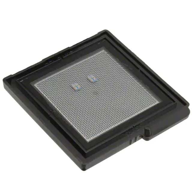

HMC-APH462 v03.0209 LINEAR & POWER AMPLIFIERS - CHIP 3 GaAs HEMT MMIC 1 WATT POWER AMPLIFIER, 15 - 27 GHz Typical Applications Features This HMC-APH462 is ideal for: Output IP3: +37 dBm • Point-to-Point Radios P1dB: +29 dBm • Point-to-Multi-Point Radios Gain: 17 dB • VSAT Supply Voltage: +5V • Military & Space 50 Ohm Matched Input/Output Die Size: 3.70 x 2.62 x 0.1 mm General Description Functional Diagram The HMC-APH462 is a high dynamic range, two stage GaAs HEMT MMIC 0.8 Watt Power Amplifier which operates between 15 and 27 GHz. The HMC-APH462 provides 17 dB of gain, and an output power of +29 dBm at 1 dB compression from a +5V supply voltage. All bond pads and the die backside are Ti/Au metallized and the amplifier device is fully passivated for reliable operation. The HMC-APH462 GaAs HEMT MMIC 1 Watt Power Amplifier is compatible with conventional die attach methods, as well as thermocompression and thermosonic wire bonding, making it ideal for MCM and hybrid microcircuit applications. All data Shown herein is measured with the chip in a 50 Ohm environment and contacted with RF probes. Electrical Specifi cations[1] TA = +25° C, Vdd1 = Vdd2 = Vdd3 = Vdd4 = 5V, Idd1 + Idd2 + Idd3 + Idd4 = 1440 mA [2] Parameter Min. Frequency Range Gain Typ. Max. Min. 15 - 17 12 16 13 Typ. Max. Units 17 - 27 GHz 17 dB Input Return Loss 15 18 dB Output Return Loss 15 18 dB 29 dBm Output power for 1dB Compression (P1dB) 26 Output Third Order Intercept (IP3) 34 37 1440 1440 Supply Current (Idd1+Idd2 + Idd3 + Idd4) 27 mA [1] Unless otherwise indicated, all measurements are from probed die [2] Adjust Vgg1=Vgg2=Vgg3=Vgg4 between -1V to +0.3V (typ. -0.5V) to achieve Idd1 + Idd4 = 480 mA, Idd2 + Idd3 = 960 mA 3 - 178 For price, delivery, and to placeCorporation: orders: Analog Devices, Inc., For price, delivery, and to place orders, please contact Hittite Microwave One Technology Way, P.O. Box 9106, Norwood, MA 02062-9106 20 Alpha Road, Chelmsford, MA 01824 Phone:Phone: 978-250-3343 978-250-3373 781-329-4700Fax: • Order online at www.analog.com Application Support: Phone: 1-800-ANALOG-D Order On-line at www.hittite.com Information furnished by Analog Devices is believed to be accurate and reliable. However, no responsibility is assumed by Analog Devices for its use, nor for any infringements of patents or other rights of third parties that may result from its use. Specifications subject to change without notice. No license is granted by implication or otherwise under any patent or patent rights of Analog Devices. Trademarks and registered trademarks are the property of their respective owners. HMC-APH462 v03.0209 GaAs HEMT MMIC 1 WATT POWER AMPLIFIER, 15 - 27 GHz Fixtured Pout vs. Frequency 20 40 18 36 16 14 12 3 32 28 IP3@18dBm/Tone P3dB P1dB 24 10 20 15 17 19 21 23 25 27 15 16 17 18 FREQUENCY (GHz) 20 21 22 23 24 25 26 27 26 27 FREQUENCY (GHz) Input Return Loss vs. Frequency Output Return Loss vs. Frequency 0 0 -5 -5 -10 -10 RETURN LOSS (dB) RETURN LOSS (dB) 19 -15 -20 -25 -30 -15 -20 -25 -30 -35 -35 -40 -40 -45 -45 15 17 19 21 23 25 27 FREQUENCY (GHz) 15 16 17 18 19 20 21 22 23 24 25 FREQUENCY (GHz) Absolute Maximum Ratings Drain Bias Voltage +5.5 Vdc Gate Bias Voltage -1 to +0.3 Vdc Drain Bias Current (Idd1 + Idd4) 530 mA Drain Bias Current (Idd2 + Idd3) 1060 mA RF Input Power 18 dBm Thermal Resistance (Channel to die bottom) 20.5 °C/W Storage Temperature -65 to +150 °C Channel Temperature 180 °C ELECTROSTATIC SENSITIVE DEVICE OBSERVE HANDLING PRECAUTIONS For price, delivery, and to placeCorporation: orders: Analog Devices, Inc., For price, delivery, and to place orders, please contact Hittite Microwave One Technology Way, P.O. Box 9106, Norwood, MA 02062-9106 20 Alpha Road, Chelmsford, MA 01824 Phone: Phone: 978-250-3343 978-250-3373 781-329-4700Fax: • Order online at www.analog.com Application Support: Phone: 1-800-ANALOG-D Order On-line at www.hittite.com Information furnished by Analog Devices is believed to be accurate and reliable. However, no responsibility is assumed by Analog Devices for its use, nor for any infringements of patents or other rights of third parties that may result from its use. Specifications subject to change without notice. No license is granted by implication or otherwise under any patent or patent rights of Analog Devices. Trademarks and registered trademarks are the property of their respective owners. LINEAR & POWER AMPLIFIERS - CHIP POUT (dBm), IP3 (dB) GAIN (dB) Fixtured Gain vs. Frequency 3 - 179 HMC-APH462 v03.0209 GaAs HEMT MMIC 1 WATT POWER AMPLIFIER, 15 - 27 GHz Outline Drawing LINEAR & POWER AMPLIFIERS - CHIP 3 Die Packaging Information [1] Standard Alternate GP-1 (Gel Pack) [2] [1] Refer to the “Packaging Information” section for die packaging dimensions. [2] For alternate packaging information contact Hittite Microwave Corporation. 3 - 180 NOTES: 1. ALL DIMENSIONS ARE IN INCHES [MM]. 2. TYPICAL BOND PAD IS .004” SQUARE. 3. BACKSIDE METALLIZATION: GOLD. 4. BACKSIDE METAL IS GROUND. 5. BOND PAD METALLIZATION: GOLD. 6. CONNECTION NOT REQUIRED FOR UNLABELED BOND PADS. 7. OVERALL DIE SIZE ±.002” For price, delivery, and to placeCorporation: orders: Analog Devices, Inc., For price, delivery, and to place orders, please contact Hittite Microwave One Technology Way, P.O. Box 9106, Norwood, MA 02062-9106 20 Alpha Road, Chelmsford, MA 01824 Phone:Phone: 978-250-3343 978-250-3373 781-329-4700Fax: • Order online at www.analog.com Application Support: Phone: 1-800-ANALOG-D Order On-line at www.hittite.com Information furnished by Analog Devices is believed to be accurate and reliable. However, no responsibility is assumed by Analog Devices for its use, nor for any infringements of patents or other rights of third parties that may result from its use. Specifications subject to change without notice. No license is granted by implication or otherwise under any patent or patent rights of Analog Devices. Trademarks and registered trademarks are the property of their respective owners. HMC-APH462 v03.0209 GaAs HEMT MMIC 1 WATT POWER AMPLIFIER, 15 - 27 GHz Pad Descriptions Function Description 1 RFIN This pad is AC coupled and matched to 50 Ohms. 6 RFOUT This pad is AC coupled and matched to 50 Ohms. 3, 5, 7, 9 Vdd1, Vdd2, Vdd3, Vdd4 Power Supply Voltage for the amplifier. See assembly for required external components. 2, 4, 8, 10 Vgg1, Vgg2, Vgg3, Vgg4 Gate control for amplifier. Please follow “MMIC Amplifier Biasing Procedure” application note. See assembly for required external components. Die Bottom GND Die bottom must be connected to RF/DC ground. Interface Schematic For price, delivery, and to placeCorporation: orders: Analog Devices, Inc., For price, delivery, and to place orders, please contact Hittite Microwave One Technology Way, P.O. Box 9106, Norwood, MA 02062-9106 20 Alpha Road, Chelmsford, MA 01824 Phone: Phone: 978-250-3343 978-250-3373 781-329-4700Fax: • Order online at www.analog.com Application Support: Phone: 1-800-ANALOG-D Order On-line at www.hittite.com Information furnished by Analog Devices is believed to be accurate and reliable. However, no responsibility is assumed by Analog Devices for its use, nor for any infringements of patents or other rights of third parties that may result from its use. Specifications subject to change without notice. No license is granted by implication or otherwise under any patent or patent rights of Analog Devices. Trademarks and registered trademarks are the property of their respective owners. 3 LINEAR & POWER AMPLIFIERS - CHIP Pad Number 3 - 181 HMC-APH462 v03.0209 GaAs HEMT MMIC 1 WATT POWER AMPLIFIER, 15 - 27 GHz Assembly Diagram LINEAR & POWER AMPLIFIERS - CHIP 3 3 - 182 For price, delivery, and to placeCorporation: orders: Analog Devices, Inc., For price, delivery, and to place orders, please contact Hittite Microwave One Technology Way, P.O. Box 9106, Norwood, MA 02062-9106 20 Alpha Road, Chelmsford, MA 01824 Phone:Phone: 978-250-3343 978-250-3373 781-329-4700Fax: • Order online at www.analog.com Application Support: Phone: 1-800-ANALOG-D Order On-line at www.hittite.com Information furnished by Analog Devices is believed to be accurate and reliable. However, no responsibility is assumed by Analog Devices for its use, nor for any infringements of patents or other rights of third parties that may result from its use. Specifications subject to change without notice. No license is granted by implication or otherwise under any patent or patent rights of Analog Devices. Trademarks and registered trademarks are the property of their respective owners. HMC-APH462 v03.0209 GaAs HEMT MMIC 1 WATT POWER AMPLIFIER, 15 - 27 GHz Mounting & Bonding Techniques for Millimeterwave GaAs MMICs 50 Ohm Microstrip transmission lines on 0.127mm (5 mil) thick alumina thin film substrates are recommended for bringing RF to and from the chip (Figure 1). If 0.254mm (10 mil) thick alumina thin film substrates must be used, the die should be raised 0.150mm (6 mils) so that the surface of the die is coplanar with the surface of the substrate. One way to accomplish this is to attach the 0.102mm (4 mil) thick die to a 0.150mm (6 mil) thick molybdenum heat spreader (moly-tab) which is then attached to the ground plane (Figure 2). 0.102mm (0.004”) Thick GaAs MMIC Ribbon Bond 3 0.076mm (0.003”) RF Ground Plane Microstrip substrates should be placed as close to the die as possible in order to minimize bond wire length. Typical die-to-substrate spacing is 0.076mm to 0.152 mm (3 to 6 mils). 0.127mm (0.005”) Thick Alumina Thin Film Substrate Figure 1. Handling Precautions Follow these precautions to avoid permanent damage. Storage: All bare die are placed in either Waffle or Gel based ESD protective containers, and then sealed in an ESD protective bag for shipment. Once the sealed ESD protective bag has been opened, all die should be stored in a dry nitrogen environment. Cleanliness: Handle the chips in a clean environment. DO NOT attempt to clean the chip using liquid cleaning systems. Static Sensitivity: strikes. 0.102mm (0.004”) Thick GaAs MMIC Ribbon Bond 0.076mm (0.003”) RF Ground Plane Follow ESD precautions to protect against ESD Transients: Suppress instrument and bias supply transients while bias is applied. Use shielded signal and bias cables to minimize inductive pickup. 0.150mm (0.005”) Thick Moly Tab 0.254mm (0.010” Thick Alumina Thin Film Substrate Figure 2. General Handling: Handle the chip along the edges with a vacuum collet or with a sharp pair of bent tweezers. The surface of the chip may have fragile air bridges and should not be touched with vacuum collet, tweezers, or fingers. Mounting The chip is back-metallized and can be die mounted with AuSn eutectic preforms or with electrically conductive epoxy. The mounting surface should be clean and flat. Eutectic Die Attach: A 80/20 gold tin preform is recommended with a work surface temperature of 255 °C and a tool temperature of 265 °C. When hot 90/10 nitrogen/hydrogen gas is applied, tool tip temperature should be 290 °C. DO NOT expose the chip to a temperature greater than 320 °C for more than 20 seconds. No more than 3 seconds of scrubbing should be required for attachment. LINEAR & POWER AMPLIFIERS - CHIP The die should be attached directly to the ground plane eutectically or with conductive epoxy (see HMC general Handling, Mounting, Bonding Note). Epoxy Die Attach: Apply a minimum amount of epoxy to the mounting surface so that a thin epoxy fillet is observed around the perimeter of the chip once it is placed into position. Cure epoxy per the manufacturer’s schedule. Wire Bonding RF bonds made with 0.003” x 0.0005” ribbon are recommended. These bonds should be thermosonically bonded with a force of 40-60 grams. DC bonds of 0.001” (0.025 mm) diameter, thermosonically bonded, are recommended. Ball bonds should be made with a force of 40-50 grams and wedge bonds at 18-22 grams. All bonds should be made with a nominal stage temperature of 150 °C. A minimum amount of ultrasonic energy should be applied to achieve reliable bonds. All bonds should be as short as possible, less than 12 mils (0.31 mm). For price, delivery, and to placeCorporation: orders: Analog Devices, Inc., For price, delivery, and to place orders, please contact Hittite Microwave One Technology Way, P.O. Box 9106, Norwood, MA 02062-9106 20 Alpha Road, Chelmsford, MA 01824 Phone: Phone: 978-250-3343 978-250-3373 781-329-4700Fax: • Order online at www.analog.com Application Support: Phone: 1-800-ANALOG-D Order On-line at www.hittite.com Information furnished by Analog Devices is believed to be accurate and reliable. However, no responsibility is assumed by Analog Devices for its use, nor for any infringements of patents or other rights of third parties that may result from its use. Specifications subject to change without notice. No license is granted by implication or otherwise under any patent or patent rights of Analog Devices. Trademarks and registered trademarks are the property of their respective owners. 3 - 183
