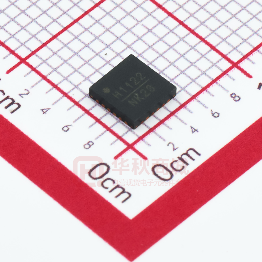

HMC1122LP4METR 数据手册
0.1 GHz to 6.0 GHz, 0.5 dB LSB, 6-Bit, Silicon Digital Attenuator HMC1122 Data Sheet LE 4 GND 5 ATTIN 6 D2 D3 D4 D5 19 SERIAL/ PARALLEL INTERFACE 6-BIT/ DIGITAL ATTENUATOR GND 7 8 9 10 11 18 VDD 17 PUP1 16 PUP2 15 SEROUT 14 GND 13 ATTOUT 12 PACKAGE BASE GND 13719-001 3 20 GND SERIN 21 GND 2 22 GND CLK 23 GND 1 24 GND P/S D1 FUNCTIONAL BLOCK DIAGRAM Attenuation range: 0.5 dB LSB steps to 31.5 dB Low insertion loss 1.1 dB at 1 GHz 1.3 dB at 2 GHz Typical step error: less than ±0.1 dB Excellent attenuation accuracy Safe state transitions High linearity Input 0.1dB compression (P0.1dB): 30 dBm typical Input third-order intercept (IP3): 55 dBm typical RF settling time (0.05 dB final RF output): 250 ns Low phase shift error: 6° at 1 GHz Single supply operation: 3.3 V to 5 V ESD rating: Class 2 (2 kV HBM) 24-lead, 4 mm × 4 mm LFCSP package: 16 mm2 Pin compatible to the HMC624A D0 FEATURES Figure 1. APPLICATIONS Cellular infrastructure Microwave radios and very small aperture terminals (VSATs) Test equipment and sensors IF and RF designs GENERAL DESCRIPTION The HMC1122 is a 6-bit digital attenuator operating from 0.1 GHz to 6 GHz with a 31.5 dB attenuation control range in 0.5 dB steps. The HMC1122 is implemented in a silicon process, offering very fast settling time, low power consumption, and high ESD robustness. The device features safe state transitions and optimized for excellent step accuracy and high linearity over frequency and temperature range. The RF input and output are internally matched to 50 Ω and do not require any external matching components. The design is bidirectional; therefore, the RF input and output are interchangeable. Rev. B The HMC1122 operates on a single supply ranging from 3.3 V to 5 V with no performance change due to an on-chip regulator. The device incorporates a driver that provides both serial and parallel control of the attenuator. The device also features a userselectable power-up state and a serial output port for cascading other serial controlled components. The HMC1122 comes in a RoHS compliant, compact, 4 mm × 4 mm LFCSP package, and is pin compatible to the HMC624A. A fully populated evaluation board is available. Document Feedback Information furnished by Analog Devices is believed to be accurate and reliable. However, no responsibility is assumed by Analog Devices for its use, nor for any infringements of patents or other rights of third parties that may result from its use. Specifications subject to change without notice. No license is granted by implication or otherwise under any patent or patent rights of Analog Devices. Trademarks and registered trademarks are the property of their respective owners. One Technology Way, P.O. Box 9106, Norwood, MA 02062-9106, U.S.A. Tel: 781.329.4700 ©2016–2017 Analog Devices, Inc. All rights reserved. Technical Support www.analog.com HMC1122 Data Sheet TABLE OF CONTENTS Features .............................................................................................. 1 Input Power Compression and Third-Order Intercept ............9 Applications ....................................................................................... 1 Theory of Operation ...................................................................... 10 Functional Block Diagram .............................................................. 1 Power Supply............................................................................... 10 General Description ......................................................................... 1 RF Input and Output ................................................................. 10 Revision History ............................................................................... 2 Serial or Parallel Mode Selection ............................................. 10 Specifications..................................................................................... 3 Serial Mode Interface ................................................................. 10 Timing Specifications .................................................................. 4 Parallel Mode Interface.............................................................. 11 Absolute Maximum Ratings............................................................ 5 Power-Up Interface .................................................................... 11 ESD Caution .................................................................................. 5 Applications Information .............................................................. 12 Pin Configuration and Function Descriptions ............................. 6 Evaluation Printed Circuit Board ............................................ 12 Interface Schematics..................................................................... 6 Evaluation Board Schematic and Artwork ............................. 13 Typical Performance Characteristics ............................................. 7 Outline Dimensions ....................................................................... 15 Insertion Loss, Return Loss, State Error, Step Error, and Relative Phase................................................................................ 7 Ordering Guide .......................................................................... 15 REVISION HISTORY 9/2017—Rev. A to Rev. B Changed CP-24-16 to HCP-24-3 ................................. Throughout Updated Outline Dimensions ....................................................... 15 Changes to Ordering Guide .......................................................... 15 8/2017—Rev. 0 to Rev. A Added Timing Specifications Section ............................................ 4 Moved Table 2 ................................................................................... 4 Change to Figure 5 ........................................................................... 6 Changes to Figure 26 ...................................................................... 11 Updated Outline Dimensions ....................................................... 15 4/2016—Revision 0: Initial Version Rev. B | Page 2 of 15 Data Sheet HMC1122 SPECIFICATIONS VDD = 3.3 V to 5 V, TA = 25°C, 50 Ω system, unless otherwise noted. Table 1. Parameter FREQUENCY RANGE INSERTION LOSS Symbol At 0.2 GHz to 1.0 GHz At 1.0 GHz to 2.0 GHz At 2.0 GHz to 4.0 GHz At 4.0 GHz to 6.0 GHz At 0.2 GHz to 6 GHz Between minimum and maximum attenuation states Between any successive attenuation states Between any successive attenuation states All attenuation states; referenced to insertion loss state ATTENUATION Range Step Size Step Error Accuracy Overshoot RETURN LOSS (ATTIN and ATTOUT) RELATIVE PHASE SWITCHING CHARACTERISTICS Rise and Fall Time On and Off Time 0.1 dB Settling Time tRISE, tFALL tON, tOFF 0.05 dB Settling Time INPUT LINEARITY Input 0.1 dB Compression Input Third-Order Intercept SUPPLY CURRENT Test Conditions/Comments P0.1dB IP3 IDD Between all attenuation states At 1.0 GHz, minimum attenuation (worst case) At 2.0 GHz, minimum attenuation (worst case) At 4.0 GHz, minimum attenuation (worst case) At 6.0 GHz, maximum attenuation (worst case) Between minimum and maximum attenuation states At 1.0 GHz At 2.0 GHz At 4.0 GHz At 6.0 GHz Between all attenuation states 10% to 90% of RF output 50% VCTL to 90% of RF output 50% VCTL to 0.1 dB of final RF output 50% VCTL to 0.05 dB of final RF output All attenuation states, 0.2 GHz to 6 GHz Two-tone input power = 15 dBm each tone, Δf = 1 MHz VDD = 3.3 V VDD = 5.0 V Rev. B | Page 3 of 15 Min 0.1 Typ 1.1 1.3 1.7 2.0 Max 6.0 1.8 2.0 2.4 2.8 Unit GHz dB dB dB dB 31.5 dB 0.5 dB
