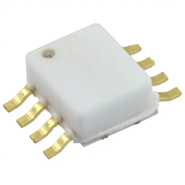

    RF Mixer IC General Purpose Up/Down Converter 7GHz ~ 10GHz 8-CSMD
HMC171C8TR 数据手册
HMC171C8 v02.1105 GaAs MMIC SMT DOUBLEBALANCED MIXER, 7 - 10 GHz Typical Applications Features The HMC171C8 is ideal for: Conversion Loss: 9 dB • Microwave Point-to-Point Radios LO to RF Isolation: 32 dB • 5.8 GHz ISM Band Circuits Surface Mount Small Size, No DC Bias Required TE Functional Diagram General Description LE The HMC171C8 is a miniature double-balanced mixer in a non-hermetic ceramic surface mount package that can be used as an upconverter, downconverter or biphase modulator. The device is a passive diode/ balun type mixer with high dynamic range. Noise figure is essentially equal to the conversion loss. The mixer can handle larger signal levels than most active mixers due to the high third order intercept. MMIC implementation provides exceptional balance in the circuit resulting in high LO/RF and LO/IF isolations and unit-to-unit consistency. This mixer has applications in circuits where small size and surface mount compatibility are important. B SO MIXERS - DBL-BAL - SMT 9 O Electrical Specifi cations, TA = +25° C, LO Drive = +10 dBm Parameter Min. Frequency Range, RF & LO Frequency Range, IF 9 - 50 Typ. Max. 7.0 - 10.0 Units GHz DC - 2 GHz Conversion Loss 9 10 dB Noise Figure (SSB) 9 10 dB LO to RF Isolation 28 32 LO to IF Isolation 21 26 dB dB IP3 (Input) 12 16 dBm IP2 (Input) 55 62 dBm 1 dB Gain Compression (Input) 7 10 dBm For price, delivery, and to placeCorporation: orders: Analog Devices, Inc., For price, delivery, and to place orders, please contact Hittite Microwave One Technology Way, P.O. Box 9106, Norwood, MA 02062-9106 20 Alpha Road, Chelmsford, MA 01824 Phone: Phone: 978-250-3343 978-250-3373 781-329-4700Fax: • Order online at www.analog.com Application Support: Phone: 1-800-ANALOG-D Order On-line at www.hittite.com Information furnished by Analog Devices is believed to be accurate and reliable. However, no responsibility is assumed by Analog Devices for its use, nor for any infringements of patents or other rights of third parties that may result from its use. Specifications subject to change without notice. No license is granted by implication or otherwise under any patent or patent rights of Analog Devices. Trademarks and registered trademarks are the property of their respective owners. HMC171C8 v02.1105 GaAs MMIC SMT DOUBLEBALANCED MIXER, 7 - 10 GHz Conversion Loss Isolation 0 -10 -5 ISOLATION (dB) -10 -15 -20 LO /IF -30 LO/IF LO/RF -40 LO/RF 9 -60 0 1 2 3 4 5 6 7 8 9 0 10 11 12 3 4 5 6 7 8 9 10 11 12 LE Distortion and 1dB Compression vs. LO Drive Level Conversion Loss vs. LO Drive -5 +13dBm -7.5 B SO Distortion RF (f1) = 8.01 GHz RF (f2) = 8.00 GHz LO = 8.5 GHz Rf Level = 0 dBm LO Drive +15dBm 1 dB Compression (dBm) IP3 (dBm) IP2 (dBm) P1dB (dBm) +7 13 59 8.5 +10 16 62 10.0 +10dBm -12.5 2 FREQUENCY (GHz) FREQUENCY (GHz) -10 1 +9dBm +8dBm -15 2 3 4 5 6 7 8 9 10 11 12 13 14 MIXERS - DBL-BAL - SMT -50 -20 CONVERSION LOSS (dB) RF/IF TE CONVERSION LOSS (dB) 0 FREQUENCY (GHz) 0 RETURN LOSS (dB) O Return Loss -10 IF LO RF -20 -30 -40 0 1 2 3 4 5 6 7 8 9 10 11 12 FREQUENCY (GHz) S - Paremeters for the RF, LO, IF Ports are Available On-Line at www.hittite.com For price, delivery, and to placeCorporation: orders: Analog Devices, Inc., For price, delivery, and to place orders, please contact Hittite Microwave One Technology Way, P.O. Box 9106, Norwood, MA 02062-9106 20 Alpha Road, Chelmsford, MA 01824 Phone: Phone: 978-250-3343 978-250-3373 781-329-4700Fax: • Order online at www.analog.com Application Support: Phone: 1-800-ANALOG-D Order On-line at www.hittite.com Information furnished by Analog Devices is believed to be accurate and reliable. However, no responsibility is assumed by Analog Devices for its use, nor for any infringements of patents or other rights of third parties that may result from its use. Specifications subject to change without notice. No license is granted by implication or otherwise under any patent or patent rights of Analog Devices. Trademarks and registered trademarks are the property of their respective owners. 9 - 51 HMC171C8 v02.1105 GaAs MMIC SMT DOUBLEBALANCED MIXER, 7 - 10 GHz +13 dBm LO Drive +27 dBm Storage Temperature -65 to +150 °C Operating Temperature -55 to +85 °C LE ELECTROSTATIC SENSITIVE DEVICE OBSERVE HANDLING PRECAUTIONS B SO Outline Drawing O MIXERS - DBL-BAL - SMT 9 RF / IF Input TE Absolute Maximum Ratings NOTES: 1. PACKAGE BODY MATERIAL: WHITE ALUMINA 92% 2. LEAD, PACKAGE BOTTOM MATERIAL: COPPER 3. PLATING: ELECTROLYTIC GOLD 100-200 MICROINCHES, OVER ELECTROLYTIC NICKEL 100-250 MICROINCHES. 4. DIMENSIONS ARE IN INCHES [MILLIMETERS]. 5. PACKAGE LENGTH AND WIDTH DIMENSIONS DO NOT INCLUDE LID SEAL PROTRUSION .005 PER SIDE. 6. ALL GROUND LEADS AND GROUND PADDLE MUST BE SOLDERED TO PCB RF GROUND. 9 - 52 For price, delivery, and to placeCorporation: orders: Analog Devices, Inc., For price, delivery, and to place orders, please contact Hittite Microwave One Technology Way, P.O. Box 9106, Norwood, MA 02062-9106 20 Alpha Road, Chelmsford, MA 01824 Phone: Phone: 978-250-3343 978-250-3373 781-329-4700Fax: • Order online at www.analog.com Application Support: Phone: 1-800-ANALOG-D Order On-line at www.hittite.com Information furnished by Analog Devices is believed to be accurate and reliable. However, no responsibility is assumed by Analog Devices for its use, nor for any infringements of patents or other rights of third parties that may result from its use. Specifications subject to change without notice. No license is granted by implication or otherwise under any patent or patent rights of Analog Devices. Trademarks and registered trademarks are the property of their respective owners. HMC171C8 v02.1105 GaAs MMIC SMT DOUBLEBALANCED MIXER, 7 - 10 GHz 9 MIXERS - DBL-BAL - SMT B SO LE TE Evaluation PCB O List of Materials for Evaluation PCB 102102 [1] Item Description J1 - J3 PCB Mount SMA RF Connector U1 HMC171C8 Mixer PCB [2] 107214 Evaluation Board [1] Reference this number when ordering complete evaluation PCB [2] Circuit Board Material: Rogers 4350 The circuit board used in the final application should use RF circuit design techniques. Signal lines should have 50 ohm impedance while the package ground leads and exposed paddle should be connected directly to the ground plane similar to that shown. A sufficient number of via holes should be used to connect the top and bottom ground planes. The evaluation circuit board shown is available from Hittite upon request. For price, delivery, and to placeCorporation: orders: Analog Devices, Inc., For price, delivery, and to place orders, please contact Hittite Microwave One Technology Way, P.O. Box 9106, Norwood, MA 02062-9106 20 Alpha Road, Chelmsford, MA 01824 Phone: Phone: 978-250-3343 978-250-3373 781-329-4700Fax: • Order online at www.analog.com Application Support: Phone: 1-800-ANALOG-D Order On-line at www.hittite.com Information furnished by Analog Devices is believed to be accurate and reliable. However, no responsibility is assumed by Analog Devices for its use, nor for any infringements of patents or other rights of third parties that may result from its use. Specifications subject to change without notice. No license is granted by implication or otherwise under any patent or patent rights of Analog Devices. Trademarks and registered trademarks are the property of their respective owners. 9 - 53
