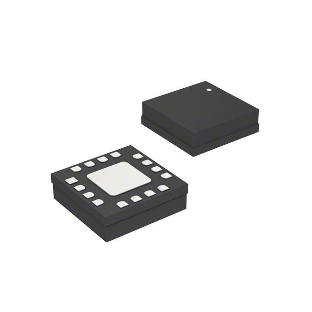

HMC723LP3E v00.0210 13 Gbps, FAST RISE TIME D-TYPE FLIP-FLOP w/ PROGRAMMABLE OUTPUT VOLTAGE HIGH SPEED LOGIC - SMT 3 Typical Applications Features The HMC723LP3E is ideal for: Supports High Data Rates: up to 13 Gbps • RF ATE Applications Differential & Singe-Ended Operation • Broadband Test & Measurement Fast Rise and Fall Times: 19 / 17 ps • Serial Data Transmission up to 13 Gbps Low Power Consumption: 260 mW typ. • Digital Logic Systems up to 13 GHz Programmable Differential Output Voltage Swing: 700 - 1300 mV Propagation Delay: 105 ps Single Supply: -3.3V 16 Lead 3x3mm SMT Package: 9mm² Functional Diagram General Description The HMC723LP3E is a D-type Flip Flop designed to support data transmission rates of up to 13 Gbps, and clock frequencies as high as 13 GHz. During normal operation, data is transferred to the outputs on the positive edge of the clock. Reversing the clock inputs allows for negative-edge triggered applications. The HMC723LP3E also features an output level control pin, VR, which allows for loss compensation or for signal level optimization. All input signals to the HMC723LP3E are terminated with 50 Ohms to ground on-chip, and maybe either AC or DC coupled. The differential outputs of the HMC723LP3E may be either AC or DC coupled. Outputs can be connected directly to a 50 Ohm to ground terminated system, while DC blocking capacitors may be used if the terminating system is 50 Ohms to a non-ground DC voltage. The HMC723LP3E operates from a single -3.3V DC supply and is available in a RoHS compliant 3x3 mm SMT package. Electrical Specifications, TA = +25°C, Vee = -3.3V Parameter Conditions Power Supply Voltage Min. Typ. Max -3.6 -3.3 -3.0 V Power Supply Current 80 mA Maximum Data Rate 13 Gbps Maximum Clock Rate 13 GHz Input High Voltage -0.5 0.5 Input Low Voltage -1.0 0.0 Input Return Loss Output Amplitude Output High Voltage 3-1 Units Frequency H H H - Positive voltage level L - Negative voltage level Information furnished by Analog Devices is believed to be accurate and reliable. However, no For price, 20 delivery, and to place orders: Analog For price, delivery and to place orders: Microwave Corporation, Alpha Road, Chelmsford, MADevices, 01824 Inc., responsibility is assumed by Analog Devices for its use, nor for anyHittite infringements of patents or other One Technology Way, P.O. Box 9106, Norwood, MA 02062-9106 rights of third parties that may result from its use. Specifications subject to change without notice. No Phone: 978-250-3343 Fax: 978-250-3373 Order at www.hittite.com Phone: On-line 781-329-4700 • Order online at www.analog.com license is granted by implication or otherwise under any patent or patent rights of Analog Devices. Application Support: Phone: 1-800-ANALOG-D Trademarks and registered trademarks are the property of their respective owners. Application Support: Phone: 978-250-3343 or apps@hittite.com 3-4 HMC723LP3E v00.0210 13 Gbps, FAST RISE TIME D-TYPE FLIP-FLOP w/ PROGRAMMABLE OUTPUT VOLTAGE Absolute Maximum Ratings HIGH SPEED LOGIC - SMT 3 Power Supply Voltage (Vee) -3.75V to +0.5V Input Signals -2V to +0.5V Output Signals -1.5V to +1V Storage Temperature -65°C to +150°C Operating Temperature -40°C to +85°C ELECTROSTATIC SENSITIVE DEVICE OBSERVE HANDLING PRECAUTIONS Outline Drawing NOTES: 1. LEADFRAME MATERIAL: COPPER ALLOY 2. DIMENSIONS ARE IN INCHES [MILLIMETERS] 3. LEAD SPACING TOLERANCE IS NON-CUMULATIVE 4. PAD BURR LENGTH SHALL BE 0.15mm MAXIMUM. PAD BURR HEIGHT SHALL BE 0.05mm MAXIMUM. 5. PACKAGE WARP SHALL NOT EXCEED 0.05mm. 6. ALL GROUND LEADS AND GROUND PADDLE MUST BE SOLDERED TO PCB RF GROUND. 7. REFER TO HITTITE APPLICATION NOTE FOR SUGGESTED LAND PATTERN. Package Information Part Number Package Body Material Lead Finish HMC723LP3E RoHS-compliant Low Stress Injection Molded Plastic 100% matte Sn MSL Rating MSL1 [2] Package Marking [3] 723 XXXX [1] Max peak reflow temperature of 235 °C [2] Max peak reflow temperature of 260 °C [3] 4-Digit lot number XXXX 3-5 Information furnished by Analog Devices is believed to be accurate and reliable. However, no For price, 20 delivery, and to place orders: Analog For price, delivery and to place orders: Microwave Corporation, Alpha Road, Chelmsford, MADevices, 01824 Inc., responsibility is assumed by Analog Devices for its use, nor for anyHittite infringements of patents or other One Technology Way, P.O. Box 9106, Norwood, MA 02062-9106 rights of third parties that may result from its use. Specifications subject to change without notice. No Phone: 978-250-3343 Fax: 978-250-3373 Order at www.hittite.com Phone: On-line 781-329-4700 • Order online at www.analog.com license is granted by implication or otherwise under any patent or patent rights of Analog Devices. Application Support: Phone: 1-800-ANALOG-D Trademarks and registered trademarks are the property of their respective owners. Application Support: Phone: 978-250-3343 or apps@hittite.com HMC723LP3E v00.0210 13 Gbps, FAST RISE TIME D-TYPE FLIP-FLOP w/ PROGRAMMABLE OUTPUT VOLTAGE Pin Descriptions Function Description 1, 4, 5, 8, 9, 12 GND Signal Grounds 2, 3 DN, DP Data Inputs 6, 7 CP, CN Clock Inputs 10, 11 QN, QP Data Outputs 13, 16 GND Supply Ground 14 VR Output level control. Output level may be adjusted by either applying a voltage to VR per “Output Differential vs. VR” plot, or by tying VR to GND with a resistor per the following equation: V0(R) = 1.2 / (2.1 + R), R in kΩ 15, Package Base Vee Negative Supply Interface Schematic Information furnished by Analog Devices is believed to be accurate and reliable. However, no For price, 20 delivery, and to place orders: Analog For price, delivery and to place orders: Microwave Corporation, Alpha Road, Chelmsford, MADevices, 01824 Inc., responsibility is assumed by Analog Devices for its use, nor for anyHittite infringements of patents or other One Technology Way, P.O. Box 9106, Norwood, MA 02062-9106 rights of third parties that may result from its use. Specifications subject to change without notice. No Phone: 978-250-3343 Fax: 978-250-3373 Order at www.hittite.com Phone: On-line 781-329-4700 • Order online at www.analog.com license is granted by implication or otherwise under any patent or patent rights of Analog Devices. Application Support: Phone: 1-800-ANALOG-D Trademarks and registered trademarks are the property of their respective owners. Application Support: Phone: 978-250-3343 or apps@hittite.com 3 HIGH SPEED LOGIC - SMT Pin Number 3-6 HMC723LP3E v00.0210 13 Gbps, FAST RISE TIME D-TYPE FLIP-FLOP w/ PROGRAMMABLE OUTPUT VOLTAGE Evaluation PCB HIGH SPEED LOGIC - SMT 3 Item Description J1 DN J2 DP J3 CP J4 CN J5 QN J6 QP J7 Vee J8 VR J9 GND List of Materials for Evaluation PCB 118777 [1] Item Description J1 - J6 PCB Mount SMA RF Connectors J7 - J9 DC Pin C1, C2 100 pF Capacitor, 0402 Pkg. C3, C4 4.7 µF Capacitor, Tantalum R1 10 Ohm Resistor, 0603 Pkg. U1 HMC723LP3E High Speed Logic, D-Type Flip-Flop PCB [2] 118775 Evaluation Board [1] Reference this number when ordering complete evaluation PCB [2] Circuit Board Material: Rogers 4350 or Arlon 25FR 3-7 The circuit board used in the application should use RF circuit design techniques. Signal lines should have 50 Ohm impedance while the package ground leads should be connected directly to the ground plane similar to that shown. The exposed package base should be connected to Vee. A sufficient number of via holes should be used to connect the top and bottom ground planes. The evaluation circuit board shown is available from Hittite upon request. Information furnished by Analog Devices is believed to be accurate and reliable. However, no For price, 20 delivery, and to place orders: Analog For price, delivery and to place orders: Microwave Corporation, Alpha Road, Chelmsford, MADevices, 01824 Inc., responsibility is assumed by Analog Devices for its use, nor for anyHittite infringements of patents or other One Technology Way, P.O. Box 9106, Norwood, MA 02062-9106 rights of third parties that may result from its use. Specifications subject to change without notice. No Phone: 978-250-3343 Fax: 978-250-3373 Order at www.hittite.com Phone: On-line 781-329-4700 • Order online at www.analog.com license is granted by implication or otherwise under any patent or patent rights of Analog Devices. Application Support: Phone: 1-800-ANALOG-D Trademarks and registered trademarks are the property of their respective owners. Application Support: Phone: 978-250-3343 or apps@hittite.com HMC723LP3E v00.0210 13 Gbps, FAST RISE TIME D-TYPE FLIP-FLOP w/ PROGRAMMABLE OUTPUT VOLTAGE Application Circuit HIGH SPEED LOGIC - SMT 3 Information furnished by Analog Devices is believed to be accurate and reliable. However, no For price, 20 delivery, and to place orders: Analog For price, delivery and to place orders: Microwave Corporation, Alpha Road, Chelmsford, MADevices, 01824 Inc., responsibility is assumed by Analog Devices for its use, nor for anyHittite infringements of patents or other One Technology Way, P.O. Box 9106, Norwood, MA 02062-9106 rights of third parties that may result from its use. Specifications subject to change without notice. No Phone: 978-250-3343 Fax: 978-250-3373 Order at www.hittite.com Phone: On-line 781-329-4700 • Order online at www.analog.com license is granted by implication or otherwise under any patent or patent rights of Analog Devices. Application Support: Phone: 1-800-ANALOG-D Trademarks and registered trademarks are the property of their respective owners. Application Support: Phone: 978-250-3343 or apps@hittite.com 3-8
