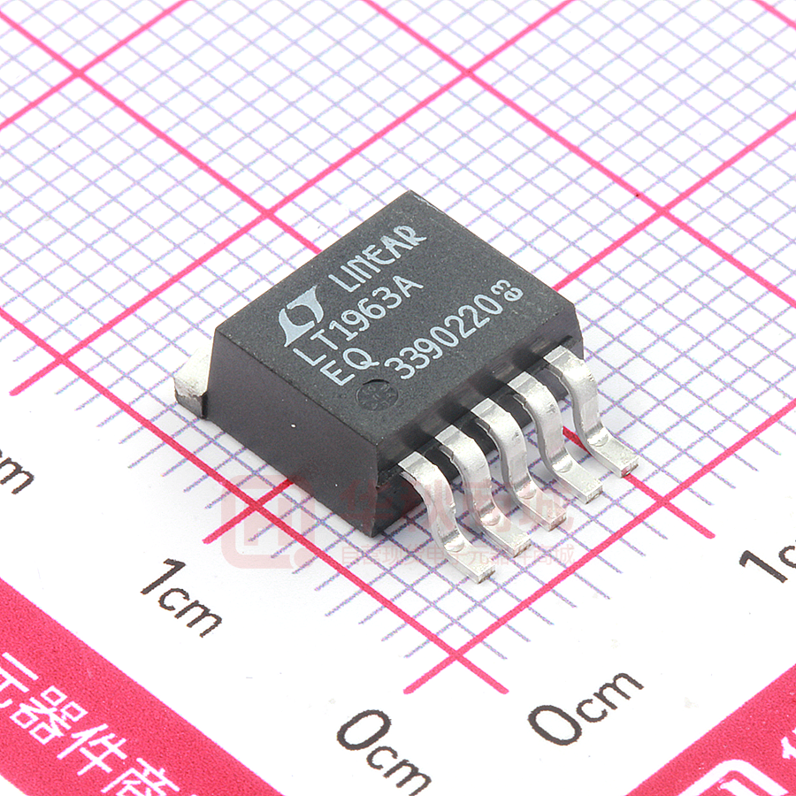

LT1963A Series 1.5A, Low Noise, Fast Transient Response LDO Regulators Features Description Optimized for Fast Transient Response Output Current: 1.5A n Dropout Voltage: 340mV n Low Noise: 40µV RMS (10Hz to 100kHz) n 1mA Quiescent Current n No Protection Diodes Needed n Controlled Quiescent Current in Dropout n Fixed Output Voltages: 1.5V, 1.8V, 2.5V, 3.3V n Adjustable Output from 1.21V to 20V n < 1µA Quiescent Current in Shutdown n Stable with 10µF Output Capacitor* n Stable with Ceramic Capacitors* n Reverse Battery Protection n No Reverse Current n Thermal Limiting n 5-Lead TO-220, DD, 3-Lead SOT-223 and 8-Lead SO Packages The LT ®1963A series are low dropout regulators optimized for fast transient response. The devices are capable of supplying 1.5A of output current with a dropout voltage of 340mV. Operating quiescent current is 1mA, dropping to < 1µA in shutdown. Quiescent current is well controlled; it does not rise in dropout as it does with many other regulators. In addition to fast transient response, the LT1963A regulators have very low output noise which makes them ideal for sensitive RF supply applications. Output voltage range is from 1.21V to 20V. The LT1963A regulators are stable with output capacitors as low as 10µF. Internal protection circuitry includes reverse battery protection, current limiting, thermal limiting and reverse current protection. The devices are available in fixed output voltages of 1.5V, 1.8V, 2.5V, 3.3V and as an adjustable device with a 1.21V reference voltage. The LT1963A regulators are available in 5-lead TO-220, DD, 3‑lead SOT-223, 8-lead SO and 16-lead TSSOP packages. n n Applications n L, LT, LTC, LTM, Linear Technology and the Linear logo are registered trademarks and ThinSOT is a trademark of Linear Technology Corporation. All other trademarks are the property of their respective owners. Protected by U.S. Patents including 6118263, 6144250. n *See Applications Information Section. 3.3V to 2.5V Logic Power Supplies Post Regulator for Switching Supplies Typical Application Dropout Voltage 400 3.3V to 2.5V Regulator VIN > 3V + IN 10µF* OUT LT1963A-2.5 SHDN + 2.5V 1.5A 10µF* SENSE GND 1963A TA01 *TANTALUM, CERAMIC OR ALUMINUM ELECTROLYTIC DROPOUT VOLTAGE (mV) 350 300 250 200 150 100 50 0 0 0.2 0.4 0.6 0.8 1.0 1.2 OUTPUT CURRENT (A) 1.4 1.6 1963A TA02 1963aff For more information www.linear.com/LT1963A 1 LT1963A Series Absolute Maximum Ratings (Note 1) IN Pin Voltage......................................................... ± 20V OUT Pin Voltage.......................................................±20V Input to Output Differential Voltage (Note 2)............±20V SENSE Pin Voltage ................................................ ± 20V ADJ Pin Voltage ....................................................... ±7V SHDN Pin Voltage .................................................. ±20V Output Short-Circuit Duration ......................... Indefinite Operating Junction Temperature Range (Note 3) LT1963AE............................................– 40°C to 125°C LT1963AI............................................– 40°C to 125°C LT1963AMP........................................– 55°C to 125°C Storage Temperature Range....................– 65°C to 150°C Lead Temperature (Soldering, 10 sec)................... 300°C Pin Configuration TOP VIEW FRONT VIEW TAB IS GND FRONT VIEW 5 SENSE/ADJ* 5 SENSE/ ADJ* 4 OUT 4 OUT 3 GND 3 GND 2 IN 2 IN 1 SHDN 1 SHDN TAB IS GND Q PACKAGE 5-LEAD PLASTIC DD 1 16 GND NC 2 15 NC OUT 3 14 IN OUT 4 OUT 5 SENSE/ADJ* 6 11 NC GND 7 10 SHDN GND 8 9 T PACKAGE 5-LEAD PLASTIC TO-220 GND TOP VIEW 3 2 1 OUT GND IN ST PACKAGE 3-LEAD PLASTIC SOT-223 TJMAX = 150°C, θJA = 50°C/ W 2 12 IN *PIN 6 = SENSE FOR LT1963A-1.5/LT1963A-1.8/ LT1963A-2.5/LT1963A-3.3 = ADJ FOR LT1963A TJMAX = 150°C, θJA = 38°C/ W FRONT VIEW TAB IS GND 13 IN 17 FE PACKAGE 16-LEAD PLASTIC TSSOP EXPOSED PAD (PIN 17) IS GND. MUST BE SOLDERED TO THE PCB. *PIN 5 = SENSE FOR LT1963A-1.5/LT1963A-1.8/ LT1963A-2.5/LT1963A-3.3 = ADJ FOR LT1963A TJMAX = 150°C, θJA = 50°C/ W *PIN 5 = SENSE FOR LT1963A-1.5/LT1963A-1.8/ LT1963A-2.5/LT1963A-3.3 = ADJ FOR LT1963A TJMAX = 150°C, θJA = 30°C/ W GND OUT 1 8 IN SENSE/ADJ* 2 7 GND GND 3 6 GND NC 4 5 SHDN S8 PACKAGE 8-LEAD PLASTIC SO *PIN 2 = SENSE FOR LT1963A-1.5/LT1963A-1.8/ LT1963A-2.5/LT1963A-3.3 = ADJ FOR LT1963A TJMAX = 150°C, θJA = 70°C/ W 1963aff For more information www.linear.com/LT1963A LT1963A Series Order Information LEAD FREE FINISH TAPE AND REEL PART MARKING* PACKAGE DESCRIPTION TEMPERATURE RANGE LT1963AEQ#PBF LT1963AEQ#TRPBF LT1963AEQ 5-Lead Plastic DD-Pak –40°C to 125°C LT1963AIQ#PBF LT1963AIQ#TRPBF LT1963AIQ 5-Lead Plastic DD-Pak –40°C to 125°C LT1963AMPQ#PBF LT1963AMPQ#TRPBF LT1963AMPQ 5-Lead Plastic DD-Pak –55°C to 125°C LT1963AEQ-1.5#PBF LT1963AEQ-1.5#TRPBF LT1963AEQ-1.5 5-Lead Plastic DD-Pak –40°C to 125°C LT1963AEQ-1.8#PBF LT1963AEQ-1.8#TRPBF LT1963AEQ-1.8 5-Lead Plastic DD-Pak –40°C to 125°C LT1963AEQ-2.5#PBF LT1963AEQ-2.5#TRPBF LT1963AEQ-2.5 5-Lead Plastic DD-Pak –40°C to 125°C LT1963AEQ-3.3#PBF LT1963AEQ-3.3#TRPBF LT1963AEQ-3.3 5-Lead Plastic DD-Pak –40°C to 125°C LT1963AET#PBF LT1963AET#TRPBF LT1963AET 5-Lead Plastic TO-220 –40°C to 125°C LT1963AIT#PBF LT1963AIT#TRPBF LT1963AIT 5-Lead Plastic TO-220 –40°C to 125°C LT1963AET-1.5#PBF LT1963AET-1.5#TRPBF LT1963AET-1.5 5-Lead Plastic TO-220 –40°C to 125°C LT1963AET-1.8#PBF LT1963AET-1.8#TRPBF LT1963AET-1.8 5-Lead Plastic TO-220 –40°C to 125°C LT1963AET-2.5#PBF LT1963AET-2.5#TRPBF LT1963AET-2.5 5-Lead Plastic TO-220 –40°C to 125°C LT1963AET-3.3#PBF LT1963AET-3.3#TRPBF LT1963AET-3.3 5-Lead Plastic TO-220 –40°C to 125°C LT1963AEFE#PBF LT1963AEFE#TRPBF 1963AEFE 16-Lead Plastic TSSOP –40°C to 125°C LT1963AIFE#PBF LT1963AIFE#TRPBF 1963AIFE 16-Lead Plastic TSSOP –40°C to 125°C LT1963AEFE-1.5#PBF LT1963AEFE-1.5#TRPBF 1963AEFE15 16-Lead Plastic TSSOP –40°C to 125°C LT1963AEFE-1.8#PBF LT1963AEFE-1.8#TRPBF 1963AEFE18 16-Lead Plastic TSSOP –40°C to 125°C LT1963AEFE-2.5#PBF LT1963AEFE-2.5#TRPBF 1963AEFE25 16-Lead Plastic TSSOP –40°C to 125°C LT1963AEFE-3.3#PBF LT1963AEFE-3.3#TRPBF 1963AEFE33 16-Lead Plastic TSSOP –40°C to 125°C LT1963AEST-1.5#PBF LT1963AEST-1.5#TRPBF 963A15 3-Lead Plastic SOT-223 –40°C to 125°C LT1963AEST-1.8#PBF LT1963AEST-1.8#TRPBF 963A18 3-Lead Plastic SOT-223 –40°C to 125°C LT1963AEST-2.5#PBF LT1963AEST-2.5#TRPBF 963A25 3-Lead Plastic SOT-223 –40°C to 125°C LT1963AEST-3.3#PBF LT1963AEST-3.3#TRPBF 963A33 3-Lead Plastic SOT-223 –40°C to 125°C LT1963AES8#PBF LT1963AES8#TRPBF 1963A 8-Lead Plastic SO –40°C to 125°C LT1963AIS8#PBF LT1963AIS8#TRPBF 1963A 8-Lead Plastic SO –40°C to 125°C LT1963AMPS8#PBF LT1963AMPS8#TRPBF 963AMP 8-Lead Plastic SO –55°C to 125°C LT1963AES8-1.5#PBF LT1963AES8-1.5#TRPBF 963A15 8-Lead Plastic SO –40°C to 125°C LT1963AES8-1.8#PBF LT1963AES8-1.8#TRPBF 963A18 8-Lead Plastic SO –40°C to 125°C LT1963AES8-2.5#PBF LT1963AES8-2.5#TRPBF 963A25 8-Lead Plastic SO –40°C to 125°C LT1963AES8-3.3#PBF LT1963AES8-3.3#TRPBF 963A33 8-Lead Plastic SO –40°C to 125°C LEAD BASED FINISH TAPE AND REEL PART MARKING* PACKAGE DESCRIPTION TEMPERATURE RANGE LT1963AEQ LT1963AEQ#TR LT1963AEQ 5-Lead Plastic DD-Pak –40°C to 125°C LT1963AIQ LT1963AIQ#TR LT1963AIQ 5-Lead Plastic DD-Pak –40°C to 125°C LT1963AMPQ LT1963AMPQ#TR LT1963AMPQ 5-Lead Plastic DD-Pak –55°C to 125°C LT1963AEQ-1.5 LT1963AEQ-1.5#TR LT1963AEQ-1.5 5-Lead Plastic DD-Pak –40°C to 125°C LT1963AEQ-1.8 LT1963AEQ-1.8#TR LT1963AEQ-1.8 5-Lead Plastic DD-Pak –40°C to 125°C LT1963AEQ-2.5 LT1963AEQ-2.5#TR LT1963AEQ-2.5 5-Lead Plastic DD-Pak –40°C to 125°C LT1963AEQ-3.3 LT1963AEQ-3.3#TR LT1963AEQ-3.3 5-Lead Plastic DD-Pak –40°C to 125°C LT1963AET LT1963AET#TR LT1963AET 5-Lead Plastic TO-220 –40°C to 125°C LT1963AIT LT1963AIT#TR LT1963AIT 5-Lead Plastic TO-220 –40°C to 125°C 1963aff For more information www.linear.com/LT1963A 3 LT1963A Series order information LEAD BASED FINISH TAPE AND REEL PART MARKING* PACKAGE DESCRIPTION TEMPERATURE RANGE LT1963AET-1.5 LT1963AET-1.5#TR LT1963AET-1.5 5-Lead Plastic TO-220 –40°C to 125°C LT1963AET-1.8 LT1963AET-1.8#TR LT1963AET-1.8 5-Lead Plastic TO-220 –40°C to 125°C LT1963AET-2.5 LT1963AET-2.5#TR LT1963AET-2.5 5-Lead Plastic TO-220 –40°C to 125°C LT1963AET-3.3 LT1963AET-3.3#TR LT1963AET-3.3 5-Lead Plastic TO-220 –40°C to 125°C LT1963AEFE LT1963AEFE#TR 1963AEFE 16-Lead Plastic TSSOP –40°C to 125°C LT1963AIFE LT1963AIFE#TR 1963AIFE 16-Lead Plastic TSSOP –40°C to 125°C LT1963AEFE-1.5 LT1963AEFE-1.5#TR 1963AEFE15 16-Lead Plastic TSSOP –40°C to 125°C LT1963AEFE-1.8 LT1963AEFE-1.8#TR 1963AEFE18 16-Lead Plastic TSSOP –40°C to 125°C LT1963AEFE-2.5 LT1963AEFE-2.5#TR 1963AEFE25 16-Lead Plastic TSSOP –40°C to 125°C LT1963AEFE-3.3 LT1963AEFE-3.3#TR 1963AEFE33 16-Lead Plastic TSSOP –40°C to 125°C LT1963AEST-1.5 LT1963AEST-1.5#TR 963A15 3-Lead Plastic SOT-223 –40°C to 125°C LT1963AEST-1.8 LT1963AEST-1.8#TR 963A18 3-Lead Plastic SOT-223 –40°C to 125°C LT1963AEST-2.5 LT1963AEST-2.5#TR 963A25 3-Lead Plastic SOT-223 –40°C to 125°C LT1963AEST-3.3 LT1963AEST-3.3#TR 963A33 3-Lead Plastic SOT-223 –40°C to 125°C LT1963AES8 LT1963AES8#TR 1963A 8-Lead Plastic SO –40°C to 125°C LT1963AIS8 LT1963AIS8#TR 1963A 8-Lead Plastic SO –40°C to 125°C LT1963AMPS8 LT1963AMPS8#TR 963AMP 8-Lead Plastic SO –55°C to 125°C LT1963AES8-1.5 LT1963AES8-1.5#TR 963A15 8-Lead Plastic SO –40°C to 125°C LT1963AES8-1.8 LT1963AES8-1.8#TR 963A18 8-Lead Plastic SO –40°C to 125°C LT1963AES8-2.5 LT1963AES8-2.5#TR 963A25 8-Lead Plastic SO –40°C to 125°C LT1963AES8-3.3 LT1963AES8-3.3#TR 963A33 8-Lead Plastic SO –40°C to 125°C Consult LTC Marketing for parts specified with wider operating temperature ranges. *The temperature grade is identified by a label on the shipping container. For more information on lead free part marking, go to: http://www.linear.com/leadfree/ For more information on tape and reel specifications, go to: http://www.linear.com/tapeandreel/ 4 1963aff For more information www.linear.com/LT1963A LT1963A Series Electrical Characteristics The l denotes specifications which apply over the full operating temperature range, otherwise specifications are at TA = 25°C. (Note 3) PARAMETER CONDITIONS TYP MAX Minimum Input Voltage (Notes 4,12) ILOAD = 0.5A ILOAD = 1.5A l 1.9 2.1 2.5 V V LT1963A-1.5 VIN = 2.21V, ILOAD = 1mA 2.5V < VIN < 20V, 1mA < ILOAD < 1.5A l 1.477 1.447 1.500 1.500 1.523 1.545 V V LT1963A-1.8 VIN = 2.3V, ILOAD = 1mA 2.8V < VIN < 20V, 1mA < ILOAD < 1.5A l 1.773 1.737 1.800 1.800 1.827 1.854 V V LT1963A-2.5 VIN = 3V, ILOAD = 1mA 3.5V < VIN < 20V, 1mA < ILOAD < 1.5A l 2.462 2.412 2.500 2.500 2.538 2.575 V V LT1963A-3.3 VIN = 3.8V, ILOAD = 1mA 4.3V < VIN < 20V, 1mA < ILOAD < 1.5A l 3.250 3.200 3.300 3.300 3.350 3.400 V V LT1963A VIN = 2.21V, ILOAD = 1mA 2.5V < VIN < 20V, 1mA < ILOAD < 1.5A l 1.192 1.174 1.210 1.210 1.228 1.246 V V Line Regulation LT1963A-1.5 ∆VIN = 2.21V to 20V, ILOAD = 1mA LT1963A-1.8 ∆VIN = 2.3V to 20V, ILOAD = 1mA LT1963A-2.5 ∆VIN = 3V to 20V, ILOAD = 1mA LT1963A-3.3 ∆VIN = 3.8V to 20V, ILOAD = 1mA LT1963A (Note 4) ∆VIN = 2.21V to 20V, ILOAD = 1mA l l l l l 2.0 2.5 3.0 3.5 1.5 6 7 10 10 5 mV mV mV mV mV Load Regulation LT1963A-1.5 VIN = 2.5V, ∆ILOAD = 1mA to 1.5A VIN = 2.5V, ∆ILOAD = 1mA to 1.5A 2 ● 9 18 mV mV LT1963A-1.8 VIN = 2.8V, ∆ILOAD = 1mA to 1.5A VIN = 2.8V, ∆ILOAD = 1mA to 1.5A 2 ● 10 20 mV mV LT1963A-2.5 VIN = 3.5V, ∆ILOAD = 1mA to 1.5A VIN = 3.5V, ∆ILOAD = 1mA to 1.5A 2.5 ● 15 30 mV mV LT1963A-3.3 VIN = 4.3V, ∆ILOAD = 1mA to 1.5A VIN = 4.3V, ∆ILOAD = 1mA to 1.5A 3 ● 20 35 mV mV LT1963A (Note 4) VIN = 2.5V, ∆ILOAD = 1mA to 1.5A VIN = 2.5V, ∆ILOAD = 1mA to 1.5A 2 ● 8 15 mV mV 0.02 0.06 0.10 V V 0.10 0.17 0.22 V V 0.19 0.27 0.35 V V 0.34 0.45 0.55 V V 1.0 1.1 3.8 15 80 1.5 1.6 5.5 25 120 mA mA mA mA mA Regulated Output Voltage (Note 5) ADJ Pin Voltage (Notes 4, 5) MIN UNITS ILOAD = 1mA ILOAD = 1mA ● ILOAD = 100mA ILOAD = 100mA ● ILOAD = 500mA ILOAD = 500mA ● ILOAD = 1.5A ILOAD = 1.5A ● GND Pin Current VIN = VOUT(NOMINAL) + 1V (Notes 6, 8) ILOAD = 0mA ILOAD = 1mA ILOAD = 100mA ILOAD = 500mA ILOAD = 1.5A ● ● ● ● ● Output Voltage Noise COUT = 10µF, ILOAD = 1.5A, BW = 10Hz to 100kHz 40 ADJ Pin Bias Current (Notes 4, 9) 3 10 µA Shutdown Threshold VOUT = Off to On VOUT = On to Off 0.90 0.75 2 V V SHDN Pin Current (Note 10) VSHDN = 0V VSHDN = 20V 0.01 3 1 30 µA µA Quiescent Current in Shutdown VIN = 6V, VSHDN = 0V 0.01 1 µA Dropout Voltage VIN = VOUT(NOMINAL) (Notes 6, 7, 12) ● ● 0.25 µVRMS 1963aff For more information www.linear.com/LT1963A 5 LT1963A Series Electrical Characteristics The l denotes specifications which apply over the full operating temperature range, otherwise specifications are at TA = 25°C. (Note 3) PARAMETER CONDITIONS Ripple Rejection VIN – VOUT = 1.5V (Avg), VRIPPLE = 0.5VP-P, fRIPPLE = 120Hz, ILOAD = 0.75A Current Limit VIN = 7V, VOUT = 0V VIN = VOUT(NOMINAL) + 1V, ∆VOUT = – 0.1V ● Input Reverse Leakage Current (Note 13) Q, T, S8 Packages VIN = –20V, VOUT = 0 ST Package VIN = –20V, VOUT = 0 ● ● Reverse Output Current (Note 11) LT1963A-1.5 LT1963A-1.8 LT1963A-2.5 LT1963A-3.3 LT1963A (Note 4) VOUT = 1.5V, VIN < 1.5V VOUT = 1.8V, VIN < 1.8V VOUT = 2.5V, VIN < 2.5V VOUT = 3.3V, VIN < 3.3V VOUT = 1.21V, VIN < 1.21V Note 1: Stresses beyond those listed under Absolute Maximum Ratings may cause permanent damage to the device. Exposure to any Absolute Maximum Rating condition for extended periods may affect device reliability and lifetime. Note 2: Absolute maximum input to output differential voltage can not be achieved with all combinations of rated IN pin and OUT pin voltages. With the IN pin at 20V, the OUT pin may not be pulled below 0V. The total measured voltage from IN to OUT can not exceed ± 20V. Note 3: The LT1963A regulators are tested and specified under pulse load conditions such that TJ ≈ TA. The LT1963AE is 100% tested at TA = 25°C. Performance at –40°C and 125°C is assured by design, characterization and correlation with statistical process controls. The LT1963AI is guaranteed over the full –40°C to 125°C operating junction temperature range. The LT1963AMP is 100% tested and guaranteed over the –55°C to 125°C operating junction temperature range. Note 4: The LT1963A (adjustable version) is tested and specified for these conditions with the ADJ pin connected to the OUT pin. Note 5: Operating conditions are limited by maximum junction temperature. The regulated output voltage specification will not apply for all possible combinations of input voltage and output current. When operating at maximum input voltage, the output current range must be limited. When operating at maximum output current, the input voltage range must be limited. 6 MIN TYP 55 63 dB 2 A A 1.6 600 600 600 600 300 MAX UNITS 1 2 mA mA 1200 1200 1200 1200 600 µA µA µA µA µA Note 6: To satisfy requirements for minimum input voltage, the LT1963A (adjustable version) is tested and specified for these conditions with an external resistor divider (two 4.12k resistors) for an output voltage of 2.4V. The external resistor divider will add a 300µA DC load on the output. Note 7: Dropout voltage is the minimum input to output voltage differential needed to maintain regulation at a specified output current. In dropout, the output voltage will be equal to: VIN – VDROPOUT. Note 8: GND pin current is tested with VIN = VOUT(NOMINAL) + 1V and a current source load. The GND pin current will decrease at higher input voltages. Note 9: ADJ pin bias current flows into the ADJ pin. Note 10: SHDN pin current flows into the SHDN pin. Note 11: Reverse output current is tested with the IN pin grounded and the OUT pin forced to the rated output voltage. This current flows into the OUT pin and out the GND pin. Note 12: For the LT1963A, LT1963A-1.5 and LT1963A-1.8 dropout voltage will be limited by the minimum input voltage specification under some output voltage/load conditions. Note 13: For the ST package, the input reverse leakage current increases due to the additional reverse leakage current for the SHDN pin, which is tied internally to the IN pin. 1963aff For more information www.linear.com/LT1963A LT1963A Series Typical Performance Characteristics Typical Dropout Voltage Guaranteed Dropout Voltage 600 GUARANTEED DROPOUT VOLTAGE (mV) 450 DROPOUT VOLTAGE (mV) 400 350 TJ = 125°C 300 250 TJ = 25°C 200 150 100 50 0 0 0.2 1.4 0.4 0.6 0.8 1.0 1.2 OUTPUT CURRENT (A) = TEST POINTS 500 450 TJ ≤ 125°C 400 TJ ≤ 25°C 300 200 100 0 1.6 Dropout Voltage 500 350 250 150 0 0.2 1.4 0.4 0.6 0.8 1.0 1.2 OUTPUT CURRENT (A) 0 –50 1.6 1.53 1.83 1.52 1.82 0.2 OUTPUT VOLTAGE (V) VIN = 6V RL = ∞, IL = 0 VSHDN = VIN 0 –50 –25 1.84 IL = 1mA OUTPUT VOLTAGE (V) LT1963A-1.5/1.8/-2.5/-3.3 0.4 1.51 1.50 1.49 1.48 1.47 50 25 75 0 TEMPERATURE (°C) 100 1.46 –50 –25 125 75 50 25 TEMPERATURE (°C) 0 100 3.36 OUTPUT VOLTAGE (V) 2.54 2.52 2.50 2.48 2.46 2.44 0 25 50 75 1.79 1.78 100 125 TEMPERATURE (°C) 0 25 50 75 125 LT1963A ADJ Pin Voltage IL = 1mA 1.225 3.34 3.32 3.30 3.28 3.26 3.22 –50 100 1963A G05 1.230 IL = 1mA 1.220 1.215 1.210 1.205 1.200 1.195 –25 0 25 50 75 100 125 1.190 –50 –25 0 25 50 75 100 125 TEMPERATURE (°C) TEMPERATURE (°C) 1963A G06 –25 TEMPERATURE (°C) 3.24 –25 1.80 1.76 –50 125 ADJ PIN VOLTAGE (V) IL = 1mA 2.42 –50 1.81 LT1963A-3.3 Output Voltage 3.38 125 100 IL = 1mA 1963A G40 LT1963A-2.5 Output Voltage 2.56 50 25 0 75 TEMPERATURE (°C) 1.77 1963A G04 2.58 –25 LT1963A-1.8 Output Voltage 1.2 0.6 IL = 1mA 1963A G03 LT1963A-1.5 Output Voltage LT1963A IL = 100mA 100 1.54 0.8 IL = 0.5A 200 1.4 1.0 IL = 1.5A 300 1963A G02 Quiescent Current QUIESCENT CURRENT (mA) 400 50 1963A G01 OUTPUT VOLTAGE (V) DROPOUT VOLTAGE (mV) 500 1963A G07 1963A G08 1963aff For more information www.linear.com/LT1963A 7 LT1963A Series TYPICAL PERFORMANCE CHARACTERISTICS 14 TJ = 25°C R =∞ 12 L VSHDN = VIN 10 8 6 4 2 8 6 4 1 2 3 4 5 6 7 INPUT VOLTAGE (V) 9 8 0 10 0 1 2 3 4 5 6 7 INPUT VOLTAGE (V) 1.4 8 6 4 2 0 1 2 3 4 5 6 7 INPUT VOLTAGE (V) 8 9 10 1963A G10 LT1963A-1.5 GND Pin Current 1.0 0.8 0.6 0.4 25 TJ = 25°C VSHDN = VIN *FOR VOUT = 1.5V 20 15 RL = 150, IL = 10mA* 10 RL = 5, IL = 300mA* 5 RL = 15, IL = 100mA* 0.2 0 1 2 3 4 5 6 7 INPUT VOLTAGE (V) 8 9 0 10 0 2 4 LT1963A-1.8 GND Pin Current 5 RL = 18, IL = 100mA* 1 2 3 4 5 6 7 INPUT VOLTAGE (V) 20 15 RL = 8.33, IL = 300mA* 10 RL = 25, IL = 100mA* 5 8 9 10 1963A G13 3 4 5 6 7 INPUT VOLTAGE (V) 0 1 2 3 4 5 6 7 INPUT VOLTAGE (V) 8 10 TJ = 25°C VSHDN = VIN *FOR VOUT = 3.3V 20 15 RL = 11, IL = 300mA* 10 RL = 33, IL = 100mA* 5 RL = 250, IL = 10mA* 0 9 8 LT1963A-3.3 GND Pin Current TJ = 25°C VSHDN = VIN *FOR VOUT = 2.5V RL = 180, IL = 10mA* 0 2 25 GND PIN CURRENT (mA) GND PIN CURRENT (mA) TJ = 25°C VSHDN = VIN 20 *FOR VOUT = 1.8V RL = 6, IL = 300mA* 1 1963A G42 LT1963A-2.5 GND Pin Current 25 15 0 1963A G12 25 10 0 6 8 10 12 14 16 18 20 INPUT VOLTAGE (V) 1963A G11 GND PIN CURRENT (mA) 4 0 10 GND PIN CURRENT (mA) 8 8 9 TJ = 25°C RL = 4.3k VSHDN = VIN 1.2 QUIESCENT CURRENT (mA) QUIESCENT CURRENT (mA) 10 0 6 LT1963A Quiescent Current TJ = 25°C RL = ∞ VSHDN = VIN 12 8 1963A G09 LT1963A-3.3 Quiescent Current 14 10 2 2 0 TJ = 25°C RL = ∞ VSHDN = VIN 12 10 1963A G41 0 14 TJ = 25°C RL = ∞ VSHDN = VIN 12 QUIESCENT CURRENT (mA) QUIESCENT CURRENT (mA) 14 0 LT1963A-2.5 Quiescent Current LT1963A-1.8 Quiescent Current QUIESCENT CURRENT (mA) LT1963A-1.5 Quiescent Current 9 10 1963A G14 0 RL = 330, IL = 100mA* 0 1 2 3 4 5 6 7 INPUT VOLTAGE (V) 8 9 10 1963A G15 1963aff For more information www.linear.com/LT1963A LT1963A Series TYPICAL PERFORMANCE CHARACTERISTICS TJ = 25°C VSHDN = VIN *FOR VOUT = 1.21V 8 RL = 4.33, IL = 300mA* 6 4 RL = 12.1, IL = 100mA* 80 70 60 RL = 1, IL = 1.5A* 50 RL = 1.5, IL = 1A* 40 30 2 RL = 3, IL = 500mA* 20 RL = 121, IL = 10mA* 0 0 1 2 3 4 5 6 7 INPUT VOLTAGE (V) 8 9 10 1 2 3 4 5 6 7 INPUT VOLTAGE (V) 80 70 0 50 40 RL = 3.3, IL = 1A* 30 RL = 5, IL = 500mA* 1 2 3 4 5 6 7 INPUT VOLTAGE (V) 9 0 10 0 1 2 3 4 5 6 7 INPUT VOLTAGE (V) SHDN PIN THRESHOLD (V) GND PIN CURRENT (mA) 0.9 60 50 40 30 20 9 0 0.2 0.4 0.6 0.8 1.0 1.2 OUTPUT CURRENT (A) 60 1.4 1.6 40 30 1963A G21 RL = 1.21, IL = 1A* RL = 2.42, IL = 500mA* 0 1 2 3 4 5 6 7 INPUT VOLTAGE (V) 8 9 10 1963A G20 SHDN Pin Threshold (Off-to-On) 1.0 IL = 1mA 0.9 0.8 0.7 0.6 0.5 0.4 0.3 0.2 0 –50 10 RL = 0.81, IL = 1.5A* 50 0 10 IL = 1.5A 0.8 0.7 0.6 IL = 1mA 0.5 0.4 0.3 0.2 0.1 0.1 10 0 8 9 70 10 SHDN PIN THRESHOLD (V) VIN = VOUT (NOMINAL) +1V 70 8 TJ = 25°C VSHDN = VIN *FOR VOUT = 1.21V 80 SHDN Pin Threshold (On-to-Off) 1.0 80 3 4 5 6 7 INPUT VOLTAGE (V) 1963A G19 GND Pin Current vs ILOAD 90 2 90 RL = 6.6, IL = 500mA* 1963A G18 100 1 20 10 8 0 100 20 0 RL = 3.6, IL = 500mA* LT1963A GND Pin Current RL = 2.2, IL = 1.5A* 60 20 10 RL = 1.8, IL = 1A* 1963A G17 GND PIN CURRENT (mA) RL = 2.5, IL = 1A* 30 10 TJ = 25°C VSHDN = VIN *FOR VOUT = 3.3V 90 50 40 30 LT1963A-3.3 GND Pin Current RL = 1.67, IL = 1.5A* 60 40 1963A G43 GND PIN CURRENT (mA) GND PIN CURRENT (mA) 70 50 20 9 8 RL = 1.2, IL = 1.5A* 60 0 100 TJ = 25°C VSHDN = VIN *FOR VOUT = 2.5V 80 70 0 LT1963A-2.5 GND Pin Current 90 80 10 0 TJ = 25°C VSHDN = VIN *FOR VOUT = 1.8V 90 10 1963A G16 100 LT1963A-1.8 GND Pin Current 100 TJ = 25°C VSHDN = VIN *FOR VOUT = 1.5V 90 GND PIN CURRENT (mA) GND PIN CURRENT (mA) LT1963A-1.5 GND Pin Current 100 GND PIN CURRENT (mA) LT1963A GND Pin Current 10 –25 50 25 0 75 TEMPERATURE (°C) 100 125 1963A G22 0 –50 –25 50 25 0 75 TEMPERATURE (°C) 100 125 1963A G23 1963aff For more information www.linear.com/LT1963A 9 LT1963A Series TYPICAL PERFORMANCE CHARACTERISTICS SHDN Pin Input Current SHDN Pin Input Current 7 SHDN PIN INPUT CURRENT (µA) SHDN PIN INPUT CURRENT (µA) 4.5 4.0 3.5 3.0 2.5 2.0 1.5 1.0 0.5 0 0 2 4 VSHDN = 20V 4.5 6 5 4 3 2 1 0 –50 –25 6 8 10 12 14 16 18 20 SHDN PIN VOLTAGE (V) ADJ Pin Bias Current 5.0 ADJ PIN BIAS CURRENT (µA) 5.0 3.5 3.0 2.5 2.0 1.5 1.0 0.5 50 25 75 0 TEMPERATURE (°C) 100 0 –50 125 –25 50 25 0 75 TEMPERATURE (°C) 1963A G25 1963A G24 Current Limit 4.0 3.0 CURRENT LIMIT (A) TJ = –50°C TJ = 125°C 1.5 1.0 1963A G26 Current Limit 2.5 2.0 1.5 1.0 0.5 ΔVOUT = 100mV 0 0 2 0 –50 6 8 10 12 14 16 18 20 4 INPUT/OUTPUT DIFFERENTIAL (V) –25 50 0 75 25 TEMPERATURE (°C) 100 Reverse Output Current Reverse Output Current 1.0 4.5 LT1963A-1.8 4.0 LT1963A-1.5 3.5 3.0 LT1963A 2.5 2.0 LT1963A-3.3 T = 25°C J VIN = 0V LT1963A-2.5 CURRENT FLOWS INTO OUTPUT PIN VOUT = VADJ (LT1963A) VOUT = VFB (LT1963A-1.5/1.8/-2.5/-3.3) 1.5 1.0 0.5 0 1 2 3 4 5 6 7 8 OUTPUT VOLTAGE (V) 9 REVERSE OUTPUT CURRENT (mA) 5.0 0 125 1963A G28 1963A G27 REVERSE OUTPUT CURRENT (mA) 125 3.0 TJ = 25°C 2.0 0.5 VIN = 0V 0.9 VOUT = 1.21V (LT1963A) = 1.5V (LT1963A-1.5) V 0.8 VOUT = 1.8V (LT1963A-1.8) OUT 0.7 VOUT = 2.5V (LT1963A-2.5) VOUT = 3.3V (LT1963A-3.3) 0.6 LT1963A-1.8/-2.5/-3.3 0.5 0.4 LT1963A 0.3 0.2 0.1 10 1963A G29 10 100 VIN = 7V 3.5 VOUT = 0V 2.5 CURRENT LIMIT (A) 4.0 0 –50 –25 50 25 0 75 TEMPERATURE (°C) 100 125 1963A G30 1963aff For more information www.linear.com/LT1963A LT1963A Series TYPICAL PERFORMANCE CHARACTERISTICS Ripple Rejection LT1963A Minimum Input Voltage 3.0 70 74 2.5 RIPPLE REJECTION (dB) 60 50 40 COUT = 100µF TANTALUM +10 × 1µF CERAMIC 30 COUT = 10µF TANTALUM 20 MINIMUM INPUT VOLTAGE (V) 76 72 70 68 66 64 IL = 0.75A VIN = VOUT(NOMINAL) +1V + 0.5VP-P RIPPLE AT f = 120Hz 62 50 100 25 75 –50 –25 0 TEMPERATURE (°C) 10 IL = 0.75A VIN = VOUT(NOMINAL) +1V + 50mVRMS RIPPLE 0 10 1k 10k 1M 100 100k FREQUENCY (Hz) 1963A G31 125 Load Regulation 0 –15 OUTPUT NOISE SPECTRAL DENSITY (µV/√Hz) LOAD REGULATION (mV) LT1963A-1.5 LT1963A LT1963A-1.8 LT1963A-2.5 LT1963A-3.3 –10 VIN = VOUT(NOMINAL) +1V (LT1963A-1.8/-2.5/-3.3) VIN = 2.7V (LT1963A/LT1963A-1.5) ΔIL = 1mA TO 1.5A –20 –50 –25 IL = 100mA 1.5 1.0 0.5 0 –50 –25 50 25 75 0 TEMPERATURE (°C) 50 25 75 0 TEMPERATURE (°C) 100 125 125 1.0 COUT = 10µF IL =1.5A LT1963A-3.3 0.1 LT1963A-2.5 LT1963A-1.8 LT1963A-1.5 0.01 10 100 LT1963A 1k 10k FREQUENCY (Hz) 100k 1963A G35 RMS Output Noise vs Load Current (10Hz to 100kHz) 45 100 1963A G33 1963A G34 50 IL = 500mA 2.0 Output Noise Spectral Density 5 –5 IL = 1.5A 1963A G32 10 OUTPUT NOISE VOLTAGE (µVRMS) RIPPLE REJECTION (dB) Ripple Rejection 80 LT1963A-3.3 10Hz to 100kHz Output Noise COUT = 10µF 40 LT1963A-3.3 35 LT1963A-2.5 30 25 VOUT 100µV/DIV LT1963A-1.8 20 LT1963A-1.5 15 LT1963A 10 5 0 0.0001 0.001 0.01 0.1 LOAD CURRENT (A) 1 10 COUT = 10µF ILOAD = 1.5A 1ms/DIV 1963A G37 1963A G36 1963aff For more information www.linear.com/LT1963A 11 LT1963A Series TYPICAL PERFORMANCE CHARACTERISTICS LT1963A-3.3 Transient Response LT1963A-3.3 Transient Response 150 VIN = 4.3V 150 CIN = 3.3µF TANTALUM COUT = 10µF TANTALUM 100 OUTPUT VOLTAGE DEVIATION (mV) OUTPUT VOLTAGE DEVIATION (mV) 200 50 0 –50 100 50 0 –50 –100 1.5 LOAD CURRENT (A) –150 0.6 LOAD CURRENT (A) –100 0.4 0.2 0 0 2 4 6 8 10 12 14 16 18 20 TIME (µs) VIN = 4.3V CIN = 33µF TANTALUM COUT = 100µF TANTALUM +10 × 1µF CERAMIC 1.0 0.5 0 0 1963A G38 12 50 100 150 200 250 300 350 400 450 500 TIME (µs) 1963A G39 1963aff For more information www.linear.com/LT1963A LT1963A Series Pin Functions OUT: Output. The output supplies power to the load. A minimum output capacitor of 10µF is required to prevent oscillations. Larger output capacitors will be required for applications with large transient loads to limit peak voltage transients. See the Applications Information section for more information on output capacitance and reverse output characteristics. SENSE: Sense. For fixed voltage versions of the LT1963A (LT1963A-1.5/LT1963A-1.8/LT1963A-2.5/LT1963A-3.3), the SENSE pin is the input to the error amplifier. Optimum regulation will be obtained at the point where the SENSE pin is connected to the OUT pin of the regulator. In critical applications, small voltage drops are caused by the resistance (RP) of PC traces between the regulator and the load. These may be eliminated by connecting the SENSE pin to the output at the load as shown in Figure 1 (Kelvin Sense Connection). Note that the voltage drop across the external PC traces will add to the dropout voltage of the regulator. The SENSE pin bias current is 600µA at the nominal rated output voltage. The SENSE pin can be pulled below ground (as in a dual supply system where the regulator load is returned to a negative supply) and still allow the device to start and operate. ADJ: Adjust. For the adjustable LT1963A, this is the input to the error amplifier. This pin is internally clamped to ± 7V. It has a bias current of 3µA which flows into the pin. The ADJ pin voltage is 1.21V referenced to ground and the output voltage range is 1.21V to 20V. SHDN: Shutdown. The SHDN pin is used to put the LT1963A regulators into a low power shutdown state. The output will be off when the SHDN pin is pulled low. The SHDN pin can be driven either by 5V logic or open-collector logic with a pull-up resistor. The pull-up resistor is required to supply the pull-up current of the open-collector gate, normally several microamperes, and the SHDN pin current, typically 3µA. If unused, the SHDN pin must be connected to VIN. The device will be in the low power shutdown state if the SHDN pin is not connected. IN: Input. Power is supplied to the device through the IN pin. A bypass capacitor is required on this pin if the device is more than six inches away from the main input filter capacitor. In general, the output impedance of a battery rises with frequency, so it is advisable to include a bypass capacitor in battery-powered circuits. A bypass capacitor in the range of 1µF to 10µF is sufficient. The LT1963A regulators are designed to withstand reverse voltages on the IN pin with respect to ground and the OUT pin. In the case of a reverse input, which can happen if a battery is plugged in backwards, the device will act as if there is a diode in series with its input. There will be no reverse current flow into the regulator and no reverse voltage will appear at the load. The device will protect both itself and the load. IN OUT LT1963A VIN + SHDN RP + SENSE LOAD GND RP 1963A F01 Figure 1. Kelvin Sense Connection 1963aff For more information www.linear.com/LT1963A 13 LT1963A Series Applications Information The LT1963A series are 1.5A low dropout regulators optimized for fast transient response. The devices are capable of supplying 1.5A at a dropout voltage of 350mV. The low operating quiescent current (1mA) drops to less than 1µA in shutdown. In addition to the low quiescent current, the LT1963A regulators incorporate several protection features which make them ideal for use in battery-powered systems. The devices are protected against both reverse input and reverse output voltages. In battery backup applications where the output can be held up by a backup battery when the input is pulled to ground, the LT1963A‑X acts like it has a diode in series with its output and prevents reverse current flow. Additionally, in dual supply applications where the regulator load is returned to a negative supply, the output can be pulled below ground by as much as 20V and still allow the device to start and operate. Adjustable Operation The adjustable version of the LT1963A has an output voltage range of 1.21V to 20V. The output voltage is set by the ratio of two external resistors as shown in Figure 2. The device servos the output to maintain the voltage at the ADJ pin at 1.21V referenced to ground. The current in R1 is then equal to 1.21V/R1 and the current in R2 is the current in R1 plus the ADJ pin bias current. The ADJ pin bias current, 3µA at 25°C, flows through R2 into the ADJ pin. The output voltage can be calculated using the formula in Figure 2. The value of R1 should be less than 4.17k to minimize errors in the output voltage caused by the ADJ pin bias current. Note that in shutdown the output is turned off and the divider current will be zero. The adjustable device is tested and specified with the ADJ pin tied to the OUT pin for an output voltage of 1.21V. Specifications for output voltages greater than 1.21V will be proportional to the ratio of the desired output voltage to 1.21V: VOUT/1.21V. For example, load regulation for an output current change of 1mA to 1.5A is – 3mV typical at VOUT = 1.21V. At VOUT = 5V, load regulation is: (5V/1.21V)(–3mV) = –12.4mV Output Capacitors and Stability The LT1963A regulator is a feedback circuit. Like any feedback circuit, frequency compensation is needed to 14 IN VIN OUT LT1963A R2 + ADJ GND R1 VOUT  R2  VOUT =1.21V 1+  + (IADJ ) (R2)  R1  VADJ =1.21V IADJ = 3µA AT 25°C 1963A F02 OUTPUT RANGE = 1.21V TO 20V Figure 2. Adjustable Operation make it stable. For the LT1963A, the frequency compensation is both internal and external—the output capacitor. The size of the output capacitor, the type of the output capacitor, and the ESR of the particular output capacitor all affect the stability. In addition to stability, the output capacitor also affects the high frequency transient response. The regulator loop has a finite band width. For high frequency transient loads, recovery from a transient is a combination of the output capacitor and the bandwidth of the regulator. The LT1963A was designed to be easy to use and accept a wide variety of output capacitors. However, the frequency compensation is affected by the output capacitor and optimum frequency stability may require some ESR, especially with ceramic capacitors. For ease of use, low ESR polytantalum capacitors (POSCAP) are a good choice for both the transient response and stability of the regulator. These capacitors have intrinsic ESR that improves the stability. Ceramic capacitors have extremely low ESR, and while they are a good choice in many cases, placing a small series resistance element will sometimes achieve optimum stability and minimize ringing. In all cases, a minimum of 10µF is required while the maximum ESR allowable is 3Ω. The place where ESR is most helpful with ceramics is low output voltage. At low output voltages, below 2.5V, some ESR helps the stability when ceramic output capacitors are used. Also, some ESR allows a smaller capacitor value to be used. When small signal ringing occurs with ceramics due to insufficient ESR, adding ESR or increasing the capacitor value improves the stability and reduces the ringing. Table 1 gives some recommended values of ESR to minimize ringing caused by fast, hard current transitions. 1963aff For more information www.linear.com/LT1963A LT1963A Series APPLICATIONS INFORMATION Table 1. Capacitor Minimum ESR VOUT 10µF 22µF 47µF 100µF 1.2V 20mΩ 15mΩ 10mΩ 5mΩ 1.5V 20mΩ 15mΩ 10mΩ 5mΩ 1.8V 15mΩ 10mΩ 10mΩ 5mΩ 2.5V 5mΩ 5mΩ 5mΩ 5mΩ 3.3V 0mΩ 0mΩ 0mΩ 5mΩ ≥5V 0mΩ 0mΩ 0mΩ 0mΩ Figures 3 through 8 show the effect of ESR on the transient response of the regulator. These scope photos show the transient response for the LT1963A at three different output voltages with various capacitors and various values of ESR. The output load conditions are the same for all traces. In all cases there is a DC load of 500mA. The load steps up to 1A at the first transition and steps back to 500mA at the second transition. At the worst case point of 1.2VOUT with 10µF COUT (Figure 3), a minimum amount of ESR is required. While 20mΩ is enough to eliminate most of the ringing, a value closer to 50mΩ provides a more optimum response. At 2.5V output with 10µF COUT (Figure 4) the output rings at the transitions with 0Ω ESR but still settles to within 10mV in 20µs after the 0.5A load step. Once again a small value of ESR will provide a more optimum response. At 5VOUT with 10µF COUT (Figure 5) the response is well damped with 0Ω ESR. With a COUT of 100µF at 0Ω ESR and an output of 1.2V (Figure 6), the output rings although the amplitude is only 20mVp-p. With COUT of 100µF it takes only 5mΩ to 20mΩ of ESR to provide good damping at 1.2V output. Performance at 2.5V and 5V output with 100µF COUT shows similar characteristics to the 10µF case (see Figures 7-8). At 2.5VOUT 5mΩ to 20mΩ can improve transient response. At 5VOUT the response is well damped with 0Ω ESR. Capacitor types with inherently higher ESR can be combined with 0mΩ ESR ceramic capacitors to achieve both good high frequency bypassing and fast settling time. Figure 9 illustrates the improvement in transient response that can be seen when a parallel combination of ceramic and POSCAP capacitors are used. The output voltage is at the worst case value of 1.2V. Trace A, is with a 10µF ceramic output capacitor and shows significant ringing with a peak amplitude of 25mV. For Trace B, a 22µF/45mΩ POSCAP is added in parallel with the 10µF ceramic. The output is well damped and settles to within 10mV in less than 20µs. For Trace C, a 100µF/35mΩ POSCAP is connected in parallel with the 10µF ceramic capacitor. In this case the peak output deviation is less than 20mV and the output settles in about 10µs. For improved transient response the value of the bulk capacitor (tantalum or aluminum electrolytic) should be greater than twice the value of the ceramic capacitor. Tantalum and Polytantalum Capacitors There is a variety of tantalum capacitor types available, with a wide range of ESR specifications. Older types have ESR specifications in the hundreds of mΩ to several Ohms. Some newer types of polytantalum with multi-electrodes have maximum ESR specifications as low as 5mΩ. In general the lower the ESR specification, the larger the size and the higher the price. Polytantalum capacitors have better surge capability than older types and generally lower ESR. Some types such as the Sanyo TPE and TPB series have ESR specifications in the 20mΩ to 50mΩ range, which provide near optimum transient response. Aluminum Electrolytic Capacitors Aluminum electrolytic capacitors can also be used with the LT1963A. These capacitors can also be used in conjunction with ceramic capacitors. These tend to be the cheapest and lowest performance type of capacitors. Care must be used in selecting these capacitors as some types can have ESR which can easily exceed the 3Ω maximum value. Ceramic Capacitors Extra consideration must be given to the use of ceramic capacitors. Ceramic capacitors are manufactured with a variety of dielectrics, each with different behavior over temperature and applied voltage. The most common dielectrics used are Z5U, Y5V, X5R and X7R. The Z5U and 1963aff For more information www.linear.com/LT1963A 15 LT1963A Series APPLICATIONS INFORMATION VOUT = 1.2V IOUT = 500mA WITH 500mA PULSE COUT = 10µF RESR (mΩ) 50 5 50mV/DIV 50mV/DIV 20 VOUT = 1.2V IOUT = 500mA WITH 500mA PULSE COUT = 100µF 0 RESR (mΩ) 0 10 20 100 20µs/DIV 1963A F03 50µs/DIV Figure 3 Figure 6 VOUT = 2.5V IOUT = 500mA WITH 500mA PULSE COUT = 10µF RESR (mΩ) 50 VOUT = 2.5V IOUT = 500mA WITH 500mA PULSE COUT = 100µF 0 100 5 50mV/DIV 20 50mV/DIV RESR (mΩ) 0 10 20 20µs/DIV 1963A F04 50µs/DIV Figure 4 1963A F07 Figure 7 VOUT = 5V IOUT = 500mA WITH 500mA PULSE COUT = 10µF 50 5 50mV/DIV 50mV/DIV 20 VOUT = 5V IOUT = 500mA WITH 500mA PULSE COUT = 100µF 0 RESR (mΩ) 0 RESR (mΩ) 1963A F06 10 20 100 20µs/DIV 1963A F05 50µs/DIV 1963A F08 Figure 8 Figure 5 50mV/DIV RESR (mΩ) A B VOUT = 1.2V IOUT = 500mA WITH 500mA PULSE COUT = A = 10µF CERAMIC B = 10µF CERAMIC II 22µF/45mΩ POLY C = 10µF CERAMIC II 100µF/35mΩ POLY C 50µs/DIV 1963A F09 Figure 9 16 1963aff For more information www.linear.com/LT1963A LT1963A Series APPLICATIONS INFORMATION Y5V dielectrics are good for providing high capacitances in a small package, but exhibit strong voltage and temperature coefficients as shown in Figures 10 and 11. When used with a 5V regulator, a 10µF Y5V capacitor can exhibit an effective value as low as 1µF to 2µF over the operating temperature range. The X5R and X7R dielectrics result in more stable characteristics and are more suitable for use as the output capacitor. The X7R type has better stability across temperature, while the X5R is less expensive and is available in higher values. Voltage and temperature coefficients are not the only sources of problems. Some ceramic capacitors have a piezoelectric response. A piezoelectric device generates voltage across its terminals due to mechanical stress, similar to the way a piezoelectric accelerometer or microphone works. For a ceramic capacitor the stress can be induced by vibrations in the system or thermal transients. “FREE” Resistance with PC Traces The resistance values shown in Table 2 can easily be made using a small section of PC trace in series with the output capacitor. The wide range of non-critical ESR makes it easy to use PC trace. The trace width should be sized to handle the RMS ripple current associated with the load. The output capacitor only sources or sinks current for a few microseconds during fast output current transitions. There is no DC current in the output capacitor. Worst case ripple current will occur if the output load is a high frequency (>100kHz) square wave with a high peak value and fast edges (< 1µs). Measured RMS value for this case is 0.5 times the peak-to-peak current change. Slower edges or lower frequency will significantly reduce the RMS ripple current in the capacitor. Table 2. PC Trace Resistors 20mΩ 30mΩ 0.011" (0.28mm) 0.204" (5.2mm) 0.011" (0.28mm) 0.307" (7.8mm) 0.5oz CU Width Length 0.011" (0.28mm) 0.102" (2.6mm) 1.0oz CU Width Length 0.006" (0.15mm) 0.110" (2.8mm) 0.006" (0.15mm) 0.220" (5.6mm) 0.006" (0.15mm) 0.330" (8.4mm) 2.0oz CU Width Length 0.006" (0.15mm) 0.224" (5.7mm) 0.006" (0.15mm) 0.450" (11.4mm) 0.006" (0.15mm) 0.670" (17mm) 20 40 BOTH CAPACITORS ARE 16V, 1210 CASE SIZE, 10µF 0 20 X5R CHANGE IN VALUE (%) CHANGE IN VALUE (%) 10mΩ –20 –40 –60 Y5V –80 –100 –20 –40 2 4 8 6 10 12 DC BIAS VOLTAGE (V) 14 16 BOTH CAPACITORS ARE 16V, 1210 CASE SIZE, 10µF –100 –50 –25 1963A F10 Figure 10. Ceramic Capacitor DC Bias Characteristics Y5V –60 –80 0 X5R 0 50 25 75 0 TEMPERATURE (°C) 100 125 1963A F11 Figure 11. Ceramic Capacitor Temperature Characteristics 1963aff For more information www.linear.com/LT1963A 17 LT1963A Series APPLICATIONS INFORMATION This resistor should be made using one of the inner layers of the PC board which are well defined. The resistivity is determined primarily by the sheet resistance of the copper laminate with no additional plating steps. Table 2 gives some sizes for 0.75A RMS current for various copper thicknesses. More detailed information regarding resistors made from PC traces can be found in Application Note 69, Appendix A. Overload Recovery Like many IC power regulators, the LT1963A-X has safe operating area protection. The safe area protection decreases the current limit as input-to-output voltage increases and keeps the power transistor inside a safe operating region for all values of input-to-output voltage. The protection is designed to provide some output current at all values of input-to-output voltage up to the device breakdown. When power is first turned on, as the input voltage rises, the output follows the input, allowing the regulator to start up into very heavy loads. During the start-up, as the input voltage is rising, the input-to-output voltage differential is small, allowing the regulator to supply large output currents. With a high input voltage, a problem can occur wherein removal of an output short will not allow the output voltage to recover. Other regulators, such as the LT1085, also exhibit this phenomenon, so it is not unique to the LT1963A-X. The problem occurs with a heavy output load when the input voltage is high and the output voltage is low. Common situations are immediately after the removal of a shortcircuit or when the shutdown pin is pulled high after the input voltage has already been turned on. The load line for such a load may intersect the output current curve at two points. If this happens, there are two stable output operating points for the regulator. With this double intersection, the input power supply may need to be cycled down to zero and brought up again to make the output recover. Output Voltage Noise The LT1963A regulators have been designed to provide low output voltage noise over the 10Hz to 100kHz bandwidth while operating at full load. Output voltage noise is 18 typically 40nV/√Hz over this frequency bandwidth for the LT1963A (adjustable version). For higher output voltages (generated by using a resistor divider), the output voltage noise will be gained up accordingly. This results in RMS noise over the 10Hz to 100kHz bandwidth of 14µVRMS for the LT1963A increasing to 38µVRMS for the LT1963A-3.3. Higher values of output voltage noise may be measured when care is not exercised with regard to circuit layout and testing. Crosstalk from nearby traces can induce unwanted noise onto the output of the LT1963A-X. Power supply ripple rejection must also be considered; the LT1963A regulators do not have unlimited power supply rejection and will pass a small portion of the input noise through to the output. Thermal Considerations The power handling capability of the device is limited by the maximum rated junction temperature (125°C). The power dissipated by the device is made up of two components: 1. Output current multiplied by the input/output voltage differential: (IOUT)(VIN – VOUT), and 2. GND pin current multiplied by the input voltage: (IGND) (VIN). The GND pin current can be found using the GND Pin Current curves in the Typical Performance Characteristics. Power dissipation will be equal to the sum of the two components listed above. The LT1963A series regulators have internal thermal limiting designed to protect the device during overload conditions. For continuous normal conditions, the maximum junction temperature rating of 125°C must not be exceeded. It is important to give careful consideration to all sources of thermal resistance from junction to ambient. Additional heat sources mounted nearby must also be considered. For surface mount devices, heat sinking is accomplished by using the heat spreading capabilities of the PC board and its copper traces. Copper board stiffeners and plated through-holes can also be used to spread the heat generated by power devices. 1963aff For more information www.linear.com/LT1963A LT1963A Series APPLICATIONS INFORMATION The following tables list thermal resistance for several different board sizes and copper areas. All measurements were taken in still air on 1/16" FR-4 board with one ounce copper. Table 3. Q Package, 5-Lead DD COPPER AREA TOPSIDE* BACKSIDE BOARD AREA THERMAL RESISTANCE (JUNCTION-TO-AMBIENT) 2500mm2 2500mm2 2500mm2 23°C/W 1000mm2 2500mm2 2500mm2 25°C/W 125mm2 2500mm2 2500mm2 33°C/W *Device is mounted on topside Table 4. S0-8 Package, 8-Lead SO COPPER AREA TOPSIDE* BACKSIDE BOARD AREA THERMAL RESISTANCE (JUNCTION-TO-AMBIENT) 2500mm2 2500mm2 2500mm2 55°C/W 1000mm2 2500mm2 2500mm2 55°C/W 225mm2 2500mm2 2500mm2 63°C/W 125mm2 2500mm2 2500mm2 69°C/W IOUT(MAX)(VIN(MAX) – VOUT) + IGND(VIN(MAX)) where, IOUT(MAX) = 500mA VIN(MAX) = 6V IGND at (IOUT = 500mA, VIN = 6V) = 10mA So, P = 500mA(6V – 3.3V) + 10mA(6V) = 1.41W Using a DD package, the thermal resistance will be in the range of 23°C/W to 33°C/W depending on the copper area. So the junction temperature rise above ambient will be approximately equal to: 1.41W(28°C/W) = 39.5°C The maximum junction temperature will then be equal to the maximum junction temperature rise above ambient plus the maximum ambient temperature or: TJMAX = 50°C + 39.5°C = 89.5°C *Device is mounted on topside Protection Features Table 5. SOT-223 Package, 3-Lead SOT-223 COPPER AREA TOPSIDE* BACKSIDE The power dissipated by the device will be equal to: BOARD AREA THERMAL RESISTANCE (JUNCTION-TO-AMBIENT) 2500mm2 2500mm2 2500mm2 42°C/W 1000mm2 2500mm2 2500mm2 42°C/W 225mm2 2500mm2 2500mm2 50°C/W 100mm2 2500mm2 2500mm2 56°C/W 1000mm2 1000mm2 1000mm2 49°C/W 1000mm2 0mm2 1000mm2 52°C/W *Device is mounted on topside T Package, 5-Lead TO-220 Thermal Resistance (Junction-to-Case) = 4°C/W Calculating Junction Temperature Example: Given an output voltage of 3.3V, an input voltage range of 4V to 6V, an output current range of 0mA to 500mA and a maximum ambient temperature of 50°C, what will the maximum junction temperature be? The LT1963A regulators incorporate several protection features which make them ideal for use in battery-powered circuits. In addition to the normal protection features associated with monolithic regulators, such as current limiting and thermal limiting, the devices are protected against reverse input voltages, reverse output voltages and reverse voltages from output to input. Current limit protection and thermal overload protection are intended to protect the device against current overload conditions at the output of the device. For normal operation, the junction temperature should not exceed 125°C. The input of the device will withstand reverse voltages of 20V. Current flow into the device will be limited to less than 1mA (typically less than 100µA) and no negative voltage will appear at the output. The device will protect both itself and the load. This provides protection against batteries that can be plugged in backward. 1963aff For more information www.linear.com/LT1963A 19 LT1963A Series APPLICATIONS INFORMATION The ADJ pin of the adjustable device can be pulled above or below ground by as much as 7V without damaging the device. If the input is left open circuit or grounded, the ADJ pin will act like an open circuit when pulled below ground and like a large resistor (typically 5k) in series with a diode when pulled above ground. In situations where the ADJ pin is connected to a resistor divider that would pull the ADJ pin above its 7V clamp voltage if the output is pulled high, the ADJ pin input current must be limited to less than 5mA. For example, a resistor divider is used to provide a regulated 1.5V output from the 1.21V reference when the output is forced to 20V. The top resistor of the resistor divider must be chosen to limit the current into the ADJ pin to less than 5mA when the ADJ pin is at 7V. The 13V difference between OUT and ADJ pins divided by the 5mA maximum current into the ADJ pin yields a minimum top resistor value of 2.6k. 20 In circuits where a backup battery is required, several different input/output conditions can occur. The output voltage may be held up while the input is either pulled to ground, pulled to some intermediate voltage, or is left open circuit. Current flow back into the output will follow the curve shown in Figure 12. When the IN pin of the LT1963A is forced below the OUT pin or the OUT pin is pulled above the IN pin, input current will typically drop to less than 2µA. This can happen if the input of the device is connected to a discharged (low voltage) battery and the output is held up by either a backup battery or a second regulator circuit. The state of the SHDN pin will have no effect on the reverse output current when the output is pulled above the input. 5.0 REVERSE OUTPUT CURRENT (mA) The output of the LT1963A can be pulled below ground without damaging the device. If the input is left open circuit or grounded, the output can be pulled below ground by 20V. For fixed voltage versions, the output will act like a large resistor, typically 5k or higher, limiting current flow to typically less than 600µA. For adjustable versions, the output will act like an open circuit; no current will flow out of the pin. If the input is powered by a voltage source, the output will source the short-circuit current of the device and will protect itself by thermal limiting. In this case, grounding the SHDN pin will turn off the device and stop the output from sourcing the short-circuit current. LT1963A VOUT = VADJ 4.5 4.0 LT1963A-1.5 VOUT = VFB 3.5 LT1963A-1.8 3.0 VOUT = VFB 2.5 LT1963A-2.5 VOUT = VFB 2.0 1.5 1.0 0.5 0 0 1 2 LT1963A-3.3 VOUT = VFB TJ = 25°C VIN = 0V CURRENT FLOWS INTO OUTPUT PIN 3 4 5 6 7 8 OUTPUT VOLTAGE (V) 9 10 1963A F12 Figure 12. Reverse Output Current 1963aff For more information www.linear.com/LT1963A LT1963A Series Typical Applications SCR Pre-Regulator Provides Efficiency Over Line Variations L1 500µH L2 1N4148 10VAC AT 115VIN 90-140 VAC LT1963A-3.3 IN OUT + SHDN GND 10000µF 1k FB 3.3VOUT 1.5A + 22µF 34k* 10VAC AT 115VIN 1N4002 1N4002 1N4002 TO ALL “+V” POINTS + 22µF 12.1k* +V “SYNC” 2.4k + 750Ω – C1A 200k 1N4148 1/2 LT1018 0.1µF +V C1B +V 1/2 LT1018 A1 1N4148 + – LT1006 10k – 750Ω + 0.033µF 10k 10k +V 1µF +V L1 = COILTRONICS CTX500-2-52 L2 = STANCOR P-8559 * = 1% FILM RESISTOR = NTE5437 LT1004 1.2V 1963A TA03 Paralleling of Regulators for Higher Output Current R1, 0.01Ω + VIN > 3.7V LT1963A-3.3 IN OUT C1 100µF SHDN GND R2 0.01Ω IN R3 2.2k FB 3.3V 3A C2 22µF LT1963A OUT SHDN GND SHDN + R4 2.2k R6 6.65k FB R7 4.12k R5 1k 3 2 + – 8 1/2 LT1366 1 4 C3 0.01µF 1963A TA05 1963aff For more information www.linear.com/LT1963A 21 LT1963A Series PACKAGE DESCRIPTION Q Package 5-Lead Plastic DD Pak (Reference LTC DWG # 05-08-1461 Rev F) .256 (6.502) .060 (1.524) TYP .060 (1.524) .390 – .415 (9.906 – 10.541) .165 – .180 (4.191 – 4.572) .045 – .055 (1.143 – 1.397) 15° TYP .060 (1.524) .183 (4.648) +.008 .004 –.004 +0.203 0.102 –0.102 .059 (1.499) TYP .330 – .370 (8.382 – 9.398) ( ) .095 – .115 (2.413 – 2.921) .075 (1.905) DETAIL A .300 (7.620) +.012 .143 –.020 +0.305 3.632 –0.508 ( BOTTOM VIEW OF DD PAK HATCHED AREA IS SOLDER PLATED COPPER HEAT SINK .067 (1.702) .028 – .038 BSC (0.711 – 0.965) TYP ) .013 – .023 (0.330 – 0.584) .050 ±.012 (1.270 ±0.305) DETAIL A 0° – 7° TYP .420 .276 .080 .420 0° – 7° TYP .325 .350 .205 .585 .585 .320 .090 .090 .067 .042 RECOMMENDED SOLDER PAD LAYOUT NOTE: 1. DIMENSIONS IN INCH/(MILLIMETER) 2. DRAWING NOT TO SCALE 22 .067 .042 RECOMMENDED SOLDER PAD LAYOUT FOR THICKER SOLDER PASTE APPLICATIONS Q(DD5) 0811 REV F 1963aff For more information www.linear.com/LT1963A LT1963A Series PACKAGE DESCRIPTION S8 Package 8-Lead Plastic Small Outline (Narrow .150 Inch) (Reference LTC DWG # 05-08-1610) .189 – .197 (4.801 – 5.004) NOTE 3 .045 ±.005 .050 BSC 8 .245 MIN .160 ±.005 .010 – .020 × 45° (0.254 – 0.508) 2 .053 – .069 (1.346 – 1.752) 0°– 8° TYP .016 – .050 (0.406 – 1.270) 5 .150 – .157 (3.810 – 3.988) NOTE 3 1 RECOMMENDED SOLDER PAD LAYOUT .008 – .010 (0.203 – 0.254) 6 .228 – .244 (5.791 – 6.197) .030 ±.005 TYP NOTE: 1. DIMENSIONS IN 7 .014 – .019 (0.355 – 0.483) TYP INCHES (MILLIMETERS) 2. DRAWING NOT TO SCALE 3. THESE DIMENSIONS DO NOT INCLUDE MOLD FLASH OR PROTRUSIONS. MOLD FLASH OR PROTRUSIONS SHALL NOT EXCEED .006" (0.15mm) 3 4 .004 – .010 (0.101 – 0.254) .050 (1.270) BSC SO8 0303 1963aff For more information www.linear.com/LT1963A 23 LT1963A Series PACKAGE DESCRIPTION ST Package 3-Lead Plastic SOT-223 (Reference LTC DWG # 05-08-1630) .248 – .264 (6.30 – 6.71) .129 MAX .114 – .124 (2.90 – 3.15) .059 MAX .264 – .287 (6.70 – 7.30) .248 BSC .130 – .146 (3.30 – 3.71) .039 MAX .059 MAX .181 MAX .033 – .041 (0.84 – 1.04) .0905 (2.30) BSC RECOMMENDED SOLDER PAD LAYOUT 10° – 16° .010 – .014 (0.25 – 0.36) 10° MAX .071 (1.80) MAX .090 BSC 10° – 16° .024 – .033 (0.60 – 0.84) .181 (4.60) BSC 24 .012 (0.31) MIN .0008 – .0040 (0.0203 – 0.1016) ST3 (SOT-233) 0502 1963aff For more information www.linear.com/LT1963A LT1963A Series PACKAGE DESCRIPTION T Package 5-Lead Plastic TO-220 (Standard) (Reference LTC DWG # 05-08-1421) .390 – .415 (9.906 – 10.541) .165 – .180 (4.191 – 4.572) .147 – .155 (3.734 – 3.937) DIA .045 – .055 (1.143 – 1.397) .230 – .270 (5.842 – 6.858) .460 – .500 (11.684 – 12.700) .570 – .620 (14.478 – 15.748) .330 – .370 (8.382 – 9.398) .700 – .728 (17.78 – 18.491) .620 (15.75) TYP SEATING PLANE .152 – .202 .260 – .320 (3.861 – 5.131) (6.60 – 8.13) BSC .067 (1.70) .095 – .115 (2.413 – 2.921) .155 – .195* (3.937 – 4.953) .013 – .023 (0.330 – 0.584) .028 – .038 (0.711 – 0.965) .135 – .165 (3.429 – 4.191) * MEASURED AT THE SEATING PLANE T5 (TO-220) 0801 1963aff For more information www.linear.com/LT1963A 25 LT1963A Series Package Description FE Package 16-Lead Plastic TSSOP (4.4mm) (Reference LTC DWG # 05-08-1663 Rev J) Exposed Pad Variation BB 4.70 (.185) 3.58 (.141) DETAIL A 4.90 – 5.10* (.193 – .201) 0.56 (.022) REF 3.58 (.141) NOTE 5 16 1514 13 12 1110 9 NOTE 5 6.60 ±0.10 2.94 3.05 (.116) (.120) 4.50 ±0.10 DETAIL A SEE NOTE 4 2.94 6.40 (.116) (.252) BSC 0.53 (.021) REF DETAIL A IS THE PART OF THE LEAD FRAM FEATURE FOR REFERENCE ONLY NO MEASUREMENT PUROSE 1.05 ±0.10 0.65 BSC 0.45 ±0.05 1 2 3 4 5 6 7 8 RECOMMENDED SOLDER PAD LAYOUT 4.30 – 4.50* (.169 – .177) 0.09 – 0.20 (.0035 – .0079) 0.25 REF 0.50 – 0.75 (.020 – .030) NOTE: 1. CONTROLLING DIMENSION: MILLIMETERS MILLIMETERS 2. DIMENSIONS ARE IN (INCHES) 3. DRAWING NOT TO SCALE 4. RECOMMENDED MINIMUM PCB METAL SIZE FOR EXPOSED PAD ATTACHMENT 26 1.10 (.0433) MAX 0° – 8° 0.65 (.0256) BSC 0.195 – 0.30 (.0077 – .0118) TYP 0.05 – 0.15 (.002 – .006) FE16 (BB) TSSOP REV J 1012 5. BOTTOM EXPOSED PADDLE MAY HAVE METAL PROTRUSION IN THIS AREA. THIS REGION MUST BE FREE OF ANY EXPOSED TRACES OR VIAS ON PBC LAYOUT *DIMENSIONS DO NOT INCLUDE MOLD FLASH. MOLD FLASH SHALL NOT EXCEED 0.150mm (.006") PER SIDE 1963aff For more information www.linear.com/LT1963A LT1963A Series Revision History (Revision history begins at Rev E) REV DATE DESCRIPTION PAGE NUMBER E 02/11 Updated FE and Q package drawings in Package Description section F 09/13 Replaced graphs with correct versions 22, 26 16 1963aff Information furnished by Linear Technology Corporation is believed to be accurate and reliable. However, no responsibility is assumed for its use. Linear Technology Corporation makes no representation that the interconnection of its circuits as described herein will not infringe on existing patent rights. For more information www.linear.com/LT1963A 27 LT1963A Series Typical Application Adjustable Current Source R5 0.01Ω VIN > 2.7V + C1 10µF R1 1k LT1004-1.2 R2 80.6k R3 2k R4 2.2k LT1963A-1.8 IN OUT R6 2.2k 2 3 C2 3.3µF NOTE: ADJUST R1 FOR 0A TO 1.5A CONSTANT CURRENT SHDN GND LOAD FB R8 100k C3 1µF + – R7 470Ω 8 1 1/2 LT1366 4 1963A TA04 Related Parts PART NUMBER DESCRIPTION COMMENTS LT1175 500mA, Micropower, Negative LDO VIN: –20V to –4.3V, VOUT(MIN) = –3.8V, VDO = 0.50V, IQ = 45µA, ISD 10µA, DD, SOT-223, PDIP8 Packages LT1185 3A, Negative LDO VIN: –35V to –4.2V, VOUT(MIN) = –2.40V, VDO = 0.80V, IQ = 2.5mA, ISD
LT1963AEQ#TRPBF
物料型号:LT1963A系列
器件简介:LT1963A系列是针对快速瞬态响应而优化的低压差稳压器。这些设备能够在压差为340mV的情况下提供1.5A的输出电流。工作时的静态电流为1mA,在关闭时降至<1µA。除了快速瞬态响应外,LT1963A稳压器还具有非常低的输出噪声,使其非常适合敏感的射频电源应用。
引脚分配:LT1963A系列有多种封装,包括5引脚的TO-220、DD、3引脚的SOT-223、8引脚的SO和16引脚的TSSOP。每种封装的引脚功能可能有所不同,但通常包括输入(IN)、输出(OUT)、使能(SHDN)、感应(SENSE)/调整(ADJ)和地(GND)。
参数特性:LT1963A系列稳压器的主要参数包括: - 最小输入电压:1.9V至2.1V(根据负载电流变化) - 调节输出电压:针对不同固定输出版本(1.5V、1.8V、2.5V、3.3V)以及可调版本(1.21V至20V) - 线路调整率和负载调整率:保证在不同输入电压和负载电流下维持稳定的输出电压 - 压差电压:在不同负载电流下,维持在0.02V至0.55V之间 - 输出噪声:在10Hz至100kHz带宽下,典型值为40µVRMS - 静态电流:在关闭状态下,典型值为<1µA
功能详解:LT1963A系列稳压器具有以下功能: - 快速瞬态响应 - 低噪声输出 - 低静态电流 - 可调输出电压范围 - 内部保护电路,包括反接电池保护、电流限制、热限制和反向电流保护
应用信息:LT1963A系列适用于3.3V至2.5V的逻辑电源供应和开关电源的后级调节器。具体应用示例包括使用LT1963A-2.5作为3.3V至2.5V的调节器。
