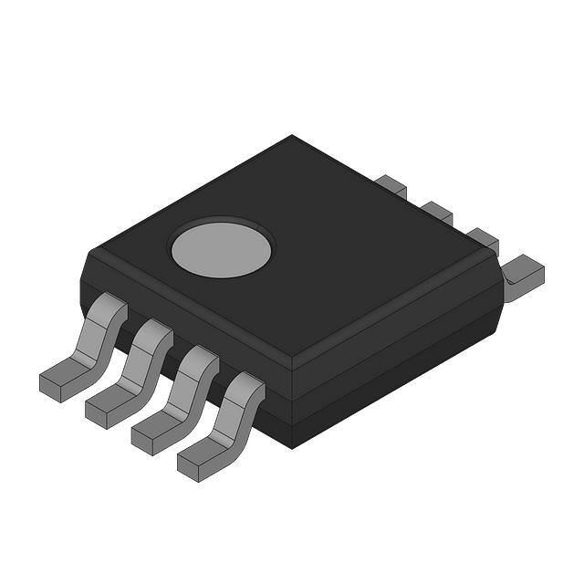

LT1999-10/LT1999-20/ LT1999-50 High Voltage, Bidirectional Current Sense Amplifier FEATURES DESCRIPTION Buffered Output with 3 Gain Options: 10V/V, 20V/V, 50V/V nn Gain Accuracy: 0.5% Max nn Input Common Mode Voltage Range: –5V to 80V nn AC CMRR > 80dB at 100kHz nn Input Offset Voltage: 1.5mV Max nn –3dB Bandwidth: 2MHz nn Smooth, Continuous Operation Over Entire Common Mode Range nn 4kV HBM Tolerant and 1kV CDM Tolerant nn Low Power Shutdown 5.5V VCM = –5V VSHDN = 0.5V, 0V < VCM < 80V l l l 100 –2.35 137.5 –1.95 0.001 175 –1.5 2.5 μA mA μA IOS Input Offset Current IOS = I(+IN) – I(–IN) (Note 8) VCM > 5.5V VCM = –5V VSHDN = 0.5V, 0V < VCM < 80V l l l –1 –10 –2.5 1 10 2.5 μA μA μA PSRR Supply Rejection Ratio V+ = 4.5V to 5.5V l 68 77 dB CMRR Sense Input Common Mode Rejection VCM = –5V to 80V VCM = –5V to 5.5V VCM = 12V, 7VP-P, f = 100kHz, VCM = 0V, 7VP-P, f = 100kHz l l l l 96 96 75 80 105 120 90 100 dB dB dB dB en Differential Input Referred Noise Voltage Density f = 10kHz f = 0.1Hz to 10Hz 97 8 nV/√Hz μVP-P REFRR REF Pin Rejection, V+ = 5.5V ΔVREF = 3.0V ΔVREF = 3.25V ΔVREF = 3.25V dB dB dB RREF REF Pin Input Impedance VREF Open Circuit Voltage VREFR REF Pin Input Range (Note 9) 4 LT1999-10 LT1999-20 LT1999-50 l l l 62 62 62 70 70 70 VSHDN = 0.5V l l 60 0.15 80 0.4 100 0.65 kΩ MΩ VSHDN = 0.5V l l 2.45 1 2.5 2.5 2.55 2.75 V V LT1999-10 LT1999-20 LT1999-50 l l l 1.25 1.125 1.125 V+ – 1.25 V+ – 1.125 V+ – 1.125 V V V Rev. E For more information www.analog.com LT1999-10/LT1999-20/ LT1999-50 ELECTRICAL CHARACTERISTICS l denotes the specifications which apply over the full operating The temperature range, 0°C < TA < 70°C for C-grade parts, –40°C < TA < 85°C for I-grade parts, and –40°C < TA < 125°C for H-grade parts, otherwise specifications are at TA = 25°C. V+ = 5V, GND = 0V, VCM = 12V, VREF = floating, VSHDN = floating, unless otherwise specified. See Figure 2. SYMBOL PARAMETER CONDITIONS ISHDN Pin Pull-Up Current V+ = 5.5V, V MIN TYP l –6 –2 SHDN Pin Input High l V+ – 0.5 VIH VIL SHDN Pin Input Low l f3dB Small Signal Bandwidth SR Slew Rate ts Settling Time due to Input Step, ΔVOUT = ±2V 0.5% Settling 2.5 μs tr Common Mode Step Recovery Time ΔVCM = ±50V, 20ns (Note 10) LT1999-10 LT1999-20 LT1999-50 0.8 1 1.3 μs μs μs VS Supply Voltage (Note 11) IS Supply Current VCM > 5.5V VCM = –5V V+ = 5.5V, VSHDN = 0.5V, VCM > 0V RO Output Impedance ΔIO = ±2mA ISRC Sourcing Output Current RLOAD = 50Ω to GND l 6 ISNK Sinking Output Current RLOAD = 50Ω to V+ l 15 VOUT Swing Output High (with Respect to V+) RLOAD = 1kΩ to Mid-Supply RLOAD = Open l l Swing Output Low (with Respect to V–) RLOAD = 1kΩ to Mid-Supply RLOAD = Open l l 250 150 tON Turn-On Time VSHDN = 0V to 5V 1 μs tOFF Turn-Off Time VSHDN = 5V to 0V 1 μs SHDN = 0V 4.5 l l l UNITS μA V 0.5 LT1999-10 LT1999-20 LT1999-50 l MAX V 2 2 1.2 MHz MHz MHz 3 V/μs 5 5.5 V 1.55 5.8 3 1.9 7.1 10 mA mA μA 40 mA 26 40 mA 125 5 250 125 mV mV 400 225 mV mV 0.15 31 Ω Rev. E For more information www.analog.com 5 LT1999-10/LT1999-20/ LT1999-50 ELECTRICAL CHARACTERISTICS The l denotes the specifications which apply over the full operating + temperature range, –55°C < TA < 150°C for MP-grade parts, otherwise specifications are at TA = 25°C. V = 5V, GND = 0V, VCM = 12V, VREF = floating, VSHDN = floating, unless otherwise specified. See Figure 2. SYMBOL PARAMETER CONDITIONS VSENSE Full-Scale Input Sense Voltage (Note 7) VSENSE = V+IN – V–IN LT1999-10 LT1999-20 LT1999-50 MAX UNITS l l l –0.35 –0.2 –0.08 VCM CM Input Voltage Range RIN(DIFF) Differential Input Impedance RINCM CM Input Impedance VOSI Input Referred Voltage Offset MIN TYP 0.35 0.2 0.08 V V V l –5 80 V ΔVINDIFF = ±2V/GAIN l 6.4 8 ΔVCM = 5.5V to 80V ΔVCM = –5V to 4.5V l l 5 3.6 20 4.8 ±500 l –750 –2000 9.6 kΩ 6 MΩ kΩ 750 2000 μV μV ΔVOSI /ΔT Input Referred Voltage Offset Drift 8 AV Gain LT1999-10 LT1999-20 LT1999-50 l l l 9.95 19.9 49.75 AV Error Gain Error ΔVOUT = ±2V l –0.5 ±0.2 0.5 % IB Input Bias Current I(+IN) = I(–IN) (Note 8) VCM > 5.5V VCM = –5V VSHDN = 0.5V, 0V < VCM < 80V l l l 100 –2.35 137.5 –1.95 0.001 180 –1.5 10 μA mA μA IOS Input Offset Current IOS = I(+IN) – I(–IN) (Note 8) VCM > 5.5V VCM = –5V VSHDN = 0.5V, 0V < VCM < 80V l l l –1 –10 –10 1 10 10 μA μA μA PSRR Supply Rejection Ratio V+ = 4.5V to 5.5V l 68 77 dB CMRR Sense Input Common Mode Rejection VCM = –5V to 80V VCM = –5V to 5.5V VCM = 12V, 7VP-P, f = 100kHz, VCM = 0V, 7VP-P, f = 100kHz l l l l 96 96 75 80 105 120 90 100 dB dB dB dB en Differential Input Referred Noise Voltage Density f= 10kHz f = 0.1Hz to 10Hz 97 8 nV/√Hz μVP-P REFRR REF Pin Rejection, V+ = 5.5V ΔVREF = 2.75V ΔVREF = 3.25V ΔVREF = 3.25V dB dB dB 10.05 20.1 50.25 V/V V/V V/V LT1999-10 LT1999-20 LT1999-50 l l l 62 62 62 70 70 70 VSHDN = 0.5V l l 60 0.15 80 0.4 100 0.65 kΩ MΩ VSHDN = 0.5V l l 2.45 0.25 2.5 2.5 2.55 2.75 V V 1.5 1.125 1.125 V+ – 1.25 V+ – 1.125 V+ – 1.125 V V V RREF REF Pin Input Impedance VREF Open Circuit Voltage VREFR REF Pin Input Range (Note 9) LT1999-10 LT1999-20 LT1999-50 l l l ISHDN Pin Pull-Up Current V+ = 5.5V, VSHDN = 0V l –6 V+ – 0.5 VIH SHDN Pin Input High l VIL SHDN Pin Input Low l f3dB Small Signal Bandwidth SR Slew Rate tS Settling Time Due to Input Step, ΔVOUT = ±2V 6 10 20 50 μV/°C –2 μA V 0.5 V LT1999-10 LT1999-20 LT1999-50 2 2 1.2 MHz MHz MHz 3 V/μs 0.5% Settling 2.5 μs Rev. E For more information www.analog.com LT1999-10/LT1999-20/ LT1999-50 ELECTRICAL CHARACTERISTICS The l denotes the specifications which apply over the full operating temperature range, –55°C < TA < 150°C for MP-grade parts, otherwise specifications are at TA = 25°C. V+ = 5V, GND = 0V, VCM = 12V, VREF = floating, VSHDN = floating, unless otherwise specified. See Figure 2. SYMBOL PARAMETER CONDITIONS tr Common Mode Step Recovery Time ΔVCM = ±50V, 20ns (Note 10) LT1999-10 LT1999-20 LT1999-50 VS Supply Voltage (Note 11) IS Supply Current VCM > 5.5V VCM = –5V V+ = 5.5V, VSHDN = 0.5V, VCM > 0V RO Output Impedance ΔIO = ±2mA ISRC Sourcing Output Current RLOAD = 50Ω to GND l 3 ISNK Sinking Output Current RLOAD = 50Ω to V+ l 10 VOUT Swing Output High (with Respect to V+) RLOAD = 1kΩ to Mid-Supply RLOAD = Open l l Swing Output Low (with Respect to V –) RLOAD = 1kΩ to Mid-Supply RLOAD = Open l l 250 150 tON Turn-On Time VSHDN = 0V to 5V 1 μs tOFF Turn-Off Time VSHDN = 5V to 0V 1 μs ( V+IN − V−IN )2 8kΩ Note 4: A heat sink may be required to keep the junction temperature below the absolute maximum rating. Note 5: The LT1999C/LT1999I are guaranteed functional over the operating temperature range –40°C to 85°C. The LT1999H is guaranteed functional over the operating temperature range –40°C to 125°C. The LT1999MP is guaranteed functional over the operating temperature range –55°C to 150°C. Junction temperatures greater than 125°C will promote accelerated aging. The LT1999 has a demonstrated typical life beyond 1000 hours at 150°C. Note 6: The LT1999C is guaranteed to meet specified performance from 0°C to 70°C. The LT1999C is designed, characterized, and expected to meet specified performance from –40°C to 85°C but is not tested or QA sampled at these temperatures. The LT1999I is guaranteed to meet specified performance from –40°C to 85°C. The LT1999H is guaranteed to meet specified performance from –40°C to 125°C. The LT1999MP is guaranteed to meet specified performance from –55°C to 150°C. TYP MAX 0.8 1 1.3 l Note 1: Stresses beyond those listed underAbsolute Maximum Ratings may cause permanent damage to the device. Exposure to any Absolute Maximum Rating condition for extended periods may affect device reliability and lifetime. Note 2: Pin 2 (+IN) and Pin 3 (–IN) are protected by ESD voltage clamps which have asymmetric bidirectional breakdown characteristics with respect to the GND pin (Pin 5). These pins can safely support common mode voltages which vary from –5.25V to 88V without triggering an ESD clamp. Note 3: Exposure to differential sense voltages exceeding the normal operating range for extended periods of time may degrade part performance. A heat sink may be required to keep the junction temperature below the Absolute Maximum Rating when the inputs are stressed differentially. The amount of power dissipated in the LT1999 due to input overdrive can be approximated by: PDISS = MIN 4.5 l l l UNITS μs μs μs 5 5.5 V 1.55 5.8 3 1.9 7.1 25 mA mA μA 40 mA 26 40 mA 125 5 250 125 mV mV 400 225 mV mV 0.15 31 Ω Note 7: Full-scale sense (VSENSE) gives indication of the maximum differential input that can be applied with better than 0.5% gain accuracy. Gain accuracy is degraded when the output saturates against either power supply rail. VSENSE is verified with V+ = 5.5V, VCM = 12V, with the REF pin set to it’s voltage range limits. The maximum VSENSE is verified with the REF pin set to it’s minimum specified limit, verifying the gain error is less than 0.5% at the output. The minimum VSENSE is verified with the REF pin set to its maximum specified limit, verifying the gain error at the output is less than 0.5%. See Note 9 for more information. Note 8: IB is defined as the average of the input bias currents to the +IN and –IN pins (Pins 2 and 3). A positive current indicates current flowing into the pin. IOS is defined as the difference of the input bias currents. IOS = I(+IN) – I(–IN) Note 9: The REF pin voltage range is the minimum and maximum limits that ensures the input referred voltage offset does not exceed ±3mV over the I, C, and H temperature ranges, and ±3.5mV over the MP temperature range. Note 10: Common mode recovery time is defined as the time it takes the output of the LT1999 to recover from a 50V, 20ns input common mode voltage transition, and settle to within the DC amplifier specifications. Note 11: Operating the LT1999 with V+ < 4.5V is possible, although the LT1999 is not tested or specified in this condition. See the Applications Information section. Rev. E For more information www.analog.com 7 LT1999-10/LT1999-20/ LT1999-50 TYPICAL PERFORMANCE CHARACTERISTICS Supply Current vs Input Common Mode 7 Supply Current vs Temperature 1.8 V+ = 5V 6 VSHDN = OPEN VINDIFF = 0V VCM = 12V 150°C 130°C 90°C 25°C –45°C –55°C 3.5 1.7 5 3.0 3 2 IS (mA) 2.5 4 IS (mA) IS (mA) Supply Current vs Supply Voltage 4.0 1.6 V+ = 5.5V 1.5 VCM = 12V 2.0 1.5 V+ = 4.5V 1.0 1 0.5 0 –5 5 15 25 35 45 VCM (V) 55 65 1.4 –55 –30 75 80 20 45 70 95 TEMPERATURE (°C) 0 120 145 0 2 3 SUPPLY VOLTAGE (V) 1 10 V+ = 5V VCM = 12V 8 1 Shutdown Input Bias Current vs Input Common Mode 1000 VSHDN = 0V VINDIFF = 0V VCM = 12V V+ = 5V VSHDN = 0V VSENSE = 0V TA = 150°C TA =130°C 6 V+ = 5.5V 4 TA =110°C IB (nA) IS (µA) IS (mA) 100 TA = 150°C TA = 90°C 10 0.01 0.001 TA = 25°C 0 1 TA = 70°C TA = –55°C 3 2 VSHDN (V) 4 0 –55 –30 5 –5 20 45 70 95 TEMPERATURE (°C) 146 V+ = 5V IMPEDANCE (kΩ) IB (µA) IB (mA) VCM = 80V 138 VCM = 5.5V 136 –1.5 8 5 15 25 35 45 VCM (V) 55 65 75 80 132 –55 –30 –5 1999 G06 1000 100 DIFFERENTIAL INPUT IMPEDANCE 10 134 –5 100 80 COMMON MODE INPUT IMPEDANCE 10000 142 140 60 40 VCM (V) 100000 VSHDN = OPEN VINDIFF = 0V 144 V+ = 5V –1.0 20 Input Impedance vs Input Common Mode Voltage Input Bias Current vs Temperature –0.5 0 1999 G05 0 –2.0 1 120 145 1999 G04 Input Bias Current vs Input Common Mode 0.5 V+ = 4.5V 2 5 1999 G03 Shutdown Supply Current vs Temperature 0.1 4 1999 G02 1999 G01 Supply Current vs SHDN Pin Voltage 10 –5 20 45 70 95 TEMPERATURE (°C) 120 145 1999 G07 1999 G08 1 –5 5 15 25 35 45 VCM (V) 55 65 75 1999 G09 Rev. E For more information www.analog.com LT1999-10/LT1999-20/ LT1999-50 TYPICAL PERFORMANCE CHARACTERISTICS Input Referred Voltage Offset vs Temperature and Gain Option 1500 Input Referred Voltage Offset vs Input Common Mode Voltage 1500 VCM = 12V 12 UNITS PLOTTED 1000 1000 500 VOSI (µV) 500 VOSI (µV) V+ = 5V TA = 25°C 12 UNITS PLOTTED 0 0 –500 –500 –1000 –1500 –55 –30 –5 LT1999-10 LT1999-20 LT1999-50 –1000 LT1999-10 LT1999-20 LT1999-50 20 45 70 95 TEMPERATURE (°C) –1500 120 145 –5 5 15 25 1999 G10 25 GAIN GAIN (dB) 135 30 90 25 45 20 0 VOUT = 0.5VP-P AT 1kHz 10 100 1000 FREQUENCY (kHz) 135 GAIN 90 45 PHASE 15 0 –90 5 –90 –135 0 0 –5 180 –45 –45 1 1999 G11 10 5 –10 –5 –180 10000 –135 VOUT = 0.5VP-P AT 1kHz 1 10 LT1999-50 Small Signal Frequency Response 1999 G13 135 90 45 PHASE 20 0 15 –45 10 –90 5 GAIN ERROR (%) 25 VOUT = 0.5VP-P AT 1kHz 10 100 1000 FREQUENCY (kHz) –180 10000 0 –0.25 –0.25 –0.50 –55 –30 V+ = 5V TA = 25°C 12 UNITS PLOTTED 0.25 0 –135 1 0.50 VCM = 12V 12 UNITS PLOTTED 0.25 PHASE (DEG) GAIN (dB) 30 0 0.50 GAIN ERROR (%) GAIN 35 Gain Error vs Input Common Mode Voltage Gain Error vs Temperature 180 –180 10000 100 1000 FREQUENCY (kHz) 1999 G12 40 75 PHASE (DEG) PHASE 35 PHASE (DEG) 15 180 GAIN (dB) 30 10 65 55 LT1999-20 Small Signal Frequency Response LT1999-10 Small Signal Frequency Response 20 35 45 VCM (V) LT1999-10 LT1999-20 LT1999-50 –5 20 45 70 95 TEMPERATURE (°C) 1999 G14 120 145 1999 G15 –0.50 LT1999-10 LT1999-20 LT1999-50 –5 5 15 25 35 45 VCM (V) 55 65 75 1999 G16 Rev. E For more information www.analog.com 9 LT1999-10/LT1999-20/ LT1999-50 TYPICAL PERFORMANCE CHARACTERISTICS LT1999-10 Pulse Response LT1999-20 Pulse Response VOUT 4.5 0.075 4.0 0 –0.025 OUTPUT ERROR 1.0 1999 G20 TIME (1µs/DIV) VOUT (V) 2.5 0.15 VOUT 0.10 3.0 0.05 2.5 0 2.0 –0.050 1.5 –0.075 1.0 –0.100 0.5 –0.05 OUTPUT ERROR OUTPUT ERROR (V) 0.025 0.20 3.5 0.050 OUTPUT ERROR (V) VOUT (V) 0.100 3.0 0.5 VSENSE (0.1V/DIV) VSENSE (0.2V/DIV) VSENSE (0.5V/DIV) 4.5 1.5 1999 G19 TIME (2µs/DIV) LT1999-20 2V Step Response Settling Time LT1999-10 2V Step Response Settling Time 2.0 VOUT 1999 G18 TIME (2µs/DIV) VOUT (1V/DIV) VOUT 1999 G17 3.5 VOUT (1V/DIV) VOUT (1V/DIV) VOUT 4.0 VSENSE VSENSE VSENSE TIME (2µs/DIV) LT1999-50 Pulse Response –0.01 –0.15 –1 0 1 2 3 4 5 6 TIME (1µs/DIV) 7 8 9 10 –0.20 1999 G21 LT1999-50 2V Step Response Settling Time 0.500 4.0 0.375 VOUT 0 2.0 –0.125 OUTPUT ERROR –0.250 –0.375 1.0 TIME (1µs/DIV) LT1999-10 LT1999-20 LT1999-50 1999 G22 –0.500 80 80 60 VCM = 12V 20 V+ = 5V TA = 25°C 6 UNITS PLOTTED 0 1000 1 10 100 FREQUENCY (kHz) 60 40 40 VCM = 0V V+ = 5V TA = 25°C 6 UNITS PLOTTED 20 10000 1999 G23 10 LT1999-10 LT1999-20 LT1999-50 100 CMRR (dB) 2.5 OUTPUT ERROR (V) 0.125 0.5 100 CMRR vs Frequency 120 0.250 3.0 1.5 120 CMRR (dB) 3.5 VOUT (V) CMRR vs Frequency 4.5 0 1 10 100 1000 FREQUENCY (kHz) 10000 1999 G24 Rev. E For more information www.analog.com LT1999-10/LT1999-20/ LT1999-50 TYPICAL PERFORMANCE CHARACTERISTICS LT1999-10 Common Mode Rising Edge Step Response LT1999-10 Common Mode Falling Edge Step Response VCM , tRISE ≈ 20ns VOUT (0.5V/DIV) VCM (25V/DIV) VCM (25V/DIV) VOUT (0.5V/DIV) VCM , tFALL ≈ 20ns VOUT TIME (0.5µs/DIV) VOUT 1999 G25 1999 G26 TIME (0.5µs/DIV) LT1999-20 Common Mode Rising Edge Step Response LT1999-20 Common Mode Falling Edge Step Response VOUT (0.5V/DIV) VCM , tFALL ≈ 20ns VOUT TIME (0.5µs/DIV) VCM (25V/DIV) VCM (25V/DIV) VOUT (0.5V/DIV) VCM , tRISE ≈ 20ns VOUT 1999 G27 1999 G28 TIME (0.5µs/DIV) LT1999-50 Comm Step Response LT1999-50 Common Mode Falling Edge Step Response VCM tRISE20ns VOUT (0.5V/DIV) VCM , tFALL ≈ 20ns VCM (25V/DIV) VCM (25V/DIV) VOUT (0.5V/DIV) VCM , tRISE ≈ 20ns VOUT VOUT (0.5 V / div) LT1999-50 Common Mode Rising Edge Step Response TIM VOUT TIME (0.5µs/DIV) 1999 G29 TIME (0.5µs/DIV) 1999 G30 Rev. E For more information www.analog.com 11 LT1999-10/LT1999-20/ LT1999-50 TYPICAL PERFORMANCE CHARACTERISTICS LT1999 Input Referred Noise Density vs Frequency Short-Circuit Current vs Temperature 1000 3.0 40 30 SINKING REF PIN VOLTAGE (V) 100 10 0 –10 –20 SOURCING 0.01 0.1 1 10 FREQUENCY (kHz) 1000 10000 –40 –55 –30 –5 20 45 70 95 TEMPERATURE (°C) 1.0 V+ = 5V 0 –55 –30 –5 20 45 70 95 TEMPERATURE (°C) Turn-On/Turn-Off Time vs SHDN Voltage V+ = 5V VCM = 12V VCM = 12V IS (1mA/DIV) TA = 150°C TA = 25°C TA = –55°C SHDN PIN VOLTAGE (5V/DIV) IS –1 –2 SHUTDOWN –3 VSHDN –4 1 2 3 VSHDN (V) 4 5 1999 G34 VOUT vs VSENSE Over the Sense ABSMAX Range VOUT vs VSENSE 6 VREF = 2.5V 5 5 4 4 3 3 2 1 12 VOUT PHASE REVERSAL FOR VSENSE < –25V 2 1 LT1999-10 LT1999-20 LT1999-50 0 –1 –0.25 1999 G35 TIME (1µs/DIV) VOUT (V) VOUT (V) 6 0 120 145 1999 G33 1999 G32 SHDN Pin Current vs SHDN Pin Voltage and Temperature ISHDN (µA) 1.5 120 145 1999 G31 0 SHDN MODE 2.0 0.5 –30 10 0.001 ACTIVE MODE 2.5 20 ISC (mA) NOISE DENSITY (nV/√Hz) REF Open Circuit Voltage vs Temperature –0.15 0.05 –0.05 VSENSE (V) 0.15 0.25 LT1999-10 LT1999-20 LT1999-50 0 VREF = 2.5V –1 –60 –30 1999 G36 0 VSENSE (V) 30 60 1999 G37 Rev. E For more information www.analog.com LT1999-10/LT1999-20/ LT1999-50 PIN FUNCTIONS (LT1999-XX/LT1999-XXF) V+ (Pins 1, 4/Pin 4): Power Supply Voltage. Pins 1 and 4 are tied internally together. The specified range of operation is 4.5V to 5.5V, but lower supply voltages (down to approximately 4V) is possible although the LT1999 is not tested or characterized below 4.5V. See the Applications Information section. +IN (Pin 2/Pin 1): Positive Sense Input Pin. –IN (Pin 3/Pin 2): Negative Sense Input Pin. NC (NA/Pin 3) GND (Pin 5/Pin 5): Ground Pin. REF (Pin 6/Pin 6): Reference Pin Input. The REF pin sets the output common mode level and is set halfway between V+ and GND using a divider made of two 160k resistors. The default open circuit potential of the REF pin is mid-supply. It can be overdriven by an external voltage source cable of driving 80k to a mid-supply potential (see the Electrical Characteristics table for its specified input voltage range). OUT (Pin 7/Pin 7): Voltage Output. VOUT = AV •(VSENSE ± VOSI), where AV is the gain, and VOSI is the input referred offset voltage. The output amplifier has a low impedance output and is designed to drive up to 200pF capacitive loads directly. Capacitive loads exceeding 200pF should be decoupled with an external resistor of at least 100Ω. SHDN (Pin 8/Pin 8): Shutdown Pin. When pulled to within 0.5V of GND (Pin 5), will place the LT1999 into low power shutdown. If the pin is left floating, an internal 2µA pullup current source will place the LT1999 into the active (amplifying) state. Rev. E For more information www.analog.com 13 LT1999-10/LT1999-20/ LT1999-50 BLOCK DIAGRAM V+ LT1999 2µA V+ 1 2 4k V+ 3 RG 2 – + 0.8k 4k V+ 2µA 0.8k 4k 8 SHDN + – 0.8k RG – + 7 V+ 7 V+ 160k 0.8k 4k 1 8 SHDN + – V+ LT1999-XXF 160k 6 3 NC 6 160k 160k V+ V+ 5 4 5 4 1999 BD 1999 BD Figure 1. Simplified Block Diagram TEST CIRCUIT V+ LT1999 + – VCM + – + – + – 4k V + + 0.8k VIN(DIFF) – 4k 3 V+ 5V 8 V SHDN SHDN 2 + – 2µA 1 0.8k 4k 1 V+ 5V VCM RG – + + – V+ + – 4k 2 7 V OUT V+ 3 160k 6 160k 4 2µA 0.8k VREF 0.8k 8 V SHDN SHDN VIN(DIFF) + – V+ LT1999F + – RG – + 7 V OUT V+ NC 160k 6 0.1µF V+ 5V 4 5 0.1µF 160k VREF 0.1µF 5 0.1µF 1999 F02 1999 F02 Figure 2. Test Circuit 14 Rev. E For more information www.analog.com LT1999-10/LT1999-20/ LT1999-50 APPLICATIONS INFORMATION The LT1999 current sense amplifier provides accurate bidirectional monitoring of current through a userselected sense resistor. The voltage generated by the current flowing in the sense resistor is amplified by a fixed gain of 10V/V, 20V/V or 50V/V (LT1999-10, LT199920, or LT1999-50 respectively) and is level shifted to the OUT pin. The voltage difference and polarity of the OUT pin with respect to REF (Pin 6) indicates magnitude and direction of the current in the sense resistor. Refer to the Block Diagram (Figure 1. Case 1: V+ < VCM < 80V For input common mode voltages exceeding the power supply, one can assume D1 ofFigure 1 is completely off. The sensed voltage (VSENSE) is applied across Pin 2 (+IN) and Pin 3 (–IN) to matched resistors R+IN and R–IN (nominally 4k each). The opposite ends of R+IN and R– IN are forced to equal potentials by transconductor GIN, which convert the differentially sensed voltage into a sensed current. The sensed current in R+IN and R–IN is combined, level-shifted, and converted back into a voltage by transresistance amplifier AO and resistor RG. Amplifier AO provides high open loop gain to accurately convert the sensed current back into a voltage and to drive external loads. The theoretical output voltage is determined by the sensed voltage (VSENSE), and the ratio of two on-chip resistors: The voltage difference between the OUT pin and the REF pin represent both polarity and magnitude of the sensed voltage. The noninverting input of amplifier AO is biased by a resistive 160k to 160k divider tied between V+ and GND to set the default REF pin bias to mid-supply. Case 2: –5V < VCM < V+ THEORY OF OPERATION VOUT − VREF = VSENSE • For the LT1999-10, RG is nominally 40k. For the LT1999-20, RG is nominally 80k, and for the LT1999-50, RG is nominally 200k. RG RIN where R + R −IN RIN = +IN nominally 4k 2 For common mode inputs which transition or are set below the supply voltage, diode D1 will turn on and will provide a source of current through R+S and R –S to bias the inputs of transconductance amplifier GIN at least 2.25V above GND. The transition is smooth and continuous; there are negligible changes to either gain or amplifier voltage offset. The only difference in amplifier operation is the bias currents provided by D1 through R+S and R–S are steered through the input pins, otherwise amplifier operation is identical. The inputs to transconductance amplifier GIN are still forced to equal potentials forcing any differential voltages appearing at the +IN and –IN pins into a differential current. This differential current is combined, level-shifted, and converted back into a voltage by transresistance amplifier AO and Resistor RG. Resistors R+S and R–S are trimmed to match R+IN and R–IN respectively, to prevent common mode to differential conversion from occurring (to the extent of the matched trim) when the input common mode transitions below V+. As described in case 1, the output is determined by the sense voltage and the ratio of two on-chip resistors: VOUT − VREF = VSENSE • RG RIN where RIN = R +IN + R −IN 2 Rev. E For more information www.analog.com 15 LT1999-10/LT1999-20/ LT1999-50 APPLICATIONS INFORMATION Input Common Mode Range –2.0 With the V+ supply configured within the specified and tested range (4.5V < V+ < 5.5V), the LT1999’s common mode range extends from –5V to 80V. Pushing +IN and –IN beyond the limits specified in the Absolute Maximum table can turn on the voltage clamps designed to protect the +IN and –IN pins during ESD events. It is possible to operate the LT1999 on power supplies as low as 4V (although it is not tested or specified below 4.5V). Operating the LT1999 on supplies below 4V will produce erratic behavior. When operating the LT1999 with supplies as low as 4V, the common mode range for inputs which extend below GND is reduced. Refer to the Block Diagram (Figure 1). For inputs driven below V+, diode D1 conducts. For proper operation, the input to the transconductor V(G+IN) must be biased at approximately 2.25V above the GND pin. V(G+IN) sits on the centertap of a voltage divider comprised of R+S and R+IN V(G –IN) likewise sits in the middle of the voltage divider comprised of R – S , and R–IN). The voltage on V(G+IN) input is given by the following equation: V(G +IN) = V +IN• ( ) R +S R +IN + V + −VD1 • R +S + R +IN R +S + R +IN Setting V(G+IN) = 2.25V, the ratio (R+IN /R+S) to 5, and VD1 equal to 0.8V (cold temperatures), a plot of the lower input common mode range plotted against supply is shown in Figure 3. 16 –2.5 VCM(LOWER LIMIT) (V) The LT1999 was optimized for high common mode rejection. Its input stage is balanced and fully differential, designed to amplify differential signals and reject common mode signals. There is negligible crossover distortion due to sense voltage reversals. The amplifier is most linear in the zero-sense region. BELOW GROUND INPUT COMMON MODE RANGE LIMITED BY V+ SUPPLY VOLTAGE –3.0 –3.5 –4.0 BELOW GROUND INPUT COMMON MODE RANGE LIMITED BY ESD CLAMPS –4.5 –5.0 –5.5 –6.0 TYPICAL ESD CLAMP VOLTAGE 4 4.25 4.5 5 4.75 SUPPLY VOLTAGE (V) 5.25 5.5 1999 F03 Figure 3. Lower Input Common Mode vs Supply Voltage Output Common Mode Range The LT1999’s output common mode level is set by the voltage on the REF pin. The REF pin sits in the middle of a 160k to 160k voltage divider connected between V+ and GND which sets the default open circuit potential of the REF pin to mid-supply. It can be overdriven by an external voltage source capable of driving 80k tied to a mid-supply potential. See the Electrical Characteristics table for the REF pin’s specified input voltage range. Differential sampling of the OUT pin with respect the REF pin provides the best noise immunity. Measurements of the output voltage made differentially with respect to the REF pin will provide the highest power supply and common mode rejection. Otherwise, power supply or GND pin disturbances are divided by the REF pin’s voltage divider and appear directly at the noninverting input of the trans-resistance amplifier AO and are not rejected. If not driven by a low impedance ( 5V, OUT will be at 5V. In the range of 4V < –IN < 5V, OUT may go to either V+ or GND, depending on the voltage applied to +IN. The open input (–IN) is biased internal to the IC to one diode below V+. 3 NC YES The circuit behaves normally. 4 V+ YES The circuit will behave as if powered off. 5 GND YES OUT, REF will float up towards 3.9V. 6 REF YES The circuit behaves normally with more broadband noise on OUT. 7 OUT YES No VOUT signal. 8 SHDN YES The low power shutdown feature will not function, otherwise the circuit behaves normally in the active state. FMEA information in this document (not limited to, but including the description of behavior under specific pin-connection conditions) is provided for convenience only. Ultimately, the end-user is responsible for verifying proper and reliable operation in each actual application. Linear Technology assumes no liability whatsoever with providing this information. 20 Rev. E For more information www.analog.com LT1999-10/LT1999-20/ LT1999-50 APPLICATIONS INFORMATION Fuse Monitor The inputs can be overdriven without fear of damaging the LT1999. This makes the LT1999 ideal for monitoring fuses if either +IN or –IN are shorted to ground while the other is at the full common mode supply voltage (see Figure 6). If the fuse in Figure 6 opens with the +IN tied to the positive supply, the load will pull –IN to GND. The output will be forced to the positive V+ supply rail. If it is desired that the output be near ground if the fuse opens, it is a simple matter of swapping the inputs. Precautions should be followed: First, when the inputs are stressed differentially due to the fuse blowing open, a large voltage drop will be placed across the +IN to –IN pins, dissipating VS V+ LT1999 2µA 1 VSHDN + – 4k V+IN 2 VOUT VREF STEERING DIODE V+ FUSE 8 SHDN ILOAD VSHDN RG – + 0.8k 7 VOUT V+ RSENSE V–IN 3 4k 0.8k 160k 6 V+ 5V 160k 4 VREF 0.1µF 5 0.1µF 1999 F05 Figure 6. Using the LT1999 to Monitor a Fuse VOUT PHASE REVERSAL FOR VSENSE < –25V VOUT (1V/DIV) LOAD Finally, the user should be aware that in fuse monitoring applications with the sense voltage (VSENSE = V+IN – V–IN) being driven in excess of –25V, the output of the LT1999 will undergo phase reversal (seeFigure 7). V+ 5V ON OFF power in the precision on-chip input resistors. Precaution should be taken to prevent junction temperatures from exceeding the Absolute Maximum ratings (see Note 3 in the Electrical Characteristics section). Secondly, if the load is inductive, and the fuse blows open without a clamp diode, energy stored in the inductive load will be dissipated in the LT1999, which could cause damage. A simple steering diode as shown in Figure 6 will prevent this from happening, and will protect the LT1999 from damage. VREF = 2.5V –60 –45 –30 –15 0 15 VSENSE (V) 30 45 60 1999 F06 Figure 7. A Plot of the LT1999’s Output Voltage vs VSENSE (VSENSE = V+IN – V– IN). In Applications Where the Sense Voltage Is Driven in Excess of –25V, the Output of the LT1999 Will Undergo Phase Reversal Rev. E For more information www.analog.com 21 LT1999-10/LT1999-20/ LT1999-50 TYPICAL APPLICATIONS Solenoid Current Monitor Bidirectional PWM Motor Monitor The solenoid of Figure 8 consists of a coil of wire in an iron case with permeable plunger that acts as a movable element. When the MOSFET turns on, the diode is reversed biased off, and current flows through RSENSE to actuate the solenoid. If the MOSFET is turned off, the current in the MOSFET is interrupted, but the energy stored in the solenoid causes the diode to turn on and current to freewheel in the loop consisting of the diode, RSENSE and the solenoid. Pulse width modulation is commonly used to efficiently vary the average voltage applied across a DC motor. The H-bridge topology of Figure 10 allows full 4-quadrant control: clockwise control, counter-clockwise control, clockwise regeneration, and counter-clockwise regeneration. The LT1999 in conjunction with a non-inductive current shunt is used to monitor currents in the rotor. The LT1999 can be used to detect stuck rotors, provide detection of overcurrent conditions in general, or provide current mode feedback control. Figure  8 shows the LT1999 monitoring currents in a ground referenced solenoid used when the coil is hard tied to the case, and is tied to ground. Figure 9 shows a supply referenced solenoid whose coil is insulated from the case. The LT1999 will interface equally well to either of these two configurations. VS V+ LT1999 V+ 5V 2µA 1 V+IN + – 4k 2 V + 0.8k VSHDN RG – + 7 VOUT V–IN 4k 3 5V V+ 0.8k 160k 6 0.1µF 160k 4 VREF 2.5V VOUT V+IN (10V/DIV) V+ RSENSE SOLENOID 8 SHDN VOUT (0.5V/DIV) OFF ON Figure 11 shows a plot of the output voltage of the LT1999. SOLENOID RELEASES SOLENOID PLUNGER PULLS IN V+IN 5 0.1µF 1999 F07a TIME (50ms/DIV) 1999 F07b Figure 8. Solenoid Current Monitor for Ground Tied Solenoid. The Common Mode Inputs to the LT1999 Switch Between VS and One Diode Drop Below Ground 22 Rev. E For more information www.analog.com LT1999-10/LT1999-20/ LT1999-50 TYPICAL APPLICATIONS V+ LT1999 VS 1 2µA V+ SOLENOID V+IN + – 4k 2 + V 0.8k – + 7 VOUT 3 5V 4 4k V+ 0.8k 160k 6 VREF 160k 0.1µF 2.5V VOUT V+IN (10V/DIV) V–IN ON VSHDN RG V+ RSENSE OFF 8 SHDN VOUT (0.5V/DIV) 5V SOLENOID RELEASES SOLENOID PLUNGER PULLS IN V+IN 5 0.1µF 1999 F08a TIME (50ms/DIV) 1999 F08b Figure 9. Solenoid Current Monitor for Non-Grounded Solenoids. This Circuit Performs the Same Function as Figure 7 Except One End of the Solenoid Is Tied to VS. The Common Mode Voltage of Inputs of the LT1999 Switch Between Ground and One Diode Drop Above VS Rev. E For more information www.analog.com 23 LT1999-10/LT1999-20/ LT1999-50 TYPICAL APPLICATIONS 5V V+ 10µF V+ LT1999-20 1 2µA SHDN + – 24V 4k 2 V+IN C4 1000µF 0.8k 80k V–IN 3 0.1µF – + 7 4k 0.8k 160k 6 160k 5V V+ 5V OUTA DIRECTION VOUT VREF 0.1µF 5 4 PWM INPUT VSHDN V+ VBRIDGE H-BRIDGE PWM IN V+ 8 RSENSE 0.025Ω 1999 F09 24V MOTOR OUTB BRAKE INPUT GND Figure 10. Armature Current Monitor for DC Motor Applications 2.5V V+IN (20V/DIV) VOUT (2V/DIV) VOUT V+IN TIME (20µs/DIV) 1999 F10 Figure 11. LT1999 Output Waveforms for the Circuit of Figure 10 24 Rev. E For more information www.analog.com LT1999-10/LT1999-20/ LT1999-50 PACKAGE DESCRIPTION MS8 Package 8-Lead Plastic MSOP (Reference LTC DWG # 05-08-1660 Rev G) 0.889 ±0.127 (.035 ±.005) 5.10 (.201) MIN 3.20 – 3.45 (.126 – .136) 3.00 ±0.102 (.118 ±.004) (NOTE 3) 0.65 (.0256) BSC 0.42 ± 0.038 (.0165 ±.0015) TYP 8 7 6 5 0.52 (.0205) REF RECOMMENDED SOLDER PAD LAYOUT 0.254 (.010) 3.00 ±0.102 (.118 ±.004) (NOTE 4) 4.90 ±0.152 (.193 ±.006) DETAIL “A” 0° – 6° TYP GAUGE PLANE 0.53 ±0.152 (.021 ±.006) DETAIL “A” 1 2 3 4 1.10 (.043) MAX 0.86 (.034) REF 0.18 (.007) SEATING PLANE 0.22 – 0.38 (.009 – .015) TYP 0.65 (.0256) NOTE: BSC 1. DIMENSIONS IN MILLIMETER/(INCH) 2. DRAWING NOT TO SCALE 3. DIMENSION DOES NOT INCLUDE MOLD FLASH, PROTRUSIONS OR GATE BURRS. MOLD FLASH, PROTRUSIONS OR GATE BURRS SHALL NOT EXCEED 0.152mm (.006") PER SIDE 4. DIMENSION DOES NOT INCLUDE INTERLEAD FLASH OR PROTRUSIONS. INTERLEAD FLASH OR PROTRUSIONS SHALL NOT EXCEED 0.152mm (.006") PER SIDE 5. LEAD COPLANARITY (BOTTOM OF LEADS AFTER FORMING) SHALL BE 0.102mm (.004") MAX 0.1016 ±0.0508 (.004 ±.002) MSOP (MS8) 0213 REV G Rev. E For more information www.analog.com 25 LT1999-10/LT1999-20/ LT1999-50 PACKAGE DESCRIPTION S8 Package 8-Lead Plastic Small Outline (Narrow .150 Inch) (Reference LTC DWG # 05-08-1610 Rev G) .050 BSC .189 – .197 (4.801 – 5.004) NOTE 3 .045 ±.005 8 .245 MIN .160 ±.005 .010 – .020 × 45° (0.254 – 0.508) NOTE: 1. DIMENSIONS IN .053 – .069 (1.346 – 1.752) 0°– 8° TYP .014 – .019 (0.355 – 0.483) TYP INCHES (MILLIMETERS) 2. DRAWING NOT TO SCALE 3. THESE DIMENSIONS DO NOT INCLUDE MOLD FLASH OR PROTRUSIONS. MOLD FLASH OR PROTRUSIONS SHALL NOT EXCEED .006" (0.15mm) 4. PIN 1 CAN BE BEVEL EDGE OR A DIMPLE 26 5 .150 – .157 (3.810 – 3.988) NOTE 3 1 RECOMMENDED SOLDER PAD LAYOUT .016 – .050 (0.406 – 1.270) 6 .228 – .244 (5.791 – 6.197) .030 ±.005 TYP .008 – .010 (0.203 – 0.254) 7 2 3 4 .004 – .010 (0.101 – 0.254) .050 (1.270) BSC SO8 REV G 0212 Rev. E For more information www.analog.com LT1999-10/LT1999-20/ LT1999-50 REVISION HISTORY REV DATE DESCRIPTION A 5/11 Revised +IN and –IN pin descriptions in Pin Functions section 12 B 3/12 Revised Voltage Output Swing Low specification (VOUT) under a loaded condition of 1kΩ to mid-supply. 4, 6 Updated Figure 4 to multicolor. 16 Addition of MSOP Pinout Option Engineered for FMEA All Correction to AV Specification for LT1999-50 from 48.75 to 49.75 5 C 2/15 Update to Pin Functions to include Pinout Option Engineered for FMEA Addition of New Application Information "Pinout Option Engineered for FMEA" Addition of Figure 5 and Renumbering of Figures 6 to 11 D E 6/15 9/19 PAGE NUMBER 12 18, 19 18 to 23 Addition of Table 1 and Table 2 19 LT1999F added to Figure 1 (Simplified Block Diagram) 13 LT1999F added to Figure 2 (Test Circuit) 14 Additional test condition (VCM = 80) added to table 1 and table 2 19 Note added regarding the use of FMEA information 19 Added Automotive Grade products, updated data sheet format All Rev. E Information furnished by Analog Devices is believed to be accurate and reliable. However, no responsibility is assumed by Analog Devices for its use, nor for any infringements of patents or other rights of third parties that may result from its use. Specifications subject to change without notice. No license For is granted implication or otherwise under any patent or patent rights of Analog Devices. more by information www.analog.com 27 LT1999-10/LT1999-20/ LT1999-50 TYPICAL APPLICATION Battery Charge Current and Load Current Monitor VOUT = 0.25V/A, Maximum Measured Current ±9.5A 0.025Ω CHARGER BAT 42V V+ LT1999-10 LOAD V+ 5V 2µA 1 V+IN SHDN + – 4k 2 + V 0.8k 8 VSHDN 7 VOUT 3 4k 0.8k – + 160k 0.1µF + +IN VOUT 6 160k V+ 5V 0.1µF 10µF 40k V+ V–IN 5V VREF – VCC VREF LTC2433-1 –IN CS SCK SDO 0.1µF 5 4 0.1µF 1999 TA02 RELATED PARTS PART NUMBER DESCRIPTION COMMENTS LT1787/ LT1787HV Precision, Bidirectional High Side Current Sense Amplifier 2.7V to 60V Operation, 75μV Offset, 60μA Current Draw LT6100 Gain-Selectable High Side Current Sense Amplifier 4.1V to 48V Operation, Pin-Selectable Gain: 10V/V, 12.5V/V, 20V/V, 25V/V, 40V/V, 50V/V LTC6101/ LTC6101HV High Voltage High Side Current Sense Amplifier 4V to 60V/5V to 100V Operation, External Resistor Set Gain, SOT23 LTC6102/ LTC6102HV Zero Drift High Side Current Sense Amplifier 4V to 60V/5V to 100V Operation, ±10μV Offset, 1μs Step Response, MSOP8/DFN Packages LTC6103 Dual High Side Precision Current Sense Amplifier 4V to 60V, Gain Configurable, 8-Pin MSOP Package LTC6104 Bidirectional, High Side Current Sense 4V to 60V, Gain Configurable, 8-Pin MSOP Package LT6106 Low Cost, High Side Precision Current Sense Amplifier 2.7V to 36V, Gain Configurable, SOT23 Package LT6105 Precision, Extended Input Range Current Sense Amplifier –0.3 to 44V, Gain Configurable, 8-Pin MSOP Package LTC4150 Coulomb Counter/Battery Gas Gauge Indicates Charge Quantity and Polarity LT1990 Precision, 100μA Gain Selectable Amplifier 2.7V to 36V Operation, CMRR > 70dB, Input Voltage = ±250V LT1991 ±250V Input Range Difference Amplifier 2.7V to 36V Operation, 50μV Offset, CMRR > 75B, Input Voltage = ±60V LT1637/LT1638 1.1/1.2MHz, 0.4V/μs Over-The-Top, Rail-to-Rail Input and Output Amplifier 28 0.4V/μs Slew Rate, 230μA per Amplifier Rev. E 09/19 www.analog.com For more information www.analog.com  ANALOG DEVICES, INC. 2010-2019
LT1999HMS8-10F#PBF
物料型号: - LT1999-10 - LT1999-20 - LT1999-50
器件简介: LT1999是一款高速精密电流感应放大器,设计用于在宽共模范围内监测双向电流。该器件提供三种增益选项:10V/V、20V/V和50V/V。
引脚分配: - V+ (Pin 1, 4): 电源电压引脚。 - +IN (Pin 2): 正向感应输入引脚。 - -IN (Pin 3): 负向感应输入引脚。 - GND (Pin 5): 地引脚。 - REF (Pin 6): 参考引脚,设置输出共模电平。 - OUT (Pin 7): 电压输出引脚。 - SHDN (Pin 8): 关闭引脚,用于低功耗关闭。
参数特性: - 增益精度:最大0.5% - 输入共模电压范围:-5V至80V - AC共模抑制比(AC CMRR):在100kHz时大于80dB - 输入偏置电压:最大1.5mV - -3dB带宽:2MHz - 电源电压:独立5V供电 - 电源关闭模式电流:小于10µA - 工作温度范围:-55°C至150°C
功能详解: LT1999通过外部电阻分压器感应电流,并生成一个指示感应电流大小和方向的输出电压。输出电压在电源电压和地之间或外部电压参考电平的一半。LT1999适用于监测H桥电机控制器、开关电源、电磁线圈电流和从满充电到放电的电池充电电流。
应用信息: - 高侧或低侧电流感应 - H桥电机控制 - 电磁线圈电流感应 - 高电压数据采集 - PWM控制回路 - 保险丝/MOSFET监控
封装信息: LT1999提供8引脚MSOP和8引脚SO(窄体)封装。还有为FMEA(故障模式和影响分析)设计的8引脚MSOP引脚选项。
