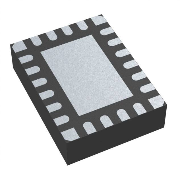

    LT8636是一款42V输入电压范围、5A连续输出电流、7A峰值瞬态输出电流的同步降压调节器。它采用Silent Switcher架构,具有超低EMI发射、可选扩频调制和高效率特性。其静态电流仅为2....
LT8636EV#PBF 数据手册
LT8636 42V, 5A/7A Peak Synchronous Step-Down Silent Switcher with 2.5µA Quiescent Current FEATURES DESCRIPTION Silent Switcher ® Architecture n Ultralow EMI Emissions n Optional Spread Spectrum Modulation n High Efficiency at High Frequency n Up to 96% Efficiency at 1MHz, 12V to 5V IN OUT n Up to 95% Efficiency at 2MHz, 12V to 5V IN OUT n Wide Input Voltage Range: 3.4V to 42V n 5A Maximum Continuous, 7A Peak Transient Output n Ultralow Quiescent Current Burst Mode® Operation n 2.5µA I Regulating 12V to 3.3V Q IN OUT n Output Ripple < 10mV P-P n Fast Minimum Switch On-Time: 30ns n Low Dropout Under All Conditions: 100mV at 1A n Forced Continuous Mode n Adjustable and Synchronizable: 200kHz to 3MHz n Output Soft-Start and Power Good n Small 20-Lead 4mm × 3mm LQFN Package n AEC-Q100 Qualified for Automotive Applications The LT®8636 synchronous step-down regulator features Silent Switcher architecture designed to minimize EMI emissions while delivering high efficiency at high switching frequencies. Peak current mode control with a 30ns minimum on-time allows high step-down ratios even at high switching frequencies. n The LT8636’s ultralow 2.5µA quiescent current—with the output in full regulation—enables applications requiring highest efficiency at very small load currents. A CLKOUT pin enables synchronizing other regulators to the LT8636. Burst Mode operation enables ultralow standby current consumption, forced continuous mode can control frequency harmonics across the entire output load range, or spread spectrum operation can further reduce EMI emissions. Soft-start and tracking functionality is accessed via the TR/SS pin, and an accurate input voltage UVLO threshold can be set using the EN/UV pin. All registered trademarks and trademarks are the property of their respective owners. Protected by U.S. patents, including 8823345. APPLICATIONS n n Automotive and Industrial Supplies General Purpose Step-Down TYPICAL APPLICATION 5V, 5A Step-Down Converter 12VIN to 5VOUT Efficiency VIN 5.7V TO 42V 1µF EN/UV VIN BST 0.1µF SW 3.3µH VOUT 5V 5A BIAS 1µF 41.2k fSW = 1MHz INTVCC 10pF RT 2.8 EFFICIENCY 100µF 2.0 80 1.6 8636 TA01a 1.2 75 POWER LOSS 65 60 0.5 243k 2.4 85 70 1M FB GND 95 90 1µF GND LT8636 3.2 1 POWER LOSS (W) GND VIN EFFICIENCY (%) 4.7µF 100 0.8 1MHz, L = 2.7µH 2MHz, L = 1.5µH 0.4 3MHz, L = 1µH 0 1.5 2 2.5 3 3.5 4 4.5 5 LOAD CURRENT (A) 8636 TA01b Rev. B Document Feedback For more information www.analog.com 1 LT8636 ABSOLUTE MAXIMUM RATINGS PIN CONFIGURATION (Note 1) FB FB TR/SS RT TOP VIEW 20 19 18 17 PG 1 16 CLKOUT BIAS 2 15 SYNC/MODE INTVCC 3 GND 4 NC 5 12 NC VIN 6 11 VIN 14 EN/UV 21 GND 7 8 9 10 SW SW SW 13 GND BST VIN, EN/UV, PG...........................................................42V BIAS...........................................................................25V FB, TR/SS ...................................................................4V SYNC/MODE Voltage ..................................................6V Operating Junction Temperature Range (Note 2) LT8636E............................................. –40°C to 125°C LT8636J............................................. –40°C to 150°C LT8636H............................................. –40°C to 150°C Storage Temperature Range................... –65°C to 150°C Maximum Reflow (Package Body) Temperature...... 260°C LQFN PACKAGE 20-LEAD (4mm × 3mm × 0.94mm) JEDEC BOARD: θJA = 41°C/W, ΨJT = 1.1°C/W, θJC(top) = 50.6°C/W, θJC(pad) = 8.0°C/W, (NOTE 3) DEMO BOARD: θJA = 26°C/W EXPOSED PAD (PIN 21) IS GND, SHOULD BE SOLDERED TO PCB ORDER INFORMATION PART NUMBER PART MARKING* FINISH CODE PAD FINISH 8636 e4 Au (RoHS) LT8636EV#PBF LT8636JV#PBF LT8636HV#PBF PACKAGE TYPE** MSL RATING LQFN (Laminate Package with QFN Footprint) 3 TEMPERATURE RANGE –40°C to 125°C –40°C to 150°C –40°C to 150°C AUTOMOTIVE PRODUCTS*** LT8636EV#WPBF LT8636JV#WPBF LT8636JV#WTRPBF –40°C to 125°C 8636 e4 Au (RoHS) LQFN (Laminate Package with QFN Footprint) LT8636HV#WPBF 3 –40°C to 150°C –40°C to 150°C –40°C to 150°C • Contact the factory for parts specified with wider operating temperature ranges. *Device temperature grade is identified by a label on the shipping container. • Pad finish code is per IPC/JEDEC J-STD-609. • Recommended PCB Assembly and Manufacturing Procedures • Package and Tray Drawings Parts ending with PBF are RoHS and WEEE compliant. **The LT8636 package has the same dimensions as a standard 4mm × 3mm QFN package. ***Versions of this part are available with controlled manufacturing to support the quality and reliability requirements of automotive applications. These models are designated with a #W suffix. Only the automotive grade products shown are available for use in automotive applications. Contact your local Analog Devices account representative for specific product ordering information and to obtain the specific Automotive Reliability reports for these models. Rev. B 2 For more information www.analog.com LT8636 The l denotes the specifications which apply over the full operating ELECTRICAL CHARACTERISTICS temperature range, otherwise specifications are at TA = 25°C. PARAMETER CONDITIONS MIN Minimum Input Voltage VIN Quiescent Current in Shutdown VEN/UV = 0V VIN Quiescent Current in Sleep VEN/UV = 2V, VFB > 0.97V, VSYNC = 0V TYP MAX l 3.0 3.4 V l 1 1 3 10 µA µA l 1.7 1.7 4 10 µA µA 220 390 µA 0.970 0.970 0.974 0.982 V V 0.004 0.02 %/V VIN Current in Regulation VOUT = 0.97V, VIN = 6V, ILOAD = 1mA, VSYNC = 0 Feedback Reference Voltage VIN = 6V VIN = 6V l VIN = 4.0V to 36V l Feedback Voltage Line Regulation Feedback Pin Input Current VFB = 1V BIAS Pin Current Consumption VBIAS = 3.3V, fSW = 2MHz Minimum On-Time ILOAD = 1.5A, SYNC = 0V ILOAD = 1.5A, SYNC = 2V 0.966 0.956 –20 l l Minimum Off-Time Oscillator Frequency RT = 221k RT = 60.4k RT = 18.2k Top Power NMOS On-Resistance ISW = 1A 20 14 l l l 180 665 1.8 l Bottom Power NMOS On-Resistance VINTVCC = 3.4V, ISW = 1A SW Leakage Current VIN = 42V, VSW = 0V, 42V EN/UV Pin Threshold EN/UV Rising 7.5 30 30 50 45 ns ns 80 110 ns 210 700 1.95 240 735 2.1 kHz kHz MHz 10 mΩ 12.5 27 –3 l 0.94 EN/UV Pin Hysteresis nA mA 66 Top Power NMOS Current Limit UNITS mΩ 3 1.0 1.06 40 –20 A µA V mV EN/UV Pin Current VEN/UV = 2V PG Upper Threshold Offset from VFB VFB Falling l 5 7.5 10.25 % PG Lower Threshold Offset from VFB VFB Rising l –10.75 –8 –5.25 % 80 nA 700 2000 Ω 0.9 1.2 2.55 1.4 2.9 V V V PG Hysteresis 20 0.2 –80 nA % PG Leakage VPG = 3.3V PG Pull-Down Resistance VPG = 0.1V l SYNC/MODE Threshold SYNC/MODE DC and Clock Low Level Voltage SYNC/MODE Clock High Level Voltage SYNC/MODE DC High Level Voltage l l l Spread Spectrum Modulation Frequency Range RT = 60.4k, VSYNC = 3.3V 22 % Spread Spectrum Modulation Frequency VSYNC = 3.3V 3 kHz TR/SS Source Current l TR/SS Pull-Down Resistance Fault Condition, TR/SS = 0.1V VIN to Disable Forced Continuous Mode VIN Rising 0.7 2.2 1.2 2.6 200 35 Note 1: Stresses beyond those listed under Absolute Maximum Ratings may cause permanent damage to the device. Exposure to any Absolute Maximum Rating condition for extended periods may affect device reliability and lifetime. Note 2: The LT8636E is guaranteed to meet performance specifications from 0°C to 125°C junction temperature. Specifications over the –40°C 1.9 37 µA Ω 39 V to 125°C operating junction temperature range are assured by design, characterization, and correlation with statistical process controls. The LT8636J and LT8636H are guaranteed over the full –40°C to 150°C operating junction temperature range. High junction temperatures degrade operating lifetimes. Operating lifetime is derated at junction temperatures greater than 125°C. The junction temperature (TJ, in °C) is calculated from Rev. B For more information www.analog.com 3 LT8636 ELECTRICAL CHARACTERISTICS the ambient temperature (TA in °C) and power dissipation (PD, in Watts) according to the formula: TJ = TA + (PD • θJA) where θJA (in °C/W) is the package thermal impedance. Note 3: θ values determined per JEDEC 51-7, 51-12. See the Applications Information section for information on improving the thermal resistance and for actual temperature measurements of a demo board in typical operating conditions. Note 4: This IC includes overtemperature protection that is intended to protect the device during overload conditions. Junction temperature will exceed 150°C when overtemperature protection is active. Continuous operation above the specified maximum operating junction temperature will reduce lifetime. TYPICAL PERFORMANCE CHARACTERISTICS 12VIN to 5VOUT Efficiency vs Frequency 12VIN to 3.3VOUT Efficiency vs Frequency 95 EFFICIENCY 100 3.2 2.8 95 2.8 2.4 90 2.0 80 1.6 1.2 75 POWER LOSS 70 65 60 0.5 1 L = XEL6060 0.8 1MHz, L = 2.7µH 2MHz, L = 1.5µH 0.4 3MHz, L = 1µH 0 1.5 2 2.5 3 3.5 4 4.5 5 LOAD CURRENT (A) 2.4 EFFICIENCY 85 2.0 80 1.6 1.2 75 POWER LOSS 70 65 60 0.5 1 L = XEL6060 0.8 1MHz, L = 2.2µH 0.4 2MHz, L = 1µH 3MHz, L = 1µH 0 1.5 2 2.5 3 3.5 4 4.5 5 LOAD CURRENT (A) 8636 G02 8636 G01 Efficiency at 5VOUT L = XEL6060, 2.7µH 95 90 EFFICIENCY 2.7 95 2.4 90 2.1 80 1.8 75 1.5 70 1.2 POWER LOSS 65 fSW = 1MHz 60 55 50 0 1 2 3 LOAD CURRENT (A) 0.9 0.6 VIN = 12V VIN = 24V 0.3 VIN = 36V 0 4 5 L = XEL6060, 2.2µH 3.0 2.7 2.4 EFFICIENCY 85 2.1 80 1.8 75 1.5 70 65 fSW = 1MHz 60 55 50 1.2 POWER LOSS 0 8636 G03 1 2 3 LOAD CURRENT (A) 0.9 POWER LOSS (W) 85 100 POWER LOSS (W) EFFICIENCY (%) Efficiency at 3.3VOUT 3.0 EFFICIENCY (%) 100 POWER LOSS (W) 85 POWER LOSS (W) EFFICIENCY (%) 90 3.2 EFFICIENCY (%) 100 0.6 VIN = 12V VIN = 24V 0.3 VIN = 36V 0 4 5 8636 G04 Rev. B 4 For more information www.analog.com LT8636 TYPICAL PERFORMANCE CHARACTERISTICS Efficiency at 5VOUT 100 Efficiency at 3.3VOUT 94 80 80 92 70 60 Burst Mode OPERATION fSW = 1MHz L = XEL6060, 4.7µH 50 20 0.01 0.1 1 10 100 LOAD CURRENT (mA) 60 Burst Mode OPERATION fSW = 1MHz L = XEL6060, 4.7µH 50 40 VIN = 12V VIN = 24V VIN = 36V 30 70 20 0.01 0.1 1 10 100 LOAD CURRENT (mA) 8636 G05 90 VIN = 24V 80 75 65 VOUT = 5V ILOAD = 10mA L = IHLP3232DZ-01 1 2 3 4 5 6 INDUCTOR VALUE (µH) 7 1000 EN Pin Thresholds 979 1.03 977 1.02 975 1.01 973 971 969 967 EN RISING 1.00 0.99 0.98 EN FALLING 0.97 965 0.96 963 961 –50 –25 8 0 8636 G10 25 50 75 100 125 150 TEMPERATURE (°C) 0.95 –50 –25 0 25 50 75 100 125 150 TEMPERATURE (°C) 8636 G12 8636 G11 Load Regulation Line Regulation 0.15 3 8636 G09 EN THRESHOLD (V) REFERENCE VOLTAGE (mV) VIN = 12V 70 86 Reference Voltage 100 85 88 8636 G07 Burst Mode Operation Efficiency vs Inductor Value 95 90 84 V = 12V IN VOUT = 3.3V 82 I LOAD = 2A L = IHLP3232DZ-01, 4.7µH 80 0 0.5 1 1.5 2 2.5 SWITCHING FREQUENCY (MHz) VIN = 12V VIN = 24V VIN = 36V 30 1000 EFFICIENCY (%) 90 40 EFFICIENCY (%) Efficiency vs Frequency 96 90 EFFICIENCY (%) EFFICIENCY (%) 100 No-Load Supply Current 0.12 4.0 0.10 0 0.05 0 1 2 3 4 LOAD CURRENT (A) 5 0.06 0.04 0.02 0.00 –0.02 –0.04 VOUT = 5V VIN = 12V VSYNC = 0V –0.10 INPUT CURRENT (µA) 0.05 –0.15 3.5 0.08 CHANGE IN VOUT (%) CHANGE IN VOUT (%) 0.10 VOUT = 5V ILOAD = 1A –0.06 6 8636 G13 –0.08 5 10 15 20 25 30 35 INPUT VOLTAGE (V) 40 45 8636 G15 3.0 2.5 2.0 VOUT = 3.3V L = 4.7µH BIAS = VOUT IN REGULATION 1.5 1.0 0 5 10 15 20 25 30 35 INPUT VOLTAGE (V) 40 45 8636 G17 Rev. B For more information www.analog.com 5 LT8636 TYPICAL PERFORMANCE CHARACTERISTICS Top FET Current Limit vs Duty Cycle Top FET Current Limit 11.0 Switch Drop vs Temperature 150 12 SWITCH CURRENT = 1A 10.5 125 9.0 8.5 8.0 7.5 10 SWITCH DROP (mV) 11 9.5 CURRENT LIMIT (A) CURRENT LIMIT (A) 10.0 5% DC 9 7.0 100 TOP SWITCH 75 50 25 BOTTOM SWITCH 6.5 6.0 0.1 0.3 0.5 DUTY CYCLE 0.7 8 –50 –25 0.9 0 8636 G19 600 DROPOUT VOLTAGE (mV) SWITCH DROP (mV) 300 TOP SWITCH 200 150 100 0 400 300 200 BOTTOM SWITCH 0 1 2 3 4 SWITCH CURRENT (A) 0 5 0 0.5 1 1.5 2 2.5 3 3.5 LOAD CURRENT (A) 4 4.5 Switching Frequency 720 710 700 690 680 670 0 20 –50 5 25 50 75 100 125 150 TEMPERATURE (°C) 8636 G25 ILOAD = 2A VOUT = 0.97V fSW = 3MHz –25 0 25 50 75 TEMPERATURE (°C) 1.2 1000 1.0 800 0.8 600 400 0 FRONT PAGE APPLICATION VIN = 12V VOUT = 5V 0 100 200 300 400 LOAD CURRENT (mA) 125 Soft-Start Tracking 1200 200 100 8636 G24 FB VOLTAGE (V) RT = 60.4k 660 –50 –25 28 Burst Frequency SWITCHING FREQUENCY (kHz) SWITCHING FREQUENCY (kHz) 730 32 8636 G23 8636 G22 740 36 24 100 50 125 Burst Mode OPERATION FORCED CONTINUOUS MODE 40 MINIMUM ON–TIME (ns) 500 100 Minimum On-Time 44 VIN = 5V VOUT SET TO REGULATE AT 5V L = IHLP3232DZ-01, 1µH 450 350 0 25 50 75 TEMPERATURE (°C) 8636 G21 Dropout Voltage Switch Drop vs Switch Current 400 –25 8636 G20 500 250 0 –50 25 50 75 100 125 150 TEMPERATURE (°C) 500 600 8636 G26 0.6 0.4 0.2 0 0 0.2 1.0 0.4 0.6 0.8 TR/SS VOLTAGE (V) 1.2 1.4 8636 G27 Rev. B 6 For more information www.analog.com LT8636 TYPICAL PERFORMANCE CHARACTERISTICS PG High Thresholds Soft–Start Current Soft-Start Current VSS = 0.5V SS PIN CURRENT (µA) 2.0 1.9 1.8 1.7 1.6 1.5 1.4 –50 –25 0 –6.0 9.5 9.0 8.5 FB RISING 8.0 7.5 FB FALLING 7.0 6.5 6.0 –50 –25 25 50 75 100 125 150 TEMPERATURE (°C) PG THRESHOLD OFFSET FROM VREF (%) 2.1 PG Low Thresholds 10.0 PG THRESHOLD OFFSET FROM VREF (%) 2.2 0 25 50 75 100 125 150 TEMPERATURE (°C) –6.5 –7.0 –7.5 FB RISING –8.0 –8.5 FB FALLING –9.0 –9.5 –10.0 –50 –25 0 8636 G31 8636 G29 RT Programmed Switching Frequency 8636 G32 Minimum Input Voltage 250 25 50 75 100 125 150 TEMPERATURE (°C) Bias Pin Current 3.6 8.5 3.4 8.0 175 INPUT VOLTAGE (V) RT PIN RESISTOR (kΩ) 200 150 125 100 75 50 BIAS PIN CURRENT (mA) 225 3.2 3.0 2.8 0 0.2 0.6 1.4 1.8 2.2 2.6 1 SWITCHING FREQUENCY (MHz) 2.4 –50 3 –25 0 25 50 75 TEMPERATURE (°C) 100 Bias Pin Current 80 5 3.0 8636 G36 10 15 20 25 30 35 INPUT VOLTAGE (V) 40 60 DEMO BOARD IN STILL AIR 50 L = XEL6030, 1.5µH 40 30 20 0 45 135 10 0.6 1 1.4 1.8 2.2 2.6 SWITCHING FREQUENCY (MHz) 5 Case Temperature Rise vs 7A Pulsed Load VIN = 12V, fSW = 1MHz VIN = 24V, fSW = 1MHz VIN = 12V, fSW = 2MHz VIN = 24V, fSW = 2MHz 70 10 VBIAS = 5V VOUT = 5V ILOAD = 1A fSW = 1MHz 8636 G35 CASE TEMPERATURE RISE (°C) VBIAS = 5V VOUT = 5V VIN = 12V ILOAD = 1A 15 0 0.2 5.5 125 Case Temperature Rise CASE TEMPERATURE RISE (°C) BIAS PIN CURRENT (mA) 20 6.5 8636 G34 8636 G33 25 7.0 6.0 2.6 25 7.5 DC2918A DEMO BOARD 120 VIN = 12V VOUT = 5V 105 fSW = 2MHz STANDBY LOAD = 0.25A 90 1kHz PULSED LOAD = 7A 75 60 45 30 15 0 1 2 3 LOAD CURRENT (A) 4 5 8636 G37 0 0 0.2 0.4 0.6 0.8 DUTY CYCLE OF 7A LOAD 1 8636 G38 Rev. B For more information www.analog.com 7 LT8636 TYPICAL PERFORMANCE CHARACTERISTICS Switching Waveforms, Full Frequency Continuous Operation Switching Rising Edge IL 1A/DIV IL 500mA/DIV VSW 2V/DIV VSW 5V/DIV 2ns/DIV VIN = 12V ILOAD = 2A VSW 5V/DIV 8636 G39 8636 G40 500ns/DIV Switching Waveforms 8636 G41 FRONT PAGE APPLICATION 12VIN TO 5VOUT AT 1A 5µs/DIV FRONT PAGE APPLICATION 12VIN TO 5VOUT AT 10mA VSYNC = 0V Transient Response; 2A to 4A Transient Transient Response; 100mA to 1.1A Transient ILOAD 2A/DIV IL 1A/DIV Switching Waveforms, Burst Mode Operation ILOAD 1A/DIV Burst Mode OPERATION VOUT 100mV/DIV VSW 10V/DIV VOUT 100mV/DIV FCM 500ns/DIV FRONT PAGE APPLICATION 36VIN TO 5VOUT AT 1A 8636 G42 VOUT 2V/DIV 50µs/DIV FRONT PAGE APPLICATION 2A TO 4A TRANSIENT 12VIN, 5VOUT fSW = 2MHz COUT = 100µF, CLEAD = 10pF Start-Up Dropout Performance VIN 2V/DIV 8636 G43 20µs/DIV FRONT PAGE APPLICATION 100mA TO 1.1A TRANSIENT 12VIN, 5VOUT, fSW = 1MHz COUT = 100µF Start-Up Dropout Performance VIN VIN VIN 2V/DIV VOUT 100ms/DIV 2.5Ω LOAD (2A IN REGULATION) 8636 G45 VOUT VOUT 2V/DIV 8636 G47 100ms/DIV 20Ω LOAD (250mA IN REGULATION) 8636 G48 Rev. B 8 For more information www.analog.com LT8636 TYPICAL PERFORMANCE CHARACTERISTICS Conducted EMI Performance Conducted EMI Performance 60 50 AMPLITUDE (dBµV/m) 40 30 20 10 0 –10 –20 SPREAD SPECTRUM MODE FIXED FREQUENCY MODE –30 –40 0 3 6 9 12 15 18 FREQUENCY (MHz) 21 24 27 DC2918A DEMO BOARD (WITH EMI FILTER INSTALLED) 14V INPUT TO 5V OUTPUT AT 5A, fSW = 2MHz 30 8636 G49 Radiated EMI Performance Radiated EMI Performance (CISPR25 Radiated Emission Test with Class 5 Peak Limits) (CISPR25 Radiated Emission Test with Class 5 Peak Limits) 50 VERTICAL POLARIZATION PEAK DETECTOR 45 AMPLITUDE (dBµV/m) 40 35 30 25 20 15 10 5 CLASS 5 PEAK LIMIT SPREAD SPECTRUM MODE FIXED FREQUENCY MODE 0 –5 0 100 200 300 400 500 600 FREQUENCY (MHz) 700 800 DC2918A DEMO BOARD (WITH EMI FILTER INSTALLED) 14V INPUT TO 5V OUTPUT AT 5A, fSW = 2MHz 900 1000 8636 G50 Rev. B For more information www.analog.com 9 LT8636 PIN FUNCTIONS PG (Pin 1): The PG pin is the open-drain output of an internal comparator. PG remains low until the FB pin is within ±8% of the final regulation voltage, and there are no fault conditions. PG is also pulled low when EN/UV is below 1V, INTVCC has fallen too low, VIN is too low, or thermal shutdown. PG is valid when VIN is above 3.4V. BIAS (Pin 2): The internal regulator will draw current from BIAS instead of VIN when BIAS is tied to a voltage higher than 3.1V. For output voltages of 3.3V to 25V this pin should be tied to VOUT. If this pin is tied to a supply other than VOUT use a 1µF local bypass capacitor on this pin. If no supply is available, tie to GND. However, especially for high input or high frequency applications, BIAS should be tied to output or an external supply of 3.3V or above. INTVCC (Pin 3): Internal 3.4V Regulator Bypass Pin. The internal power drivers and control circuits are powered from this voltage. INTVCC maximum output current is 20mA. Do not load the INTVCC pin with external circuitry. INTVCC current will be supplied from BIAS if BIAS > 3.1V, otherwise current will be drawn from VIN. Voltage on INTVCC will vary between 2.8V and 3.4V when BIAS is between 3.0V and 3.6V. Place a low ESR ceramic capacitor of at least 1µF from this pin to ground close to the IC. GND (Pins 4, 13, Exposed Pad Pin 21): Ground. Place the negative terminal of the input capacitor as close to the GND pins as possible. The exposed pads should be soldered to the PCB for good thermal performance. If necessary due to manufacturing limitations Pin 21 may be left disconnected, however thermal performance will be degraded. NC (Pins 5, 12): No Connect. This pin is not connected to internal circuitry and can be tied anywhere on the PCB, typically ground. VIN (Pins 6, 11): The VIN pins supply current to the LT8636 internal circuitry and to the internal topside power switch. The LT8636 requires the use of multiple VIN bypass capacitors. Two small 1µF capacitors should be placed as close as possible to the LT8636, one capacitor on each side of the device (CIN1, CIN2). A third capacitor with a larger value, 2.2µF or higher, should be placed near CIN1 or CIN2. See Applications Information section for sample layout. BST (Pin 7): This pin is used to provide a drive voltage, higher than the input voltage, to the topside power switch. Place a 0.1µF boost capacitor as close as possible to the IC. SW (Pins 8–10): The SW pins are the outputs of the internal power switches. Tie these pins together and connect them to the inductor. This node should be kept small on the PCB for good performance and low EMI. EN/UV (Pin 14): The LT8636 is shut down when this pin is low and active when this pin is high. The hysteretic threshold voltage is 1.00V going up and 0.96V going down. Tie to VIN if the shutdown feature is not used. An external resistor divider from VIN can be used to program a VIN threshold below which the LT8636 will shut down. SYNC/MODE (Pin 15): For the LT8636, this pin programs four different operating modes: 1) Burst Mode operation. Tie this pin to ground for Burst Mode operation at low output loads—this will result in ultralow quiescent current. 2) Forced Continuous mode (FCM). This mode offers fast transient response and full frequency operation over a wide load range. Float this pin for FCM. When floating, pin leakage currents should be 3.1V OR GND VOUT 1.8V 5A 10pF 866k FB INTVCC RT 1µH 0.1µF BIAS 1µF 17.8k 1µF 0603 1M GND 100µF 1210 X5R/X7R 8636 TA02 fSW = 2MHz L: XEL6030 PINS NOT USED IN THIS CIRCUIT: CLKOUT, PG, SYNC/MODE RELATED PARTS PART DESCRIPTION COMMENTS LT8640S/ LT8643S 42V, 6A Synchronous Step-Down Silent Switcher 2 with IQ = 2.5μA VIN(MIN) = 3.4V, VIN(MAX) = 42V, VOUT(MIN) = 0.97V, IQ = 2.5µA, ISD < 1µA, 4mm × 4mm LQFN-24 LT8640/ LT8640-1 42V, 5A, 96% Efficiency, 3MHz Synchronous MicroPower Step-Down DC/DC Converter with IQ = 2.5μA VIN(MIN) = 3.4V, VIN(MAX) = 42V, VOUT(MIN) = 0.97V, IQ = 2.5µA, ISD < 1µA, 3mm × 4mm QFN-18 LT8645S/ LT8646S 65V, 8A, Synchronous Step-Down Silent Switcher 2 with IQ = 2.5μA VIN(MIN) = 3.4V, VIN(MAX) = 65V, VOUT(MIN) = 0.97V, IQ = 2.5µA, ISD < 1µA, 4mm × 6mm LQFN-32 LT8641 65V, 3.5A, 95% Efficiency, 3MHz Synchronous MicroPower Step-Down DC/DC Converter with IQ = 2.5μA VIN(MIN) = 3V, VIN(MAX) = 65V, VOUT(MIN) = 0.81V, IQ = 2.5µA, ISD < 1µA, 3mm × 4mm QFN-18 LT8609/ LT8609A 42V, 2A, 94% Efficiency, 2.2MHz Synchronous MicroPower Step-Down DC/DC Converter with IQ = 2.5µA VIN(MIN) = 3V, VIN(MAX) = 42V, VOUT(MIN) = 0.8V, IQ = 2.5µA, ISD < 1µA, MSOP-10E LT8610A/ LT8610AB 42V, 3.5A, 96% Efficiency, 2.2MHz Synchronous MicroPower StepDown DC/DC Converter with IQ = 2.5µA VIN(MIN) = 3.4V, VIN(MAX) = 42V, VOUT(MIN) = 0.97V, IQ = 2.5µA, ISD < 1µA, MSOP-16E LT8610AC 42V, 3.5A, 96% Efficiency, 2.2MHz Synchronous MicroPower StepDown DC/DC Converter with IQ = 2.5µA VIN(MIN) = 3V, VIN(MAX) = 42V, VOUT(MIN) = 0.8V, IQ = 2.5µA, ISD < 1µA, MSOP-16E LT8610 42V, 2.5A, 96% Efficiency, 2.2MHz Synchronous MicroPower StepDown DC/DC Converter with IQ = 2.5µA VIN(MIN) = 3.4V, VIN(MAX) = 42V, VOUT(MIN) = 0.97V, IQ = 2.5µA, ISD < 1µA, MSOP-16E LT8616 42V, Dual 2.5A + 1.5A, 95% Efficiency, 2.2MHz Synchronous MicroPower Step-Down DC/DC Converter with IQ = 5µA VIN(MIN) = 3.4V, VIN(MAX) = 42V, VOUT(MIN) = 0.8V, IQ = 5µA, ISD < 1µA, TSSOP-28E, 3mm × 6mm QFN-28 LT8620 65V, 2.5A, 94% Efficiency, 2.2MHz Synchronous MicroPower StepDown DC/DC Converter with IQ = 2.5µA VIN(MIN) = 3.4V, VIN(MAX) = 65V, VOUT(MIN) = 0.97V, IQ = 2.5µA, ISD < 1µA, MSOP-16E, 3mm × 5mm QFN-24 LT8614 42V, 4A, 96% Efficiency, 2.2MHz Synchronous Silent Switcher StepDown DC/DC Converter with IQ = 2.5µA VIN(MIN) = 3.4V, VIN(MAX) = 42V, VOUT(MIN) = 0.97V, IQ = 2.5µA, ISD < 1µA, 3mm × 4mm QFN18 LT8612 42V, 6A, 96% Efficiency, 2.2MHz Synchronous MicroPower Step-Down DC/DC Converter with IQ = 2.5µA VIN(MIN) = 3.4V, VIN(MAX) = 42V, VOUT(MIN) = 0.97V, IQ = 3.0µA, ISD < 1µA, 3mm × 6mm QFN-28 LT8602 42V, Quad Output (2.5A + 1.5A + 1.5A + 1.5A) 95% Efficiency, 2.2MHz Synchronous MicroPower Step-Down DC/DC Converter with IQ = 25µA VIN(MIN) = 3V, VIN(MAX) = 42V, VOUT(MIN) = 0.8V, IQ = 2.5µA, ISD < 1µA, 6mm × 6mm QFN-40 Rev. B 26 04/20 For more information www.analog.com www.analog.com  ANALOG DEVICES, INC. 2020
