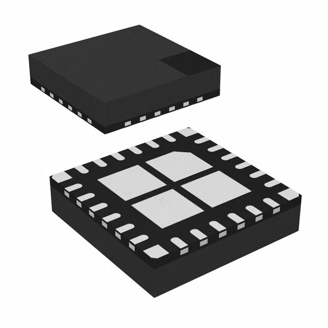

LT8640S-2/LT8643S-2 42V, 6A Synchronous Step-Down Silent Switcher with 2.5µA Quiescent Current FEATURES DESCRIPTION Silent Switcher ® Architecture n Ultralow EMI Emissions n Optional Spread Spectrum Modulation n High Efficiency at High Frequency n Up to 96% Efficiency at 1MHz, 12V to 5V IN OUT n Up to 95% Efficiency at 2MHz, 12V to 5V IN OUT n Wide Input Voltage Range: 3.4V to 42V n 6A Maximum Continuous, 7A Peak Output n Ultralow Quiescent Current Burst Mode® Operation n 2.5µA I Regulating 12V to 3.3V Q IN OUT (LT8640S-2) n Output Ripple < 10mV P-P n External Compensation: Fast Transient Response and Current Sharing (LT8643S-2) n Fast Minimum Switch On-Time: 30ns n Low Dropout Under All Conditions: 100mV at 1A n Forced Continuous Mode n Adjustable and Synchronizable: 200kHz to 3MHz n Output Soft-Start and Tracking n Small 24-Lead 4mm × 4mm LQFN Package n AEC-Q100 Qualified for Automotive Applications The LT®8640S-2/LT8643S-2 synchronous step-down regulator features Silent Switcher architecture designed to minimize EMI emissions while delivering high efficiency at high switching frequencies. Peak current mode control with a 30ns minimum on-time allows high step-down ratios even at high switching frequencies.The LT8643S-2 has external compensation to enable current sharing and fast transient response at high switching frequencies. APPLICATIONS n n n Burst Mode operation enables ultralow standby current consumption, forced continuous mode can control frequency harmonics across the entire output load range, or spread spectrum operation can further reduce EMI emissions. SYNC/ 150°C INTERNAL PACKAGE MODE ≠ 0 VC COMP GRADE CLKOUT CAPS Automotive and Industrial Supplies General Purpose Step-Down PulseInternal Skipping Yes No No Internal Yes No No FCM Internal No Yes Yes LQFN FCM External No Yes Yes LQFN FCM Internal Yes Yes No LQFN FCM External Yes Yes No LT8640 QFN LT8640-1 QFN FCM LT8640S LQFN LT8643S LT8640S-2 LT8643S-2 All registered trademarks and trademarks are the property of their respective owners. Protected by U.S. patents, including 8823345. TYPICAL APPLICATION 12VIN to 5VOUT Efficiency 5V, 6A Step-Down Converter VIN 5.7V TO 42V GND VIN BST 0.1µF SW 3.3µH VOUT 5V 6A BIAS 1µF 41.2k fSW = 1MHz INTVCC 10pF RT 1M 100µF FB GND 95 2.8 90 1µF GND LT8640S-2 3.2 243k 2.4 EFFICIENCY 85 2.0 80 1.6 1.2 75 POWER LOSS POWER LOSS (W) 1µF EN/UV VIN EFFICIENCY (%) 4.7µF 100 0.8 1MHz, L = 3.3µH 65 2MHz, L = 2.2µH 0.4 3MHz, L = 1µH 0 60 0.5 1 1.5 2 2.5 3 3.5 4 4.5 5 5.5 6 LOAD CURRENT (A) 70 8640s2 TA01b 8640s2 TA01a Rev. A Document Feedback For more information www.analog.com 1 LT8640S-2/LT8643S-2 ABSOLUTE MAXIMUM RATINGS (Note 1) VIN, EN/UV, PG...........................................................42V BIAS...........................................................................25V FB, TR/SS ...................................................................4V SYNC/MODE Voltage ..................................................6V Operating Junction Temperature Range (Note 2) LT8640S-2E/LT8643S-2E................... –40°C to 125°C LT8640S-2I/LT8643S-2I..................... –40°C to 125°C LT8640S-2H/LT8643S-2H.................. –40°C to 150°C Storage Temperature Range................... –65°C to 150°C Maximum Reflow (Package Body) Temperature...... 260°C PIN CONFIGURATION LT8640S-2 LT8643S-2 PG GND TR/SS SYNC/MODE CLKOUT FB PG VC TR/SS SYNC/MODE CLKOUT 21 20 19 27 GND 28 GND BIAS 1 INTVCC 2 GND 3 NC 4 14 VIN VIN 5 13 VIN VIN 6 17 EN/UV 16 GND 15 NC 7 8 9 10 11 12 LQFN PACKAGE 24-LEAD (4mm × 4mm × 0.94mm) JEDEC BOARD: θJA = 38°C/W, θJC(PAD) = 7°C/W (NOTE 3) DEMO BOARD: θJA = 24°C/W EXPOSED PAD (PINS 25 TO 28) ARE GND, SHOULD BE SOLDERED TO PCB 2 18 RT 25 GND 26 GND 27 GND 28 GND 17 EN/UV 16 GND 15 NC 14 VIN 13 VIN 7 8 9 10 11 12 SW 26 GND SW 18 RT 25 GND SW 6 22 SW 5 23 SW VIN VIN 24 BST 4 19 SW NC 20 SW 3 21 SW GND 22 SW 2 23 SW 1 24 BST BIAS INTVCC TOP VIEW FB TOP VIEW LQFN PACKAGE 24-LEAD (4mm × 4mm × 0.94mm) JEDEC BOARD: θJA = 38°C/W, θJC(PAD) = 7°C/W (NOTE 3) DEMO BOARD: θJA = 24°C/W EXPOSED PAD (PINS 25 TO 28) ARE GND, SHOULD BE SOLDERED TO PCB Rev. A For more information www.analog.com LT8640S-2/LT8643S-2 ORDER INFORMATION PART NUMBER PART MARKING* FINISH CODE PACKAGE TYPE** PAD FINISH MSL RATING TEMPERATURE RANGE –40°C to 125°C LT8640SEV-2#PBF LT8640SIV-2#PBF e4 LT8643SEV-2#PBF LT8643SIV-2#PBF –40°C to 125°C 86402 LT8640SHV-2#PBF LQFN (Laminate Package with QFN Footprint) Au (RoHS) –40°C to 150°C 3 –40°C to 125°C 86432 –40°C to 125°C LT8643SHV-2#PBF –40°C to 150°C AUTOMOTIVE PRODUCTS*** LT8640SIV-2#WPBF LT8640SHV-2#WPBF LT8643SIV-2#WPBF LT8643SHV-2#WPBF –40°C to 125°C 86402 e4 LQFN (Laminate Package with QFN Footprint) Au (RoHS) 86432 –40°C to 150°C 3 –40°C to 125°C –40°C to 150°C • Contact the factory for parts specified with wider operating temperature ranges. *Pad or ball finish code is per IPC/JEDEC J-STD-609. • Recommended LGA and BGA PCB Assembly and Manufacturing Procedures • Device temperature grade is indicated by a label on the shipping container. • LGA and BGA Package and Tray Drawings Parts ending with PBF are RoHS and WEEE compliant. **The LT8640S-2/LT8643S-2 package has the same dimensions as a standard 4mm × 4mm QFN package. ***Versions of this part are available with controlled manufacturing to support the quality and reliability requirements of automotive applications. These models are designated with a #W suffix. Only the automotive grade products shown are available for use in automotive applications. Contact your local Analog Devices account representative for specific product ordering information and to obtain the specific Automotive Reliability reports for these models. ELECTRICAL CHARACTERISTICS The l denotes the specifications which apply over the full operating temperature range, otherwise specifications are at TA = 25°C. PARAMETER CONDITIONS Minimum Input Voltage VIN Quiescent Current in Shutdown VEN/UV = 0V LT8640S-2 VIN Quiescent Current in Sleep (Internal Compensation) VEN/UV = 2V, VFB > 0.97V, VSYNC = 0V LT8643S-2 VIN Quiescent Current in Sleep (External Compensation) VEN/UV = 2V, VFB > 0.97V, VSYNC = 0V, VBIAS = 0V MIN TYP MAX UNITS l 3.0 3.4 V l 0.75 0.75 3 10 µA µA l 1.7 1.7 4 10 µA µA l 230 230 290 340 µA µA VEN/UV = 2V, VFB > 0.97V, VSYNC = 0V, VBIAS = 5V 19 25 µA LT8643S-2 BIAS Quiescent Current in Sleep VEN/UV = 2V, VFB > 0.97V, VSYNC = 0V, VBIAS = 5V 200 260 µA LT8640S-2 VIN Current in Regulation VOUT = 0.97V, VIN = 6V, ILOAD = 100µA, VSYNC = 0 VOUT = 0.97V, VIN = 6V, ILOAD = 1mA, VSYNC = 0 l l 21 220 60 390 µA µA Feedback Reference Voltage VIN = 6V VIN = 6V l 0.970 0.970 0.976 0.982 V V VIN = 4.0V to 36V l 0.004 0.02 %/V Feedback Voltage Line Regulation Feedback Pin Input Current VFB = 1V LT8643S-2 Error Amp Transconductance VC = 1.25V 0.964 0.958 –20 20 1.7 LT8643S-2 Error Amp Gain nA mS 260 LT8643S-2 VC Source Current VFB = 0.77V, VC = 1.25V 350 µA LT8643S-2 VC Sink Current VFB = 1.17V, VC = 1.25V 350 µA 5 A/V LT8643S-2 VC Pin to Switch Current Gain Rev. A For more information www.analog.com 3 LT8640S-2/LT8643S-2 ELECTRICAL CHARACTERISTICS The l denotes the specifications which apply over the full operating temperature range, otherwise specifications are at TA = 25°C. PARAMETER CONDITIONS MIN LT8643S-2 VC Clamp Voltage BIAS Pin Current Consumption VBIAS = 3.3V, fSW = 2MHz Minimum On-Time ILOAD = 1.5A, SYNC = 0V ILOAD = 1.5A, SYNC = 2V l l Minimum Off-Time Oscillator Frequency RT = 221k RT = 60.4k RT = 18.2k Top Power NMOS On-Resistance ISW = 1A l l l 180 665 1.8 TYP MAX 2.6 V 14 mA 30 30 50 45 ns ns 80 110 ns 210 700 1.95 240 735 2.1 kHz kHz MHz 66 Top Power NMOS Current Limit l Bottom Power NMOS On-Resistance VINTVCC = 3.4V, ISW = 1A SW Leakage Current VIN = 42V, VSW = 0V, 42V EN/UV Pin Threshold EN/UV Rising 7.5 10 mΩ 12.5 27 –1.5 l 0.94 EN/UV Pin Hysteresis 1.0 VEN/UV = 2V PG Upper Threshold Offset from VFB PG Lower Threshold Offset from VFB –20 A mΩ 1.5 1.06 40 EN/UV Pin Current UNITS µA V mV 20 nA VFB Falling l 5 7.5 10.25 % VFB Rising l –5.25 –8 –10.75 % 40 nA 700 2000 Ω 0.9 1.2 2.55 1.4 2.9 V V V PG Hysteresis 0.2 –40 % PG Leakage VPG = 3.3V PG Pull-Down Resistance VPG = 0.1V l SYNC/MODE Threshold SYNC/MODE DC and Clock Low Level Voltage SYNC/MODE Clock High Level Voltage SYNC/MODE DC High Level Voltage l l l Spread Spectrum Modulation Frequency Range RT = 60.4k, VSYNC = 3.3V 22 % Spread Spectrum Modulation Frequency VSYNC = 3.3V 3 kHz TR/SS Source Current l TR/SS Pull-Down Resistance Fault Condition, TR/SS = 0.1V Output Sink Current in Forced Continuous Mode VFB = 1.01V, L = 6.8µH, RT = 60.4k VIN to Disable Forced Continuous Mode VIN Rising Note 1: Stresses beyond those listed under Absolute Maximum Ratings may cause permanent damage to the device. Exposure to any Absolute Maximum Rating condition for extended periods may affect device reliability and lifetime. Note 2: The LT8640-2E/LT8643E is guaranteed to meet performance specifications from 0°C to 125°C junction temperature. Specifications over the –40°C to 125°C operating junction temperature range are assured by design, characterization, and correlation with statistical process controls. The LT8640-2I/LT8643I is guaranteed over the full –40°C to 125°C operating junction temperature range. The LT8640-2H/LT8643H is guaranteed over the full –40°C to 150°C operating junction temperature range. High junction temperatures degrade operating lifetimes. Operating lifetime is derated at junction temperatures greater than 125°C. The junction 4 0.7 2.2 1.2 1.9 2.6 200 µA Ω 0.25 0.6 1.1 A 35 37 39 V temperature (TJ, in °C) is calculated from the ambient temperature (TA in °C) and power dissipation (PD, in Watts) according to the formula: TJ = TA + (PD • θJA) where θJA (in °C/W) is the package thermal impedance. Note 3: θ values determined per JEDEC 51-7, 51-12. See the Applications Information section for information on improving the thermal resistance and for actual temperature measurements of a demo board in typical operating conditions. Note 4: This IC includes overtemperature protection that is intended to protect the device during overload conditions. Junction temperature will exceed 150°C when overtemperature protection is active. Continuous operation above the specified maximum operating junction temperature will reduce lifetime. Rev. A For more information www.analog.com LT8640S-2/LT8643S-2 TYPICAL PERFORMANCE CHARACTERISTICS 12VIN to 3.3VOUT Efficiency vs Frequency 3.2 2.4 90 80 1.6 75 1.2 POWER LOSS 1.6 75 1.2 POWER LOSS 70 3.0 2.7 90 2.4 EFFICIENCY 85 2.1 80 1.8 75 1.5 70 65 60 55 50 1.2 POWER LOSS 0 1 VIN = 12V 0.9 VIN = 24V 0.6 VIN = 36V fSW = 1MHz 0.3 L = IHLP3232DZ-01, 2.2µH 0 2 3 4 5 6 LOAD CURRENT (A) 100 50 VIN = 12V VIN = 24V VIN = 36V 40 30 20 0.01 30 20 0.01 fSW = 1MHz L = IHLP3232DZ-01, 4.7µH 0.1 1 10 100 LOAD CURRENT (mA) 1000 8640s2 G07 EFFICIENCY (%) EFFICIENCY (%) 100 80 40 1 8640s2 G03 100 LT8643S-2 Low Load Efficiency at 5VOUT 1 10 100 LOAD CURRENT (mA) 60 50 40 VIN = 12V VIN = 24V VIN = 36V 30 20 fSW = 1MHz L = IHLP3232DZ-01, 4.7µH 0.1 70 10 0.1 1000 fSW = 1MHz L = IHLP3232DZ–01, 4.7µH 1 10 100 LOAD CURRENT (mA) 1000 8640s2 G05 80 VIN = 12V VIN = 24V VIN = 36V 0 1.2 VIN = 12V 0.9 VIN = 24V 0.6 VIN = 36V fSW = 1MHz 0.3 L = IHLP3232DZ-01, 3.3µH 0 2 3 4 5 6 LOAD CURRENT (A) 65 80 60 90 50 1.5 POWER LOSS 70 90 70 90 60 75 50 80 LT8640S-2 Low Load Efficiency at 3.3V Efficiency OUT at 3.3V OUT 70 1.8 55 LT8640S-2 Low Load Efficiency at 5VOUT OUT 8640s2 G04 100 2.1 80 60 90 EFFICIENCY (%) 95 2.4 EFFICIENCY 85 8640s2 G02 POWER LOSS (W) EFFICIENCY (%) 100 2.0 80 8640s2 G01 Efficiency at 3.3VOUT 90 L = WE-LHMI1040 0.8 1MHz, L = 2.2µH 0.4 65 2MHz, L = 1µH 3MHz, L = 1µH 0 60 0.5 1 1.5 2 2.5 3 3.5 4 4.5 5 5.5 6 LOAD CURRENT (A) L = WE-LHMI1040 0.8 1MHz, L = 3.3µH 65 2MHz, L = 2.2µH 0.4 3MHz, L = 1µH 0 60 0.5 1 1.5 2 2.5 3 3.5 4 4.5 5 5.5 6 LOAD CURRENT (A) 70 2.7 2.4 EFFICIENCY 85 2.8 POWER LOSS (W) 2.0 3.0 95 POWER LOSS (W) 85 100 EFFICIENCY (%) EFFICIENCY 95 POWER LOSS (W) EFFICIENCY (%) 90 2.8 Efficiency at 5VOUT 3.2 8640s2 G06 LT8643S-2 Low Load Efficiency at 3.3VOUT 94 92 70 60 50 40 VIN = 12V VIN = 24V VIN = 36V 30 fSW = 1MHz L = IHLP3232DZ–01, 4.7µH 20 10 0.1 Efficiency vs Frequency 96 1 10 100 LOAD CURRENT (mA) 1000 8640s2 G08 EFFICIENCY (%) 95 100 EFFICIENCY (%) 100 EFFICIENCY (%) 12VIN to 5VOUT Efficiency vs Frequency Frequency vs 90 88 86 84 VIN = 12V VOUT = 3.3V ILOAD = 2A L = IHLP3232DZ-01, 4.7µH 82 80 0 0.5 1 1.5 2 2.5 SWITCHING FREQUENCY (MHz) 3 8640s2 G09 Rev. A For more information www.analog.com 5 LT8640S-2/LT8643S-2 TYPICAL PERFORMANCE CHARACTERISTICS Burst Mode Operation Efficiency vs Inductor Value (LT8640S-2) Reference Voltage 100 VIN = 12V VIN = 24V 85 80 75 VOUT = 5V ILOAD = 10mA L = IHLP3232DZ-01 70 65 1 2 3 4 5 6 INDUCTOR VALUE (µH) 977 1.02 973 971 969 967 –25 0 25 50 75 TEMPERATURE (°C) 8640s2 G10 LT8640S-2 Load Regulation 0 0.05 VOUT = 5V VIN = 12V VSYNC = 0V 1 2 3 4 LOAD CURRENT (A) 6 0.30 0.10 0.10 0.00 –0.10 –0.20 –0.40 1 0.02 0.00 –0.02 –0.04 VOUT = 5V VIN = 12V VSYNC = 0V 0 0.04 2 3 4 LOAD CURRENT (A) 5 6 –0.08 VOUT = 5V ILOAD = 1A –0.15 5 10 15 20 25 30 35 INPUT VOLTAGE (V) 40 45 3.0 2.5 2.0 1.5 1.0 VOUT = 3.3V L = 4.7µH IN REGULATION 0 5 10 15 20 25 30 35 INPUT VOLTAGE (V) 8640s2 G16 6 20 25 30 35 INPUT VOLTAGE (V) 40 45 VOUT = 5V L = 4.7µH IN REGULATION 200 INPUT CURRENT (µA) INPUT CURRENT (µA) CHANGE IN VOUT (%) 0.09 –0.12 15 225 3.5 –0.09 10 LT8643S-2 No-Load Supply Current 4.0 –0.06 5 8640s2 G15 0.12 0 VOUT = 5V ILOAD = 1A –0.06 8640s2 G14 0.15 125 0.06 LT8640S-2 No-Load Supply Current –0.03 100 0.08 0.20 LT8643S-2 Line Regulation 0.03 0 25 50 75 TEMPERATURE (°C) LT8640S-2 Line Regulation 0.12 8640s2 G13 0.06 –25 8640s2 G12 0.40 –0.30 5 EN FALLING 0.95 –50 125 CHANGE IN VOUT (%) CHANGE IN VOUT (%) CHANGE IN VOUT (%) 0.05 0 100 LT8643S-2 Load Regulation 0.10 –0.15 0.98 8640s2 G11 0.15 –0.10 0.99 0.96 961 –50 8 1.00 0.97 965 963 7 EN RISING 1.01 EN THRESHOLD (V) EFFICIENCY (%) 90 1.03 975 REFERENCE VOLTAGE (mV) 95 EN Pin Thresholds 979 40 175 150 125 100 75 50 45 8640s2 G17 25 5 10 15 20 25 30 35 INPUT VOLTAGE (V) 40 45 8640s2 G18 Rev. A For more information www.analog.com LT8640S-2/LT8643S-2 TYPICAL PERFORMANCE CHARACTERISTICS Top FET Current Limit vs Duty Cycle Top FET Current Limit Switch Drop vs Temperature 12 11.0 150 SWITCH CURRENT = 1A 10.5 125 9.0 8.5 8.0 7.5 10 SWITCH DROP (mV) 11 9.5 CURRENT LIMIT (A) CURRENT LIMIT (A) 10.0 5% DC 9 7.0 100 TOP SWITCH 75 50 25 BOTTOM SWITCH 6.5 6.0 0.1 0.3 0.5 DUTY CYCLE 0.7 8 –50 0.9 –25 0 25 50 75 TEMPERATURE (°C) 100 600 DROPOUT VOLTAGE (mV) SWITCH DROP (mV) 350 300 TOP SWITCH 200 150 100 0 400 300 200 BOTTOM SWITCH 0 1 2 3 4 SWITCH CURRENT (A) 0 5 0 0.5 1 1.5 2 2.5 3 3.5 LOAD CURRENT (A) Switching Frequency 720 710 700 690 680 670 –25 0 25 50 75 TEMPERATURE (°C) 4 4.5 20 –50 5 100 125 8640s2 G25 ILOAD = 2A VOUT = 0.97V fSW = 3MHz –25 0 25 50 75 TEMPERATURE (°C) 1.2 1000 1.0 800 0.8 600 400 0 FRONT PAGE APPLICATION VIN = 12V VOUT = 5V 0 100 200 300 400 LOAD CURRENT (mA) 125 LT8640S-2 Soft-Start Tracking 1200 200 100 8640s2 G24 FB VOLTAGE (V) RT = 60.4k 660 –50 28 Burst Frequency SWITCHING FREQUENCY (kHz) SWITCHING FREQUENCY (kHz) 730 32 8640s2 G23 8640s2 G22 740 36 24 100 50 125 Burst Mode OPERATION FORCED CONTINUOUS MODE 40 MINIMUM ON–TIME (ns) 500 100 Minimum On-Time 44 VIN = 5V VOUT SET TO REGULATE AT 5V L = IHLP3232DZ-01, 1µH 450 0 25 50 75 TEMPERATURE (°C) 8640s2 G21 Dropout Voltage Switch Drop vs Switch Current 500 400 –25 8640s2 G20 8640s2 G19 250 0 –50 125 500 600 8640s2 G26 0.6 0.4 0.2 0 0 0.2 1.0 0.4 0.6 0.8 TR/SS VOLTAGE (V) 1.2 1.4 8640s2 G27 Rev. A For more information www.analog.com 7 LT8640S-2/LT8643S-2 TYPICAL PERFORMANCE CHARACTERISTICS LT8643S-2 Soft-Start Tracking 2.2 1.2 0.4 1.9 1.8 1.7 1.6 0.2 0.4 0.6 0.8 1 1.2 TR/SS VOLTAGE (V) 1.4 1.6 1.4 –50 –500 –200 –25 0 25 50 75 TEMPERATURE (°C) 100 PG THRESHOLD OFFSET FROM VREF (%) PG THRESHOLD OFFSET FROM VREF (%) 9.0 FB RISING 7.5 FB FALLING 6.5 –25 0 25 50 75 TEMPERATURE (°C) 100 125 250 –6.5 225 –7.5 FB RISING –8.0 FB FALLING –8.5 –9.0 75 25 –25 0 25 50 75 TEMPERATURE (°C) 100 0 0.2 125 125 8640s2 G34 3 Bias Pin Current 25 7.5 7.0 6.5 VBIAS = 5V VOUT = 5V ILOAD = 1A fSW = 1MHz 6.0 100 0.6 1.4 1.8 2.2 2.6 1 SWITCHING FREQUENCY (MHz) 8640s2 G33 BIAS PIN CURRENT (mA) INPUT VOLTAGE (V) 100 Bias Pin Current 2.6 8 125 8640s2 G32 8.0 0 25 50 75 TEMPERATURE (°C) 150 50 –10.0 –50 3.4 –25 175 –9.5 8.5 2.8 200 200 –7.0 Minimum Input Voltage 3.0 –100 0 100 FB PIN ERROR VOLTAGE (mV) 8640s2 G30 –6.0 3.6 3.2 VC = 1.25V RT Programmed Switching Frequency 8640s2 G31 2.4 –50 125 PG Low Thresholds 9.5 6.0 –50 –250 8640s2 G29 10.0 7.0 –125 –375 PG High Thresholds 8.0 0 1.5 8640s2 G28 8.5 125 RT PIN RESISTOR (kΩ) 0.2 250 BIAS PIN CURRENT (mA) 0 VC PIN CURRENT (µA) 0.6 375 2.0 TR/SS PIN CURRENT (µA) FB VOLTAGE (V) 0.8 500 VSS = 0.5V 2.1 1.0 0 LT8643S-2 Error Amp Output Current Soft-Start Current 5.5 5 10 15 20 25 30 35 INPUT VOLTAGE (V) 40 45 8640s2 G35 20 VBIAS = 5V VOUT = 5V VIN = 12V ILOAD = 1A 15 10 5 0 0.2 0.6 1 1.4 1.8 2.2 2.6 SWITCHING FREQUENCY (MHz) 3.0 8640s2 G36 Rev. A For more information www.analog.com LT8640S-2/LT8643S-2 TYPICAL PERFORMANCE CHARACTERISTICS Case Temperature Rise vs 7A Pulsed Load Case Temperature Rise 80 90 DC2530A DEMO BOARD VIN = 12V, fSW = 1MHz VIN = 24V, fSW = 1MHz VIN = 12V, fSW = 2MHz VIN = 24V, fSW = 2MHz 60 50 40 30 20 10 0 DC2530A DEMO BOARD VIN = 12V VOUT = 5V fSW = 2MHz STANDBY LOAD = 0.25A 1kHz PULSED LOAD = 7A 80 CASE TEMPERATURE RISE (°C) CASE TEMPERATURE RISE (°C) 70 Switching Rising Edge 70 60 VSW 2V/DIV 50 40 30 20 10 0 1 2 3 4 LOAD CURRENT (A) 5 6 0 0 0.2 0.4 0.6 0.8 DUTY CYCLE OF 7A LOAD 8640s2 G37 1 Switching Waveforms, Burst Mode Operation Switching Waveforms IL 1A/DIV IL 500mA/DIV VSW 5V/DIV VSW 10V/DIV VSW 5V/DIV 500ns/DIV 8640s2 G40 8640s2 G41 5µs/DIV FRONT PAGE APPLICATION 12VIN TO 5VOUT AT 10mA VSYNC = 0V FRONT PAGE APPLICATION 12VIN TO 5VOUT AT 1A ILOAD 2A/DIV ILOAD 2A/DIV VOUT 100mV/DIV VOUT 100mV/DIV FRONT PAGE APPLICATION 2A TO 4A TRANSIENT 12VIN, 5VOUT fSW = 2MHz COUT = 100µF, CLEAD = 10pF 500ns/DIV FRONT PAGE APPLICATION 36VIN TO 5VOUT AT 1A 8640s2 G42 LT8643S-2 Transient Response; External Compensation LT8640S-2 Transient Response; Internal Compensation 20µs/DIV 8640s2 G39 8640s2 G38 Switching Waveforms, Full Frequency Continuous Operation IL 1A/DIV 2ns/DIV VIN = 12V ILOAD = 2A 8640s2 G43 20µs/DIV 8640s2 G44 FRONT PAGE APPLICATION 2A TO 4A TRANSIENT 12VIN, 5VOUT fSW = 2MHz CC = 330pF, RC = 8.45k COUT = 100µF, CLEAD = 4.7pF Rev. A For more information www.analog.com 9 LT8640S-2/LT8643S-2 TYPICAL PERFORMANCE CHARACTERISTICS LT8640S-2 Transient Response; 100mA to 1.1A Transient LT8643S-2 Transient Response; 100mA to 1.1A Transient ILOAD 1A/DIV ILOAD 1A/DIV Burst Mode OPERATION Burst Mode OPERATION VOUT 100mV/DIV VOUT 100mV/DIV FCM FCM 8640s2 G45 50µs/DIV VIN 2V/DIV VOUT 2V/DIV FRONT PAGE APPLICATION 100mA TO 1.1A TRANSIENT 12VIN, 5VOUT, fSW = 1MHz COUT = 100µF Start-Up Dropout Performance Start-Up Dropout Performance VIN VIN VIN 2V/DIV VOUT 100ms/DIV 2.5Ω LOAD (2A IN REGULATION) 10 8640s2 G46 50µs/DIV CC = 330pF, RC = 6.49k, CLEAD = 4.7pF 100mA TO 1.1A TRANSIENT 12VIN, 5VOUT, fSW = 1MHz COUT = 100µF VOUT VOUT 2V/DIV 8640s2 G47 100ms/DIV 20Ω LOAD (250mA IN REGULATION) 8640s2 G48 Rev. A For more information www.analog.com LT8640S-2/LT8643S-2 TYPICAL PERFORMANCE CHARACTERISTICS Conducted EMI Performance Conducted EMI Performance 60 50 AMPLITUDE (dBµV) 40 30 20 10 0 –10 –20 SPREAD SPECTRUM MODE FIXED FREQUENCY MODE –30 –40 0 3 6 9 12 15 18 FREQUENCY (MHz) DC2530A DEMO BOARD USING LT8640S (WITH EMI FILTER INSTALLED) 14V INPUT TO 5V OUTPUT AT 4A, fSW = 2MHz 21 24 27 30 8640s2 G49 Radiated EMI Performance (CISPR25 Radiated Emission Test with Class 5 Peak Limits) 50 VERTICAL POLARIZATION PEAK DETECTOR 45 AMPLITUDE (dBµV/m) 40 35 30 25 20 15 10 5 CLASS 5 PEAK LIMIT SPREAD SPECTRUM MODE FIXED FREQUENCY MODE 0 –5 0 100 200 300 400 500 600 FREQUENCY (MHz) 700 800 900 1000 8640s2 G50a 50 HORIZONTAL POLARIZATION PEAK DETECTOR 45 AMPLITUDE (dBµV/m) 40 35 30 25 20 15 10 5 CLASS 5 PEAK LIMIT SPREAD SPECTRUM MODE FIXED FREQUENCY MODE 0 –5 0 100 200 300 400 500 600 FREQUENCY (MHz) DC2530A DEMO BOARD USING LT8640S (WITH EMI FILTER INSTALLED) 14V INPUT TO 5V OUTPUT AT 4A, fSW = 2MHz 700 800 900 1000 8640s2 G50b Rev. A For more information www.analog.com 11 LT8640S-2/LT8643S-2 PIN FUNCTIONS BIAS (Pin 1): The internal regulator will draw current from BIAS instead of VIN when BIAS is tied to a voltage higher than 3.1V. For output voltages of 3.3V to 25V this pin should be tied to VOUT. If this pin is tied to a supply other than VOUT use a 1µF local bypass capacitor on this pin. If no supply is available, tie to GND. However, especially for high input or high frequency applications, BIAS should be tied to output or an external supply of 3.3V or above. INTVCC (Pin 2): Internal 3.4V Regulator Bypass Pin. The internal power drivers and control circuits are powered from this voltage. INTVCC maximum output current is 20mA. Do not load the INTVCC pin with external circuitry. INTVCC current will be supplied from BIAS if BIAS > 3.1V, otherwise current will be drawn from VIN. Voltage on INTVCC will vary between 2.8V and 3.4V when BIAS is between 3.0V and 3.6V. Place a low ESR ceramic capacitor of at least 1µF from this pin to ground close to the IC. GND (Pins 3, 16, Exposed Pad Pins 25–28): Ground. Place the negative terminal of the input capacitor as close to the GND pins as possible. The exposed pads should be soldered to the PCB for good thermal performance. If necessary due to manufacturing limitations Pins 25 to 28 may be left disconnected, however thermal performance will be degraded. NC (Pins 4, 15): No Connect. This pin is not connected to internal circuitry and can be tied anywhere on the PCB, typically ground. VIN (Pins 5, 6, 13, 14): The VIN pins supply current to the LT8640S-2/LT8643S-2 internal circuitry and to the internal topside power switch. The LT8640S-2/LT8643S-2 requires the use of multiple VIN bypass capacitors. Two small 1µF capacitors should be placed as close as possible to the LT8640S-2/LT8643S-2, one capacitor on each side of the device (CIN1, CIN2). A third capacitor with a larger value, 2.2µF or higher, should be placed near CIN1 or CIN2. See Applications Information section for sample layout. BST (Pin 7): This pin is used to provide a drive voltage, higher than the input voltage, to the topside power switch. Place a 0.1µF boost capacitor as close as possible to the IC. 12 SW (Pins 8–12): The SW pins are the outputs of the internal power switches. Tie these pins together and connect them to the inductor. This node should be kept small on the PCB for good performance and low EMI. EN/UV (Pin 17): The LT8640S-2/LT8643S-2 is shut down when this pin is low and active when this pin is high. The hysteretic threshold voltage is 1.00V going up and 0.96V going down. Tie to VIN if the shutdown feature is not used. An external resistor divider from VIN can be used to program a VIN threshold below which the LT8640S-2/ LT8643S-2 will shut down. RT (Pin 18): A resistor is tied between RT and ground to set the switching frequency. CLKOUT (Pin 19): In forced continuous mode, spread spectrum, and synchronization modes, the CLKOUT pin will provide a ~200ns wide pulse at the switch frequency. The low and high levels of the CLKOUT pin are ground and INTVCC respectively, and the drive strength of the CLKOUT pin is several hundred ohms. In Burst Mode operation, the CLKOUT pin will be low. Float this pin if the CLKOUT function is not used. SYNC/MODE (Pin 20): For the LT8640S-2/LT8643S-2, this pin programs four different operating modes: 1) Burst Mode operation. Tie this pin to ground for Burst Mode operation at low output loads—this will result in ultralow quiescent current. 2) Forced Continuous mode (FCM). This mode offers fast transient response and full frequency operation over a wide load range. Float this pin for FCM. When floating, pin leakage currents should be 3.1V OR GND VOUT 1.8V 6A 10pF 866k FB 1M GND 100µF 1210 X5R/X7R 8640s2 TA02 fSW = 2MHz L: XEL6030 PINS NOT USED IN THIS CIRCUIT: CLKOUT, PG, SYNC/MODE RELATED PARTS PART DESCRIPTION COMMENTS LT8640S/ LT8643S 42V, 6A Synchronous Step-Down Silent Switcher 2 with IQ = 2.5μA VIN(MIN) = 3.4V, VIN(MAX) = 42V, VOUT(MIN) = 0.97V, IQ = 2.5µA, ISD < 1µA, 4mm × 4mm LQFN-24 LT8640/ LT8640-1 42V, 5A, 96% Efficiency, 3MHz Synchronous MicroPower Step-Down DC/DC Converter with IQ = 2.5μA VIN(MIN) = 3.4V, VIN(MAX) = 42V, VOUT(MIN) = 0.97V, IQ = 2.5µA, ISD < 1µA, 3mm × 4mm QFN-18 LT8645S 65V, 8A, Synchronous Step-Down Silent Switcher 2 with IQ = 2.5μA VIN(MIN) = 3.4V, VIN(MAX) = 65V, VOUT(MIN) = 0.97V, IQ = 2.5µA, ISD < 1µA, 4mm × 6mm LQFN-32 LT8641 65V, 3.5A, 95% Efficiency, 3MHz Synchronous MicroPower Step-Down DC/DC Converter with IQ = 2.5μA VIN(MIN) = 3V, VIN(MAX) = 65V, VOUT(MIN) = 0.81V, IQ = 2.5µA, ISD < 1µA, 3mm × 4mm QFN-18 LT8609/ LT8609A 42V, 2A, 94% Efficiency, 2.2MHz Synchronous MicroPower Step-Down DC/DC Converter with IQ = 2.5µA VIN(MIN) = 3V, VIN(MAX) = 42V, VOUT(MIN) = 0.8V, IQ = 2.5µA, ISD < 1µA, MSOP-10E LT8610A/ LT8610AB 42V, 3.5A, 96% Efficiency, 2.2MHz Synchronous MicroPower StepDown DC/DC Converter with IQ = 2.5µA VIN(MIN) = 3.4V, VIN(MAX) = 42V, VOUT(MIN) = 0.97V, IQ = 2.5µA, ISD < 1µA, MSOP-16E LT8610AC 42V, 3.5A, 96% Efficiency, 2.2MHz Synchronous MicroPower StepDown DC/DC Converter with IQ = 2.5µA VIN(MIN) = 3V, VIN(MAX) = 42V, VOUT(MIN) = 0.8V, IQ = 2.5µA, ISD < 1µA, MSOP-16E LT8610 42V, 2.5A, 96% Efficiency, 2.2MHz Synchronous MicroPower StepDown DC/DC Converter with IQ = 2.5µA VIN(MIN) = 3.4V, VIN(MAX) = 42V, VOUT(MIN) = 0.97V, IQ = 2.5µA, ISD < 1µA, MSOP-16E LT8616 42V, Dual 2.5A + 1.5A, 95% Efficiency, 2.2MHz Synchronous MicroPower Step-Down DC/DC Converter with IQ = 5µA VIN(MIN) = 3.4V, VIN(MAX) = 42V, VOUT(MIN) = 0.8V, IQ = 5µA, ISD < 1µA, TSSOP-28E, 3mm × 6mm QFN-28 LT8620 65V, 2.5A, 94% Efficiency, 2.2MHz Synchronous MicroPower StepDown DC/DC Converter with IQ = 2.5µA VIN(MIN) = 3.4V, VIN(MAX) = 65V, VOUT(MIN) = 0.97V, IQ = 2.5µA, ISD < 1µA, MSOP-16E, 3mm × 5mm QFN-24 LT8614 42V, 4A, 96% Efficiency, 2.2MHz Synchronous Silent Switcher StepDown DC/DC Converter with IQ = 2.5µA VIN(MIN) = 3.4V, VIN(MAX) = 42V, VOUT(MIN) = 0.97V, IQ = 2.5µA, ISD < 1µA, 3mm × 4mm QFN18 LT8612 42V, 6A, 96% Efficiency, 2.2MHz Synchronous MicroPower Step-Down DC/DC Converter with IQ = 2.5µA VIN(MIN) = 3.4V, VIN(MAX) = 42V, VOUT(MIN) = 0.97V, IQ = 3.0µA, ISD < 1µA, 3mm × 6mm QFN-28 LT8602 42V, Quad Output (2.5A + 1.5A + 1.5A + 1.5A) 95% Efficiency, 2.2MHz Synchronous MicroPower Step-Down DC/DC Converter with IQ = 25µA VIN(MIN) = 3V, VIN(MAX) = 42V, VOUT(MIN) = 0.8V, IQ = 2.5µA, ISD < 1µA, 6mm × 6mm QFN-40 30 Rev. A 05/21 www.analog.com For more information www.analog.com  ANALOG DEVICES, INC. 2018-2021
