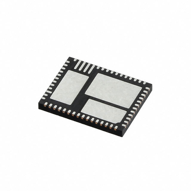

LTC3613 24V, 15A Monolithic Step Down Regulator with Differential Output Sensing DESCRIPTION FEATURES n n n n n n n n n n n n n n Wide VIN Range: 4.5V to 24V; VOUT Range: 0.6V to 5.5V at up to 15A 0.67% Output Voltage Accuracy Controlled On-Time Valley Current Mode Architecture, Excellent Current Sharing Capability Frequency Programmable from 200kHz to 1MHz and Synchronizable to External Clock RSENSE or Inductor DCR Current Sensing With Accurate Current Limit Fast Transient Response Differential Output Voltage Sensing Allowing 500mV Common Mode Remote Ground tON(MIN) = 65ns; tOFF(MIN) = 105ns Overvoltage Protection and Current Limit Foldback Power Good Output Voltage Monitor Voltage Tracking Start-Up External VCC Input for Bypassing Internal LDO Micropower Shutdown: IQ = 15μA 7mm × 9mm 56-pin QFN Package APPLICATIONS n n n The LTC®3613 is a monolithic synchronous step-down switching regulator capable of regulating outputs from 0.6V to 5.5V with up to 15A output current. The controlled on-time constant frequency valley current mode architecture allows for both fast transient response and constant frequency switching in steady-state operation, independent of VIN, VOUT and load. This also provides excellent current sharing capability. Differential output voltage sensing along with a precision internal reference combine to offer ±0.67% output regulation, even if the output ground reference deviates from local ground by 500mV. The switching frequency can be programmed from 200kHz to 1MHz with an external resistor. The switching frequency is also phase synchronizable to an external clock in applications where switching noise/ EMI reduction is crucial. Very low tON and tOFF times allow for near 0% and near 100% duty cycles, respectively. Voltage tracking soft start-up is provided for tracking and sequencing applications. Safety features include output overvoltage protection, programmable current limit with foldback, and power good monitoring. L, LT, LTC, LTM, OPTI-LOOP, Linear Technology and the Linear logo are registered trademarks and Hot Swap and No RSENSE is a trademark of Linear Technology Corporation. All other trademarks are the property of their respective owners. Protected by U.S. Patents including 5481178, 5487554, 6580258, 6304066, 6476589, 6774611. Distributed Power System Point-of-Load Converters Servers TYPICAL APPLICATION Efficiency and Power Loss vs Load Current High Efficiency High Power Step-Down Converter 100k PVIN SVIN RUN MODE/PLLIN EXTVCC 0.1μF 47pF 270pF TRACK/SS SENSE+ 1000pF ITH RT SGND 1.5mΩ SW 0.1μF 15k VOUT 1.5V 15A BOOST PGND VOSNS+ VOSNS– 3.0 2.5 70 60 2.0 FORCED CONTINUOUS MODE 50 40 1.5 30 1.0 20 + VIN = 12V VOUT = 1.5V 10 10k 4.7μF 115k 10Ω 0.47μH PULSE-SKIPPING MODE 80 10Ω INTVCC 21k 82μF 0.1μF SENSE– VRNG 90 POWER LOSS (W) LTC3613 VOUT PGOOD 3.5 100 VIN 4.5V TO 24V + EFFICIENCY (%) INTVCC 330μF ×2 0 0.01 0.5 0 0.1 10 1 LOAD CURRENT (A) 3613 TA01a 3613 TA01 3613fa 1 LTC3613 ABSOLUTE MAXIMUM RATINGS PIN CONFIGURATION (Note 1) 56 PVIN 55 PVIN 54 PVIN 53 PVIN 52 NC 51 SW 50 SW 49 SW 48 SW 47 SW 46 SW 45 SW TOP VIEW PVIN 1 PVIN 2 PVIN 3 PVIN 4 PVIN 5 PVIN 6 PVIN 7 PVIN 8 PVIN 9 SW 10 BOOST 11 SGND 12 PGOOD 13 SNS+ 14 SNS– 15 SGND 16 44 PGND 43 PGND 42 PGND 41 PGND 40 PGND 39 PGND 38 PGND 37 PGND 36 PGND 35 SW 34 INTVCC 33 INTVCC 32 SVIN 31 MODE/PLLIN 30 EXTVCC 29 SGND SW 58 PVIN 57 SGND 59 SGND 17 VOUT 18 SGND 19 VOSNS– 20 VOSES+ 21 TRACK/SS 22 ITH 23 VRNG 24 RT 25 RUN 26 NC 27 SGND 28 Supply Voltage (PVIN, SVIN)....................... –0.3V to 24V Boost Voltage ............................................ –0.3V to 30V SW Voltage ................................................ –0.3V to 24V INTVCC, EXTVCC, (BOOST-SW), MODE /PLLIN, VRNG, PGOOD, RUN Voltages....................... –0.3V to 6V VOSNS+, VOSNS – Voltages ........ –0.6V to (INTVCC + 0.3V) VOUT, SENSE+, SENSE– Voltages ................. –0.6V to 6V RT, ITH Voltages ..................... –0.3V to (INTVCC + 0.3V) TRACK/SS Voltages ..................................... –0.3V to 5V Operating Junction Temperature Range (Notes 2, 4) ............................................ –40°C to 125°C Storage Temperature Range .................. –65°C to 150°C WKH PACKAGE 56-LEAD (7mm × 9mm) MULTIPAD QFN TJMAX = 125°C, θJA = 29°C/W ORDER INFORMATION LEAD FREE FINISH TAPE AND REEL PART MARKING* PACKAGE DESCRIPTION TEMPERATURE RANGE LTC3613EWKH#PBF LTC3613EWKH#TRPBF LTC3613WKH 56-Lead (7mm × 9mm) Plastic QFN –40°C to 125°C LTC3613IWKH#PBF LTC3613IWKH#TRPBF LTC3613WKH 56-Lead (7mm × 9mm) Plastic QFN –40°C to 125°C Consult LTC Marketing for parts specified with wider operating temperature ranges. *The temperature grade is identified by a label on the shipping container. For more information on lead free part marking, go to: http://www.linear.com/leadfree/ For more information on tape and reel specifications, go to: http://www.linear.com/tapeandreel/ 3613fa 2 LTC3613 ELECTRICAL CHARACTERISTICS The l denotes the specifications which apply over the specified operating junction temperature range, otherwise specifications are at TA = 25°C. SVIN = 15V, VFB = VOSNS+ – VOSNS–, unless otherwise noted. (Note 4) SYMBOL PARAMETER CONDITIONS MIN TYP MAX UNITS Main Control Loop VIN Input Voltage Operating Range l 4.5 24 V VOUT Output Voltage Operating Range l 0.6 5.5 V IQ Input DC Supply Current Normal Shutdown Supply Current 2 15 4 25 mA μA VREG MODE/PLLIN = INTVCC RUN = 0V Regulated Differential Feedback Voltage (VOSNS+ – VOSNS–) ITH = 1.2V (Note 3) TA = 25°C TA = 0°C to 85°C TA = –40°C to 125°C l l 0.5985 0.596 0.594 0.6 0.6 0.6 0.6015 0.604 0.606 V V V Regulated Differential Feedback Voltage Over Line, Load and Common Mode (VOSNS+ – VOSNS–) VIN = 4.5V to 24V, ITH = 0.5V to 1.9V, VOSNS– = ±500mV (Note 3) TA = 0°C to 85°C TA = –40°C to 125°C l l 0.594 0.591 0.6 0.6 0.606 0.609 V V tON(MIN) Minimum On-Time 65 ns tOFF(MIN) Minimum Off-Time 105 ns gm(EA) Error Amplifier Transconductance ITH = 1.2V (Note 3) l 1.4 1.7 2 mS VRNG = 2V, VFB = 0.57V VRNG = 0V, VFB = 0.57V VRNG = INTVCC, VFB = 0.57V l l l 80 22 39 100 30 50 120 38 61 mV mV mV VSENSE(MAX) Valley Current Sense Threshold, VSENSE+ – VSENSE–, Peak Current = Valley + Ripple VSENSE(MIN) Minimum Current Sense Threshold,VSENSE+ – VRNG = 2V, VFB = 0.63V VSENSE–, Force Continuous Operation VRNG = 0V, VFB = 0.63V VRNG = INTVCC, VFB = 0.63V VSENSE(CM) SENSE+, SENSE– Voltage Range (Common Mode) ISENSE SENSE+, SENSE– Input Bias Current VSENSE(CM) = 0.6V VSENSE(CM) = 5V VRUN(TH) RUN Pin On Threshold VRUN Rising VRUN(HYS) RUN Pin Hysteresis –50 –15 –25 l l –0.5 1.1 mV mV mV 5.5 V ±5 1 ±50 4 nA μA 1.2 1.3 V 80 ISS Soft-Start Charging Current VTRACKSS = 0V UVLO INTVCC Undervoltage Lockout INTVCC Undervoltage Lockout Release Falling Rising IVOSNS+ VOSNS+ Input Bias Current IVOSNS– VOSNS– Input Bias Current mV 1.0 l l 3.4 μA 3.65 4.2 4.0 4.5 V V VFB = 0.6V ±5 ±25 nA VFB = 0.6V –15 –50 μA 3613fa 3 LTC3613 ELECTRICAL CHARACTERISTICS The l denotes the specifications which apply over the specified operating junction temperature range, otherwise specifications are at TA = 25°C. SVIN = 15V, VFB = VOSNS+ – VOSNS–, unless otherwise noted. (Note 4) SYMBOL PARAMETER CONDITIONS MIN TYP MAX UNITS RT = 205k RT = 80.6k RT = 38.8k 175 450 900 200 500 1000 225 550 1100 kHz kHz kHz Oscillator and Clock Synchronization fOSC Free Running Switching Frequency CLKIH Clock Input High Level Into Mode/PLLIN CLKIL Clock Input Low Level Into Mode/PLLIN 2 V 0.5 V 5.3 5.55 V –1 –2 % 4.6 4.75 V Internal VCC Regulator and External VCC INTVCC Internal VCC Voltage 6V < VIN < 24V 5.1 INTVCC(%) Internal VCC Load Regulation ICC = 0mA to 50mA EXTVCC(TH) EXTVCC Switchover Voltage EXTVCC Rising EXTVCC(HYS) EXTVCC Switchover Hysteresis ΔINTVCC EXTVCC Voltage Drop VEXTVCC = 5V. ICC = 50mA PGDOV PGOOD Upper Threshold VFB Rising (With Respect to Regulated Feedback Voltage VREG) 5 7.5 10 % PGDUV PGOOD Lower Threshold VFB Falling (With Respect to Regulated Feedback Voltage VREG) –10 –7.5 –5 % 4.4 200 mV 200 mV PGOOD Output PGDHYS PGOOD Hysteresis VFB Returning 2 VPGD(LO) PGOOD Low Voltage IPGOOD = 5mA 0.15 % tPGD(FALL) Delay from OV/UV Fault to PGOOD Falling (Note 5) 20 μs tPGD(RISE) Delay from OV/UV Recovery to PGOOD Rising (Note 5) 10 μs Top Switch On-Resistance Bottom Switch On-Resistance 7.5 5.5 mohm mohm 0.4 V RDS(ON) RDS(ON) Note 1: Stresses beyond those listed under Absolute Maximum Ratings cause permanent damage to the device. Exposure to any Absolute Maximum Rating condition for extended periods may affect device reliability and lifetime. Note 2: TJ is calculated from the ambient temperature, TA, and power dissipation, PD, as follows: TJ = TA + (PD • 29°C/W) (θJA is simulated per JESD51-7 high effective thermal conductivity test board) θJC =1°C/W (θJC is simulated when heat sink is applied at the bottom of the package.) Note 3: The LTC3613 is tested in a feedback loop that adjusts VFB = VOSNS+ – VOSNS– to achieve a specified error amplifier output voltage (ITH). Note 4: The LTC3613 is tested under pulsed load conditions such that TJ ≈ TA. The LTC3613E is guaranteed to meet specifications from 0°C to 125°C junction temperature. Specifications over the –40°C to 125°C operating junction temperature range are assured by design, characterization and correlation with statistical process controls. The LTC3613I is guaranteed over the full –40°C to 125°C operating junction temperature range. Note that the maximum ambient temperature consistent with these specifications is determined by specific operating conditions in conjunction with board layout, the rated package thermal impedance and other environmental factors. Note 5: Delay times are measured using 50% levels. 3613fa 4 LTC3613 TYPICAL PERFORMANCE CHARACTERISTICS Transient Response: Forced Continuous Mode TA = 25°C unless otherwise noted Load Step: Forced Continuous Mode VOUT 100mV/DIV Load Release: Forced Continuous Mode VOUT 100mV/DIV VOUT 100mV/DIV IL 10A/DIV IL 10A/DIV IL 10A/DIV ILOAD 10A/DIV ILOAD 10A/DIV ILOAD 10A/DIV 40μs/DIV LOAD TRANSIENT = 0A TO 15A VIN = 12V, VOUT = 1.5V FIGURE 10 CIRCUIT 3613 G01 10μs/DIV LOAD STEP = 0A TO 15A VIN = 12V, VOUT = 1.5V FIGURE 10 CIRCUIT Transient Response: Pulse-Skipping Mode 3613 G02 10μs/DIV LOAD RELEASE = 15A TO 0A VIN = 12V, VOUT = 1.5V FIGURE 10 CIRCUIT Load Release: Pulse-Skipping Mode Load Step: Pulse-Skipping Mode VOUT 100mV/DIV VOUT 100mV/DIV VOUT 100mV/DIV IL 10A/DIV IL 10A/DIV IL 10A/DIV ILOAD 10A/DIV ILOAD 10A/DIV ILOAD 10A/DIV 40μs/DIV LOAD TRANSIENT = 500mA TO 15A VIN = 12V, VOUT = 1.5V FIGURE 10 CIRCUIT 3613 G04 10μs/DIV LOAD STEP = 500mA TO 15A VIN = 12V, VOUT = 1.5V FIGURE 10 CIRCUIT 3613 G05 10μs/DIV LOAD RELEASE = 15A TO 500mA VIN = 12V, VOUT = 1.5V FIGURE 10 CIRCUIT Soft Start-Up into a Pre-Biased Output Normal Soft Start-Up 3613 G03 3613 G06 Output Tracking VIN 5V/DIV VIN 5V/DIV TRACK/SS 500mV/DIV TRACK/SS 500mV/DIV TRACK/SS 500mV/DIV VOUT 1V/DIV VOUT 1V/DIV 4ms/DIV VIN = 12V VOUT = 1.5V FIGURE 10 CIRCUIT 3613 G07 VOUT 1V/DIV VOUT PRE-BIASED TO 0.75V 2ms/DIV VIN = 12V VOUT = 1.5V FIGURE 10 CIRCUIT 3613 G08 VIN = 12V 10ms/DIV VOUT = 1.5V FIGURE 10 CIRCUIT 3613 G09 3613fa 5 LTC3613 TYPICAL PERFORMANCE CHARACTERISTICS Overcurrent Protection LOAD-STEP TRIGGER 7.5A Short-Circuit Protection SHORTCIRCUIT TRIGGER VOUT DROOPS DUE TO REACHING CURRENT LIMIT VOUT 1V/DIV TA = 25°C unless otherwise noted Overvoltage Protection VOUT 200mV/DIV SHORT-CIRCUIT REGION OVERVOLTAGE TRIGGER VOUT 1V/DIV IL 10A/DIV NOTE ILOAD 10A/DIV ILOAD 10A/DIV 3613 G10 VIN = 12V 4ms/DIV VOUT = 1.5V FIGURE 10 CIRCUIT Output Regulation vs Input Voltage VIN = 12V 20μs/DIV VOUT = 1.5V FIGURE 10 CIRCUIT NOTE: SW IS FORCED LOW FOR EXTENDED PERIODS TO REMOVE OVERVOLTAGE Output Regulation vs Load Current Output Regulation vs Temperature 0.1 –0.1 3613 G12 0.2 VIN = 12V ILOAD = 4A 0.3 FIGURE 10 CIRCUIT ΔVOUT ERROR (%) ΔVOUT ERROR (%) 3613 G11 200μs/DIV VIN = 12V VOUT = 1.5V FIGURE 10 CIRCUIT NOTE: INDUCTOR CURRENT REACHES CURRENT LIMIT BEFORE FOLDBACK AND DURING SHORT-CIRCUIT RECOVERY 0.5 VIN = 12V ILOAD = 5A FIGURE 10 CIRCUIT 0.3 SW 20V/DIV NORMALIZED ΔVOUT (%) 0.5 OVERVOLTAGE REGION 0.1 –0.1 VIN = 12V ILOAD = 0A VOUT NORMALIZED AT TA = 25°C 0.1 FIGURE 10 CIRCUIT 0 –0.1 –0.3 –0.3 –0.5 0 4 8 12 16 INPUT VOLTAGE (V) 20 –0.5 24 0 3 9 6 LOAD CURRENT (A) 12 3613 G13 –0.2 –50 –25 Non-Synchronized Switching Frequency vs Temperature 0.5 2.0 1.0 VIN = 12V ILOAD = 4A 0.3 FIGURE 10 CIRCUIT 0 –1.0 0 4 8 12 VIN (V) 0.1 16 –0.1 –0.5 20 24 3613 G16 VIN = 12V ILOAD = 0A FREQUENCY NORMALIZED AT TA = 25°C FIGURE 10 CIRCUIT 0 –0.5 –0.3 VIN = 12V ILOAD = 5A FIGURE 10 CIRCUIT –0.5 0.5 NORMALIZED Δf (%) NORMALIZED Δf (%) 1.5 0.5 25 50 55 100 125 150 TEMPERATURE (°C) 3613 G15 Switching Frequency vs Load Current 1.0 0 3613 G14 Switching Frequency vs Input Voltage NORMALIZED Δf (%) 15 –1.0 –1.5 0 3 9 6 LOAD CURRENT (A) 12 15 3613 G17 –2.0 –50 –25 0 25 50 75 100 125 150 TEMPERATURE (°C) 3613 G18 3613fa 6 LTC3613 TYPICAL PERFORMANCE CHARACTERISTICS Error Amplifier Transconductance vs Temperature TA = 25°C unless otherwise noted Current Sense Voltage vs ITH Voltage Maximum Current Sense Voltage vs Temperature MAXIMUM CURRENT SENSE VOLTAGE (mV) 120 1.80 CURRENT SENSE VOLTAGE (mV) 1.70 1.65 1.60 1.55 80 60 40 20 0 VRNG = 0.6V VRNG = 0.9V VRNG = 1.3V VRNG = 1.6V VRNG = 2.0V –20 –40 1.50 –50 –25 0 0 0.5 1.5 1 ITH VOLTAGE (V) 2 3613 G22 UVLO THRESHOLDS (V) RUN PIN THRESHOLDS (V) STANDBY REGION 0.6 SHUTDOWN REGION 0.4 0 25 50 75 100 125 150 TEMPERATURE (°C) 3613 G25 40 VRNG = 0.6V 20 0 25 50 75 100 125 150 TEMPERATURE (°C) 3613 G24 RUN and TRACK/SS Pull-Up Currents vs Temperature UVLO RELEASE (INTVCC RISING) 1.6 RUN 4.1 3.9 UVLO LOCK (INTVCC FALLING) 3.7 3.5 0.2 VRNG = 1V 1.8 4.3 0.8 0 –50 –25 2.5 4.5 SWITCHING REGION 1.0 60 Input Undervoltage Lockout Thresholds vs Temperature 1.6 1.2 80 3613 G23 RUN Thresholds vs Temperature 1.4 VRNG = 2V 100 0 –50 –25 –60 25 50 75 100 125 150 TEMPERATURE (°C) CURRENT (μA) TRANSCONDUCTANCE (mS) 100 1.75 120 3.3 –50 –25 1.4 1.2 TRACK/SS 1.0 0.8 0 25 50 75 100 125 150 TEMPERATURE (°C) 3613 G26 0.6 –50 –25 0 25 50 75 100 125 150 TEMPERATURE (°C) 3613 G27 3613fa 7 LTC3613 PIN FUNCTIONS PVIN (Pins 1-9, 53-56, 57 Exposed Pad): Power Supply Inputs. These pins connect to the drain of the internal power MOSFETS. The PVIN exposed pad must be soldered to the circuit board for electrical contact and rated thermal performance. The supply voltage can range from 4.5V to 24V. The voltage on this pin is also used to adjust the TG on-time in order to maintain constant frequency operation. SW (Pins 10, 35, 45-51, 58 Exposed Pad): Switch Node Connection. The (–) terminal of the bootstrap capacitor, CB, connects to this node. This pin swings from a diode voltage below ground up to VIN. The SW exposed pad must be soldered to the circuit board for electrical contact and rated thermal performance. BOOST (Pin 11): Boosted Driver Supply Connection. The (+) terminal of the bootstrap capacitor, CB, as well as the cathode of the Schottky diode, DB , connects to this node. This node swings from INTVCC – VSCHOTTKY to VIN + INTVCC – VSCHOTTKY. VOUT (Pin 18): Output voltage sense for adjusting the on-time for constant frequency operation. Tying this pin to the local output (instead of the remote output) is recommended for most applications. This pin can be programmed as needed for achieving the steady-state on-time required for constant frequency operation. VOSNS– (Pin 20): Differential Output Sensing (–) Input. Connect this pin to the negative terminal of the output capacitor. There is a bias current of 35μA (typical) flowing out of this pin. VOSNS+ (Pin 21): Differential Output Sensing (+) Input. Connect this pin to the feedback resistor divider between the positive and negative output capacitor terminals. In normal operation the LTC3613 will regulate the differential output voltage which is divided down to 0.6V by the feedback resistor divider. SGND (Pins 12, 16, 17, 19, 28, 29, 59 Exposed Pad): Signal Ground Connection. The SGND exposed pad must be soldered to the circuit board for electrical contact and rated thermal performance. All small-signal components should be connected to the signal ground. Connect signal ground to power ground only at one point using a single PCB trace. TRACK/SS (Pin 22): External Tracking and Soft-Start Input. The LTC3613 regulates the differential feedback voltage (VOSNS+ − VOSNS–) to the smaller of 0.6V or the voltage on the TRACK/SS pin. An internal 1.0μA pull-up current source is connected to this pin. A capacitor to ground at this pin sets the ramp time to the final regulated output voltage. Alternatively, another voltage supply connected through a resistor divider to this pin allows the output to track the other supply during start-up. PGOOD (Pin 13): Power Good Indicator Output. This open-drain logic output is pulled to ground when the output voltage is outside of a ±7.5% window around the regulation point. ITH (Pin 23): Current Control Voltage and Switching Regulator Compensation Point. The current sense threshold increases with this control voltage which ranges from 0V to 2.4V. SENSE+ (Pin 14): Differential Current Sensing (+) Input. For RSENSE current sensing, Kelvin (4-wire) connect SENSE+ and SENSE– pins across the sense resistor. For DCR sensing, Kelvin connect SENSE+ and SENSE– pins across the sense filter capacitor. VRNG (Pin 24): Current Sense Voltage Range Input. The maximum allowed sense voltage between SENSE+ and SENSE– is equal to 0.05 • VRNG . If VRNG is tied to SGND, the device operates with a maximum sense voltage of 30mV. If VRNG is tied to INTVCC, the device operates with a maximum sense voltage of 50mV. SENSE– (Pin 15): Differential Current Sensing (–) Input. For RSENSE current sensing, Kelvin (4-wire) connect the SENSE+ and SENSE– pins across the sense resistor. For DCR sensing, Kelvin connect the SENSE+ and SENSE– pins across the sense filter capacitor. RT (Pin 25): Switching Frequency Programming Pin. Connect an external resistor from RT to signal ground to program the switching frequency between 200kHz and 1MHz. An external clock applied to MODE/PLLIN must be within ±30% of this free-running frequency to ensure frequency lock. 3613fa 8 LTC3613 PIN FUNCTIONS RUN (Pin 26): Digital Run Control Input. RUN self biases high with an internal 1.3μA pull-up. Forcing RUN below 1.2V disables switching. Taking RUN below 0.75V shuts down all bias and places the LTC3613 into micropower shutdown mode of approximately 15μA. EXTVCC (Pin 30): External VCC Input. When EXTVCC exceeds 4.6V, an internal switch connects this pin to INTVCC and shuts down the internal regulator so that the controller and gate drive power is drawn from EXTVCC. EXTVCC should not exceed VIN. MODE/PLLIN (Pin 31): External Clock Synchronization Input and/or Forced Continuous Mode Input. When an external clock is applied to this pin, the rising switching cycle will be synchronized with the rising edge of the external clock. Additionally, this pin determines operation under light load conditions. When either a clock input is detected or MODE/PLLIN is tied to INTVCC, forced continuous mode operation is selected. Tying this pin to SGND allows discontinuous pulse-skipping mode operation at light loads. SVIN (Pin 32): Signal Input Supply. This pin powers the internal control circuitry. INTVCC (Pins 33, 34): Internal 5.3V Regulator Output. The driver and control circuits are powered from this voltage. Decouple this pin to power ground with a minimum of 4.7μF ceramic capacitor (CVCC). The anode of the Schottky diode, DB, connects to this pin. PGND (Pins 36-44): Power Ground Connection. Connect this pin as close as practical to the (–) terminal of CVCC and the (–) terminal of CIN. 3613fa 9 LTC3613 FUNCTIONAL DIAGRAM VIN CIN PVIN SVIN IN LDO OUT EN UVLO + – – INPUT SUPPLY CIN BO0ST DB 3.65V 4.2V TG DRV MT CB L SW 1.3μA RUN VOUT – START ONE-SHOT TIMER VOUT EXTVCC + + – – 0.75V 1.2V RSENSE 4.6V LOGIC CONTROL COUT INTVCC INTVCC STOP CVCC MB BG DRV TIME ADJUST RFB2 RFB1 PGND CLOCK MODE/PLLIN – CLOCK DETECT ICMP – + IREV + PLL SYSTEM SENSE+ SENSE– RT OSCILLATOR RT 1μA + + – INTVCC RPGD PGOOD + – 0.645V OV + – UV VRNG ITH CSS 0.6V EA (gm(EA) = 1.7mS) 0.555V TRACK/SS + DA (A = 1) – VOSNS+ VOSNS– 3613 FD SGND INTVCC R1 RITH CITH1 R2 OPERATION (Refer to Functional Diagram) Main Control Loop The LTC3613 uses valley current mode control to regulate the output voltage in a monolithic, all N-channel MOSFET DC/DC step-down converter. Current control is achieved by sensing the inductor current across SENSE+ and SENSE–, either by using an explicit resistor connected in series with the inductor or by implicitly sensing the inductor’s resistive (DCR) voltage drop through an RC filter connected across the inductor. In normal steady-state operation, the top MOSFET is turned on for a fixed time interval proportional to the delay in the one-shot timer. The PLL system adjusts the delay in the one-shot timer until the top MOSFET turn-on is synchronized either to the internal oscillator or the external clock input if provided. As the top MOSFET turns off, the bottom MOSFET turns on with a small time delay (dead time) to avoid shoot-through current. The next switching cycle is initiated when the current comparator, ICMP, senses that inductor current has reached the valley threshold point 3613fa 10 LTC3613 OPERATION (Refer to Functional Diagram) and turns the bottom MOSFET off immediately and the top MOSFET on. Again in order to avoid shoot-through current there is a small dead time delay before the top MOSFET turns on. The voltage on the ITH pin sets the ICMP valley threshold point. The error amplifier, EA, adjusts this ITH voltage by comparing the differential feedback signal, VOSNS+ − VOSNS–, to a 0.6V internal reference voltage. Consequently, the LTC3613 regulates the output voltage by forcing the differential feedback voltage to be equal to the 0.6V internal reference. The difference amplifier, DA, converts the differential feedback signal to a single-ended input for the EA. If the load current increases, it causes a drop in the differential feedback voltage relative to the reference. The EA forces ITH voltage to rise until the average inductor current again matches the load current. Differential Output Sensing The output voltage is resistively divided externally to create a feedback voltage for the controller. The internal difference amplifier, DA, senses this feedback voltage along with the output’s remote ground reference to create a differential feedback voltage. This scheme overcomes any ground offsets between local ground and remote output ground, resulting in a more accurate output voltage. The LTC3613 allows for remote output ground deviations as much as ±500mV with respect to local ground. INTVCC/EXTVCC Power Power for the top and bottom MOSFET drivers and most other internal circuitry is derived from the INTVCC pin. Power on the INTVCC pin is derived in two ways: if the EXTVCC pin is below 4.6V, then an internal 5.3V low dropout linear regulator, LDO, supplies INTVCC power from PVIN; if the EXTVCC pin is tied to an external source larger than 4.6V, then the LDO is shut down and an internal switch shorts the EXTVCC pin to the INTVCC pin, thereby powering the INTVCC pin with the external source and helping to increase overall efficiency and decrease internal self heating through power dissipated in the LDO. This external power source could be the output of the step-down switching regulator itself if the output is programmed to higher than 4.6V. The top MOSFET driver is biased from the floating bootstrap capacitor, CB, which normally recharges during each off cycle through an external Schottky diode when the top MOSFET turns off. If the VIN voltage is low and INTVCC drops below 3.65V, undervoltage lockout circuitry disables the external MOSFET driver and prevents the power switches from turning on. Shutdown and Start-Up The LTC3613 can be shut down using the RUN pin. Pulling this pin below 1.2V prevents switching, and less than 0.75V disables most of the internal bias circuitry, including the INTVCC regulator. When RUN is less than 0.75V, the shutdown IQ is about 15μA. Pulling the RUN pin between 0.75V and 1.2V enables the controller into a standby mode where all internal circuitry is powered-up except for the MOSFET driver. The standby IQ is about 2mA. Releasing the RUN pin from ground allows an internal 1.3μA current to pull the pin above 1.2V and fully enable the controller including the MOSFET driver. Alternatively, the RUN pin may be externally pulled up or driven directly by logic. Be careful not to exceed the absolute maximum rating of 6V on this pin. When pulled up by a resistor to an external voltage, the RUN pin will sink about 35μA of current before reaching 6V. If the external voltage is above 6V (e.g., VIN), select a large enough resistor value so that the voltage on RUN will not exceed 6V. The start-up of the output voltage, VOUT, is controlled by the voltage on the TRACK/SS pin. When the voltage on the TRACK/SS pin is less than the 0.6V internal reference, the LTC3613 regulates the differential feedback voltage to the TRACK/SS voltage instead of the 0.6V reference. This allows the TRACK/SS pin to be used for programming a ramp-up time for VOUT by connecting an external capacitor from the TRACK/SS pin to SGND. An internal 1μA pull-up current charges this capacitor, creating a voltage ramp on the TRACK/SS pin. As the TRACK/SS voltage rises from 0V to 0.6V (and beyond), the LTC3613 forces the output voltage, VOUT , to ramp up smoothly to its final value. Alternatively, the TRACK/SS pin can be used to track the start-up of VOUT to another external supply as in a master slave configuration. Typically, this requires connecting a resistor divider from the master supply to the TRACK/SS pin (see Soft-Start and Tracking). 3613fa 11 LTC3613 OPERATION When the RUN pin is pulled low to disable the controller or when INTVCC drops below its undervoltage lockout threshold of 3.65V, the TRACK/SS pin is pulled low internally. Light Load Current Operation When the DC load current is less than 1/2 of the peakto-peak inductor current ripple, the inductor current can drop to zero or become negative. If the MODE/PLLIN pin is connected to SGND, the LTC3613 will transition into discontinuous mode operation (also called pulse-skipping mode), where a current reversal comparator, IREV , detects and prevents negative inductor current by shutting off the bottom MOSFET, MB. In this mode, both switches remain off with the output capacitor supplying the load current. As the output capacitor discharges and the output voltage droops lower, the EA will eventually move the ITH voltage above the zero current level to initiate another switching cycle. If the MODE/PLLIN pin is tied to INTVCC or an external clock is applied to MODE/PLLIN, the LTC3613 will be forced to operate in continuous mode (forced continuous mode) and not transition into discontinuous mode. In this case the current reversal comparator, IREV , is disabled, allowing the inductor current to become negative and thus maintain constant frequency operation. Frequency Selection and External Clock Synchronization The steady-state switching frequency of the LTC3613 is set by an internal oscillator. The frequency of this internal oscillator can be programmed from 200kHz to 1MHz by connecting a resistor from the RT pin to SGND. The RT pin is forced to 1.2V internally. A phase-locked loop (PLL) system synchronizes the turn-on of the switching cycle to this internal oscillator when no external clock is provided. For applications with stringent frequency or interference requirements, an external clock source connected to the MODE/PLLIN pin can be used to synchronize the switching cycle turn-on to the rising edge of the clock. The LTC3613 operates in forced continuous mode when it is synchronized to the external clock. The external clock frequency has to be within ±30% of the internal oscillator frequency for successful synchronization and the clock input levels should be greater than 2V for HI and less than 0.5V for LO. The MODE/PLLIN pin has an internal 600kΩ pull-down resistor. Power Good and Fault Protection The power good pin, PGOOD, is connected internally to an open-drain N-channel MOSFET. An external pull-up resistor to a voltage supply of up to 6V (or INTVCC) completes the power good detection scheme. Overvoltage and undervoltage comparators OV and UV turn on the MOSFET and pull the PGOOD pin low when the differential feedback voltage is outside a ±7.5% window of the 0.6V reference voltage. The PGOOD pin is also pulled low when the LTC3613 is in the soft-start or tracking phase, when in undervoltage lockout, or when the RUN pin is low (shut down). When the differential feedback voltage is within the ±7.5% requirement, the open-drain NMOS is turned off and the pin is pulled up by an external resistor. There is an internal delay of 10μs before the PGOOD pin will indicate power good once the differential feedback voltage is within the ±7.5% window. When the feedback voltage goes out of the ±7.5% window, there is an internal 20μs delay before PGOOD is pulled low. In an overvoltage condition, MT is turned off and MB is turned on immediately without any delay and held on until the overvoltage condition clears. Foldback current limiting is provided if the output is shorted to ground. As the differential feedback voltage drops, the current threshold voltage on the ITH pin is pulled down and clamped to 1.2V. This reduces the inductor valley current level to one-fourth of its maximum value as the differential feedback approaches 0V. Foldback current limiting is disabled at start-up. 3613fa 12 LTC3613 APPLICATIONS INFORMATION The Typical Application on the first page of this data sheet is a basic LTC3613 application circuit. The LTC3613 can be configured to sense the inductor current either through a series sense resistor, RSENSE, or through an RC filter across the inductor (DCR). The choice between the two current sensing schemes is largely a design trade-off between cost, power consumption and accuracy. DCR sensing is becoming popular because it saves expensive current sensing resistors and is more power efficient, especially in high current applications. However, current sensing resistors provide the most accurate current limits for the controller. Once the required output voltage and operating frequency have been determined, external component selection is driven by load requirements, and begins with the selection of inductor and current sensing components. Next, the proper current sense threshold is programmed using the VRNG pin. Finally, input and output capacitors are selected. Output Voltage Programming and Differential Output Sensing The LTC3613 integrates differential output sensing with output voltage programming, allowing for simple and seamless design. As shown in Figure 1, the output voltage is programmed by an external resistor divider from the regulated output point to its ground reference. The resistive divider is tapped by the VOSNS+ pin, and the ground reference is sensed by VOSNS–. An optional feed-forward capacitor, CFF , can be used to improve the transient performance of the regulator system as discussed under OPTI-LOOP® Compensation. The resulting output voltage is given according to the following equation: ⎛ R ⎞ VOUT =0.6V• ⎜ 1+ FB2 ⎟ ⎝ RFB1 ⎠ More precisely, the VOUT value programmed in the previous equation is with respect to the output’s ground reference, and thus is a differential quantity. For example, if VOUT is programmed to 5V and the output ground reference is at –0.5V, then the output will be 4.5V with respect to signal ground. The minimum differential output voltage is limited to the internal reference, 0.6V, and the maximum differential output voltage is 5.5V. SW LTC3613 VOUT CFF (OPT) RFB2 + COUT VOSNS RFB1 VOSNS– 3613 F01 Figure 1. Setting Output Voltage The VOSNS+ pin is high impedance with no input bias current. The VOSNS– pin has about 35μA of current flowing out of the pin. Differential output sensing allows for more accurate output regulation in high power distributed systems having large line losses. Figure 2 illustrates the potential variations in the power and ground lines due to parasitic elements. These variations are exacerbated in multi-application systems with shared ground planes. Without differential output sensing, these variations directly reflect as an error in the regulated output voltage. The LTC3613’s differential output sensing can correct for up to ±500mV of variation in the output’s power and ground lines. The LTC3613’s differential output sensing scheme is distinct from conventional schemes where the regulated output and its ground reference are directly sensed with a difference amplifier whose output is then divided down with an external resistive divider and fed into the error amplifier input. This conventional scheme is limited by the common mode input range of the difference amplifier and typically limits differential sensing to the lower range of output voltages. The LTC3613 allows for seamless differential output sensing by sensing the resistively divided feedback voltage differentially. This allows for differential sensing in the full output range from 0.6V to 5.5V. The difference amplifier of the LTC3613 has a –3dB bandwidth of 8MHz, high enough to not affect main loop compensation and transient behavior. 3613fa 13 LTC3613 APPLICATIONS INFORMATION CIN PVIN + – VIN POWER TRACE PARASITICS L LTC3613 SW ±VDROP(PWR) VOSNS+ RFB2 VOSNS– PGND RFB1 COUT1 ILOAD COUT2 I LOAD GROUND TRACE PARASITICS ±VDROP(GND) OTHER CURRENTS FLOWING IN SHARED GROUND PLANE 3613 F02 Figure 2. Differential Output Sensing Used to Correct Line Loss Variations in a High Power Distributed System with a Shared Ground Plane To avoid noise coupling into VOSNS+, the resistor divider should be placed near the VOSNS+ and VOSNS– pins and physically close to the LTC3613. The remote output and ground traces should be routed together as a differential pair to the remote output. These traces should be terminated as close as physically possible to the remote output point that is to be accurately regulated through remote differential sensing. Switching Frequency Programming The choice of operating frequency is a trade-off between efficiency and component size. Lowering the operating frequency improves efficiency by reducing MOSFET switching losses but requires larger inductance and/or capacitance to maintain low output ripple voltage. Conversely, raising the operating frequency degrades efficiency but reduces component size. The switching frequency of the LTC3613 can be programmed from 200kHz to 1MHz by connecting a resistor from the RT pin to signal ground. The value of this resistor is given by the following empirical formula: R T [kΩ ] = Not counting resistor tolerances, the switching frequency could still have a ±10% deviation from the ideal programmed value. The internal PLL has a synchronization range of ±30% around this programmed frequency. Therefore, during external clock synchronization be sure that the external clock frequency is within this ±30% range of the RT programmed frequency. It is advisable that the RT programmed frequency be equal to the external clock for maximum synchronization margin. Refer to Phase and Frequency Synchronization for further details. Inductor Selection The operating frequency and inductor selection are interrelated in that higher operating frequencies allow the use of smaller inductor and capacitor values. A higher frequency generally results in lower efficiency because of MOSFET gate charge losses and top MOSFET transition losses. In addition to this basic trade-off, the effect of inductor value on ripple current and low current operation must also be considered. 41550 –2.2 f [kHz ] 3613fa 14 LTC3613 APPLICATIONS INFORMATION The inductor value has a direct effect on ripple current. The inductor ripple current, ΔIL, decreases with higher inductance or frequency and increases with higher VIN: ΔIL = VOUT f •L ⎛ V ⎞ • ⎜ 1– OUT ⎟ VIN ⎠ ⎝ Accepting larger values of ΔIL allows the use of low inductances, but results in higher output voltage ripple, higher ESR losses in the output capacitor, and greater core losses. A reasonable starting point for setting ripple current is ΔIL = 0.4 • IOUT(MAX) where IOUT(MAX) is the maximum output current for the application. The maximum ΔIL occurs at the maximum input voltage. To guarantee that ripple current does not exceed a specified maximum, the inductance should be chosen according to: L= ⎛ ⎞ VOUT V • ⎜ 1– OUT ⎟ f • ΔIL(MAX) ⎝ VIN(MAX) ⎠ Once the value for L is known, the type of inductor must be selected. High efficiency converters generally cannot tolerate the core loss of low cost powdered iron cores, forcing the use of more expensive ferrite, molypermalloy or Kool Mμ cores. Ferrite core material saturates hard, meaning that inductance collapses abruptly when the peak design current is exceeded. This results in an abrupt increase in inductor ripple current and consequent output voltage ripple. Do not allow the core to saturate! A variety of inductors designed for high current, low voltage applications are available from manufacturers such as Sumida, Panasonic, Coiltronics, Coilcraft, Toko, Vishay, Pulse and Würth. Current Sense Pins and Current Limit Programming Inductor current is sensed through the SENSE+ and SENSE– pins and fed into the internal current comparators. The common mode input voltage range of the cur- rent comparators is –0.5V to 5.5V. Both SENSE pins are high impedance inputs. When the common mode range is between –0.5V to 1.1V, there is no input bias current, and when between 1.4V and 5.5V, there is less than 1μA of current flowing into the pins. Between 1.1V and 1.4V, the input bias current will be zero if the common mode voltage is ramped up from 1.1V and less than 1μA if the common mode voltage is ramped down from 1.4V. The high impedance inputs to the current comparator allow accurate DCR sensing. However, care must be taken not to float these pins during normal operation. The maximum allowed sense voltage VSENSE(MAX) between SENSE+ and SENSE– is set by the voltage applied to the VRNG pin and is given by: VSENSE(MAX) = 0.05 • VRNG The current mode control loop does not allow the inductor current valleys to exceed 0.05 • VRNG. The maximum output current is given by: IOUT(MAX) = VSENSE(MAX) 1 + ΔIL RSENSE 2 The VSENSE(MAX) is shown in the figure “Maximum Current Sense Voltage vs Temperature” in the Typical Performance Characteristics. Note that ITH is close to 2.4V when in current limit. An external resistive divider from INTVCC can be used to set the voltage on the VRNG pin between 0.6V and 2V, resulting in maximum sense voltages between 30mV and 100mV. The wide voltage sense range allows for a variety of applications. The VRNG pin can also be tied to either SGND or INTVCC to force internal defaults. When VRNG is tied to SGND, the device operates with a maximum sense voltage of 30mV. When the VRNG pin is tied to INTVCC, the device operates with a maximum sense voltage of 50mV. When setting current limit, ensure that the junction temperature does not exceed the rating of 125°C. 3613fa 15 LTC3613 APPLICATIONS INFORMATION RSENSE RESISTOR AND PARASITIC INDUCTANCE R ESL VOUT SW LTC3613 RF SENSE+ CF SENSE– RF 3613 F03 FILTER COMPONENTS PLACED NEAR SENSE PINS Figure 3. RSENSE Current Sensing RSENSE Inductor Current Sensing A typical RSENSE inductor current sensing scheme is shown in Figure 3. RSENSE is chosen based on the required maximum output current. Given the maximum current, IOUT(MAX), maximum sense voltage, VSENSE(MAX), set by the VRNG pin, and maximum inductor ripple current, ΔIL(MAX), the value of RSENSE can be chosen as: RSENSE = VSENSE(MAX) ΔIL(MAX) IOUT(MAX) – 2 Conversely, given RSENSE and IOUT(MAX), VSENSE(MAX) and thus the VRNG voltage could be determined from the above equation. To assure that the maximum rated output current can be supplied for different operating conditions and component variations, sufficient design margin should be built into these calculations. Because of possible PCB noise in the current sensing loop, the current ripple of ΔVSENSE = ΔIL • RSENSE also needs to be checked in the design to get a good signal-to-noise ratio. In general, for a reasonably good PCB layout, a 10mV ΔVSENSE voltage is recommended as a conservative number to start with, either for RSENSE or DCR sensing applications. For today’s highest current density solutions the value of the sense resistor can be less than 1mΩ and the maximum sense voltage can be as low as 30mV. In addition, inductor ripple currents greater than 50% with operation up to 1MHz are becoming more common. Under these conditions, the voltage drop across the sense resistor’s parasitic inductance becomes more relevant. A small RC filter placed near the IC has been traditionally used to reduce the effects of capacitive and inductive noise coupled in the sense traces on the PCB. A typical filter consists of two series 10Ω resistors connected to a parallel 1000pF capacitor, resulting in a time constant of 20ns. The filter components need to be placed close to the IC. The positive and negative sense traces need to be routed as a differential pair and Kelvin (4-wire) connected to the sense resistor. DCR Inductor Current Sensing For applications requiring higher efficiency at high load currents, the LTC3613 is capable of sensing the voltage drop across the inductor DCR, as shown in Figure 4. The DCR of the inductor represents the small amount of DC winding resistance, which can be less than 1mΩ for today’s low value, high current inductors. In a high current application requiring such an inductor, conduction loss through a sense resistor would cost several points of efficiency compared to DCR sensing. INDUCTOR L DCR VOUT SW COUT L/DCR = (R1||R2) C1 LTC3613 R1 SENSE+ C1 SENSE– R2 (OPT) 3613 F04 C1 NEAR SENSE PINS Figure 4. DCR Current Sensing 3613fa 16 LTC3613 APPLICATIONS INFORMATION The inductor DCR is sensed by connecting an RC filter across the inductor. This filter typically consists of one or two resistors (R1 and R2) and one capacitor (C1) as shown in Figure 4. If the external R1||R2 • C1 time constant is chosen to be exactly equal to the L/DCR time constant, the voltage drop across the external capacitor is equal to the voltage drop across the inductor DCR multiplied by R2/(R1 + R2). Therefore, R2 may be used to scale the voltage across the sense terminals when the DCR is greater than the target sense resistance. With the ability to program current limit through the VRNG pin, R2 may be optional. C1 is usually selected to be in the range of 0.01μF to 0.47μF. This forces R1|| R2 to around 2k to 4k, reducing error that might have been caused by the sense pins’ input bias currents. The first step in designing DCR current sensing is to determine the DCR of the inductor. Where provided, use the manufacturer’s maximum value, usually given at 25°C. Increase this value to account for the temperature coefficient of resistance, which is approximately 0.4%/°C. A conservative value for inductor temperature TL is 100°C. The DCR of the inductor can also be measured using a good RLC meter, but the DCR tolerance is not always the same and varies with temperature; consult the manufacturers’ datasheets for detailed information. From the DCR value, VSENSE(MAX) is calculated as: ( ) VSENSE(MAX) =DCRMAX at 25°C• ⎡1+0.4% TL(MAX) –25°C ⎤ ⎣ ⎦ • ⎡⎣IOUT(MAX) –ΔIL /2⎤⎦ If VSENSE(MAX) is within the maximum sense voltage of the LTC3613 as programmed by the VRNG pin (30mV to 100mV), then the RC filter only needs R1. If VSENSE(MAX) is higher, then R2 may be used to scale down the maximum sense voltage so that it falls within range. The maximum power loss in R1 is related to duty cycle, and will occur in continuous mode at the maximum input voltage: PLOSS (R1) = ( VIN(MAX) –VOUT ) • VOUT R1 Ensure that R1 has a power rating higher than this value. If high efficiency is necessary at light loads, consider this power loss when deciding whether to use DCR sensing or RSENSE sensing. Light load power loss can be modestly higher with a DCR network than with a sense resistor due to the extra switching losses incurred through R1. However, DCR sensing eliminates a sense resistor, reduces conduction losses and provides higher efficiency at heavy loads. Peak efficiency is about the same with either method. To maintain a good signal-to-noise ratio for the current sense signal, use a minimum ΔVSENSE of 10mV. For a DCR sensing application, the actual ripple voltage will be determined by: ΔVSENSE = VIN –VOUT VOUT • R1• C1 VIN • f Operating Multiple Units in Parallel The LTC3613’s current mode control architecture makes it straightforward to parallel multiple units for higher output current. Figure 13 shows an example circuit of two LTC3613s placed in parallel to provide 30A at 1.2V from a 6V to 24V input. The signals at MODE/PLLIN are 180° out of phase, to reduce stress on the input and output capacitors. Since the ITH pin voltage determines the cycle-by-cycle valley inductor current, sharing is achieved by connecting the ITH pins together. Because the ITH pin is sensitive to noise, a small 22pF to 47pF decoupling capacitor should 3613fa 17 LTC3613 APPLICATIONS INFORMATION be placed close to each ITH pin. If a compensation scheme is stable on a single phase application, a polyphase application with N phases should be compensated as: CITH1 = N • CITH(SINGLE), CITH2 = N • CITH2(SINGLE) and RITH = RITH(SINGLE)/N. The TRACK/SS pins should be connected together so that all LTC3613s start up with the same slew rate. The VOSENSE+ pins of paralleled LTC3613s should be connected together to prevent any false triggering of overvoltage and short circuit protection. Only one divider is necessary. The remote output and ground traces should be routed together as differential pairs and terminated at the same remote sensing location (preferably Kelvin connected across the bulk capacitors at the remote output point). The smaller value ceramic input and output capacitors, however, should be in close proximity to the ICs. CIN and COUT Selection In continuous mode, the current into PVIN is a square wave of duty cycle VOUT/VIN. To prevent large voltage transients, a low ESR input capacitor sized for the maximum RMS current must be used. The maximum RMS capacitor current is given by: IRMS ≅IOUT(MAX) • VOUT • VIN VIN –1 VOUT This formula has a maximum at VIN = 2VOUT , where IRMS = IOUT(MAX)/2. This simple worst-case condition is commonly used for design because even significant deviations do not offer much relief. Note that capacitor manufacturers’ ripple current ratings for electrolytic and conductive polymer capacitors are often based on only 2000 hours of life. This makes it advisable to further derate the capacitor or to choose a capacitor rated at a higher temperature than required. The selection of COUT is primarily determined by the effective series resistance, ESR, to minimize voltage ripple. The output ripple, ΔVOUT, in continuous mode is determined by: The output ripple is highest at maximum input voltage since ΔIL increases with input voltage. Typically, once the ESR requirement for COUT has been met, the RMS current rating generally far exceeds the peak-to-peak current ripple requirement. The choice of using smaller output capacitance increases the ripple voltage due to the discharging term but can be compensated for by using capacitors of very low ESR to maintain the ripple voltage. Multiple capacitors placed in parallel may be needed to meet the ESR and RMS current handling requirements. Dry tantalum, special polymer, aluminum electrolytic and ceramic capacitors are all available in surface mount packages. Special polymer capacitors offer very low ESR but have lower capacitance density than other types. Tantalum capacitors have the highest capacitance density but it is important to only use types that have been surge tested for use in switching power supplies. Aluminum electrolytic capacitors have significantly higher ESR, but can be used in cost-sensitive applications provided that consideration is given to ripple current ratings and long-term reliability. Ceramic capacitors have excellent low ESR characteristics but can have a high voltage coefficient and audible piezoelectric effects. The high Q of ceramic capacitors with trace inductance can also lead to significant ringing. When using ceramic input capacitors, care must be taken to ensure that ringing from inrush currents and switching does not pose an overvoltage hazard to the regulator. For high switching frequencies, reducing output ripple and better EMI filtering may require small-value capacitors that have low ESL (and correspondingly higher self resonant frequencies) to be placed in parallel with larger value capacitors that have higher ESL. This will ensure good noise and EMI filtering in the entire frequency spectrum of interest. Even though ceramic capacitors generally have good high frequency performance, small ceramic capacitors may still have to be parallel connected with large ones to optimize performance. ⎛ ⎞ 1 ΔVOUT ≤ΔIL ⎜ RESR + 8 • f • COUT ⎟⎠ ⎝ 3613fa 18 LTC3613 APPLICATIONS INFORMATION Top MOSFET Driver Supply (CB, DB) An external bootstrap capacitor, CB, connected to the BOOST pin supplies the gate drive voltage for the topside MOSFET. This capacitor is charged through diode DB from INTVCC when the switch node is low. When the top MOSFET turns on, the switch node rises to VIN and the BOOST pin rises to approximately PVIN + INTVCC. The boost capacitor needs to store approximately 100 times the gate charge required by the top MOSFET. In most applications a 0.1μF to 0.47μF, X5R or X7R dielectric capacitor is adequate. It is recommended that the BOOST capacitor be no larger than 10% of the INTVCC capacitor, CVCC, to ensure that the CVCC can supply the upper MOSFET gate charge and BOOST capacitor under all operating conditions. Variable frequency in response to load steps offers superior transient performance but requires higher instantaneous gate drive. Gate charge demands are greatest in high frequency low duty factor applications under high dI/dt load steps and at start-up. In order to minimize SW node ringing and EMI, connect a 5Ω to 10Ω resistor in series with the BOOST pin. Make the CB and DB connections on the other side of the resistor. This series resistor helps to slow down the SW node rise time, limiting the high dI/dt current through the top MOSFET that causes SW node ringing. INTVCC Regulator and EXTVCC Power The LTC3613 features a PMOS low dropout linear regulator (LDO) that supplies power to INTVCC from the SVIN supply. INTVCC powers much of the LTC3613’s internal circuitry. The LDO regulates the voltage at the INTVCC pin to 5.3V. The LDO can supply a maximum current of 50mARMS and must be bypassed to ground with a minimum of 4.7μF ceramic capacitor. Good bypassing is needed to supply the high transient currents required by the power MOSFET gate drivers. When the voltage applied to EXTVCC pin rises above 4.6V, the INTVCC LDO is turned off and the EXTVCC is connected to INTVCC with an internal switch. This switch remains on as long as the voltage applied to EXTVCC remains above 4.4V. Using the EXTVCC allows the MOSFET driver and control power to be derived from the LTC3613’s switching regulator output during normal operation and from the LDO when the output is out of regulation (e.g., start-up, short circuit). If more than 50mARMS current is required through EXTVCC, then an external Schottky diode can be added between the EXTVCC and INTVCC pins. Do not apply more than 6V to the EXTVCC pin and make sure that this external voltage source is less than SVIN. Significant efficiency and thermal gains can be realized by powering INTVCC from the switching regulator output, since the VIN current resulting from the driver and control currents will be scaled by a factor of (Duty Cycle)/(Switcher Efficiency). The following list summarizes the four possible connections for EXTVCC: 1. EXTVCC left open (or grounded). This will cause INTVCC to be powered from the internal 5.3V LDO resulting in an efficiency penalty of up to 10% at high input voltages. 2. EXTVCC connected directly to switching regulator output VOUT > 4.6V. This provides the highest efficiency. 3. EXTVCC connected to an external supply. If a 4.6V or greater external supply is available, it may be used to power EXTVCC provided that the external supply is sufficient enough for MOSFET gate drive requirements. 4. EXTVCC connected to an output-derived boost network. For 3.3V and other low voltage converters, efficiency gains can still be realized by connecting EXTVCC to an output-derived voltage that has been boosted to greater than 4.6V. 3613fa 19 LTC3613 APPLICATIONS INFORMATION For applications where the main input power is less than 5.3V, tie the VIN and INTVCC pins together and tie the combined pins to the PVIN input with an optional 1Ω or 2.2Ω resistor as shown in Figure 5 to minimize the voltage drop caused by the gate charge current. This will override the INTVCC LDO and will prevent INTVCC from dropping too low due to the dropout voltage. LTC3613 VIN PVIN CIN INTVCC SVIN RVIN CVCC 3613 F05 Figure 5. Setup for VIN ≤ 5V VIN Undervoltage Lockout (UVLO) The LTC3613 has two functions that help protect the controller in case of input undervoltage conditions. A precision UVLO comparator constantly monitors the INTVCC voltage to ensure that an adequate gate-drive voltage is present. The comparator enables UVLO and locks out the switching action until INTVCC rises above 4.2V. Once UVLO is released, the comparator does not retrigger UVLO until INTVCC falls below 3.65V. This hysteresis prevents oscillations when there are disturbances on INTVCC . Another way to detect an undervoltage condition is to monitor the VIN supply. Because the RUN pin has a precision turn-on voltage of 1.2V, one can use a resistor divider from VIN to turn on the IC when VIN is high enough. The RUN pin has bias currents that depend on the RUN voltage as well as SVIN voltage. These bias currents should be taken into account when designing the voltage divider and UVLO circuit to prevent faulty conditions. Generally for RUN < 3V a bias current of 1.3μA flows out of the RUN pin, and for RUN > 3V, correspondingly increasing current flows into the pin, reaching about 35μA for RUN = 6V. Soft-Start and Tracking The LTC3613 has the ability to either soft-start by itself with a capacitor or track the output of an external supply. Soft-start or tracking features are achieved not by limiting the maximum output current of the switching regulator but by controlling the regulator’s output voltage according to the ramp rate on the TRACK/SS pin. When configured to soft-start by itself, a capacitor should be connected to the TRACK/SS pin. TRACK/SS is pulled low until the RUN pin voltage exceeds 1.2V and UVLO is released, at which point an internal current of 1μA charges the soft-start capacitor, CSS, connected to TRACK/SS. Current foldback is disabled during this phase to ensure smooth soft-start or tracking. The soft-start or tracking range is defined to be the voltage range from 0V to 0.6V on the TRACK/SS pin. The total soft-start time can be calculated as: C tSOFTSTART =0.6V • SS 1μA When the LTC3613 is configured to track another supply, a voltage divider can be used from the tracking supply to the TRACK/SS pin to scale the ramp rate appropriately. Two common implementations of tracking as shown in Figure 6 are coincident and ratiometric. For coincident tracking, make the divider ratio from the external supply the same as the divider ratio for the differential feedback voltage. Ratiometric tracking could be achieved by using a different ratio than the differential feedback (Figure 7). Note that the small soft-start capacitor charging current is always flowing, producing a small offset error. To minimize this error, select the tracking resistive divider values to be small enough to make this offset error negligible. 3613fa 20 LTC3613 APPLICATIONS INFORMATION VOUT EXTERNAL SUPPLY VOLTAGE VOLTAGE EXTERNAL SUPPLY VOUT TIME TIME Coincident Tracking Ratiometric Tracking 3613 F06 Figure 6. Two Different Modes of Output Tracking EXT. V VOUT RFB2 TO TRACK/SS TO VOSNS+ RFB1 RFB1 VOUT EXT. V RFB2 R1 TO TRACK/SS R2 0.6V ≥ R1+ R2 EXT. V R2 TO VOSNS– RFB2 TO VOSNS+ RFB1 TO VOSNS– 3613 F07 Coincident Tracking Setup Ratiometric Tracking Setup Figure 7. Setup for Coincident and Ratiometric Tracking Phase and Frequency Synchronization For applications that require better control of EMI and switching noise or have special synchronization needs, the LTC3613 can phase and frequency synchronize the turn-on of the switching cycle to an external clock signal applied to the MODE/PLLIN pin. The applied clock signal needs to be within ±30% of the RT pin programmed freerunning frequency to assure proper frequency and phase lock. The clock signal levels should generally comply to VIH > 2V and VIL < 0.5V. The MODE/PLLIN pin has an internal 600k pull-down resistor to ensure pulse-skipping mode if the pin is left floating. The LTC3613 uses the voltages on SVIN and VOUT pins as well as the RT programmed frequency to determine the steady-state on-time as follows: tON ≈ VOUT VIN • f An internal PLL system adjusts this on-time dynamically in order to maintain phase and frequency lock with the external clock. The LTC3613 will maintain phase and frequency lock under steady-state conditions for VIN, VOUT and load current. As shown in the previous equation, the on-time is a function of the switching regulator’s output. This output is measured by the VOUT pin and is used to calculate the required on-time. Therefore, simply connecting VOUT to the regulator’s local output point is preferable for most applications. However, there could be applications where the internally calculated on-time differs significantly from the real on-time required by the application. For example, if there are differences between the local output point and the remotely regulated output point due to line losses, then the internally calculated on-time will be inaccurate. Lower efficiencies in the switching regulator can also cause the real on-time to be significantly different from the internally 3613fa 21 LTC3613 APPLICATIONS INFORMATION calculated on-time (see Efficiency Considerations). For these circumstances, the voltage on the VOUT pin can be programmed with a resistive divider from INTVCC or from the regulator’s output itself. Note that there is a 500k nominal resistance looking into the VOUT pin. The PLL adjusted on-time achieved after phase locking is the steady-state on-time required by the switching regulator, and if the VOUT programmed on-time is substantially equal to this steady-state on-time, then the PLL system does not have to use its ±30% frequency lock range for systematic corrections. Instead the lock range can be used to correct for component variations or other operating point conditions. If needed, the VOUT pin can be programmed to achieve the steady-state on-time as required by the application and therefore maintain constant frequency operation. If the application requires very low on-times approaching minimum on-time, the PLL system may not be able to maintain a ±30% synchronization range. In fact, there is a possibility of losing phase/frequency lock at minimum on-time, and definitely losing phase/frequency lock for applications requiring less than minimum on-time. This is discussed further under Minimum On-Time, Minimum Off-Time and Dropout Operation. During dynamic transient conditions either in the line or load (e.g., load step or release), the LTC3613 may lose phase and frequency lock in the process of achieving faster transient response. For large slew rates (e.g., 10A/ μs), phase and frequency lock will be lost (see Figure 8) until the system returns back to a steady-state condition at which point the device will resume frequency lock and eventually achieve phase lock to the external clock. For relatively small slew rates (10A/s), phase and frequency lock can still be maintained. For light loading conditions, the phase and frequency synchronization will be active if there is a clock input applied. If there is no clock input during light loading, then the switching frequency is based on what the MODE/PLLIN pin is tied to. When MODE/PLLIN is tied to INTVCC, the LTC3613 will operate in forced continuous mode at the RT programmed free-running frequency. When MODE/PLLIN pin is tied to signal ground, the LTC3613 will operate in pulse-skipping discontinuous conduction mode for light loading and will switch to continuous conduction (at the free-running frequency) for normal and heavy loads. ILOAD CLOCK INPUT PHASE LOCKED LOSES PHASE LOCK DUE TO FAST LOAD STEP ESTABLISHES FREQUENCY LOCK SOON ESTABLISHES PHASE LOCK AFTER ~600μs LOSES PHASE LOCK DUE TO FAST LOAD RELEASE ESTABLISHES FREQUENCY LOCK SOON SW VOUT 3613 F08 Figure 8. Phase and Frequency Locking Behavior During Transient Load Conditions 3613fa 22 LTC3613 APPLICATIONS INFORMATION Minimum On-Time, Minimum Off-Time and Dropout Operation The minimum on-time is the smallest duration of time in which the LTC3613 can keep its top power MOSFET in its on state. This minimum on-time is 65ns for the LTC3613 and is achieved when the VOUT pin is tied to its minimum value of 0.6V while the PVIN is tied to its maximum value of 24V. For larger values of VOUT or smaller values of PVIN, the minimum on-time achievable will be longer than 65ns. The minimum on-time will have a dependency on the operating conditions of the switching regulator, but is intended to be smaller for high step-down ratio applications that will require low on-times. In continuous mode operation, the minimum on-time limit imposes a minimum duty cycle of: DMIN = f • tON(MIN) where tON(MIN) is the minimum on-time for the switching regulator. As the equation shows, reducing the operating frequency will alleviate the minimum duty cycle constraint. If the application requires a smaller than minimum duty cycle, the output voltage will still remain in regulation, but the switching frequency will decrease from its programmed value or lose frequency synchronization if using an external clock. Depending on the application, this may not be of critical importance. The minimum off-time is the smallest duration of time that the top power MOSFET can be turned off and then immediately turned back on. The minimum off-time that the LTC3613 can achieve is 105ns. The minimum off-time limit imposes a maximum duty cycle of: DMAX = 1 – f • tOFF(MIN) where tOFF(MIN) is the minimum off-time of the switching regulator. Reducing the operating frequency alleviates the maximum duty cycle constraint. If the maximum duty cycle is reached, due to a drooping input voltage for example, then the output will drop out of regulation. The minimum input voltage to avoid dropout is: VIN(MIN) = VOUT DMAX At the onset of dropout, there is a region of PVIN about 500mV that generates two discrete off-times, one being the minimum off-time and the other being an off-time that is about 40ns to 60ns larger than the minimum off-time. This secondary off-time is due to the longer delay in tripping the internal current comparator. The two off-times average out to the required duty cycle to keep the output in regulation with the output ripple remaining the same. However, there is higher SW node jitter, especially apparent when synchronized to an external clock. Depending on the application, this may not be of critical importance. Fault Conditions: Current Limiting and Overvoltage The maximum inductor current is inherently limited in a current mode controller by the maximum sense voltage. In the LTC3613, the maximum sense voltage is controlled by the voltage on the VRNG pin. With valley current mode control, the maximum sense voltage and the sense resistance determine the maximum allowed inductor valley current. The corresponding output current limit is: ILIMIT = VSENSE(MAX) 1 + • ΔIL RSENSE 2 The current limit value should be checked to ensure that ILIMIT(MIN) > IOUT(MAX). The current limit value should be greater than the inductor current required to produce maximum output power at the worst-case efficiency. Worst-case efficiency typically occurs at the highest PVIN and highest ambient temperature. 3613fa 23 LTC3613 APPLICATIONS INFORMATION To further limit current in the event of a short circuit to ground, the LTC3613 includes foldback current limiting. If the output fails by more than 50%, then the maximum sense voltage is progressively lowered to about one-fourth of its full value. If the output exceeds 7.5% of the programmed value, then it is considered as an overvoltage (OV) condition. In such a case, the top MOSFET is immediately turned off and the bottom MOSFET is turned on indefinitely until the OV condition is removed. Current limiting is not active during an OV. If the output returns to a nominal level, then normal operation resumes. If the OV persists a long time, the current through the inductor could exceed its maximum rating. OPTI-LOOP Compensation OPTI-LOOP compensation, through the availability of the ITH pin, allows the transient response to be optimized for a wide range of loads and output capacitors. The ITH pin not only allows optimization of the control loop behavior but also provides a test point for the step-down regulator ’s DC-coupled and AC-filtered closed-loop response. The DC step, rise time and settling at this test point truly reflects the closed-loop response. Assuming a predominantly second order system, phase margin and/or damping factor can be estimated using the percentage of overshoot seen at this pin. The bandwidth can also be estimated by examining the rise time at this pin. The ITH series RITH-CITH1 filter sets the dominant pole-zero loop compensation. Additionally, a small capacitor placed from the ITH pin to SGND, CITH2, may be required to attenuate high frequency noise. The values can be modified to optimize transient response once the final PCB layout is done and the particular output capacitor type and value have been determined. The output capacitors need to be selected because their various types and values determine the loop feedback factor gain and phase. An output current pulse of 20% to 100% of full load current having a rise time of 1μs to 10μs will produce output voltage and ITH pin waveforms that will give a sense of the overall loop stability without breaking the feedback loop. The general goal of OPTI-LOOP compensation is to realize a fast but stable ITH response with minimal output droop due to the load step. For a detailed explanation of OPTI-LOOP compensation, refer to Application Note 76. Switching regulators take several cycles to respond to a step in load current. When a load step occurs, VOUT immediately shifts by an amount equal to ΔILOAD • ESR, where ESR is the effective series resistance of COUT . ΔILOAD also begins to charge or discharge COUT , generating a feedback error signal used by the regulator to return VOUT to its steady-state value. During this recovery time, VOUT can be monitored for overshoot or ringing that would indicate a stability problem. Connecting a resistive load in series with a power MOSFET, then placing the two directly across the output capacitor and driving the gate with an appropriate signal generator is a practical way to produce a realistic load-step condition. The initial output voltage step resulting from the step change in output current may not be within the bandwidth of the feedback loop, so this signal cannot be used to determine phase margin. This is why it is better to look at the ITH pin signal which is in the feedback loop and is the filtered and compensated feedback loop response. The gain of the loop increases with RITH and the bandwidth of the loop increases with decreasing CITH1. If RITH is increased by the same factor that CITH1 is decreased, the zero frequency will be kept the same, thereby keeping the phase the same in the most critical frequency range of the feedback loop. In addition, a feedforward capacitor, CFF, can be added to improve the high frequency response, as shown in Figure 1. Capacitor CFF provides phase lead by creating a high frequency zero with RFB2 which improves the phase margin. The output voltage settling behavior is related to the stability of the closed-loop system and will demonstrate overall performance of the step-down regulator. 3613fa 24 LTC3613 APPLICATIONS INFORMATION In some applications, a more severe transient can be caused by switching in loads with large (>10μF) input capacitors. If the switch connecting the load has low resistance and is driven quickly, then the discharged input capacitors are effectively put in parallel with COUT , causing a rapid drop in VOUT . No regulator can deliver enough current to prevent this problem. The solution is to limit the turn-on speed of the load switch driver. A Hot Swap™ controller is designed specifically for this purpose and usually incorporates current limiting, short-circuit protection and soft starting. Efficiency Considerations The percent efficiency of a switching regulator is equal to the output power divided by the input power times 100%. It is often useful to analyze individual losses to determine what is limiting the efficiency and which change would produce the most improvement. Percent efficiency can be expressed as: %Efficiency = 100% – (L1 + L2 + L3 + ...) where L1, L2, etc. are the individual losses as a percentage of input power. Although all dissipative elements in the circuit produce losses, four main sources account for most of the losses: 1. I2R losses. These arise from the resistances of the MOSFETs, inductor and PC board traces and cause the efficiency to drop at high output currents. In continuous mode the average output current flows though the inductor L, but is chopped between the top and bottom MOSFETs. 2. Transition loss. This loss arises from the brief amount of time the top MOSFET spends in the saturated region during switch node transitions. It depends upon the input voltage, load current, driver strength and MOSFET capacitance, among other factors. The loss is significant at input voltages above 20V. 3. INTVCC current. This is the sum of the MOSFET driver and control currents. The MOSFET driver current results from switching the gate capacitance of the power MOSFETs. Each time a MOSFET gate is switched from low to high to low again, a packet of charge, dQ, moves from INTVCC to ground. The resulting dQ/dt is a current out of INTVCC that is typically much larger than the controller IQ current. Supplying INTVCC power through EXTVCC could save several points of efficiency, especially for high VIN applications. Connecting EXTVCC to an output-derived source will scale the VIN current required for the driver and controller circuits by a factor of Duty Cycle/Efficiency. For example, in a 20V to 5V application, 10mA of INTVCC current results in approximately 2.5mA of VIN current. This reduces the mid-current loss from 10% or more (if the driver was powered directly from VIN) to only a few percent. 4. CIN loss. The input capacitor has the difficult job of filtering the large RMS input current to the regulator. It must have a very low ESR to minimize the AC I2R loss and sufficient capacitance to prevent the RMS current from causing additional upstream losses in cabling, fuses or batteries. Other losses, which include the COUT ESR loss, bottom MOSFET reverse-recovery loss and inductor core loss generally account for less than 2% additional loss. When making adjustments to improve efficiency, the input current is the best indicator of changes in efficiency. If you make a change and the input current decreases, then the efficiency has increased. If there is no change in input current there is no change in efficiency. Power losses in the switching regulator will reflect as a longer than ideal on-time. This efficiency accounted ontime in continuous mode can be calculated as: tON(REAL) ≈ tON(IDEAL) Efficiency 3613fa 25 LTC3613 APPLICATIONS INFORMATION Design Example Consider a step-down converter with VIN = 6V to 24V, VOUT = 1.2V, IOUT(MAX) = 15A, and f = 350kHz (see Figure 9). The minimum on-time occurs for maximum VIN and should be greater than 65ns, which is the best that the LTC3613 can achieve. The minimum on-time for this application is: The regulated output voltage is determined by: tON(MIN) = ⎛ R ⎞ VOUT =0.6V • ⎜ 1+ FB2 ⎟ ⎝ RFB1 ⎠ Using a 20k resistor from VOSNS+ to VOSNS–, the top feedback resistor is also 20k. 1.2V ≈ 143ns VIN(MAX) • f 24V • 350kHz = Set the inductor value to give 40% ripple current at maximum VIN: L= The frequency is programmed by: R T [kΩ ] = VOUT 1.2V ⎛ 1.2V ⎞ • ⎜ 1– ⎟ ≈ 0.54μH 350kHz • 40%• 15A ⎝ 24V ⎠ Select 0.56μH, which is the nearest standard value. 41550 41550 –2.2= –2.2 ≈ 116.5k f [kHz ] 350 Select the nearest standard value of 115k. SVIN RPGD 100k PVIN CIN2 10μF VOUT PGOOD LTC3613 RDIV1 52.3k VRNG RDIV2 10k RUN CITH1 220pF RITH 28k SENSE+ 90 CDCR RDCR 0.1μF 3.09k SW VOUT 1.2V 15A CB 0.1μF BOOST TRACK/SS DB INTVCC INTVCC CVCC 4.7μF ITH CITH2 100pF RFB2 20k RFB1 20k COUT2 100μF ×2 + COUT1 330μF 2.5V ×2 60 50 FORCED CONTINUOUS MODE 40 30 20 VIN = 12V VOUT = 1.2V 10 1 10 LOAD CURRENT (A) 100 3613 F10a VOSNS+ VOSNS– CIN1: SANYO 25SVPD82M COUT1: SANYO 2R5TPE330M9 70 0 0.1 PGND RT SGND PULSE-SKIPPING MODE 80 L1 0.56μH MODE/PLLIN EXTVCC RT 115k 100 SENSE– 350kHz CSS 0.1μF VIN CIN1 6V TO 24V 82μF 25V + EFFICIENCY (%) INTVCC 3613 F10 DB: CENTRAL CMDSH-3 L1: VISHAY IHLP4040DZ-056μH Figure 9. 1.2V, 15A, 350kHz Step-Down Converter 3613fa 26 LTC3613 APPLICATIONS INFORMATION The resulting maximum ripple current is: ΔIL = 1.2V ⎛ 1.2V ⎞ • ⎜ 1– ⎟ ≈ 5.8A 350kHz • 0.56μH ⎝ 24V ⎠ Often in high power applications, DCR current sensing is preferred over RSENSE in order to maximize efficiency. In order to determine the DCR filter values, first the inductor manufacturer has to be chosen. For this design, the Vishay IHLP-4040DZ-01 model is chosen with a value of 0.56μH and DCRMAX =1.8mΩ. This implies that: VSENSE(MAX) = DCRMAX at 25°C • [1 + 0.4% (TL(MAX) – 25°C)] • [IOUT(MAX) – ΔIL/2] = 1.8mΩ • [1 + 0.4% (100°C – 25°C)] • [15A – 5.8A/2] ≈ 28.3mV The maximum sense voltage is within the range that LTC3613 can handle without any additional scaling. Therefore, the DCR filter consists of a simple RC filter across the inductor. If the C is chosen to be 0.1μF, then the R can be calculated as: RDCR = L DCRMAX • CDCR = 0.56μH ≈ 3.11k 1.8mΩ • 0.1μF The closest standard value is 3.09k. The resulting value of VRNG with a 50% design margin factor is: VRNG = VSENSE(MAX)/0.05 • MF = 28.3mV/0.05 • 1.5 ≈ 850mV To generate the VRNG voltage, connect a resistive divider from INTVCC to SGND with RDIV1 = 52.3k and RDIV2 = 10k. Select CIN to give an RMS current rating greater than 7A at 75°C. The output capacitor COUT is chosen for a low ESR of 4.5mΩ to minimize output voltage changes due to inductor ripple current and load steps. The output voltage ripple is given as: ΔVOUT(RIPPLE) = ΔIL(MAX) • ESR = (5.8A)(4.5mΩ) ≈ 26mV However, a 0A to 10A load step will cause an output change of up to: ΔVOUT(STEP) = ΔILOAD • ESR = (10A)(4.5mΩ) = 45mV Optional 100μF ceramic output capacitors are included to minimize the effect of ESR and ESL in the output ripple and to improve load step response. PC Board Layout Checklist When laying out the printed circuit board, the following checklist should be used to ensure proper operation of the LTC3613. • Multilayer boards with dedicated ground layers are preferable for reduced noise and for heat sinking purposes. Use wide rails and/or entire planes for VIN, VOUT and PGND nodes for good filtering and minimal copper loss. Flood unused areas of all layers with copper for better heat sinking. • Keep signal and power grounds separate except at the point where they are shorted together. Short signal and power ground together only at a single point with a narrow PCB trace (or single via in a multilayer board). All power train components should be referenced to power ground and all small-signal components (e.g., CITH1, RT , CSS etc.) should be referenced to signal ground. • Place CIN, inductor, sense resistor (if used), and primary COUT capacitors close together in one compact area. The SW node should be compact but be large enough to handle the inductor currents without large copper losses. Connect PVIN as close as possible to the (+) plate of CIN capacitor(s) that provides the bulk of the AC current (these are normally the ceramic capacitors), and connect PGND as close as possible to the (–) terminal of the same CIN capacitor(s). The high dI/ dt loop formed by CIN, the top MOSFET, and the bottom MOSFET should have short leads and PCB trace lengths to minimize high frequency EMI and voltage stress from inductive ringing. The (–) terminal of the primary COUT capacitor(s) which filter the bulk of the inductor ripple current (these are normally the ceramic capacitors) should also be connected close to the (–) terminal of CIN. 3613fa 27 LTC3613 APPLICATIONS INFORMATION • Place the BOOST, PVIN, SW, and PGND pins facing the power train components. Keep high dV/dt signals on BOOST and SW away from sensitive small-signal traces and components. • For RSENSE current sensing, place the sense resistor close to the inductor on the output side. Use a Kelvin (4-wire) connection across the sense resistor and route the traces together as a differential pair. RC filter the differential sense signal close to SENSE+/SENSE– pins, placing the filter capacitor as close as possible to the pins. For DCR sensing, Kelvin connect across the inductor and place the DCR sensing resistor closer to the SW node and further away from the SENSE+/ SENSE– pins. Place the DCR capacitor close to the SENSE+/SENSE– pins. • Place the ceramic CVCC capacitor as close as possible to the INTVCC and PGND pins. Likewise, the CB capacitor should be as close as possible to BOOST and SW pins. These capacitors provide the gate charging currents for the onboard power MOSFETs. • Place small-signal components as close to their respective pins as possible. This minimizes the possibility of PCB noise coupling into these pins. Give priority to VOSNS+/VOSNS–, SENSE+/SENSE–, ITH, RT and VRNG pins. Use sufficient isolation when routing a clock signal into MODE/PLLIN pin so that the clock does not couple into sensitive small-signal pins. • Filter the SVIN input to the LTC3613 with a simple RC filter close to the pin. The RC filter should be referenced to signal ground. • Place the resistive feedback divider RFB1/2 as close as possible to VOSNS+/VOSNS– pins and route the remote output and ground traces together as a differential pair and terminate as close to the regulation point as possible (preferably Kelvin connect across the capacitor at the remote output point). 3613fa 28 LTC3613 APPLICATIONS INFORMATION PVIN INTVCC RVIN 2.2Ω SVIN RPGD 100k CVIN 0.1μF LTC3613 VOUT PGOOD CIN1 82μF 25V RSENSE 1.5mΩ L1 0.47μH VRNG CB 0.1μF RFB2 15k BOOST DB TRACK/SS RFB1 10k CITH2 47pF INTVCC RITH 21k INTVCC CVCC 4.7μF PGND ITH RT 115k VOSNS+ VOSNS– RT SGND COUT2 100μF ×2 + COUT1 330μF 2.5V ×2 3833 F11 CIN1: SANYO 25SVPD82M COUT1: SANYO 2R5TPE330M9 DB: CENTRAL CMDSH-3 L1: COILTRONICS FP1109-R47 Efficiency 100 PULSE-SKIPPING MODE 90 EFFICIENCY (%) CITH1 270pF VOUT 1.5V 15A SW EXTVCC CSS 0.1μF VIN 4.5V TO 24V CF RF1 1000pF 10Ω SENSE+ MODE/PLLIN + RF2 10Ω SENSE– RUN CIN2 22μF ×2 FORCED CONTINUOUS MODE 80 70 60 50 VIN = 12V VOUT = 1.5V 40 0.1 1 10 LOAD CURRENT (A) 100 3613 F11a Figure 10. 1.5V, 15A, 350kHz High Current Step-Down Converter 3613fa 29 LTC3613 TYPICAL APPLICATIONS PVIN RVIN 2.2Ω SVIN INTVCC RPGD 100k EXTVCC PGOOD 30.9k 10k VOUT SENSE– CSS 0.1μF SENSE+ LTC3613 VIN 7V TO 24V VOUT 5V 8A SW CB 0.1μF RB 10Ω BOOST RFB2 147k DB ITH RT 205k CIN1 100μF 50V L1 4.7μH TRACK/SS CITH1 1000pF RITH 49.9k + CDCR RDCR 0.1μF 8.25k RUN VRNG CIN2 10μF ×3 CVIN 0.1μF INTVCC INTVCC RFB1 20k CVCC 4.7μF RT COUT2 100μF ×2 + COUT1 330μF 6.3V ×2 MODE/PLLIN PGND SGND VOSNS+ VOSNS– 3613 TA02 CIN1: NICHICON UCJ1H101MCL1GS COUT1: SANYO 6TPE330MIL DB: DIODES INC. SDM10K45 L1: COILCRAFT XAL1010-472ME Efficiency 100 EFFICIENCY (%) 95 VIN = 12V VOUT = 5V 90 FORCED CONTINUOUS MODE 85 80 PULSE-SKIPPING MODE 75 70 0.01 VIN = 12V VOUT = 5V 1 0.1 LOAD CURRENT (A) 10 3613 TA03 Figure 11. 5V, 8A, 200kHz High Efficiency Step-Down Converter 3613fa 30 LTC3613 TYPICAL APPLICATIONS PVIN INTVCC SVIN RPGD 100k LTC3613 PGOOD RVIN 2.2Ω CVIN 0.1μF VOUT MODE/PLLIN VRNG SENSE– SENSE+ RUN CIN2 10μF ×3 VIN CIN1 4.5V TO 14V 82μF 25V RF2 10Ω RF1 CF 1000pF 10Ω CSS 0.1μF L1 1μH RSENSE 3mΩ SW TRACK/SS CITH1 470pF + + CB 0.1μF RITH 17.4k BOOST ITH COUT1 330μF 2.5V ×2 VOUT 0.6V 10A DB RT 205k INTVCC RT EXTVCC INTVCC CVCC 4.7μF COUT2 100μF ×2 PGND VOSNS+ VOSNS– SGND 3613 TA04 DB: DIODES INC. SDM10K45 L1: IHLP-2525EZERR82M01 CIN1: SANYO 25SVPD82M COUT: SANYO 2R5TPE330M9 Efficiency 100 90 EFFICIENCY (%) 80 70 PULSE-SKIPPING MODE 60 50 40 FORCED CONTINUOUS MODE 30 20 VIN = 12V VOUT = 0.6V 10 0 0.01 0.10 1 LOAD CURRENT (A) 10 3613 TA05 Figure 12. 0.6V, 10A, 200kHz Low Output Voltage Step-Down Converter 3613fa 31 LTC3613 TYPICAL APPLICATIONS INTVCC RPGD 100k VIN CIN2 10μF VOUT PGOOD LTC3613 RDIV1 56.2k VRNG RDIV2 10k RUN + CIN1 82μF 25V VIN 6V TO 24V SENSE– SENSE+ CDCR 0.1μF 350kHz MODE/PLLIN BOOST EXTVCC CSS 0.1μF TRACK/SS CITH1 330pF CB 0.1μF 0.47μH SW DB INTVCC RITH 10k ITH CITH2 47pF INTVCC CVCC 4.7μF + RT SGND RFB2 20k COUT2 100μF ×2 RFB1 20k PGND RT 115k 2mΩ VOSNS VOSNS– VOUT 1.2V 30A VIN CIN2 10μF VOUT PGOOD LTC3613 VRNG RUN 350kHz (θ1 → θ2 = 180° OUT OF PHASE) + COUT1 330μF 2.5V ×4 + CIN1 82μF 25V SENSE– SENSE+ CDCR 0.1μF MODE/PLLIN BOOST EXTVCC CB 0.1μF 0.47μH 2mΩ SW TRACK/SS DB INTVCC 47pF ITH INTVCC CVCC 4.7μF COUT2 100μF ×2 PGND RT 115k RT SGND VOSNS+ VOSNS– CIN1: SANYO 25SVPD82M COUT1: SANYO 2R5TPE330M9 DB: CENTRAL CMDSH-3 L1: COILTRONICS FP1109-R47 3613 TA12 Figure 13. 2 Phase, 1.2V, 30A, 350kHz Step-Down Converter 3613fa 32 LTC3613 TYPICAL APPLICATIONS Efficiency 100 EFFICIENCY (%) VIN = 12V 90 VOUT = 1.2V 80 FORCED CONTINUOUS MODE 70 60 50 40 30 20 10 0 0.1 1 10 LOAD CURRENT (A) 100 3613 TA013 Transient Response VOUT(AC) 100mV/DIV ILOAD 10A/DIV 20μs/DIV LOAD STEP = 0A TO 30A VIN = 12V 3613 TA14 3613fa 33 LTC3613 PACKAGE DESCRIPTION Please refer to http://www.linear.com/designtools/packaging/ for the most recent package drawings. WKH Package 56-Lead QFN Multipad (7mm × 9mm) (Reference LTC DWG # 05-08-1870 Rev Ø) SEATING PLANE A 7.00 BSC 2.63 REF 0.00 – 0.05 45 B PAD 1 CORNER 3 2.90 REF 0.50 BSC 44 1 3.82 REF bbb M C A B 4 9.00 BSC PIN 1 ID 56 3.15 ± 0.10 4.76 ± 0.10 1.97 ± 0.10 4.06 ± 0.10 0.95 REF 1.50 REF NX b 12 aaa C 2x 2.25 ± 0.10 4.27 ± 0.10 16 29 0.58 ± 0.05 0.40 ± 0.05 28 aaa C 2x 0.90 ± 0.10 TOP VIEW 6 NX 0.08 C // ccc C 7.50 ± 0.05 2.90 REF 5 2.63 REF 0.50 BSC 1.97 ± 0.05 4.06 ± 0.05 0.25 ± 0.05 BOTTOM VIEW (BOTTOM METALLIZATION DETAILS) 3 THE LOCATION OF THE TERMINAL #1 IDENTIFIER AND TERMINAL NUMBERING CONVENTION CONFORMS TO JEDEC PUBLICATION 95 SPP-002 4 DIMENSION b APPLIES TO METALLIZED TERMINAL AND IS MEASURED BETWEEN 0.20mm AND 0.30mm FROM THE TERMINAL TIP. IF THE TERMINAL HAS THE OPTIONAL RADIUS ON THE OTHER END OF THE TERMINAL, THE DIMENSION b SHOULD NOT BE MEASURED IN THAT RADIUS AREA. 5 COPLANARITY APPLIES TO THE TERMINALS AND ALL OTHER SURFACE METALLIZATION 6 DRAWING SHOWN ARE FOR ILLUSTRATION ONLY 3.82 REF 3.15 ± 0.05 4.76 ± 0.05 9.50 ± 0.05 1.50 REF MLP56 QFN REV Ø 0310 SYMBOL TOLERANCE aaa 0.15 bbb 0.10 ccc 0.10 4.27 ± 0.05 2.25 ± 0.05 1.78 REF 17 NOTE: 1. DIMENSIONING AND TOLERANCING CONFORM TO ASME Y14.5M-1994 2. ALL DIMENSIONS ARE IN MILLIMETERS, ANGLES ARE IN DEGREES (°) PIN 1 3.82 REF 1.35 ± 0.05 19 PACKAGE OUTLINE 0.40 ± 0.05 0.25 ± 0.05 1.78 REF 1.35 ± 0.05 RECOMMENDED SOLDER PAD LAYOUT TOP VIEW 3613fa 34 LTC3613 REVISION HISTORY REV DATE DESCRIPTION A 07/12 Clarified Electrical Characteristics PAGE NUMBER 3, 4 Clarified PIn Functions 8 Modified Application Circuit 33 3613fa Information furnished by Linear Technology Corporation is believed to be accurate and reliable. However, no responsibility is assumed for its use. Linear Technology Corporation makes no representation that the interconnection of its circuits as described herein will not infringe on existing patent rights. 35 LTC3613 TYPICAL APPLICATION High Frequency 5V, 4A, 1MHz Step-Down Converter PVIN SVIN PGOOD MODE/PLLIN RDIV1 0Ω VRNG CIN2 4.7μF ×2 CVIN 0.1μF EXTVCC VOUT RUN TRACK/SS CITH1 220pF RITH 20k SENSE+ LTC3613 CF 1000pF SW SGND RSENSE 10mΩ 90 80 VOUT 5V 4A CB 0.1μF 60 50 PULSESKIPPING MODE FORCED CONTINUOUS MODE 40 30 20 VIN = 12V VOUT = 5V 10 CFF 22pF DB INTVCC 100 VIN 7V TO 24V RF1 10Ω BOOST RT CIN1 47μF 35V 70 L1 1.2μH ITH RT 40.2k + RF2 10Ω SENSE– CSS 0.1μF Efficiency RVIN 2.2Ω EFFICIENCY (%) RPGD 100k INTVCC RFB2 147k INTVCC CVCC 4.7μF RFB1 20k COUT1 22μF ×2 0 0.01 10 0.10 1 LOAD CURRENT (A) 3613 TA11 PGND VOSNS+ VOSNS– CIN1: KEMET T521X476M035ATE070 DB: DIODES, INC. SDM10K45 3613 TA10 L1: WÜRTH 744313120 RELATED PARTS PART NUMBER DESCRIPTION COMMENTS LTC3602 2.5A (IOUT), 3MHz, Synchronous Step-Down DC/DC Converter 95% Efficiency, VIN: 4.5V to 10V, VOUT(MIN) = 0.6V, IQ = 75μA, ISD
