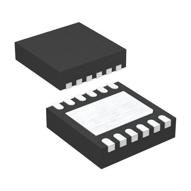

LTC6957-1/LTC6957-2/ LTC6957-3/LTC6957-4 Low Phase Noise, Dual Output Buffer/Driver/ Logic Converter DESCRIPTION FEATURES Low Phase Noise Buffer/Driver nn Optimized Conversion of Sine Wave Signals to Logic Levels nn Three Logic Output Types Available nn LVPECL nn LVDS nn CMOS nn Additive Jitter 45fs RMS (LTC6957-1) nn Frequency Range Up to 300MHz nn 3.15V to 3.45V Supply Operation nn Low Skew 3ps Typical nn Fully Specified from –40°C to 125°C nn 12-Lead MSOP and 3mm × 3mm DFN Packages The LTC®6957-1/LTC6957-2/LTC6957-3/LTC6957-4 is a family of very low phase noise, dual output AC signal buffer/driver/logic level translators. The input signal can be a sine wave or any logic level (≤2VP-P). There are four members of the family that differ in their output logic signal type as follows: nn LTC6957-1: LVPECL Logic Outputs LTC6957-2: LVDS Logic Outputs LTC6957-3: CMOS Logic, In-Phase Outputs LTC6957-4: CMOS Logic, Complementary Outputs The LTC6957 will buffer and distribute any logic signal with minimal additive noise, however, the part really excels at translating sine wave signals to logic levels. The early amplifier stages have selectable lowpass filtering to minimize the noise while still amplifying the signal to increase its slew rate. This input stage filtering/noise limiting is especially helpful in delivering the lowest possible phase noise signal with slow slewing input signals such as a typical 10MHz sine wave system reference. APPLICATIONS System Reference Frequency Distribution High Speed ADC, DAC, DDS Clock Driver nn Military and Secure Radio nn Low Noise Timing Trigger nn Broadband Wireless Transceiver nn High Speed Data Acquisition nn Medical Imaging nn Test and Measurement nn nn All registered trademarks and trademarks are the property of their respective owners. Protected by U.S. Patents 7969189 and 8319551. TYPICAL APPLICATION 3.3V 0.1µF Additive Phase Noise at 100MHz –140 OCXO 100MHz +7dBm SINE WAVE V+ SD1 FILTB 10nF –145 OUT1 IN+ TO PLL CHIPS OR SYSTEM SAMPLING CLOCKS – IN 50Ω 10nF OUT2 GND SD2 6957 TA01a PHASE NOISE (dBc/Hz) FILTA SINGLE-ENDED SINE WAVE INPUT AT +7dBm (500mVRMS) FILTA = FILTB = GND LTC6957-2 (LVDS) –150 LTC6957-4 (CMOS) –155 –160 LTC6957-3 (CMOS) –165 100 LTC6957-1 (LVPECL) 1k 10k 100k OFFSET FREQUENCY (Hz) 1M 69571234 TA01b 6957fb For more information www.linear.com/LTC6957-1 1 LTC6957-1/LTC6957-2/ LTC6957-3/LTC6957-4 ABSOLUTE MAXIMUM RATINGS (Note 1) Supply Voltage (V+ or VDD) to GND...........................3.6V Input Current (IN+, IN–, FILTA, FILTB, SD1, SD2) (Note 2)........................................................... ±10mA LTC6957-1 Output Current ......................... 1mA, –30mA LTC6957-2 Output Current .................................. ±10mA LTC6957-3, LTC6957-4 Output Current (Note 3)... ±30mA Specified Temperature Range LTC6957I..............................................–40°C to 85°C LTC6957H........................................... –40°C to 125°C Junction Temperature ........................................... 150°C Storage Temperature Range .................. –65°C to 150°C Lead Temperature (for MSOP Soldering, 10sec).... 300°C PIN CONFIGURATION LTC6957-1, LTC6957-2 LTC6957-3, LTC6957-4 TOP VIEW TOP VIEW FILTA 1 12 SD1 FILTA 1 V+ 2 11 OUT1+ V+ 2 IN+ 3 10 OUT1– IN+ 3 IN– 4 9 OUT2– IN– 4 OUT2+ GND 5 FILTB 6 13 GND GND 5 8 FILTB 6 7 SD2 13 GND 11 V DD 10 OUT1 9 OUT2 8 GNDOUT 7 SD2 DD PACKAGE 12-LEAD (3mm × 3mm) PLASTIC DFN DD PACKAGE 12-LEAD (3mm × 3mm) PLASTIC DFN TJMAX = 150°C, θJA = 58°C/W, θJC = 10°C/W EXPOSED PAD (PIN 13) IS GND, MUST BE SOLDERED TO PCB TJMAX = 150°C, θJA = 58°C/W, θJC = 10°C/W EXPOSED PAD (PIN 13) IS GND, MUST BE SOLDERED TO PCB LTC6957-1, LTC6957-2 LTC6957-3, LTC6957-4 TOP VIEW FILTA V+ IN+ IN– GND FILTB 2 12 SD1 1 2 3 4 5 6 TOP VIEW 12 11 10 9 8 7 SD1 OUT1+ OUT1– OUT2– OUT2+ SD2 FILTA V+ IN+ IN– GND FILTB 1 2 3 4 5 6 12 11 10 9 8 7 MS PACKAGE 12-LEAD PLASTIC MSOP MS PACKAGE 12-LEAD PLASTIC MSOP TJMAX = 150°C, θJA = 145°C/W TJMAX = 150°C, θJA = 145°C/W SD1 V DD OUT1 OUT2 GNDOUT SD2 6957fb For more information www.linear.com/LTC6957-1 LTC6957-1/LTC6957-2/ LTC6957-3/LTC6957-4 ORDER INFORMATION http://www.linear.com/product/LTC6957-1#orderinfo LEAD FREE FINISH TAPE AND REEL PART MARKING* PACKAGE DESCRIPTION SPECIFIED TEMPERATURE RANGE LTC6957IDD-1#PBF LTC6957IDD-1#TRPBF LFQJ 12-Lead (3mm × 3mm) Plastic DFN –40°C to 85°C LTC6957IDD-2#PBF LTC6957IDD-2#TRPBF LFQK 12-Lead (3mm × 3mm) Plastic DFN –40°C to 85°C LTC6957IDD-3#PBF LTC6957IDD-3#TRPBF LFQM 12-Lead (3mm × 3mm) Plastic DFN –40°C to 85°C LTC6957IDD-4#PBF LTC6957IDD-4#TRPBF LFQN 12-Lead (3mm × 3mm) Plastic DFN –40°C to 85°C LTC6957IMS-1#PBF LTC6957IMS-1#TRPBF 69571 12-Lead Plastic MSOP –40°C to 85°C LTC6957HMS-1#PBF LTC6957HMS-1#TRPBF 69571 12-Lead Plastic MSOP –40°C to 125°C LTC6957IMS-2#PBF LTC6957IMS-2#TRPBF 69572 12-Lead Plastic MSOP –40°C to 85°C LTC6957HMS-2#PBF LTC6957HMS-2#TRPBF 69572 12-Lead Plastic MSOP –40°C to 125°C LTC6957IMS-3#PBF LTC6957IMS-3#TRPBF 69573 12-Lead Plastic MSOP –40°C to 85°C LTC6957HMS-3#PBF LTC6957HMS-3#TRPBF 69573 12-Lead Plastic MSOP –40°C to 125°C LTC6957IMS-4#PBF LTC6957IMS-4#TRPBF 69574 12-Lead Plastic MSOP –40°C to 85°C LTC6957HMS-4#PBF LTC6957HMS-4#TRPBF 69574 12-Lead Plastic MSOP –40°C to 125°C Consult LTC Marketing for parts specified with wider operating temperature ranges. *The temperature grade is identified by a label on the shipping container. For more information on lead free part marking, go to: http://www.linear.com/leadfree/ For more information on tape and reel specifications, go to: http://www.linear.com/tapeandreel/. Some packages are available in 500 unit reels through designated sales channels with #TRMPBF suffix. 6957fb For more information www.linear.com/LTC6957-1 3 LTC6957-1/LTC6957-2/ LTC6957-3/LTC6957-4 ELECTRICAL CHARACTERISTICS LTC6957-1 The l denotes the specifications which apply over the full operating temperature range, otherwise specifications are at TA = 25°C. V+ = 3.3V, SD1 = SD2 = 0.4V, FILTA = FILTB = 0.4V, RLOAD = 50Ω connected to 1.3V, unless otherwise specified. All voltages are with respect to ground. SYMBOL PARAMETER CONDITIONS MIN TYP MAX UNITS 300 MHz 0.8 2 VP-P 0.8 2 VP-P Inputs (IN–, IN+) fIN Input Frequency Range l VINSE Input Signal Level Range, Single-Ended l 0.2 VINDIFF Input Signal Level Range, Differential l 0.2 tMIN Minimum Input Pulse Width VINCM Self-Bias Voltage, IN+, IN– l 1.8 2.06 2.3 V RIN Input Resistance, Differential l 1.5 2 2.5 kΩ CIN Input Capacitance, Differential BWIN Input Section Small Signal Bandwidth (–3dB) High or Low 0.5 ns 0.5 FILTB = L, FILTA = L FILTB = L, FILTA = H FILTB = H, FILTA = L FILTB = H, FILTA = H pF 1200 500 160 50 MHz MHz MHz MHz Outputs (LVPECL) VOH Output High Voltage LTC6957I LTC6957H l l V+ – 1.22 V+ – 0.98 V+ – 0.93 V+ – 1.22 V+ – 0.98 V+ – 0.87 V V VOL Output Low Voltage LTC6957I LTC6957H l l V+ – 2.1 V+ – 2.1 V+ – 1.8 V+ – 1.8 V+ – 1.67 V+ – 1.62 V V VOD Output Differential Voltage l ±660 ±810 ±965 tr Output Rise Time 180 ps tf Output Fall Time 160 ps t PD Propagation Delay FILTB = L, FILTA = L FILTB = L, FILTA = H FILTB = H, FILTA = L FILTB = H, FILTA = H l l l l ∆tPD /∆T Propagation Delay Variation Over Temperature FILTB = L, FILTA = L FILTB = L, FILTA = H FILTB = H, FILTA = L FILTB = H, FILTA = H l l l l 0.1 0.1 0.11 0.15 ∆tPD/∆V Propagation Delay Variation vs Supply Voltage FILTB = L, FILTA = L l 4 50 ps/V tSKEW Output Skew, Differential, CH1 to CH2 l 3 30 ps tMATCH Output Matching (OUTx + to OUTx–) See Timing Diagram l 2.5 30 ps V+ V+ Operating Supply Voltage Range RLOAD = 50Ω to (V+– 2V) l 3.3 3.45 V IS Supply Current Both Outputs Enabled (SD1 = SD2 = L) One Output Enabled (SD1 = L, SD2 = H or SD1 = H, SD2 = L) Both Outputs Disabled (SD1 = SD2 = H) Including Output Loads No Output Loads No Output Loads No Output Loads RLOAD = 50Ω to (V+– 2V), ×4 l l l l 18 15 0.7 58 22 19 1.2 72 mA mA mA mA 0.35 0.5 0.6 1.1 3.2 0.7 0.8 1.3 4 mV ns ns ns ns ps/°C ps/°C ps/°C ps/°C Power 3.15 tENABLE Output Enable Time, Other SDx = L 40 µs tWAKEUP Output Enable Time, Other SDx = H 120 µs tDISABLE Output Disable Time, Other SDx = L 20 µs tSLEEP Output Disable Time, Other SDx = H 20 µs 4 6957fb For more information www.linear.com/LTC6957-1 LTC6957-1/LTC6957-2/ LTC6957-3/LTC6957-4 ELECTRICAL CHARACTERISTICS LTC6957-1 The l denotes the specifications which apply over the full operating temperature range, otherwise specifications are at TA = 25°C. V+ = 3.3V, SD1 = SD2 = 0.4V, FILTA = FILTB = 0.4V, RLOAD = 50Ω connected to 1.3V, unless otherwise specified. All voltages are with respect to ground. SYMBOL PARAMETER CONDITIONS MIN TYP MAX UNITS Digital Logic Inputs VIH High Level SD or FILT Input Voltage l VIL Low Level SD or FILT Input Voltage l IIN_DIG Input Current SD or FILT Pins l V+ – 0.4 V 0.1 0.4 V ±10 µA Additive Phase Noise and Jitter fIN = 300MHz Sine Wave, 7dBm (FILTA = L, FILTB = L) at 10Hz Offset at 100Hz Offset at 1kHz Offset at 10kHz Offset at 100kHz Offset >1MHz Offset Jitter (10Hz to 150MHz) Jitter (12kHz to 20MHz) –130 –140 –150 –157 –157.5 –157.5 123 45 dBc/Hz dBc/Hz dBc/Hz dBc/Hz dBc/Hz dBc/Hz fsRMS fsRMS fIN = 122.88MHz Sine Wave, 0dBm (FILTA = H, FILTB = L) at 10Hz Offset at 100Hz Offset at 1kHz Offset at 10kHz Offset at 100kHz Offset >1MHz Offset Jitter (10Hz to 61.44MHz) Jitter (12kHz to 20MHz) –137 –146 –154.6 –157 –157.2 –157.2 200 114 dBc/Hz dBc/Hz dBc/Hz dBc/Hz dBc/Hz dBc/Hz fsRMS fsRMS fIN = 100MHz Sine Wave, 10dBm (FILTA = L, FILTB = L) at 10Hz Offset at 100Hz Offset at 1kHz Offset at 10kHz Offset at 100kHz Offset >1MHz Offset Jitter (10Hz to 50MHz) Jitter (12kHz to 20MHz) –138 –148.1 –156.8 –160.6 –161 –161 142 90 dBc/Hz dBc/Hz dBc/Hz dBc/Hz dBc/Hz dBc/Hz fsRMS fsRMS 6957fb For more information www.linear.com/LTC6957-1 5 LTC6957-1/LTC6957-2/ LTC6957-3/LTC6957-4 ELECTRICAL CHARACTERISTICS LTC6957-2 The l denotes the specifications which apply over the full operating temperature range, otherwise specifications are at TA = 25°C. V+ = 3.3V, SD1 = SD2 = 0.4V, FILTA = FILTB = 0.4V, RLOAD = 110Ω differential, unless otherwise specified. All voltages are with respect to ground. SYMBOL PARAMETER CONDITIONS MIN TYP MAX UNITS 300 MHz Inputs (IN–, IN+) fIN Input Frequency Range l VINSE Input Signal Level Range, Single-Ended l 0.2 0.8 2 VP-P VINDIFF Input Signal Level Range, Differential l 0.2 0.8 2 VP-P tMIN Minimum Input Pulse Width VINCM Self-Bias Voltage, IN+, IN– l 1.8 2 2.3 V RIN Input Resistance, Differential l 1.5 2 2.5 kΩ CIN Input Capacitance, Differential BWIN Input Section Small Signal Bandwidth High or Low 0.5 ns 0.5 FILTB = L, FILTA = L FILTB = L, FILTA = H FILTB = H, FILTA = L FILTB = H, FILTA = H pF 1200 500 160 50 MHz MHz MHz MHz Outputs (LVDS) VOD Output Differential Voltage l ∆VOD Delta VOD l VOS Output Offset Voltage l ∆VOS Delta VOS l ISC Short-Circuit Current l tr Output Rise Time 170 ps tf Output Fall Time 170 ps t PD Propagation Delay FILTB = L, FILTA = L FILTB = L, FILTA = H FILTB = H, FILTA = L FILTB = H, FILTA = H l l l l ∆tPD /∆T Propagation Delay Variation Over Temperature FILTB = L, FILTA = L FILTB = L, FILTA = H FILTB = H, FILTA = L FILTB = H, FILTA = H l l l l 0.5 0.6 0.7 1.8 ∆tPD /∆V Propagation Delay Variation vs Supply Voltage FILTB = L, FILTA = L l 5 60 ps/V Output Skew, Differential, CH1 to CH2 l 3 50 ps V+ V+ Operating Supply Voltage Range l 3.3 3.45 V IS Supply Current Both Outputs Enabled (SD1 = SD2 = L) One Output Enabled (SD1 = L, SD2 = H or SD1 = H, SD2 = L) Both Outputs Disabled (SD1 = SD2 = H) l l l 38 26 0.7 45 30 1.2 mA mA mA tSKEW 250 1.125 0.65 360 450 mV 0.2 50 mV 1.25 1.375 1.5 50 mV 3.9 6 mA 0.84 0.9 1.35 3.5 1.15 1.3 1.8 4.4 V ns ns ns ns ps/°C ps/°C ps/°C ps/°C Power 3.15 tENABLE Output Enable Time, Other SDx = L 300 ns tWAKEUP Output Enable Time, Other SDx = H 400 ns tDISABLE Output Disable Time, Other SDx = L 40 ns tSLEEP Output Disable Time, Other SDx = H 50 ns 6 6957fb For more information www.linear.com/LTC6957-1 LTC6957-1/LTC6957-2/ LTC6957-3/LTC6957-4 ELECTRICAL CHARACTERISTICS LTC6957-2 The l denotes the specifications which apply over the full operating temperature range, otherwise specifications are at TA = 25°C. V+ = 3.3V, SD1 = SD2 = 0.4V, FILTA = FILTB = 0.4V, RLOAD = 110Ω differential, unless otherwise specified. All voltages are with respect to ground. SYMBOL PARAMETER CONDITIONS MIN TYP MAX UNITS Digital Logic Inputs VIH High Level SD or FILT Input Voltage l VIL Low Level SD or FILT Input Voltage l IIN_DIG Input Current SD or FILT Pins l V+ – 0.4 V 0.1 0.4 V ±10 µA Additive Phase Noise and Jitter fIN = 300MHz Sine Wave, 7dBm (FILTA = L, FILTB = L) 10Hz Offset 100Hz Offset 1kHz Offset 10kHz Offset 100kHz Offset >1MHz Offset Jitter (10Hz to 150MHz) Jitter (12kHz to 20MHz) –124 –134 –143.5 –151.3 –154 –154 183 67 dBc/Hz dBc/Hz dBc/Hz dBc/Hz dBc/Hz dBc/Hz fsRMS fsRMS fIN = 122.88MHz Sine Wave, 0dBm (FILTA = H, FILTB = L) 10Hz Offset 100Hz Offset 1kHz Offset 10kHz Offset 100kHz Offset >1MHz Offset Jitter (10Hz to 61.44MHz) Jitter (12kHz to 20MHz) –132.5 –142.5 –150.7 –156 –157 –157 203 116 dBc/Hz dBc/Hz dBc/Hz dBc/Hz dBc/Hz dBc/Hz fsRMS fsRMS fIN = 100MHz Sine Wave, 10dBm (FILTA = L, FILTB = L) 10Hz Offset 100Hz Offset 1kHz Offset 10kHz Offset 100kHz Offset >1MHz Offset Jitter (10Hz to 50MHz) Jitter (12kHz to 20MHz) –132 –142 –151 –157.5 –159.5 –159.5 169 107 dBc/Hz dBc/Hz dBc/Hz dBc/Hz dBc/Hz dBc/Hz fsRMS fsRMS 6957fb For more information www.linear.com/LTC6957-1 7 LTC6957-1/LTC6957-2/ LTC6957-3/LTC6957-4 ELECTRICAL CHARACTERISTICS LTC6957-3/LTC6957-4 The l denotes the specifications which apply over the full operating temperature range, otherwise specifications are at TA = 25°C. V+ = VDD = 3.3V, SD1 = SD2 = 0.4V, FILTA = FILTB = 0.4V, RLOAD = 480Ω to VDD /2, unless otherwise specified. All voltages are with respect to ground. SYMBOL PARAMETER CONDITIONS Inputs (IN–, IN+) Input Frequency Range fIN Input Signal Level Range, Single-Ended VINSE VINDIFF Input Signal Level Range, Differential tMIN Minimum Input Pulse Width Self-Bias Voltage, IN+, IN– VINCM Input Resistance, Differential RIN Input Capacitance, Differential CIN Input Section Small Signal Bandwidth BWIN l l 0.2 0.2 0.8 0.8 0.6 2 2 0.5 1200 500 160 50 High or Low l 1.8 1.5 l l VDD – 0.1 VDD – 0.2 l FILTB = L, FILTA = L FILTB = L, FILTA = H FILTB = H, FILTA = L FILTB = H, FILTA = H No Load –3mA Load No Load 3mA Load VOL Output Low Voltage tr tf tPD Output Rise Time Output Fall Time Propagation Delay ∆tPD/∆T Propagation Delay Variation Over Temperature ∆tPD/∆V Propagation Delay Variation vs Supply Voltage tSKEW Output Skew, CH1 to CH2 LTC6957-3 LTC6957-4 IDD V+ Operating Supply Voltage Range VDD Operating Supply Voltage Range Supply Current, Pin 2 Both Outputs Enabled (SD1 = SD2 = L) One Output Enabled (SD1 = L, SD2 = H or SD1 = H, SD2 = L) Both Outputs Disabled (SD1 = SD2 = H) Supply Current, Pin 11, No Load tENABLE tWAKEUP tDISABLE tSLEEP Output Enable Time, Other SDx = L Output Enable Time, Other SDx = H Output Disable Time, Other SDx = L Output Disable Time, Other SDx = H 8 TYP l Outputs (CMOS) Output High Voltage VOH Power V+ VDD IS MIN FILTB = L, FILTA = L FILTB = L, FILTA = H FILTB = H, FILTA = L FILTB = H, FILTA = H FILTB = L, FILTA = L FILTB = L, FILTA = H FILTB = H, FILTA = L FILTB = H, FILTA = H FILTB = FILTA = L, V+ = VDD 300 2 2 MHz VP-P VP-P ns V kΩ pF MHz MHz MHz MHz 2.3 2.5 l 320 300 0.95 1 1.5 3.6 1.7 1.7 2 3 100 200 l l 5 120 35 250 ps ps 3.3 3.3 3.45 3.45 V V 24 24 0.7 0.001 0.056 200 300 20 20 27.5 27.5 1.2 0.01 0.07 mA mA mA mA mA/MHz ns ns ns ns 0.1 0.2 l l l l l l 0.8 l l l l l l l l Static Dynamic, per Output UNITS V V V V ps ps ns ns ns ns ps/°C ps/°C ps/°C ps/°C ps/V l VDD Must Be ≤V + MAX l l 3.15 2.4 1.6 1.8 2.4 4.8 6957fb For more information www.linear.com/LTC6957-1 LTC6957-1/LTC6957-2/ LTC6957-3/LTC6957-4 ELECTRICAL CHARACTERISTICS LTC6957-3/LTC6957-4 The l denotes the specifications which apply over the full operating temperature range, otherwise specifications are at TA = 25°C. V+ = VDD = 3.3V, SD1 = SD2 = 0.4V, FILTA = FILTB = 0.4V, RLOAD = 480Ω to VDD /2, unless otherwise specified. All voltages are with respect to ground. SYMBOL PARAMETER CONDITIONS Digital Logic Inputs VIH High Level SD or Filt Input Voltage Low Level SD or Filt Input Voltage VIL Input Current SD or Filt Pins IIN_DIG MIN l TYP MAX UNITS 0.1 0.4 ±10 V V µA V+ – 0.4 l l Additive Phase Noise and Jitter fIN = 300MHz Sine Wave, 7dBm (FILTA = L, FILTB = L) 10Hz Offset 100Hz Offset 1kHz Offset 10kHz Offset 100kHz Offset >1MHz Offset Jitter (10Hz to 150MHz) Jitter (12kHz to 20MHz) fIN = 122.88MHz Sine Wave, 0dBm (FILTA = H, FILTB = L) 10Hz Offset 100Hz Offset 1kHz Offset 10kHz Offset 100kHz Offset >1MHz Offset Jitter (10Hz to 61.44MHz) Jitter (12kHz to 20MHz) fIN = 100MHz Sine Wave, 10dBm (FILTA = L, FILTB = L) 10Hz Offset 100Hz Offset 1kHz Offset 10kHz Offset 100kHz Offset >1MHz Offset Jitter (10Hz to 50MHz) Jitter (12kHz to 20MHz) Note 1: Stresses beyond those listed under Absolute Maximum Ratings may cause permanent damage to the device. Exposure to any Absolute Maximum Rating condition for extended periods may affect device reliability and lifetime. Note 2: Input pins IN+, IN–, FILTA, FILTB, SD1 and SD2 are protected by steering diodes to either supply. If the inputs go beyond either supply rail, the input current should be limited to less than 10mA. If pushing current into FILTB, the Pin 6 voltage must be limited to 4V. On the logic pins (FILTA, FILTB, SD1 and SD2) the Absolute Maximum input current applies –123 –133 –143 –152 –156 –156 146 53 dBc/Hz dBc/Hz dBc/Hz dBc/Hz dBc/Hz dBc/Hz fsRMS fsRMS –132 –142 –150.6 –156.5 –157.4 –157.4 192 109 dBc/Hz dBc/Hz dBc/Hz dBc/Hz dBc/Hz dBc/Hz fsRMS fsRMS –135 –145 –153 –159.8 –161 –161 142 90 dBc/Hz dBc/Hz dBc/Hz dBc/Hz dBc/Hz dBc/Hz fsRMS fsRMS only at the maximum operating supply voltage of 3.45V; 10mA of input current with the absolute maximum supply voltage of 3.6V may create permanent damage from voltage stress. Note 3: With 3.6V Absolute Maximum supply voltage, the LTC6957-3/ LTC6957-4 CMOS outputs can sink 30mA while low, and source 30mA while high without damage. However, if overdriven or subject to an inductive load kick outside the supply rails, 30mA can create damaging voltage stress and is not guaranteed unless VDD is limited to 3.15V. 6957fb For more information www.linear.com/LTC6957-1 9 LTC6957-1/LTC6957-2/ LTC6957-3/LTC6957-4 TYPICAL PERFORMANCE CHARACTERISTICS Input Self Bias Voltage vs Temperature Supply Current vs Supply Voltage 20 V+ = 3.45V 16 2.10 SUPPLY CURRENT (mA) INPUT VOLTAGE (V) NO OUTPUT LOADS 18 2.15 V+ = 3.3V 2.05 2.00 V+ = 3.15V 18.4 12 TA = –55°C TA = 25°C 10 8 6 5 25 45 65 85 105 125 TEMPERATURE (°C) 17.2 16.8 0.6 0.9 1.2 1.5 1.8 2.1 2.4 2.7 3.0 3.3 3.6 SUPPLY VOLTAGE (V) 2.45 Supply Current vs Temperature 58 V+ = 3.3V 50Ω LOADS TO 1.3V 1.55 VOL SUPPLY CURRENT (mA) OUTPUT VOLTAGE (V) 1.60 V+ = 3.45V 56 VOH 2.30 5 25 45 65 85 105 125 TEMPERATURE (°C) 69571234 G03 Output Voltage vs Temperature 2.50 1.50 17.4 16.6 –55 –35 –15 2.4 VOH V+ = 3.15V 17.8 2 Output Voltage vs Load Current 1.45 18.0 69571234 G02 2.55 2.35 V+ = 3.3V 0 69571234 G01 2.40 V+ = 3.45V 18.2 17.0 4 1.90 –55 –35 –15 NO OUTPUT LOADS 18.8 TA = 125°C 14 1.95 OUTPUT VOLTAGE (V) Supply Current vs Temperature 18.6 SUPPLY CURRENT (mA) 2.20 LTC6957-1 2.2 1.6 VOL 54 V+ = 3.3V 52 V+ = 3.15V 50 48 50Ω “Y” LOAD TO GROUND ON BOTH CHANNELS 1.40 –8 –2 –6 –4 LOAD CURRENT (mA) 1.4 –55 –35 –15 0 5 25 45 65 85 105 125 TEMPERATURE (°C) Enable and Wakeup WAKE-UP: OUTPUTS WITH OTHER CHANNEL OFF 80 NUMBER OF UNITS 2.5V 2.0V 1.5V ENABLE: OUTPUTS WITH OTHER CHANNEL ON 3.0V 0V SD Differential Output vs Frequency 60 1.8 OUT1+ TO OUT2+ RISING EDGE TYPICAL OF ALL OUTPUT EDGES/PAIRS 1.6 2 LOTS, 400 UNITS EACH, 3 TEMPERATURES = 125°C = 25°C = –55°C 40 20 69571234 G07 20ns/DIV MULTIPLE EXPOSURES, PERSISTENCE MODE CLOCK I/O = 120MHz SD DRIVE ~ 140kHz, ASYNCHRONOUS 1.4 1.2 125°C 1.0 0.8 25°C 0.6 0.4 –55°C 0.2 0 –10 –8 –6 –4 –2 0 2 tSKEW (ps) 4 6 8 10 69571234 G08 PRODUCTION DATA, 1ps RESOLUTION, ~1-2ps UNCERTAINTY 10 69571234 G06 Typical Distribution of Skew 100 2.5V 1.5V 5 25 45 65 85 105 125 TEMPERATURE (°C) 69571234 G05 69571234 G04 2.0V 46 –55 –35 –15 DIFFERENTIAL OUTPUT (VP-P) 1.35 –10 0 0dBm INPUT 0 250 500 750 1000 1250 1500 1750 2000 FREQUENCY (MHz) 69571234 G09 6957fb For more information www.linear.com/LTC6957-1 LTC6957-1/LTC6957-2/ LTC6957-3/LTC6957-4 TYPICAL PERFORMANCE CHARACTERISTICS Additive Phase Noise vs Input Frequency 300MHz 153.6MHz –155 –160 –140 –10dBm, FILTA = L, FILTB = H –145 0dBm, FILTA = H, FILTB = L –150 –155 –165 100 1M 1k 10k 100k OFFSET FREQUENCY (Hz) 69571234 G10 PHASE NOISE (dBc/Hz) –150 3.45V 3.3V –160 –145 0dBm, FILTA = H, FILTB = L –150 –155 7dBm, FILTA = FILTB = L –165 1k 10k 100k 100 OFFSET FREQUENCY (Hz) 1M 0.550 3.5 FILTA = FILTB = H 69571234 G16 tPD (ns) tPD (ns) 125°C 0.56 V+ = 3.0V, 50Ω LOADS TO 1.3V 0.54 V+ = 3.3V, 50Ω LOADS TO 1.3V 0.450 –55 –35 –15 50Ω LOADS TO V+ –2V 0.52 0.50 50Ω LOADS TO FIXED 1.3V 0.475 5 25 45 65 85 105 125 TEMPERATURE (°C) 25°C –3 tPD vs Supply Voltage and Termination Voltage 0.500 FILTA = H, FILTB = L 0 –55 –35 –15 –1 –2 tPD vs Temperature 0.525 FILTA = FILTB = L –55°C 0 69571234 G15 V+ = 3.6V, 50Ω LOADS TO 1.9V 3.0 0.5 2 1 69571234 G14 tPD vs Temperature 1.0 3 –4 EACH CURVE NORMALIZED TO 0° AT 0dBm –5 –10 –8 –6 –4 –2 0 2 4 6 8 10 INPUT AMPLITUDE (dBm) 1M 69571234 G13 FILTA = L, FILTB = H fIN = 300MHz V+ = 3.3V 4 –140 1M AM to PM Conversion 5 –160 3.15V 1k 10k 100k OFFSET FREQUENCY (Hz) 1k 10k 100k OFFSET FREQUENCY (Hz) 69571234 G12 tPD (ns) PHASE NOISE (dBc/Hz) 1M SINGLE-ENDED SINE WAVE INPUT –145 125°C –55°C –165 100 –135 –140 25°C –155 –130 SINGLE-ENDED SINE WAVE INPUT, 100MHz at 7dBm (500mVRMS) FILTA = FILTB = L –165 100 –150 Additive Phase Noise at 122.88MHz –130 –155 –145 69571234 G11 Additive Phase Noise vs Supply Voltage –135 –140 –160 +10dBm, FILTA = FILTB = L 1k 10k 100k OFFSET FREQUENCY (Hz) SINGLE-ENDED SINE WAVE INPUT, 100MHz at 7dBm (500mVRMS) FILTA = FILTB = L –135 –160 100MHz –165 100 –130 SINGLE-ENDED 100MHz SINE WAVE INPUT SEE APPLICATIONS INFORMATION PHASE NOISE (dBc/Hz) –145 –150 –135 PHASE NOISE (dBc/Hz) –140 Additive Phase Noise vs Temperature –130 SINGLE-ENDED SINE WAVE INPUT AT 7dBm (500mVRMS) FILTA = FILTB = L –135 PHASE NOISE (dBc/Hz) Additive Phase Noise vs Amplitude NORMALIZED PHASE (DEG) –130 LTC6957-1 0.48 FILTA = FILTB = L 5 25 45 65 85 105 125 TEMPERATURE (°C) 69571234 G17 0.46 FILTA = FILTB = L 3 3.1 3.2 3.3 3.4 SUPPLY VOLTAGE (V) 3.5 3.6 69571234 G18 6957fb For more information www.linear.com/LTC6957-1 11 LTC6957-1/LTC6957-2/ LTC6957-3/LTC6957-4 TYPICAL PERFORMANCE CHARACTERISTICS Input Self Bias Voltage vs Temperature Supply Current vs Supply Voltage V+ = 3.45V 40 V+ = 3.3V 2.05 2.00 V+ = 3.15V 40.5 35 SUPPLY CURRENT (mA) 30 TA = 125°C 25 20 TA = 25°C 15 TA = –55°C 10 1.95 0 5 25 45 65 85 105 125 TEMPERATURE (°C) DC DATA, IN+ > (IN– + 50mV) VOH, VOL AND VOS (V) 1.0 0 50 410 1.2 VOD (CALCULATED) 400 250 1.0 –55 –35 –15 1.0V 1.5V 3.0V 0V SD ENABLE: OUTPUTS WITH OTHER CHANNEL ON 69571234 G25 20ns/DIV MULTIPLE EXPOSURES, PERSISTENCE MODE CLOCK I/O = 120MHz SD DRIVE ~ 140kHz, ASYNCHRONOUS 380 5 25 45 65 85 105 125 TEMPERATURE (°C) 1 LOAD STRESS PER TIA/EIA-644-A FIGURE 4 0.6 1.2 1.8 VTEST LOAD VOLTAGE (V) 0 69571234 G23 3.95 2.4 69571234 G24 Differential Output vs Frequency 900 V+ = 3.3V 3.90 V+ = 3.15V 3.85 3.80 3.75 –55 –35 –15 –55°C 800 V+ = 3.45V ANY ONE (1) OUTPUT SHORTED TO GROUND 5 25 45 65 85 105 125 TEMPERATURE (°C) 69571234 G26 12 OUT– 1.1 4.00 2.0V 1.0V 1.2 Output Short-Circuit Current vs Temperature WAKE-UP: OUTPUTS WITH OTHER CHANNEL OFF 125°C 25°C –55°C OUT+ 1.3 390 69571234 G22 SHORT-CIRCUIT CURRENT (mA) 1.5V 1.4 VOS (CALCULATED) Enable and Wakeup 2.0V 420 VOL (MEASURED) 150 100 200 LOAD RESISTOR (Ω) USE OF RLOAD > 150Ω NOT RECOMMENDED fIN MAY BE COMPROMISED 1.5 1.3 1.1 V+ = 3.6V V+ = 3.3V V+ = 3V Output Voltages vs Loading 430 DIFFERENTIAL OUTPUT (mVP-P) OUTPUT VOLTAGE (V) OUT – 5 25 45 65 85 105 125 TEMPERATURE (°C) 69571234 G21 VOD (mV) 1.2 0.8 VOH (MEASURED) 1.4 1.4 V+ = 3.15V 38.5 Output Voltages vs Temperature 1.5 OUT + 39.0 69571234 G20 Output Voltages vs Load Resistor 1.6 39.5 37.5 –55 –35 –15 0.6 0.9 1.2 1.5 1.8 2.1 2.4 2.7 3 3.3 3.6 SUPPLY VOLTAGE (V) 69571234 G19 1.8 V+ = 3.3V 38.0 5 1.90 –55 –35 –15 V+ = 3.45V 40.0 OUTPUT VOLTAGE (V) INPUT VOLTAGE (V) 2.15 2.10 Supply Current vs Temperature 41.0 45 SUPPLY CURRENT (mA) 2.20 LTC6957-2 700 25°C 600 500 125°C 400 300 200 10dBm INPUT FILTA = FILTB = L RLOAD = 100Ω 100 0 0 200 400 600 800 FREQUENCY (MHz) 1000 1200 69571234 G27 6957fb For more information www.linear.com/LTC6957-1 LTC6957-1/LTC6957-2/ LTC6957-3/LTC6957-4 TYPICAL PERFORMANCE CHARACTERISTICS –140 –145 153.6MHz –150 300MHz –155 –160 –135 PHASE NOISE (dBc/Hz) –135 PHASE NOISE (dBc/Hz) –130 SINGLE-ENDED SINE WAVE INPUT AT 7dBm (500mVRMS) FILTA = FILTB = L –165 100 –10dBm, FILTA = L, FILTB = H –145 0dBm, FILTA = H, FILTB = L –150 1k 10k 100k OFFSET FREQUENCY (Hz) –155 PHASE NOISE (dBc/Hz) PHASE NOISE (dBc/Hz) 3.45V –150 3.3V –155 3.15V 1k 10k 100k OFFSET FREQUENCY (Hz) 1M 1k 10k 100k OFFSET FREQUENCY (Hz) AM to PM Conversion 5 –145 –150 0dBm, FILTA = H, FILTB = L –155 3 2 1 –55°C 0 –1 25°C –2 –3 125°C –4 7dBm, FILTA = FILTB = L 1k 10k 100k OFFSET FREQUENCY (Hz) 69571234 G31 fIN = 300MHz V+ = 3.3V 4 –140 EACH CURVE NORMALIZED TO 0° AT 0dBm –5 –10 –8 –6 –4 –2 0 2 4 6 INPUT AMPLITUDE (dBm) 1M 69571234 G32 tPD vs Temperature 0.96 0.950 FILTA = FILTB = H V+ = 3.0V 10 tPD vs Supply Voltage 125°C 0.94 0.925 3.0 8 69571234 G33 tPD vs Temperature 4.0 1M 69571234 G30 SINGLE-ENDED SINE WAVE INPUT –165 100 1M 125°C –55°C –165 100 –160 –160 1k 10k 100k OFFSET FREQUENCY (Hz) 25°C –155 –135 –140 –165 100 –150 Additive Phase Noise at 122.88MHz –130 SINGLE-ENDED SINE WAVE INPUT, 100MHz AT 7dBm (500mVRMS) FILTA = FILTB = L –145 –145 69571234 G29 Additive Phase Noise vs Supply Voltage –135 –140 10dBm, FILTA = FILTB = L 69571234 G28 –130 SINGLE-ENDED SINE WAVE INPUT, 100MHz AT 7dBm (500mVRMS) FILTA = FILTB = L –160 –165 100 1M Additive Phase Noise vs Temperature –135 –140 –160 100MHz –130 SINGLE-ENDED 100MHz SINE WAVE INPUT SEE APPLICATIONS INFORMATION NORMALIZED PHASE (DEG) –130 Additive Phase Noise vs Amplitude PHASE NOISE (dBc/Hz) Additive Phase Noise vs Input Frequency LTC6957-2 FILTA = FILTB = L 100Ω LOAD 1.0 FILTA = L, FILTB = H V+ = 3.6V tPD (ns) 1.5 tPD (ns) tPD (ns) 0.92 0.900 V+ = 3.3V 0.875 0.88 FILTA = H, FILTB = L 0.850 FILTA = FILTB = L 0.5 –55 –35 –15 100Ω LOAD 5 25 45 65 85 105 125 TEMPERATURE (°C) 69571234 G34 0.825 –55 –35 –15 25°C 0.90 FILTA = FILTB = L 100Ω LOAD 5 25 45 65 85 105 125 TEMPERATURE (°C) 69571234 G35 0.86 0.84 –55°C 3 3.1 3.4 3.2 3.3 SUPPLY VOLTAGE (V) 3.5 3.6 69571234 G36 6957fb For more information www.linear.com/LTC6957-1 13 LTC6957-1/LTC6957-2/ LTC6957-3/LTC6957-4 TYPICAL PERFORMANCE CHARACTERISTICS Input Self Bias Voltage vs Temperature Supply Current vs Supply Voltage V+ = 3.45V V+ SUPPLY CURRENT (mA) V+ = 3.3V 2.05 2.00 V+ = 3.15V 20 15 25°C 10 125°C 5 1.95 0 5 25 45 65 85 105 125 TEMPERATURE (°C) 0.6 0 2.4 1.2 1.8 V+ VOLTAGE (V) 3 69571234 G37 V+ = 3.15V 20.0 0.25 0 5 10 15 LOAD CURRENT (mA) 125°C VDD – 0.75 VDD = 3.3V 0.50 OUTPUT LOW, SINKING CURRENT 0.25 0 20 125°C –55°C 0 21 V DD SUPPLY CURRENT (mA) 125°C 0 0.6 25°C –55°C 2.4 1.2 1.8 VDD VOLTAGE (V) 3 3.6 69571234 G43 14 2.7V –155 3.0V 3.3V –165 100 20 1k 10k 100k OFFSET FREQUENCY (Hz) V+ = VDD = 3.3V 20 69571234 G42 3.0 100 10 DYNAMIC, ONE (1) OUTPUT ACTIVE AT 312.5MHz, 13pF LOAD, LEFT AXIS 19 OTHER OUTPUT DISABLED 1 18 0.1 17 –55 –35 –15 1M Output Voltage Swing vs Frequency STATIC, NO DC LOAD, RIGHT (LOGARITHMIC) AXIS VDD SUPPLY CURRENT (µA) 1 2.4V –150 Supply Current vs Temperature 5 2 –145 69571234 G41 Supply Current vs Supply Voltage 3 SINGLE-ENDED SINE WAVE INPUT, at 7dBm (500mVRMS) –135 100MHz V+ = 3.3V, VDD AS SHOWN FILTA = FILTB = L –140 –160 25°C 5 10 15 LOAD CURRENT (mA) 69571234 G40 4 25°C OUTPUT HIGH, SOURCING CURRENT VDD – 0.5 OUTPUT LOW, SINKING CURRENT 0 –55°C PHASE NOISE (dBc/Hz) 0.50 Additive Phase Noise vs Supply Voltage –130 VDD – 0.25 VDD = 3.6V VDD = 3.3V VDD = 3V VDD = 2.7V VDD = 2.4V VDD – 0.75 5 25 45 65 85 105 125 TEMPERATURE (°C) 69571234 G39 VDD OUTPUT HIGH, SOURCING CURRENT VDD – 0.5 19.5 –55 –35 –15 3.6 Output Voltages vs Load Current Output Voltages vs Load Current VDD – 0.25 OUTPUT VOLTAGE (V) V+ = 3.3V 69571234 G38 OUTPUT VOLTAGE (V) VDD VDD CURRENT (mA) 20.5 –55°C 1.90 –55 –35 –15 0 V+ = 3.45V 21.0 0.01 5 25 45 65 85 105 125 TEMPERATURE (°C) 69571234 G44 OUTPUT SWING (VP-P) INPUT VOLTAGE (V) 2.15 2.10 Supply Current vs Temperature 21.5 25 V + SUPPLY CURRENT (mA) 2.20 LTC6957-3/LTC6957-4 2.5 –55°C 25°C 125°C 2.0 1.5 1 10dBm INPUT FILTA = FILTB = L IN DC1766A RLOAD = 133Ω AC-COUPLED CAUTION: AT VERY HIGH FREQUENCIES, THE CMOS OUTPUTS MAY NOT TOGGLE AT ALL DEPENDING ON INPUT FREQUENCY, AMPLITUDE, SUPPLY VOLTAGE, OR TEMPERATURE 0 100 200 300 400 500 600 700 800 900 1000 FREQUENCY (MHz) 69571234 G45 6957fb For more information www.linear.com/LTC6957-1 LTC6957-1/LTC6957-2/ LTC6957-3/LTC6957-4 TYPICAL PERFORMANCE CHARACTERISTICS –140 300MHz –145 153.6MHz –150 –155 –135 PHASE NOISE (dBc/Hz) –135 PHASE NOISE (dBc/Hz) –130 SINGLE-ENDED SINE WAVE INPUT AT 7dBm (500mVRMS) FILTA = FILTB = L 100MHz –10dBm, FILTA = L, FILTB = H –145 0dBm, FILTA = H, FILTB = L –150 –155 –165 100 –165 100 SINGLE-ENDED SINE WAVE INPUT, 100MHz AT 7dBm (500mVRMS) V+ = VDD FILTA = FILTB = L 3.15V 3.45V –155 –160 10dBm, FILTA = FILTB = L 1k 10k 100k OFFSET FREQUENCY (Hz) 1k 10k 100k OFFSET FREQUENCY (Hz) 1M –150 0dBm, FILTA = H, FILTB = L –155 –165 100 1k 10k 100k OFFSET FREQUENCY (Hz) 3.0 1M RISING EDGE tPD (ns) tPD (ns) tPD (ns) 69571234 G52 –55°C –2 –3 0.75 –55 –35 –15 8 10 tPD vs Supply Voltage V+ = 3.45V 1.02 1.00 V+ = VDD 0.98 FALLING EDGE 0.96 0.80 FALLING EDGE 0 –1 1.04 0.90 5 25 45 65 85 105 125 TEMPERATURE (°C) 1 1.06 0.95 0.85 0.5 –55 –35 –15 2 69571234 G51 1.00 FILTA = H, FILTB = L 3 EACH CURVE NORMALIZED TO 0° AT 0dBm fIN = 300MHz V+= VDD = 3.3V 25°C –4 125°C –5 –10 –8 –6 –4 –2 0 2 4 6 INPUT AMPLITUDE (dBm) tPD vs Temperature 1.05 1M AM to PM Conversion 1.10 1.0 1k 10k 100k OFFSET FREQUENCY (Hz) 69571234 G50 1.15 FILTA = L, FILTB = H –55°C 69571234 G48 4 –145 tPD vs Temperature FILTA = FILTB = L 125°C 5 –140 FILTA = FILTB = H 1.5 –155 SINGLE-ENDED SINE WAVE INPUT 69571234 G49 4.0 1M 7dBm, FILTA = FILTB = L 3.3V 25°C –165 100 –160 –165 100 –150 –135 –145 –150 –145 Additive Phase Noise at 122.88MHz –130 PHASE NOISE (dBc/Hz) PHASE NOISE (dBc/Hz) –140 –140 69571234 G47 Additive Phase Noise vs Supply Voltage –135 SINGLE-ENDED SINE WAVE INPUT, 100MHz AT 7dBm (500mVRMS) FILTA = FILTB = L –160 69571234 G46 –130 –135 –140 –160 1M –130 SINGLE-ENDED 100MHz SINE WAVE INPUT SEE APPLICATIONS INFORMATION –160 1k 10k 100k OFFSET FREQUENCY (Hz) Additive Phase Noise vs Temperature NORMALIZED PHASE (DEG) –130 Additive Phase Noise vs Amplitude PHASE NOISE (dBc/Hz) Additive Phase Noise vs Input Frequency LTC6957-3/LTC6957-4 FILTA = FILTB = L 5 25 45 65 85 105 125 TEMPERATURE (°C) 69571234 G53 RISING EDGE 0.94 2.4 2.55 2.7 2.85 3 3.15 3.3 3.45 3.6 VDD SUPPLY VOLTAGE (V) 69571234 G54 6957fb For more information www.linear.com/LTC6957-1 15 LTC6957-1/LTC6957-2/ LTC6957-3/LTC6957-4 PIN FUNCTIONS FILTA, FILTB (Pin 1, Pin 6): Input Bandwidth Limiting Control. These CMOS logic inputs control the bandwidth of the early amplifier stages. For slow slewing signals substantially lower phase noise is achieved by using this feature. See the Applications Information section for more details. V+ (Pin 2): Supply Voltage (3.15V to 3.45V). This supply must be kept free from noise and ripple. It should be bypassed directly to GND (Pin 5) with a 0.1µF capacitor. IN+, IN– (Pin 3, Pin 4): Input Signal Pins. These inputs are differential, but can also interface with single-ended signals. The input can be a sine wave signal or a CML, LVPECL, TTL or CMOS logic signal. See the Applications Information section for more details. GND (Pin 5): Ground. Connect to a low inductance ground plane for best performance. The connection to the bypass capacitor for V+ (Pin 2) should be through a direct, low inductance path. SD1, SD2 (Pin 12, Pin 7): Output Enable Control. These CMOS logic inputs control the enabling and disabling of their respective OUT1 and OUT2 outputs. When both outputs are disabled, the LTC6957 is placed in a low power shutdown state. LTC6957-1 Only OUT1–, OUT1+ (Pin 10, Pin 11): LVPECL Outputs. Differential logic outputs typically terminated by 50Ω connected to a supply 2V below the V+ supply. Refer to the Applications Information section for more details. OUT2–, OUT2+ (Pin 9, Pin 8): LVPECL Outputs. Differential logic outputs typically terminated by 50Ω connected to a supply 2V below the V+ supply. Refer to the Applications Information section for more details. 16 LTC6957-2 Only OUT1–, OUT1+ (Pin 10, Pin 11): LVDS Outputs, Mostly TIA/EIA-644-A Compliant. Refer to the Applications Information section for more details. OUT2–, OUT2+ (Pin 9, Pin 8): LVDS Outputs, Mostly TIA/EIA-644-A Compliant. Refer to the Applications Information section for more details. LTC6957-3/LTC6957-4 Only OUT1, OUT2 (Pin 10, Pin 9): CMOS Outputs. Refer to the Applications Information section for more details. VDD (Pin 11): Output Supply Voltage (2.4V to 3.45V). For best performance connect this to the same supply as V+ (Pin 2). If the output needs to be a lower logic rail, this supply can be separately connected, but this voltage must be less than or equal to that on Pin 2 for proper operation. This supply must also be kept free from noise and ripple. It should be bypassed directly to the GNDOUT pin (Pin 8) with a 0.1µF capacitor. GNDOUT (Pin 8): Output Logic Ground. Tie to a low inductance ground plane for best performance. The connection to the bypass capacitor for VDD (Pin 11) should be through a direct, low inductance path. LTC6957-xDD Only Exposed Pad (Pin 13): Always tie the underlying DFN exposed pad to GND (Pin 5). To achieve the rated θJA of the DD package, there should be good thermal contact to the PCB. 6957fb For more information www.linear.com/LTC6957-1 LTC6957-1/LTC6957-2/ LTC6957-3/LTC6957-4 BLOCK DIAGRAMS 1 6 3 4 FILTA 2 12 V+ SD1 OUT1+ FILTB OUT1– IN+ 11 10 IN– OUT2– OUT2+ 5 GND 9 8 SD2 7 LTC6957-1 and LTC6957-2 1 6 3 4 FILTA 2 V+ 12 SD1 FILTB V DD OUT1 11 10 IN+ IN– OUT2 9 GNDOUT 8 5 GND 7 SD2 6957 BD LTC6957-3 and LTC6957-4 6957fb For more information www.linear.com/LTC6957-1 17 LTC6957-1/LTC6957-2/ LTC6957-3/LTC6957-4 TIMING DIAGRAM SD1 SD2 INPUT * OUT1+/OUT1 OUT1– * * OUT2+/OUT2 OUT2– * tDISABLE tSLEEP tWAKEUP tENABLE * SEE APPLICATIONS INFORMATION FOR LOGIC BEHAVIOR DURING SHUTDOWN SPECIFIC TO LVPECL/LVDS/CMOS OUTPUTS. LTC6957-1 SHOWN HERE FOR REFERENCE. EACH OUTPUT TYPE BEHAVES DIFFERENTLY DURING SHUTDOWN. DETAIL INPUT tPD 50% OUT1+/OUT1 OUT1– 50% tMATCH 90% OUT2+/OUT2 OUT2– 10% tRISE 90% 10% tFALL 18 tSKEW 6957 TD1 6957fb For more information www.linear.com/LTC6957-1 LTC6957-1/LTC6957-2/ LTC6957-3/LTC6957-4 APPLICATIONS INFORMATION General Considerations The LTC6957-1/LTC6957-2/LTC6957-3/LTC6957-4 are low noise, dual output clock buffers that are designed for demanding, low phase noise applications. Properly applied, they can preserve phase noise performance in situations where alternative solutions would degrade the phase noise significantly. They are also useful as logic converters. However, no buffer device is capable of removing or reducing phase noise present on an input signal. As with most low phase noise circuits, improper application of the LTC6957-1/LTC6957-2/LTC6957-3/LTC6957-4 can result in an increase in the phase noise through a variety of mechanisms. The information below will, hopefully, allow a designer to avoid such an outcome. The LTC6957 is designed to be used with high performance clock signals destined for driving the encode inputs of ADCs or mixer inputs. Such clocks should not be treated as digital signals. The beauty of digital logic is that there is noise margin both in the voltage and the timing, before any deleterious effects are noticed. In contrast, high performance clock signals have no margin for error in the timing before the system performance is degraded. Users are encouraged to keep this distinction in mind while designing the entire clocking signal chain before, during, and after the LTC6957. Input Interfacing The input stage is the same for all versions of the LTC6957 and is designed for low noise and ease of interfacing to sine-wave and small amplitude signals. Other logic types can interface directly, or with little effort since they present a smaller challenge for noise preservation. Figure 1 shows a simplified schematic of the LTC6957 input stage. The diodes are all for protection, both during ESD events and to protect the low noise NPN devices from being damaged by input overdrive. The resistors are to bias the input stage at an optimal DC level, but they are too large to leave floating without increasing the noise. Therefore, for low noise use, always connect both inputs to a low AC impedance. A capacitor to ground/return is imperative on the unused input in singleended applications. 2 1 6 3 4 V+ FILTA FILTERS FILTB + 1.8k 1.2k IN IN– 1.2k 2mA 3.2k 5 GND 6957 F01 Figure 1 6957fb For more information www.linear.com/LTC6957-1 19 LTC6957-1/LTC6957-2/ LTC6957-3/LTC6957-4 APPLICATIONS INFORMATION Figure 2a shows how to interface single-ended LVPECL logic to the LTC6957, while Figure 2b shows how to drive the LTC6957 with differential LVPECL signals. The capacitors shown are 10nF and can be inexpensive ceramics, preferably in small SMT cases. For use above 100MHz, lower value capacitors may be desired to avoid series resonance, which could increase the noise in Figure 2a even though the capacitor is just on the DC input. This comment applies to all capacitors hooked to the inputs throughout this data sheet. In Figure 2a, the RTERM implementation is up to the user and is to terminate the transmission line. If it is connected to a VTT that is passively generated and heavily bypassed to ground, the 10nF to ground shown on the inverting LTC6957 input is the appropriate connection to use. However, if the termination goes to an actively generated VTT voltage, lower noise may be achieved by connecting the capacitor on the inverting input to that VTT rather than ground. In Figure 2b, both inputs to the LTC6957 are driven, increasing the differential input signal size and minimizing noise from any common mode source such as VTT, both of which improve the achievable phase noise. A variety of termination techniques can be used, and as long as the two sides use the same termination, the configuration used won't matter much. In Figure 2b, the RTERMs are shown in a "Y" configuration that creates a passive VTT at the common point. Most 3.3V LVPECL devices have differential outputs and can be terminated with three 50Ω resistors as shown. Figure 3 shows a 50Ω RF signal source interface to the LTC6957. For a pure tone (sine wave) input, Figure 3 can handle up to 10dBm maximum. A broadband 50Ω match as shown should suffice for most applications, though for small amplitude input signals a narrow band reactive matching network may offer incremental improvements in performance. 3.3V 10nF 50Ω + LTC6957 50Ω – + SOURCE LTC6957 RTERM 10nF 6957 F03 – 10nF 6957 F02a Figure 3. Single-Ended 50Ω Input Source Figure 2a. Single-Ended LVPECL Input 3.3V + LTC6957 – 6957 F02b 3× RTERM Figure 2b. Differential LVPECL Input Figure 2 20 6957fb For more information www.linear.com/LTC6957-1 LTC6957-1/LTC6957-2/ LTC6957-3/LTC6957-4 APPLICATIONS INFORMATION Figure 4b shows a single-ended CML signal driving the LTC6957. This is not commonly used because of noise and immunity weaknesses compared to the differential CML case. Because the signal is created by a current pulled through the termination resistor, the signal is inherently referenced to the supply voltage to which RTERM is tied. For that reason, the other LTC6957 should be AC-referenced to that supply voltage as shown. Figure 4 shows the interface between current mode logic (CML) signals and the LTC6957 inputs. The specifics of terminating will be dependent on the particular CML driver used; Figure 4 shows terminations only at the load end of the line, but the same LTC6957 interface is appropriate for applications with the source end of the line also terminated. In Figure 4a, a differential signal interface to the LTC6957 is shown, which must be AC-coupled due to the DC input levels required at the LTC6957. RTERM The polarity change shown here is for graphic clarity only, and can be reversed by swapping the LTC6957 input terminals. RTERM 10nF + LTC6957 10nF – 6957 F04a Figure 4a. Differential CML Input 10nF + RTERM LTC6957 10nF – 6957 F04b Figure 4b. Single-Ended CML Input Figure 4 6957fb For more information www.linear.com/LTC6957-1 21 LTC6957-1/LTC6957-2/ LTC6957-3/LTC6957-4 APPLICATIONS INFORMATION Figure 5 shows the LTC6957 being driven by an LVDS (EIA-644-A) signal pair. This is simply a matter of differentially terminating the pair and AC-coupling as shown into the LTC6957 whose DC common mode voltage is incompatible with the LVDS standard. 10nF + 110Ω LTC6957 10nF – 6957 F05 Figure 5. LVDS Input The choice of 110Ω versus 100Ω termination is arbitrary (the EIA-644-A standard allows 90Ω to 132Ω) and should be made to match the differential impedance of the trace pair. The termination and AC-coupling elements should be located as close as possible to the LTC6957. If DC-coupling is desired, for example to control the LTC6957 output phasing during times the LVDS input clocks will be halted, a pair of 3k resistors can parallel the two capacitors in Figure 5. An EIA/TIA-644-A compliant driver can drive this load, which is less load stress than specification 4.1.1. The differential voltage into the LTC6957 when clocked (>100kHz) will be full LVDS levels. When the clocks stop, the DC differential voltage created by the resistors and the 1.2k internal resistors (Figure 1) will be 100mV, still sufficient to assure the desired LTC6957 output polarity. Choosing the smallest capacitors needed for phase noise performance will minimize the settling transients when the clocks restart. Interfacing with CMOS Logic The logic families discussed and illustrated to this point are generally a better choice for routing and distributing low phase-noise reference/clock signals than is CMOS logic. All of the logic types shown so far are well suited for use with low impedance terminations. Most of the time there is a differential signal when using LVPECL or CML, and LVDS always has a differential signal. Differential signals provide lots of margin for error when it comes to picking up noise and interference that can corrupt a reference clock. 22 CMOS on the other hand cannot drive 50Ω loads, is usually routed single-ended, and by its nature is coupled to the potentially noisy supply voltage half the time. The LTC6957-3/LTC6957-4 provide CMOS outputs, so it may seem surprising to read herein that CMOS is a poor choice for low phase noise applications. However, these devices should prove useful for designers that recognize the challenges and limitations of using CMOS signals for low phase noise applications. See the CMOS Outputs of the LTC6957-3/LTC6957-4 section for further information. The best method for driving the LTC6957 with CMOS signals would be to provide differential drive, but if that is not available, there are few ways to create a differential CMOS signal without running the risk of corrupting the skew or creating other problems. Therefore, single-ended CMOS signals are the norm and care must be taken when using this to drive the LTC6957. The primary concern is that all routing should be terminated to minimize reflections. With CMOS logic there is usually plenty of signal (more than the LTC6957 can handle without attenuation) and the amplitude of the LTC6957 input signal will generally be of secondary importance compared to avoiding the deleterious effects of signal reflections. The primary concern about terminations is that the input waveform presented to the LTC6957 should have full speed slewing at the all important transitions. If a rising edge is slowed by the destructive addition of the ringing/settling of a prior edge reflection, or even the start of the current edge, the phase noise performance will suffer. This is true for all logic types, but is particularly problematic when using CMOS because of the fast slew rates and because it does not naturally lend itself to clean terminations. Point-to-point routing is best, and care should be taken to avoid daisy-chain routing, because the terminated end may be the only point along the line that sees clean transitions. Earlier loads may even see a dwell in the transition region which will greatly degrade phase noise performance. 6957fb For more information www.linear.com/LTC6957-1 LTC6957-1/LTC6957-2/ LTC6957-3/LTC6957-4 APPLICATIONS INFORMATION Figure 6 shows a suggested CMOS to LTC6957 interface. The transmission line shown is the PCB trace and the component values are for a characteristic impedance of 50Ω, though they could be scaled up or down for other values of Z0. The R1/R2 divider at the CMOS output cuts the Thevenin voltage in half when the ZOUT of the driver is included. More importantly, it drives the transmission line with a Thevenin driving resistance of 50Ω, matching the Z0 of the line. On the other end of the line, a 50Ω load is presented, minimizing reflections. This results in a second 2:1 attenuation in voltage, so the LTC6957 input will be approximately 800mVP-P with 3V CMOS; 1.25VP-P with 5V and 600mVP-P with 2.5V. All of these levels are less than the maximum input swing of 2VP-P yet with clean edges and fast slew rates should be able to realize the full phase noise performance of the LTC6957. CMOS R1 75Ω ROUT ≈ 25Ω R2 100Ω 50Ω Input Resistors The LTC6957 input resistors, seen in Figure 1, are present at all times, including during shutdown. Although they constitute a large portion of the shutdown current, this behavior prevents the shutdown and wake-up cycling of the LTC6957 from “kicking back” into prior stages, which could create large transients that could take a while to settle. Particularly in the common case of AC-coupling where the coupling cap charge is preserved. Input Filtering The LTC6957 includes input filtering with three narrowband settings in addition to the full bandwidth limitation of the circuit design. Table 1 + Z0 = 50Ω phase noise spectrum related to the other signals processed in the driver. LTC6957 – 6957 F06 Figure 6. CMOS Input The various capacitors are for AC-coupling and should have Z
