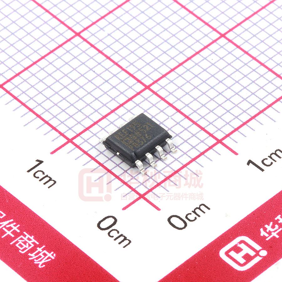

REF195GSZ-REEL
REF195GSZ-REEL
    AD(亚德诺)
    SOIC-8_4.9X3.9MM
    电压基准 IC ±0.2% 8-SOIC
REF195GSZ-REEL 数据手册
Data Sheet Precision Micropower, Low Dropout Voltage References REF19x Series FEATURES TEST PINS Temperature coefficient: 5 ppm/°C maximum High output current: 30 mA Low supply current: 45 μA maximum Initial accuracy: ±2 mV maximum 1 Sleep mode: 15 μA maximum Low dropout voltage Load regulation: 4 ppm/mA Line regulation: 4 ppm/V Short-circuit protection Test Pin 1 and Test Pin 5 are reserved for in-package Zener zap. To achieve the highest level of accuracy at the output, the Zener zapping technique is used to trim the output voltage. Because each unit may require a different amount of adjustment, the resistance value at the test pins varies widely from pin to pin and from part to part. The user should leave Pin 1 and Pin 5 unconnected. TP 1 VS 2 REF19x SERIES 8 NC 7 NC SLEEP 3 APPLICATIONS Portable instruments ADCs and DACs Smart sensors Solar powered applications Loop-current-powered instruments NOTES 1. NC = NO CONNECT. 2. TP PINS ARE FACTORY TEST POINTS, NO USER CONNECTION. Figure 1. 8-Lead SOIC_N and TSSOP Pin Configuration (S Suffix and RU Suffix) TP 1 VS 2 GENERAL DESCRIPTION SLEEP 3 The REF19x series references are specified over the extended industrial temperature range (−40°C to +85°C) with typical performance specifications over −40°C to +125°C for applications, such as automotive. REF19x SERIES 8 NC 7 NC NOTES 1. NC = NO CONNECT. 2. TP PINS ARE FACTORY TEST POINTS, NO USER CONNECTION. 00371-002 6 OUTPUT TOP VIEW GND 4 (Not to Scale) 5 TP The REF19x series precision band gap voltage references use a patented temperature drift curvature correction circuit and laser trimming of highly stable, thin-film resistors to achieve a very low temperature coefficient and high initial accuracy. The REF19x series is made up of micropower, low dropout voltage (LDV) devices, providing stable output voltage from supplies as low as 100 mV above the output voltage and consuming less than 45 μA of supply current. In sleep mode, which is enabled by applying a low TTL or CMOS level to the SLEEP pin, the output is turned off and supply current is further reduced to less than 15 μA. 00371-001 6 OUTPUT TOP VIEW GND 4 (Not to Scale) 5 TP Figure 2. 8-Lead PDIP Pin Configuration (P Suffix) Table 1. Nominal Output Voltage Part Number REF191 REF192 REF193 REF194 REF195 REF196 REF198 Nominal Output Voltage (V) 2.048 2.50 3.00 4.50 5.00 3.30 4.096 All electrical grades are available in an 8-lead SOIC package; the PDIP and TSSOP packages are available only in the lowest electrical grade. 1 Initial accuracy does not include shift due to solder heat effect (see the Applications Information section). Rev. L Information furnished by Analog Devices is believed to be accurate and reliable. However, no responsibility is assumed by Analog Devices for its use, nor for any infringements of patents or other rights of third parties that may result from its use. Specifications subject to change without notice. No license is granted by implication or otherwise under any patent or patent rights of Analog Devices. Trademarks and registered trademarks are the property of their respective owners. One Technology Way, P.O. Box 9106, Norwood, MA 02062-9106, U.S.A. Tel: 781.329.4700 www.analog.com Fax: 781.461.3113 ©1996–2011 Analog Devices, Inc. All rights reserved. REF19x Series Data Sheet TABLE OF CONTENTS Features .............................................................................................. 1 Applications....................................................................................... 1 Electrical Characteristics—REF196 @ −40°C ≤ TA ≤ +125°C ....................................................................................................... 13 General Description ......................................................................... 1 Electrical Characteristics—REF198 @ TA = 25°C.................. 14 Test Pins ............................................................................................. 1 Electrical Characteristics—REF198 @ −40°C ≤ TA ≤ +85°C ....................................................................................................... 14 Revision History ............................................................................... 3 Specifications..................................................................................... 4 Electrical Characteristics—REF191 @ TA = 25°C .................... 4 Electrical Characteristics—REF191 @ −40°C ≤ +85°C........... 5 Electrical Characteristics—REF198 @ −40°C ≤ TA ≤ 125°C15 Absolute Maximum Ratings ......................................................... 16 Thermal Resistance .................................................................... 16 ESD Caution................................................................................ 16 Electrical Characteristics—REF191 @ −40°C ≤ TA ≤ +125°C................................................................... 6 Typical Performance Characteristics ........................................... 17 Electrical Characteristics—REF192 @ TA = 25°C .................... 6 Applications Information .............................................................. 20 Electrical Characteristics—REF192 @ −40°C ≤ TA ≤ +85°C ......................................................................................................... 7 Output Short-Circuit Behavior ................................................ 20 Electrical Characteristics—REF192 @ −40°C ≤ TA ≤ +125°C ......................................................................................................... 7 Output Voltage Bypassing ......................................................... 20 Electrical Characteristics—REF193 @ TA = 25°C .................... 8 Basic Voltage Reference Connections ..................................... 20 Electrical Characteristics—REF193 @ −40°C ≤ TA ≤ +85°C ......................................................................................................... 8 Membrane Switch-Controlled Power Supply............................. 20 Electrical Characteristics—REF193 @ TA ≤ −40°C ≤ +125°C ......................................................................................................... 9 Current-Boosted References with Current Limiting............. 21 Device Power Dissipation Considerations.............................. 20 Sleep Mode Operation............................................................... 20 Solder Hear Effect ...................................................................... 21 Electrical Characteristics—REF194 @ TA = 25°C .................... 9 Negative Precision Reference Without Precision Resistors.. 22 Electrical Characteristics—REF194 @ −40°C ≤ TA ≤ +85°C ....................................................................................................... 10 Stacking Reference ICs for Arbitrary Outputs ....................... 22 Electrical Characteristics—REF194 @ −40°C ≤ TA ≤ +125°C ....................................................................................................... 10 Switched Output 5 V/3.3 V Reference..................................... 23 Electrical Characteristics—REF195 @ TA = 25°C .................. 11 Fail-Safe 5 V Reference.............................................................. 24 Electrical Characteristics—REF195 @ −40°C ≤ TA ≤ +85°C ....................................................................................................... 11 Low Power, Strain Gage Circuit ............................................... 25 Electrical Characteristics—REF195 @ −40°C ≤ TA ≤ +125°C ....................................................................................................... 12 Precision Current Source .......................................................... 23 Kelvin Connections.................................................................... 24 Outline Dimensions ....................................................................... 26 Ordering Guide .......................................................................... 27 Electrical Characteristics—REF196 @ TA = 25°C .................. 12 Electrical Characteristics—REF196 @ −40°C ≤ TA ≤ +85°C ....................................................................................................... 13 Rev. L | Page 2 of 28 Data Sheet REF19x Series REVISION HISTORY 9/11—Rev. K to Rev. L Change to Condition Column for Dropout Voltage Parameter, Table 2 ................................................................................................. 4 Change to Condition Column for Dropout Voltage Parameter, Table 3 ................................................................................................. 5 Change to Operating Temperature Range, Table 23...................16 7/10—Rev. J to Rev. K Add Note 1, Features Section........................................................... 1 Changes to Note 1, Table 2 ............................................................... 4 Changes to Note 1, Table 5 ............................................................... 6 Changes to Note 1, Table 8 ............................................................... 8 Changes to Note 1, Table 11 ............................................................. 9 Changes to Note 1, Table 14 ...........................................................11 Changes to Note 1, Table 17 ...........................................................12 Changes to Note 1, Table 20 ...........................................................14 Moved Figure 22 ..............................................................................20 Added Figure 23, Solder Heat Effect Section, and Figure 24; Renumbered Sequentially ..............................................................21 Moved Negative Precision Reference Without Precision Resistors Section ..............................................................................22 Moved Precision Current Source Section ....................................23 Moved Kelvin Connections Section .............................................24 Moved Figure 32 ..............................................................................25 Updated Outline Dimensions ........................................................26 Changes to Ordering Guide ...........................................................27 3/08—Rev. I to Rev. J Changes to General Description ..................................................... 1 Changes to Specifications Section................................................... 4 Deleted Wafer Test Limits Section ................................................14 Changes to Table 23, Thermal Resistance Section, and Table 24 .............................................................................................16 Changes to Figure 6.........................................................................17 Changes to Device Power Dissipation Considerations Section ...................................................................20 Changes to Current-Boosted References with Current Limiting Section ..............................................................................21 Changes to Precision Current Source Section ............................ 22 Changes to Figure 28 ...................................................................... 23 Changes to Figure 30 ...................................................................... 24 Changes to Low Power, Strain Gage Circuit Section.................. 25 Changes to Ordering Guide ........................................................... 27 9/06—Rev. H to Rev. I Updated Format ................................................................. Universal Changes to Table 25 ........................................................................ 16 Changes to Figure 6 ........................................................................ 16 Changes to Figure 10, Figure 12, Figure 14, and Figure 26 ....... 17 Changes to Figure 18 ...................................................................... 18 Changes to Figure 20 ...................................................................... 19 Changes to Figure 23 ...................................................................... 20 Changes to Figure 25 ...................................................................... 21 Updated Outline Dimensions........................................................ 25 Changes to Ordering Guide ........................................................... 26 6/05—Rev. G to Rev. H Updated Format ................................................................. Universal Changes to Caption in Figure 7..................................................... 16 Updated Outline Dimensions........................................................ 25 Changes to Ordering Guide ........................................................... 26 7/04—Rev. F to Rev. G Changes to Ordering Guide ............................................................. 4 3/04—Rev. E to Rev. F Updated Absolute Maximum Rating.............................................. 4 Changes to Ordering Guide ........................................................... 14 Updated Outline Dimensions........................................................ 24 1/03—Rev. D to Rev. E Changes to Figure 3 and Figure 4 ................................................. 15 Changes to Output Short Circuit Behavior ................................. 17 Changes to Figure 20 ...................................................................... 17 Changes to Figure 26 ...................................................................... 19 Updated Outline Dimensions........................................................ 23 1/96—Revision 0: Initial Version Rev. L | Page 3 of 28 REF19x Series Data Sheet SPECIFICATIONS ELECTRICAL CHARACTERISTICS—REF191 @ TA = 25°C @ VS = 3.3 V, TA = 25°C, unless otherwise noted. Table 2. Parameter INITIAL ACCURACY 1 E Grade F Grade G Grade LINE REGULATION 2 E Grade F and G Grades LOAD REGULATION2 E Grade F and G Grades DROPOUT VOLTAGE Symbol VO LONG-TERM STABILITY 3 NOISE VOLTAGE DVO eN Condition Min Typ Max Unit IOUT = 0 mA 2.046 2.043 2.038 2.048 2.050 2.053 2.058 V V V 3.0 V ≤ VS ≤ 15 V, IOUT = 0 mA 2 4 4 8 ppm/V ppm/V VS = 5.0 V, 0 mA ≤ IOUT ≤ 30 mA 4 6 10 15 0.95 1.25 1.55 ppm/mA ppm/mA V V V mV μV p-p ΔVO/ΔVIN ΔVO/ΔVLOAD V S − VO VS = 3.0 V, ILOAD = 2 mA VS = 3.3 V, ILOAD = 10 mA VS = 3.6 V, ILOAD = 30 mA 1000 hours @ 125°C 0.1 Hz to 10 Hz 1 1.2 20 Initial accuracy does not include shift due to solder heat effect (see the Applications Information section). Line and load regulation specifications include the effect of self-heating. 3 Long-term stability specification is noncumulative. The drift in subsequent 1000-hour periods is significantly lower than in the first 1000-hour period. 2 Rev. L | Page 4 of 28 Data Sheet REF19x Series ELECTRICAL CHARACTERISTICS—REF191 @ −40°C ≤ +85°C @ VS = 3.3 V, −40°C ≤ TA ≤ +85°C, unless otherwise noted. Table 3. Parameter TEMPERATURE COEFFICIENT 1, 2 E Grade F Grade G Grade 3 LINE REGULATION 4 E Grade F and G Grades LOAD REGULATION4 E Grade F and G Grades DROPOUT VOLTAGE SLEEP PIN Logic High Input Voltage Logic High Input Current Logic Low Input Voltage Logic Low Input Current SUPPLY CURRENT Sleep Mode 1 2 Symbol TCVO/°C Condition Min Typ Max Unit IOUT = 0 mA 2 5 10 5 10 25 ppm/°C ppm/°C ppm/°C 3.0 V ≤ VS ≤ 15 V, IOUT = 0 mA 5 10 10 20 ppm/V ppm/V VS = 5.0 V, 0 mA ≤ IOUT ≤ 25 mA 5 10 15 20 0.95 1.25 1.55 ppm/mA ppm/mA V V V −8 0.8 −8 45 15 V μA V μA μA μA ΔVO/ΔVIN ΔVO/ΔVLOAD V S − VO VS = 3.0 V, ILOAD = 2 mA VS = 3.3 V, ILOAD = 10 mA VS = 3.6 V, ILOAD = 25 mA VH IH VL IL 2.4 No load No load For proper operation, a 1 μF capacitor is required between the output pin and the GND pin of the device. TCVO is defined as the ratio of output change with temperature variation to the specified temperature range expressed in ppm/°C. TCVO = (VMAX − VMIN)/VO(TMAX − TMIN) 3 Guaranteed by characterization. 4 Line and load regulation specifications include the effect of self-heating. Rev. L | Page 5 of 28 REF19x Series Data Sheet ELECTRICAL CHARACTERISTICS—REF191 @ −40°C ≤ TA ≤ +125°C @ VS = 3.3 V, −40°C ≤ TA ≤ +125°C, unless otherwise noted. Table 4. Parameter TEMPERATURE COEFFICIENT 1, 2 E Grade F Grade G Grade 3 LINE REGULATION 4 E Grade F and G Grades LOAD REGULATION4 E Grade F and G Grades DROPOUT VOLTAGE 1 2 Symbol TCVO/°C Condition Min Typ Max Unit IOUT = 0 mA 2 5 10 ppm/°C ppm/°C ppm/°C 3.0 V ≤ VS ≤ 15 V, IOUT = 0 mA 10 20 ppm/V ppm/V VS = 5.0 V, 0 mA ≤ IOUT ≤ 20 mA 10 20 ppm/mA ppm/mA V V ΔVO/ΔVIN ΔVO/ΔVLOAD V S − VO VS = 3.3 V, ILOAD = 10 mA VS = 3.6 V, ILOAD = 20 mA 1.25 1.55 For proper operation, a 1 μF capacitor is required between the output pin and the GND pin of the device. TCVO is defined as the ratio of output change with temperature variation to the specified temperature range expressed in ppm/°C. TCVO = (VMAX − VMIN)/VO(TMAX − TMIN) 3 Guaranteed by characterization. 4 Line and load regulation specifications include the effect of self-heating. ELECTRICAL CHARACTERISTICS—REF192 @ TA = 25°C @ VS = 3.3 V, TA = 25°C, unless otherwise noted. Table 5. Parameter INITIAL ACCURACY 1 E Grade F Grade G Grade LINE REGULATION 2 E Grade F and G Grades LOAD REGULATION2 E Grade F and G Grades DROPOUT VOLTAGE Symbol VO LONG-TERM STABILITY 3 NOISE VOLTAGE DVO eN 1 2 3 Condition Min Typ Max Unit IOUT = 0 mA 2.498 2.495 2.490 2.500 2.502 2.505 2.510 V V V 3.0 V ≤ VS ≤ 15 V, IOUT = 0 mA 2 4 4 8 ppm/V ppm/V VS = 5.0 V, 0 mA ≤ IOUT ≤ 30 mA 4 6 10 15 1.00 1.40 ppm/mA ppm/mA V V mV μV p-p ΔVO/ΔVIN ΔVO/ΔVLOAD V S − VO VS = 3.5 V, ILOAD = 10 mA VS = 3.9 V, ILOAD = 30 mA 1000 hours @ 125°C 0.1 Hz to 10 Hz 1.2 25 Initial accuracy does not include shift due to solder heat effect (see the Applications Information section). Line and load regulation specifications include the effect of self-heating. Long-term stability specification is noncumulative. The drift in subsequent 1000-hour periods is significantly lower than in the first 1000-hour period. Rev. L | Page 6 of 28 Data Sheet REF19x Series ELECTRICAL CHARACTERISTICS—REF192 @ −40°C ≤ TA ≤ +85°C @ VS = 3.3 V, −40°C ≤ TA ≤ +85°C, unless otherwise noted. Table 6. Parameter TEMPERATURE COEFFICIENT 1, 2 E Grade F Grade G Grade 3 LINE REGULATION 4 E Grade F and G Grades LOAD REGULATION4 E Grade F and G Grades DROPOUT VOLTAGE SLEEP PIN Logic High Input Voltage Logic High Input Current Logic Low Input Voltage Logic Low Input Current SUPPLY CURRENT Sleep Mode 1 2 Symbol TCVO/°C Condition Min Typ Max Unit IOUT = 0 mA 2 5 10 5 10 25 ppm/°C ppm/°C ppm/°C 3.0 V ≤ VS ≤ 15 V, IOUT = 0 mA 5 10 10 20 ppm/V ppm/V VS = 5.0 V, 0 mA ≤ IOUT ≤ 25 mA 5 10 15 20 1.00 1.50 ppm/mA ppm/mA V V −8 0.8 −8 45 15 V μA V μA μA μA Max Unit ΔVO/ΔVIN ΔVO/ΔVLOAD V S − VO VS = 3.5 V, ILOAD = 10 mA VS = 4.0 V, ILOAD = 25 mA VH IH VL IL 2.4 No load No load For proper operation, a 1 μF capacitor is required between the output pin and the GND pin of the device. TCVO is defined as the ratio of output change with temperature variation to the specified temperature range expressed in ppm/°C. TCVO = (VMAX − VMIN)/VO(TMAX − TMIN) 3 Guaranteed by characterization. 4 Line and load regulation specifications include the effect of self-heating. ELECTRICAL CHARACTERISTICS—REF192 @ −40°C ≤ TA ≤ +125°C @ VS = 3.3 V, −40°C ≤ TA ≤ +125°C, unless otherwise noted. Table 7. Parameter TEMPERATURE COEFFICIENT 1, 2 E Grade F Grade G Grade 3 LINE REGULATION 4 E Grade F and G Grades LOAD REGULATION4 E Grade F and G Grades DROPOUT VOLTAGE 1 2 Symbol TCVO/°C Condition Min Typ IOUT = 0 mA 2 5 10 ppm/°C ppm/°C ppm/°C 3.0 V ≤ VS ≤ 15 V, IOUT = 0 mA 10 20 ppm/V ppm/V VS = 5.0 V, 0 mA ≤ IOUT ≤ 20 mA 10 20 ppm/mA ppm/mA V V ΔVO/ΔVIN ΔVO/ΔVLOAD V S − VO VS = 3.5 V, ILOAD = 10 mA VS = 4.0 V, ILOAD = 20 mA For proper operation, a 1 μF capacitor is required between the output pin and the GND pin of the device. TCVO is defined as the ratio of output change with temperature variation to the specified temperature range expressed in ppm/°C. TCVO = (VMAX − VMIN)/VO(TMAX − TMIN) 3 Guaranteed by characterization. 4 Line and load regulation specifications include the effect of self-heating. Rev. L | Page 7 of 28 1.00 1.50 REF19x Series Data Sheet ELECTRICAL CHARACTERISTICS—REF193 @ TA = 25°C @ VS = 3.3 V, TA = 25°C, unless otherwise noted. Table 8. Parameter INITIAL ACCURACY 1 G Grade LINE REGULATION 2 G Grade LOAD REGULATION2 G Grade DROPOUT VOLTAGE Symbol VO LONG-TERM STABILITY 3 NOISE VOLTAGE DVO eN 1 2 3 Condition Min Typ Max Unit IOUT = 0 mA 2.990 3.0 3.010 V 3.3 V, ≤ VS ≤ 15 V, IOUT = 0 mA 4 8 ppm/V VS = 5.0 V, 0 mA ≤ IOUT ≤ 30 mA VS = 3.8 V, ILOAD = 10 mA VS = 4.0 V, ILOAD = 30 mA 1000 hours @ 125°C 0.1 Hz to 10 Hz 6 15 0.80 1.00 ppm/mA V V mV μV p-p ΔVO/ΔVIN ΔVO/ΔVLOAD V S − VO 1.2 30 Initial accuracy does not include shift due to solder heat effect (see the Applications Information section). Line and load regulation specifications include the effect of self-heating. Long-term stability specification is noncumulative. The drift in subsequent 1000-hour periods is significantly lower than in the first 1000-hour period. ELECTRICAL CHARACTERISTICS—REF193 @ −40°C ≤ TA ≤ +85°C @ VS = 3.3 V, TA = −40°C ≤ TA ≤ +85°C, unless otherwise noted. Table 9. Parameter TEMPERATURE COEFFICIENT 1, 2 G Grade 3 LINE REGULATION 4 G Grade LOAD REGULATION4 G Grade DROPOUT VOLTAGE SLEEP PIN Logic High Input Voltage Logic High Input Current Logic Low Input Voltage Logic Low Input Current SUPPLY CURRENT Sleep Mode 1 2 Symbol TCVO/°C Condition Typ Max Unit IOUT = 0 mA 10 25 ppm/°C 3.3 V ≤ VS ≤ 15 V, IOUT = 0 mA 10 20 ppm/V VS = 5.0 V, 0 mA ≤ IOUT ≤ 25 mA VS = 3.8 V, ILOAD = 10 mA VS = 4.1 V, ILOAD = 30 mA 10 20 0.80 1.10 ppm/mA V V −8 0.8 −8 45 15 V μA V μA μA μA ΔVO/ΔVIN ΔVO/ΔVLOAD V S − VO VH IH VL IL 2.4 No load No load For proper operation, a 1 μF capacitor is required between the output pin and the GND pin of the device. TCVO is defined as the ratio of output change with temperature variation to the specified temperature range expressed in ppm/°C. TCVO = (VMAX − VMIN)/VO(TMAX − TMIN) 3 4 Min Guaranteed by characterization. Line and load regulation specifications include the effect of self-heating. Rev. L | Page 8 of 28 Data Sheet REF19x Series ELECTRICAL CHARACTERISTICS—REF193 @ TA ≤ −40°C ≤ +125°C @ VS = 3.3 V, –40°C ≤ TA ≤ +125°C, unless otherwise noted. Table 10. Parameter TEMPERATURE COEFFICIENT 1, 2 G Grade 3 LINE REGULATION 4 G Grade LOAD REGULATION4 G Grade DROPOUT VOLTAGE 1 2 Symbol TCVO/°C Condition Min Typ Max Unit IOUT = 0 mA 10 ppm/°C 3.3 V ≤ VS ≤ 15 V, IOUT = 0 mA 20 ppm/V VS = 5.0 V, 0 mA ≤ IOUT ≤ 20 mA VS = 3.8 V, ILOAD = 10 mA VS = 4.1 V, ILOAD = 20 mA 10 ΔVO/ΔVIN ΔVO/ΔVLOAD V S − VO 0.80 1.10 ppm/mA V V For proper operation, a 1 μF capacitor is required between the output pin and the GND pin of the device. TCVO is defined as the ratio of output change with temperature variation to the specified temperature range expressed in ppm/°C. TCVO = (VMAX − VMIN)/VO(TMAX − TMIN) 3 Guaranteed by characterization. 4 Line and load regulation specifications include the effect of self-heating. ELECTRICAL CHARACTERISTICS—REF194 @ TA = 25°C @ VS = 5.0 V, TA = 25°C, unless otherwise noted. Table 11. Parameter INITIAL ACCURACY 1 E Grade G Grade LINE REGULATION 2 E Grade G Grade LOAD REGULATION2 E Grade G Grade DROPOUT VOLTAGE Symbol VO LONG-TERM STABILITY 3 NOISE VOLTAGE DVO eN 1 2 3 Condition Min Typ Max Unit IOUT = 0 mA 4.498 4.490 4.5 4.502 4.510 V V 4.75 V ≤ VS ≤ 15 V, IOUT = 0 mA 2 4 4 8 ppm/V ppm/V VS = 5.8 V, 0 mA ≤ IOUT ≤ 30 mA 2 4 4 8 0.50 1.30 ppm/mA ppm/mA V V mV μV p-p ∆VO/∆VIN ∆VO/∆VLOAD V S − VO VS = 5.00 V, ILOAD = 10 mA VS = 5.8 V, ILOAD = 30 mA 1000 hours @ 125°C 0.1 Hz to 10 Hz 2 45 Initial accuracy does not include shift due to solder heat effect (see the Applications Information section). Line and load regulation specifications include the effect of self-heating. Long-term stability specification is noncumulative. The drift in subsequent 1000-hour periods is significantly lower than in the first 1000-hour period. Rev. L | Page 9 of 28 REF19x Series Data Sheet ELECTRICAL CHARACTERISTICS—REF194 @ −40°C ≤ TA ≤ +85°C @ VS = 5.0 V, TA = −40°C ≤ TA ≤ +85°C, unless otherwise noted. Table 12. Parameter TEMPERATURE COEFFICIENT 1, 2 E Grade G Grade 3 LINE REGULATION 4 E Grade G Grade LOAD REGULATION4 E Grade G Grade DROPOUT VOLTAGE SLEEP PIN Logic High Input Voltage Logic High Input Current Logic Low Input Voltage Logic Low Input Current SUPPLY CURRENT Sleep Mode 1 2 Symbol TCVO/°C Condition Min Typ Max Unit IOUT = 0 mA 2 10 5 25 ppm/°C ppm/°C 4.75 V ≤ VS ≤ 15 V, IOUT = 0 mA 5 10 10 20 ppm/V ppm/V VS = 5.80 V, 0 mA ≤ IOUT ≤ 25 mA 5 10 15 20 0.5 1.30 ppm/mA ppm/mA V V −8 0.8 −8 45 15 V μA V μA μA μA Max Unit ∆VO/∆VIN ∆VO/∆VLOAD V S − VO VS = 5.00 V, ILOAD = 10 mA VS = 5.80 V, ILOAD = 25 mA VH IH VL IL 2.4 No load No load For proper operation, a 1 μF capacitor is required between the output pin and the GND pin of the device. TCVO is defined as the ratio of output change with temperature variation to the specified temperature range expressed in ppm/°C. TCVO = (VMAX − VMIN)/VO(TMAX − TMIN) 3 Guaranteed by characterization. 4 Line and load regulation specifications include the effect of self-heating. ELECTRICAL CHARACTERISTICS—REF194 @ −40°C ≤ TA ≤ +125°C @ VS = 5.0 V, −40°C ≤ TA ≤ +125°C, unless otherwise noted. Table 13. Parameter TEMPERATURE COEFFICIENT 1, 2 E Grade G Grade 3 LINE REGULATION 4 E Grade G Grade LOAD REGULATION E Grade Grade DROPOUT VOLTAGE 1 2 Symbol TCVO/°C Condition Min Typ IOUT = 0 mA 2 10 ppm/°C ppm/°C 4.75 V ≤ VS ≤ 15 V, IOUT = 0 mA 5 10 ppm/V ppm/V VS = 5.80 V, 0 mA ≤ IOUT ≤ 20 mA 5 10 ppm/mA ppm/mA V V ΔVO/ΔVIN ΔVO/ΔVLOAD V S − VO VS = 5.10 V, ILOAD = 10 mA VS = 5.95 V, ILOAD = 20 mA For proper operation, a 1 μF capacitor is required between the output pin and the GND pin of the device. TCVO is defined as the ratio of output change with temperature variation to the specified temperature range expressed in ppm/°C. TCVO = (VMAX − VMIN)/VO(TMAX − TMIN) 3 Guaranteed by characterization. 4 Line and load regulation specifications include the effect of self-heating. Rev. L | Page 10 of 28 0.60 1.45 Data Sheet REF19x Series ELECTRICAL CHARACTERISTICS—REF195 @ TA = 25°C @ VS = 5.10 V, TA = 25°C, unless otherwise noted. Table 14. Parameter INITIAL ACCURACY 1 E Grade F Grade G Grade LINE REGULATION 2 E Grade F and G Grades LOAD REGULATION2 E Grade F and G Grades DROPOUT VOLTAGE Symbol VO LONG-TERM STABILITY 3 NOISE VOLTAGE DVO eN Condition Min Typ Max Unit IOUT = 0 mA 4.998 4.995 4.990 5.0 5.002 5.005 5.010 V V V 5.10 V ≤ VS ≤ 15 V, IOUT = 0 mA 2 4 4 8 ppm/V ppm/V VS = 6.30 V, 0 mA ≤ IOUT ≤ 30 mA 2 4 4 8 0.50 1.30 ppm/mA ppm/mA V V mV μV p-p ΔVO/ΔVIN ΔVO/ΔVLOAD V S − VO VS = 5.50 V, ILOAD = 10 mA VS = 6.30 V, ILOAD = 30 mA 1000 hours @ 125°C 0.1 Hz to 10 Hz 1.2 50 1 Initial accuracy does not include shift due to solder heat effect (see the Applications Information section). Line and load regulation specifications include the effect of self-heating. 3 Long-term stability specification is noncumulative. The drift in subsequent 1000-hour periods is significantly lower than in the first 1000-hour period. 2 ELECTRICAL CHARACTERISTICS—REF195 @ −40°C ≤ TA ≤ +85°C @ VS = 5.15 V, TA = −40°C ≤ TA ≤ +85°C, unless otherwise noted. Table 15. Parameter TEMPERATURE COEFFICIENT 1, 2 E Grade F Grade G Grade 3 LINE REGULATION 4 E Grade F and G Grades LOAD REGULATION4 E Grade F and G Grades DROPOUT VOLTAGE SLEEP PIN Logic High Input Voltage Logic High Input Current Logic Low Input Voltage Logic Low Input Current SUPPLY CURRENT Sleep Mode 1 2 Symbol TCVO/°C Condition Min Typ Max Unit IOUT = 0 mA 2 5 10 5 10 25 ppm/°C ppm/°C ppm/°C 5.15 V ≤ VS ≤ 15 V, IOUT = 0 mA 5 10 10 20 ppm/V ppm/V VS = 6.30 V, 0 mA ≤ IOUT ≤ 25 mA 5 10 10 20 0.50 1.30 ppm/mA ppm/mA V V −8 0.8 −8 45 15 V μA V μA μA μA ΔVO/ΔVIN ΔVO/ΔVLOAD V S − VO VS = 5.50 V, ILOAD = 10 mA VS = 6.30 V, ILOAD = 25 mA VH IH VL IL 2.4 No load No load For proper operation, a 1 μF capacitor is required between the output pin and the GND pin of the device. TCVO is defined as the ratio of output change with temperature variation to the specified temperature range expressed in ppm/°C. TCVO = (VMAX − VMIN)/VO(TMAX − TMIN) 3 Guaranteed by characterization. 4 Line and load regulation specifications include the effect of self-heating. Rev. L | Page 11 of 28 REF19x Series Data Sheet ELECTRICAL CHARACTERISTICS—REF195 @ −40°C ≤ TA ≤ +125°C @ VS = 5.20 V, −40°C ≤ TA ≤ +125°C, unless otherwise noted. Table 16. Parameter TEMPERATURE COEFFICIENT 1, 2 E Grade F Grade G Grade 3 LINE REGULATION 4 E Grade F and G Grades LOAD REGULATION4 E Grade F and G Grades DROPOUT VOLTAGE 1 2 Symbol TCVO/°C Condition Min Typ Max Unit IOUT = 0 mA 2 5 10 ppm/°C ppm/°C ppm/°C 5.20 V ≤ VS ≤ 15 V, IOUT = 0 mA 5 10 ppm/V ppm/V VS = 6.45 V, 0 mA ≤ IOUT ≤ 20 mA 5 10 0.60 ppm/mA ppm/mA V 1.45 V ΔVO/ΔVIN ΔVO/ΔVLOAD VS − V O VS = 5.60 V, ILOAD = 10 mA VS = 6.45 V, ILOAD = 20 mA For proper operation, a 1 μF capacitor is required between the output pin and the GND pin of the device. TCVO is defined as the ratio of output change with temperature variation to the specified temperature range expressed in ppm/°C. TCVO = (VMAX − VMIN)/VO(TMAX − TMIN) 3 Guaranteed by characterization. 4 Line and load regulation specifications include the effect of self-heating. ELECTRICAL CHARACTERISTICS—REF196 @ TA = 25°C @ VS = 3.5 V, TA = 25°C, unless otherwise noted. Table 17. Parameter INITIAL ACCURACY 1 G Grade LINE REGULATION 2 G Grade LOAD REGULATION2 G Grade DROPOUT VOLTAGE Symbol VO LONG-TERM STABILITY 3 NOISE VOLTAGE DVO eN Condition Min Typ Max Unit IOUT = 0 mA 3.290 3.3 3.310 V 3.50 V ≤ VS ≤ 15 V, IOUT = 0 mA 4 8 ppm/V VS = 5.0 V, 0 mA ≤ IOUT ≤ 30 mA VS = 4.1 V, ILOAD = 10 mA VS = 4.3 V, ILOAD = 30 mA 1000 hours @ 125°C 0.1 Hz to 10 Hz 6 15 0.80 1.00 ppm/mA V V mV μV p-p ΔVO/ΔVIN ΔVO/ΔVLOAD V S − VO 1 1.2 33 Initial accuracy does not include shift due to solder heat effect (see the Applications Information section). Line and load regulation specifications include the effect of self-heating. 3 Long-term stability specification is noncumulative. The drift in subsequent 1000-hour periods is significantly lower than in the first 1000-hour period. 2 Rev. L | Page 12 of 28 Data Sheet REF19x Series ELECTRICAL CHARACTERISTICS—REF196 @ −40°C ≤ TA ≤ +85°C @ VS = 3.5 V, TA = –40°C ≤ TA ≤ +85°C, unless otherwise noted. Table 18. Parameter TEMPERATURE COEFFICIENT 1, 2 G Grade 3 LINE REGULATION 4 G Grade LOAD REGULATION4 G Grade DROPOUT VOLTAGE SLEEP PIN Logic High Input Voltage Logic High Input Current Logic Low Input Voltage Logic Low Input Current SUPPLY CURRENT Sleep Mode 1 2 Symbol TCVO/°C Condition Min Typ Max Unit IOUT = 0 mA 10 25 ppm/°C 3.5 V ≤ VS ≤ 15 V, IOUT = 0 mA 10 20 ppm/V VS = 5.0 V, 0 mA ≤ IOUT ≤ 25 mA VS = 4.1 V, ILOAD = 10 mA VS = 4.3 V, ILOAD = 25 mA 10 20 0.80 1.00 ppm/mA V V −8 0.8 −8 45 15 V μA V μA μA μA Max Unit ΔVO/ΔVIN ΔVO/ΔVLOAD V S − VO VH IH VL IL 2.4 No load No load For proper operation, a 1 μF capacitor is required between the output pin and the GND pin of the device. TCVO is defined as the ratio of output change with temperature variation to the specified temperature range expressed in ppm/°C. TCVO = (VMAX − VMIN)/V0(TMAX − TMIN) 3 Guaranteed by characterization. 4 Line and load regulation specifications include the effect of self-heating. ELECTRICAL CHARACTERISTICS—REF196 @ −40°C ≤ TA ≤ +125°C @ VS = 3.50 V, −40°C ≤ TA ≤ +125°C, unless otherwise noted. Table 19. Parameter TEMPERATURE COEFFICIENT 1, 2 G Grade 3 LINE REGULATION 4 G Grade LOAD REGULATION4 G Grade DROPOUT VOLTAGE 1 2 Symbol TCVO/°C Condition Min Typ IOUT = 0 mA 10 ppm/°C 3.50 V ≤ VS ≤ 15 V, IOUT = 0 mA 20 ppm/V VS = 5.0 V, 0 mA ≤ IOUT ≤ 20 mA VS = 4.1 V, ILOAD = 10 mA VS = 4.4 V, ILOAD = 20 mA 20 ΔVO/ΔVIN ΔVO/ΔVLOAD V S − VO For proper operation, a 1 μF capacitor is required between the output pin and the GND pin of the device. TCVO is defined as the ratio of output change with temperature variation to the specified temperature range expressed in ppm/°C. TCVO = (VMAX − VMIN)/VO(TMAX − TMIN) 3 Guaranteed by characterization. 4 Line and load regulation specifications include the effect of self-heating. Rev. L | Page 13 of 28 0.80 1.10 ppm/mA V V REF19x Series Data Sheet ELECTRICAL CHARACTERISTICS—REF198 @ TA = 25°C @ VS = 5.0 V, TA = 25°C, unless otherwise noted. Table 20. Parameter INITIAL ACCURACY 1 E Grade F Grade G Grade LINE REGULATION 2 E Grade F and G Grades LOAD REGULATION2 E Grade F and G Grades DROPOUT VOLTAGE Symbol VO LONG-TERM STABILITY 3 NOISE VOLTAGE DVO eN Condition Min Typ Max Unit IOUT = 0 mA 4.094 4.091 4.086 4.096 4.098 4.101 4.106 V V V 4.5 V ≤ VS ≤ 15 V, IOUT = 0 mA 2 4 4 8 ppm/V ppm/V VS = 5.4 V, 0 mA ≤ IOUT ≤ 30 mA 2 4 4 8 0.502 1.30 ppm/mA ppm/mA V V mV μV p-p ΔVO/ΔVIN ΔVO/ΔVLOAD V S − VO VS = 4.6 V, ILOAD = 10 mA VS = 5.4 V, ILOAD = 30 mA 1000 hours @ 125°C 0.1 Hz to 10 Hz 1.2 40 1 Initial accuracy does not include shift due to solder heat effect (see the Applications Information section). Line and load regulation specifications include the effect of self-heating. 3 Long-term stability specification is noncumulative. The drift in subsequent 1000-hour periods is significantly lower than in the first 1000-hour period. 2 ELECTRICAL CHARACTERISTICS—REF198 @ −40°C ≤ TA ≤ +85°C @ VS = 5.0 V, −40°C ≤ TA ≤ +85°C, unless otherwise noted. Table 21. Parameter TEMPERATURE COEFFICIENT 1, 2 E Grade F Grade G Grade 3 LINE REGULATION 4 E Grade F and G Grades LOAD REGULATION4 E Grade F and G Grades DROPOUT VOLTAGE SLEEP PIN Logic High Input Voltage Logic High Input Current Logic Low Input Voltage Logic Low Input Current SUPPLY CURRENT Sleep Mode 1 2 Symbol TCVO/°C Condition Min Typ Max Unit IOUT = 0 mA 2 5 10 5 10 25 ppm/°C ppm/°C ppm/°C 4.5 V ≤ VS ≤ 15 V, IOUT = 0 mA 5 10 10 20 ppm/V ppm/V VS = 5.4 V, 0 mA ≤ IOUT ≤ 25 mA 5 10 10 20 0.502 1.30 ppm/mA ppm/mA V V −8 0.8 −8 45 15 V μA V μA μA μA ΔVO/ΔVIN ΔVO/ΔVLOAD V S − VO VS = 4.6 V, ILOAD = 10 mA VS = 5.4 V, ILOAD = 25 mA VH IH VL IL 2.4 No load No load For proper operation, a 1 μF capacitor is required between the output pin and the GND pin of the device. TCVO is defined as the ratio of output change with temperature variation to the specified temperature range expressed in ppm/°C. TCVO = (VMAX − VMIN)/VO(TMAX − TMIN) 3 Guaranteed by characterization. 4 Line and load regulation specifications include the effect of self-heating. Rev. L | Page 14 of 28 Data Sheet REF19x Series ELECTRICAL CHARACTERISTICS—REF198 @ −40°C ≤ TA ≤ +125°C @ VS = 5.0 V, −40°C ≤ TA ≤ +125°C, unless otherwise noted. Table 22. Parameter TEMPERATURE COEFFICIENT 1, 2 E Grade F Grade G Grade 3 LINE REGULATION 4 E Grade F and G Grades LOAD REGULATION4 E Grade F and G Grades DROPOUT VOLTAGE 1 2 Symbol TCVO/°C Condition 4 Typ Max Unit IOUT = 0 mA 2 5 10 ppm/°C ppm/°C ppm/°C 4.5 V ≤ VS ≤ 15 V, IOUT = 0 mA 5 10 ppm/V ppm/V VS = 5.6 V, 0 mA ≤ IOUT ≤ 20 mA 5 10 ppm/mA ppm/mA V V ΔVO/ΔVIN ΔVO/ΔVLOAD V S − VO VS = 4.7 V, ILOAD = 10 mA VS = 5.6 V, ILOAD = 20 mA For proper operation, a 1 μF capacitor is required between the output pin and the GND pin of the device. TCVO is defined as the ratio of output change with temperature variation to the specified temperature range expressed in ppm/°C. TCVO = (VMAX − VMIN)/VO(TMAX − TMIN) 3 Min Guaranteed by characterization. Line and load regulation specifications include the effect of self-heating. Rev. L | Page 15 of 28 0.60 1.50 REF19x Series Data Sheet ABSOLUTE MAXIMUM RATINGS THERMAL RESISTANCE Table 23. Parameter Supply Voltage Output to GND Output to GND Short-Circuit Duration Storage Temperature Range PDIP, SOIC Package Operating Temperature Range REF19x Junction Temperature Range PDIP, SOIC Package Lead Temperature (Soldering 60 sec) Rating −0.3 V to +18 V −0.3 V to VS + 0.3 V Indefinite θJA is specified for worst-case conditions; that is, θJA is specified for the device in socket for PDIP and is specified for the device soldered in the circuit board for the SOIC and TSSOP packages. −65°C to +150°C Package Type 8-Lead PDIP (N) 8-Lead SOIC (R) 8-Lead TSSOP (RU) −40°C to +125°C −65°C to +150°C 300°C Table 24. ESD CAUTION Stresses above those listed under Absolute Maximum Ratings may cause permanent damage to the device. This is a stress rating only; functional operation of the device at these or any other conditions above those indicated in the operational section of this specification is not implied. Exposure to absolute maximum rating conditions for extended periods may affect device reliability. Rev. L | Page 16 of 28 θJA 103 158 240 θJC 43 43 43 Unit °C/W °C/W °C/W Data Sheet REF19x Series TYPICAL PERFORMANCE CHARACTERISTICS 50 5.004 3 TYPICAL PARTS 5.15V < VIN < 15V 5.003 BASED ON 600 45 UNITS, 4 RUNS –40°C ≤ TA ≤ +85°C 40 PERCENTAGE OF PARTS 5.001 5.000 4.999 4.998 4.997 35 30 25 20 15 10 5 –25 0 25 50 TEMPERATURE (°C) 75 0 –20 00371-003 4.996 –50 100 –15 –10 10 15 20 Figure 6. TCVOUT Distribution Figure 3. REF195 Output Voltage vs. Temperature 32 –5 0 5 TCVOUT (ppm/°C) 00371-006 OUTPUT VOLTAGE (V) 5.002 40 5.15V ≤ VS ≤ 15V 28 35 24 30 SUPPLY CURRENT (μA) LOAD REGULATION (ppm/V) NORMAL MODE –40°C 20 16 +25°C 12 +85°C 8 25 20 15 10 4 5 0 0 –50 10 15 ILOAD (mA) 20 25 30 Figure 4. REF195 Load Regulator vs. ILOAD 20 SLEEP PIN CURRENT (µA) +25°C 12 –40°C 8 4 –4 –3 –2 VL –1 6 8 100 –5 +85°C 4 75 –6 10 VIN (V) 12 14 16 0 –50 00371-005 LINE REGULATION (ppm/mA) 0 25 50 TEMPERATURE (°C) Figure 7. Supply Current vs. Temperature 0mA ≤ IOUT ≤ 25mA 16 0 –25 00371-007 5 Figure 5. REF195 Line Regulator vs. VIN VH –25 0 25 50 TEMPERATURE (°C) 75 Figure 8. SLEEP Pin Current vs. Temperature Rev. L | Page 17 of 28 100 00371-008 0 00371-004 SLEEP MODE REF19x Series Data Sheet 5V 0 OFF 100% RIPPLE REJECTION (dB) –20 ON 90% –40 –60 –80 –100 10% –120 100 1k 10k FREQUENCY (Hz) 100k 20mV 00371-009 1M Figure 9. Ripple Rejection vs. Frequency 100µs Figure 12. Load Transient Response 10μF 10μF 1μF 1kΩ REF REF19x 2 6 100% VG = 2V p-p 1μF Z 90% VS = 4V 4 1mA LOAD 3 2 10% 1 0% 0 30mA LOAD 2V 10 100 1k 10k 100k FREQUENCY (Hz) 1M 10M 100µs 00371-011 ZO (Ω) 1μF 2V 200V 4 10mA 0 Figure 13. Load Transient Response Measurement Circuit Figure 10. Ripple Rejection vs. Frequency Measurement Circuit VIN = 7V 1μF Figure 11. Output Impedance vs. Frequency Figure 14. Power-On Response Time REF19x 2 VIN = 7V 6 4 1μF Figure 15. Power-On Response Time Measurement Circuit Rev. L | Page 18 of 28 00371-014 4 10μF 6 4 OUTPUT 6 00371-010 2 2 00371-013 REF19x 1kΩ VIN = 15V REF19x VIN = 15V 00371-015 10 00371-012 0% Data Sheet REF19x Series 5V 5V ON 100% 90% 90% IL = 1mA VOUT IL = 10mA 10% 10% 200mV 00371-016 2ms 1V 35 REF19x VOUT 2 6 30 1μF Figure 17. SLEEP Response Time Measurement Circuit 25 20 15 10 5 0 0 0.1 0.2 0.3 0.4 0.5 0.6 0.7 REF195 DROPOUT VOLTAGE (V) 0.8 Figure 19. Load Current vs. REF195 Dropout Voltage Rev. L | Page 19 of 28 0.9 00371-019 4 LOAD CURRENT (mA) 3 200µs Figure 18. Line Transient Response Figure 16. SLEEP Response Time VIN = 15V 00371-018 0% 0% 00371-017 OFF 100% REF19x Series Data Sheet APPLICATIONS INFORMATION OUTPUT SHORT-CIRCUIT BEHAVIOR SLEEP MODE OPERATION The REF19x family of devices is totally protected from damage due to accidental output shorts to GND or to VS. In the event of an accidental short-circuit condition, the reference device shuts down and limits its supply current to 40 mA. All REF19x devices include a sleep capability that is TTL/CMOSlevel compatible. Internally, a pull-up current source to VS is connected at the SLEEP pin. This permits the SLEEP pin to be driven from an open collector/drain driver. A logic low or a 0 V condition on the SLEEP pin is required to turn off the output stage. During sleep, the output of the references becomes a high impedance state where its potential would then be determined by external circuitry. If the sleep feature is not used, it is recommended that the SLEEP pin be connected to VS (Pin 2). VS OUTPUT BASIC VOLTAGE REFERENCE CONNECTIONS SLEEP (SHUTDOWN) Figure 20. Simplified Schematic REF19x DEVICE POWER DISSIPATION CONSIDERATIONS The REF19x family of references is capable of delivering load currents to 30 mA with an input voltage that ranges from 3.3 V to 15 V. When these devices are used in applications with large input voltages, exercise care to avoid exceeding the maximum internal power dissipation of these devices. Exceeding the published specifications for maximum power dissipation or junction temperature can result in premature device failure. The following formula should be used to calculate the maximum junction temperature or dissipation of the device: TJ − TA θJA where TJ and TA are the junction and ambient temperatures, respectively; PD is the device power dissipation; and θJA is the device package thermal resistance. OUTPUT VOLTAGE BYPASSING For stable operation, low dropout voltage regulators and references generally require a bypass capacitor connected from their VOUT pins to their GND pins. Although the REF19x family of references is capable of stable operation with capacitive loads exceeding 100 μF, a 1 μF capacitor is sufficient to guarantee rated performance. The addition of a 0.1 μF ceramic capacitor in parallel with the bypass capacitor improves load current transient performance. For best line voltage transient performance, it is recommended that the voltage inputs of these devices be bypassed with a 10 μF electrolytic capacitor in parallel with a 0.1 μF ceramic capacitor. 0.1µF 8 NC 2 7 SLEEP 3 6 NC OUTPUT 4 5 NC + 1µF TANT 0.1µF NC = NO CONNECT Figure 21. Basic Voltage Reference Connections MEMBRANE SWITCH-CONTROLLED POWER SUPPLY With output load currents in the tens of mA, the REF19x family of references can operate as a low dropout power supply in hand-held instrument applications. In the circuit shown in Figure 22, a membrane on/off switch is used to control the operation of the reference. During an initial power-on condition, the SLEEP pin is held to GND by the 10 kΩ resistor. Recall that this condition (read: three-state) disables the REF19x output. When the membrane on switch is pressed, the SLEEP pin is momentarily pulled to VS, enabling the REF19x output. At this point, current through the 10 kΩ resistor is reduced and the internal current source connected to the SLEEP pin takes control. Pin 3 assumes and remains at the same potential as VS. When the membrane off switch is pressed, the SLEEP pin is momentarily connected to GND, which once again disables the REF19x output. REF19x VS 1kΩ 5% ON NC 1 8 2 7 3 6 4 5 NC NC OUTPUT NC +1µF TANT 10kΩ OFF NC = NO CONNECT Figure 22. Membrane Switch Controlled Power Supply Rev. L | Page 20 of 28 00371-022 PD = 10µF NC 1 VS 00371-021 00371-020 GND The circuit in Figure 21 illustrates the basic configuration for the REF19x family of references. Note the 10 μF/0.1 μF bypass network on the input and the 1 μF/0.1 μF bypass network on the output. It is recommended that no connections be made to Pin 1, Pin 5, Pin 7, and Pin 8. If the sleep feature is not required, Pin 3 should be connected to VS. Data Sheet REF19x Series SUPPLIER TP ≥ TC USER TP ≤ TC TC TC = –5°C SUPPLIER tP USER tP TP TC = –5°C tP MAXIMUM RAMP UP RATE = 3°C/s TEMPERATURE MAXIMUM RAMP DOWN RATE = 6°C/s TL TSMAX tL PREHEAT AREA TSMIN tS 00371-123 25 TIME 25°C TO PEAK TIME Figure 23. Classification Profile (Not to Scale) The mechanical stress and heat effect of soldering a part to a PCB can cause output voltage of a reference to shift in value. The output voltage of REF195 shifts after the part undergoes the extreme heat of a lead-free soldering profile, like the one shown in Figure 23. The materials that make up a semiconductor device and its package have different rates of expansion and contraction. The stress on the dice has changed position, causing shift on the output voltage, after exposed to extreme soldering temperatures. This shift is similar but more severe than thermal hysteresis. CURRENT-BOOSTED REFERENCES WITH CURRENT LIMITING Whereas the 30 mA rated output current of the REF19x series is higher than is typical of other reference ICs, it can be boosted to higher levels, if desired, with the addition of a simple external PNP transistor, as shown in Figure 25. Full-time current limiting is used to protect the pass transistor against shorts. +VS = 6V TO 9V (SEE TEXT) Typical result of soldering temperature effect on REF19x output value shift is shown in Figure 24. It shows the output shift due to soldering and does not include mechanical stress. C2 100µF 25V R2 1.5kΩ C3 0.1µF U1 3 1N4148 (SEE TEXT ON SLEEP) 5 4 VS COMMON REF196 6 VOUT (V) REF192 REF193 REF196 REF194 REF195 2.5 3.0 3.3 4.5 5.0 F +VOUT 3.3V @ 150mA S (SEE TABLE) 4 U1 C1 10µF/25V R3 1.82kΩ (TANTALUM) S F + R1 VOUT COMMON Figure 25. Boosted 3.3 V Referenced with Current Limiting 2 SHIFT DUE TO SOLDER HEAT EFFECT (%) Figure 24. Output Shift due to Solder Heat Effect 0.16 00371-124 0.14 0.12 0.10 0.08 0.06 0.04 0 0.02 –0.02 –0.04 –0.06 –0.08 –0.10 –0.12 0 –0.14 1 –0.16 NUMBER OF UNITS Q2 2N3906 + D1 VC OUTPUT TABLE R1 1kΩ 2 6 3 Q1 TIP32A (SEE TEXT) R4 2Ω 00371-023 SOLDER HEAT EFFECT In this circuit, the power supply current of reference U1 flowing through R1 to R2 develops a base drive for Q1, whose collector provides the bulk of the output current. With a typical gain of 100 in Q1 for 100 mA to 200 mA loads, U1 is never required to furnish more than a few mA, so this factor minimizes temperature-related drift. Short-circuit protection is provided by Q2, which clamps the drive to Q1 at about 300 mA of load current, with values as shown in Figure 25. With this separation of control and power functions, dc stability is optimum, allowing most advantageous use of premium grade REF19x devices for U1. Of course, load Rev. L | Page 21 of 28 REF19x Series Data Sheet The requirement for a heat sink on Q1 depends on the maximum input voltage and short-circuit current. With VS = 5 V and a 300 mA current limit, the worst-case dissipation of Q1 is 1.5 W, less than the TO-220 package 2 W limit. However, if smaller TO-39 or TO-5 package devices, such as the 2N4033, are used, the current limit should be reduced to keep maximum dissipation below the package rating. This is accomplished by simply raising R4. A tantalum output capacitor is used at C1 for its low equivalent series resistance (ESR), and the higher value is required for stability. Capacitor C2 provides input bypassing and can be an ordinary electrolytic. Shutdown control of the booster stage is an option, and when used, some cautions are needed. Due to the additional active devices in the VS line to U1, a direct drive to Pin 3 does not work as with an unbuffered REF19x device. To enable shutdown control, the connection from U1 to Q2 is broken at the X, and Diode D1 then allows a CMOS control source, VC, to drive U1 to 3 for on/off operation. Startup from shutdown is not as clean under heavy load as it is in basic REF19x series, and can require several milliseconds under load. Nevertheless, it is still effective and can fully control 150 mA loads. When shutdown control is used, heavy capacitive loads should be minimized. NEGATIVE PRECISION REFERENCE WITHOUT PRECISION RESISTORS In many current-output CMOS DAC applications where the output signal voltage must be the same polarity as the reference voltage, it is often necessary to reconfigure a current-switching DAC into a voltage-switching DAC using a 1.25 V reference, an op amp, and a pair of resistors. Using a current-switching DAC directly requires an additional operational amplifier at the output to reinvert the signal. A negative voltage reference is then desirable because an additional operational amplifier is not required for either reinversion (current-switching mode) or amplification (voltage-switching mode) of the DAC output voltage. In general, any positive voltage reference can be converted into a negative voltage reference using an operational amplifier and a pair of matched resistors in an inverting configuration. The disadvantage to this approach is that the largest single source of error in the circuit is the relative matching of the resistors used. The circuit illustrated in Figure 26 avoids the need for tightly matched resistors by using an active integrator circuit. In this circuit, the output of the voltage reference provides the input drive for the integrator. To maintain circuit equilibrium, the VS 10kΩ 2N3906 SLEEP TTL/CMOS 2 VS 3 SLEEP OUTPUT 6 1µF 1kΩ +5V REF19x GND 10kΩ 100Ω A1 1µF 4 –VREF 100kΩ –5V A1 = 1/2 OP295, 1/2 OP291 00371-024 Because of the current limiting configuration, the dropout voltage circuit is raised about 1.1 V over that of the REF19x devices, due to the VBE of Q1 and the drop across Current Sense Resistor R4. However, overall dropout is typically still low enough to allow operation of a 5 V to 3.3 V regulator/reference using the REF196 for U1 as noted, with a VS as low as 4.5 V and a load current of 150 mA. integrator adjusts its output to establish the proper relationship between the VOUT and GND references. Thus, any desired negative output voltage can be selected by substituting for the appropriate reference IC. The sleep feature is maintained in the circuit with the simple addition of a PNP transistor and a 10 kΩ resistor. Figure 26. Negative Precision Voltage Reference Uses No Precision Resistors One caveat to this approach is that although rail-to-rail output amplifiers work best in the application, these operational amplifiers require a finite amount (mV) of headroom when required to provide any load current; consider this issue when choosing the negative supply for the circuit. STACKING REFERENCE ICs FOR ARBITRARY OUTPUTS Some applications may require two reference voltage sources that are a combined sum of standard outputs. The circuit in Figure 27 shows how this stacked output reference can be implemented. Two reference ICs are used, fed from a common unregulated input, VS. The outputs of the individual ICs are connected in series, as shown in Figure 27, which provide two output voltages, VOUT1 and VOUT2. VOUT1 is the terminal voltage of U1, whereas VOUT2 is the sum of this voltage and the terminal voltage of U2. U1 and U2 are chosen for the two voltages that supply the required outputs (see Table 1). If, for example, both U1 and U2 are REF192s, the two outputs are 2.5 V and 5.0 V. OUTPUT TABLE U1/U2 +VS VS > VOUT2 + 0.15V VOUT1 (V) VOUT2 (V) REF192/REF192 2.5 REF192/REF194 2.5 REF192/REF195 2.5 5.0 7.0 7.5 2 C1 0.1µF U2 3 REF19x +VOUT2 6 (SEE TABLE) VO (U2) 4 + C2 1µF 2 C3 0.1µF U1 3 REF19x 4 VIN COMMON Rev. L | Page 22 of 28 6 (SEE TABLE) VO (U1) + C4 1µF R1 3.9kΩ +VOUT1 (SEE TEXT) VOUT COMMON Figure 27. Stacking Voltage References with the REF19x 00371-025 management should still be exercised. A short, heavy, low dc resistance (DCR) conductor should be used from U1 to 6 to the VOUT Sense Point S, where the collector of Q1 connects to the load, Point F. Data Sheet REF19x Series +VS VS > VOUT2 + 0.15V 2 U1 REF192 4 VIN COMMON D1 AD589 6 VO (U1) VO (D1) + C2 1μF + C3 1μF R1 4.99kΩ +VOUT2 3.735V (SEE TEXT) +VOUT1 1.235V VOUT COMMON Figure 28. Stacking Voltage References with the REF192 PRECISION CURRENT SOURCE 2 VS REF19x 3 SLEEP OUTPUT 6 GND 4 1µF R1 ISY ADJUST P1 IOUT VIN ≥ IOUT × RL (MAX) + VSY (MIN) IOUT = VOUT RSET VOUT RSET RSET RL + ISY (REF19x) FOR EXAMPLE, REF195: VOUT = 5V IOUT = 5mA R1 = 953Ω P1 = 100Ω, 10-TURN >> ISY Figure 29. A Low Dropout, Precision Current Source SWITCHED OUTPUT 5 V/3.3 V REFERENCE Applications often require digital control of reference voltages, selecting between one stable voltage and a second. With the sleep feature inherent to the REF19x series, switched output reference configurations are easily implemented with little additional hardware. The circuit in Figure 30 shows the general technique, which takes advantage of the output wire-OR capability of the REF19x device family. When off, a REF19x device is effectively an open circuit at the output node with respect to the power supply. When on, a REF19x device can source current up to its current rating, but sink only a few μA (essentially, just the relatively low current of the internal output scaling divider). Consequently, when two devices are wired together at their common outputs, the output voltage is the same as the output voltage for the on device. The off state device draws a small standby current of 15 μA (maximum), but otherwise does not interfere with operation of the on device, which can operate to its full current rating. Note that the two devices in the circuit conveniently share both input and output capacitors, and with CMOS logic drive, it is power efficient. OUTPUT TABLE In low power applications, the need often arises for a precision current source that can operate on low supply voltages. As shown in Figure 29, any one of the devices in the REF19x family of references can be configured as a precision current source. The circuit configuration illustrated is a floating current source with a grounded load. The output voltage of the reference is bootstrapped across RSET, which sets the output current into the load. With this configuration, circuit precision is maintained for load currents in the range from the reference’s supply current (typically 30 μA) to approximately 30 mA. The low dropout voltage of these devices maximizes the current source’s output voltage compliance without excess headroom. U1/U2 VC* VOUT (V) REF195/ HIGH 5.0 REF196 LOW 3.3 REF194/ HIGH 4.5 REF195 LOW 5.0 +VS = 6V 2 VC 1 2 3 4 *CMOS LOGIC LEVELS U1 3 REF19x 6 (SEE TABLE) U3A U3B 74HC04 74HC04 4 +VOUT 2 U2 3 REF19x 6 + C2 1µF (SEE TABLE) C1 0.1µF 4 VIN COMMON VOUT COMMON Figure 30. Switched Output Reference Rev. L | Page 23 of 28 00371-028 3 00371-026 C1 0.1μF VS 00371-027 Although this concept is simple, some cautions are needed. Because the lower reference circuit must sink a small bias current from U2 (50 μA to 100 μA), plus the base current from the series PNP output transistor in U2, either the external load of U1 or R1 must provide a path for this current. If the U1 minimum load is not well defined, Resistor R1 should be used, set to a value that conservatively passes 600 μA of current with the applicable VOUT1 across it. Note that the two U1 and U2 reference circuits are locally treated as macrocells, each having its own bypasses at input and output for best stability. Both U1 and U2 in this circuit can source dc currents up to their full rating. The minimum input voltage, VS, is determined by the sum of the outputs, VOUT2, plus the dropout voltage of U2. A related variation on stacking two 3-terminal references is shown in Figure 28, where U1, a REF192, is stacked with a 2-terminal reference diode, such as the AD589. Like the 3-terminal stacked reference shown in Figure 27, this circuit provides two outputs, VOUT1 and VOUT2, which are the individual terminal voltages of D1 and U1, respectively. Here this is 1.235 V and 2.5 V, which provides a VOUT2 of 3.735 V. When using 2-terminal reference diodes, such as D1, the rated minimum and maximum device currents must be observed, and the maximum load current from VOUT1 can be no greater than the current setup by R1 and VO (U1). When VO (U1) is equal to 2.5 V, R1 provides a 500 μA bias to D1, so the maximum load current available at VOUT1 is 450 μA or less. REF19x Series Data Sheet Due to the nature of the wire-OR, one application caveat should be understood about this circuit. Because U1 and U2 can only source current effectively, negative going output voltage changes, which require the sinking of current, necessarily take longer than positive going changes. In practice, this means that the circuit is quite fast when undergoing a transition from 3.3 V to 5 V, but the transition from 5 V to 3.3 V takes longer. Exactly how much longer is a function of the load resistance, RL, seen at the output and the typical 1 μF value of C2. In general, a conservative transition time is approximately several milliseconds for load resistances in the range of 100 Ω to 1 kΩ. Note that for highest accuracy at the new output voltage, several time constants should be allowed (for example, >7.6 time constants for
REF195GSZ-REEL
物料型号:REF19x系列
器件简介:REF19x系列是一系列精密的微功耗低压差(LDV)电压基准,采用专利的温度漂移曲率校正电路和激光修调的高稳定性薄膜电阻器,实现极低的温度系数和高初始精度。
引脚分配:文档提供了8引脚SOIC_N和TSSOP(S后缀和RU后缀)、8引脚PDIP(P后缀)的引脚配置图。例如,8引脚SOIC_N和TSSOP的配置中,1脚和5脚为测试引脚,2脚为睡眠模式引脚,3脚为输出引脚,4脚为地。
参数特性: - 初始精度:±2 mV最大 - 温度系数:最高5 ppm/°C - 输出电流:高达30 mA - 供电电流:最大45 μA - 睡眠模式电流:最大15 μA - 低压差电压:100 mV以上输出电压 - 线路调节:4 ppm/V - 负载调节:4 ppm/mA
功能详解: - 睡眠模式:通过将SLEEP引脚设置为低电平,输出关闭,进一步降低供电电流。 - 短路保护:器件具有短路保护功能。 - Zener zap技术:用于调整输出电压以实现最高准确度。
应用信息: - 便携式仪器 - ADCs和DACs - 智能传感器 - 太阳能应用 - 环路电流供电仪器
封装信息:REF19x系列有8引脚SOIC、PDIP和TSSOP封装,其中PDIP和TSSOP封装仅提供最低电气等级。
电气特性表格详细列出了不同型号(如REF191、REF192、REF193等)在不同条件下(如25°C、-40°C至+85°C、-40°C至+125°C)的电气参数,包括初始精度、线路调节、负载调节、低压差电压、长期稳定性和噪声电压等。
