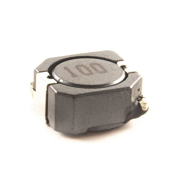

    固定电感器 Nonstandard 2.2µH ±20% 9.25A 7.2mΩ
PCS105-2R2M-RC 数据手册
RoHS Power Chip Shielded Inductors Dimensions: Allied Allied Part Part Number Number Inductance Inductance (µh) (µH) Tolerance Tolerance (%) (%) Test Test DCR Frequency( Ω) Freq. KHz, 1V Max PCS105 Inches (mm) DCR SRF Max. (MHz)Typ (Ω) ISAT IDC (A) (A) PCS105-R80T-RC 0.8 30 100 0.0043 13.50 PCS105-1R5T-RC 1.5 30 100 0.0058 10.50 PCS105-2R2T-RC 2.2 30 100 0.0072 9.25 PCS105-3R3T-RC 3.3 30 100 0.0104 7.80 PCS105-4R7T-RC 4.7 30 100 0.0123 6.40 PCS105-6R8T-RC 6.8 30 100 0.0180 5.40 PCS105-8R2T-RC 8.2 30 100 0.0200 4.85 PCS105-100T-RC 10 30 100 0.0260 4.45 PCS105-120T-RC 12 30 100 0.0330 4.00 PCS105-150T-RC 15 30 100 0.0410 3.60 PCS105-180T-RC 18 30 100 0.0460 3.20 PCS105-220T-RC 22 30 100 0.0610 2.95 PCS105-270T-RC Features • • • • Shielded SMD Power Inductor Available in magnetically shielded Low DC resistance Ideal for DC-DC converter applications Electrical Inductance Range: 0.8µH to 1000µH Tolerance: 30% over entire range Also available in tighter tolerances M = 20%, T = 30% Operating Temp: -55ºC to +125ºC IDC: Current at which inductance drop = 35% typ. 27 30 100 0.0690 2.70 PCS105-330T-RC 33 30 100 0.0840 2.50 PCS105-390T-RC 39 30 100 0.1060 2.30 PCS105-470T-RC 47 30 100 0.1300 2.00 PCS105-560T-RC 56 30 100 0.1490 1.90 PCS105-680T-RC 68 30 100 0.2010 1.65 PCS105-820T-RC 82 30 100 0.2270 1.50 PCS105-101T-RC 100 30 100 0.2530 1.35 PCS105-121T-RC 120 30 100 0.3030 1.28 PCS105-151T-RC 150 30 100 0.3700 1.12 PCS105-181T-RC 180 30 100 0.4190 1.04 PCS105-221T-RC 220 30 100 0.5000 0.94 PCS105-271T-RC 270 30 100 0.6720 0.84 PCS105-331T-RC 330 30 100 0.8120 0.75 Packaging: 500 pieces per 13 inch reel. PCS105-391T-RC 390 30 100 0.9530 0.70 Marking: EIA Inductance Code PCS105-471T-RC 470 30 100 1.290 0.60 PCS105-561T-RC 560 30 100 1.430 0.54 PCS105-681T-RC 680 30 100 1.600 0.52 PCS105-821T-RC 820 30 100 1.770 0.50 PCS105-102T-RC 1000 30 100 1.990 0.48 All specifications subject to change without notice. 949-356-1780 ALLIED COMPONENTS INTERNATIONAL REVISED15 09/07/2017 Resistance to Soldering Heat Pre-Heat 150ºC, 1 minute. Solder Composition: Sn/Ag3.0/Cu0.5 Solder Temp: 260ºC ± 5ºC for 10 sec. ± 1 sec. Test Equipment (L): HP 4192A LF Impedance Analyzer (RDC): Chen Hwa 502 (IDC): HP4284A + HP42841A Physical Option Insert “A” after tolerance indicator for added epoxy in the assembly process. This has been proven to further eliminate noise due vibration in certain applications. Example: PCS105-XXXT-A-RC www.alliedcomponents.com
