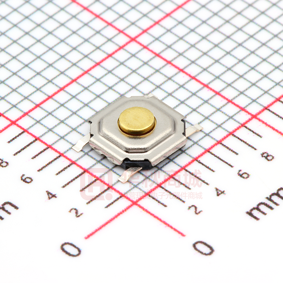

    SMD-4P,5.2x5.2mm
    轻触开关 5.2*5.2*1.5mm 立贴
SKQGAKE010 数据手册
TACT SwitchTM 5.2mm Square Low-profile (Surface Mount Type) SKQG Series Available in two types - 0.8mm height without stem or 1.5mm height with stem. Detector Push Slide Rotary Encoders Power Dual-in-line Package Type TACT SwitchTM CustomProducts Product Line Product No. SKQGAEE010 SKQGAAE010 SKQGACE010 SKQGAFE010 SKQGABE010 Operating force 0.98N 500,000cycles 1.57N 2.55N 0.98N 1.57N 2.55N 100,000cycles 3.43N Vertical 0.25 50mA 12V DC 10BA 1V DC 50,000cycles 100mΩ max. With stem 4,000 2 Without stem 5,000 1 Operating Travel Rating Rating Operating life direction (mm)(max.)(min.) (5mA 5V DC) Initial contact resistance Variety Minimum order unit Drawing (pcs.) No. 500,000cycles Sharp Feeling Soft Feeling Snap-in Type Surface Mount Type Radial Type SKQGADE010 SKQGAKE010 Specification of Embossed Taping Package (Taping Packaging for Auto-insertion) Reel Size Plastic Reel Series SKQGAA SKQGAC SKQGAE ¿380 13.5 Unit:mm Number of packages pcs.) ( 1 reel 1 case /Japan 50,000 1 case /export packing 50,000 Tape width (mm) 5,000 SKQGAB SKQGAD SKQGAF SKQGAK 12 4,000 40,000 40,000 Note 1. Please place purchase orders for taping products per minimum order unit (1 reel or a case). 2. For φ330mm diameter reel requirements, please contact us. Refer to P.306 for soldering conditions. 276 TACT SwitchTM 5.2×5.2mm Low-profile (Surface Mount Type) SKQG Series Dimensions No. Photo Without stem type 1 2 Unit:mm Style PC board mounting hole dimensions (Viewed from switch mounting face) Detector Push 3.7 5.2 ø3 Prohibitted area of copper tracks 0.5 Slide Rotary 2.6 1 3 5.2 6.4 4 4.8 Encoders 2 4.4 Power Dual-in-line Package Type TACT SwitchTM 0.8 8 With stem type 1 2 CustomProducts 0.5 3.7 5.2 ø2 Prohibitted area of copper tracks 2.6 2 3 5.2 6.4 4 4.8 2 Sharp Feeling Soft Feeling Snap-in Type Surface Mount Type Radial Type Stem 4.4 8 Circuit Diagram 1 3 2 4 0.8 1.2 1.5 277 TACT SwitchTM List of Varieties Sharp Feeling Type Series Detector Push Type Slide Features Rotary Encoders Power W Dual-in-line Package Type TACT SwitchTM H CustomProducts Operation force coverage 5N Ground terminal Operating temperature range Electrical performance Durability Insulation resistance Voltage proof Vibration Lifetime Cold Dry heat Damp heat Page 482 265 267 268 7.1 See the relevant pages for respective product descriptions ― 11.3 4.3 12 0.35 0.4 0.5 0.55 0.6 0.8 11.5 □10 □12 11.9 □3.7 □4.5 □4.8 7 7.5 □5.2 4–direction Water–proof switch+push Horizontal type switch ● ― ― ● Snap–in Long Life ● ― ● Long Stem ● ● Surface mount Low–profile ● ― ● ● Low–profile and long life Low–profile ● ● SKQU SKQB SKQE SKHC SKHK SKRW SKRM SKQR SKRB SKRR SKQG Photo Dimensions (mm) Operating direction Vertical Horizontal D 1N Sharp Feeling Soft Feeling Snap-in Type Surface Mount Type Radial Type ー30℃ to +85℃ 100MΩ min. 100V DC 250V AC for 1min. SKRW/RM/RB/RR : 100V AC for 1min. 10 to 55 to 10Hz/min., the amplitude is 1.5mm for all the frequencies, in the 3 direction of X, Y and Z for 2hours respectively Shall be in accordance with individual specifications. ー30±2℃ for 96h 80±2℃ for 96h 60±2℃, 90 to 95%RH for 96h 270 271 272 273 274 275 276 ● TACT SwitchTM Soldering Conditions ………………………………………………………………………………………306 ● TACT SwitchTM Cautions ………………………………………………………………………………………………………307 ● Product Line of Knob for TACT SwitchTM ……………………………………………………………………………………308 Note The automotive operating temperature range to be individually discussed upon request. Environmental performance W:Width. The most outer dimension excluding terminal portion. D :Depth. The most outer dimension excluding terminal portion. H :Height. The minimum dimension if there are variances. 248 TACT SwitchTM Soldering Conditions Condition for Reflow Available for Surface Mount Type. 1. Heating method: Double heating method with infrared heater. 2. Temperature measurement: Thermocouple 0.1 to 0.2φ CA K) CC T) solder joints copper foil surface) A heat resistive tape ( or ( at ( . Detector Push Slide Rotary Encoders Power should be used to fix thermocouple. 3. Temperature profile Temperature (˚C ) 260˚C max. 3 sec max. 180 150 Time 230˚C Dual-in-line Package Type TACT SwitchTM 120 sec max. pre-heating ) ( 3 to 4min. 40s max. CustomProducts Time inside soldering equipment Note 1. The above temperature shall be measured on the mounting surface of a PC board. There are cases where the PC board's temperature greatly differs from that of the switch, depending on the material, size, thickness of PC boards and others. The above-stated conditions shall also apply to switch surface temperatures. 2. Soldering conditions differ depending on reflow soldering machines. Prior verification of soldering condition is highly recommended. Sharp Feeling Soft Feeling Snap-in Type Surface Mount Type Radial Type Conditions for Auto-dip Available for Snap-in Type and Radial Type (Except SKHJ, SKHL, SKQJ, SKQK, SKEG series) Items Flux built-up Condition Mounting surface should not be exposed to fluk Ambient temperature of the soldered surface of PC board. 100℃ max. 60s max. 260℃ max. 5s max. 2times max. Manual Soldering(Except SKRT Series) Items Soldering temperature Duration of soldering Capacity of soldering iron Condition 350℃max. 3s max. 60W max. Preheating temperature Preheating time Soldering temperature Duration of immersion Number of soldering Notes 1. 2. 3. 4. 5. Consult with us for availability of TACT SwitchTM washing. Prevent flux penetration from the top side of the TACT SwitchTM. Switch terminals and a PC board should not be coated with flux prior to soldering. The second soldering should be done after the switch is stable with normal temperature. Use the flux with a specific gravity of min 0.81. (EC-19S-8 by TAMURA Corporation, or equivalents.) 306
