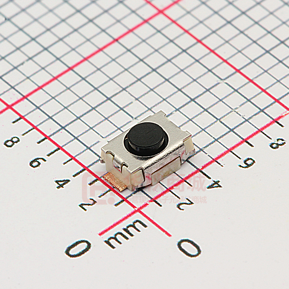

    SMD,3.9x2.9mm
    轻触开关 3.9*2.9*2mm 立贴
SKRKAEE020 数据手册
2017/6/19 SKRK Series - Basic information 3.9×2.9mm Compact Type (Surface Mount) SKRK Series Part number SKRKAEE020 Type Surface mount Operating force 1.57N Operating direction Top push Travel 0.13mm Operating life (5mA 5V DC) 200,000 cycles Initial contact resistance 100mΩ max. Stem height 2mm Series type Sharp feeling type Operating temperature range -30℃ to +85℃ Rating (max.) 50mA 12V DC Rating (min.) 10µA 1V DC Electrical performance Insulation resistance 100MΩ min. 100V DC for 1min. Voltage proof 250V AC for 1 min. Durability Vibration 10 to 55 to 10Hz/min., the amplitude is 1.5mm for all the frequencies, in the 3 direction of X, Y and Z for 2 hours respectively Environmental performance Cold -30±2℃ for 96h Dry heat 80±2℃ for 96h Damp heat 60±2℃, 90 to 95%RH for 96h Minimum order unit Japan (pcs.) Export 4,500 4,500 http://www.alps.com/prod/info/E/HTML/Tact/SurfaceMount/SKRK/SKRKAEE020.html 1/5 2017/6/19 SKRK Series - Basic information Photo Dimensions Land Dimensions http://www.alps.com/prod/info/E/HTML/Tact/SurfaceMount/SKRK/SKRKAEE020.html 2/5 2017/6/19 SKRK Series - Basic information Viewed from mounting face. Circuit Diagram Packing Specifications Taping Number of packages 1 reel 4,500 (pcs.) 1 case / Japan 45,000 1 case / export 45,000 packing Tape width (mm) 12 http://www.alps.com/prod/info/E/HTML/Tact/SurfaceMount/SKRK/SKRKAEE020.html 3/5 2017/6/19 Export package measurements (mm) SKRK Series - Basic information 395×395×205 Soldering Conditions Condition for Reflow 1. Heating method Double heating method with infrared heater. 2. Temperature measurement Thermocouple 0.1 to 0.2 Φ CA(K) or CC(T) at solder joints (copper foil surface). A heat resisting tape should be used for fix measurement. 3. Temperature profile (1) The above temperature shall be measured of the top of switch. There are cases where PC board's temperature greatly differs from that of the switch, depending on the material, size, thickness of PC board's and others. Care, should be taken to prevent the switch's surface temperature from exceeding 260℃. (2) Soldering conditions differ depending on reflow soldering machines. Prior verification of soldering condition is highly recommended. Manual Soldering Items Condition Soldering temperature 350℃ max. Duration of soldering 3s max. Capacity of soldering iron 60W max. 1. Consult with us for availability of TACT switch™ washing. 2. Prevent flux penetration from the top side of the TACT switch™. 3. Switch terminals and a PC board should not be coated with flux prior to soldering. 4. The second soldering should be done after the switch returns to normal temperature. Notes are common to this series/models. 1. This site catalog shows only outline specifications. When using the products, please obtain formal http://www.alps.com/prod/info/E/HTML/Tact/SurfaceMount/SKRK/SKRKAEE020.html 4/5 2017/6/19 SKRK Series - Basic information specifications for supply. 2. Please place purchase orders for taping products per minimum order unit (1 reel or a case). 3. For φ330mm diameter reel requirements, please contact us. 4. Please contact us for automotive use products. http://www.alps.com/prod/info/E/HTML/Tact/SurfaceMount/SKRK/SKRKAEE020.html 5/5
